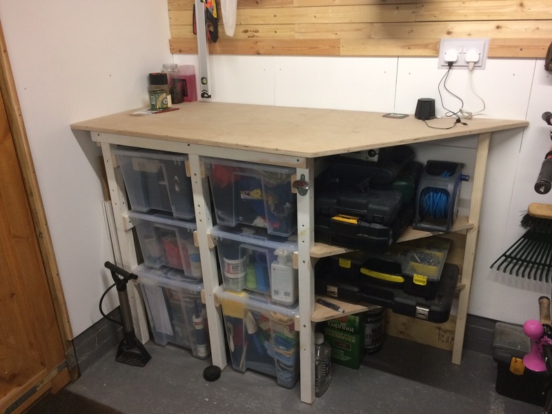

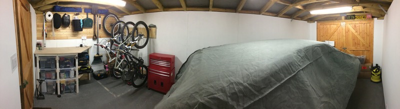

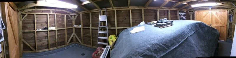

UPDATE: Again to the garage
All finished on the garage, so shortly back to working on the car now all the garage is straight. its so much easier to work in now and lots more space. It has hardly cost me anything too with free insulation and cheap plasterboard. The back wall is clad in pine bed slats and the shelving/worktop is made from the same pine bed frame. As for the car I will be un-covering it this week, and will probably try and get the engine on the engine stand to do the belts and switch the sumps.
A few pics of the finished article.
The garage BEFORE:
AFTER:

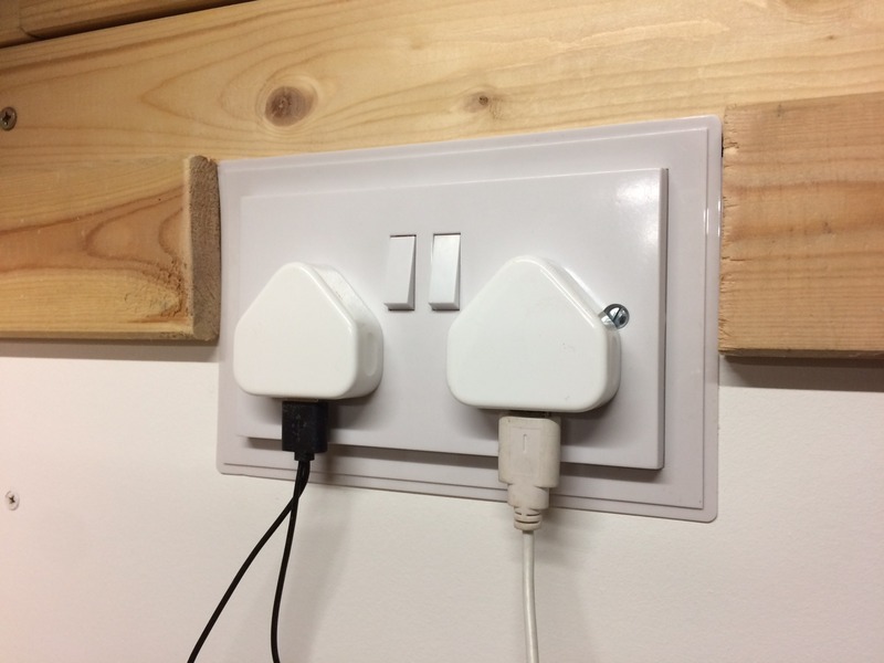

And some details:

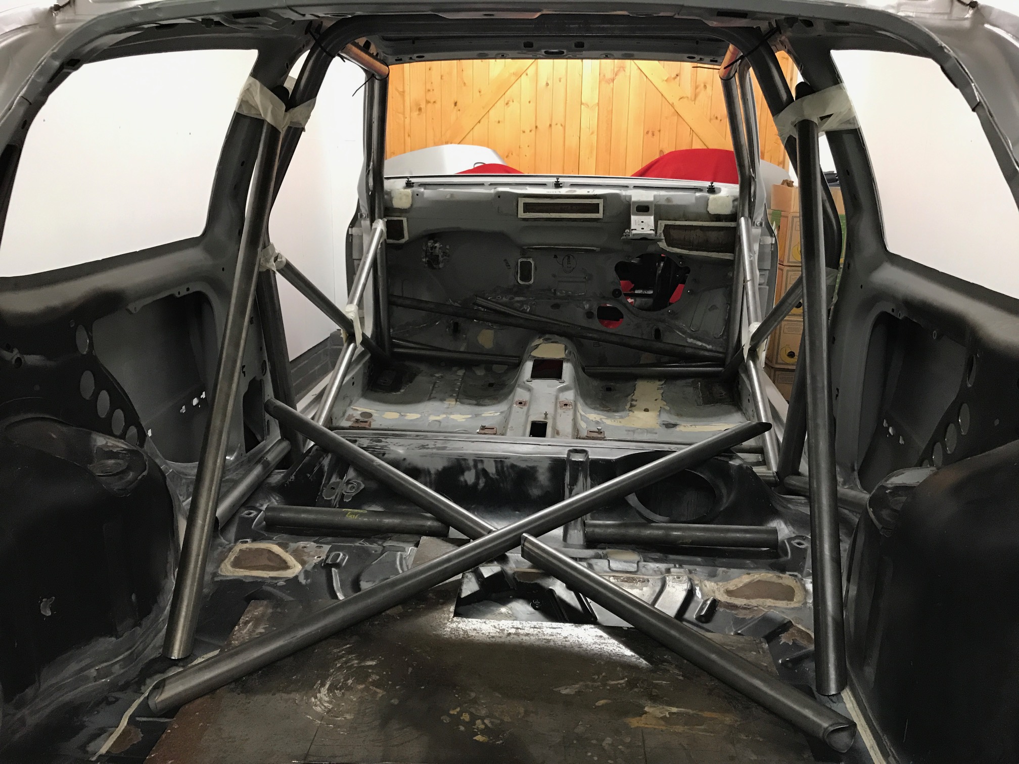

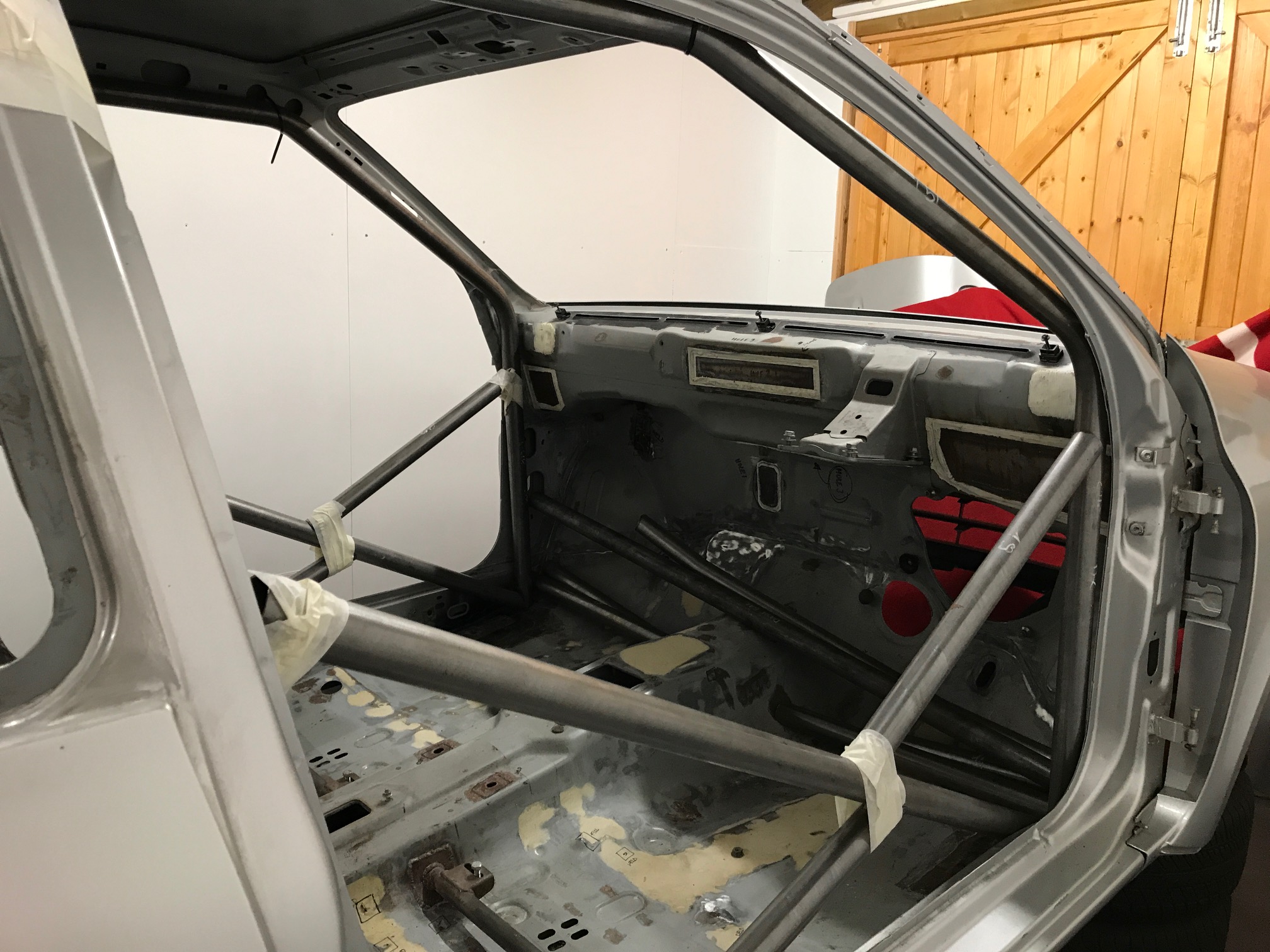

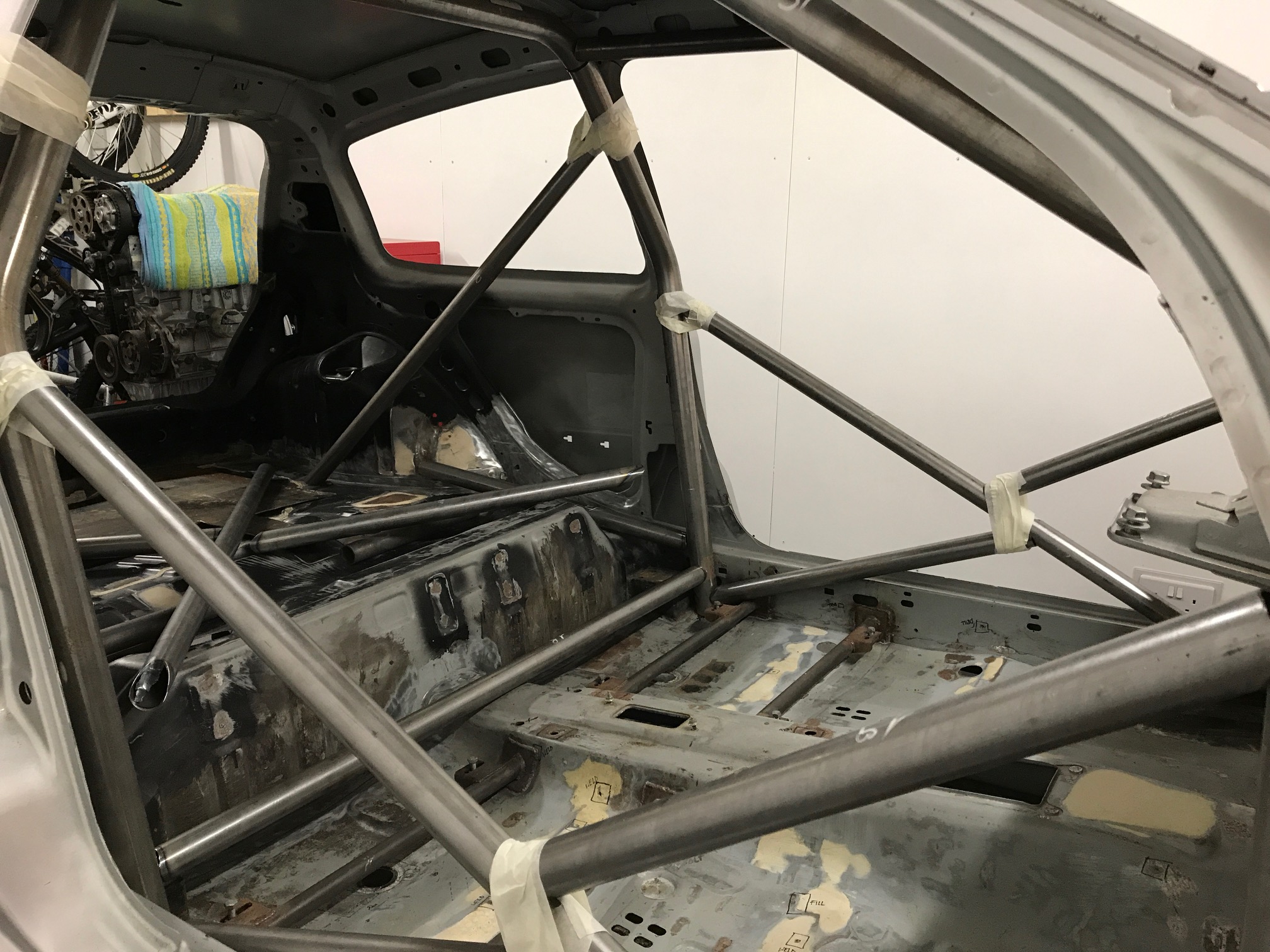

It really feels like I am on the verge of really getting back into moving forward with the build as the cage has now turned up and I can start looking forward to the fabrication stage. Over the past few days I have been reading @Tomotek's build thread, not only does that make my thread feel less than ideal (a bit of a mess) but it has also made me consider a lot of things with regards to the clio build that I perhaps hadn't thought of previously... I think I will be using his thread and a fair few others to reference from this point moving forward.
With the cage turning up I was keen to check all the items were in the packaging as the seller was less than ideal with their communication. I removed all the items and very quickly laid them out/mocked them up to see. All items were there luckily.
The cage is a Sassa/oreca 6-point with added dash and harness bars - I am wondering if it will be beneficial to triangulate to the rear beam mounts, and instead of going to the rear arch I should go to the rear shock mounts - However it will be my neighbour doing the welding so I am conscious of all the extra fab work that will be needed - and whether I will actually notice a difference. Something to consider. For now though see some poor mock up pictures (tape and zip ties are alright yeah)?

If you're going coilover rear I'd triangulate to the rear strut tops and the beam mounts. The extra weight in the rear end will do it more good than you realise. Ask James about his corner weighting. Assuming he can remember. Lol!

@ph-reebone I have that cage and I altered mine to go to the rear strut tops with a bar joining both struts and also triangulated through to the front strut towers. I'll be adding further triangulation to the rear beam mounts over winter
I am now looking into doing this and looking at the base way to do this without being able to weld/fabricate myself.

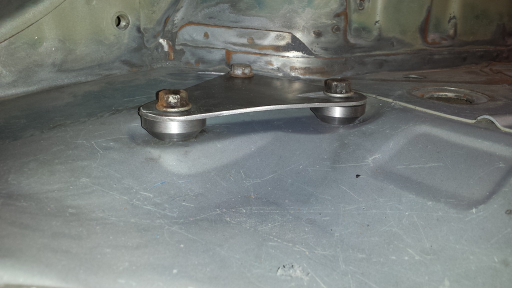

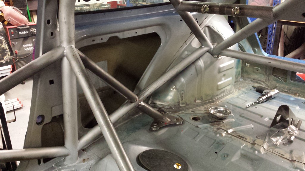

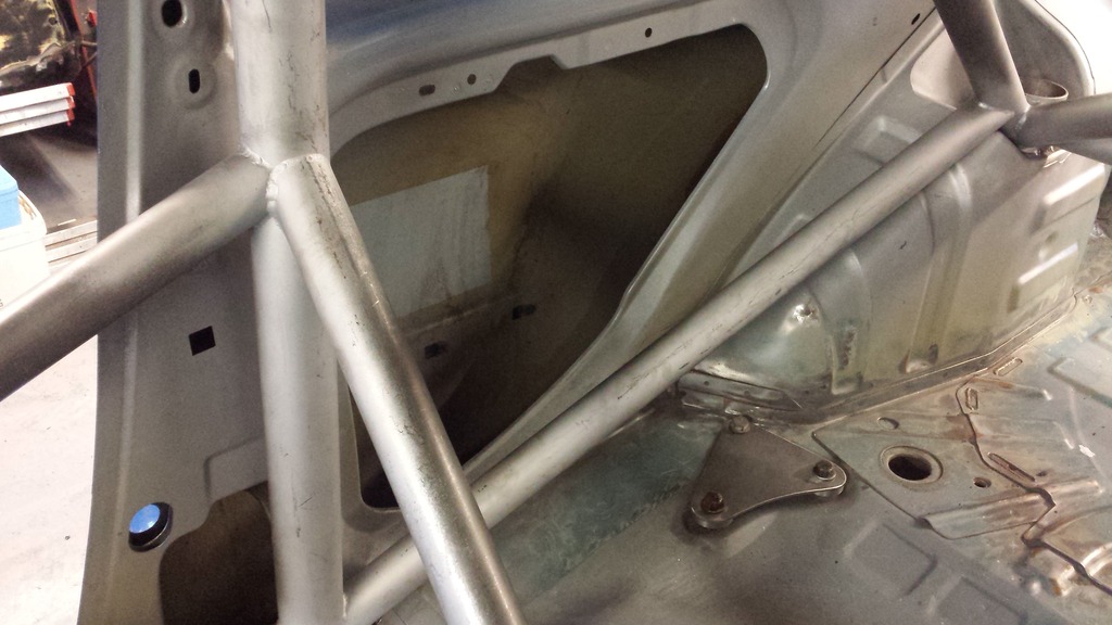

So after getting the original cage from Sassa/Oreca I have decided how I am going to alter it.
Unlike what I have mentioned above I have decided against triangulating to the rear beam mounts. I have spoken to several people who have made interesting points that although you may strengthen this area the actual rear beam bracket itself could/will flex, and then there is also possible play in bearings etc... you will never remove all play, and it may even be more a hinderance as you are just putting stress through a different point - the other choice for this cage was to give safety but not go OTT on weight.
I am however going to triangulate to the backstays to the rear suspension turrets and then also brace between them, I will need to order some more 3x 40x2 CDS for this and also some for the suspension turret tubes themselves - and this is where the issue lies. I can't believe how difficult this is to find. The inside diameter of this tube will need to be +50mm to fit over the current suspension mount point, meaning the tubing will probably need to be 57.15x2.03 however this comes out at a mental amount (£70 for 400mm..ha). I WILL find some somewhere, or alternatively I will have to get something machined up... either way I am very keen to get this moving.
