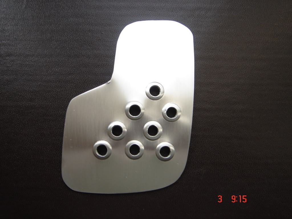

Or just find someone to whip you up something like this
Extended Accelerator Pedal
