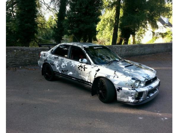

Mine is supposedly 320bhp and I can confirm that it's plenty. My mate can't keep up in his 535d. Not even close.
Nice....someone has obviously swapped out the TD04 turbo for something bigger and replaced the 380cc injectors and had it mapped.....That power is also right on the limit of the TMIC..

Yeah it's a td05. Someone else mentioned the top mount actually.
It's got the td05, sti intercooler, no cats, turbo back exhaust, panel filter, uprated clutch, and was mapped by someone whose name I can't remember. It's got more but I'm at work and the paperwork is at home.

If its an STI TMIC then its nowhere the limit, 400 is the norm although a fella from SN (bez) is running 480ish on his STI topmount. It its not been done already, replacing the WRX uppipe for an STI one is a cheap little mod and if you really want to get stuck in, lift of the inlet manifold for a TGV delete mod....At 320 there is definitely some more room for extracting a few more ponies.....TD05's can flow enough air to hit 350 although that is the upper end of what they can achieve.

Lay mans terms please? You need to talk to me like a 6 year old.

The Newage WRX has 3 CATS, the main down pipe, secondary CAT and the uppipe is also a CAT. The STI has no CAT in the uppipe so aids spool and is a cheap mod if you can pick one up.
The TGV's(Tumber Generator Valves) are basically butterfly valves which direct air over the injector for a better air/fuel mixture to help with emissions, removing them gives better airflow on the intake......They're housed in their own bodies between the inlet manifold and each head.....Something else the STI does not have.
