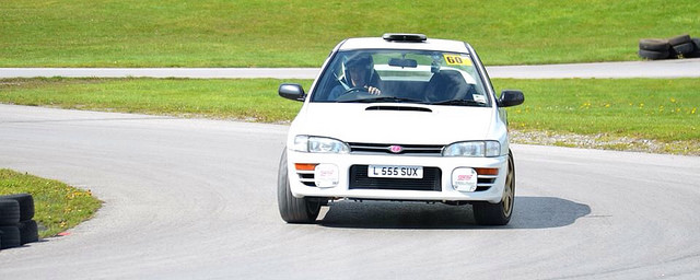

Pic of my mate joe at the time attack at oulton in his ra;
Joes ra by cobzy1, on Flickr
