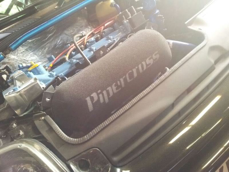

That oil leak looks pretty horrific... I would get the car to TDF and have the rocker cover resealed, I assume the work is warranted?

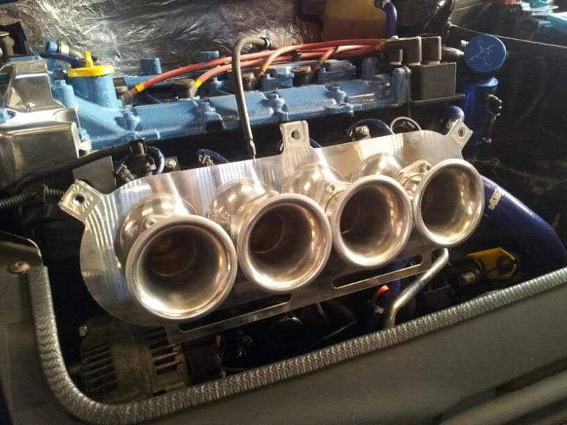

and get rid of that FILTER OF DEATH.... Just looking at how clogged up the trumpets and throttles are you can only imagine how caked up the valves etc. are!
There are plenty of filter solutions out there.. Pipercross, ITG both do a sausage filter with backing plates
I sorted a filter and few other bits out for a local lad who runs the K-tec DTH bodies on his PH-1 172:
Admitantly he fitted a 172 cup aux set up at the same time..
He was experiencing the same problems with the FILTER OF DEATH, trumpets and throttles clogged up and the filter dropping to pieces.

Please, please please get that awful filter of death off there asap!! As you can see, god only knows whats being sucked in there ...

Cheers for the information mate. I'm happy to report that a new filter has been sourced and sorted and will be fitted in the very near future. I will post up pics and thoughts, etc. in a coming thread update. I've also contacted BG Motorsport and am looking to have the work done in the first week of October all being well, including the adjustment upgrade ('unpinning').

Regarding the filter of death, I am concerned as to the state the valves might be in. Whilst the trumpets and butterflies get a good cleaning the valves aren't so easy to do (!) so I'm hoping for the best. The good news is that my new filter solution is on the way, consisting of a proper backplate and filter on top with plenty of room to breathe. The car is not being driven much either so hopefully any problems won't be exaggerated.

It looks to be due to the ITB's being in need of balancing. Under partial throttle you can actually see that the rightmost butterfly is opening before (and further) than the others, with the leftmost also slightly out of sync. The valves may also be clogged up with the foam shed from the filter of death. When I get them balanced and serviced in the coming weeks I'll take a closer look and report back in a thread update.

At this point I still find myself in a position where my new ITB filter solution is ready and waiting for me (I should have got it last week), my ITB's still need servicing and balancing, ECU update and software to be acquired, general service is needed, new brakes need fitting, lower gearbox mount needs replacing (it's broke completely) and a plethora of other little niggles that all should have been fixed last week. It's also another handful of annual leave days lost in work.

The more I see cars with Itb's the more it puts me off, I think they are more for a track car than a daily, hope its nothing too costly.
Yeah, Andy not being funny mate but I'd be taking it back to TDF and asking them to get a look at it, even if it's unrelated to the top end rebuild, they know the car.
For a start your cam cover definitely needs resealing. If you tell them they'll do at least that under warranty
Has Fred had a look at it yet?
Bummer mate If you have low comp hopefully it points toward top-end and maybe you can may have some come back on the work done but if shes breathing heavy..........
On a brighter note you could always save a few K and buy my cup :)
Didn't the car have a top end rebuild at TDF?
Have you contacted them to discuss the problems?

I think its think its safe to say that i would be taking it back to them at this point.
you sure dont have any luck mate :dapprove:
To be fair mate, it's not the ITB's. There are many daily runners on here with ITB's and they are running well (at least as far as I know). I believe the issue is definitely engine/component related hence I don't really have a good foundation for the ITB's and/or other modifications at present. I wouldn't be put off getting ITB's though (assuming funds are available and that one has realistic expectations as to the gains likely to be achieved).
Cheers fella - yes, I'm looking at getting it sorted at the moment. The problem is that I'm just about out of funds and have used my annual leave entitlement in a bid to get this car sorted already! Two weeks of my entitlement staying in hotels, etc. whilst travelling and waiting to get it sorted... Work have been great but I can't take anymore time as it's taking the pi$$ (although my work colleagues are having a bloody good laugh about the whole thing!)
Fred has seen my car but not in-depth. I popped in the other week to say 'hi' and to discuss future work, although I reckon any future work will be put on hold until I definitely have the current issue(s) fixed. I am looking to go back to TDF with the problems but in future think I will go to Fred for mechanical stuff. THIS IS NOT A SLUR ON TDF!!!! It's simply because Fred is a lot closer to me (only 2 hours away) and I like the guy (please don't tell him). For mapping, etc. then I'll still be visiting TDF. :D As it stands though - yes - TDF know my car and hopefully can get onto it asap.
Funnily enough, Fred was at TDF when I went to pick up my Trophy following the work I had done there. He also saw as it started to spew oil as Matt was finishing off the mapping. He suggested it was the cam seals and he was right. Anyways, I digress...
I'm not sure if any warranty was given on the work TDF did to be honest. I don't think there was. All I remember is that they were extremely busy at the time they worked on mine and went out of their way to help and get it back to me.
