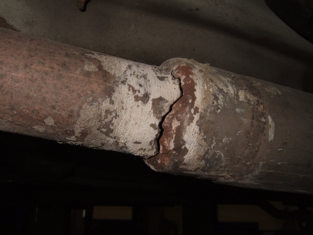

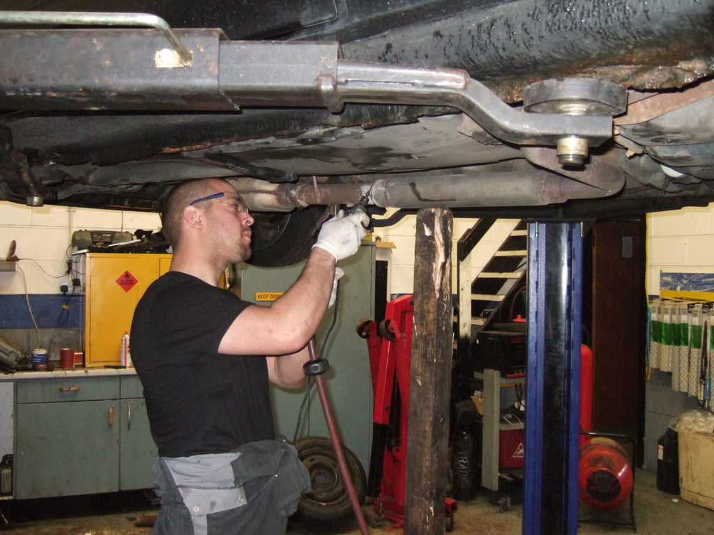

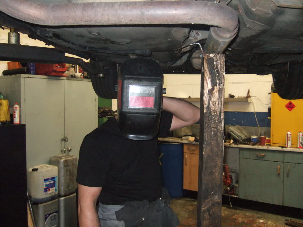

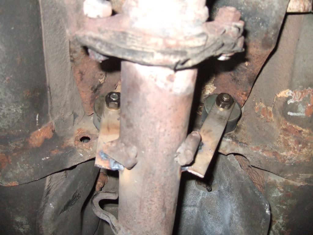

1. Exhaust Blowing - he welded up the knackered join

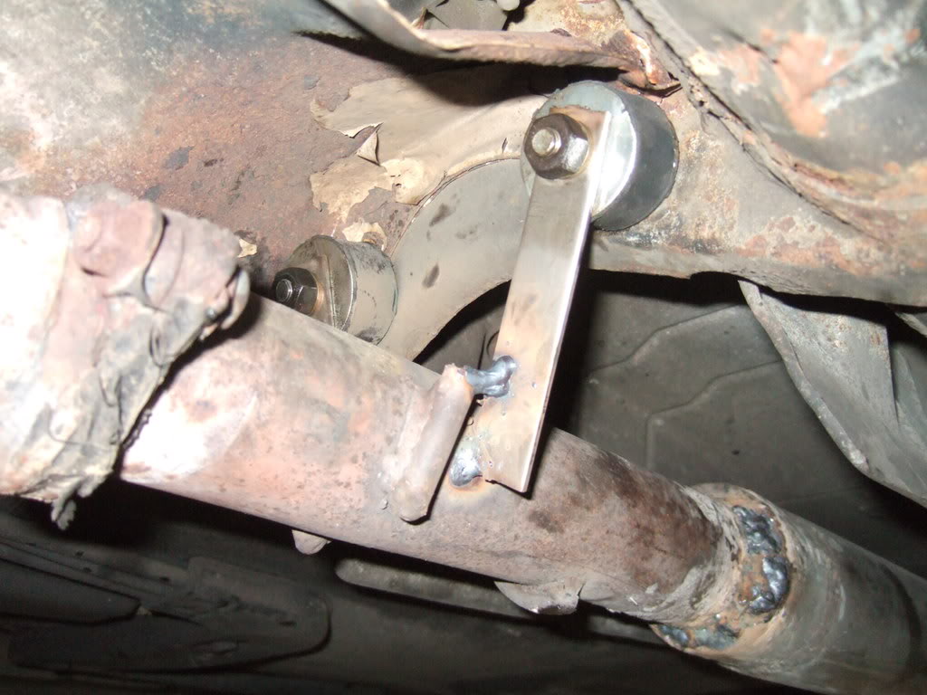

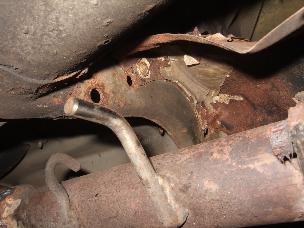

2. Exhaust Hangers improvised some beefy hangers
3. Steering Play - welding the UJ/column joint - a common problem apparently

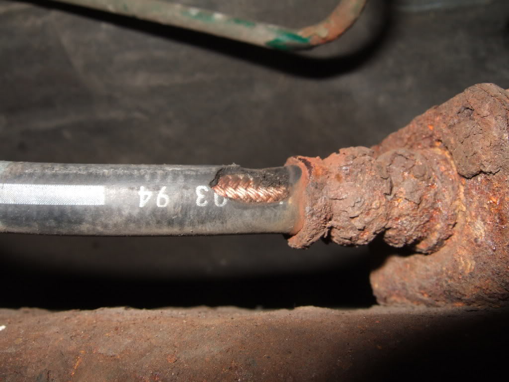

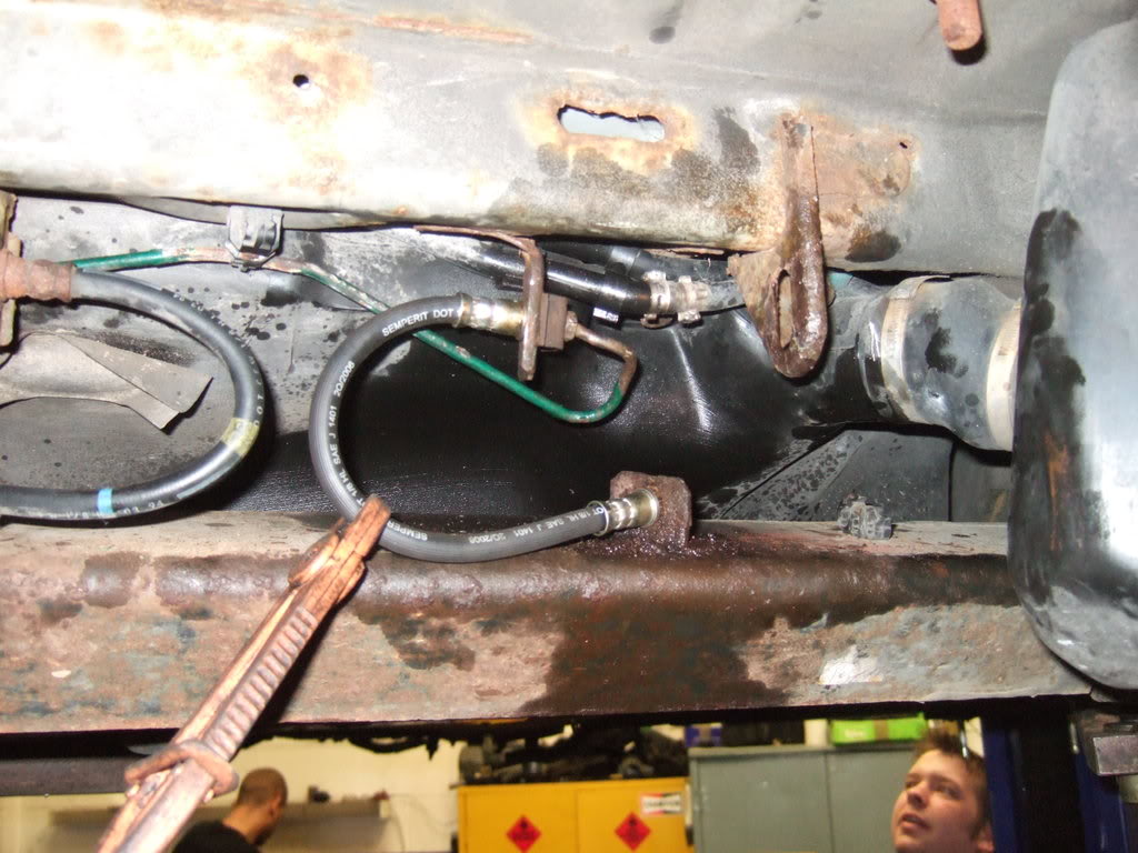

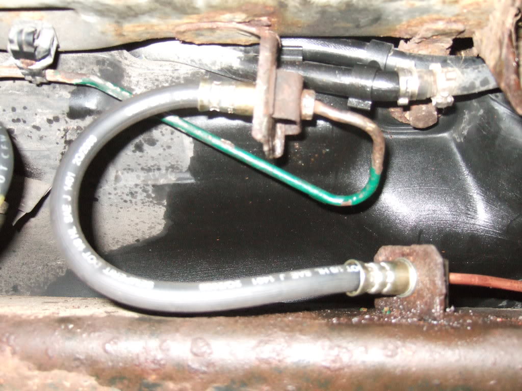

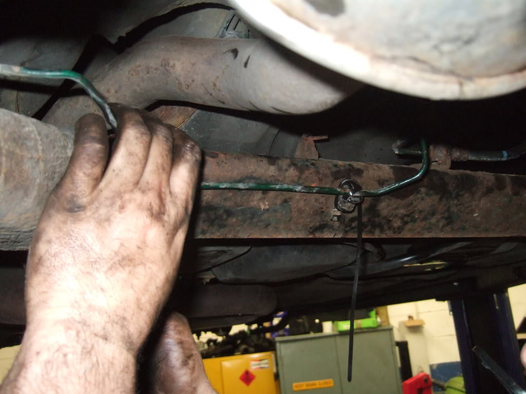

4. Rear Brake Hose you can see where it was knackered, we replaced it
5. Brake hose clips - cable ties FTW

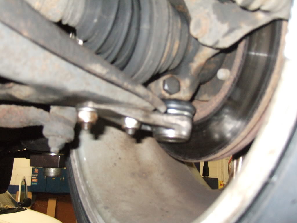

6. Bottom ball joints both sides

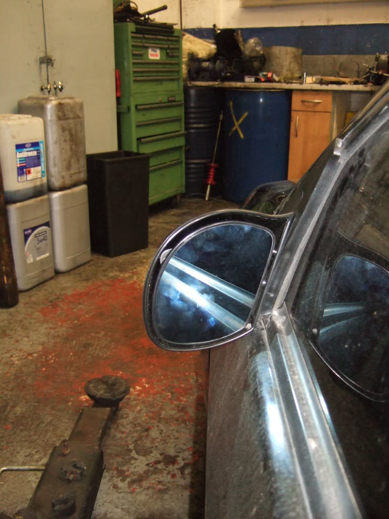

7. New Mirrors
