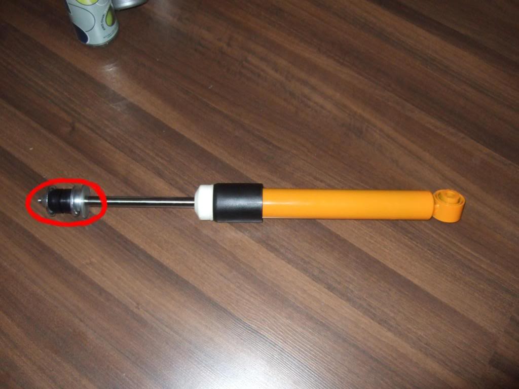

right i know how to do the front's just wondering on the rear's, do i take the bit off the top that is circled in red or do i put the old top mount on top of that ?
  alien green rs133
Re: The lowwwwwww ph2 remake - Progress Thread
one bit of rubber goes under neath and one ontop of the hole it goes through, but first you need to take the cover off your other shock as it incorperated the bump stops.
there should be instructions in the box btw
didnt come with any lol have you got a picutre of this or a diagram ?
  alien green rs133
ok i admit i explained it badly.
slide everything off the top after unscrewing the nut, keeping it all in order.
slide the cover off your old shock onto new shock (cover is a black plastic bit similar diameter to a bog roll tube, with a rubber end on it.)
slide things back on in order apart from the last three things to go on.
a rubber,
a washer
and a nut.
put strut through the hole, put rubber then washer and then tighten nut down.
then you gotta wind that fecker down till its scrubbing :D
simples, you will kick yourself its so easy

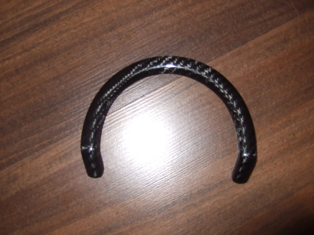

SMALL UPDATE
I got this in the post today looks really nice im very happy with it thanks K-tec :approve:

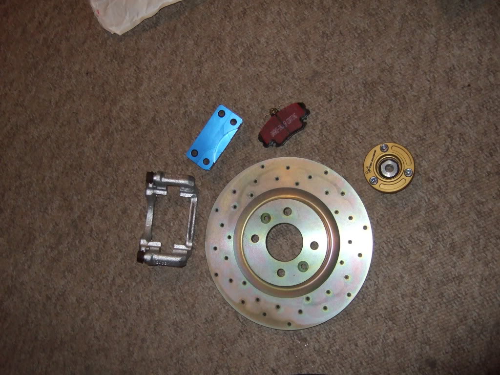

----UPDATE----
:approve: Well i ordered this all over xmas from ktec and im over the moon with it all and they posted it super fast so thanks to ktec for that, just waiting for the snow to go before i can fit it all.
ktr solid top mount
ktr big brake kit
carbone lorraine dot 4 brake fluid
will upload more pictures when it is all fitted :D

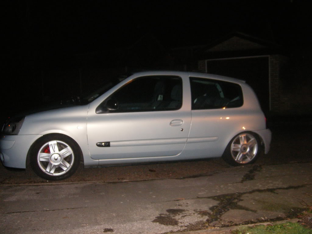

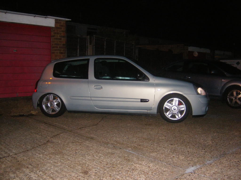

well i went to r-tec today to get my coilovers fitted with the custom rear spring going back on monday to get new wheels and to get the custom springs taken out as it is just too lowwww. hope you like ;)
The Boosh!
ClioSport Admin
  Elise, Duster
You need to go way lower on the front to pull the rear off IMO
  Megane 225
That is lowwwwwwwww! How much do those rear springs lower it by?
Fuking lol! Sorry mate but IMO that looks absolutely gash. It doesnt look lowered, it just looks like the whole rear suspension has given up! Can't see the appeal to be honest, but each to their own.
Sorry dude, but have to agree with Dan.
Jord pulled the look off as he had the right wheels and stance.

the front is as low as it will go without rubbing but the back will be going back up just wanted to see what it looked like lol
