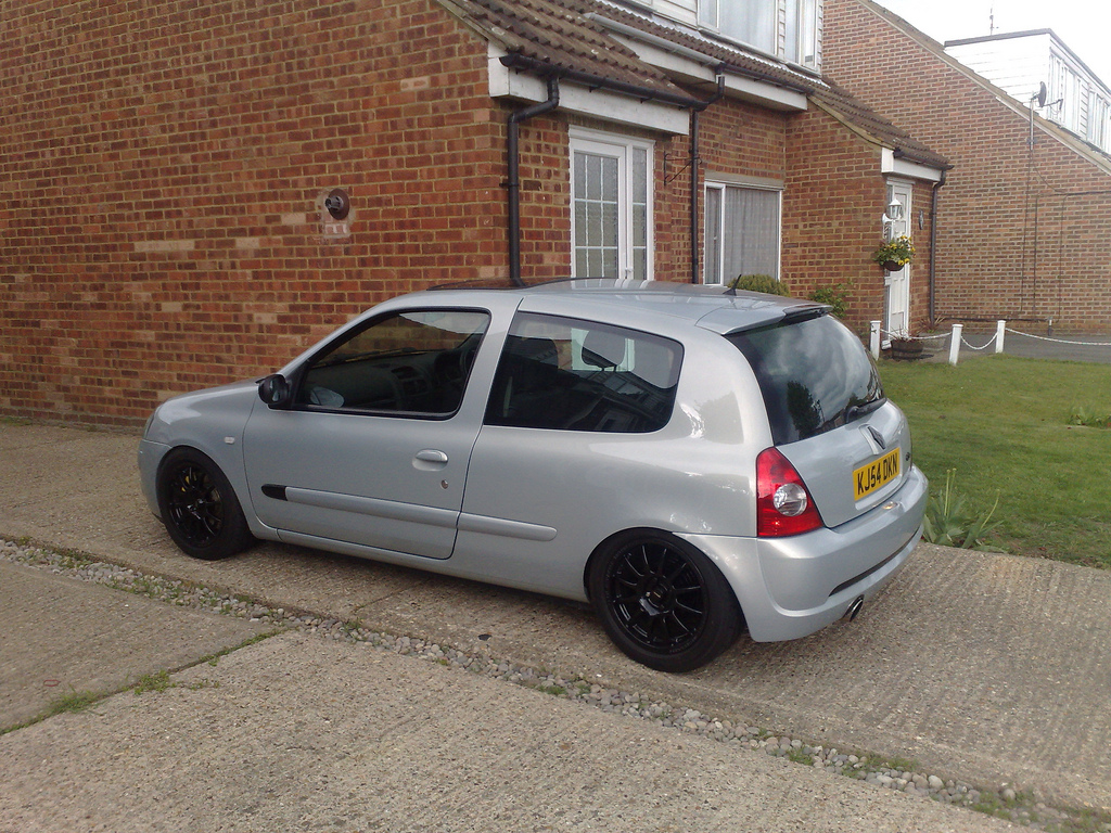

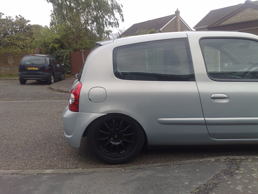

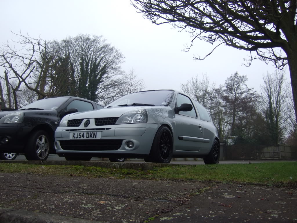

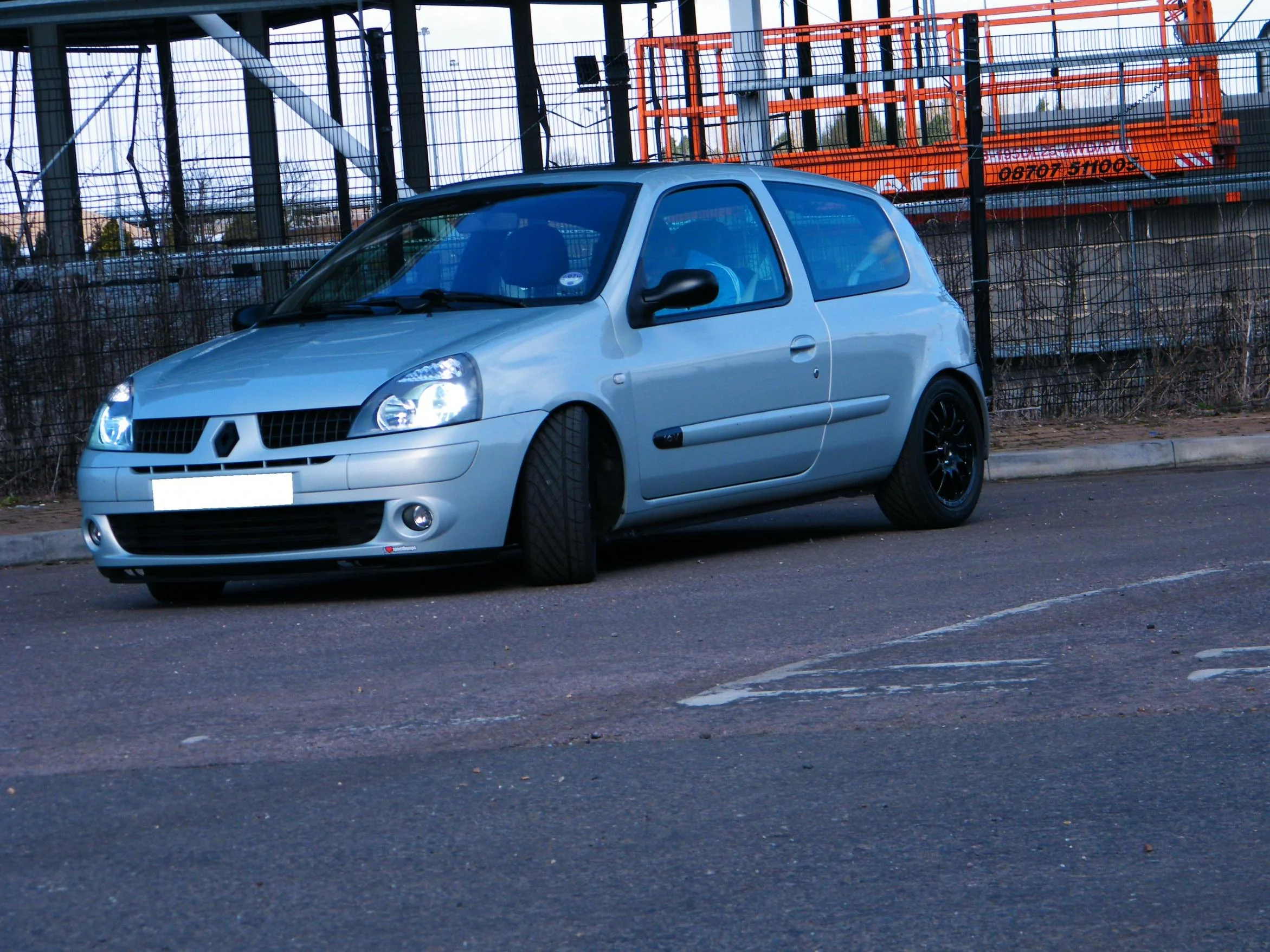

As for the rear, I'd go no more than 65mm/70mm on it
90mm looks crap, 80mm wont look much better, 70mm should be spot on
It wants the back raising 20mm and the front dropping 20mm and it should still hold its original stance just with a 4 inch drop :)

Great looking car! :)
It looks spot on, I'd leave it (for the outside). Also, that gap on your rear bumper either side is normal. Mine was exactly the same, also seem to sit a bit lower under the rear lights than the sports did. I learned to live with it, no one can tell apart from you and us clio owners haha. :)

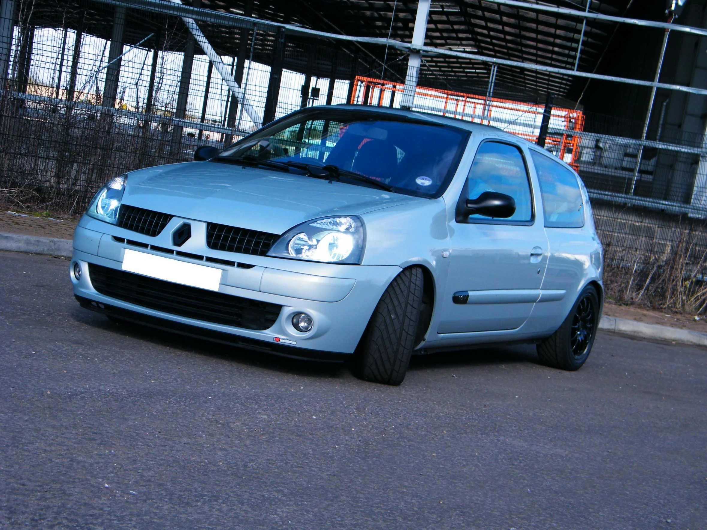

its 90mm at the front and around 70ish at the back photos arnt the best will up load better ones soon

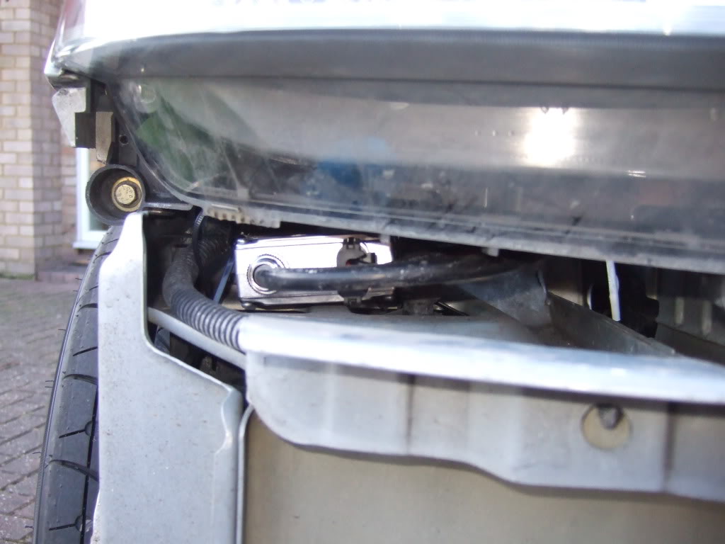

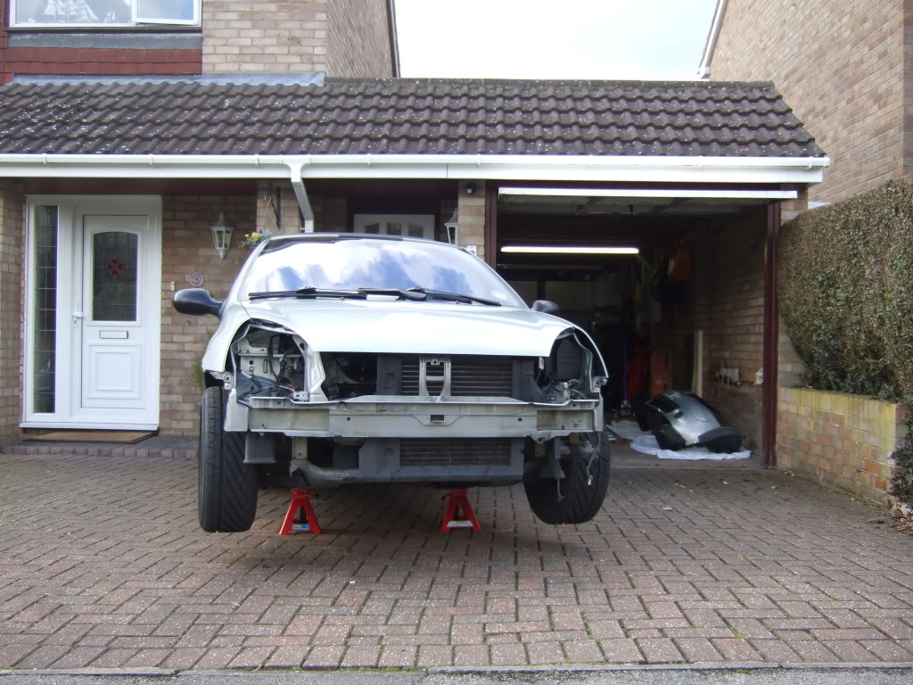

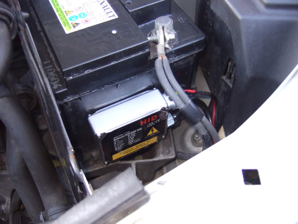

This is quite a small update nothing marjor i got my arse in gear and tryed to figure out how i fit the h.i.d light, well i was kicking my self in the end as it was soo easy :D Frist i started to take the front bumper and light out as i still need to sand down the bumper brackets abit more.

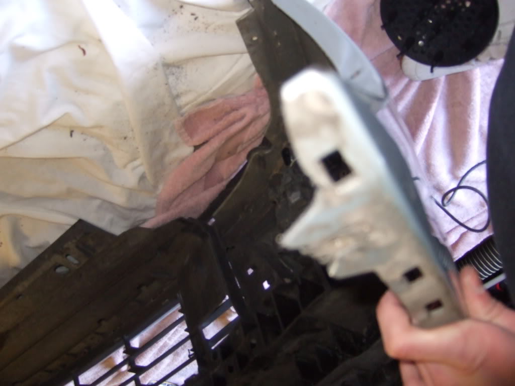

As my car is soo looow at the front i cant just stick my head under it and undo the bolts that hold the bumper on i have to jack the car up and stick it on some axle stands, it does make life quite alot easyer ;) after all that i started by sanding the bumper brackets down abit more and ive taken all the front arch liners out lol

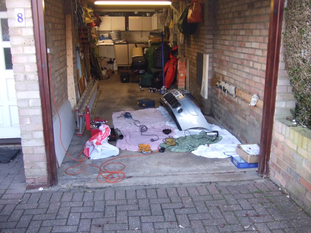

This is my work space nothing huge but it does the job quite will :eek:
You can see the huge piece of bumper bracket that has been cut off and sanded down not the best picture in the world but you get the idea.
When i started to fit the h.i.d units i didnt want the power pack on show so on the right light i mounted it under the light with some cable ties very happy with the result as you can see it at all :)
On the left hand side light i could mounted the h.i.d unit like the right hand side one so i had to try and make it look neat but im going to have another look and try and find a new spot for it as it too on show for my liking :approve: will have a few more updates soon :D

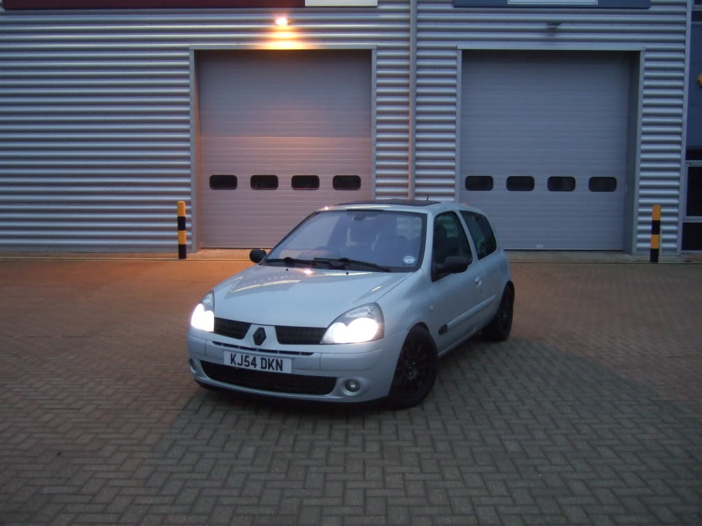

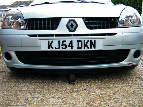

Right when i was driving around last night i pulled over to have a look at the light and see how good they look and i found a little problem that will really bug me lol The front right light is nice and bright blue colour and the front left is abit more of a yellow colour which isnt right so ive order so 8000k bulbs to fix it as i think the bulb is broken or somthing like that :dapprove:

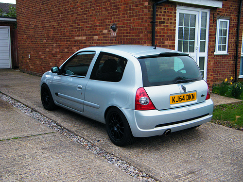

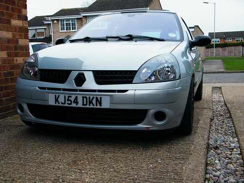

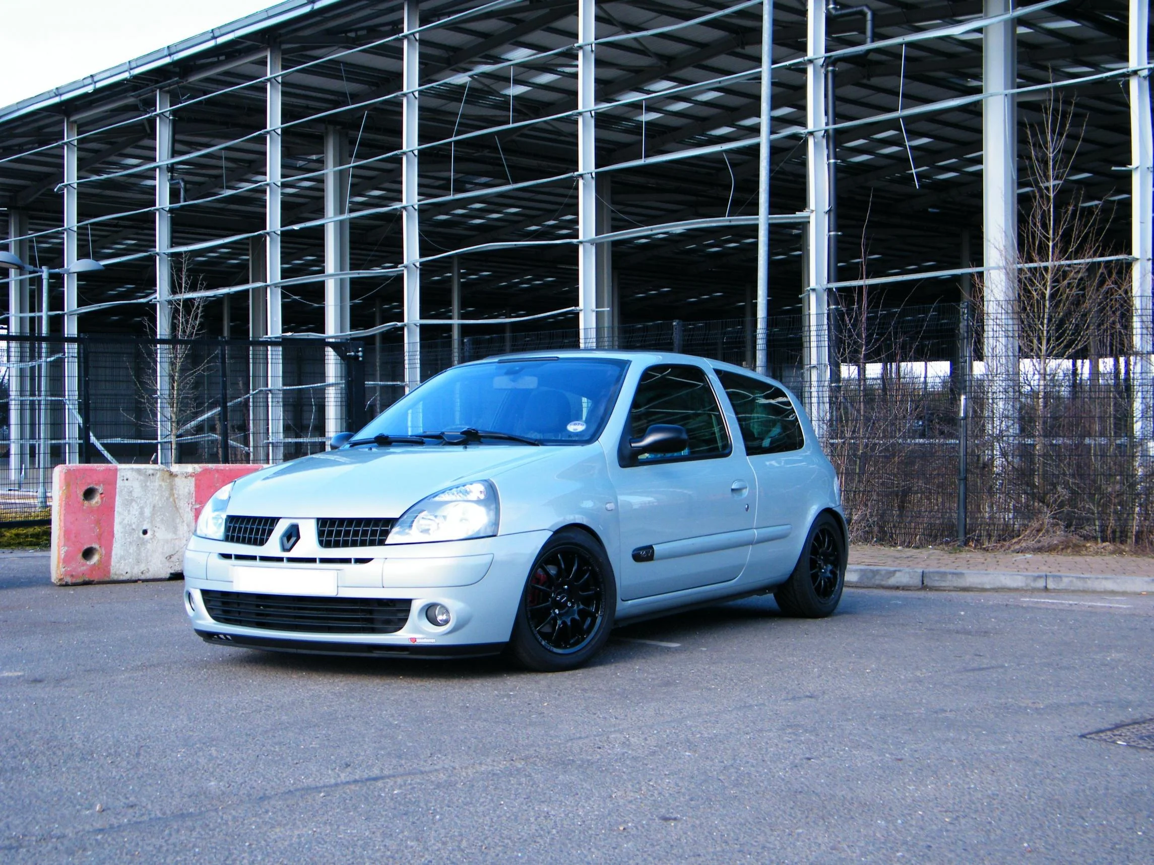

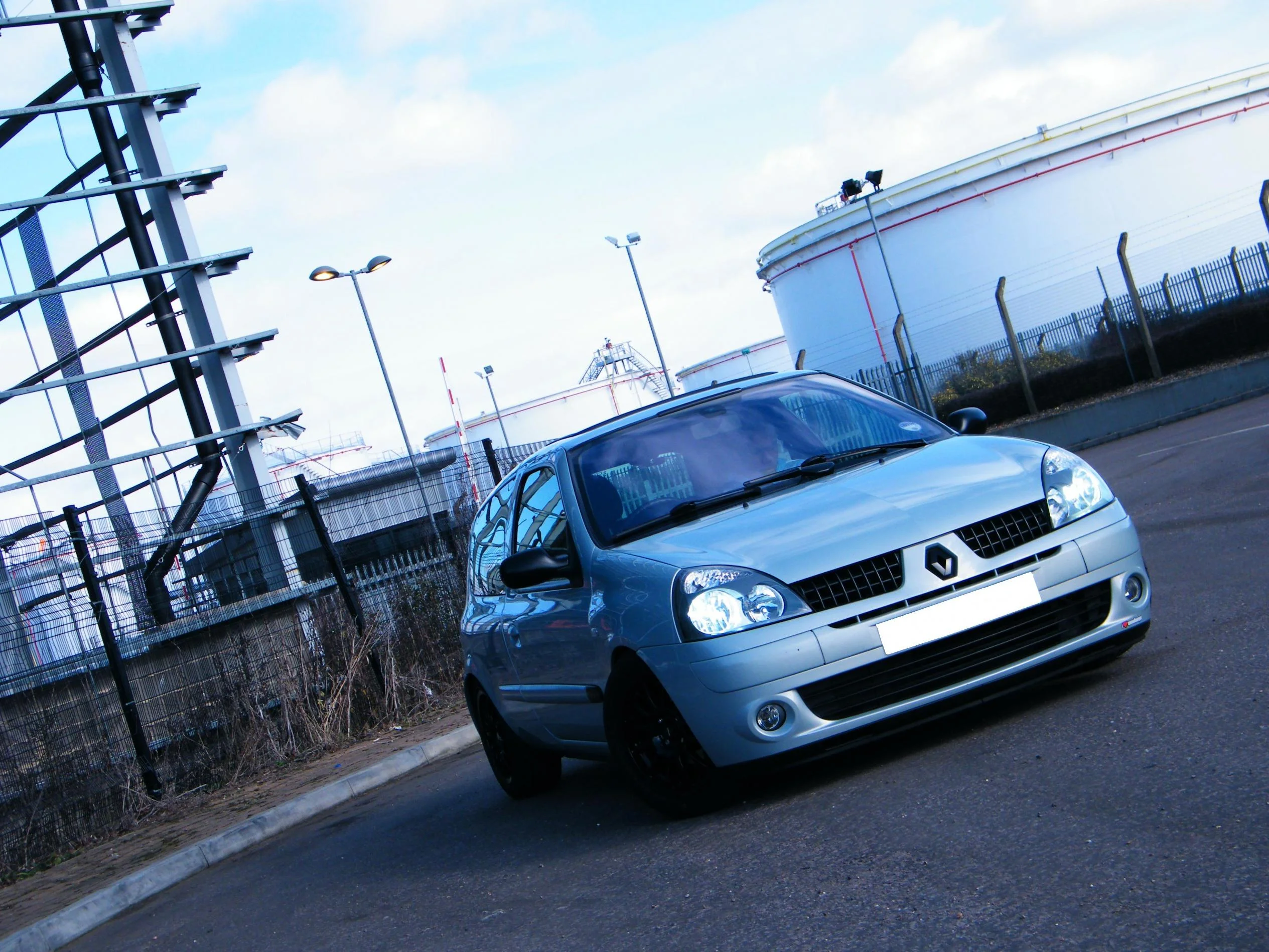

new camera new pictures hope you like ;)

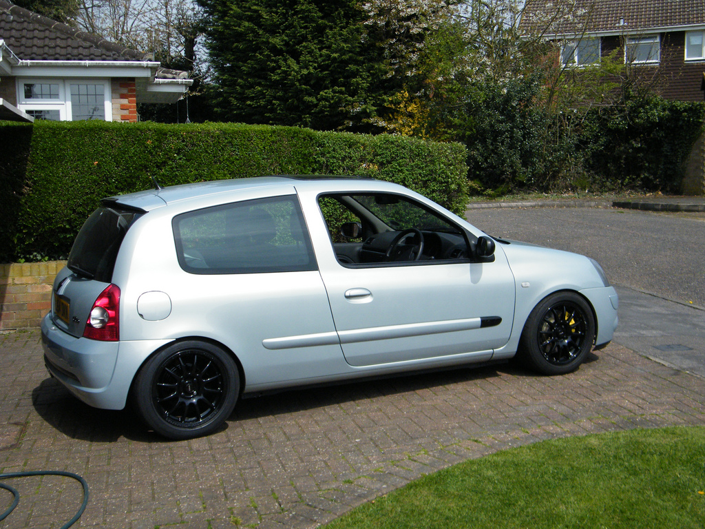

Height at the front looks excellent mate! Do you get any rubbing at that height? I had mine abit lower than that a few days ago while trying to get it perfect but the inside of the alloy was scrubbing up against something so i have had to take it up. Gutted tbh :(

im on 15s and i had to take out all the front arch liner and cut the bumper braket no rubbing now just need the rear to sit a little lower then ill be happy :approve:

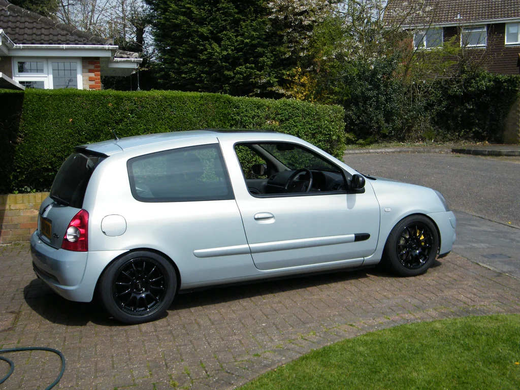

just took these pictures not that good :dapprove: will get better pictures at the essex meet on sunday :approve:

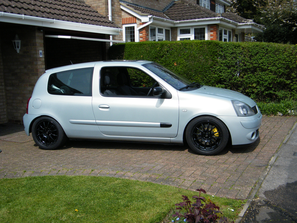

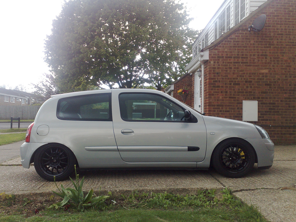

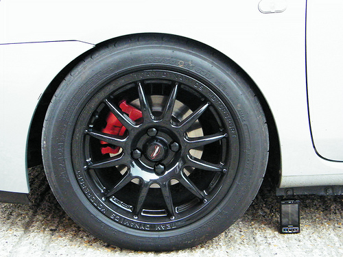

UPDATE !!!

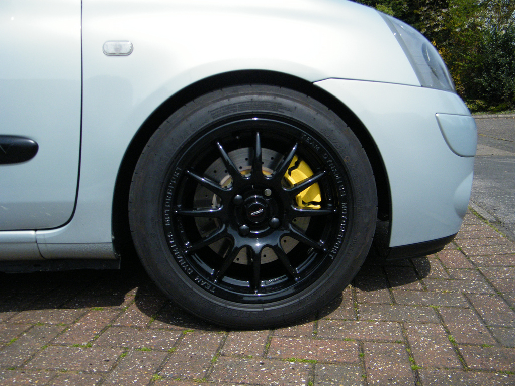

Last week i fitted my k-tec big brake kit and bled all the brakes which got quite alot of air out of the system ;)

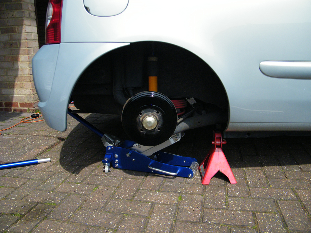

The weather has been great over the past week soo i went to halfords got some caliper paint and high temp paint ready for this weekend. Ive painted the front caliper yellow they look lovely and work really well with the black wheels and silver. I couldnt paint the front and leave the poor old drums alone they needed abit of tlc soo i painted them black ;) I also cleaned the front coilovers up and while i was doing that i feel the need to go lower so i got the c spanner out and went 5mm lower at the front :rasp: some pictures of the results hope you like.
Adz
  Work van

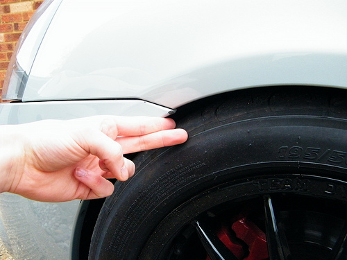

Looks nice but go looooooooower.
Im going to go back to my custom rear springs after ive had my arches rolled, i cant get my finger in the arch as it is very low. The picture with the front wheel yellow caliper i had the car jacked up that why it looks quite high. I get a little bit of rub on the font tyres 195/50s yoko prada spec 2 which are quite a chunky tyre. I will be changing them soon so i can go that little bit lower :approve:
  Mk1 16v 172 hybrid
I got rub on my front I can only just fit my finger under the front arch and I am running 205 45 16 just had to cut part of the arch away. Keep the pics comming and the good work.

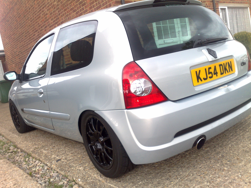

update
well ive had my custom springs laying around for quite somtime now so i thought ill would pop them in and see how the car was.......well it slamed it so i striped the rear out which brought it up 5mm which help, only problem i had was my tyres on the rear are about 1mm away bumper bracket this was after i had grinded it down :dapprove:
Also the springs didnt have much travel in them soo i had the nice sound of spring on spring plus if i put them in again im going to cable tie them down as i dont want them poping out :dapprove: Im trying to find some ways of sorting these problems out with rubber spring protectors for the noise of spring contact and maybe swap my 195/50/15 tyres for 175/50/15 which will add a little strech and stop my tyres getting chewed up :D
