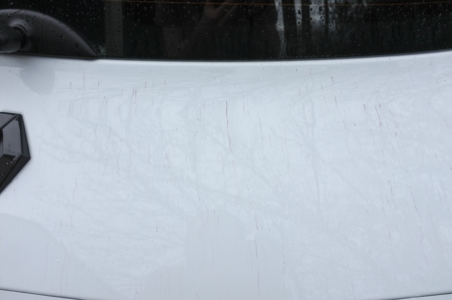

I wanted to give it a proper decon treatment, as there's loads of tiny back spots everywhere, and the paintwork is relatively rough too (nothing major at all!)

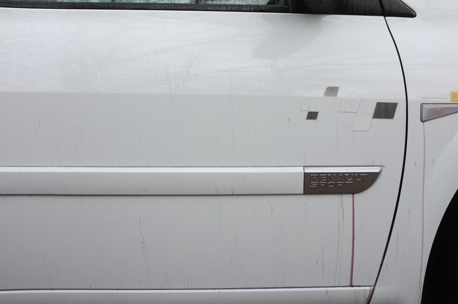

After a wash, it was out with the Iron-X everywhere.

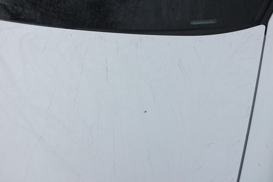

The bonnet actually looked pretty good initially, until I saw all the purple!
That's it for now, as I spent all day cleaning out the garage. Starting again tomorrow morning with some claying to hopefully remove the last of the spots, then SRP (until I order some AF Tripple), then Zaino Z5.

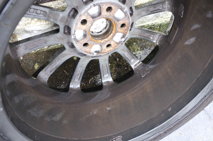

Next up was a full clean for the wheels.
Starting out with general Bilberry clean:

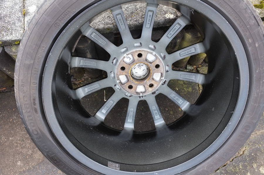

Not in too bad a state initially:

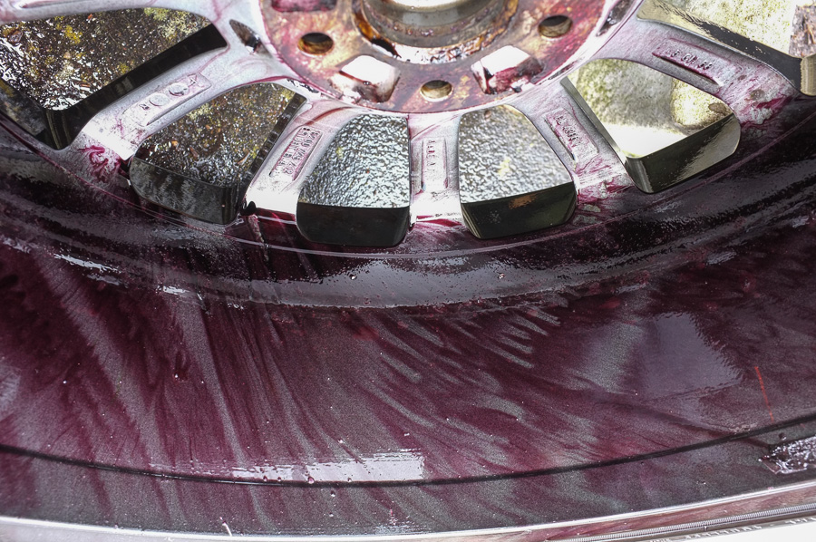

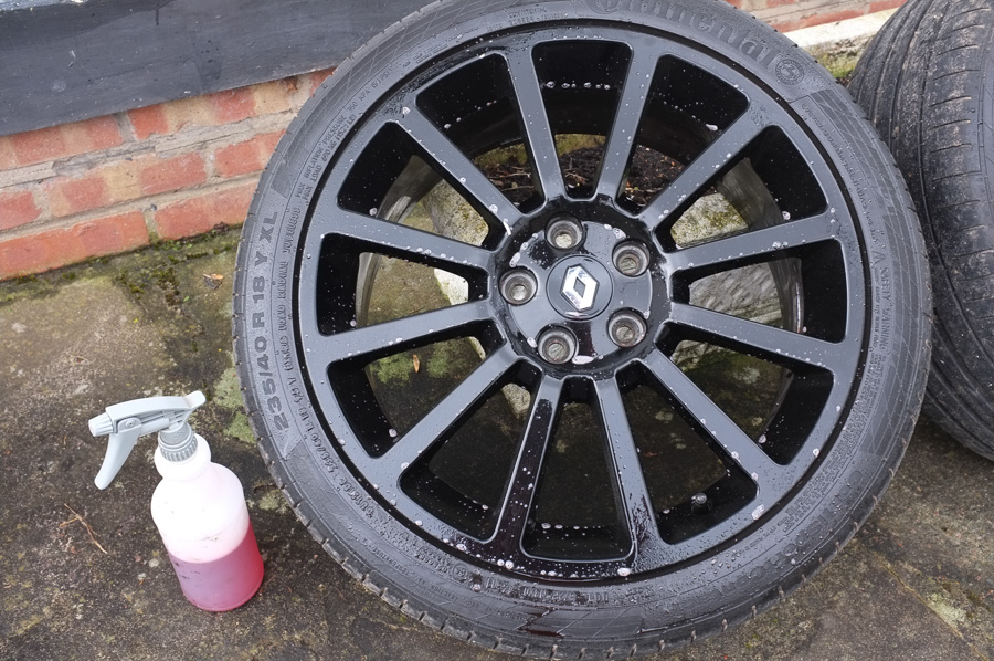

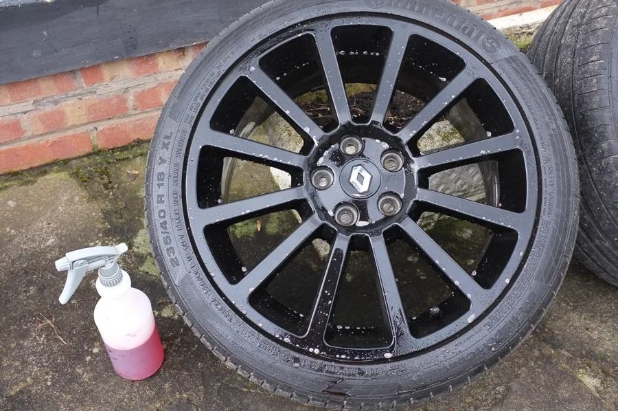

Then holy Iron-X!!
Nice and clean ready for drying...

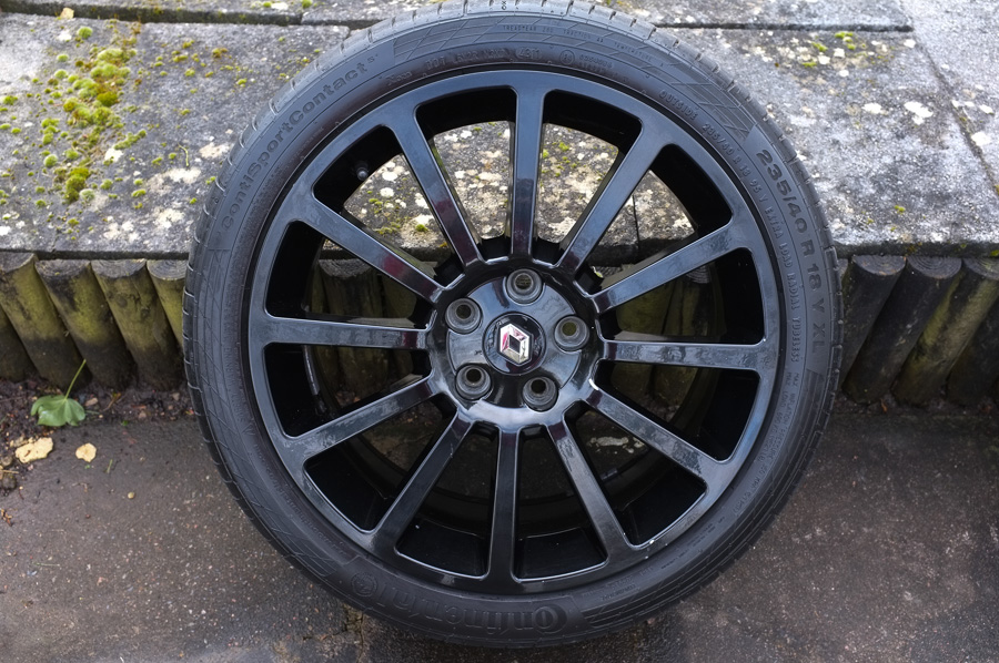

Then a coat of Gtechniq C5 wheel armour.

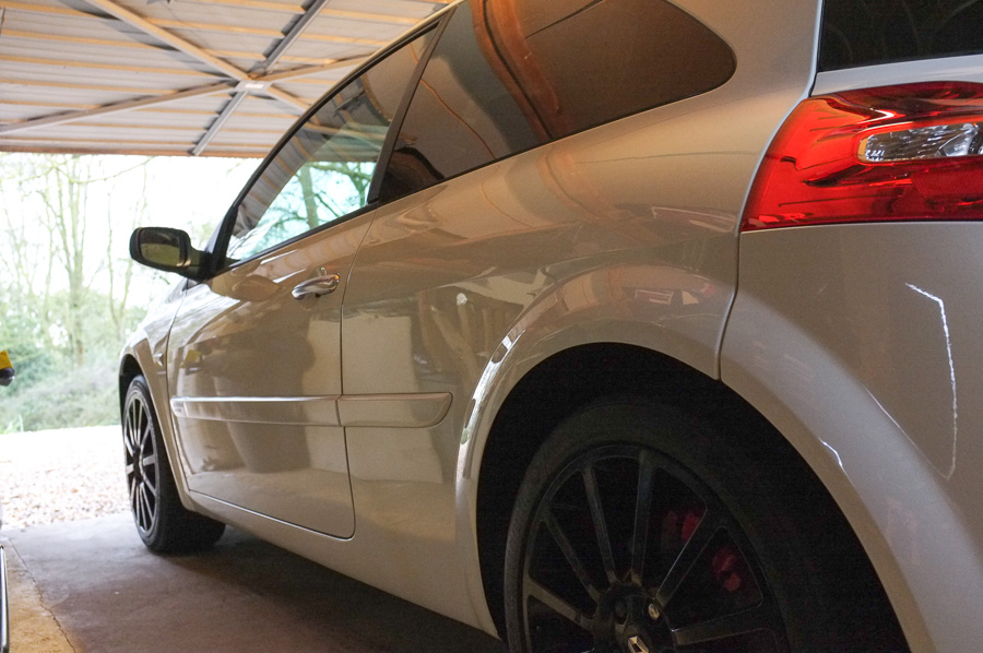

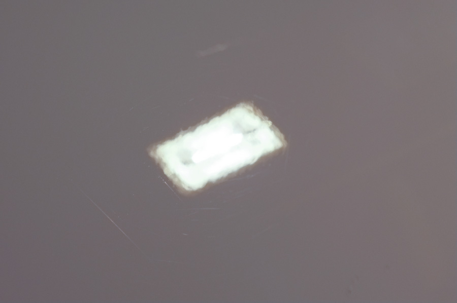

Then it was on to machine polishing. The car was in a pretty good state already, with just a load of really minor marks, with the occasional deeper marks.
Here's the only after shot I did, you can still see one deeper mark and a couple of other little ones which I struggled to get out, without the rear of going too deep. I'm not really after 100% correction, as I'm not talented enough for that, jus to get the major stuff off.

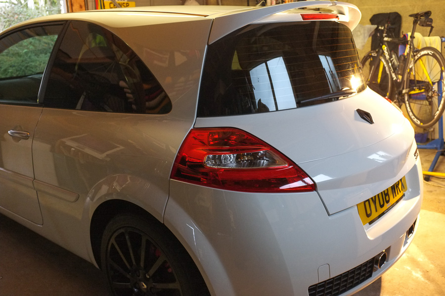

Well it took a lot longer than I was anticipating, but as I havent needed to use the car, I've just kept doing more things in the evenings after work....finishing it off today.
In total:
Washed
Clayed
Machine polished - Menzerna Intensive polish and power gloss on Menzerna polishing pad
AF Tough Prep
Zaino Z2 - three coats
Trim done with GTechniq C4 trim restorer

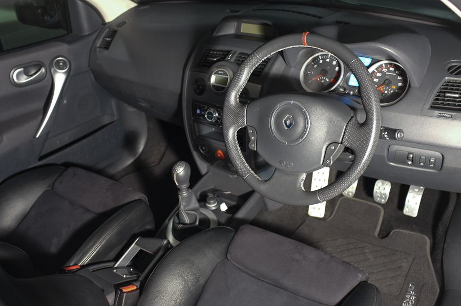

Interior done with Poorboys Natural Look dressing
Interior glass cleaned with AF Crystal
GTechniq G1 on the windscreen
I think that's about everything!!

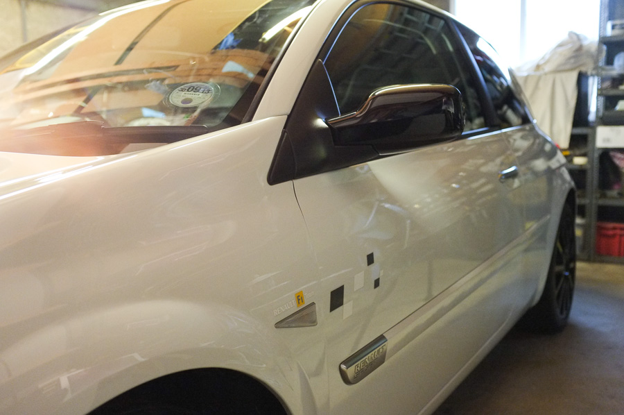

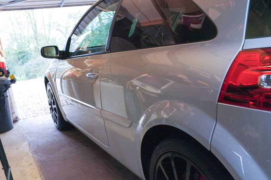

I havent got it out of the garage yet as the weather is crap and I can't bear to get in dirty after all that work! ;) So just some shots as is....
The best reflection shot I could get, white really isn't the best for this I'm learning!
I wish the weather was able to do it justice though :( Oh well....I'll do a top up detail soon enough I guess.
