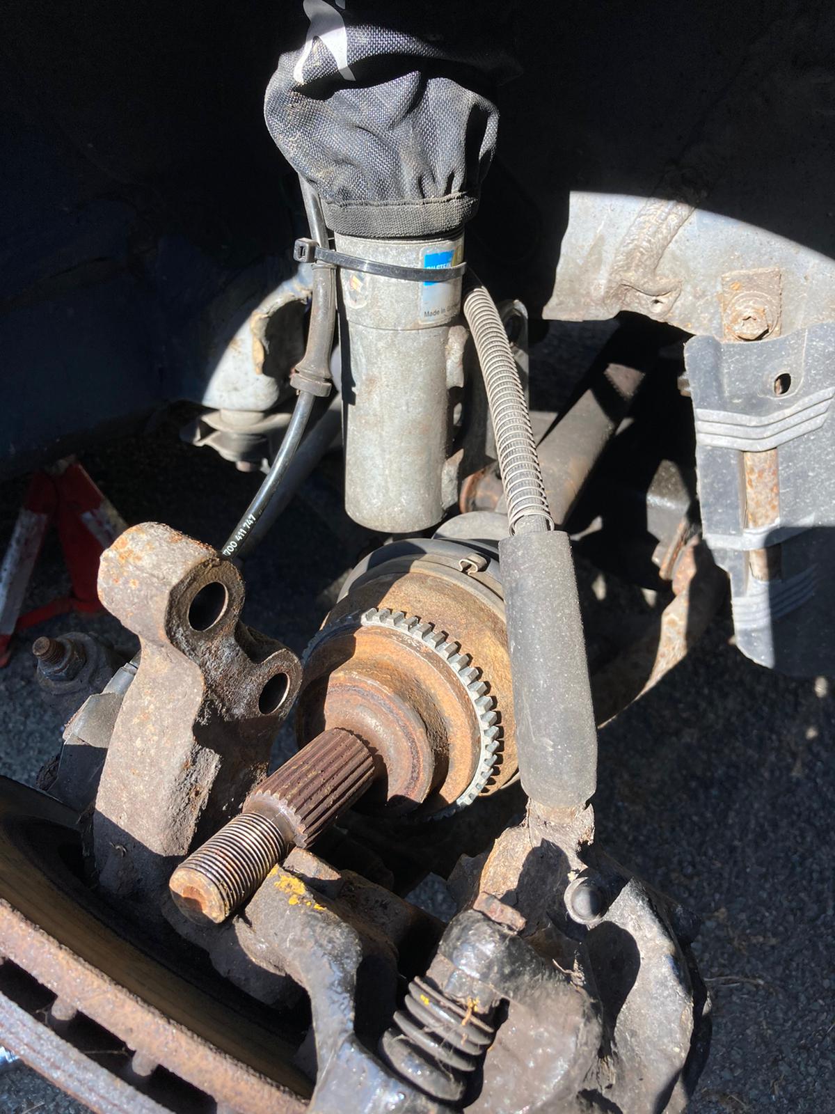

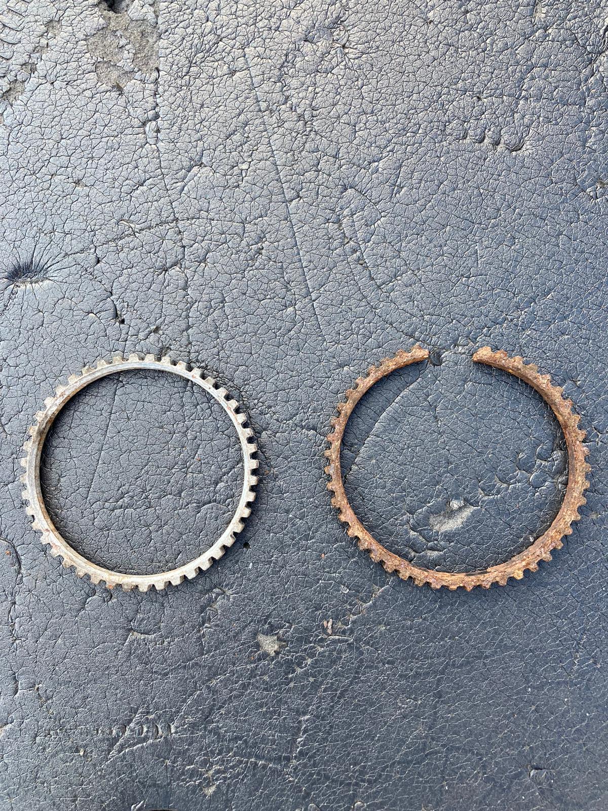

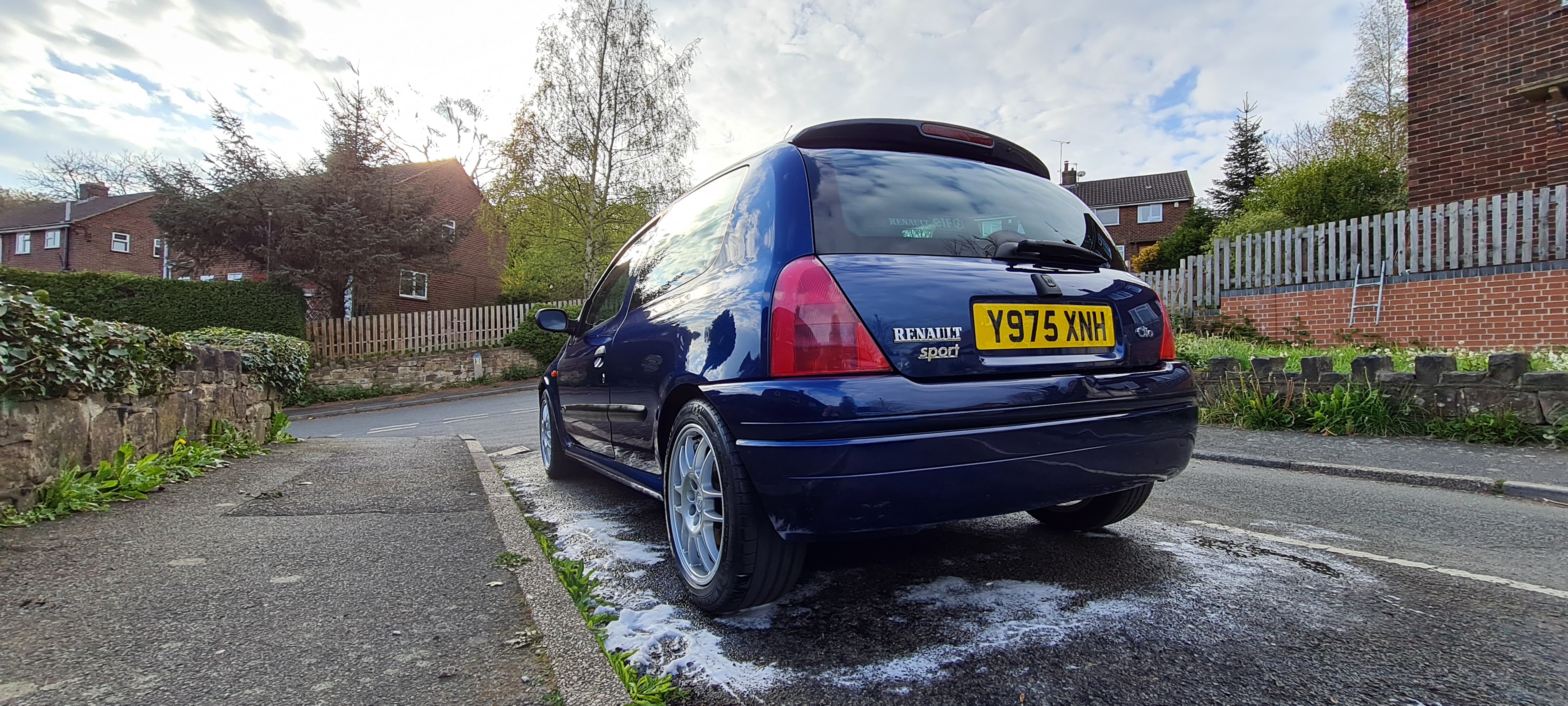

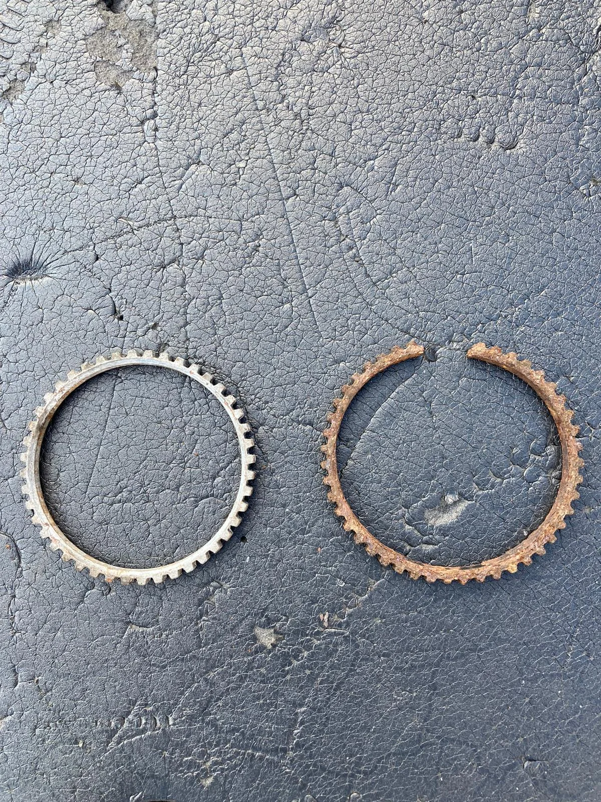

ABS rings replaced today, and rehung exhaust correctly. So tax will go live Monday and she's good to go for the spring. Mint
Oh replaced the zip ties for new stainless abs wiring brackets too but forgot to take any pics

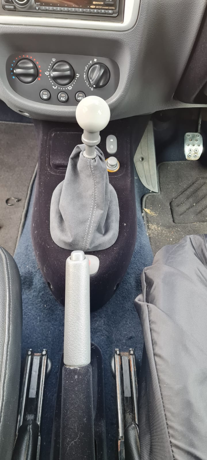

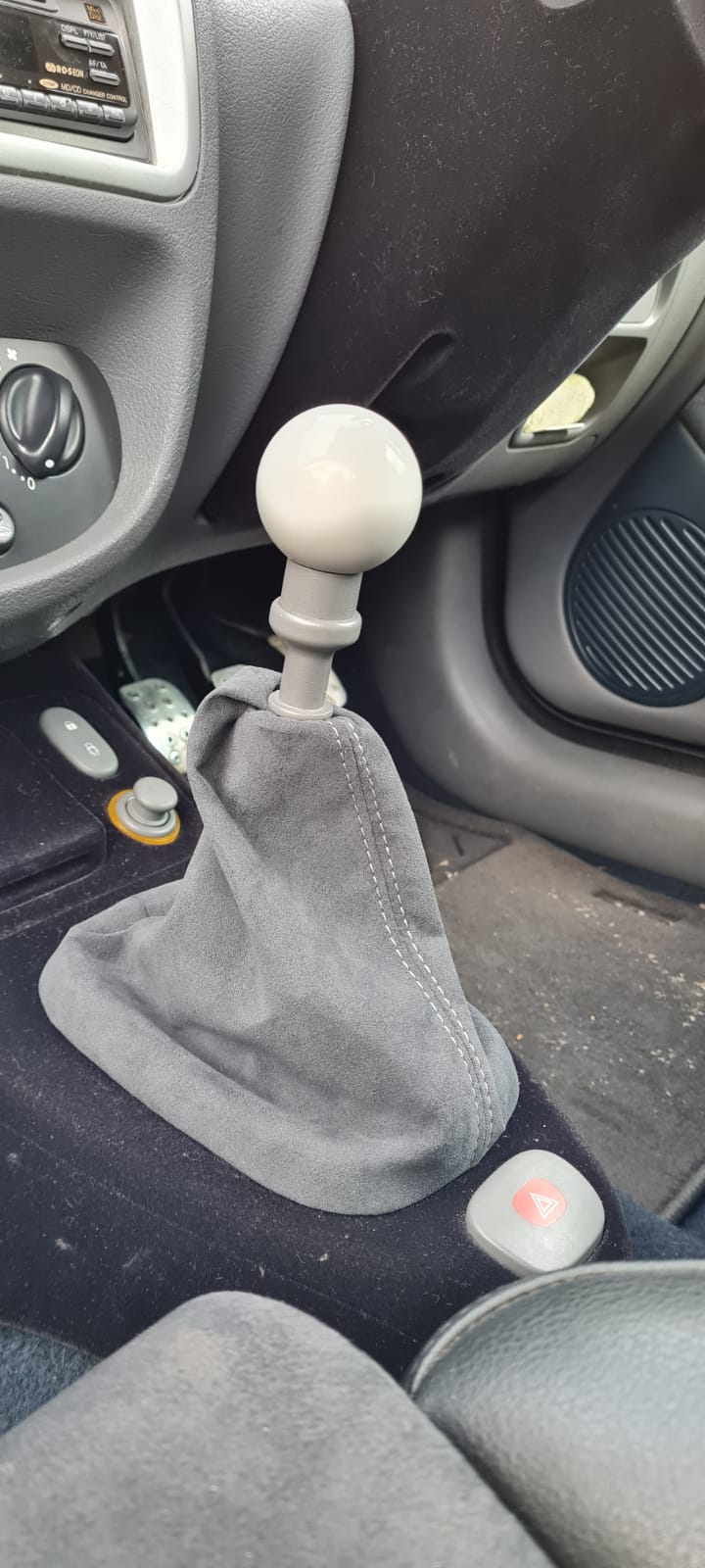

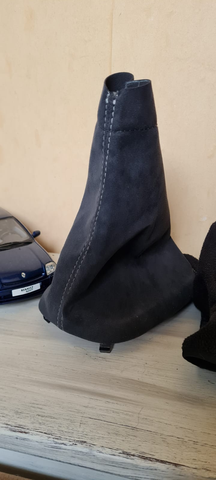

Andy (Snappy) sorted me a new gear gaiter, oem+ approach again so went alacantra with white stitching and moved the stitch from the front which the stock one had to the rear so you can see it. Next job is the handbrake cover to match.
Old original
New
Fitted

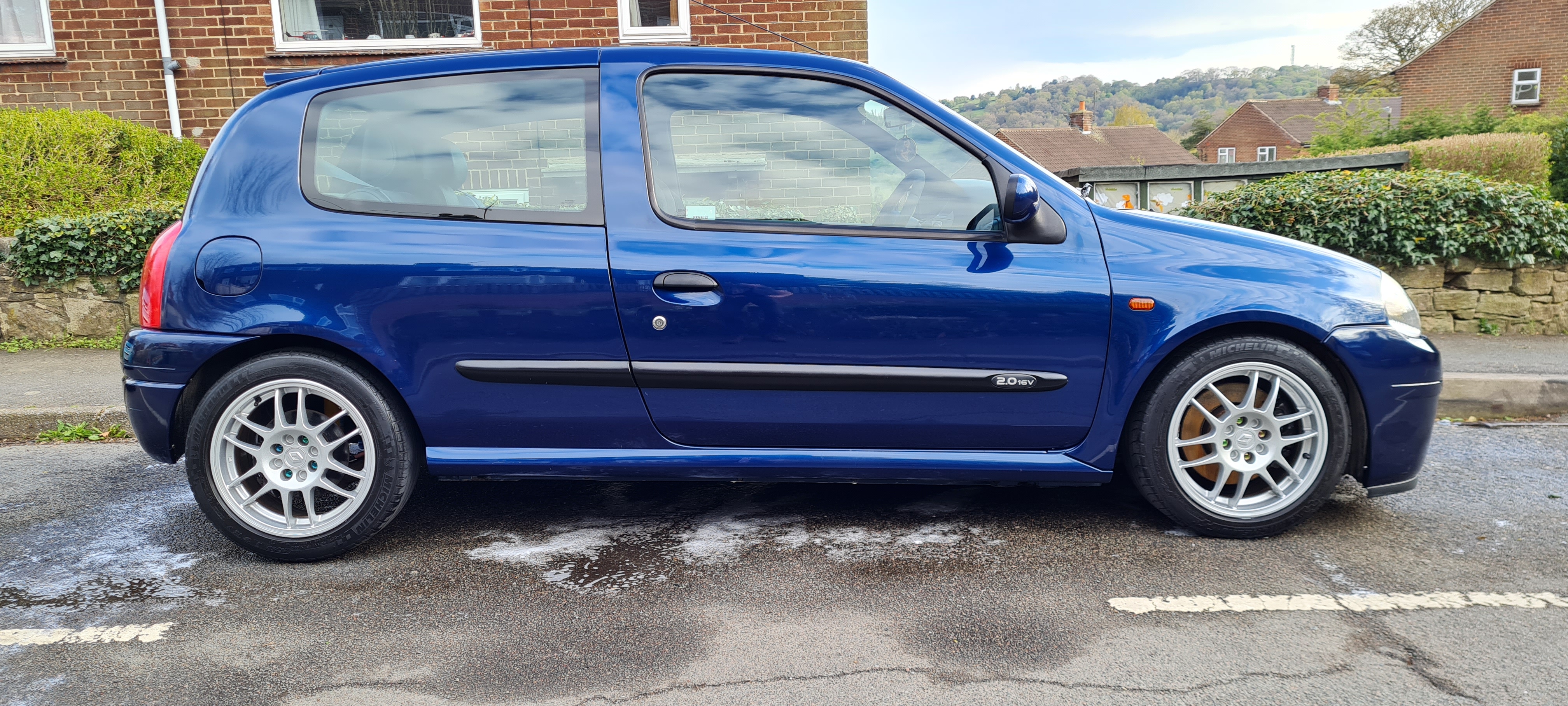

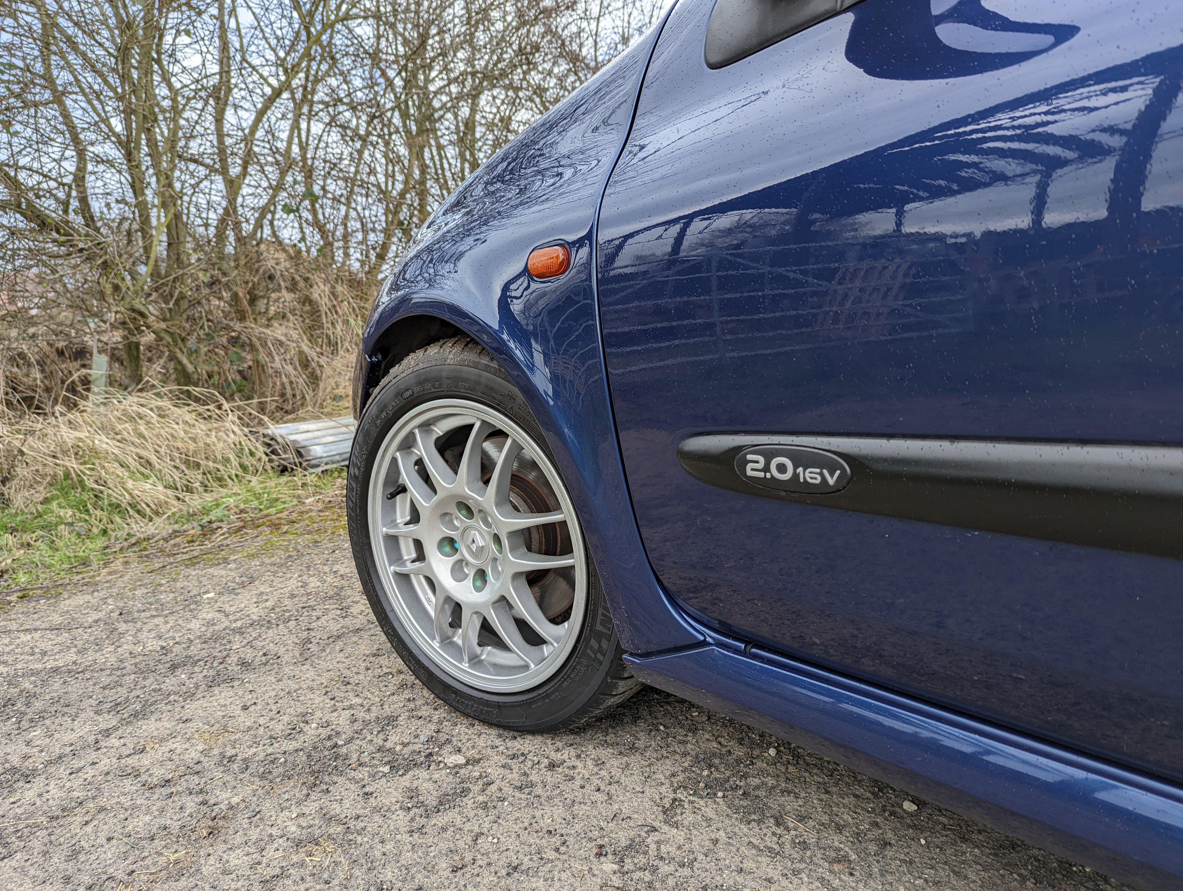

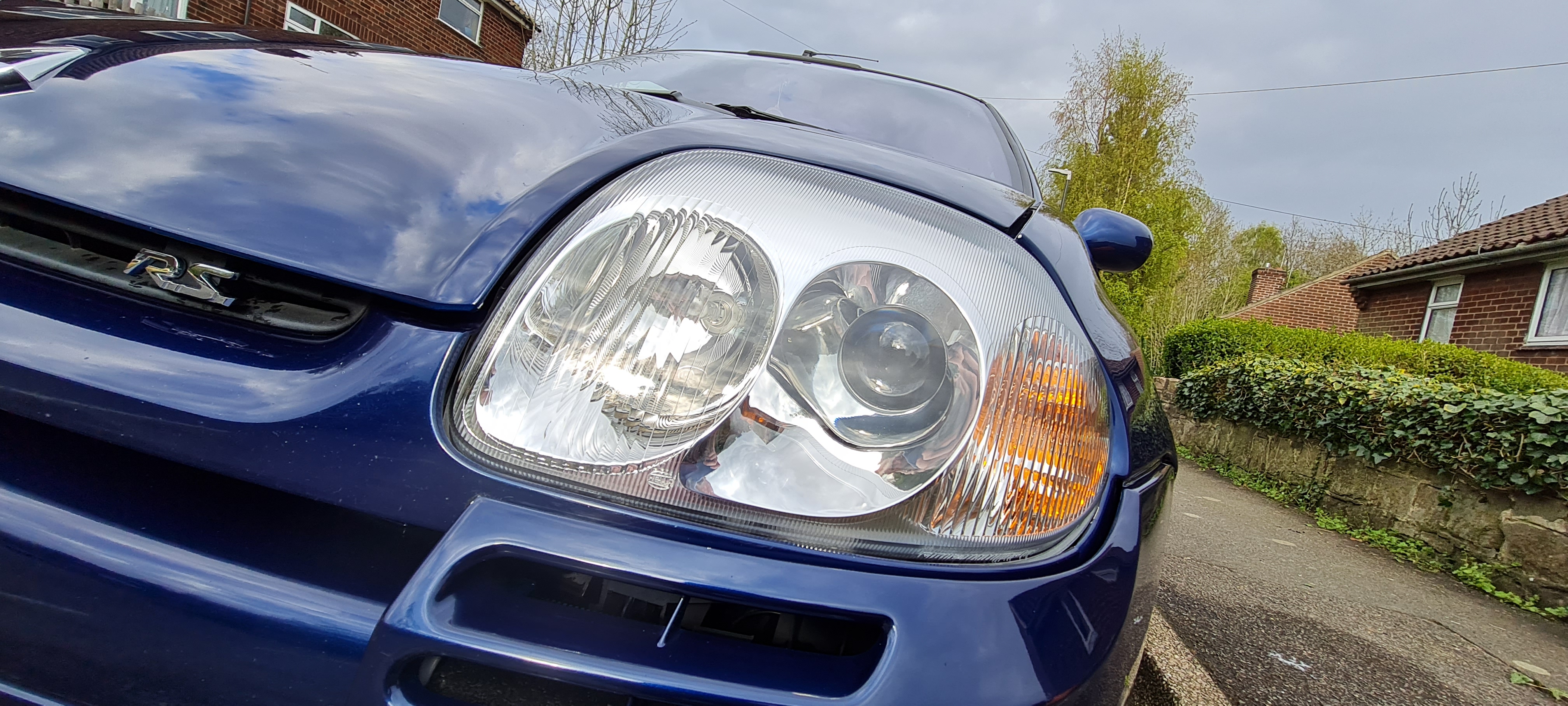

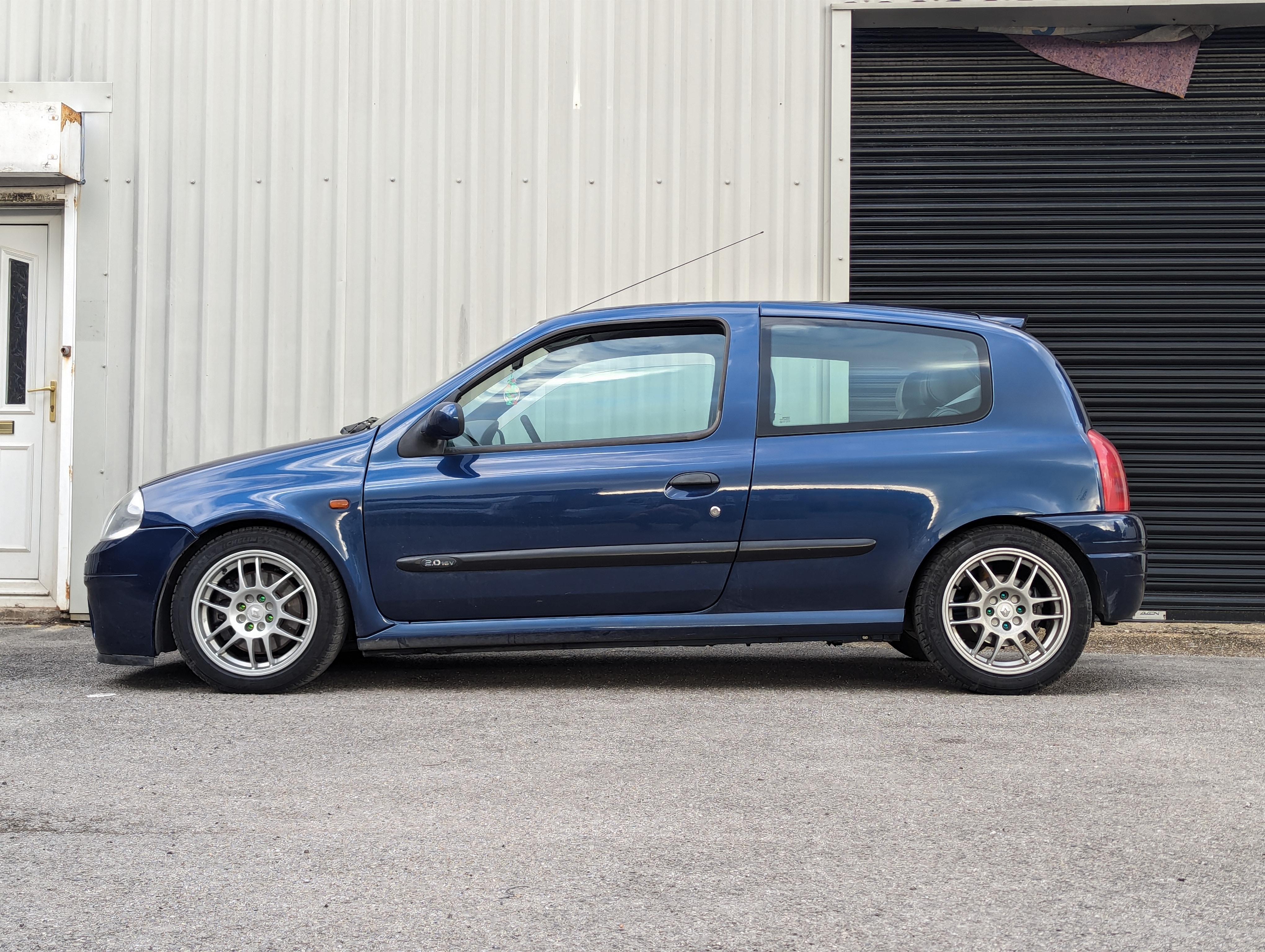

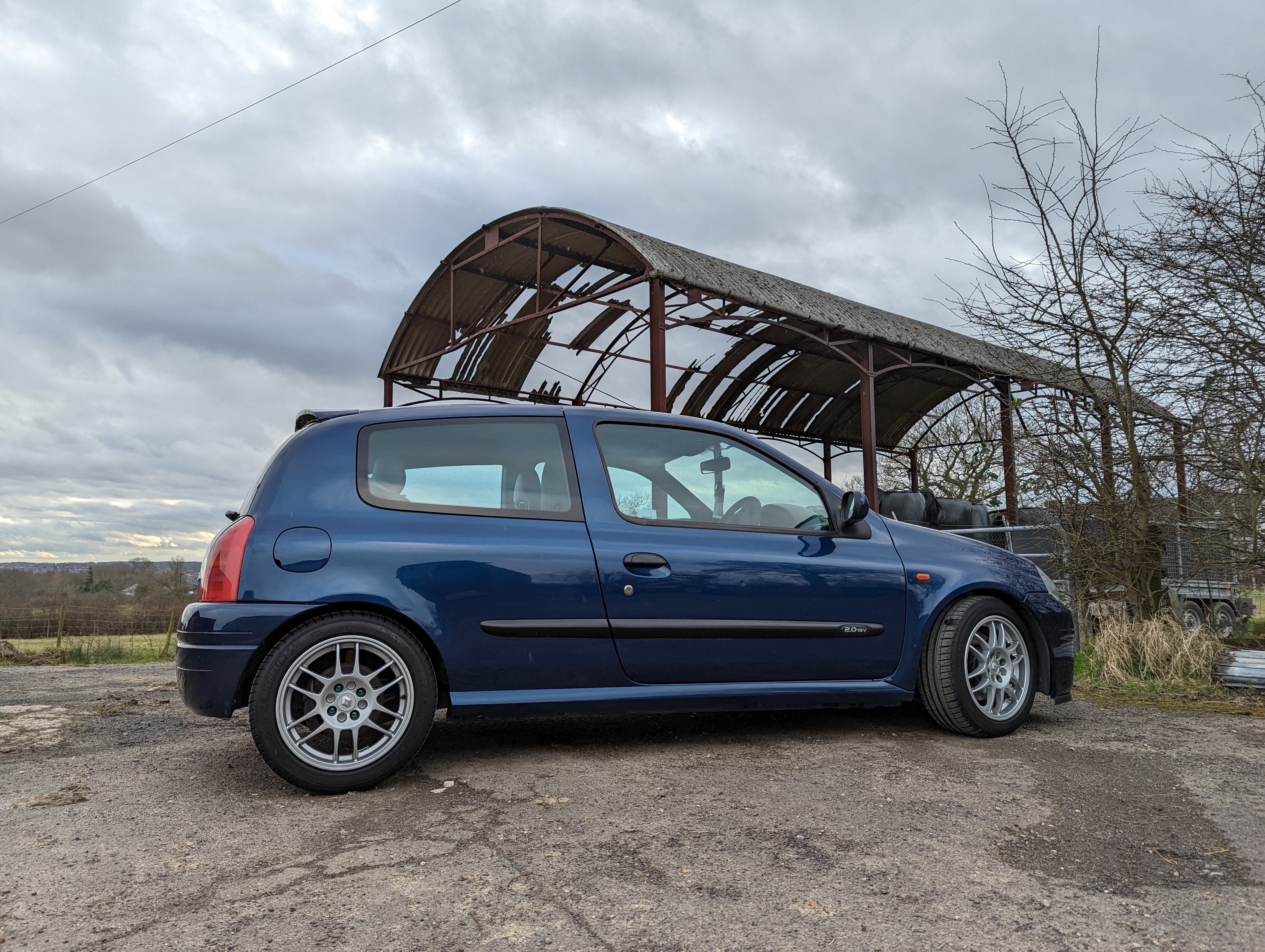

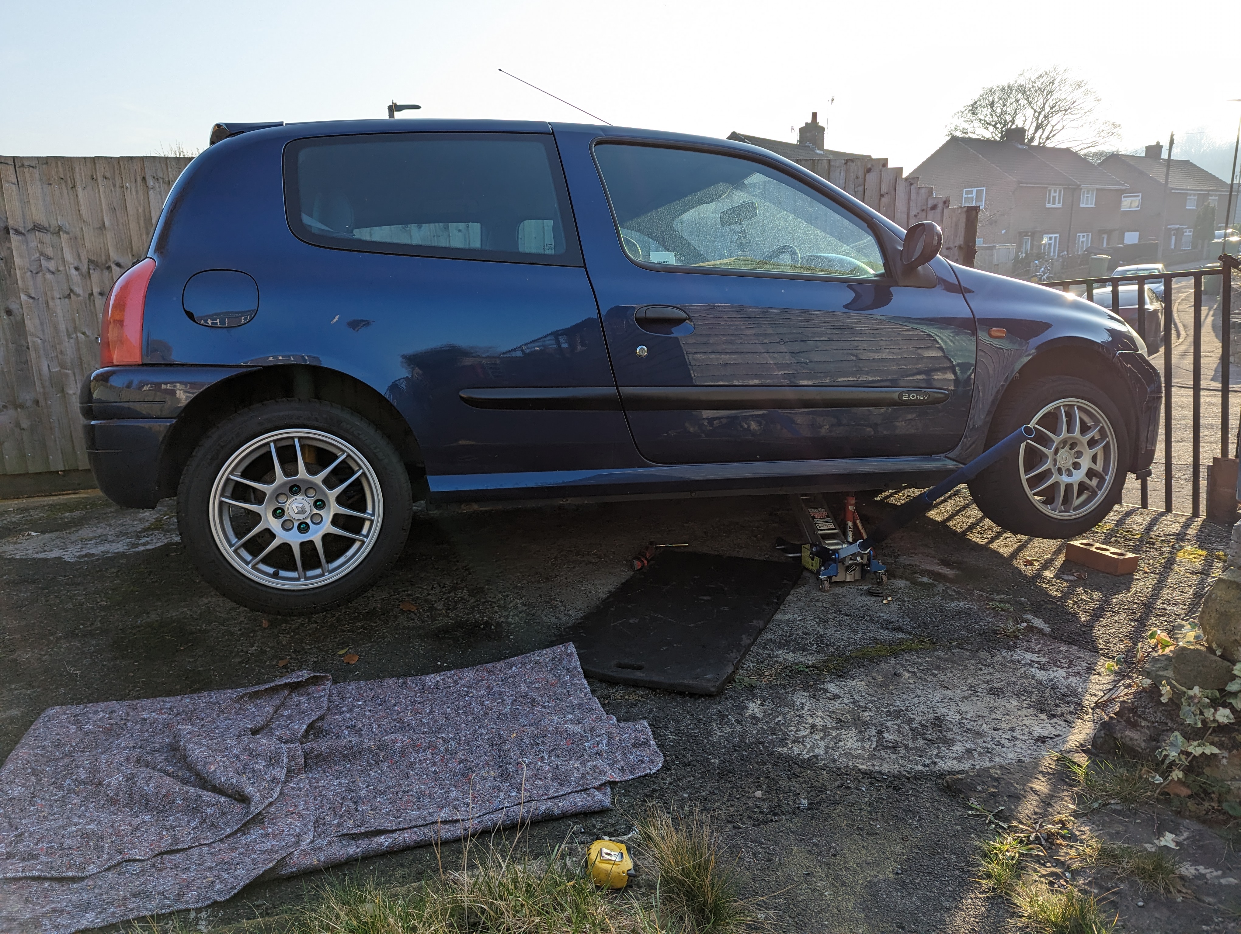

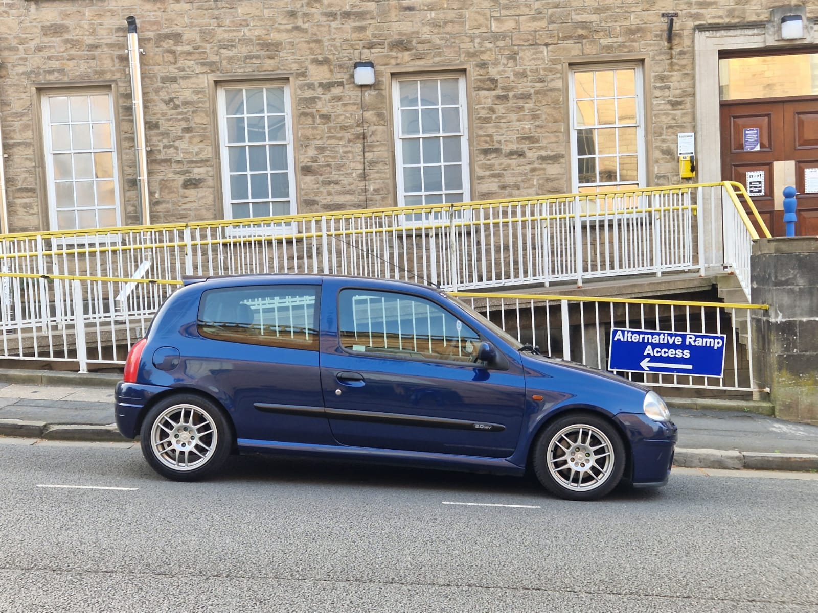

As the car is currently in daily use I elected to insert the adjusters into the rear spring platforms and raise the ride height around 15-20mm all round. Just to make the car slightly more comfortable and chuckable for the day to day usage.

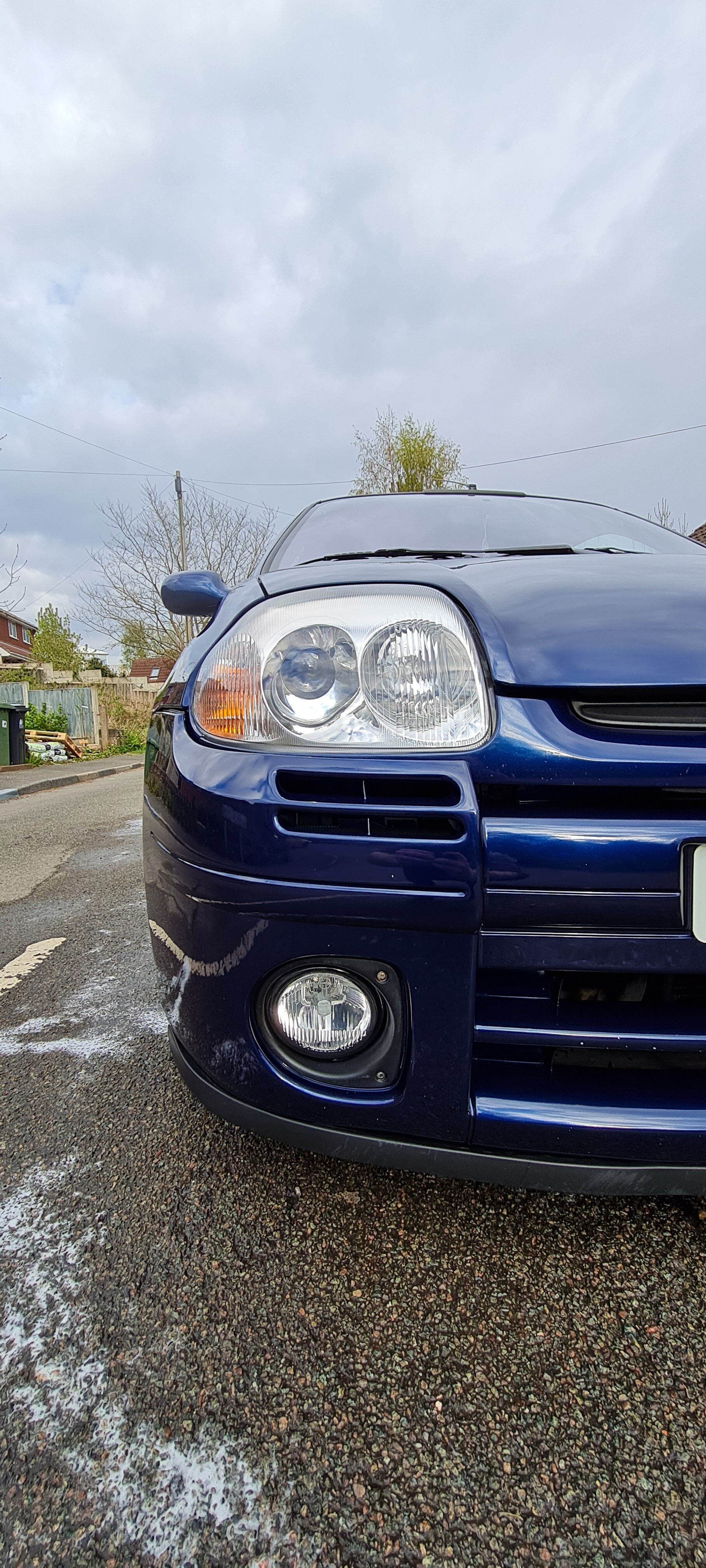

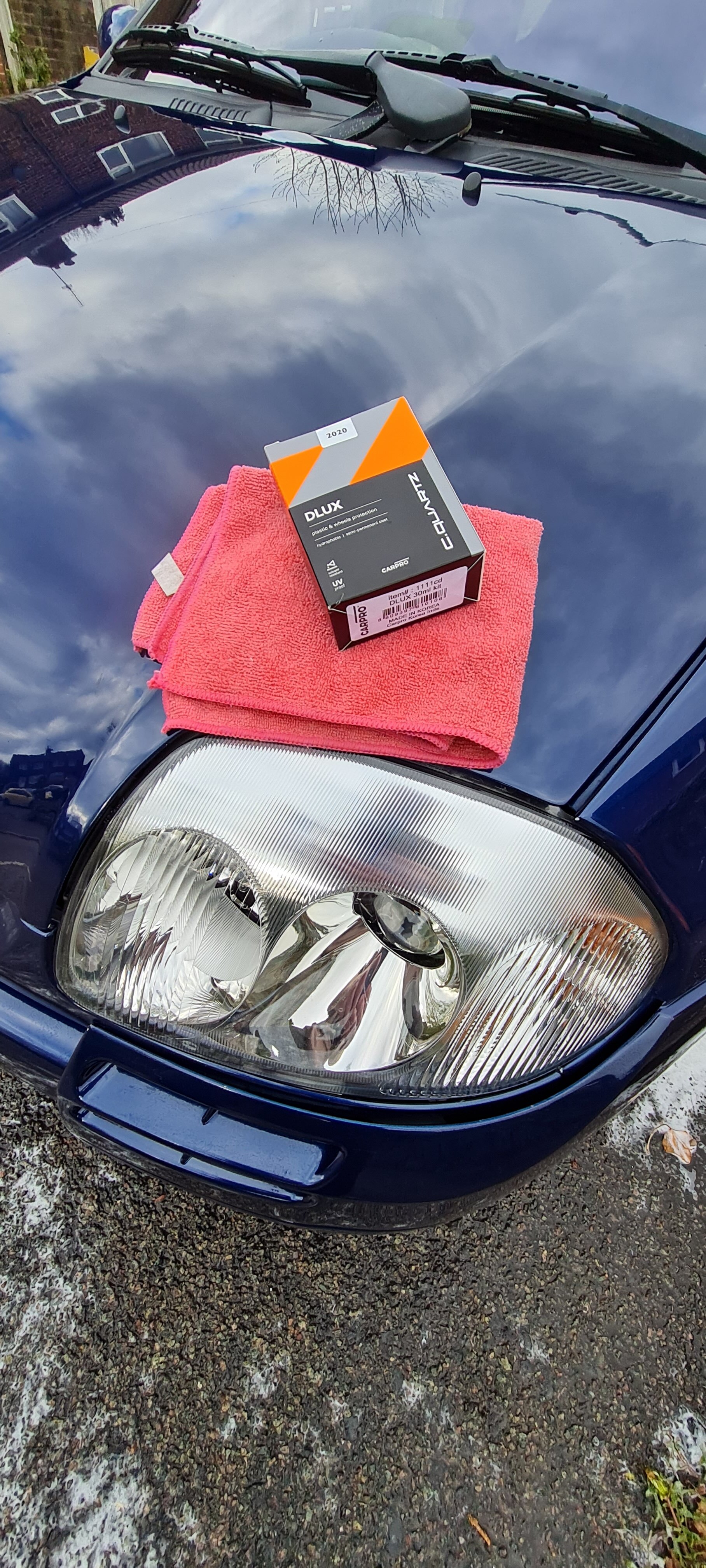

Also gave her a wipe with a rag and sealed the headlights up with the poshest car care stuff I've ever bought. Recommended by @Dr Jekyll and it's such easy stuff to work with. Will add couple more layers soon.
Anyway, pics

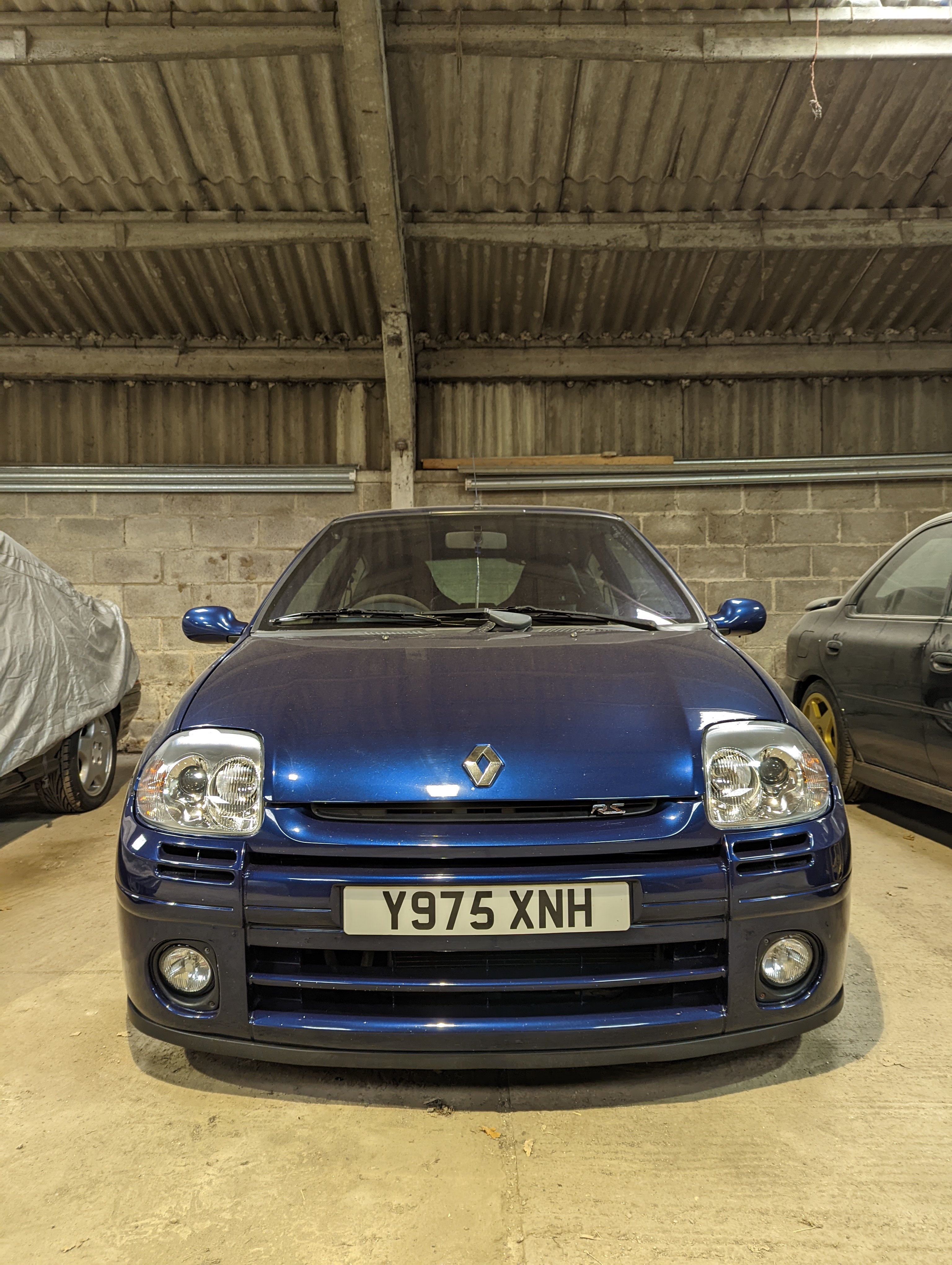

Not updated this one in ages either, car passed MOT earlier this year with advisory for ARB bushes but I've collected whole genuine OEM suspension refresh setup so that'll go on along with powdercoated subframe etc later in the year.
For now it's SORN and stored in a unit for the year whilst I enjoy the track car for the summer, back out in 2023 I reckon.

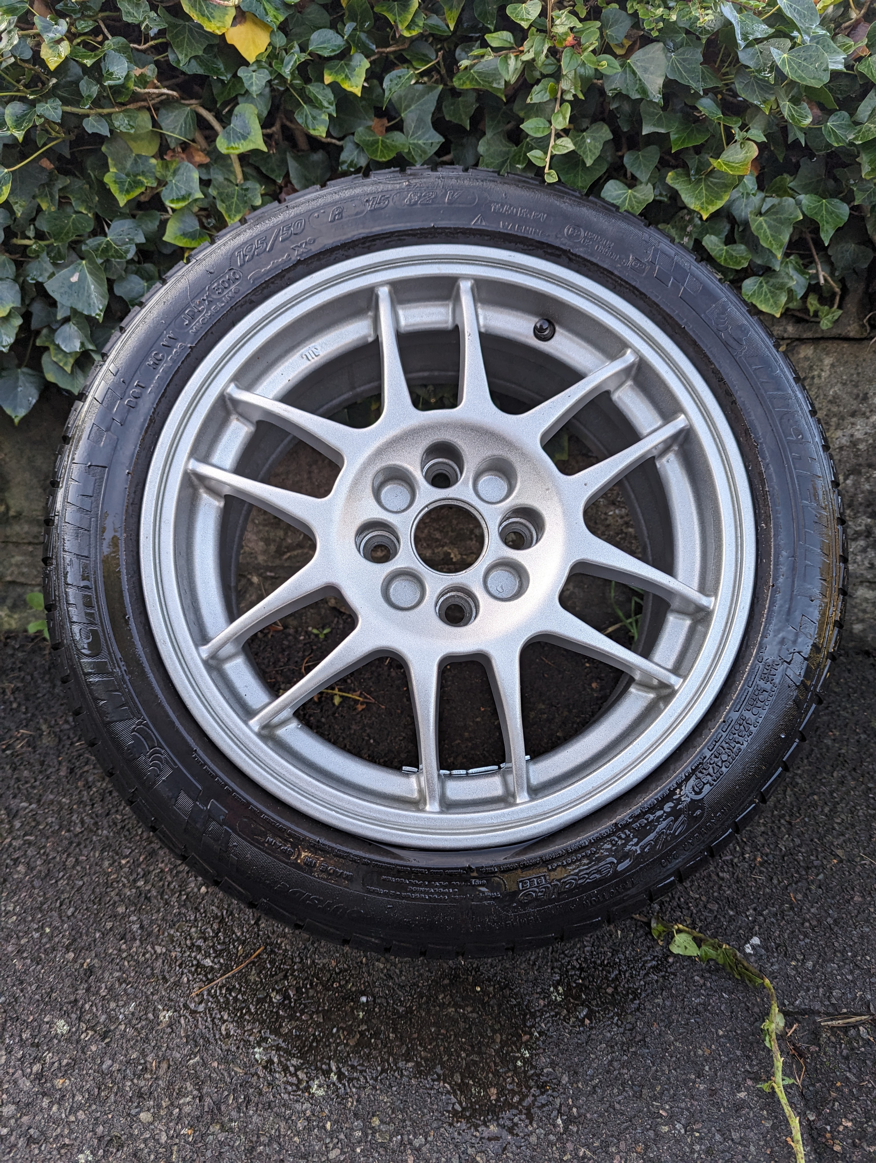

OG wheels back on too with new old PS3's

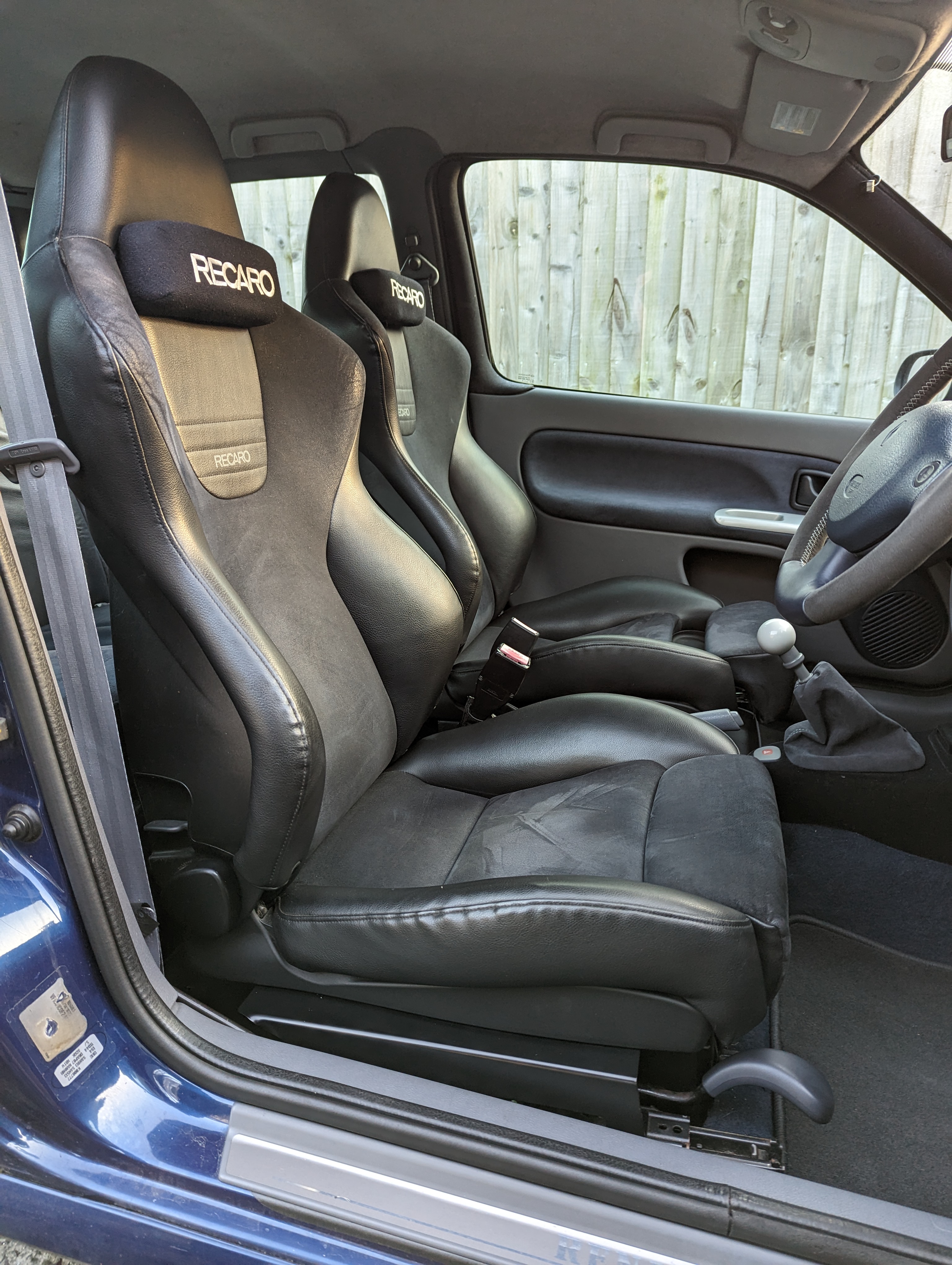

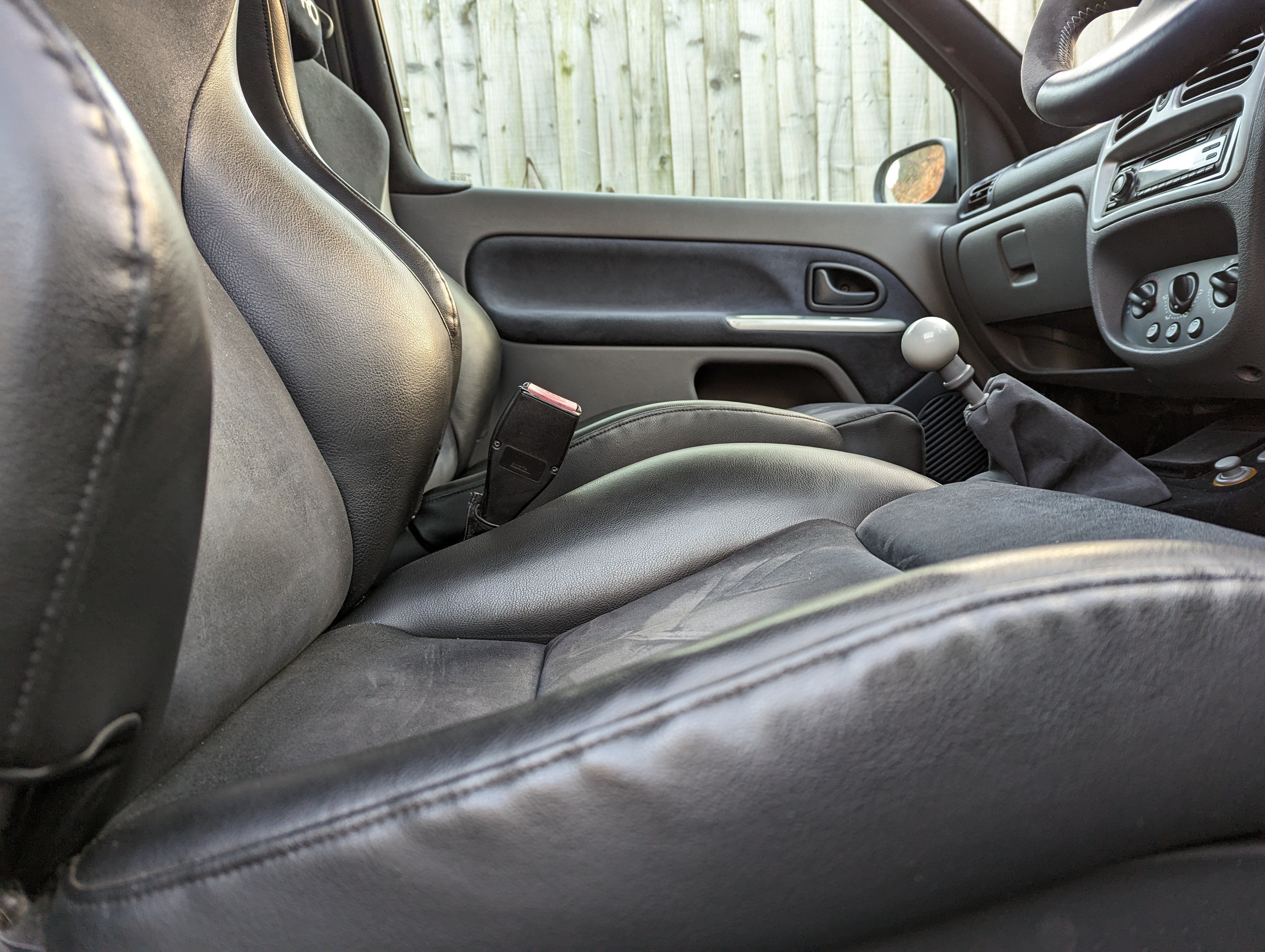

Cars back at home now, been a while since I updated but latest mod installed today, well one of the two anyway

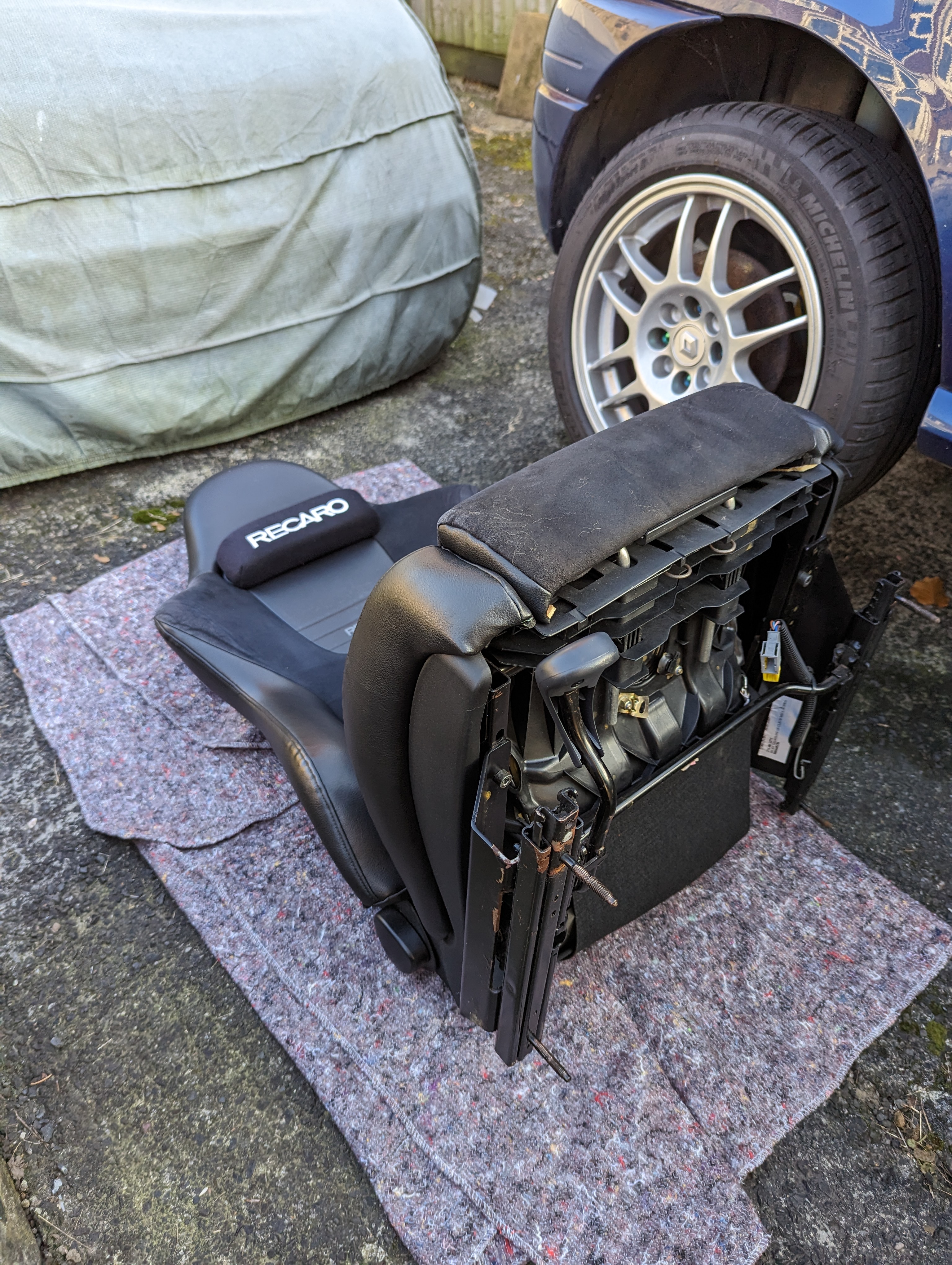

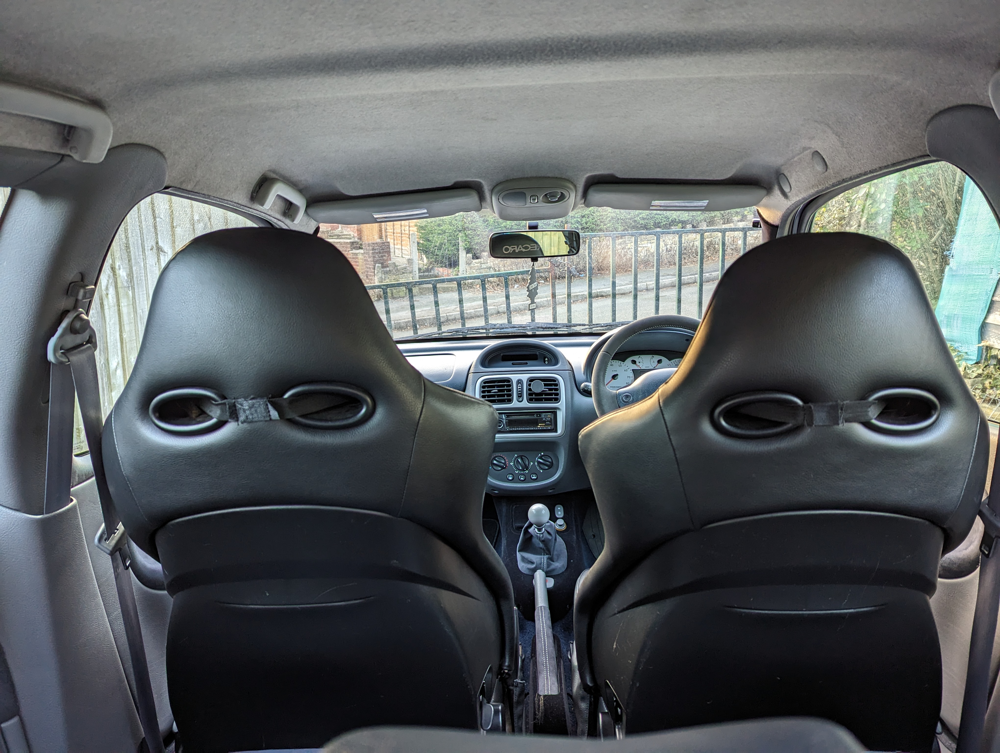

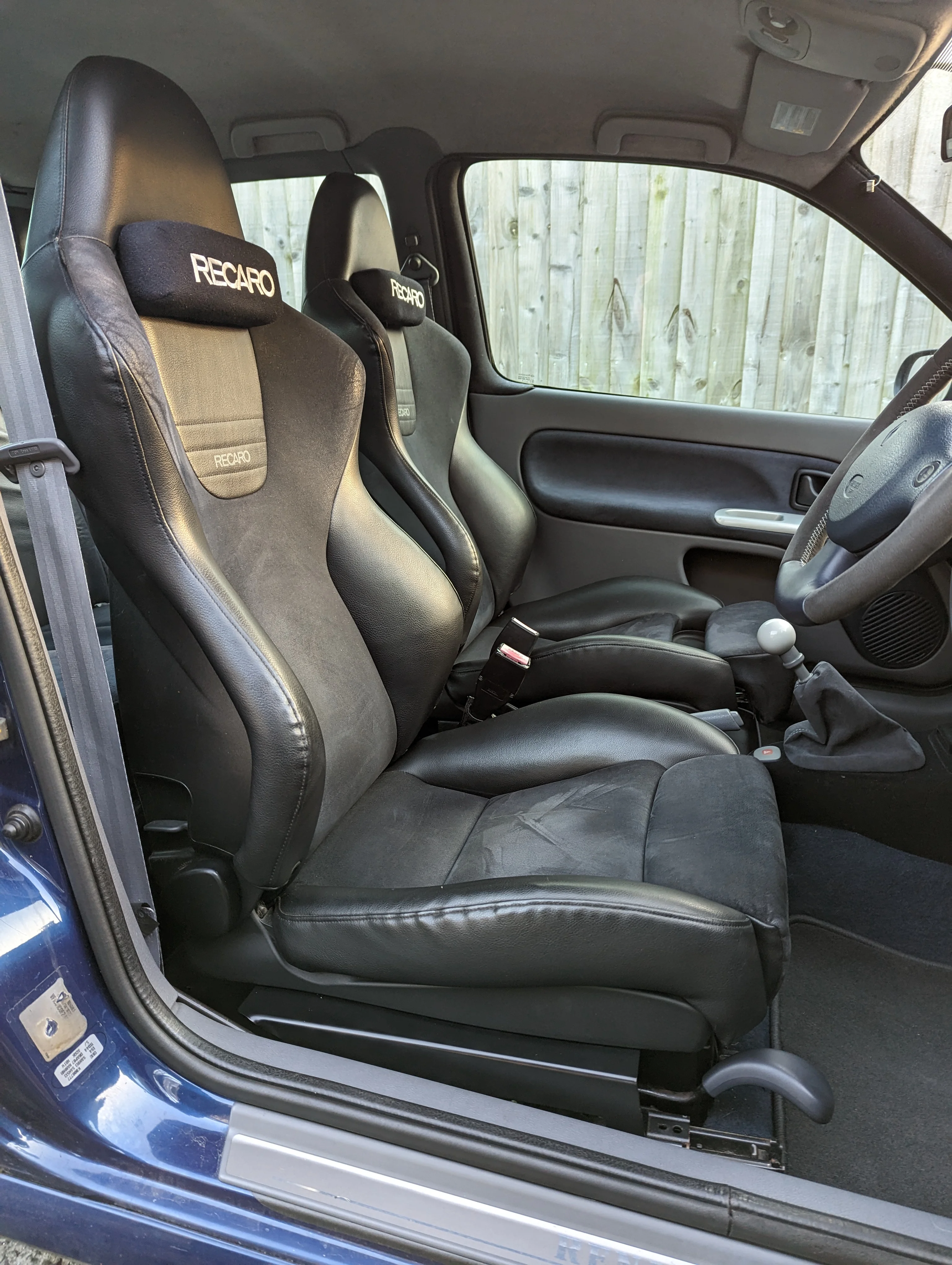

Jon Fossard extra low frames for the Recaros.
Measured before and after and the drivers side now sits 38mm lower than before, perfect!

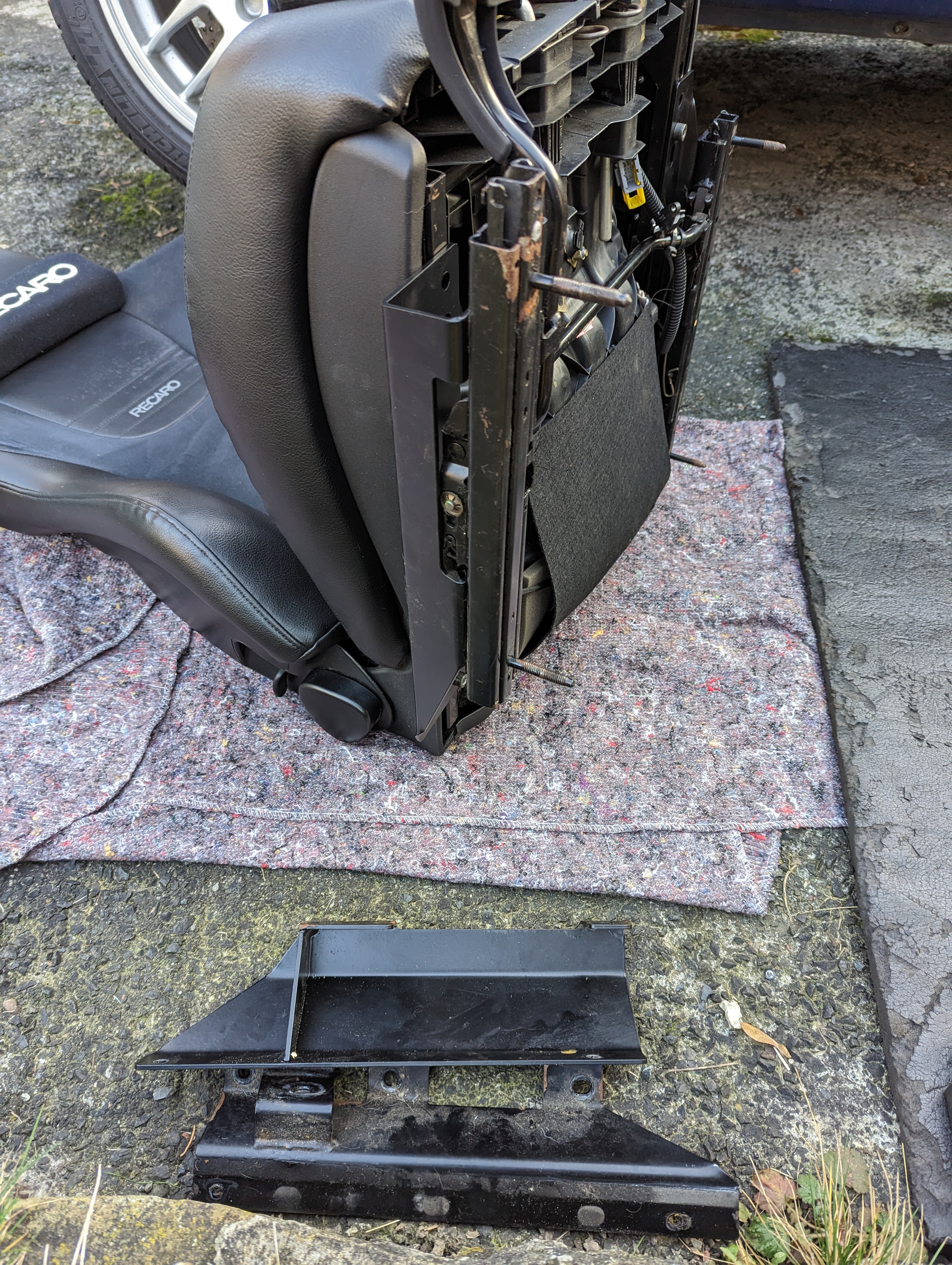

Got the passenger frame into the car after a bit of a faff......as in broken stud on the inner rail where it bolts under the car in the exhaust tunnel. s**t design that, and I'd copper greased it and still snapped. Thankfully just scavenged the runner off the original seats and sorted.
Taxed it and went for a spin, running and driving spot on so it'll be on daily duties this week leading up to Cadwell on Thursday.

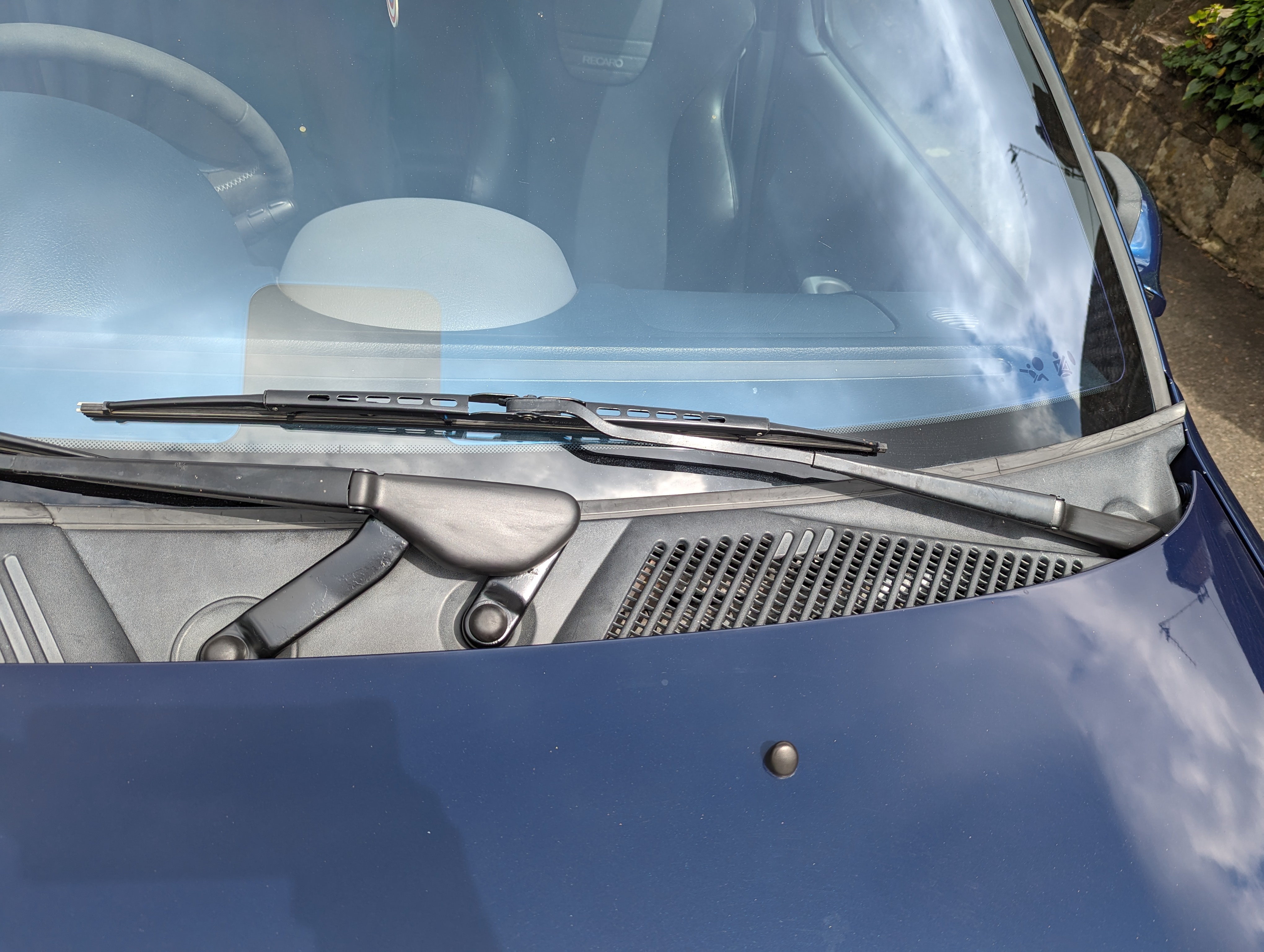

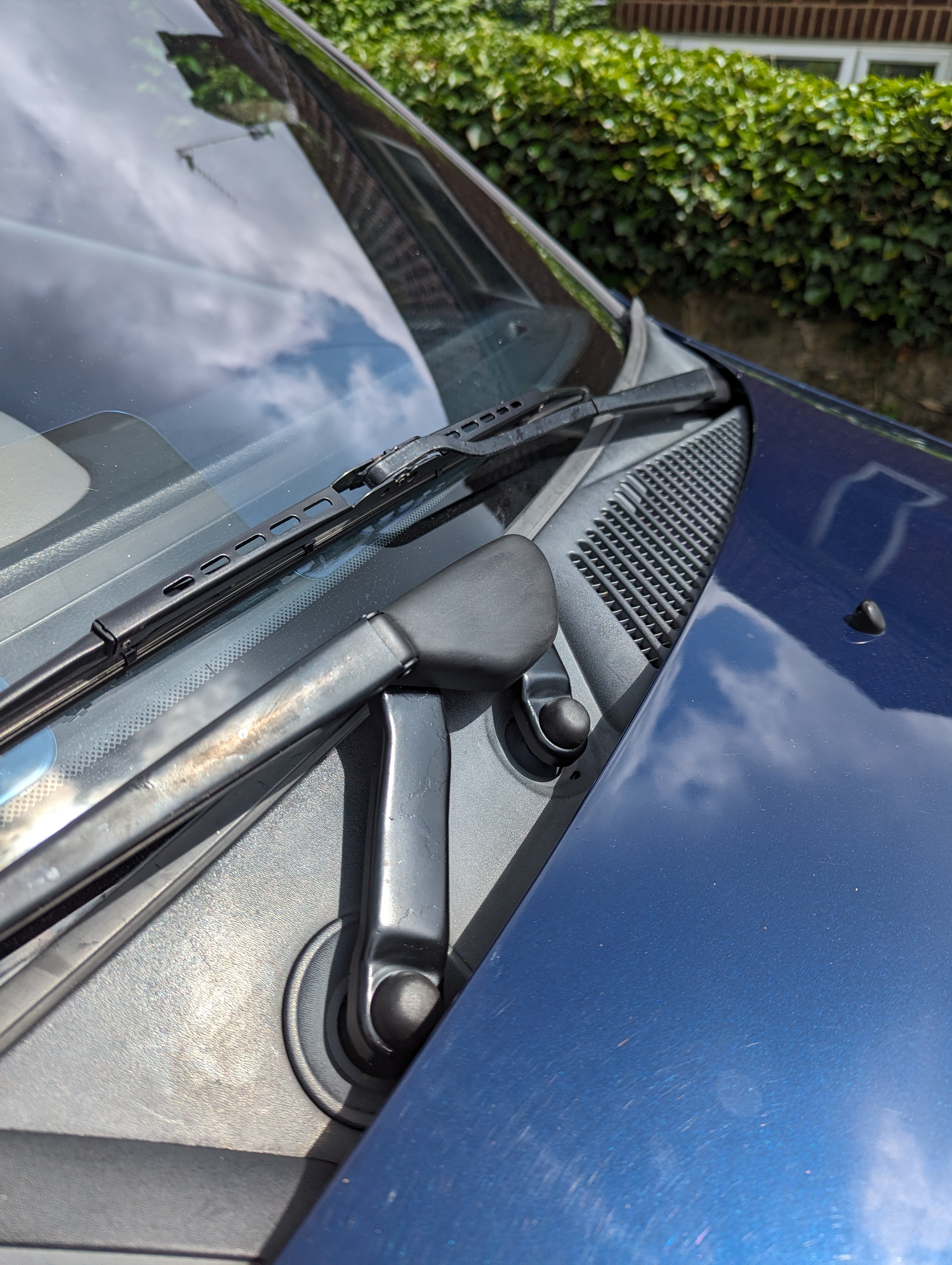

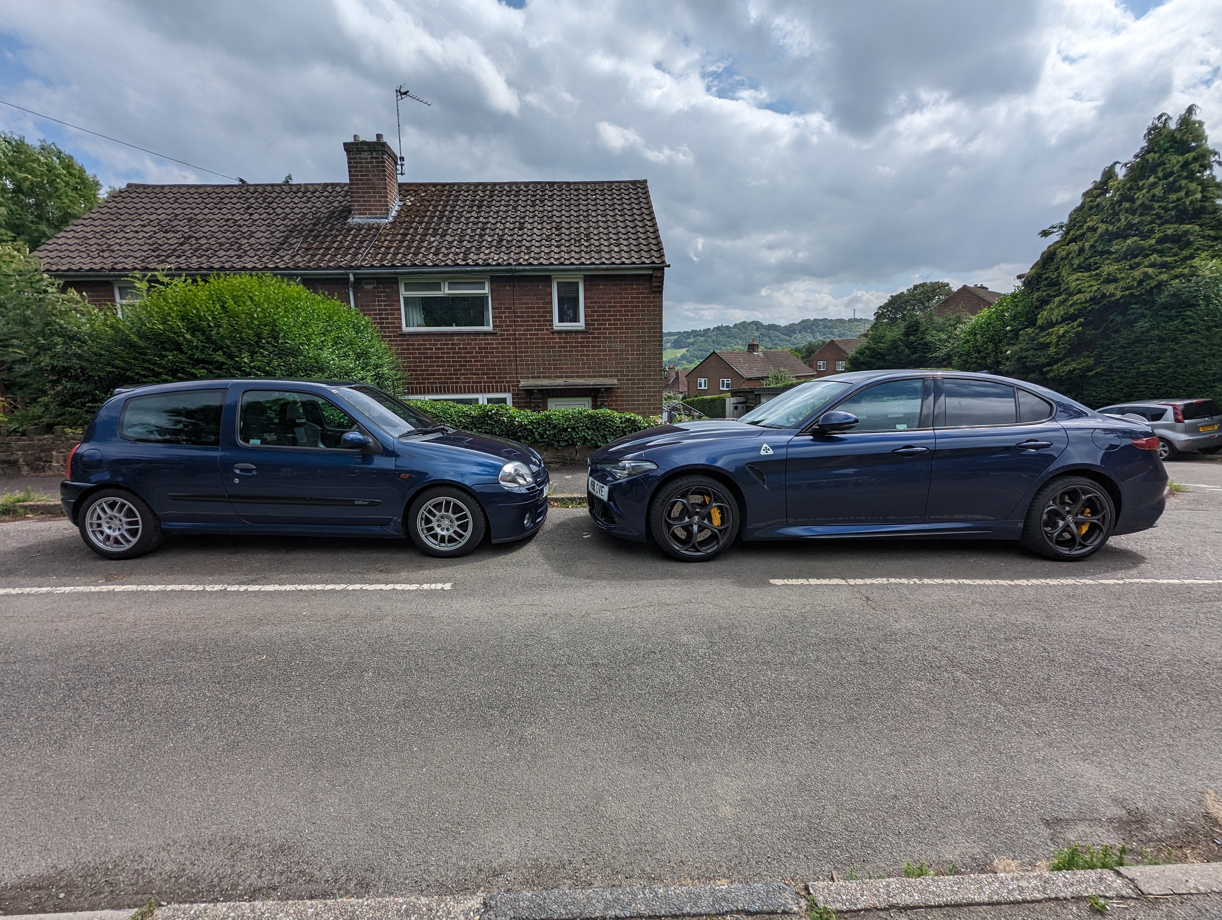

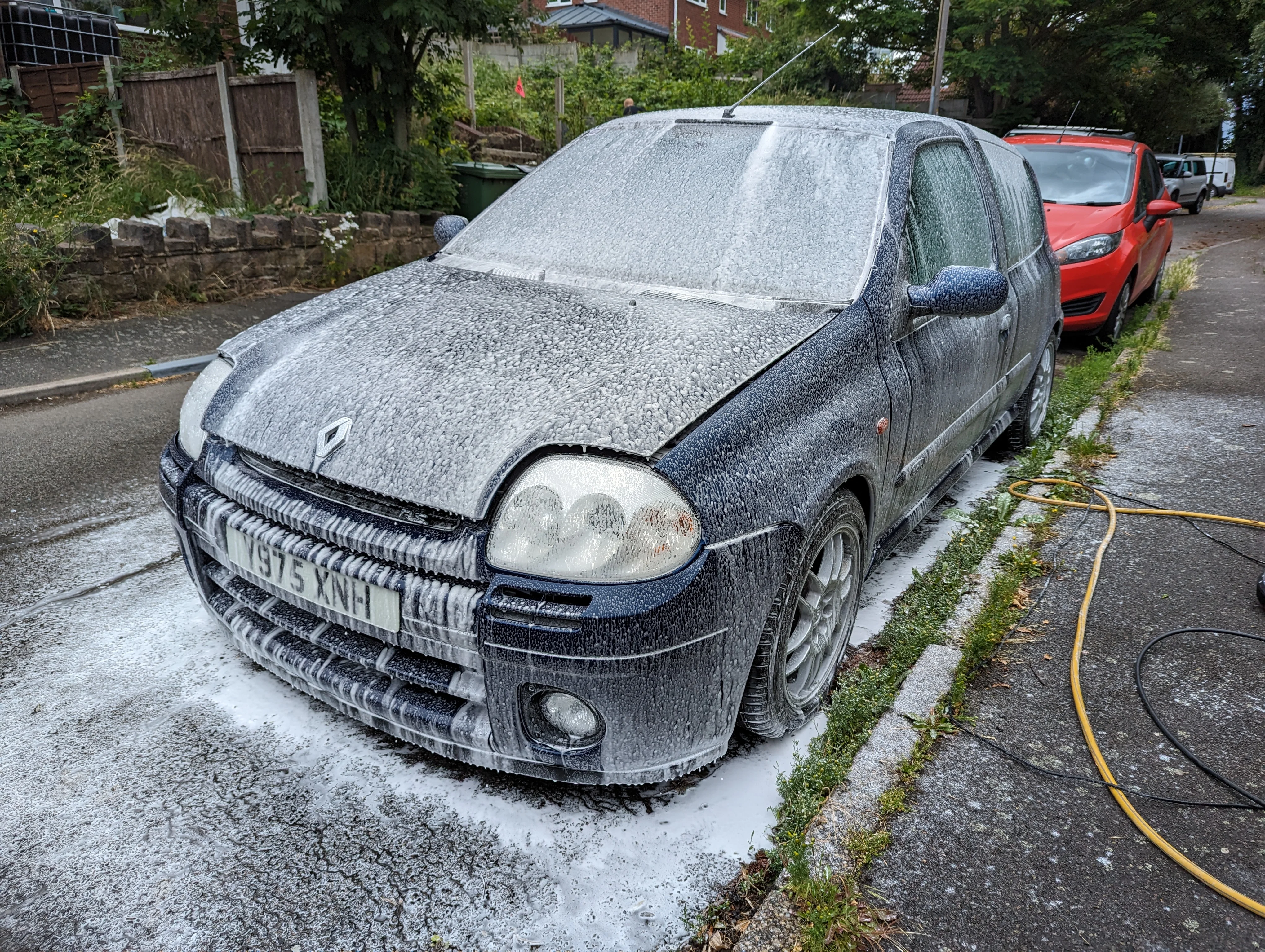

Gave her a bath as was looking very sorry and didn't want Mick thinking he had a barn find on his hands come Monday
Fitted new drivers side mirror glass as heated element on old one was none functional and refurbished the wipers to make them a little more presentable.
Then nose to nose with the Alfa. Makes you realise just how small the little Clios are!

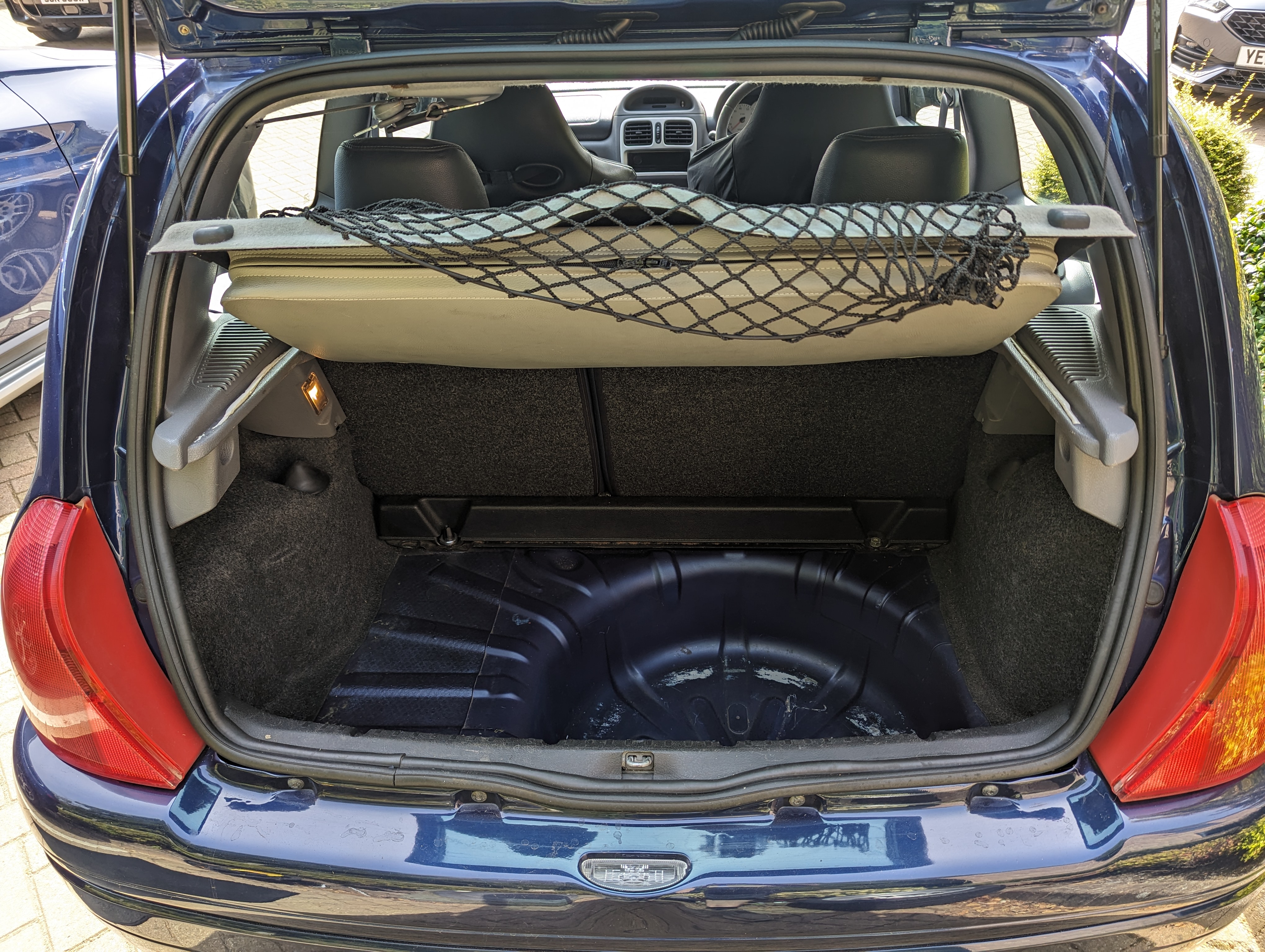

Bit of dampness in the boot, suspect grommets so I'll seal those up, used the blazing sunshine today in the works car park to empty and dry the boot out

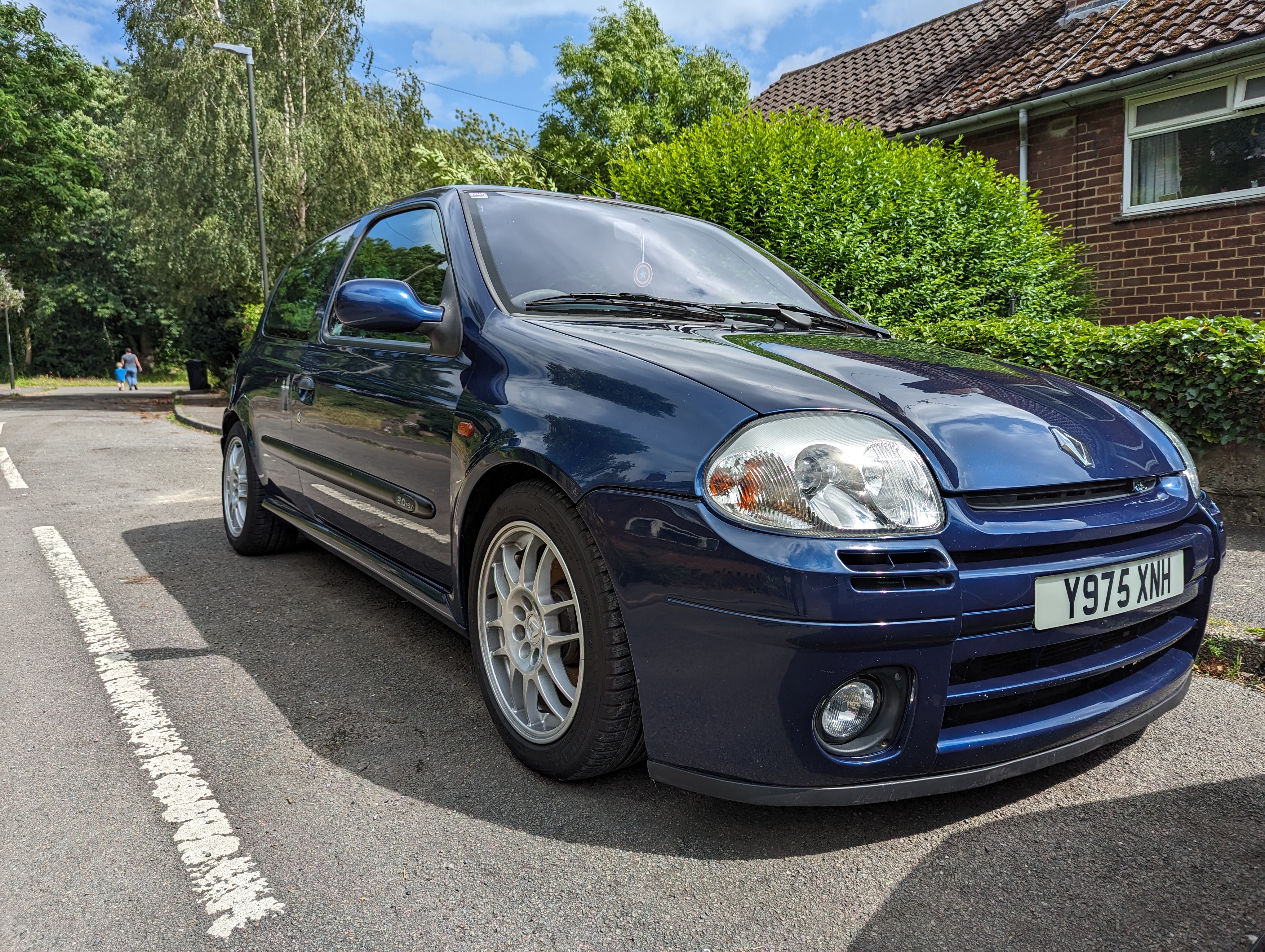

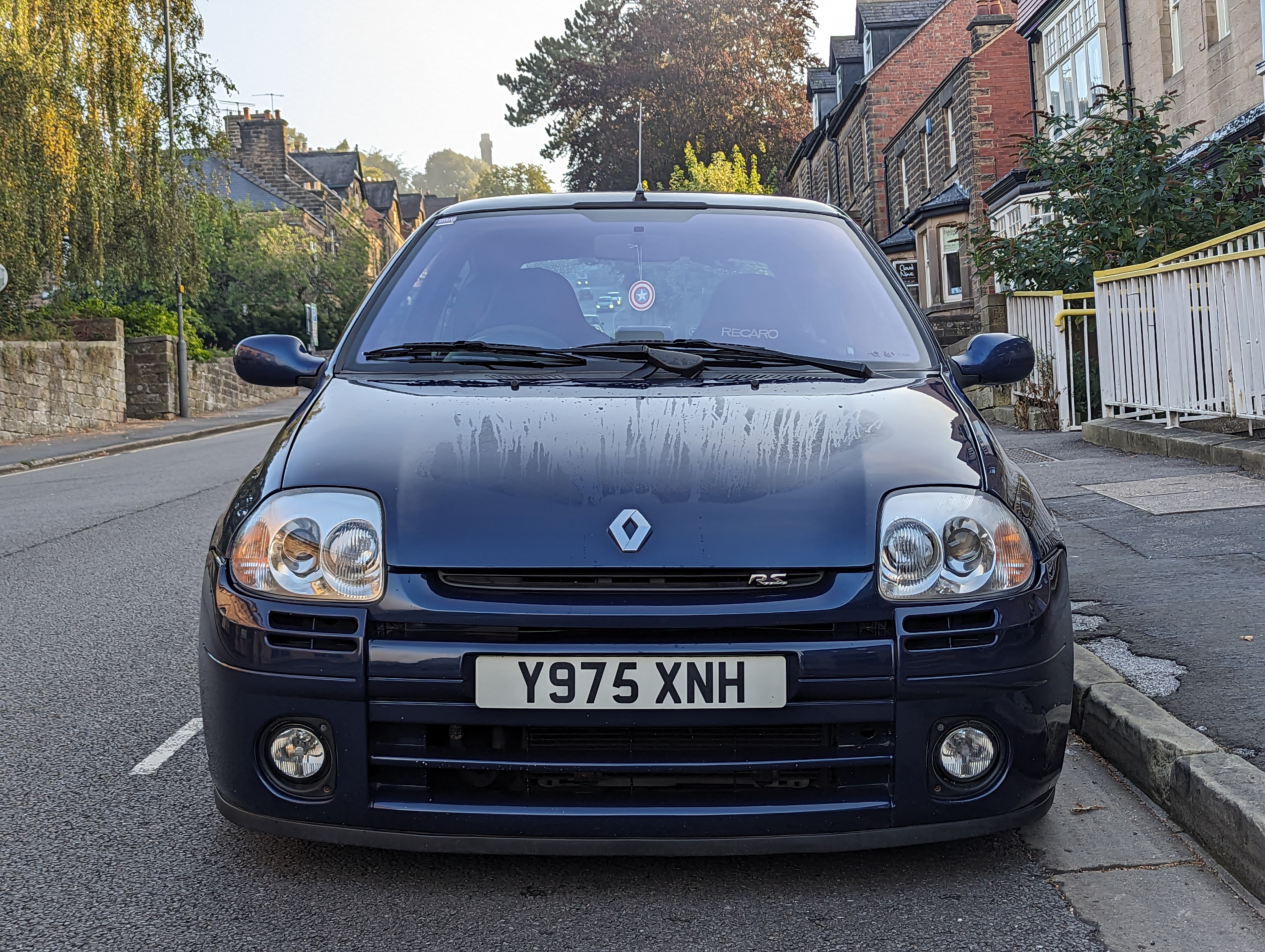

Just been cranking the miles recently, cars a dream, few niggles to sort like dash centre display light intermittently going out despite new bulbs and just simple crap like that which is par for the course keeping a 20 plus year old car going.
She does look good
What a view...

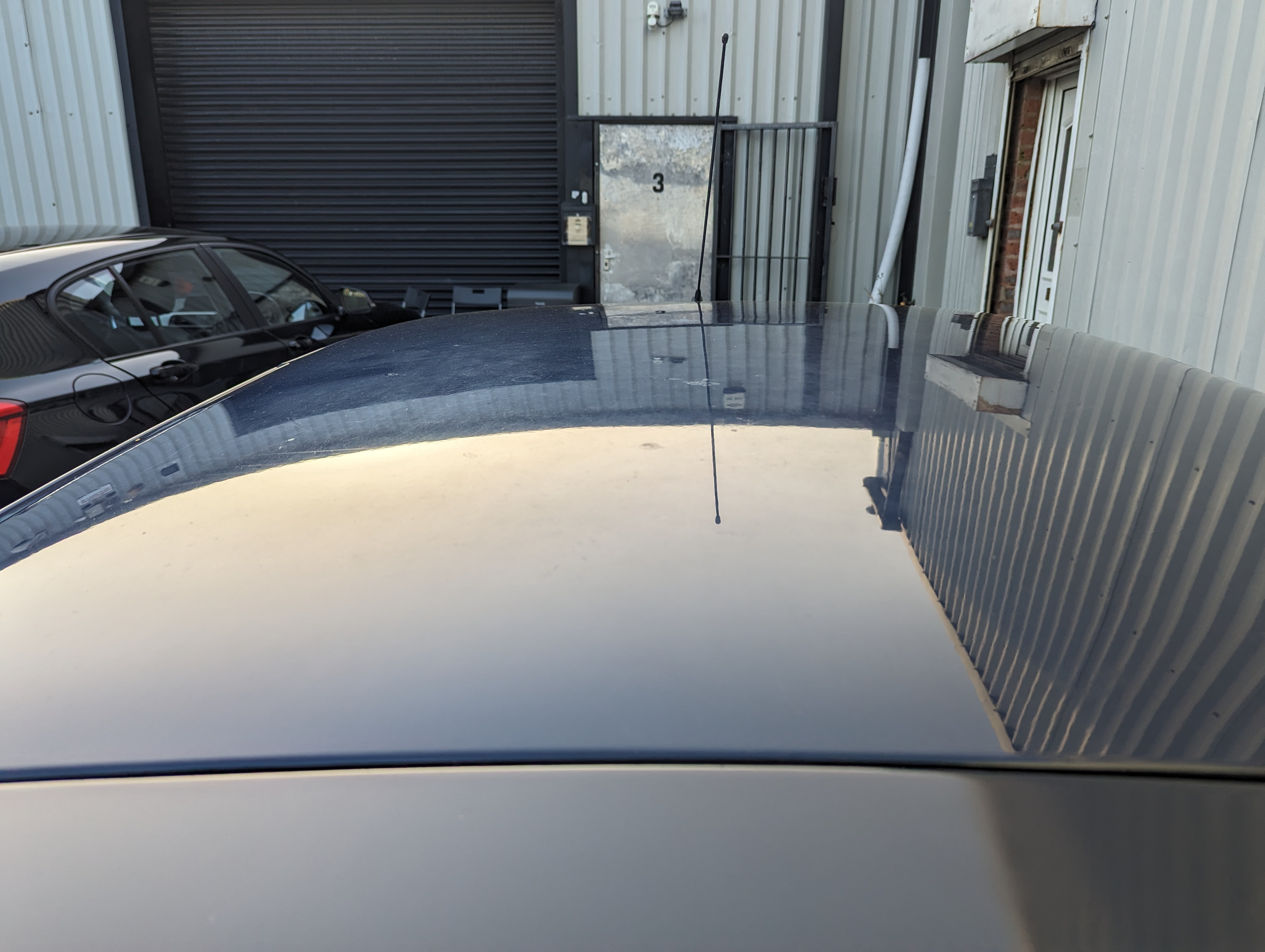

Roof has gone a bit flat too, hard to see in pics but it needs a buff, whole car does really.
Paint is the weak point, she's rot free but needs a full hit really.......

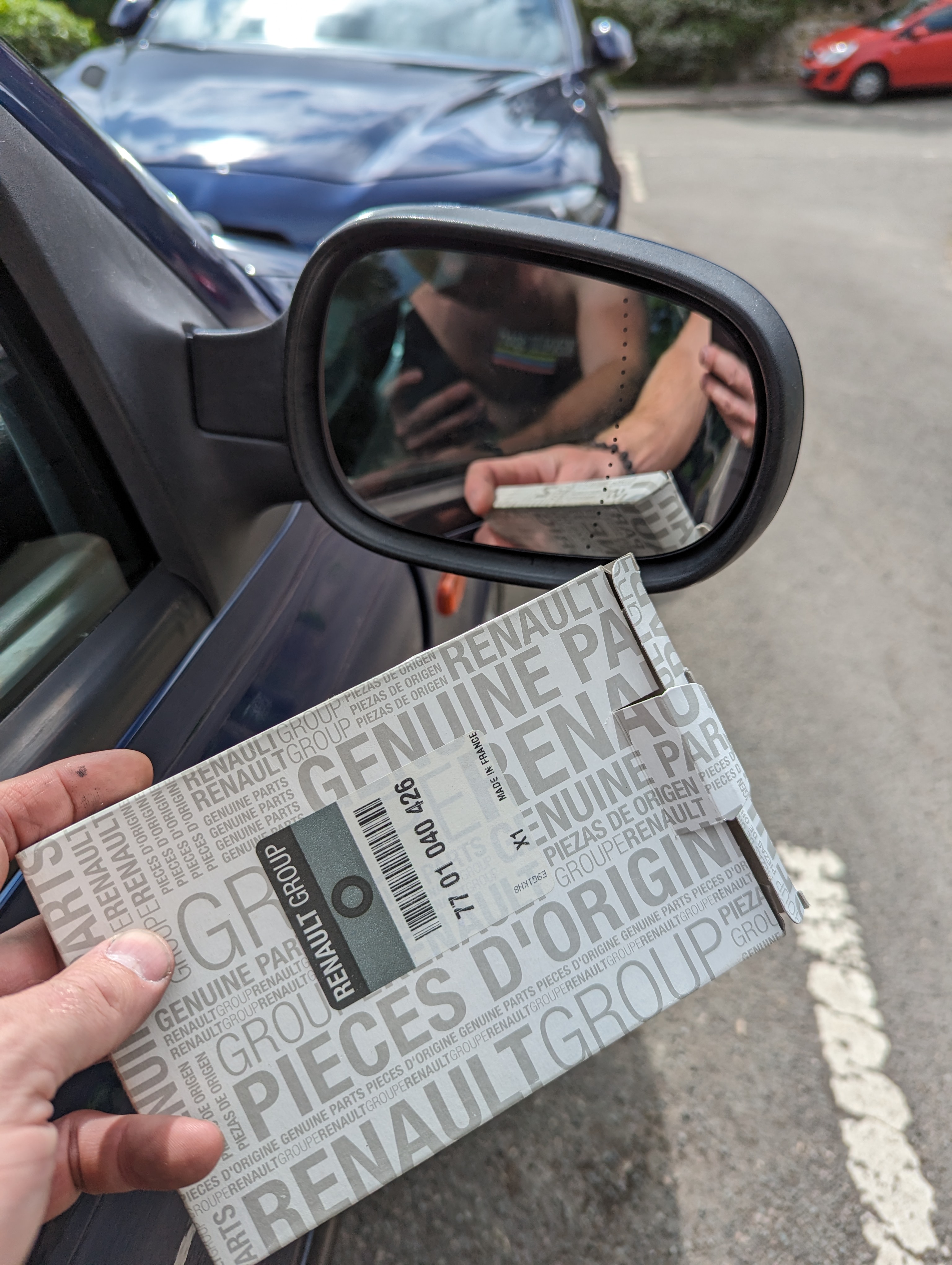

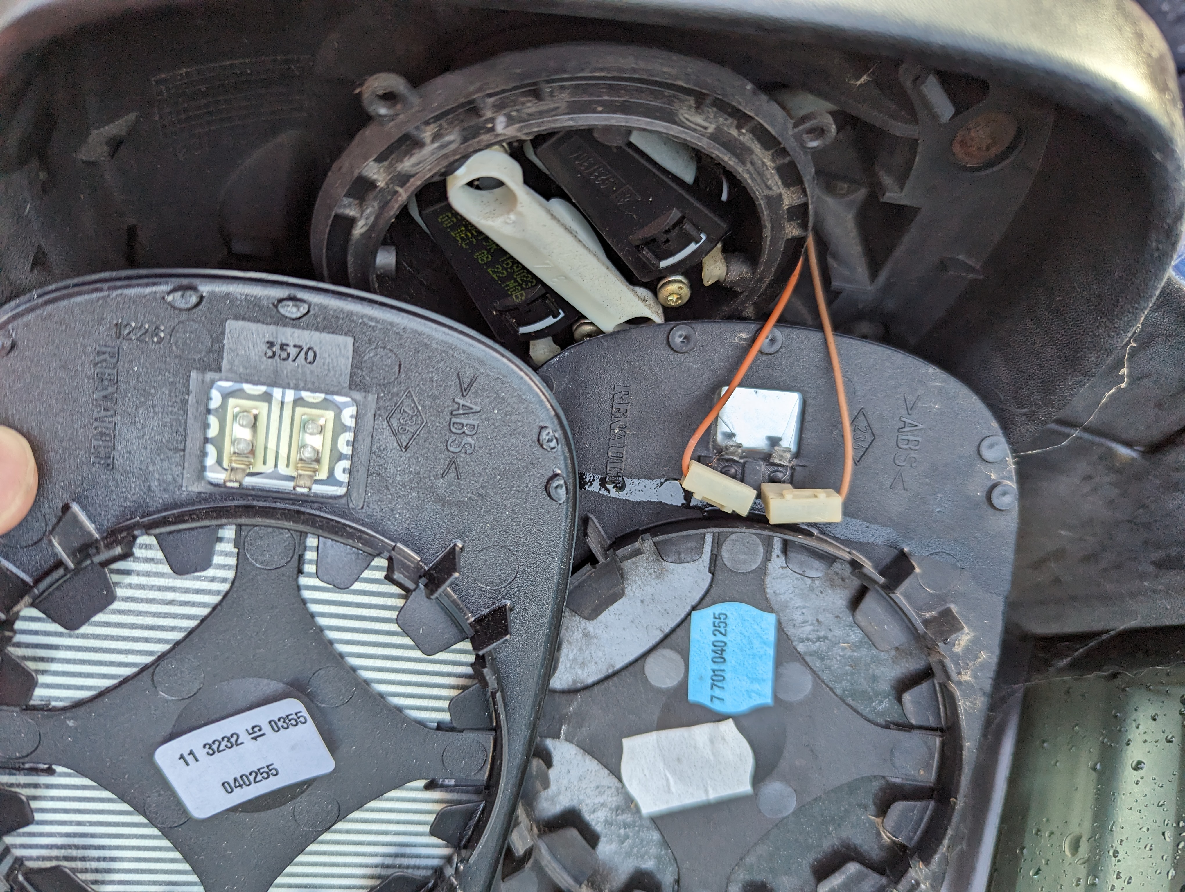

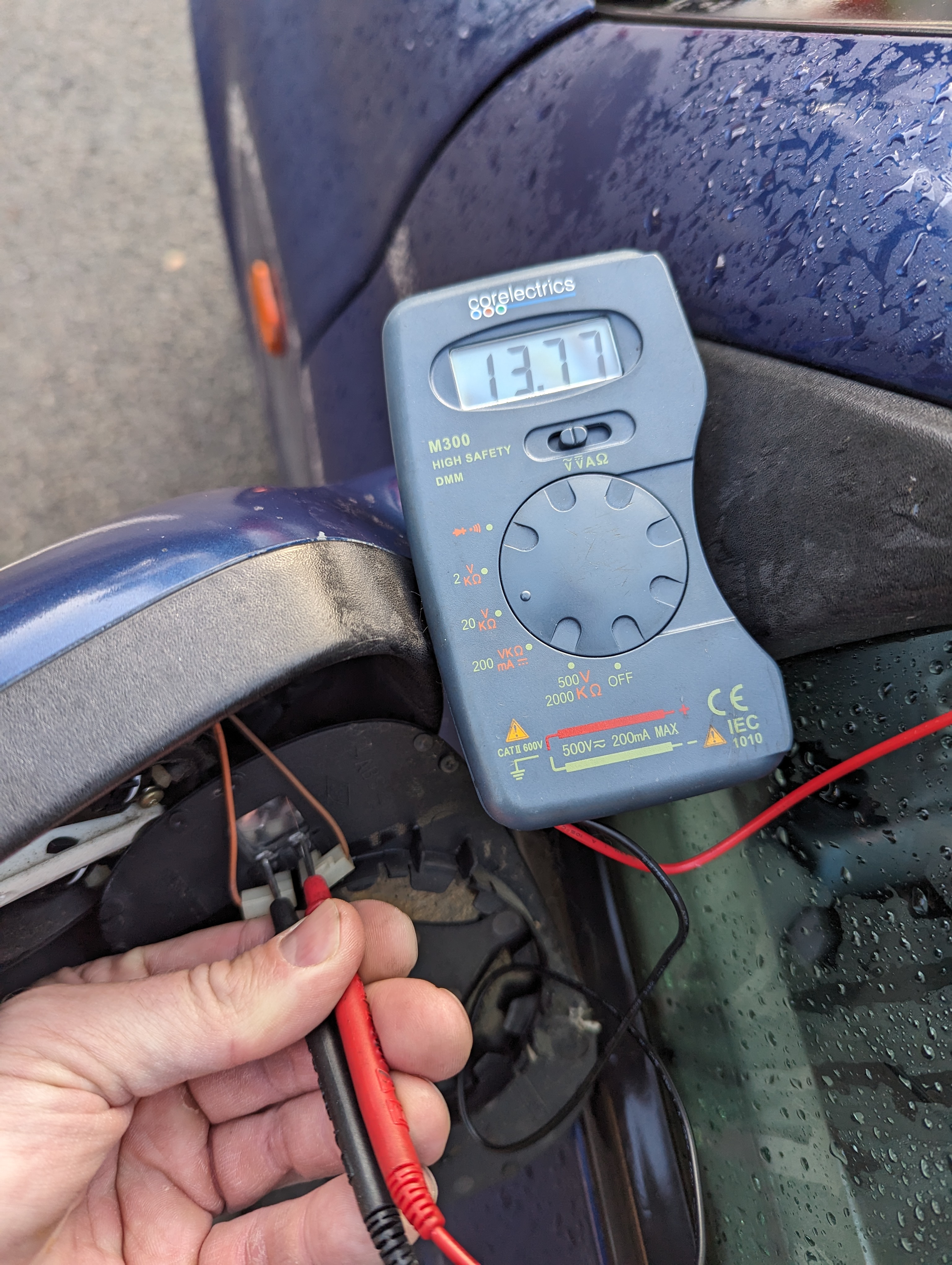

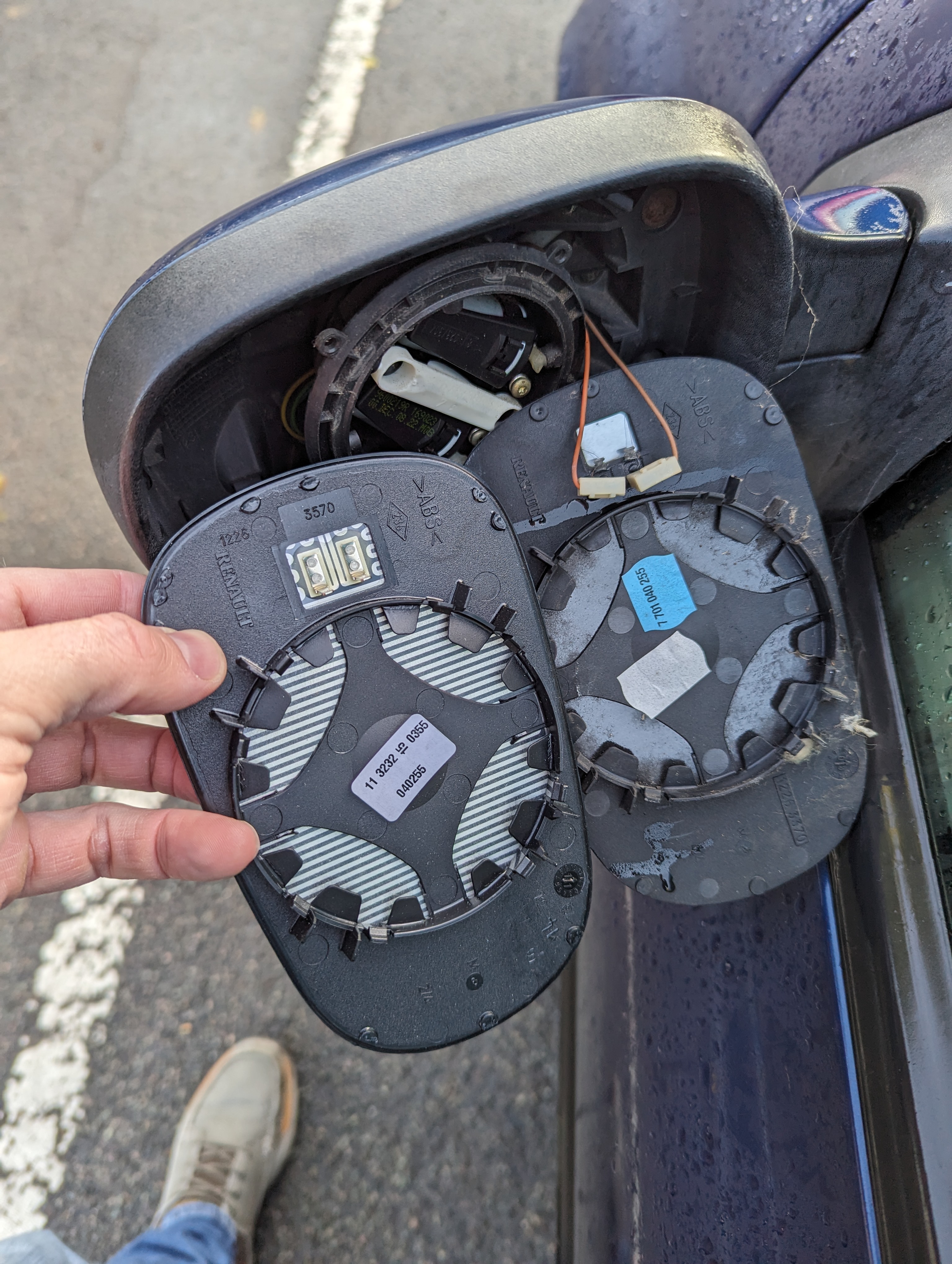

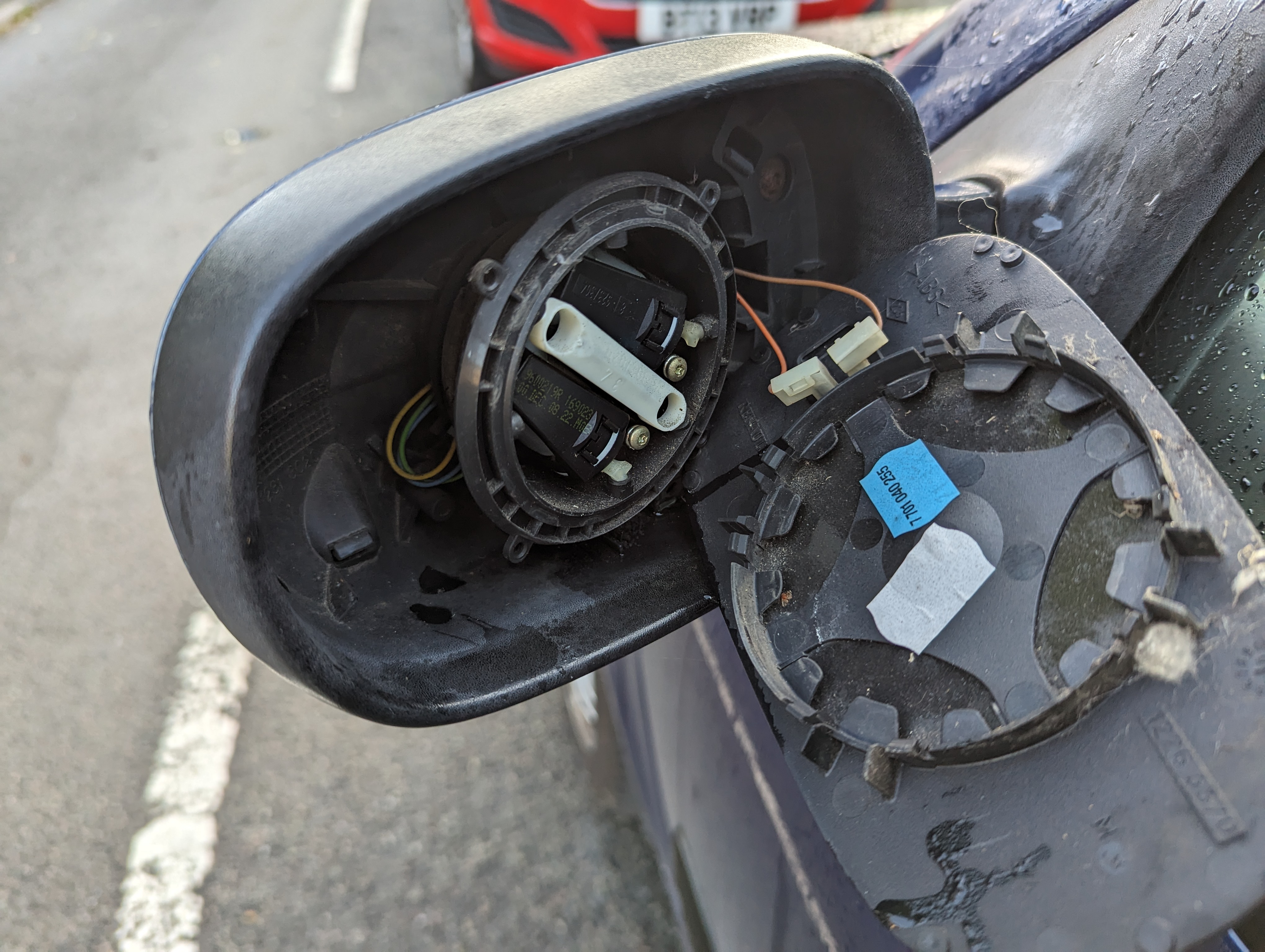

First niggle, passenger heater mirror not working, I replaced the driver's not long back and bought both sides from rpd when they were on offer for like 8 quid a piece.
Wiring looked in tact on old glass when I prised it out, so quick check with multimeter make sure was defo glass and not wiring at fault, and plenty of volts so we're fine.
New glass in and done, can see the revised design on the connector too on the newer glass, better weather protection etc

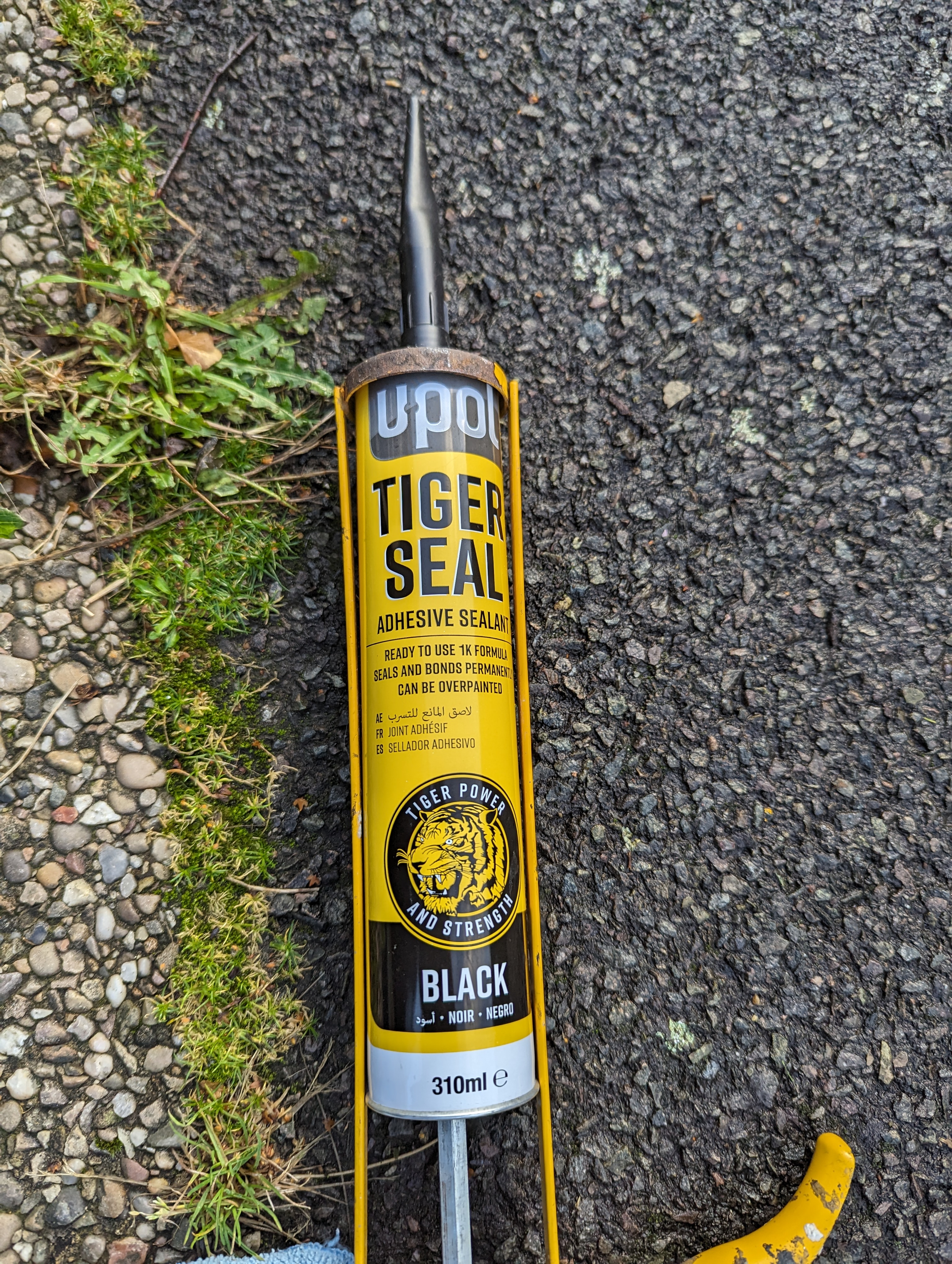

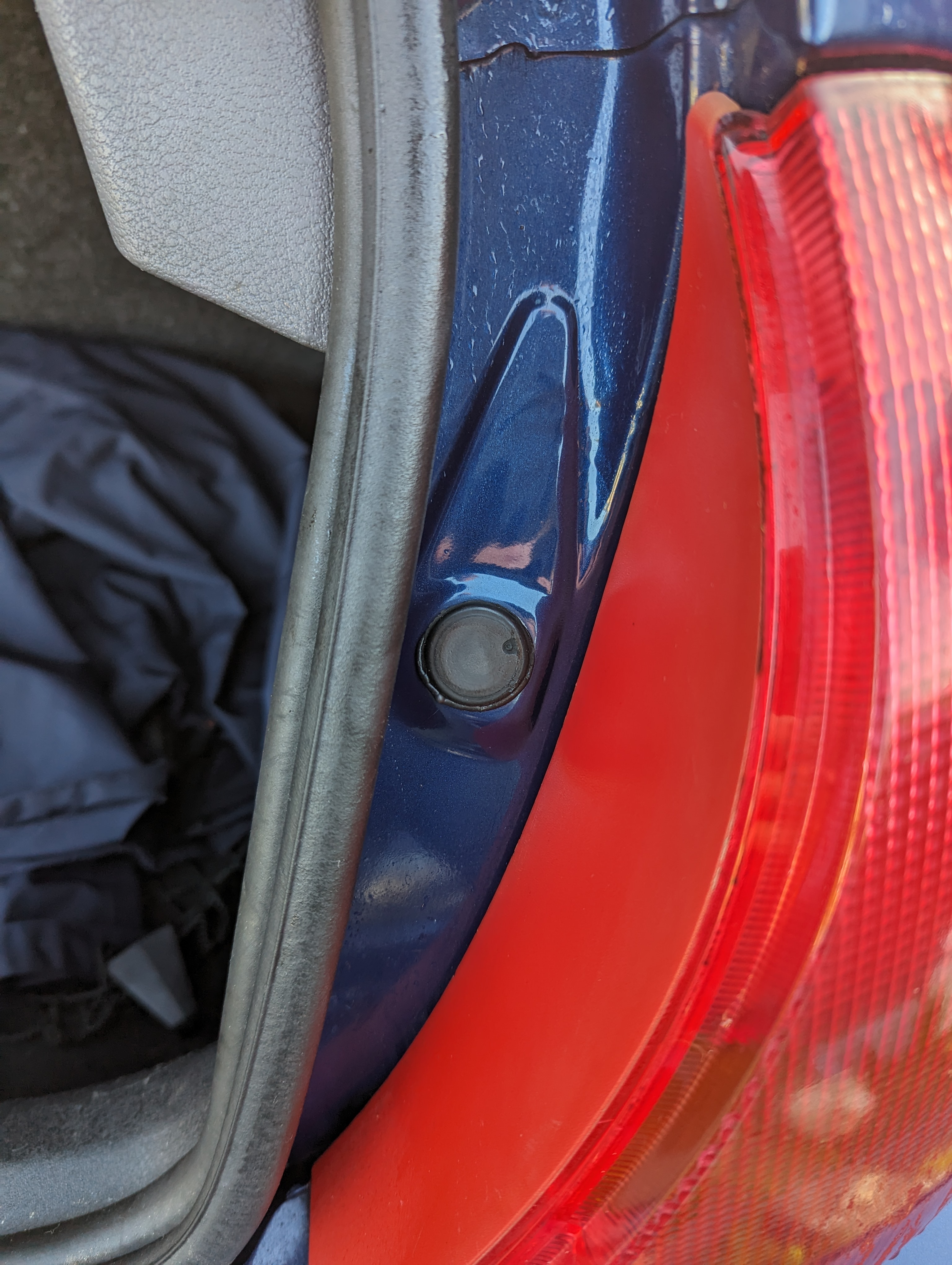

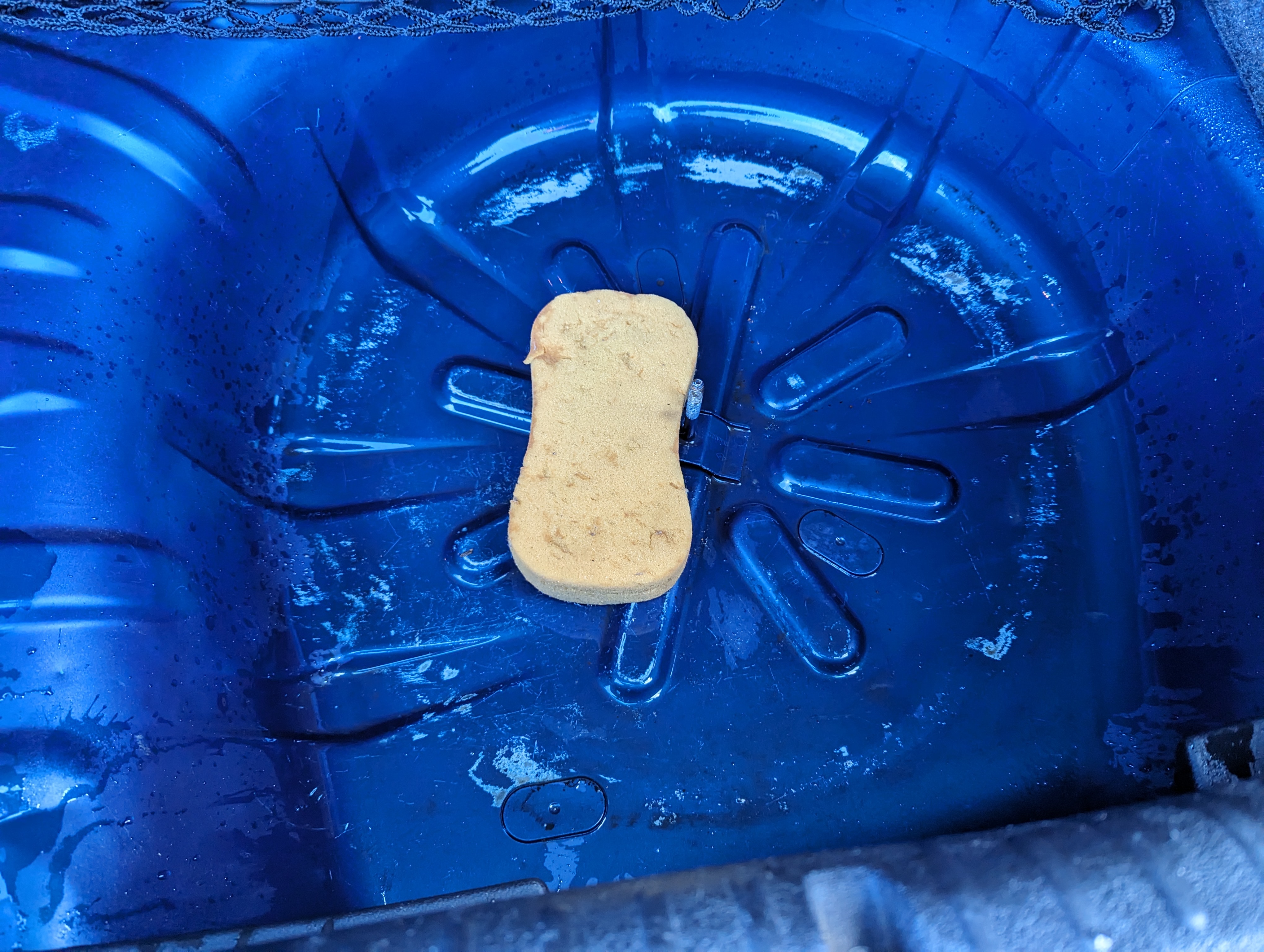

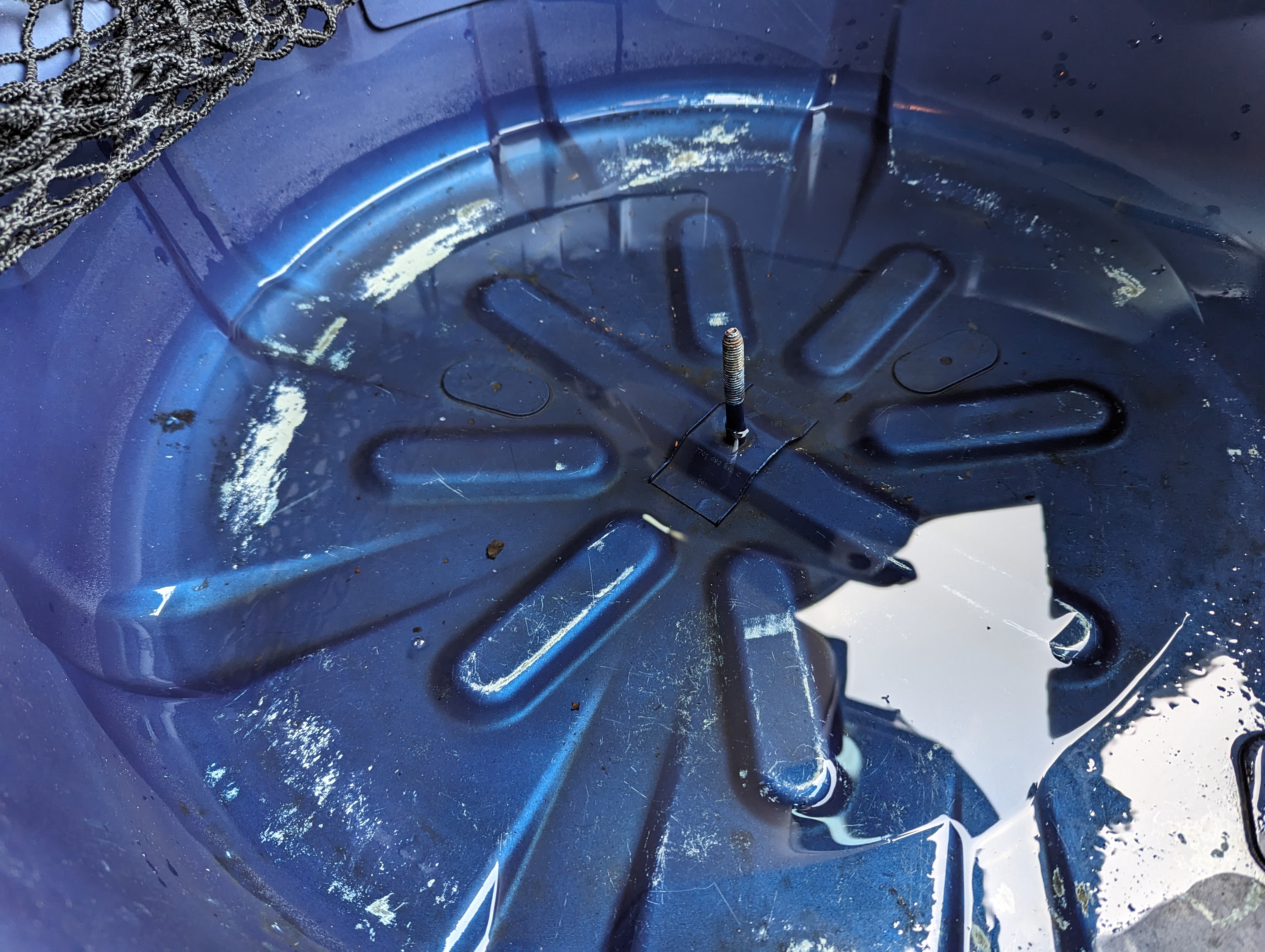

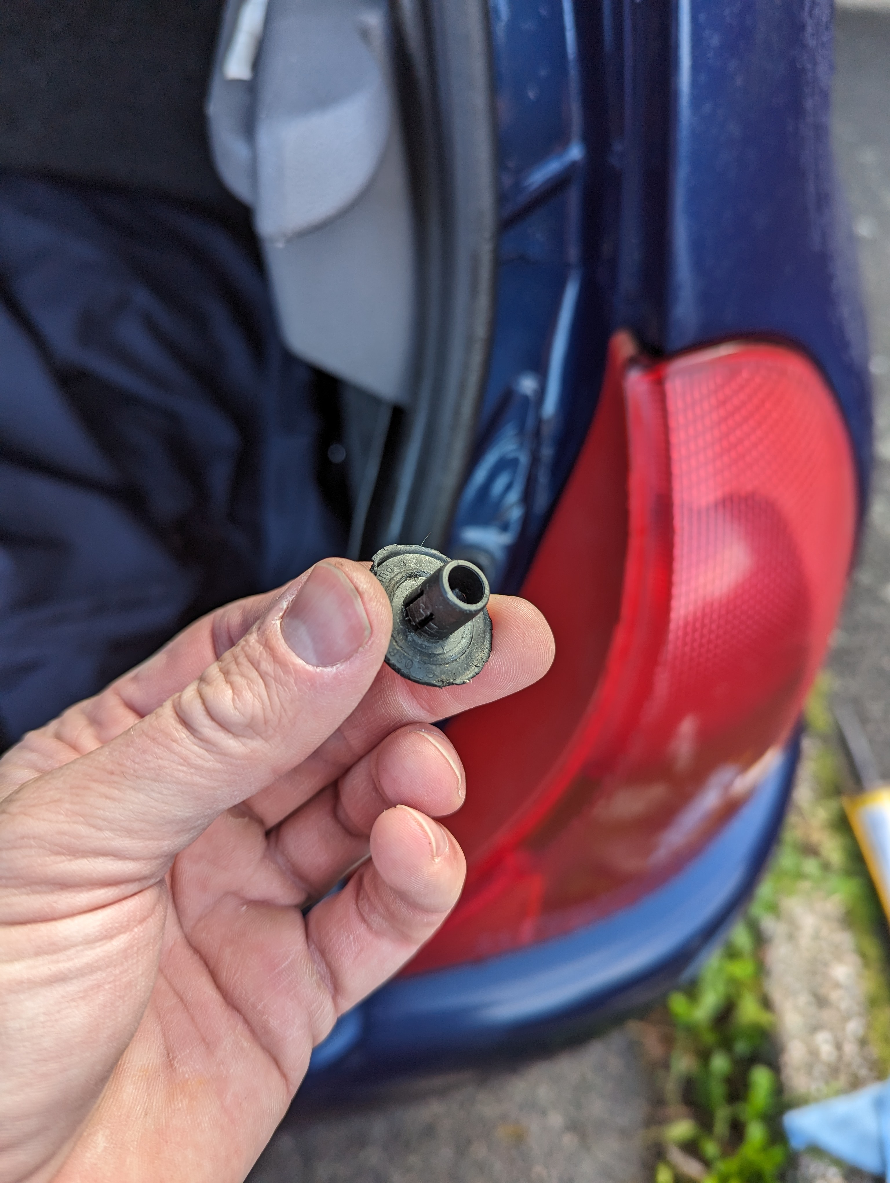

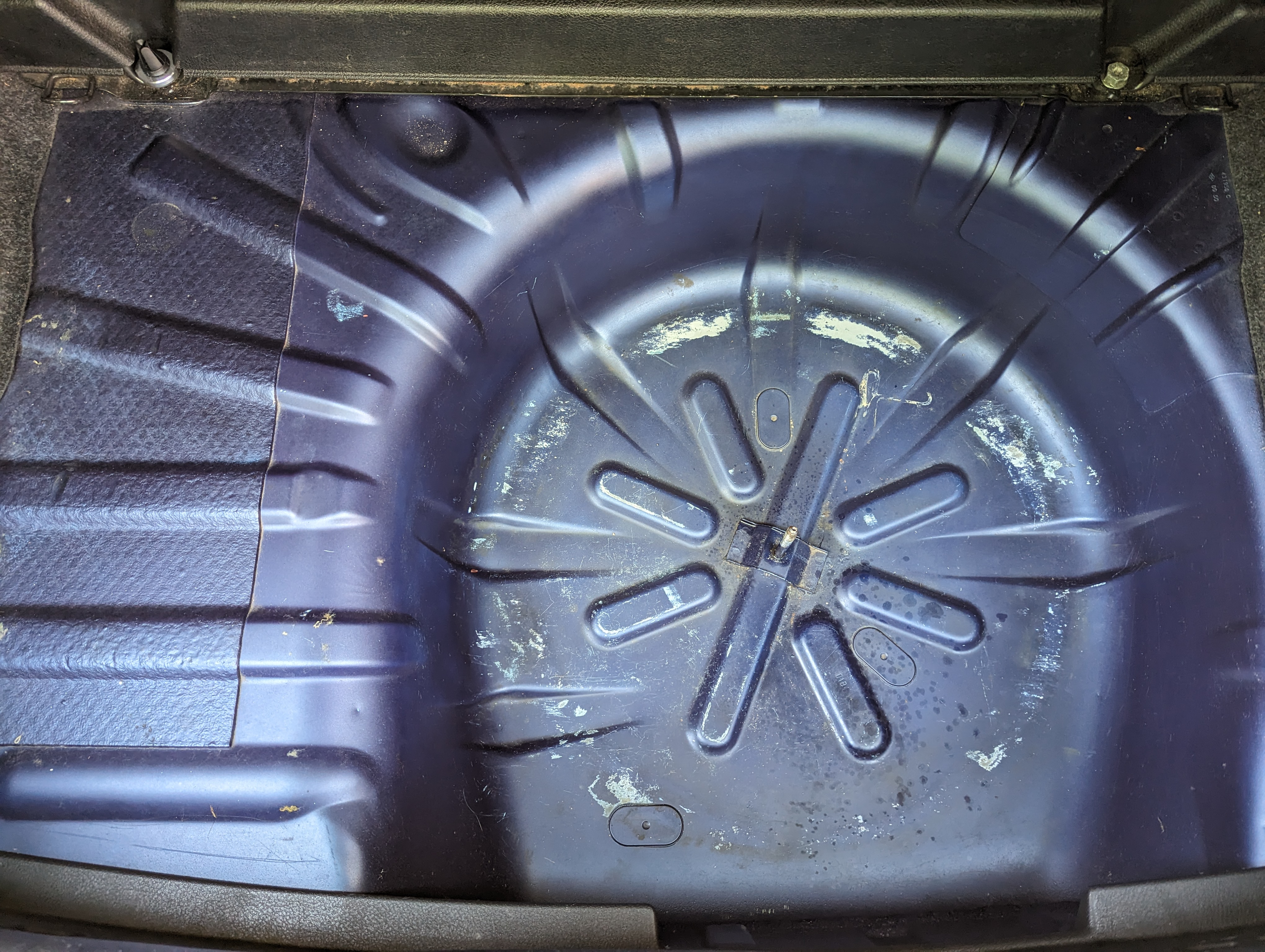

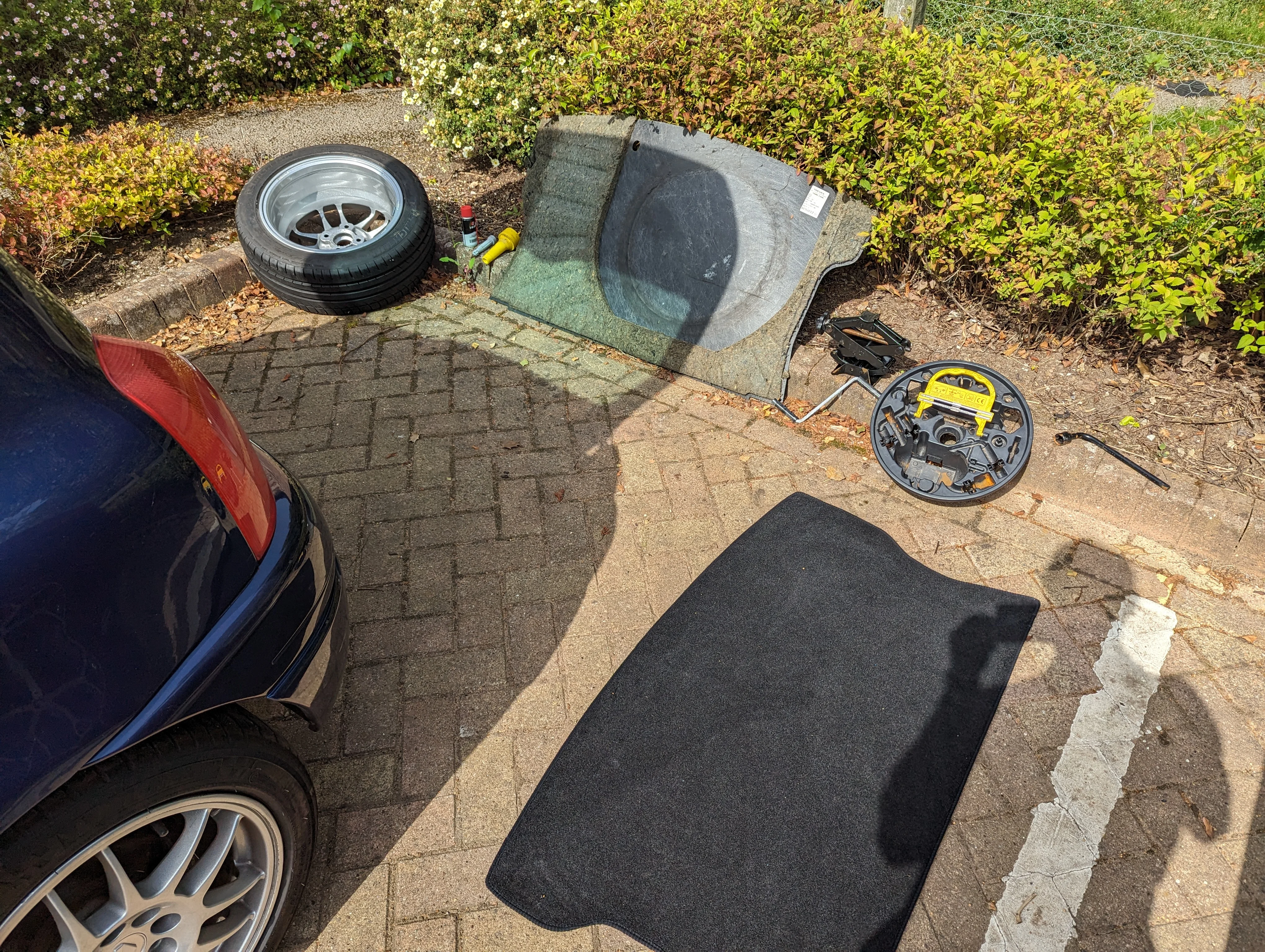

Next niggle, boot has always let in a little water, but it's reached new extremes recently, about 1.5" in there today so decided enough was enough and got the bungs out which were slack as piss so most likely the issue.
Cleaned up and good old tiger seal applied then refitted, hopefully that'll cure it.
Nice sunny day too so sponged out the water and left all the carpets and tool kit/spare to dry. Decided against the Clarkson shotgun drain method.....

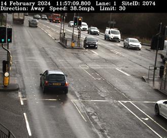

Recently I've replaced the clock twice as one died completely then the next one the temperature display was goosed and the clock itself just kept advancing a minute every second or so, all sorted now though.
Passed MOT on valentine's day although the hazards worked once then died, so new switch on the way to fix that niggle.

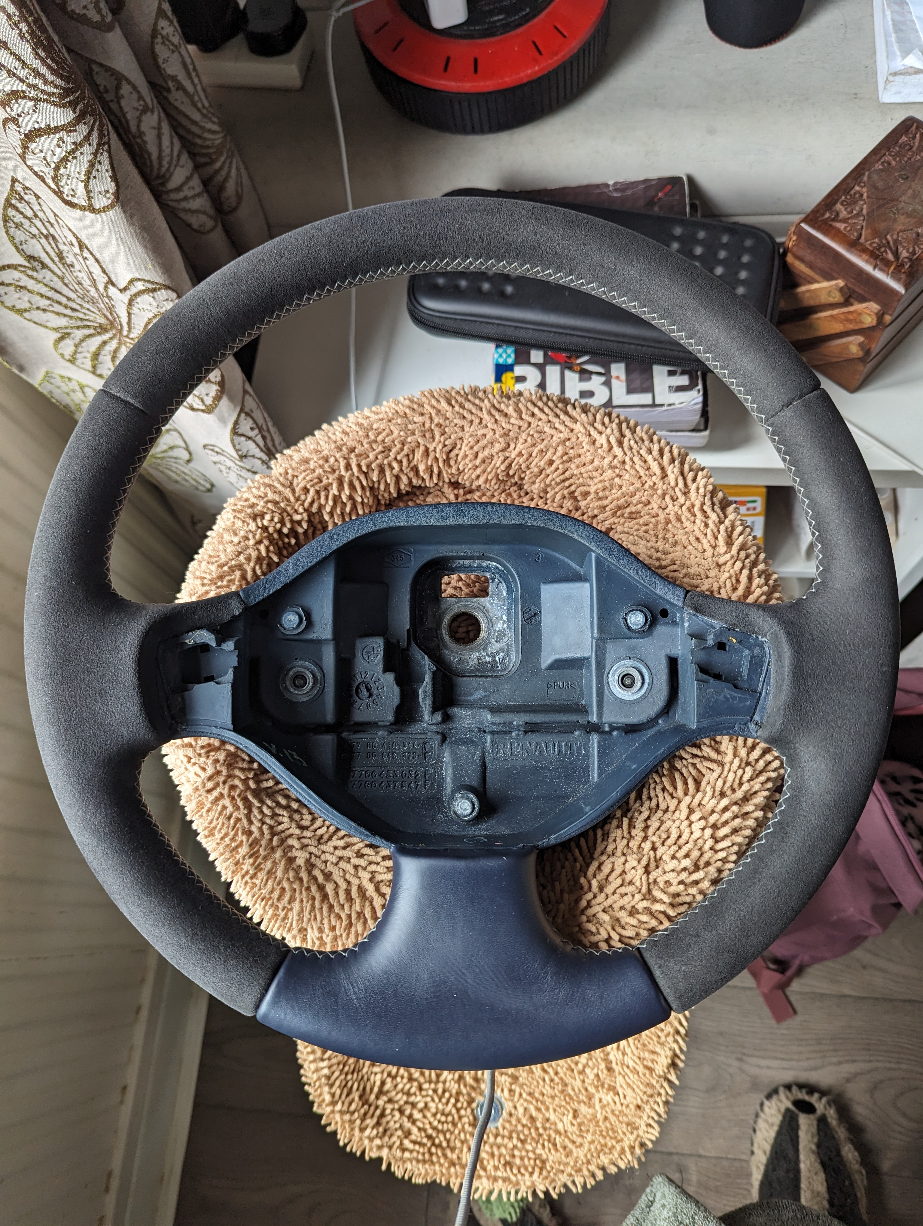

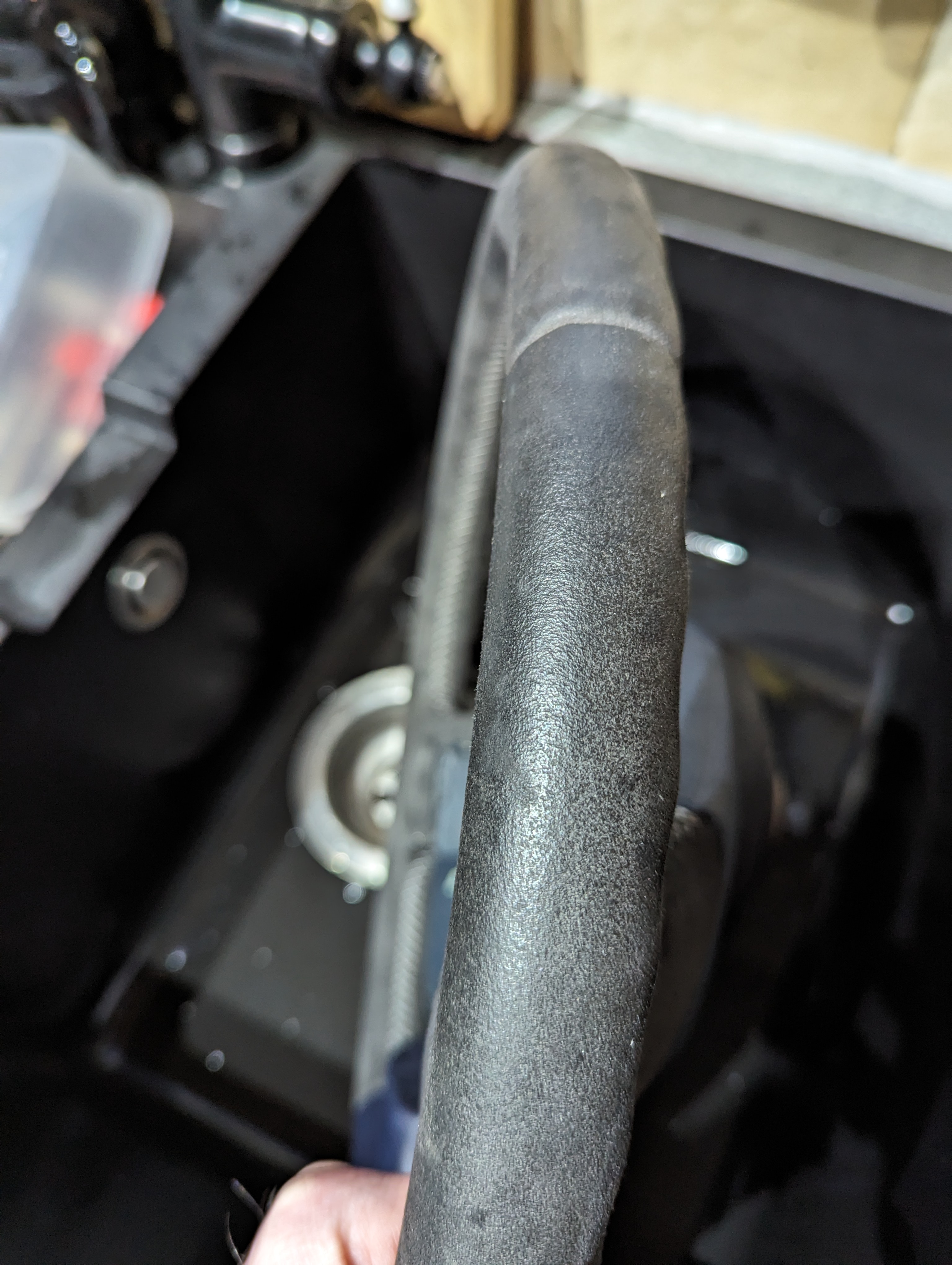

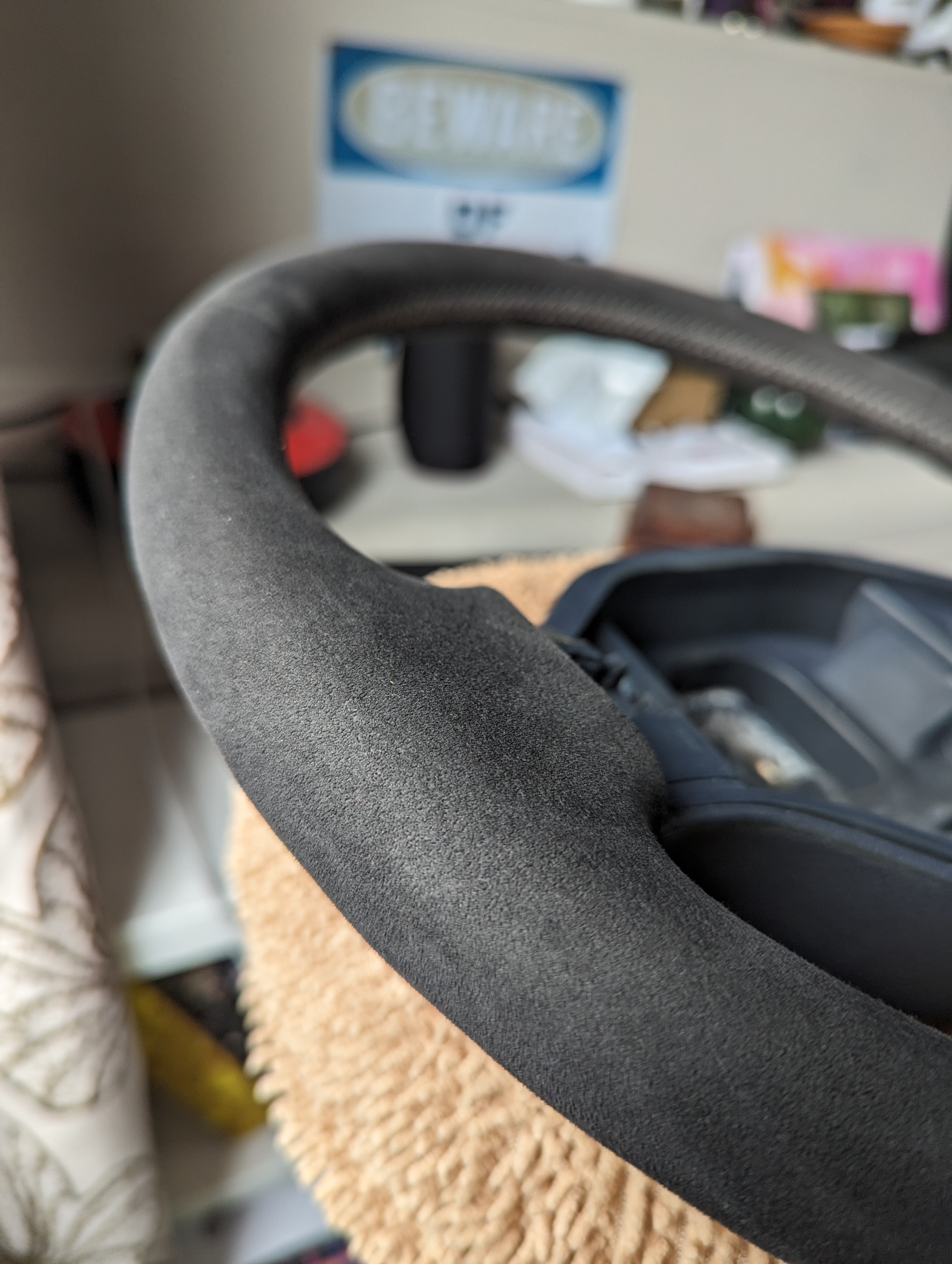

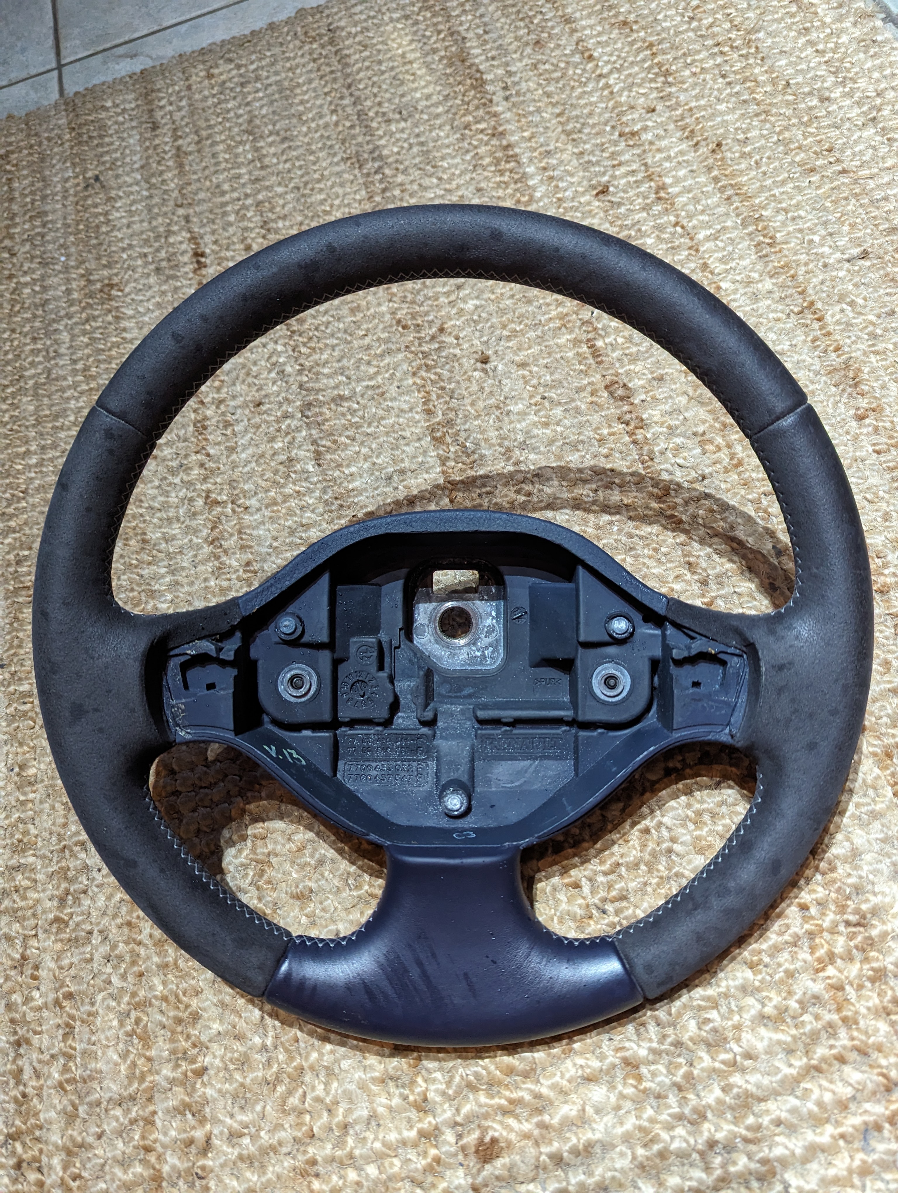

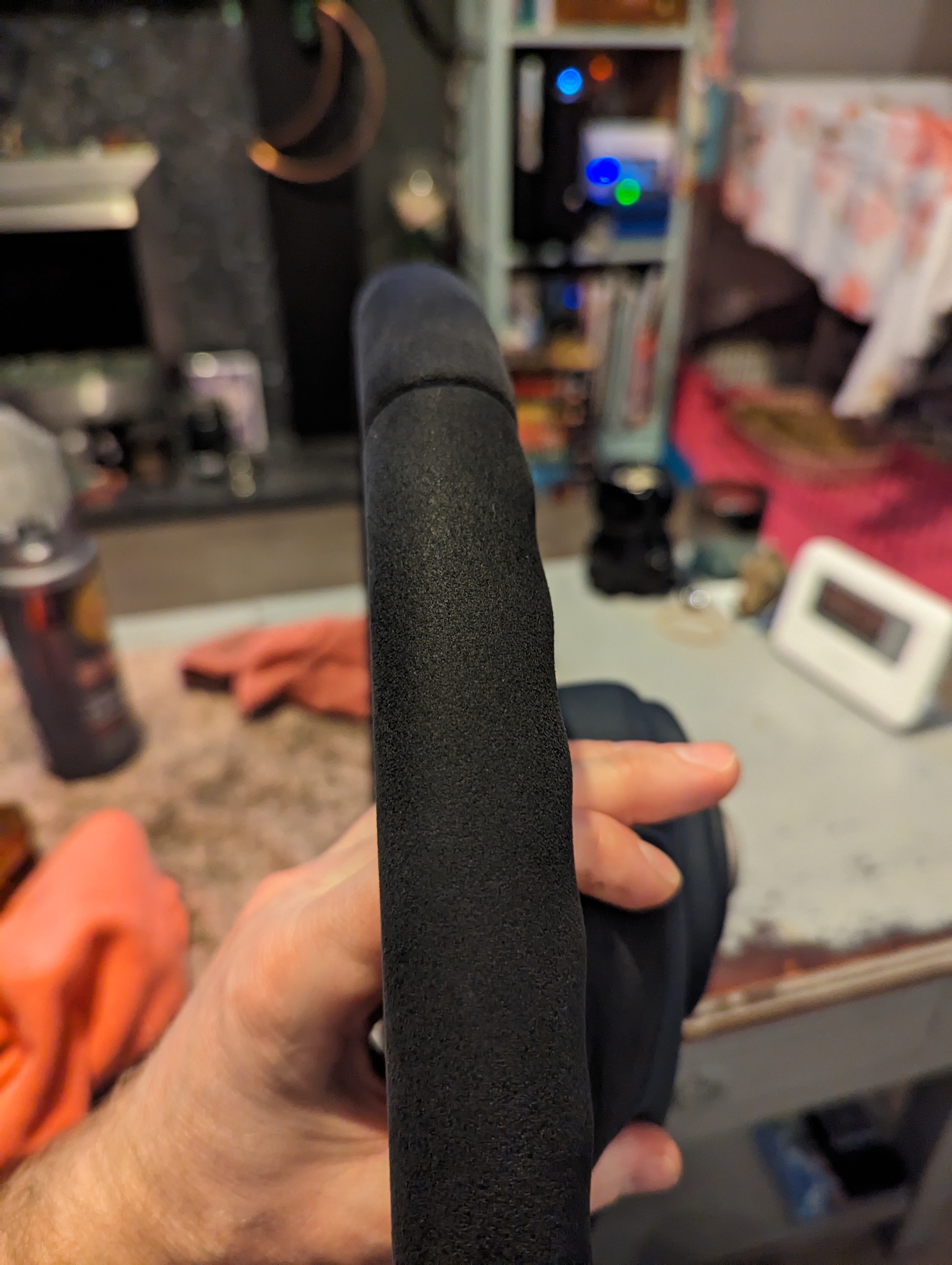

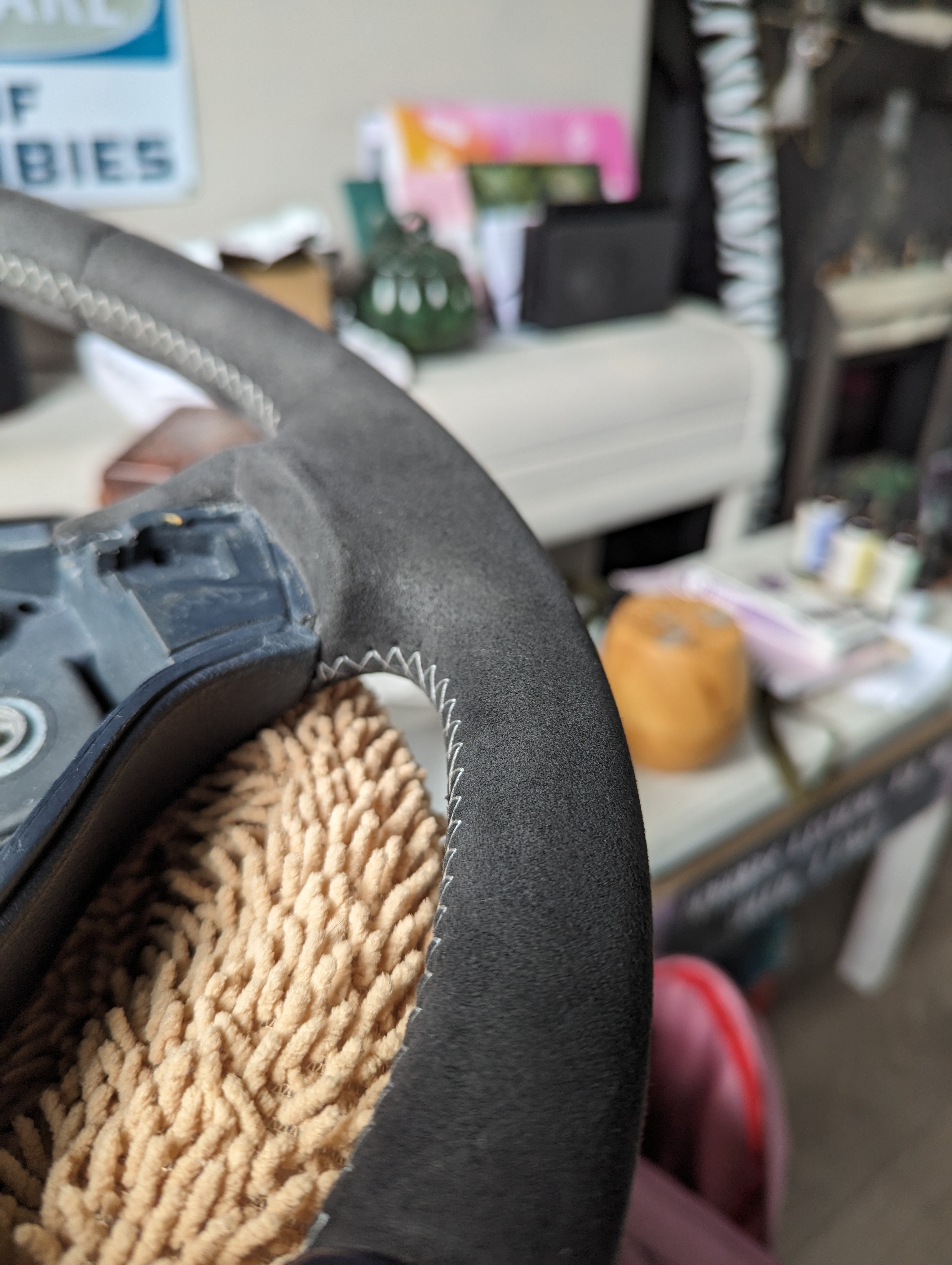

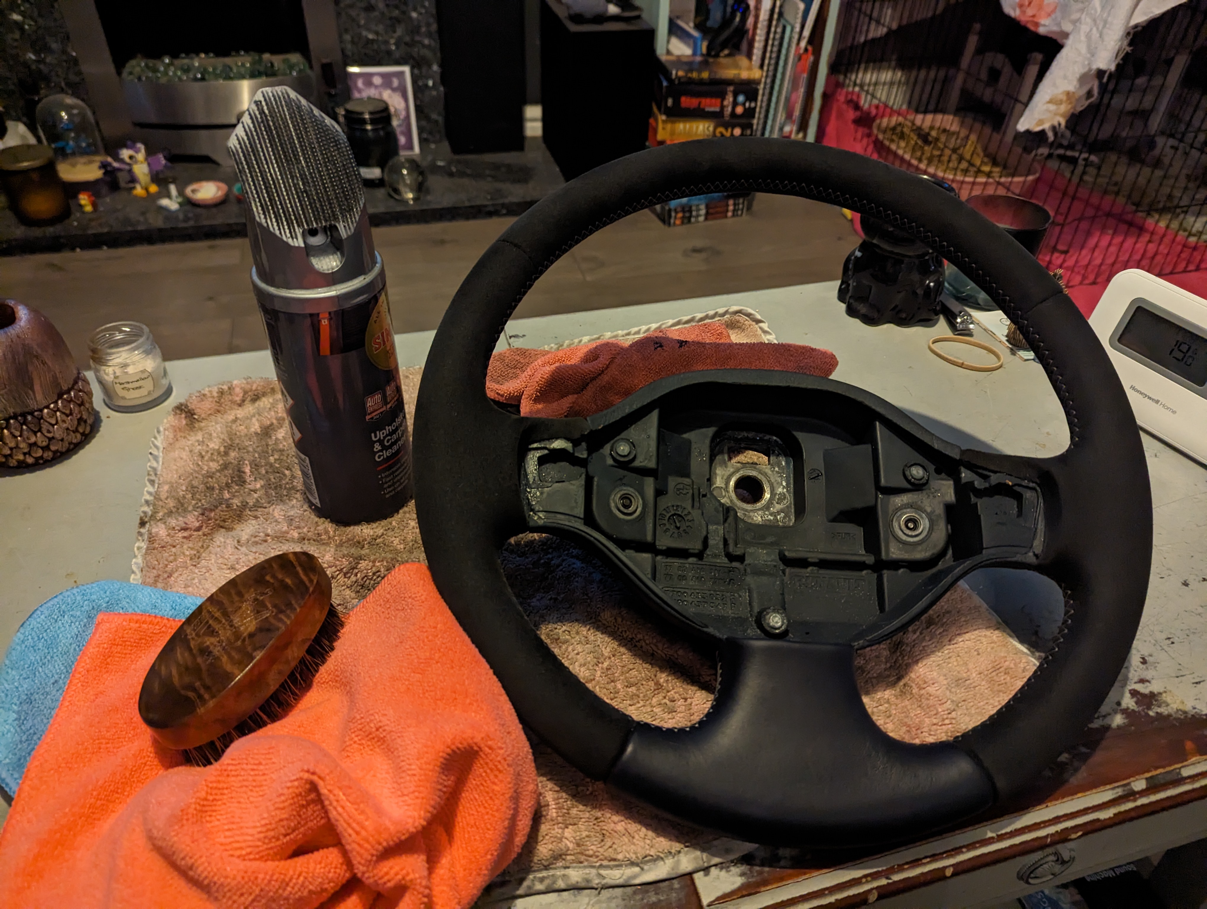

Did oil and filter for the 166k service yesterday and then removed the gopping alcantara steering wheel that Snappy refurbished for me almost exactly 4 years ago now to clean it, it's come up a treat.
Plans are too possibly return to more standard soon, so original spoiler, suspension and seats... Maybe.... Not decided yet.
Cheers
Ben
Disgusting wheel, full of last 4 years of grime
Used some cheap simonz interior cleaner and a beard brush, worked like magic
Clean
