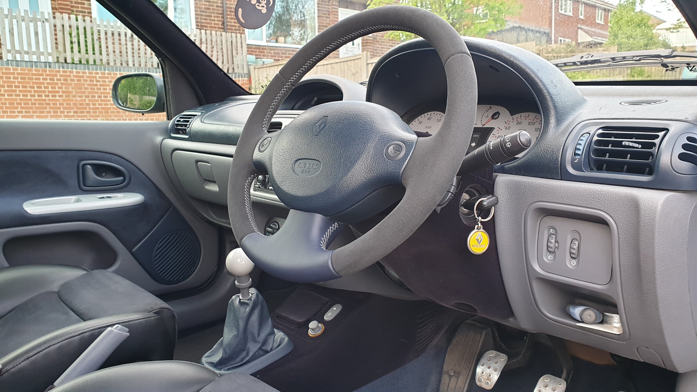

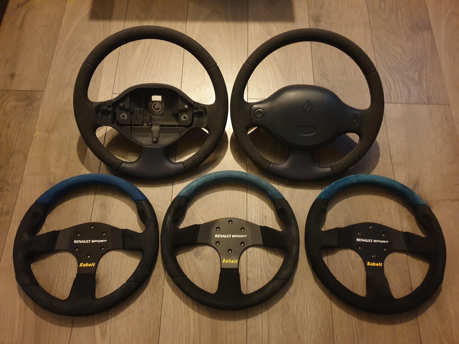

That's steering wheel looks a perfect, works really well with the interior colours. Are you selling the sabelts? If I cant have the car....
I may sell one of the sabelts soon, undecided as yet, but i'll tag you in the sale if I do let one go, definitely got wheel issues at the mo, lol!

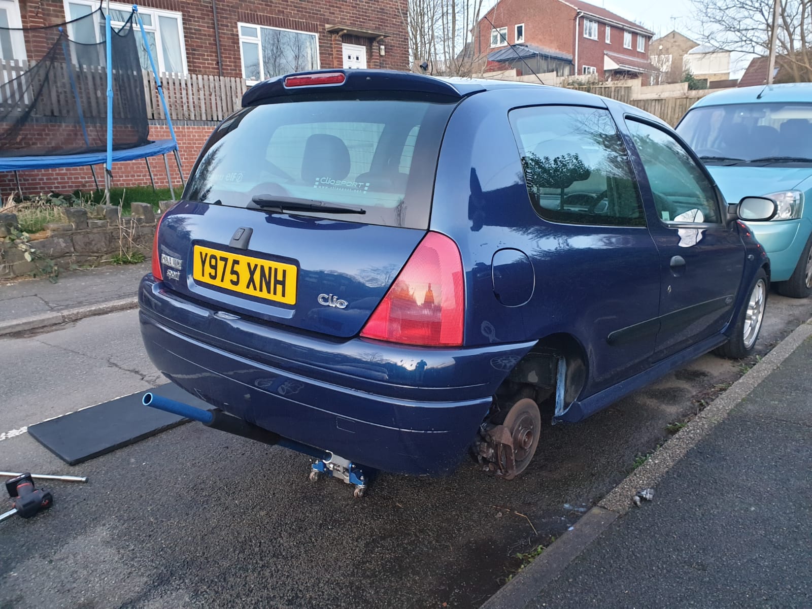

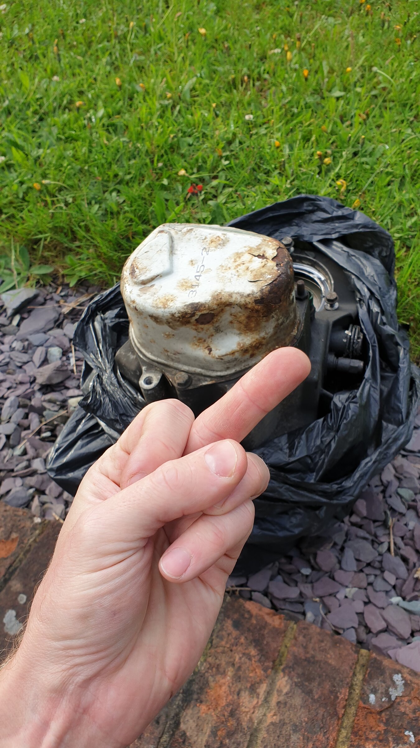

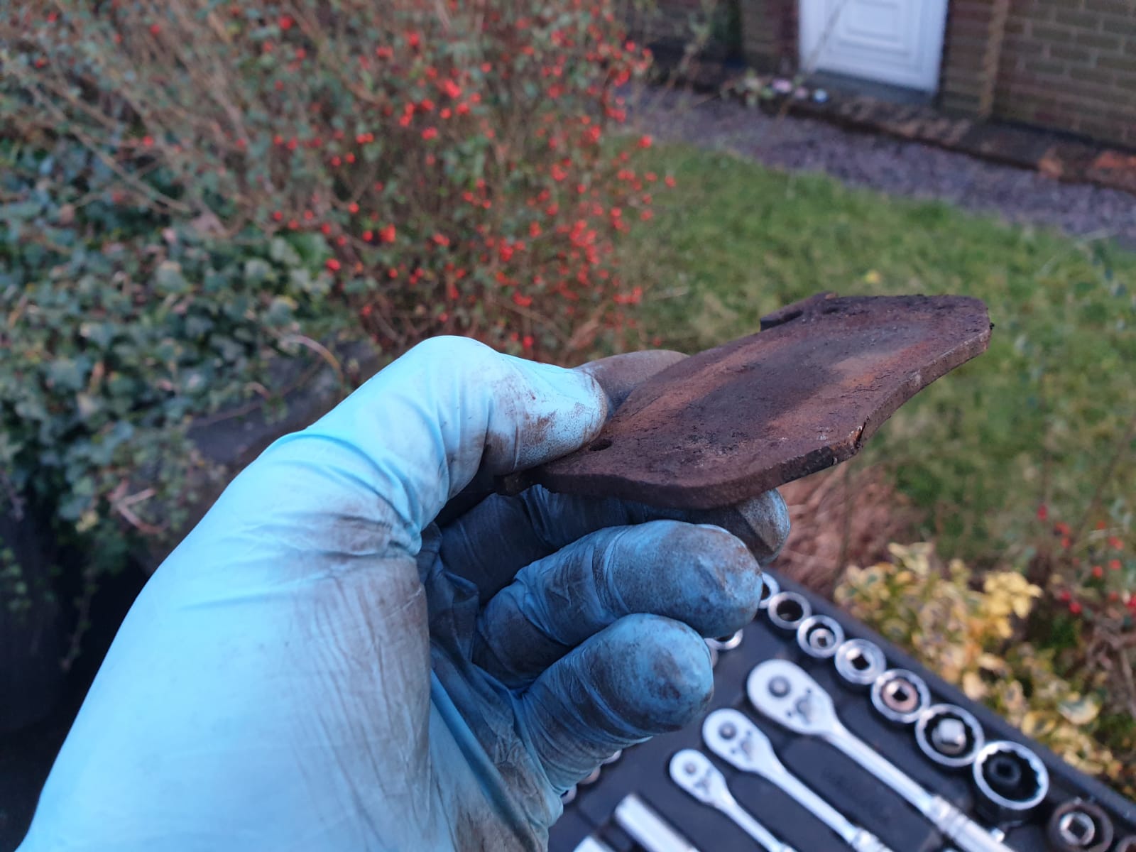

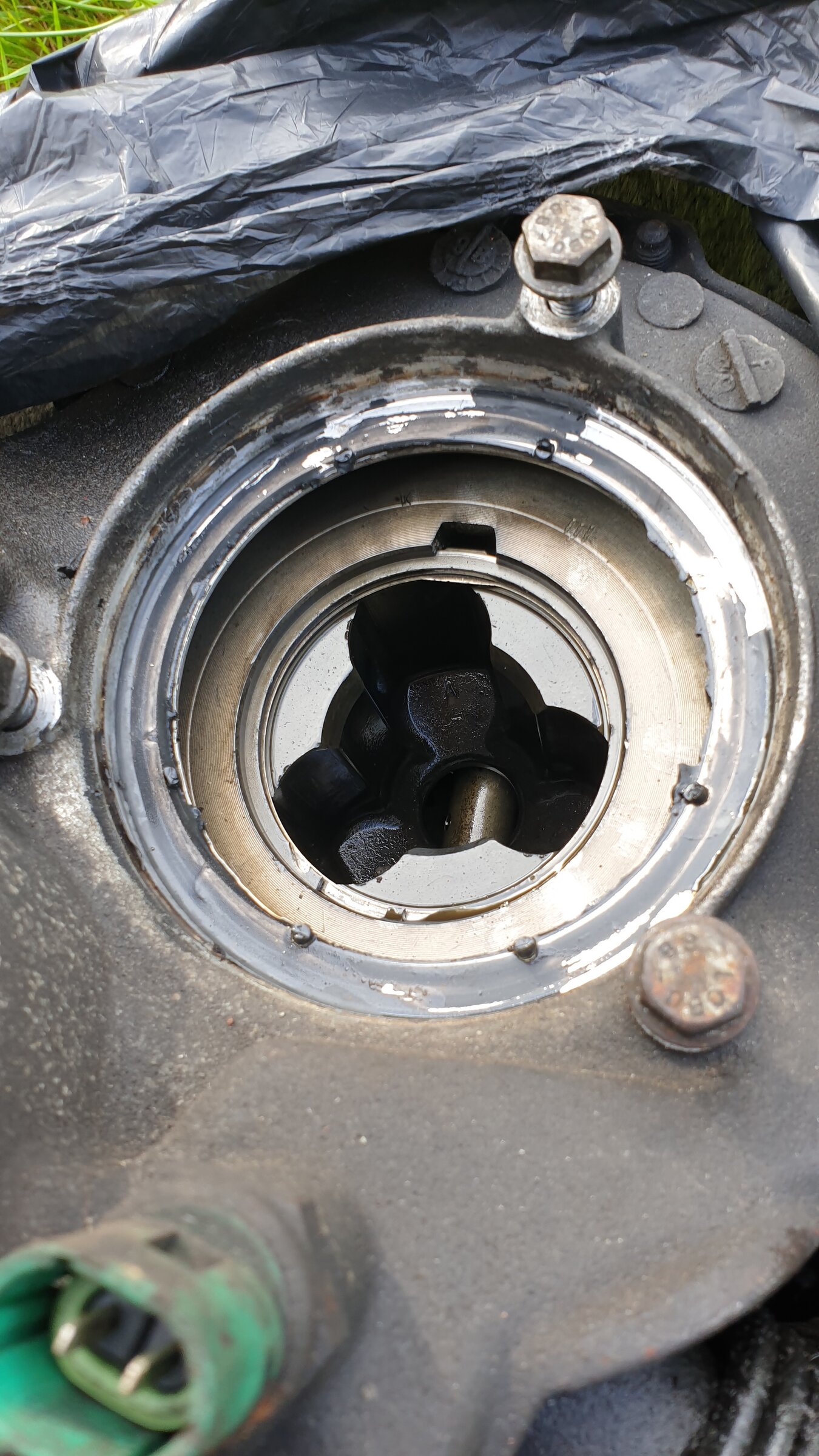

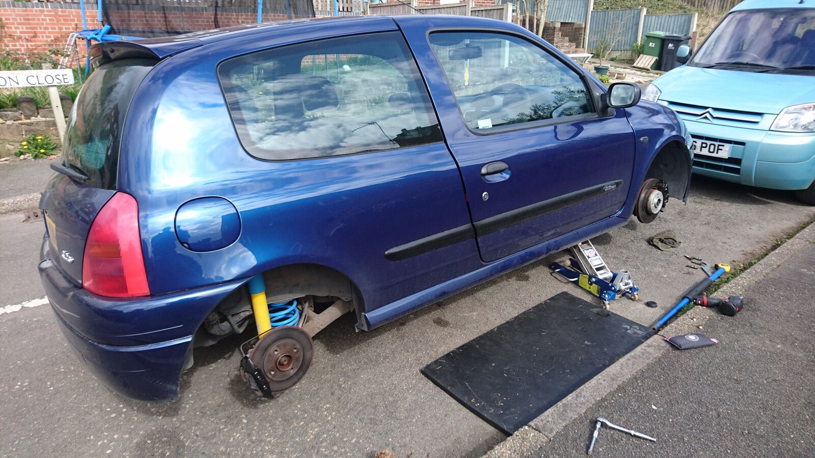

So, tried to use the car over the weekend as the weather was okay on Saturday daytime..... Pulled away from house and made it all of 20 metres before heard a huge clunk and brake pedal went nearly to the floor..
Manged to investigate this afternoon and it was.... Pad shed it's friction material, never had this happen before and especially not on a basic road pad.
Anyway had good used set in shed so cleaned everything up and fitted replacement and all good.
Took the opportunity whilst rear wheels were off to scrub up the inner rear arches and treat any surface corrosion with hydrate 80 too.
Then took her for quick spin and all okay...... Until parked up at home

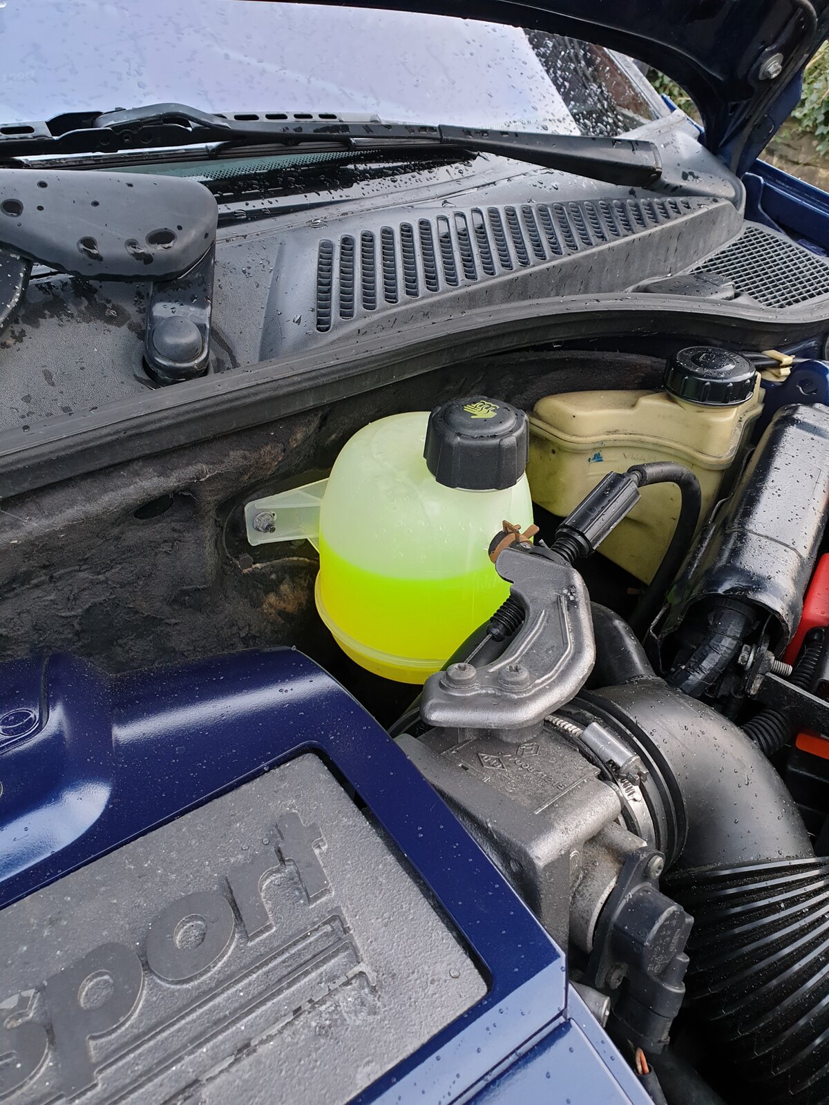

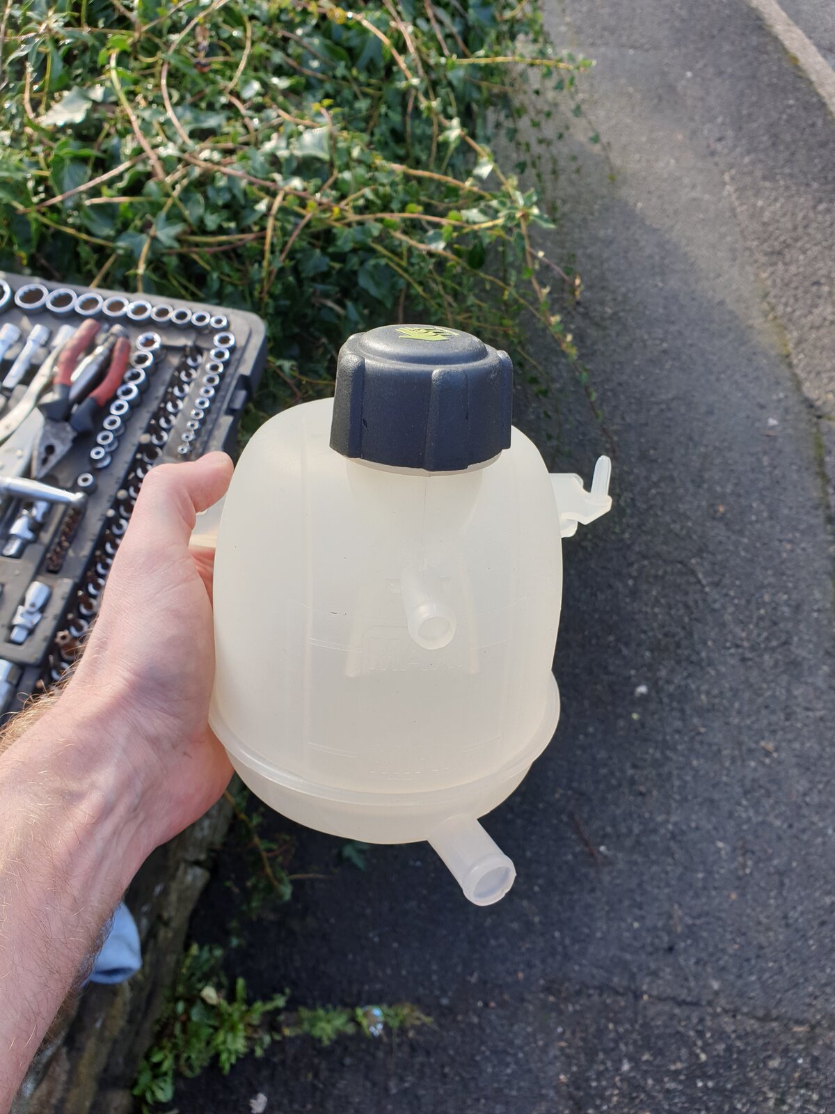

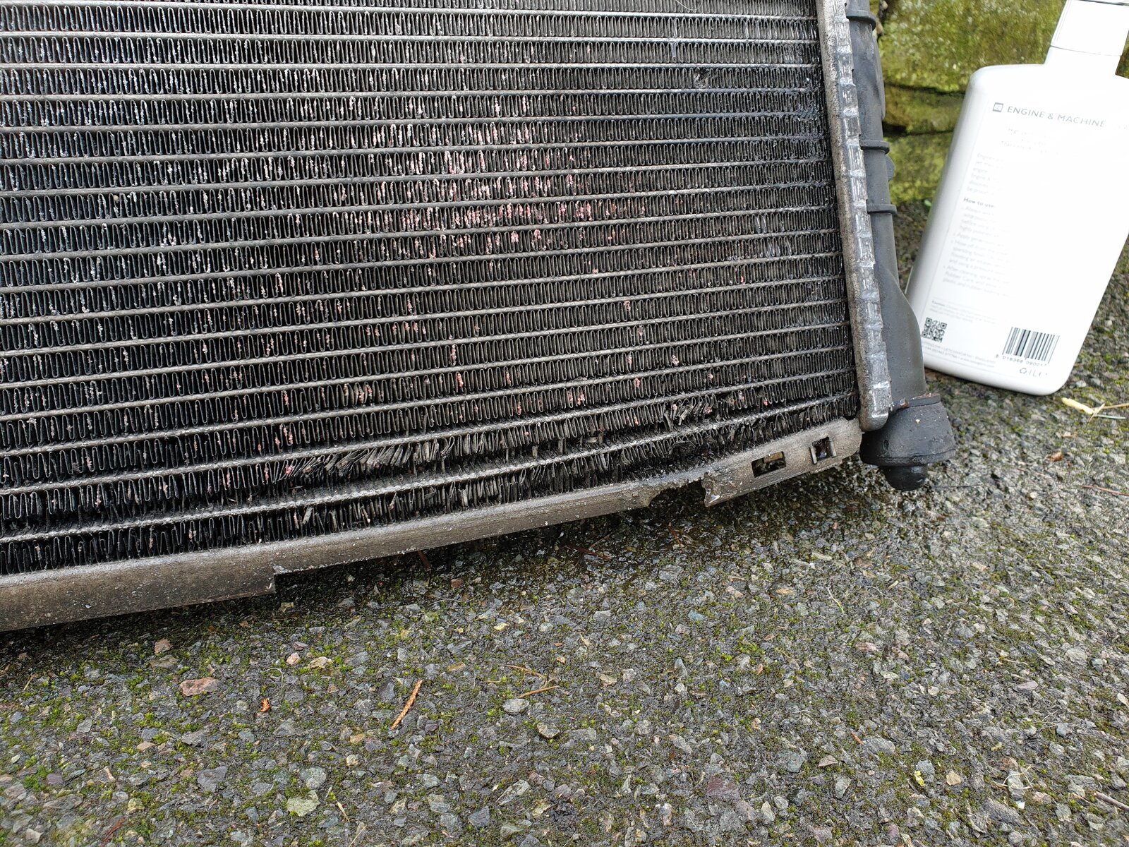

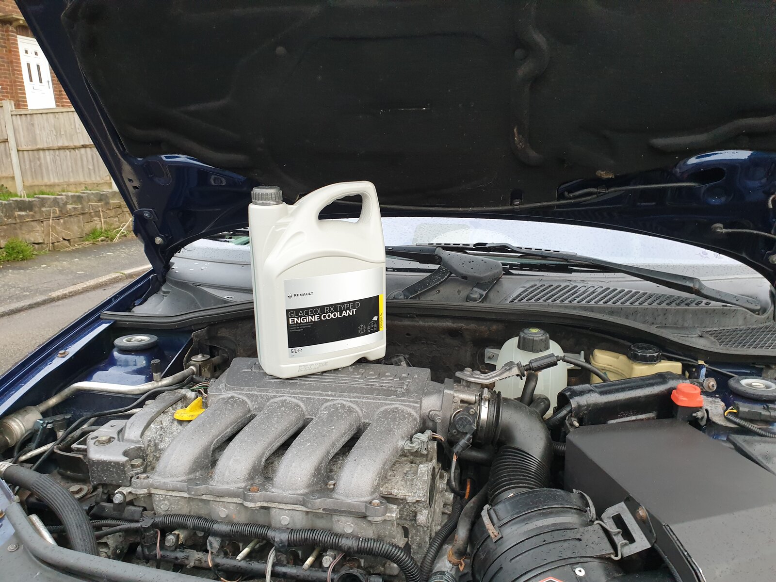

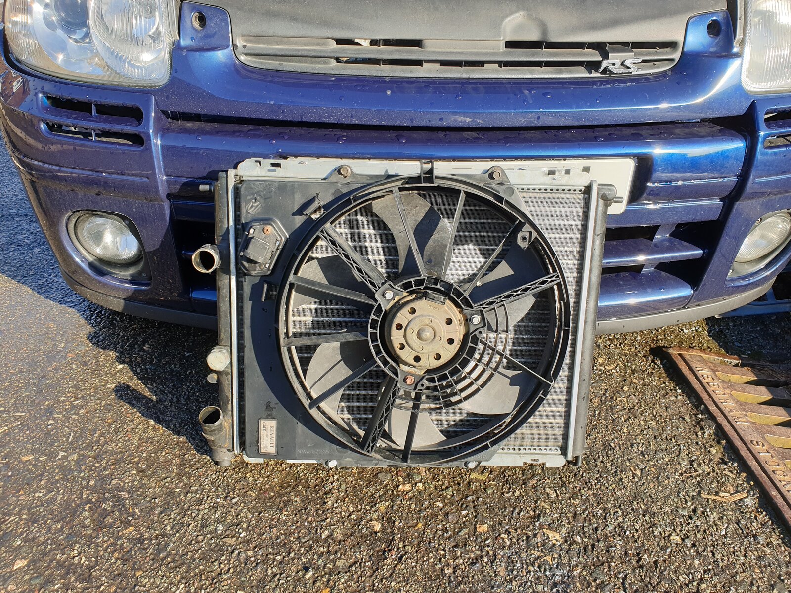

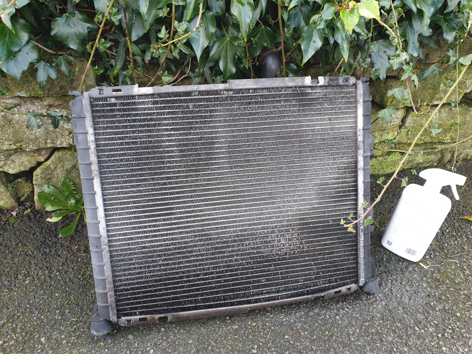

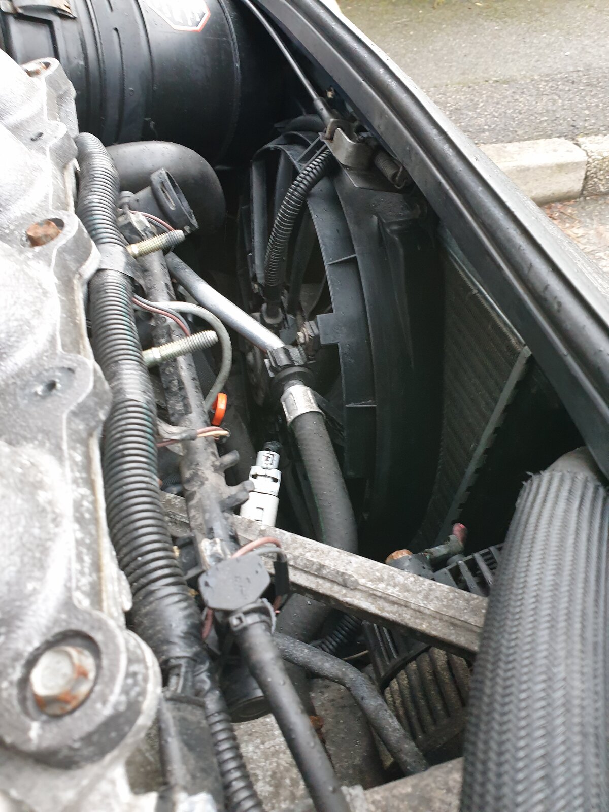

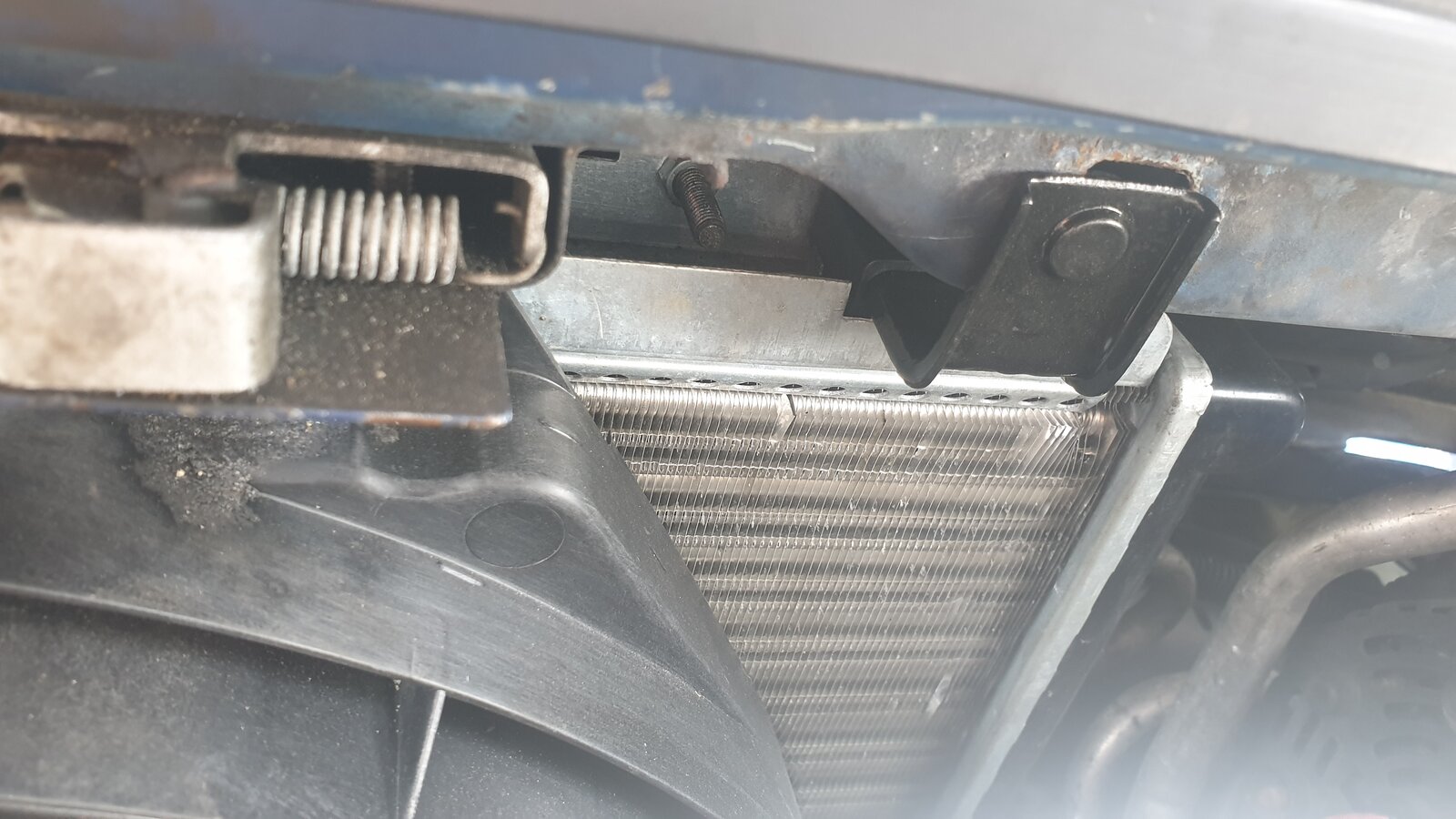

So weather just about held off enough yesterday to work on the cooling system and replace the knackered radiator.
In bits

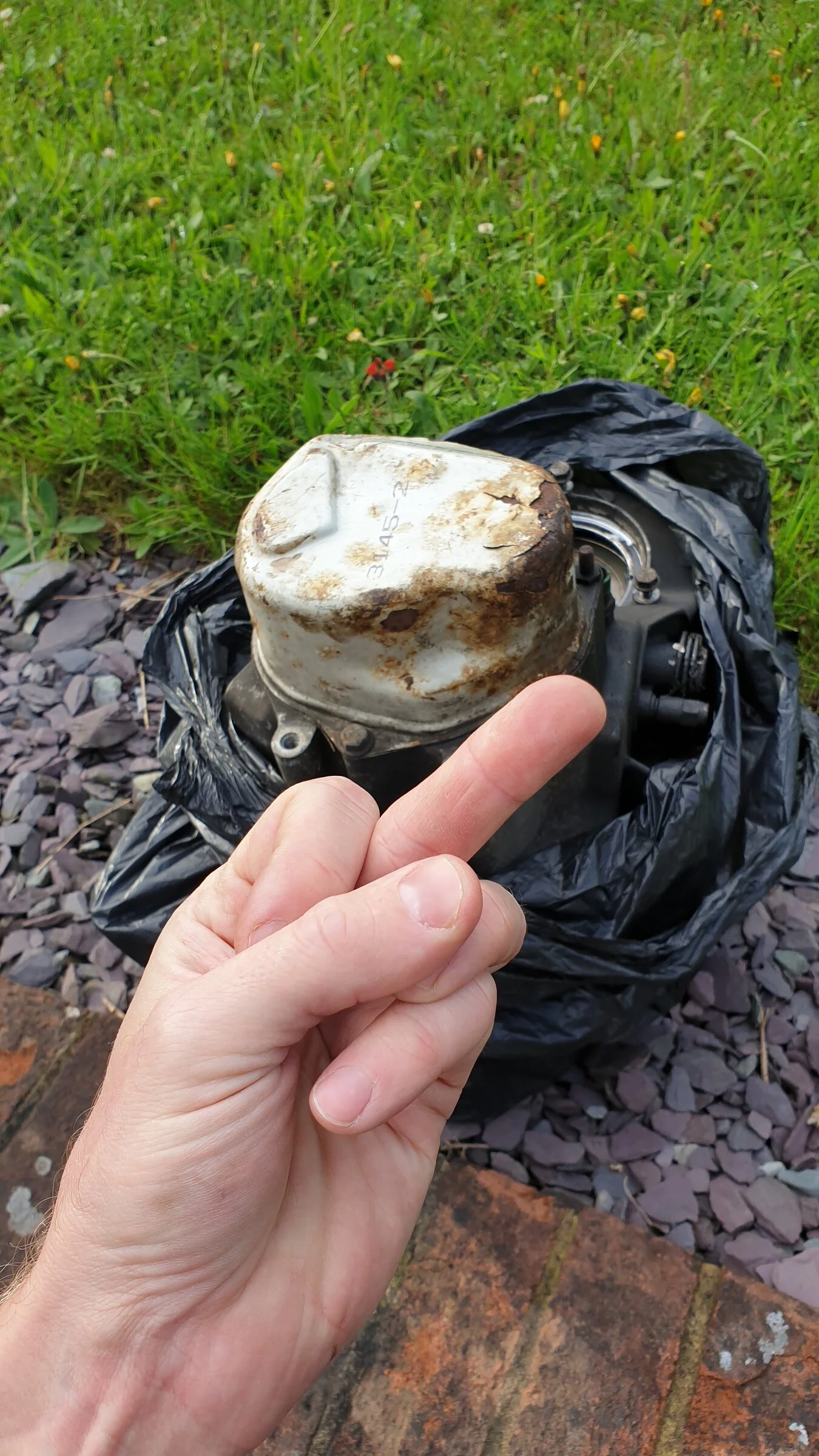

Old radiator out, see the split where it's let go
New radiator with fan assembly mounted and new header tank
Fitted and area cleaned up a bit
New type d
And done
Took her for a spin, topped off the header tank with type d once it had settled. No leaks, no issues, gravy!
Cheers
Ben

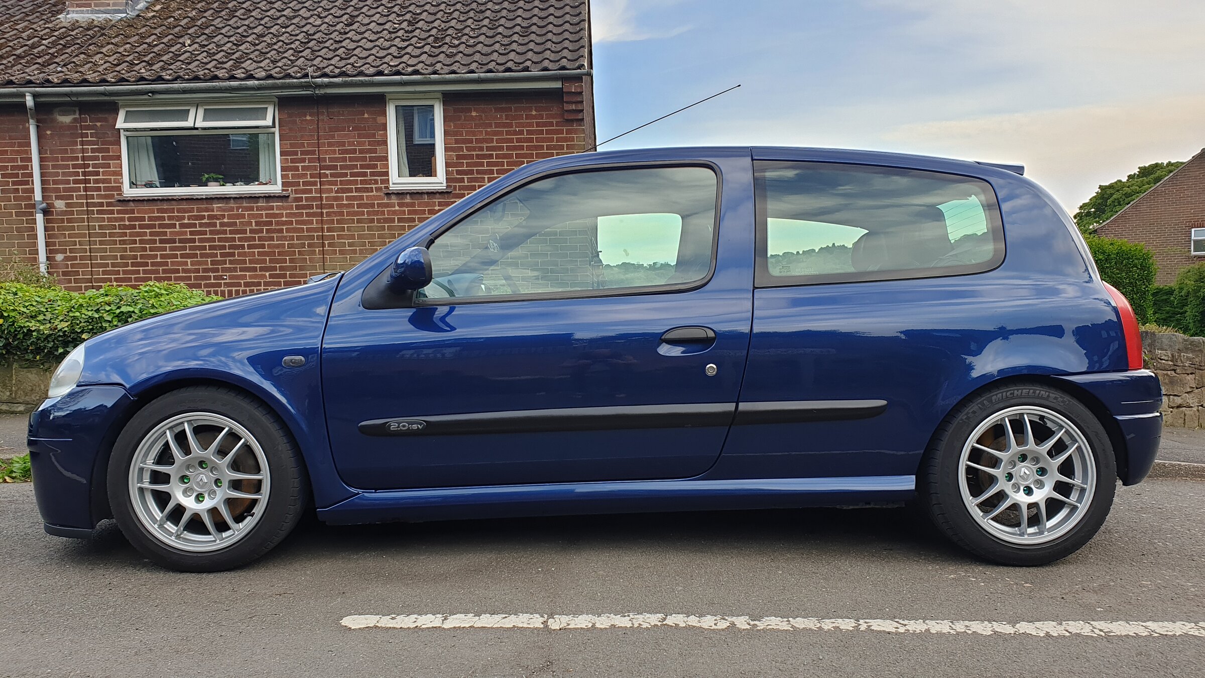

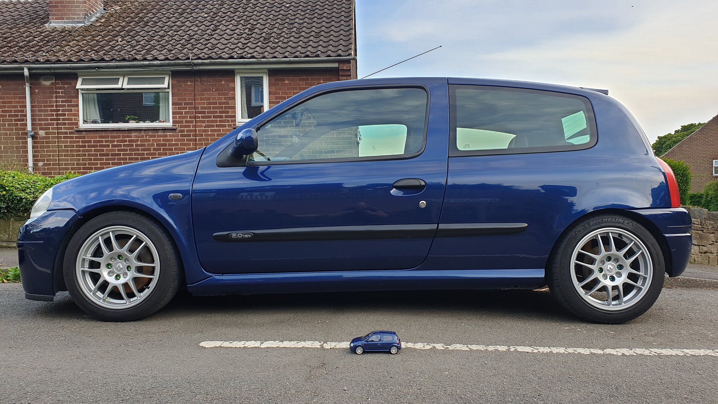

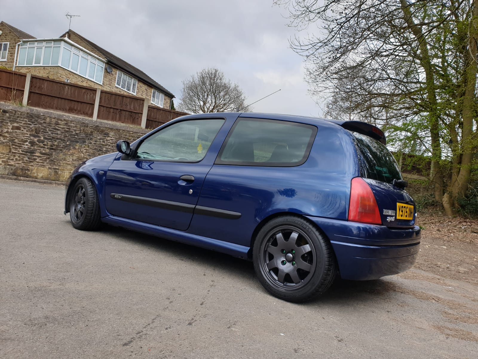

Few more changes, wound the coilovers down another 10mm up front to get her sitting correctly.
Then refitted the minidisc 💽 head unit, with the connects2 so now the column control works which is nice.
Fitted some 182 rear speakers as they were in shed and the original 172 ones were knackered
Also fitted the trendlines and Williams wheels and gave her a bath.
Few pics!

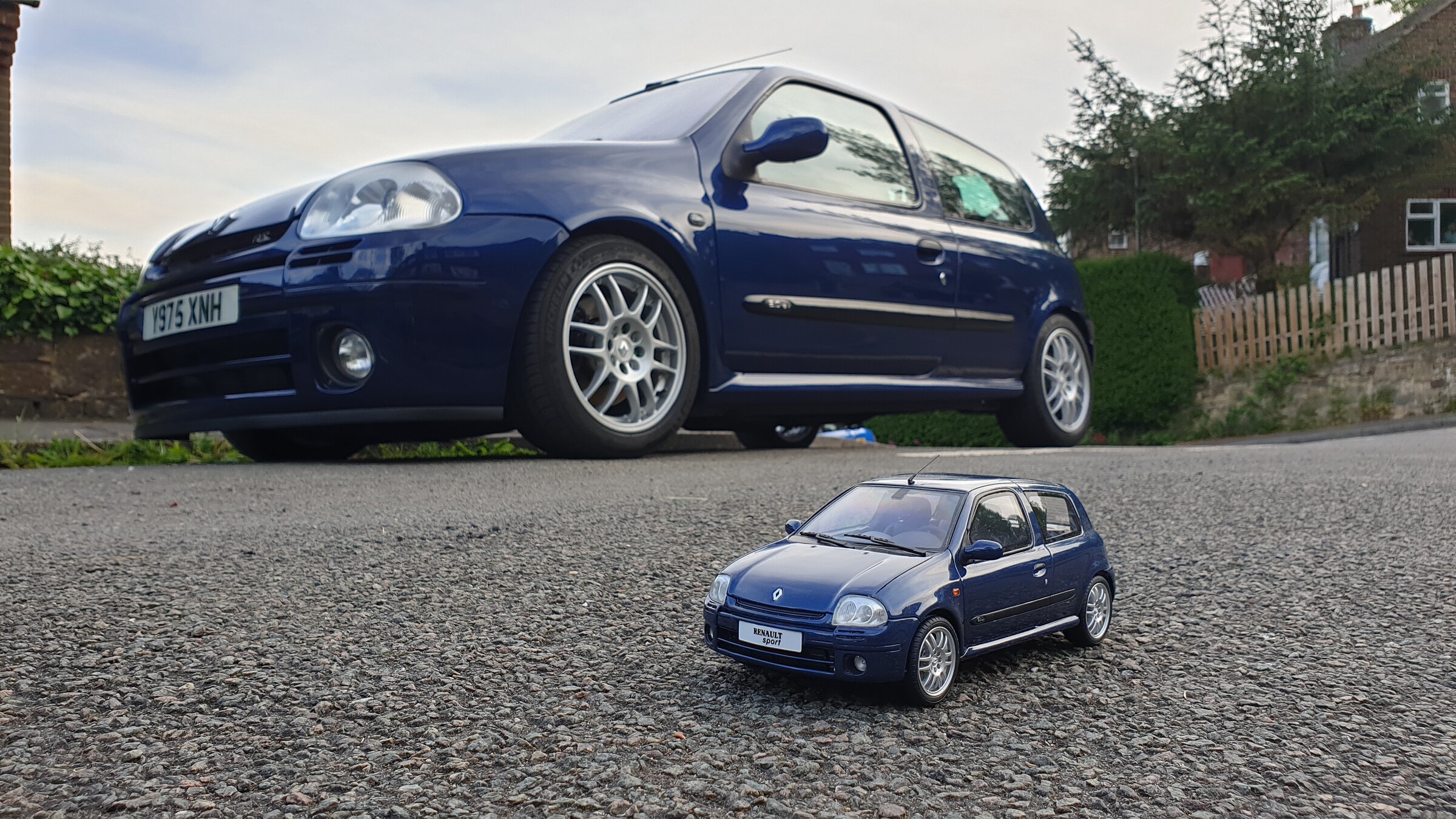

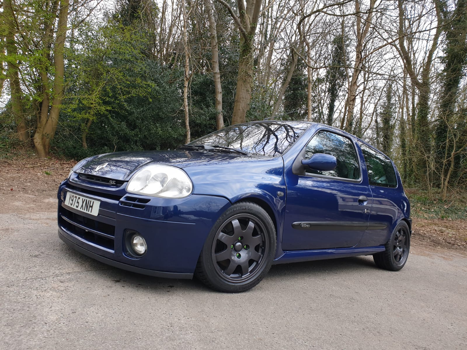

Now I do love a Williams wheel, but this looks 100x better on the OZ f1's...
Think I may get some OZ F1's as my spare/wet set (rather than TD's)
agreed, the silver on blue works so well tbh. I hate F1's for their egginess under the slightest bump.....but they suit the car so so well.
Williams have been reallocated back to GTT now anyway....

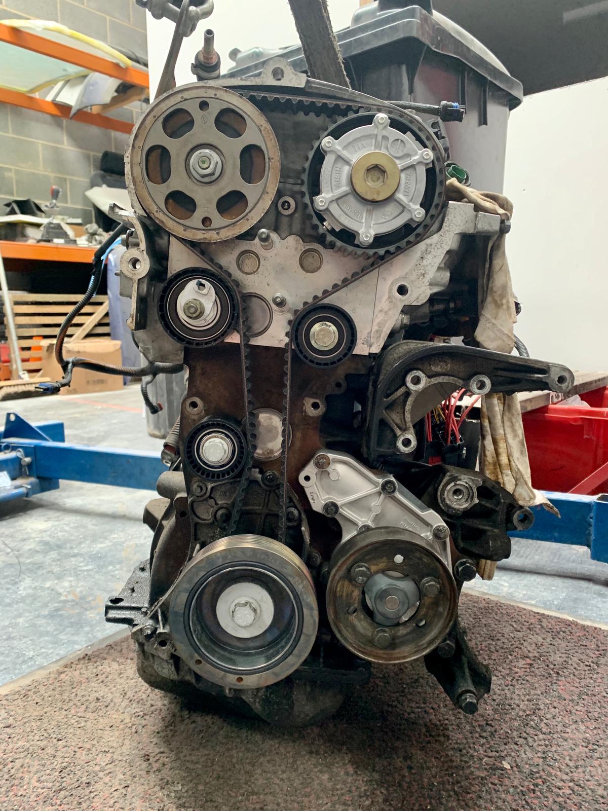

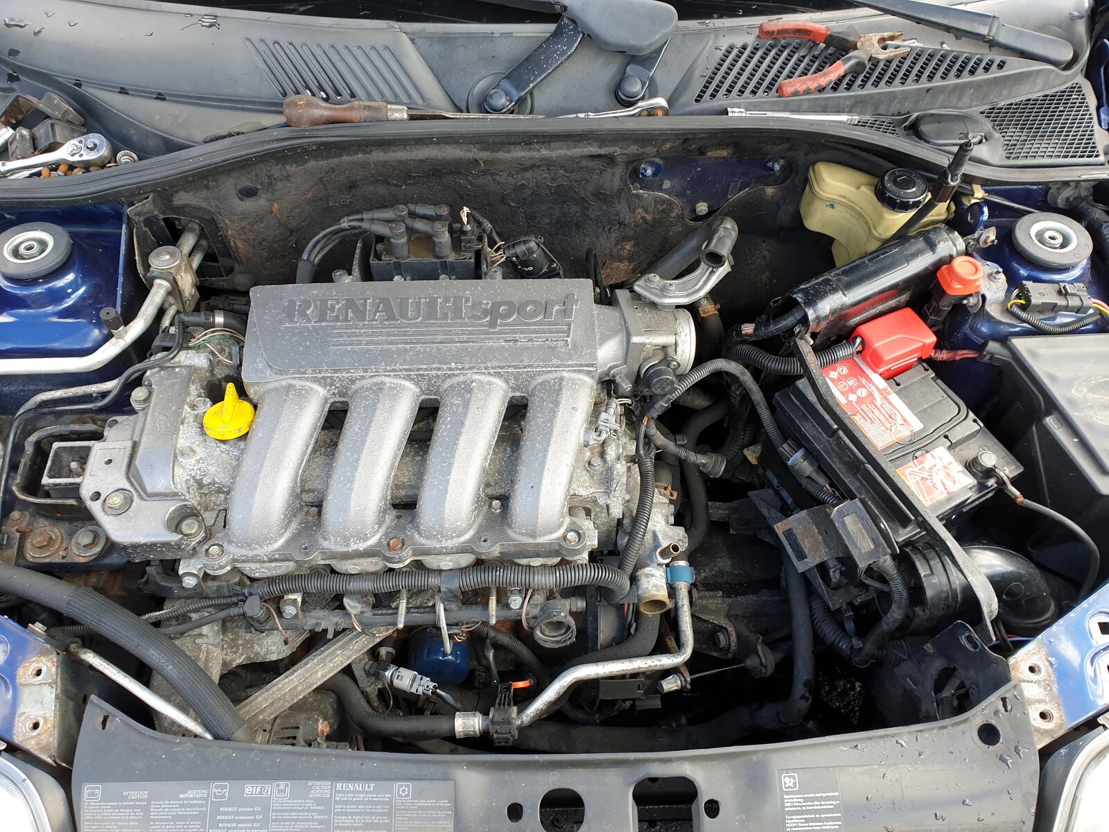

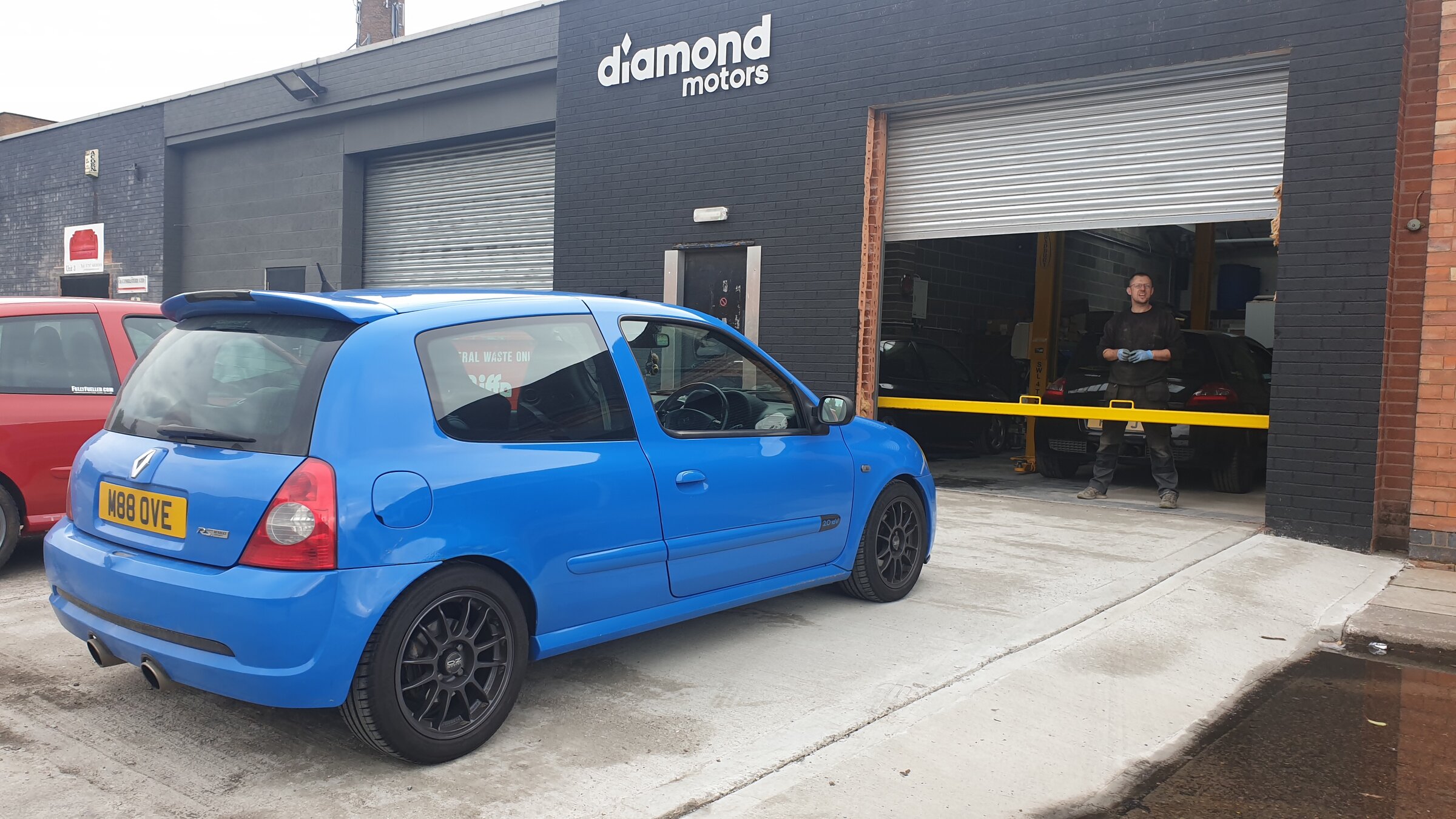

So, belts overdue by a year.... on cambelt so the aux belt was 3 years over.
Bit the bullet and got me awld mukka @MicKPM at Diamond to give the old girl a well overdue refresh. All genuine Renault parts used for the following:
- cambelt kit
- aux belt kit
- dephaser
- harmonic balancer
- water pump
- sump gasket
- crank oil seal
- all fluids and filters
- clutch
- clutch cable
- accelerator cable
- aircon regas

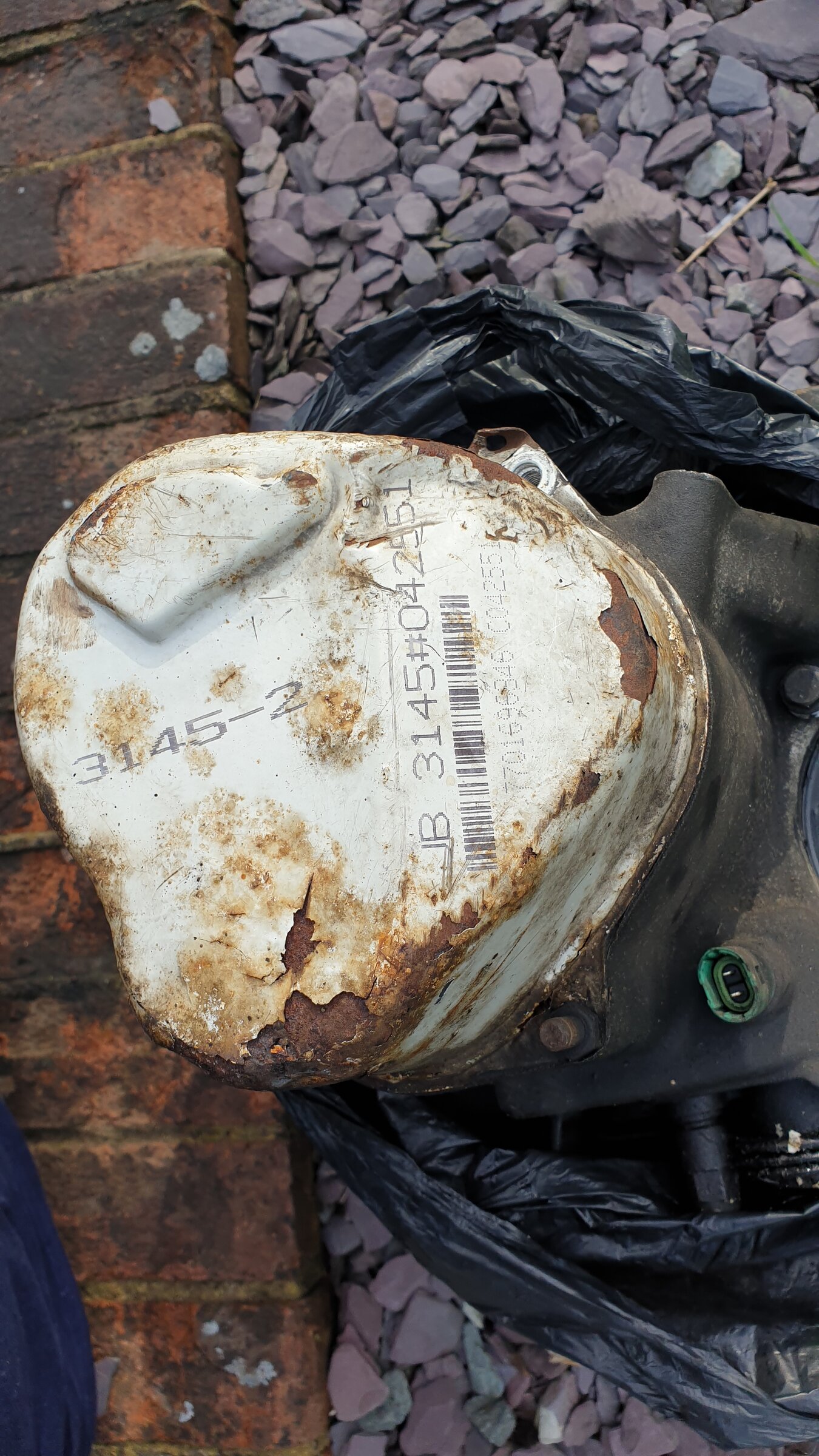

Anything else we find too...... which transpires was a Laguna 1.8 8v gearbox on the car, JB3 145 code which was why my speedo was reading wrong! Lol! So grabbed the spare JC5 089 from the shed which should hopefully do the job.
Car will be picked up next week and hopefully be perfect for the foreseeable
Booked Blyton Park for my birthday too so may use her for that.
Anyway, few pics!

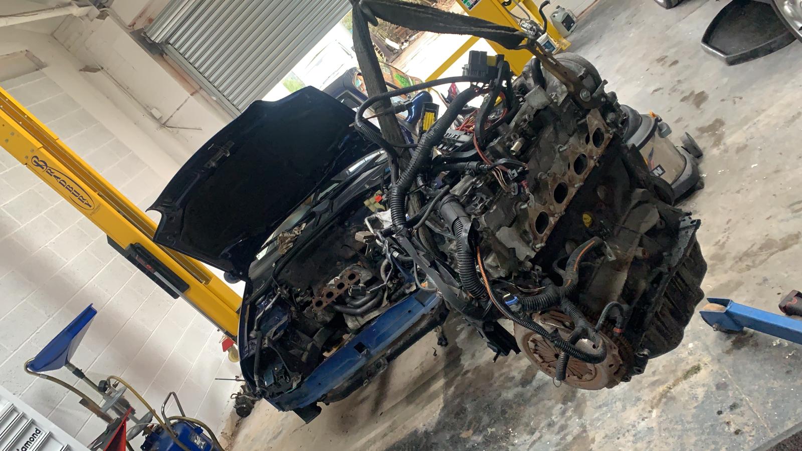

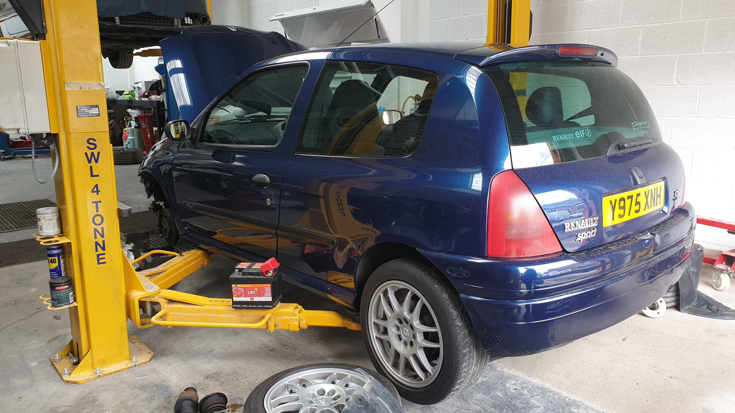

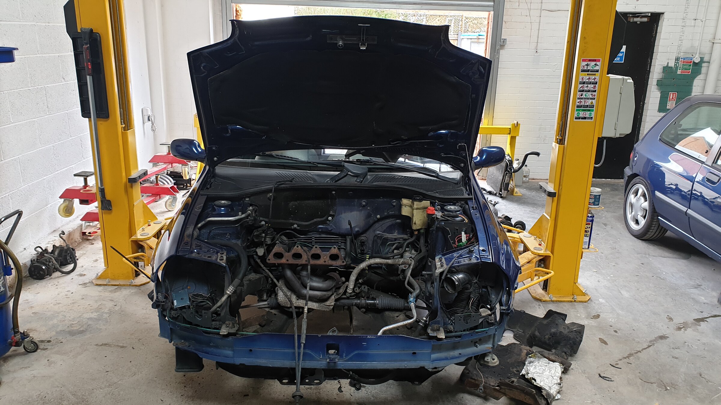

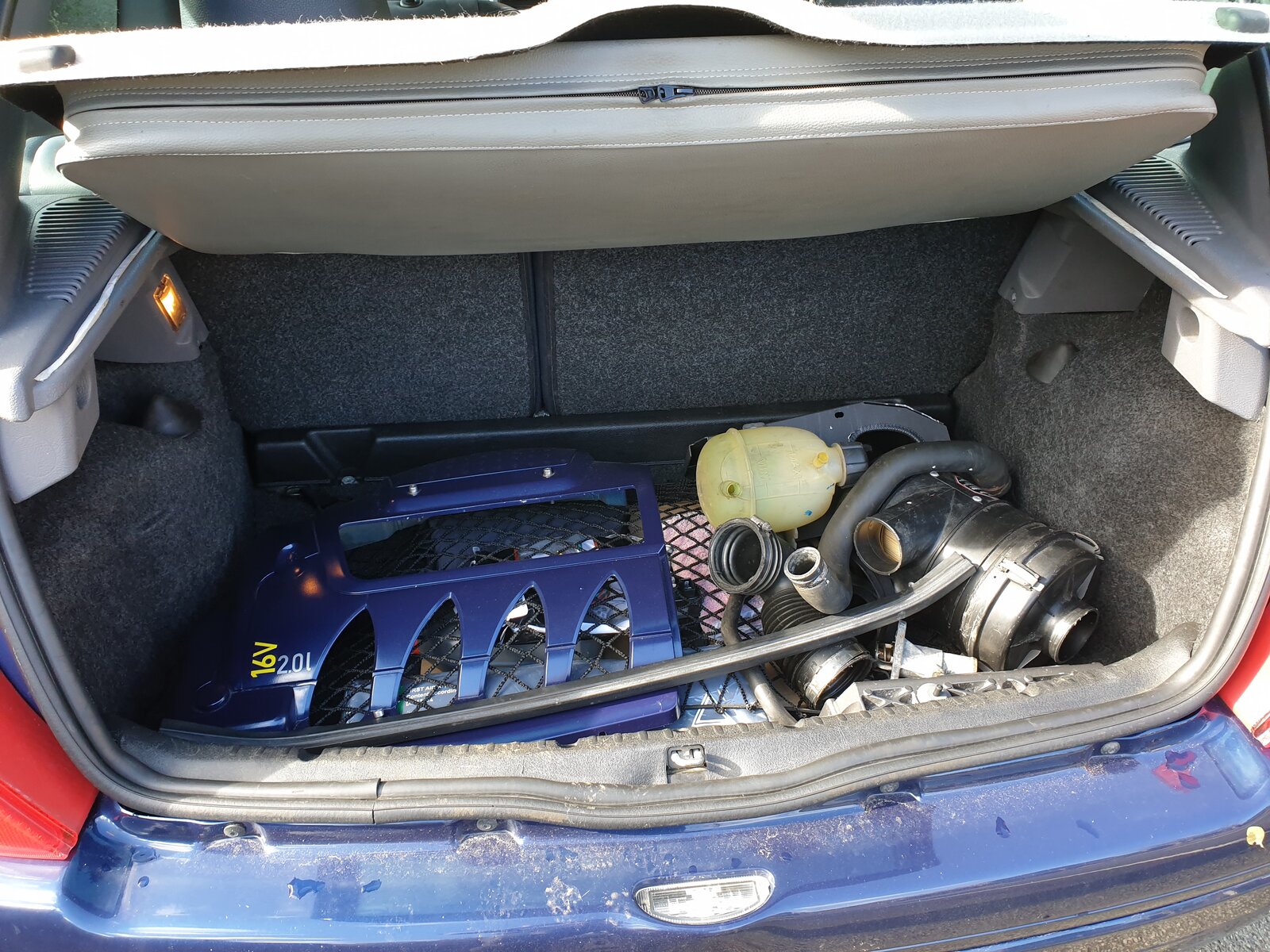

On the ramp
Engine out
Empty
Shiny new parts
Incorrect gearbox, must of leaked too as wet side shaft was siliconed in, lmao
And feelings mutual
Cheers
Ben

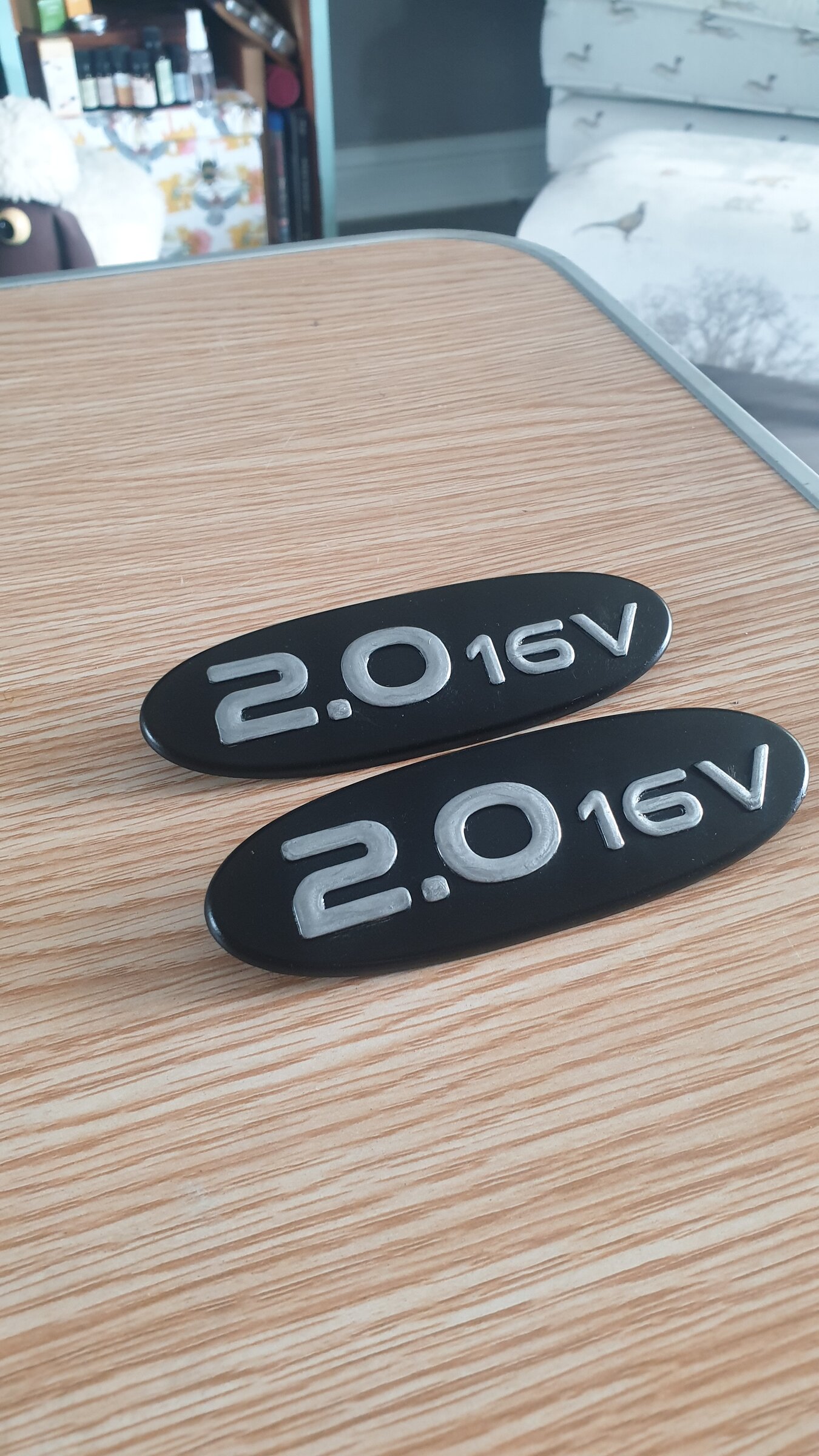

Cars back together and being collected this week. Minor issue on the aircon, stuck new seal kit into it but then the condensor blew so awaiting overnight parts from France on that one, but as Mick's busy it'll have to wait
In meantime tried to refurb some side badges, model paint and not very steady hand and they'll do, not great but better than totally worn out. Just unfortunate that the paint is marbly, so finish isn't great
