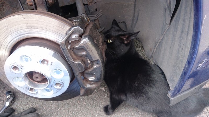

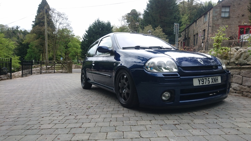

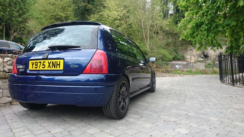

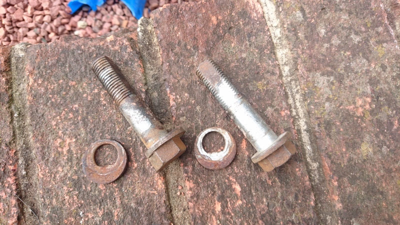

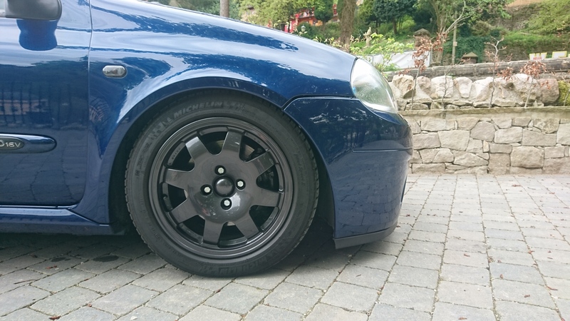

So today, added camber bolts and wound coilovers down another 5mm at the front. She scrubs on anything over like 1/3 lock but meh, looks awesome. Lol!
Bolts
The cat helped.....
....not a lot.......
.....then demanded tickles
And as it sits now
Then had a giggle at the end of the lane with the track car and my 1:18 models and the RB popped along too, lol

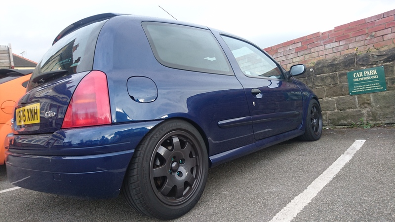

Another week and more tinkering and improvement on the old girl!
First order of business was to raise the ride height at the front slightly, @Dr Jekyll was right, too low! Upped it 1.5cm on coilover platform measurement and can actually drive it now, so much better!

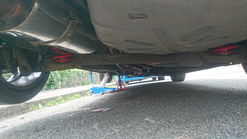

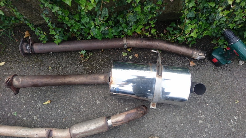

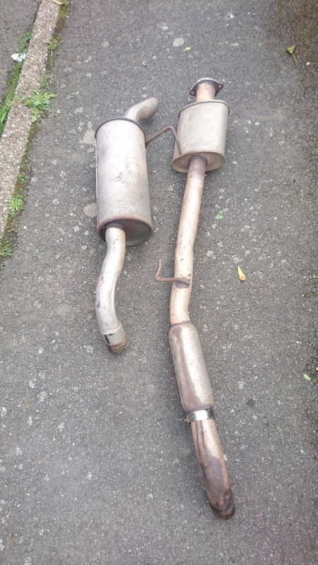

Next was replace exhaust, the standard I bought was boomy as hell and has started to leak a bit from the joints etc so decided to revert to the Ktec, which is equally as loud but at least its stainless yo so mod points for that!
so out with the old
and in with the not actually new

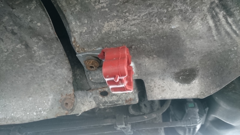

replaced kippered centre exhaust rubber whilst I was there
out with the old
new (with tags, lol!)
fitted

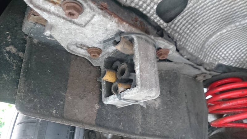

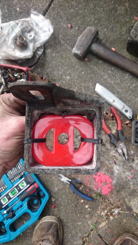

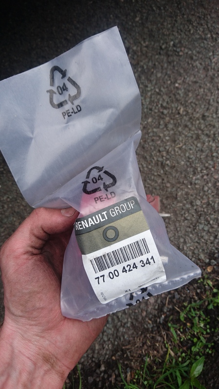

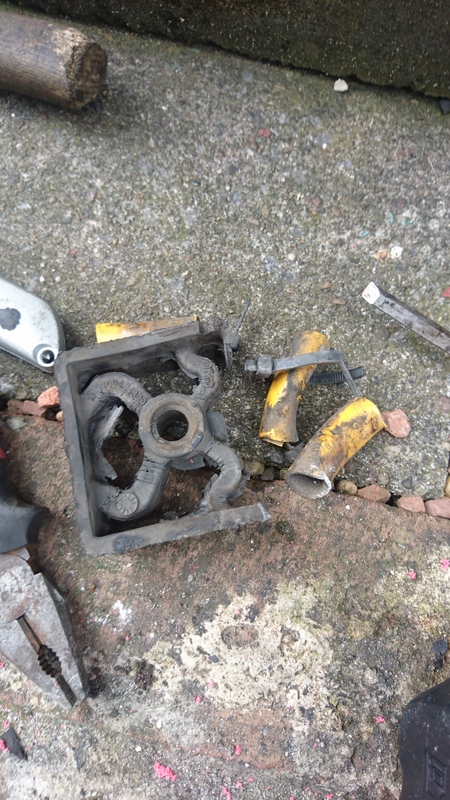

then rear mount was addressed too as it had been bodged, so removed and powerflex generic bush drilled and fitted

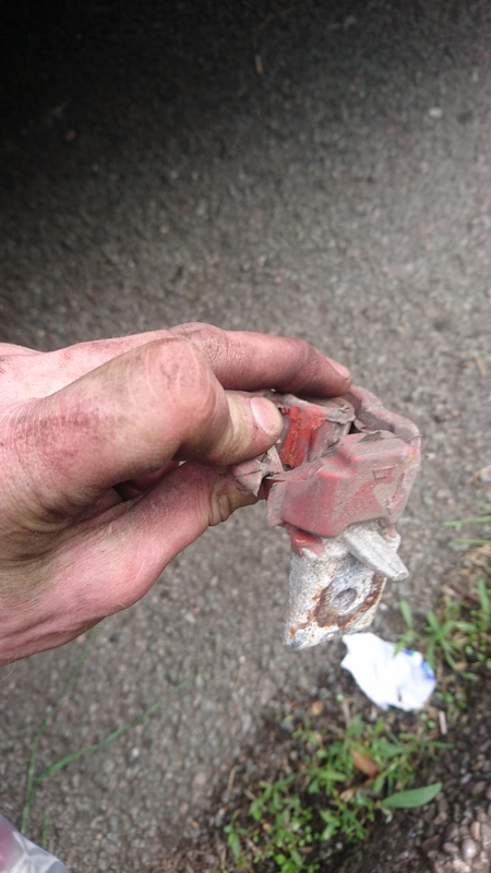

s**t removed
powerflex fitted

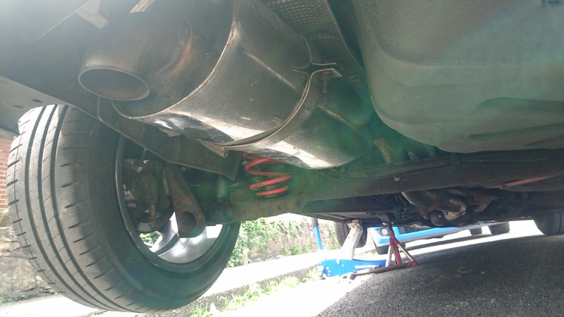

exhaust on

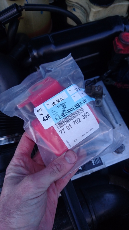

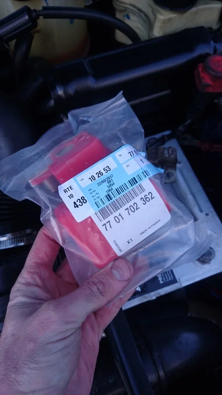

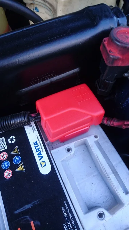

next was fit new positive terminal to battery as the old one's flap (snigger) had broken away

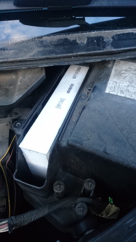

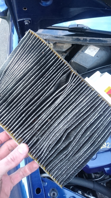

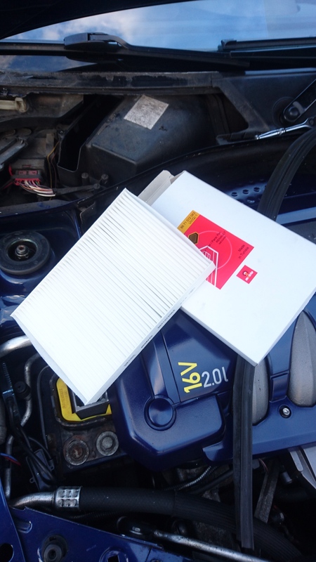

and pollen filter change

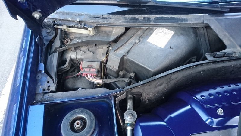

I'd brought spare set from the track car with me though, so quick ten mins swapping ECU UCH, transponder etc and I was sorted but what a PITA
Not totally sorted either as although she's starting on the button, central locking all synced up and working etc I have engine management light on. Not sure why as spare setup is off a late model twin lambda car too, so I need a plugin!
