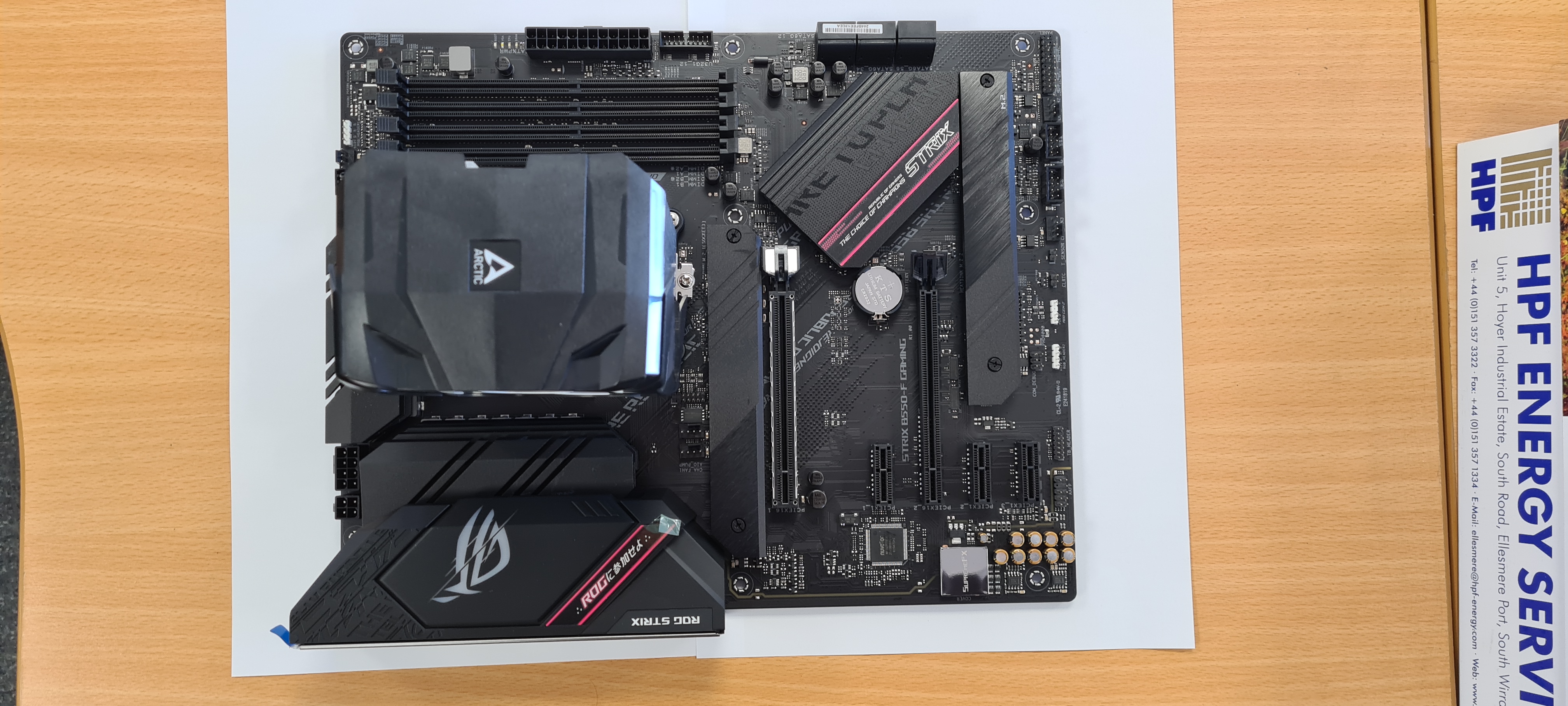

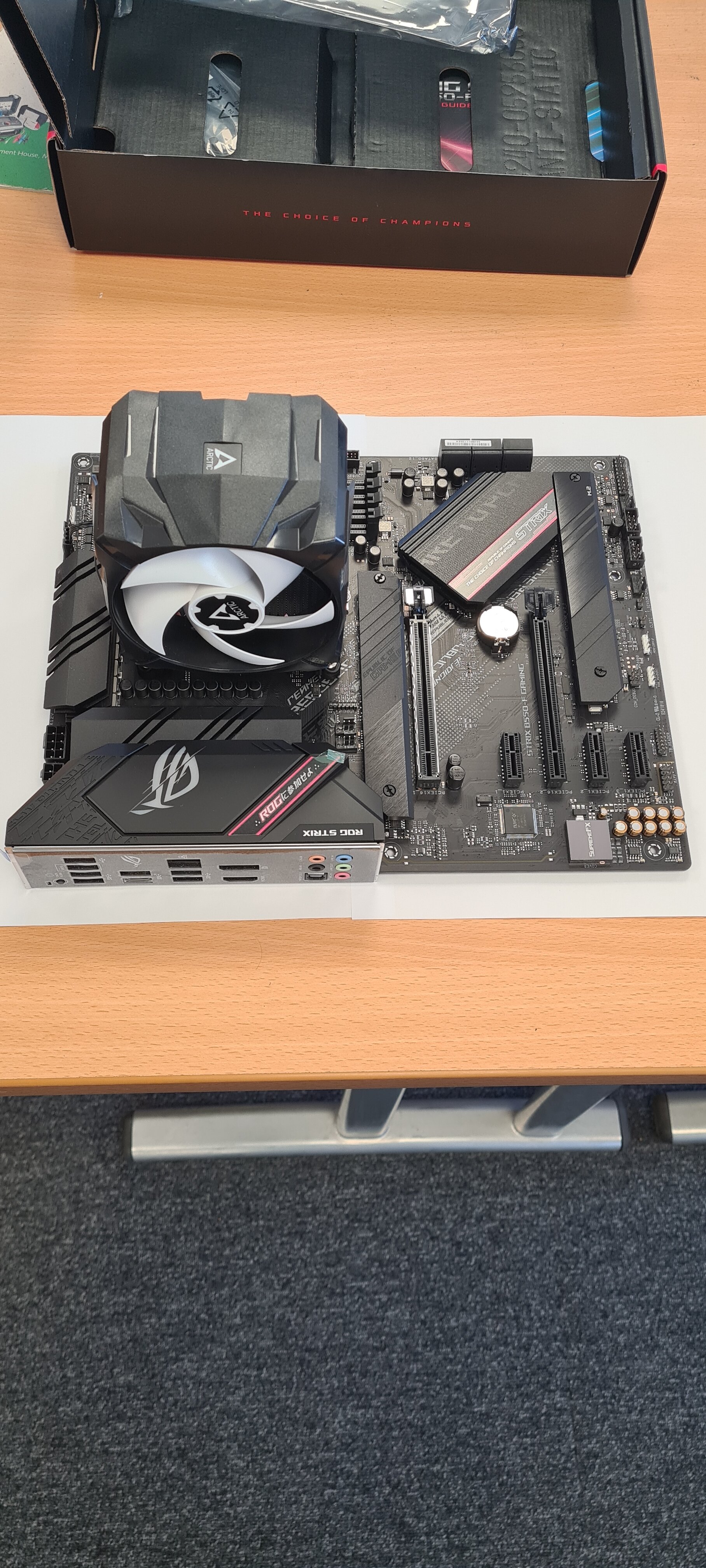

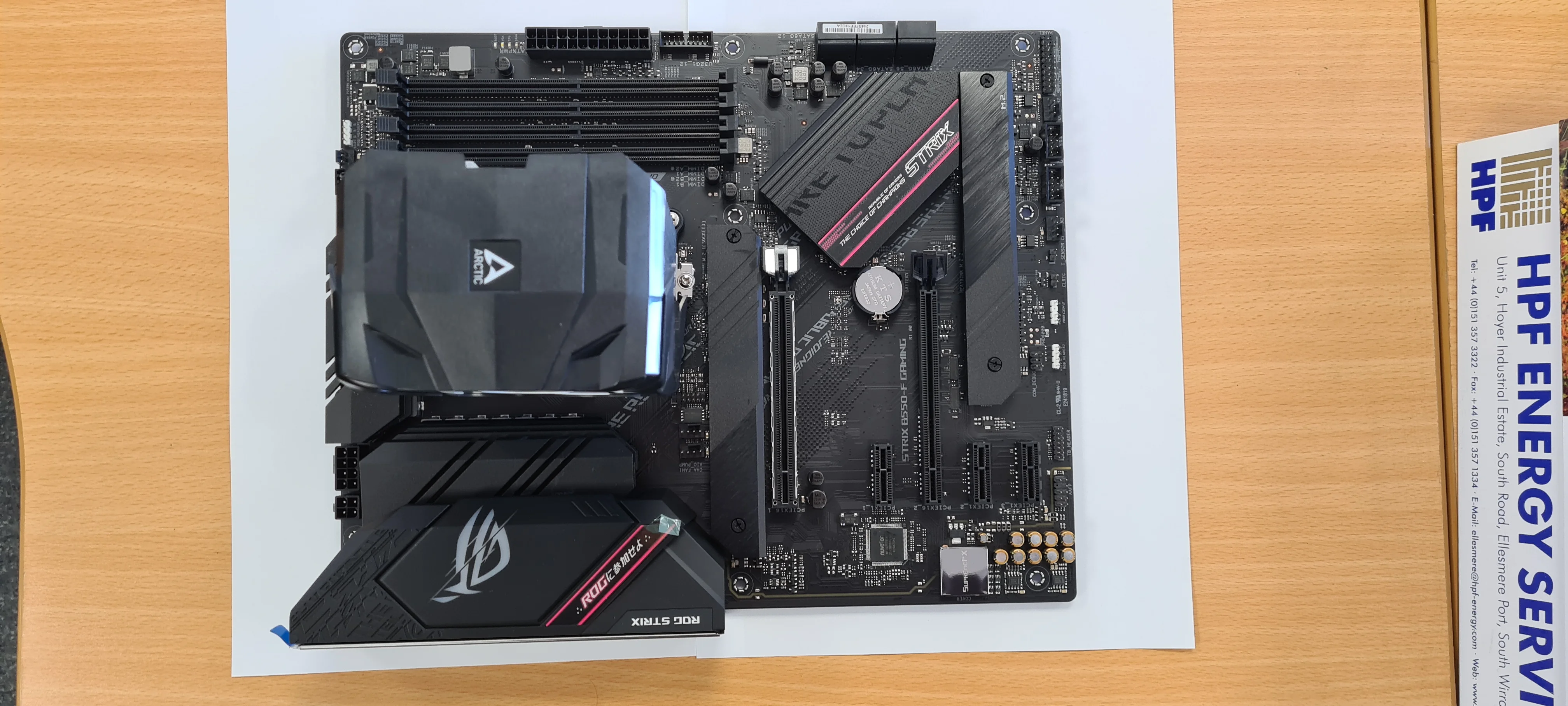

Another couple, i am excited and its not even for me...🤣

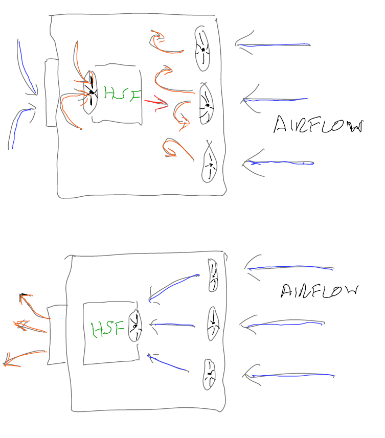

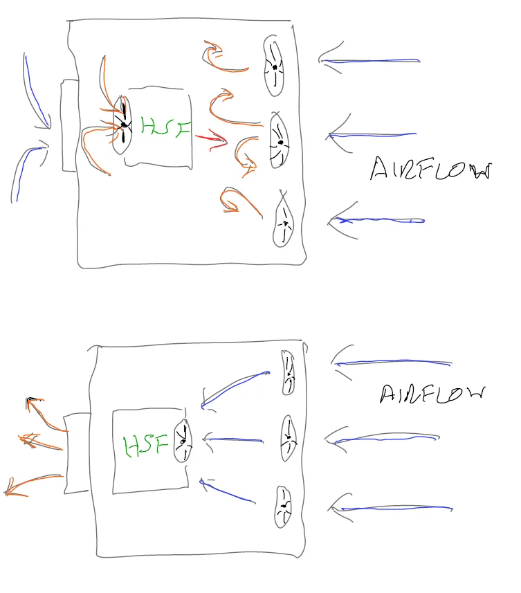

I'd check if that HS&F unit doesn't need to be rotated 180 degrees.
If the airflow fan is an inlet rather than exhaust, then you'll be fighting the incoming cool air from the front of the case (presumably). Apologies for my scribbling, but leaving it as is, looks like you could have the top image. Flipped around, would be much better for airflow, assuming front mounted fans existed.
Plus, 'Arctic' would be the right way around if the HS&F was rotated.

i will have a look, i don't really want to move the cooler round as it will disturb the thermal paste etc won't it? sorry this is all new to me.
It came pre assembled, i would have assumed they would mount the fan to suit airflow?
Willo40
  M135i
It definitely needs turning around.
You might get lucky if the fan and shroud can come off and be attached the other way.
Also, as they've put it on backwards it makes me wonder what the thermal paste application is like.
Just says its been fitted with pre applied mx-2 thermal paste, i have sent them an email to see what's gone on.
As @Daz... says - if it came like that, it's likely to be the wrong way around. It's not going to ruin anything as such, but it's far from optimal if left like it is.
Moving the heat-sink off is a very straight-forward process - but I wouldn't do it without having some decent replacement paste on the sidelines. Removing old paste is easy with with likes of rubbing alcohol and tissue wipe and again as @Daz... says - it does make you think how the original paste was applied if the unit is 180 degrees around?
Usually, you can see a little direction marker on the outer edge of fan units which indicate the way the air blows. Just make you have the motherboard on something slightly compliant with some give and free of static - a sheet of cardboard is usually ideal to work off.
Thermal paste loses its efficiency over the years - ending up brittle and chalky. I've been lazy with mine and only swapped it the other weekend after a good 4 years of my system being built. I'd normally aim for at least half that.

This is why i said do it yourself lol, just unscrew it and turn it around. If you take it off and the paste doesn't cover the cpu and its not a nice even layer then clean it off and put your own on.

Right anti static bracelet and MX-4 thermal paste order, i hope i can just turn the fan round instead of taking it off.... 😂

You might get away with it, if the shroud comes off you might be able to turn it all around, otherwise you will have to take it off.

So they have mailed back admitting it's on the wrong way, and asked if i am confident enough to turn it round myself, it should be a straight forward job, i have ordered thermal paste, do i need to order something to remove pre-applied paste? or if looks ok just turn it round and screw it down again?
From what i have read pre-applied paste is ok if it's been applied properly?
Cheers for the help chaps.
Anything really with a bit of detergent action to it. I've even used glass cleaner in the past - but don't use anything abrasive like cream cleaner (JIF).
As mentioned earlier, we've got a big bottle of rubbing alcohol in the office and use that regularly. The big plus point with that is that it tends to dry quickly in normal atmospheric conditions once the debris of the old paste comes off.
The paste sticks to everything too - so make sure you have more tissue at hand to remove it from your hands! A cotton-bud is a good applicator - so long as it doesn't start to separate and leave strands in amongst the fresh paste.
edit - it goes without saying - clean both the plate surface of the heat sink and also the lid of the CPU too. Don't do just one side.
