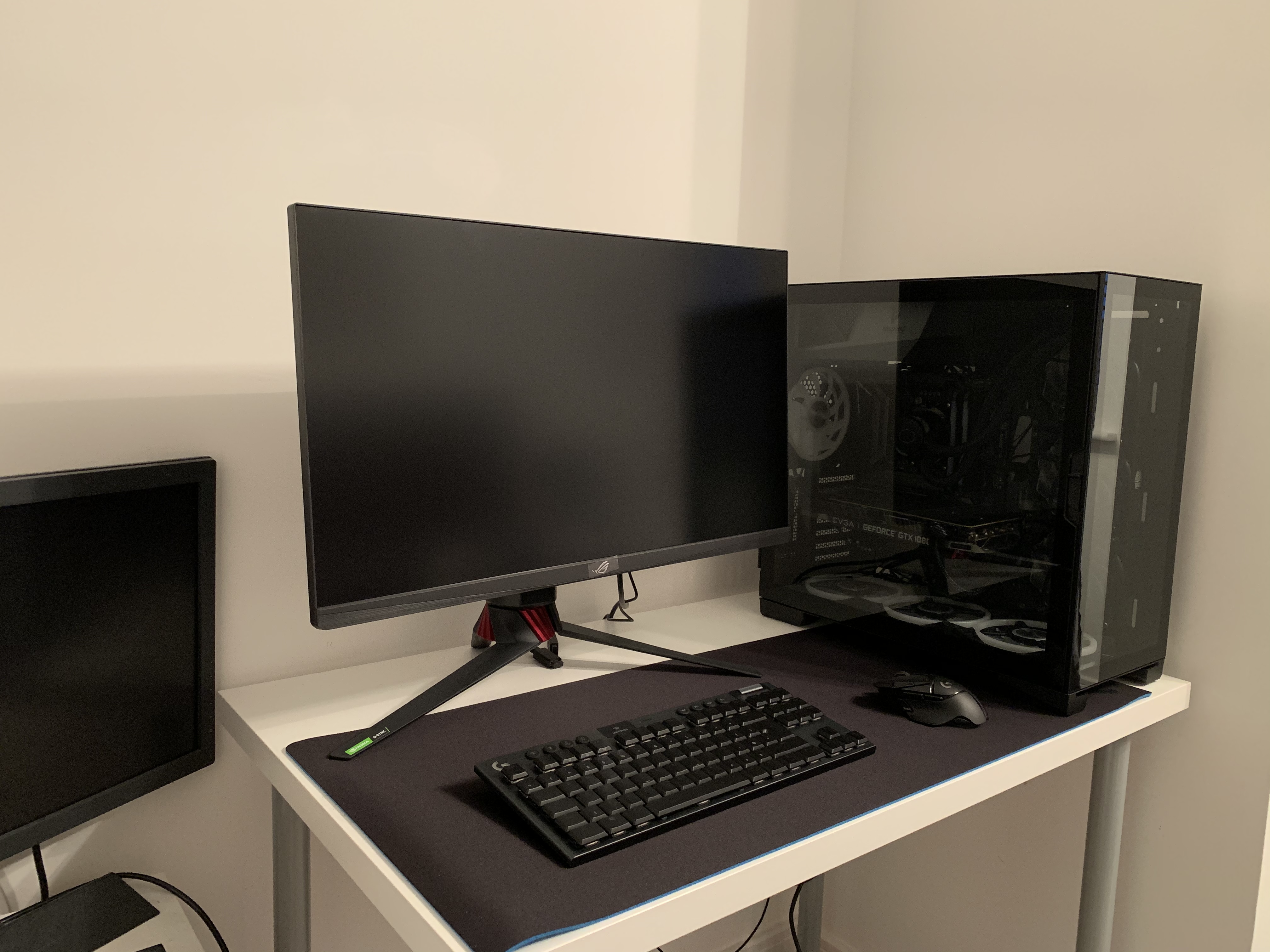

Well done mate, does it work?
Well... so so
Boots up fine but can’t do anything on the monitor using display port cable....have to use hdmi in order to view bios etc. Will this maybe be rectified once everything’s updated?
