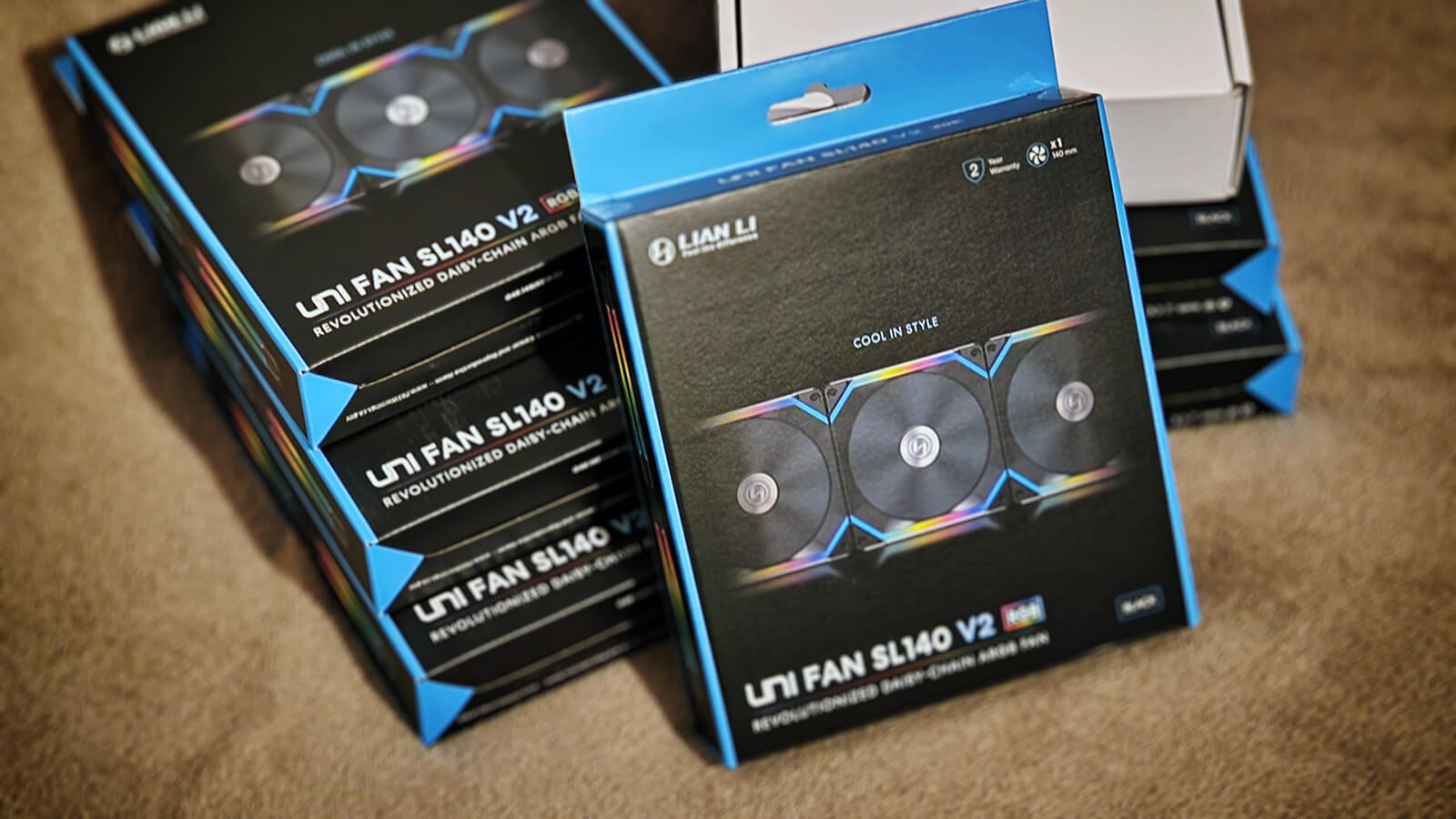

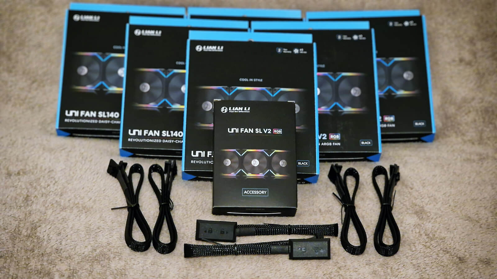

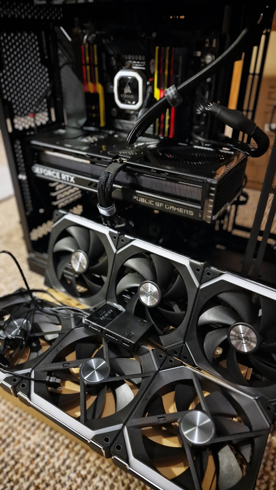

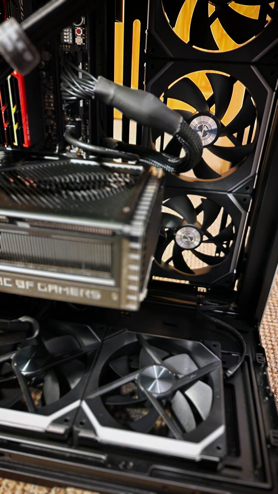

Well, that was a freakin' nightmare... I had to unbuild a fair bit of my PC setup to get to fan headers in order to remove the old fans, installed the new setup, and found my system was completely dead. :(
I thought I might have accidentally knocked (or inadvertently loosened) some connectors so went through each cable/connector and checked them. Reseated the RAM. Reseated the GPU. All the usual stuff. Nope, still nothing. I then started to worry a little as I suspected the motherboard was dead. Turns out, it's the brand new PSU I've just bought. It has a fault and it is being returned, the replacement sent out to me shortly. Thankfully, I've got a couple of backup PSUs that can power the system... but I had to change the cables! I also could not be bothered going through the process of cable management so they are jumbled (but functional) until the replacement PSU arrives.
The fans themselves are very good quality - feeling solid and with a nice weight to them. The daisy-chaining is cool and really helps keep cable clutter to a minimum. I did have an additional hour of faffing as one of the cables was about 15mm too short for my particular setup hence I had to move the hub controller and a few other cables around (again).
The only other issue I had was not having a spare internal USB 9-pin header on my motherboard for one of the hub connectors as the single 9-pin header I do have is being used by the CPU cooler/radiator/fan. I disconnected that CPU cooler, found a spare micro-USB cable, routed it outside to an external USB connector - and thus freed up the internal header for the fan controller! :ROFLMAO:
Please help me - I don't want to turn into one of those people... 🫣

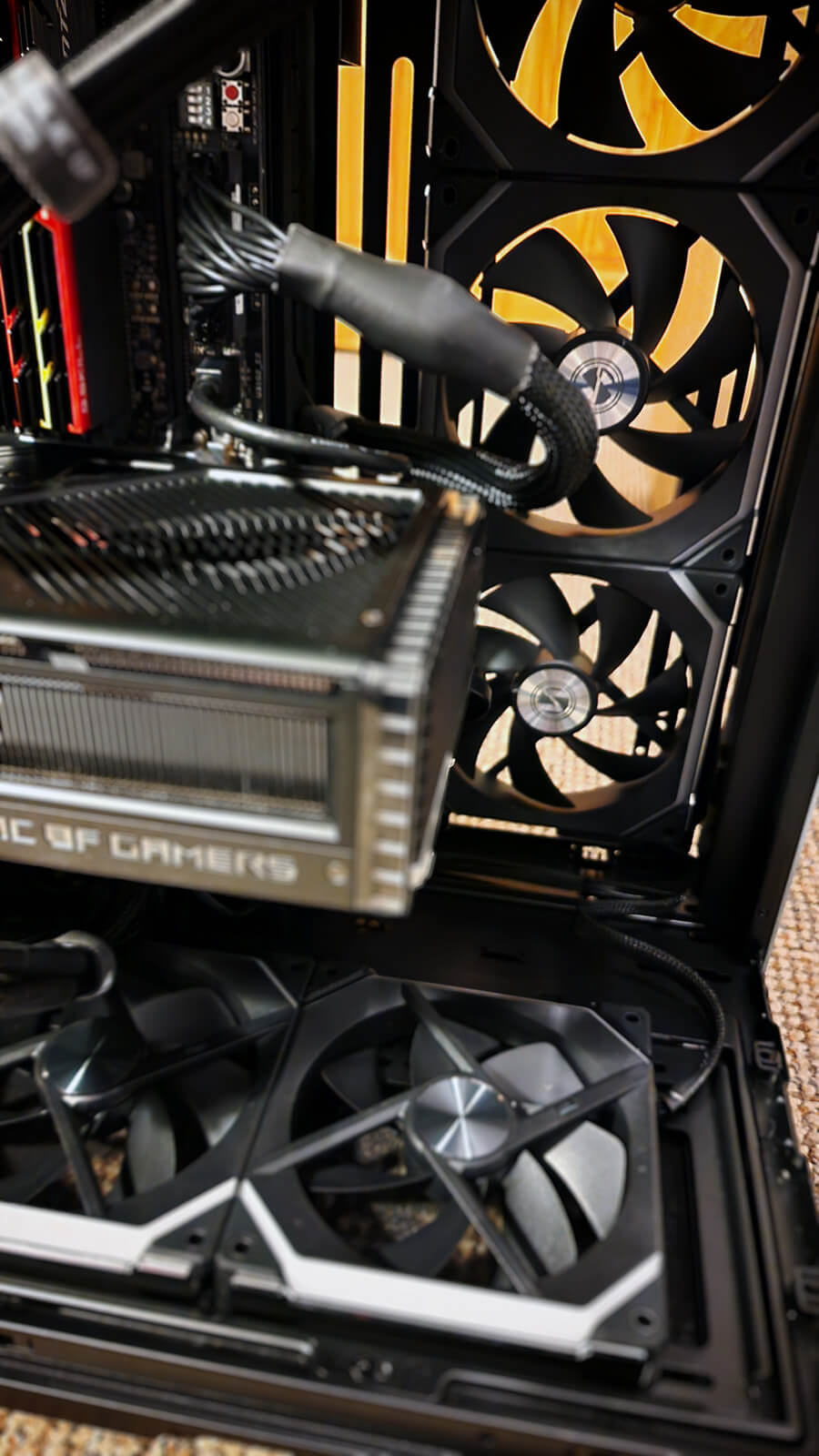

See my post about the Thermalright fans above ^^
Too late, I went for the Lian Li items! :ROFLMAO: Thanks for the info though mate - might come in useful for someone else or for the future. Cheers! (y)
If you want the same airflow but a bit less noise than the Lian Li in the futures then they're the ones.
10CFM more than the Noctua but a bit louder.
However it took a good few weeks to get them.
Not sure why they're not for sale in the UK when they're possibly the best fan around!

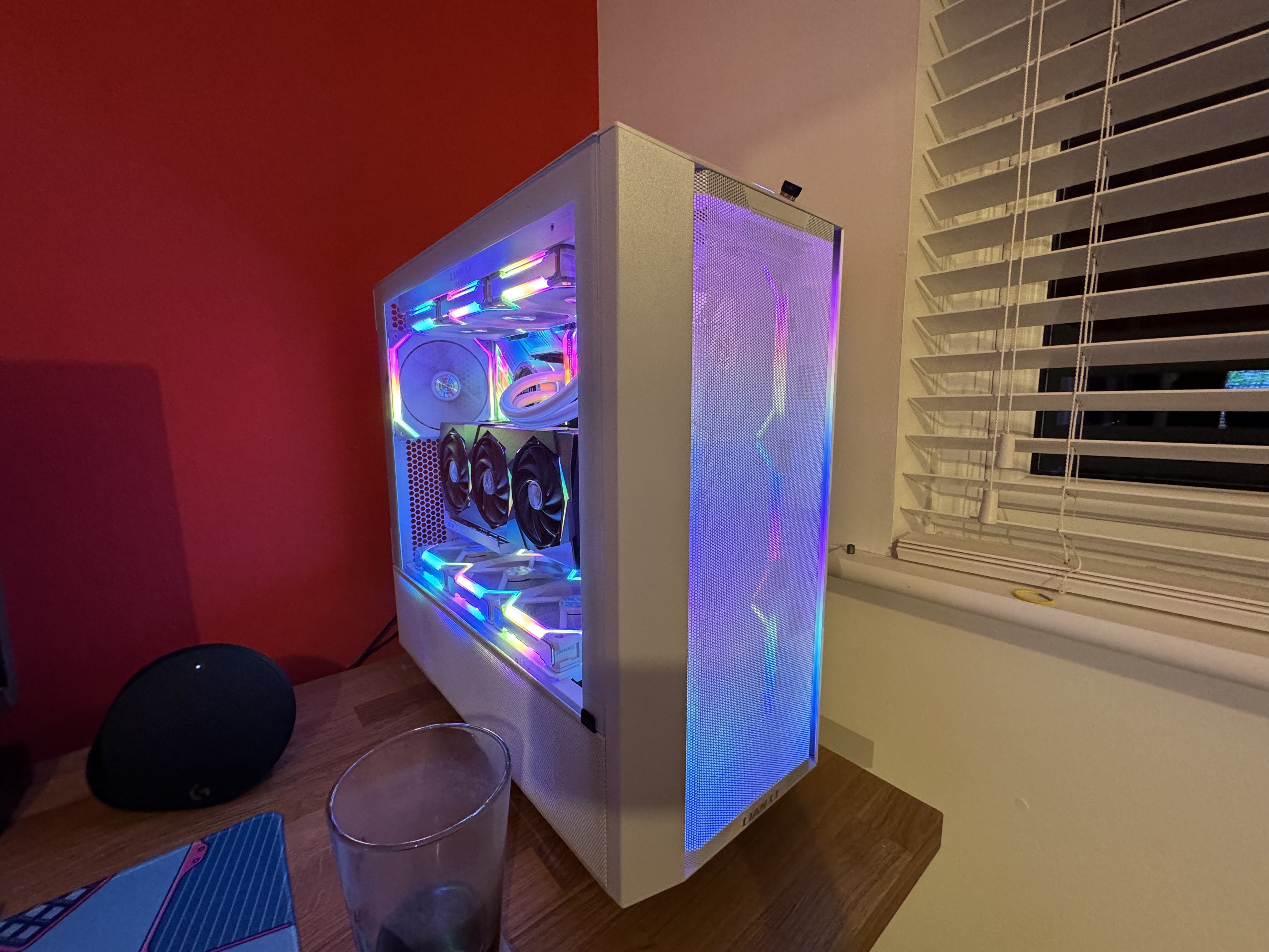

Very cool. I’ve been running the white versions since late last year. I went for the unicorn vommit look though:

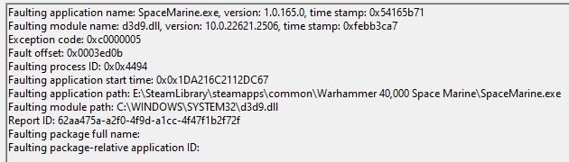

Any gurus or wizards who can help me before I throw this f**king PC out of a window?
Everything was working perfectly until about 10 days ago when I started getting weird crashes after a Windows update.
I go to launch a game, and it thinks about it for a second, then as soon as the icon appears on the taskbar/game appears in task manager it immediately crashes.
So far it only seems to affect games that are opened via a launcher like Steam or Epic, but even happens when I go to the .exe and try to open from there.
It's not game specific either, as I can run a game fine through Steam but it immediately crashes if I try to launch it through Epic, obviously there are only a small number of games that I happen to own on both (thank you free games on Epic!)
The crash log shows the same error every time, the only thing that changes is the name of the app that crashes.
I've tried updating my GPU drivers thinking they might have been corrupted by the windows update but nothing changed. I've tried using the sfc/scannow thing in command prompt, along with some other ones like dism checkhealth scanhealth and restorehealth. All of them did nothing.
Can I just manually delete the d3d9.dll and let windows sort it out itself? Or is there something else I can try?

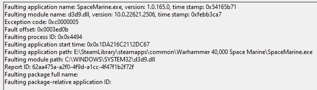

The crash log shows the same error every time, the only thing that changes is the name of the app that crashes.View attachment 1670636
Rivatuner f**king Statistics Server, you absolute cuntrag of a program 🤬
False alarm lads, I was about to install Linux and start shaving my legs but it's sorted now and I can play games again
I’ve had to install an older version in the past to stop it from messing with things.
I can't even remember what it does tbh, I know I installed it alongside Afterburner but apart from that I'm drawing a blank. Stumbled across a Reddit post from 7 years ago where someone mentioned a similar issue after about 2 hours of messing around 🤣

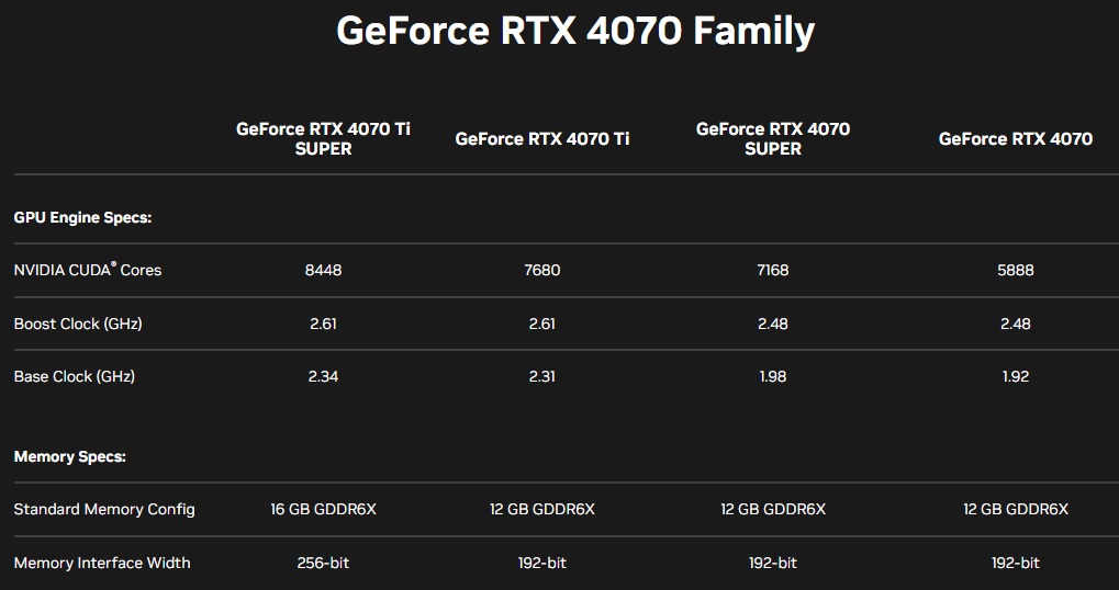

NVidia have refreshed their mid-range offerings and released details at CES.
The 4070 range is getting some love. The current 4070Ti has received some criticism. At circa £750 It seems to exist more to bridge the price gap between 4070 and 4080 (£500 and £1000), and not bridge the performance gap. Much of the criticism is that you're paying 50% more for the 4070Ti and only getting a modest increase in performance.
To sort this NVidia are launching the 4070 Super and 4070Ti Super.
The 4070 Super gets 20% more CUDA cores, putting it very close to the current 4070Ti, it will also get a small bump in clock rate.
The 4070TI Super gets more CUDA cores, higher clock rate and notably more VRAM with a wider memory bus.
A 4080 Super is also announced, with 5% more CUDA cores and a slightly higher boost clock.
