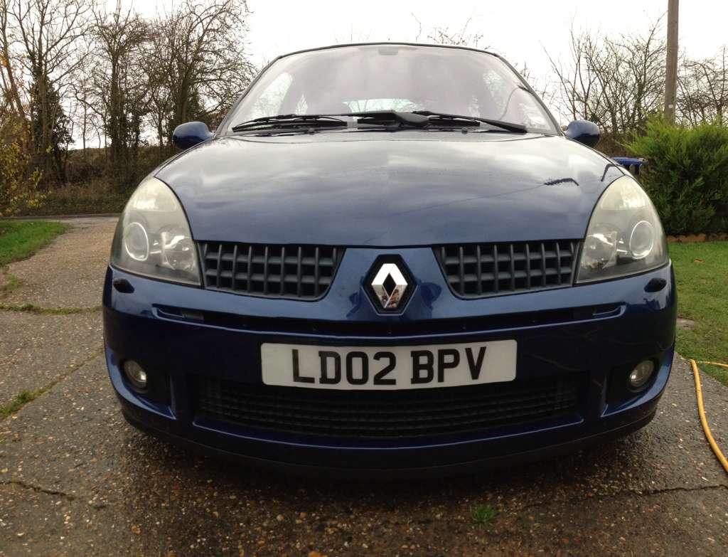

Well it seems once again I can't go 6 weeks without a 172 in my life! With a big chunk of savings laying in the bank I had to buy one.
The plan is to share with the Missus and she will sell her car, so unfortunately I couldn't get an "ugly" Ph1.
Found this in Clacton on eBay with FSH, every MOT and every Tax disc and only on 49k! Went to have a look and its in outstanding condition for a 10 nearly 11 year old car.

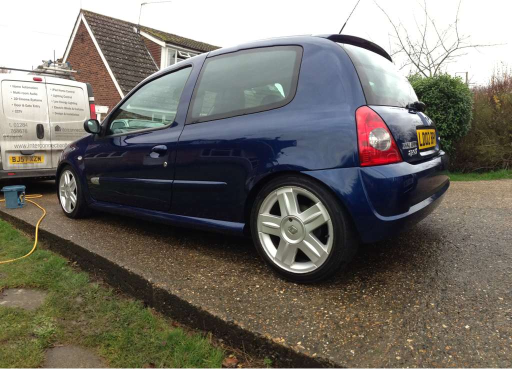

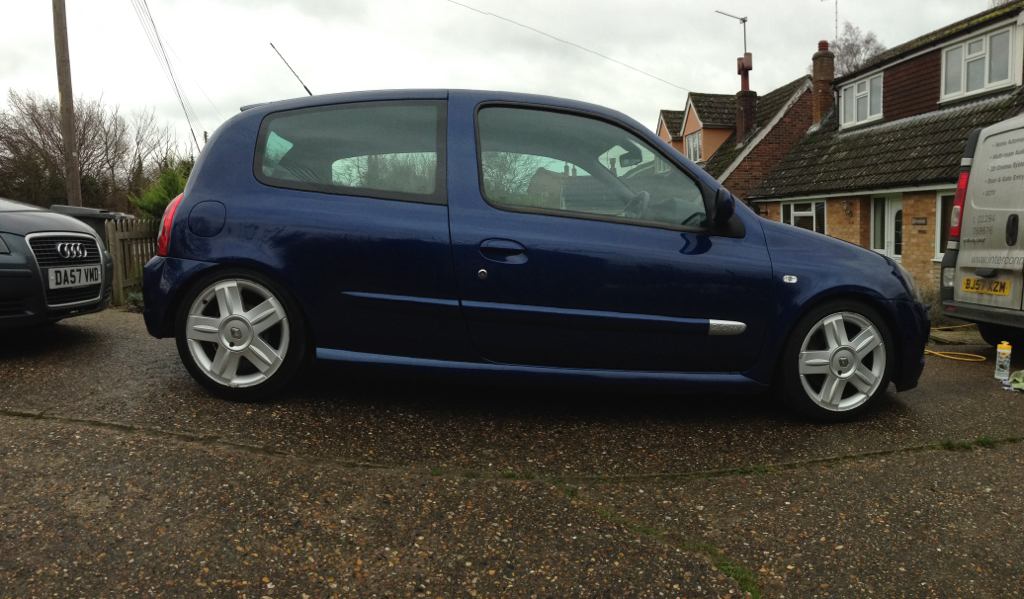

I later found out that the rear shocks were knackered so luckily I had a couple spare sets of coilovers so got those on with some spacers and sorted the ride height promptly.
I kind of like the big gay wheels which most people hate, they look massive now it's been lowered too!
Few short term plans are for the rear hub spacers to bring the rears out 10mm. Lower the seat as the seating position is dire after having bucket seats in past cars. Generally tidying it up, satin black most plastics as they're getting a bit grey and faded. I've got plenty of silver powder coated bits too so will get some of those on when I service it etc.

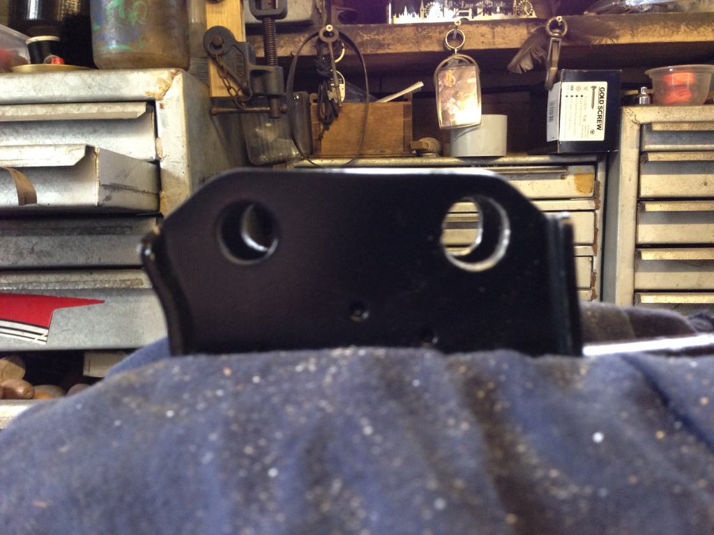

I also slotted the top hole of the standard shocks so I could get a bit of negative camber. Hole was 14mm and I stretched it too 16.5mm.

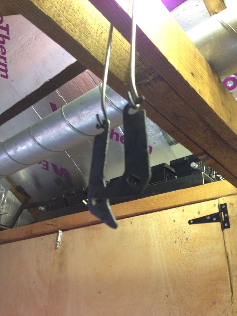

Also sprayed the little ABS sensor brackets as they were very rusty.
I'm loving having a normal feeling 172 again, but the suspension seems a bit soft. I'm getting a lot of rubbing on the inner arch in harder corners. Unfortunately the bumper brackets are where I'm hitting. Any decent ideas to get rid that doesn't involve hitting with a hammer?

Can you not take a dremmel to the inner arch bracket and just cut it off. I bent mine up against itself but I did that with a hammer, which you don't want to use.

I may have to take a hammer to it, could probably cut it off as the bumper seems sturdy, just seemed a bit of a s**t design. We're Renault not thinking of the modified market ;)

s**t design on the bumper? much better than the ph1 bumper, you dont need to use any bolts to hold it on either which is a plus. Saying that in a few weeks time mine will no doubt fall off and ill run over it or something.
Lol, yes the bracket that sits even with the arch so the wheel is constantly hitting it when turning,
Same rubbing problem that I always had on mine with spacers on the front Dan, its a pain in the arse tbh! My fix was to bend it slightly, fit smaller spacers and set my coilovers stiffer! :P

I'll bend it or cut it off and see how it goes before smaller spacers.
