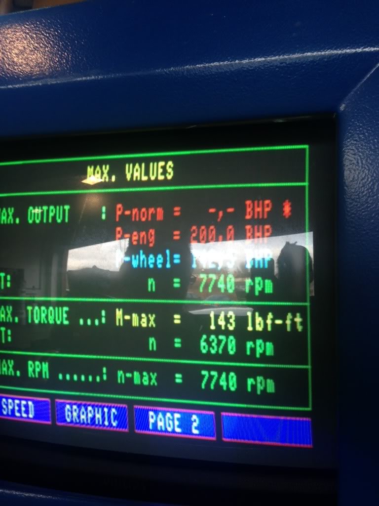

He just text me this picture :)
Well done on getting the magical 200bhp Dan
Having driven and been in this car I have to say its an impressive car all round and that was at 192bhp!! Really nice all round car even without the impending 1.8T conversion!!

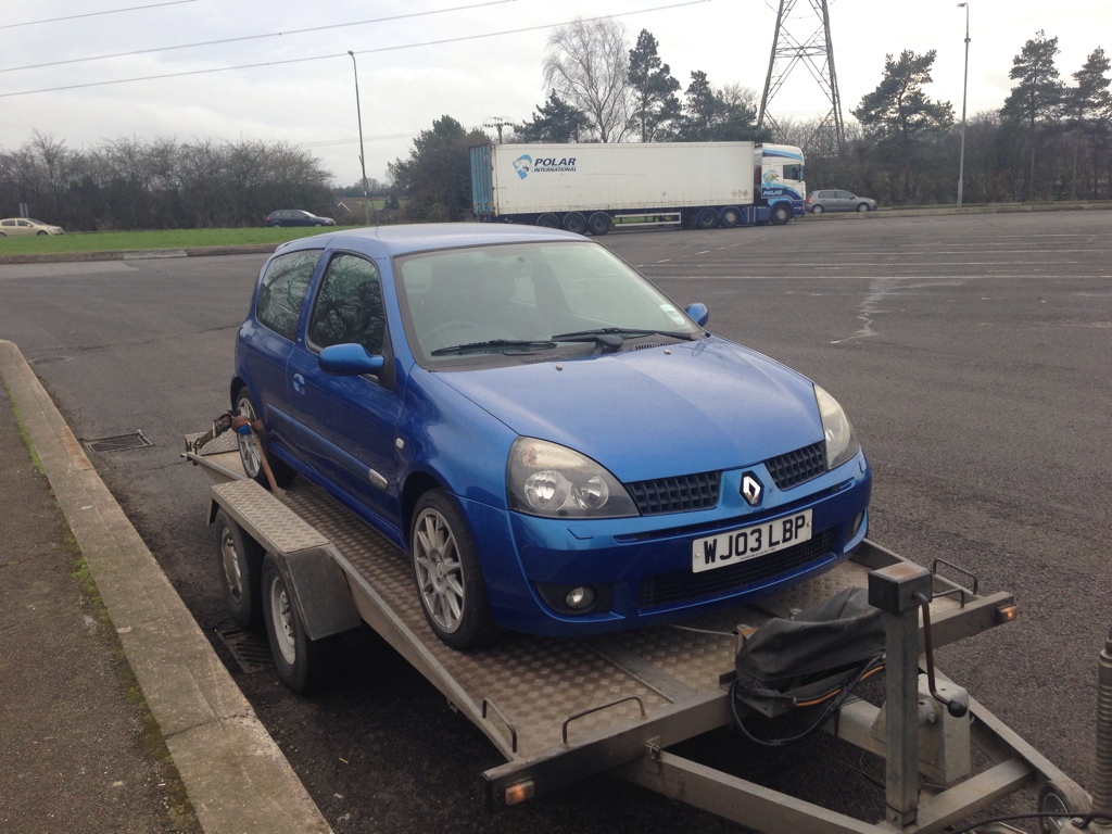

This morning left rather early(330am) to go to Lincoln, to collect my new daily driver...
Needs a bottom end, but ill pull the motor from the Monaco and put it in the cup and use the cup as a daily. Few other observations, charging fault, no 12v feed at the exciter so not a massive thing to sort. The aux belt is easily the worst I've ever seen, it's transparent in places, so if the bottom end hadnt let go, the belt Would've within 200 miles!

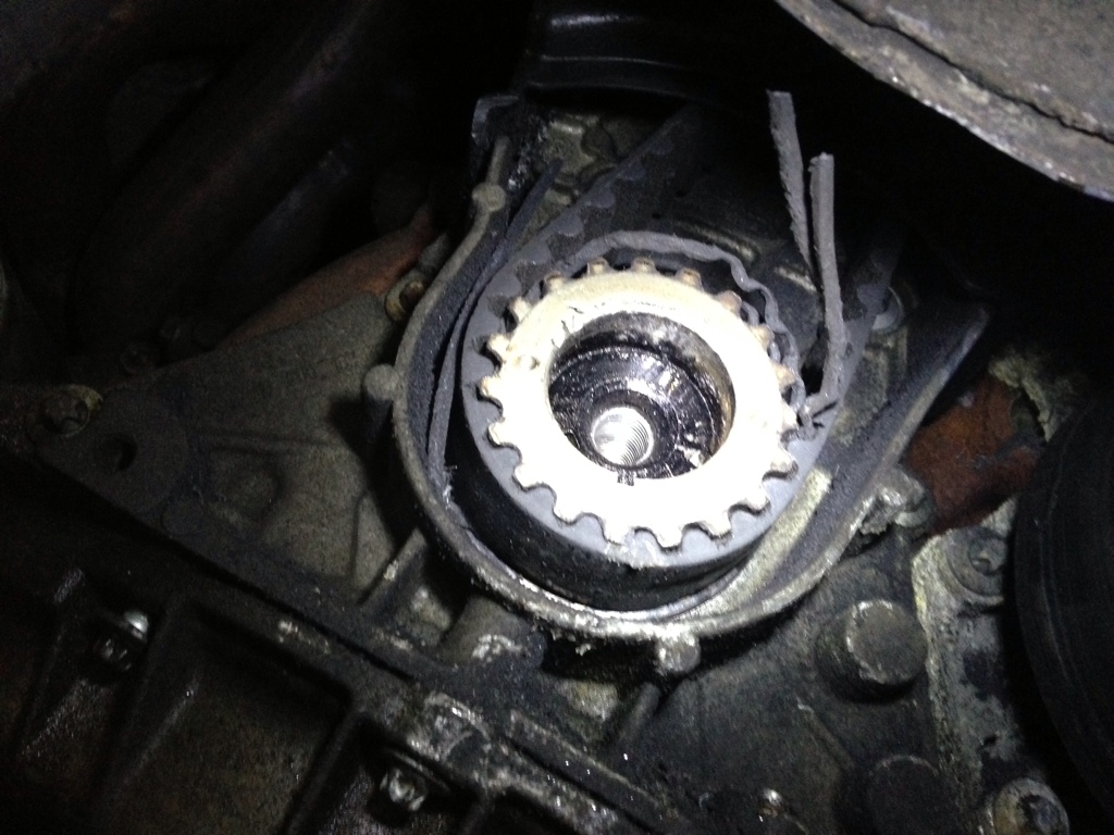

Started it up to bring it in to the garage and as I'm walking away to move my car out the way it rattled and cut out.
I was greeted with this.
f**k my life!
Well certainly needs an engine now.
