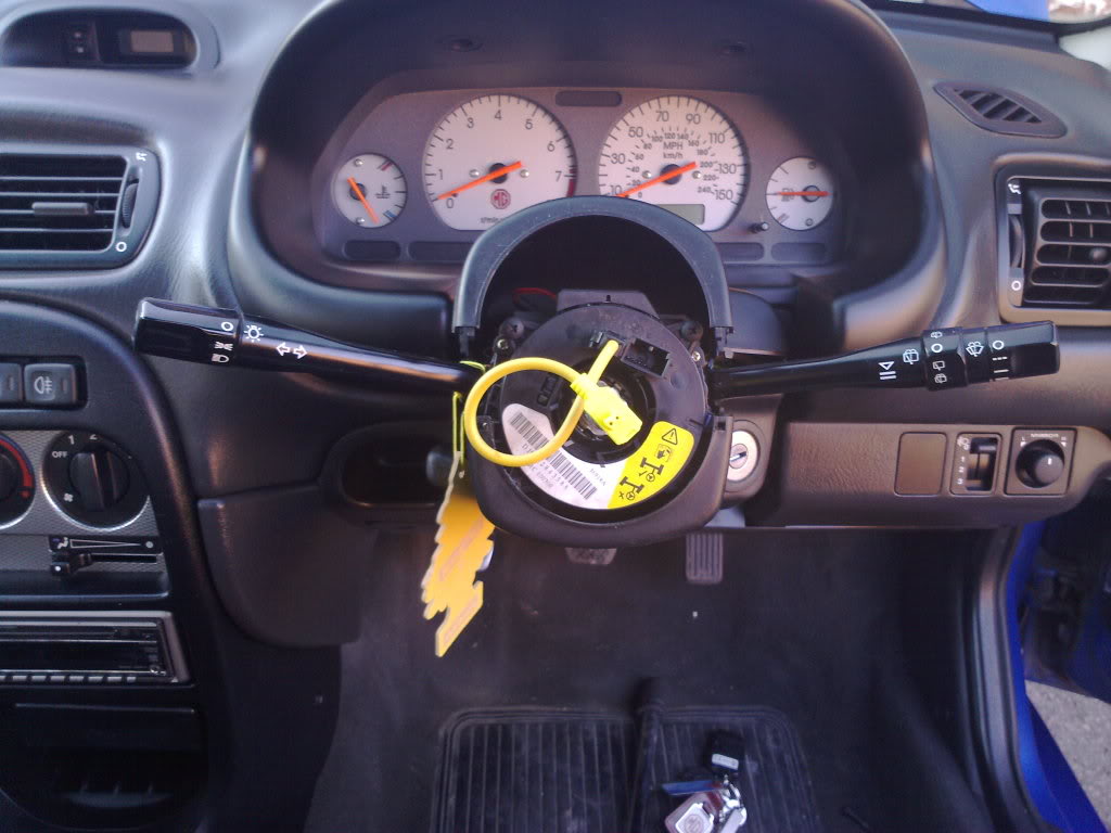

  • TF Airbag Coupler fitted (No more SRS light)
  • Inspection of brakes/suspension (brakes = :()
Coupler -

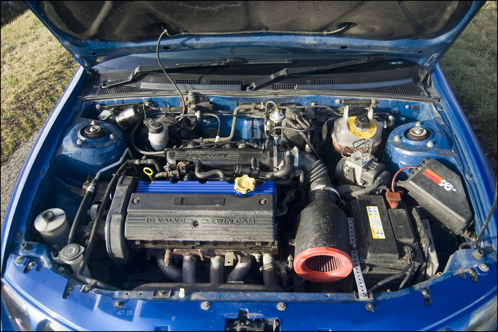

And a token shot of the bay (still a WIP for Fast Show, and needs a clean)

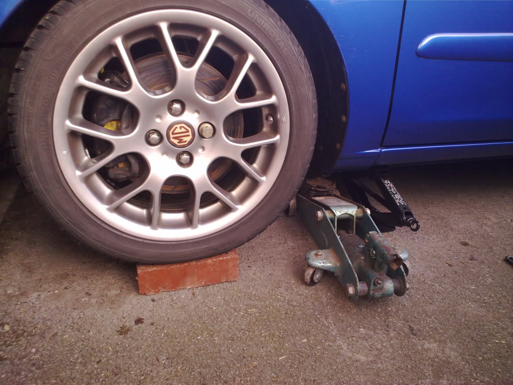

Oh and a quick shot of how I have to jack it up at home. Drive onto brick, then use emergency jack to raise the body enough to get the trolley jack in!

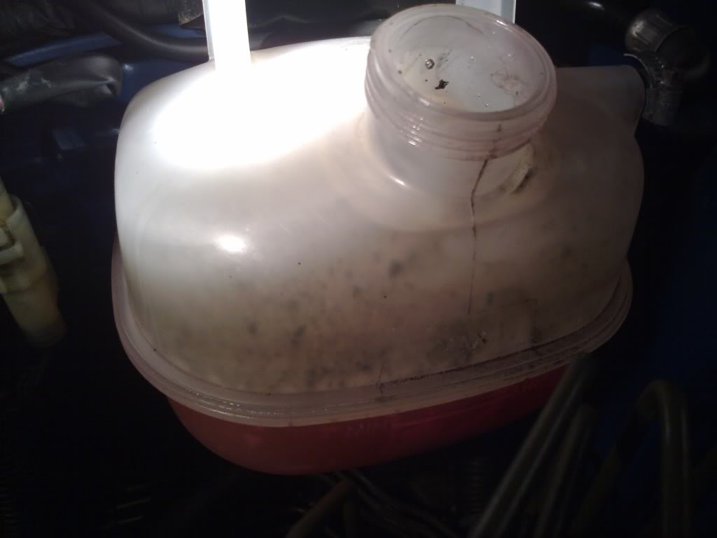

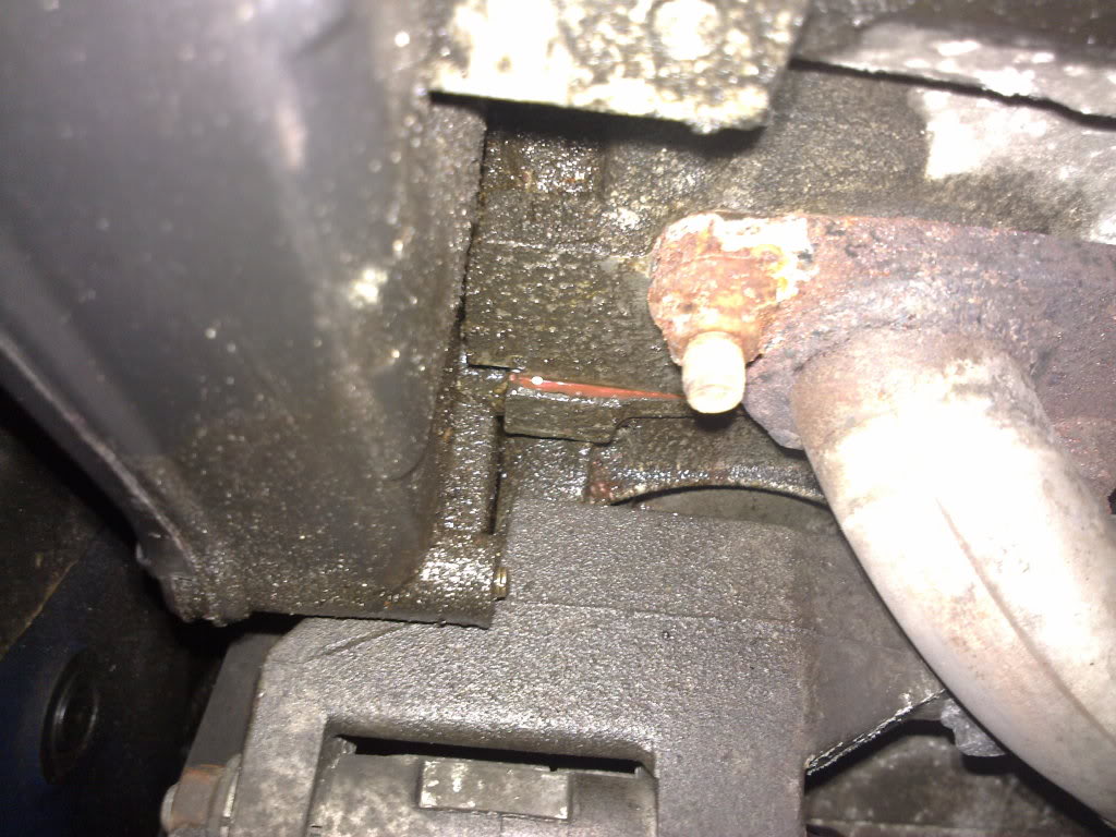

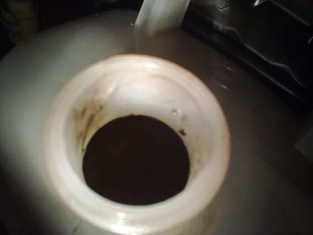

The day has finally come; I've had the car nearly 2 years, and I'm pretty certain I now have the dreaded Head Gasket Failure, as shown in the following pictures. Coolant has been steadily disappearing for a couple of months now, and a black gunk has recently appeared in the expansion tank. Then, I found coolant weeping between the block and the head, the final piece of confirmation I needed.
