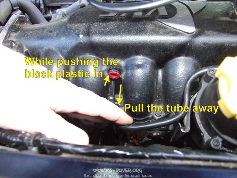

im struggling to see what it actually is, does the pipe go into the hole or around a fitting? maybe try some brass connector fittings with the threaded ends and heli/tap it?
Normal Connection -
I don't have the red bit, and the black plastic behind it is all deformed.
Well, we started the car this morning with the hose out, as we knew it would sit at about 2K. Then put the hose in, with a poor seal, and the idle dropped to 1K. Left the car to fully warm up, idle dropped as the engine got warmer, back down to the usual 750ish RPM.
So now I've got to put the bodywork back on, and have a run around the block to see if I have any servo assist and how it runs out on the road, rather than sat in a garage.
is that the standard manifold? Ive got a plastic 1.6 16v inlet at home that i can butcher to get that plastic fitting if you want?
Nope, I had the plastic type you have on before. It's now a metal VVC type. Not changing the manifold, there's no room to remove it all with the head in situ.
I think I'll just gum it right up with some kind of sealant and hope for the best.

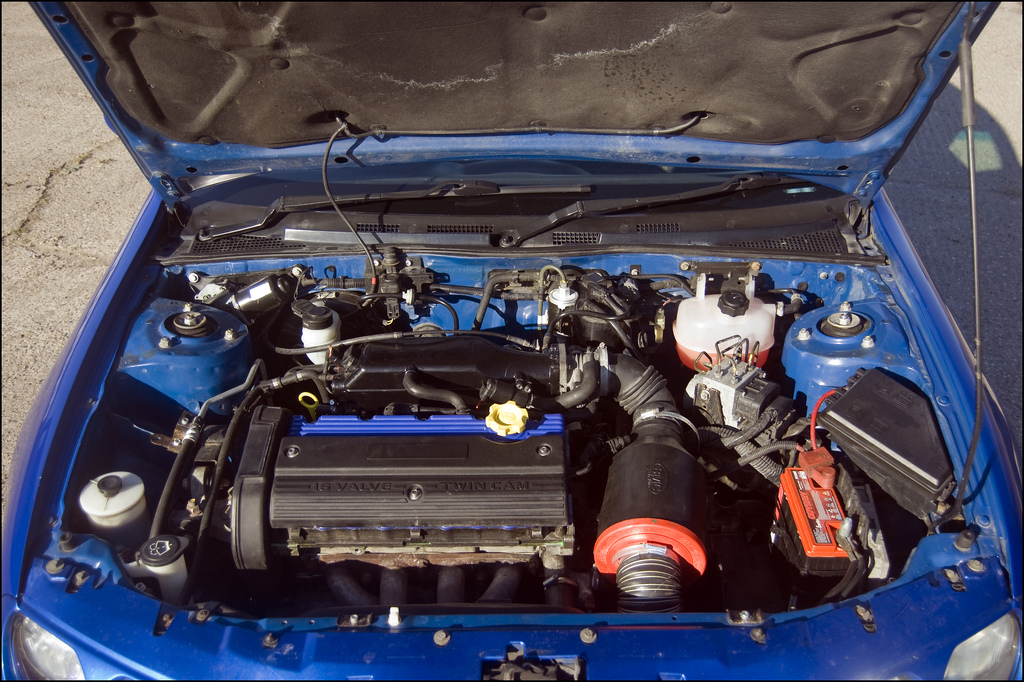

Spec:
BMC DIA Induction Kit, 52mm Throttle Body, VVC Inlet, TF135 camshafts, Magnecor 8mm Leads, Janspeed Exhaust Manifold, Sports Cat, 6x4 Oval Catback System, MIL Eliminator
620ti Calipers, 282mm Discs, Yellowstuff Pads, Goodridge Hoses, DOT 5.1 Fluid, Standard 120 rears
AAautosport Coilovers - Down about 60mm, O.Z Racing F1 16x7 in Steel with Trophy Blue writing
TF Wheel, Airbag & Coupler, Richbrook Gearknob, Dewipered, Tinted Rear Lights, Odyssey Race Battery, Powdercoated Rocker Cover

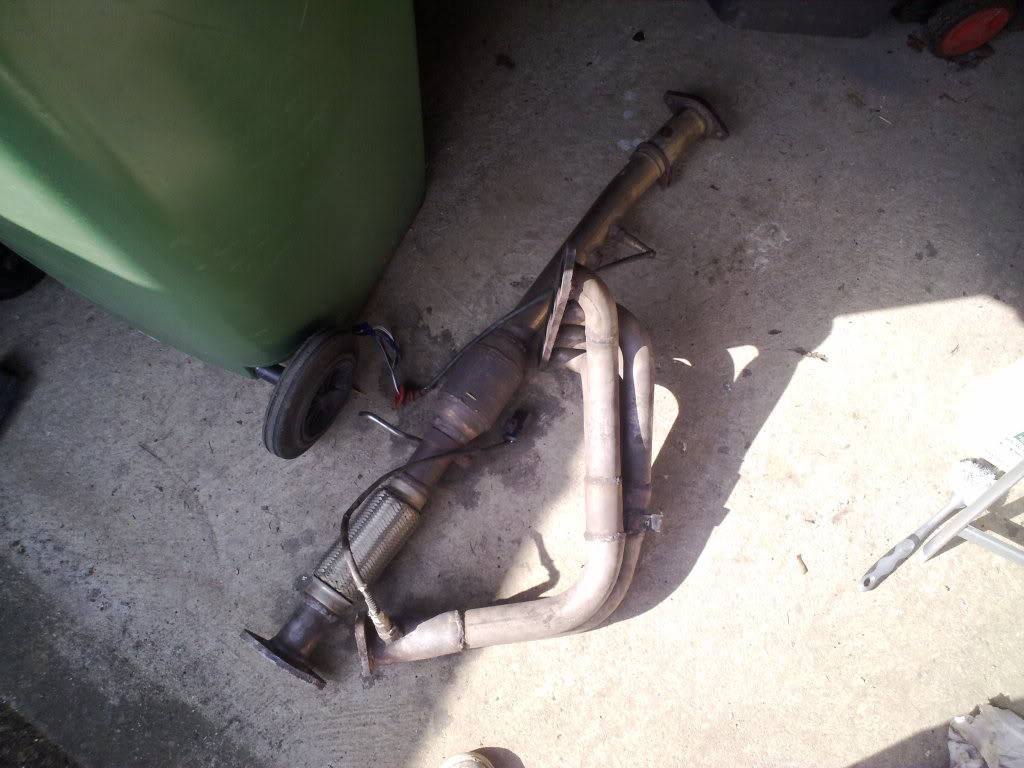

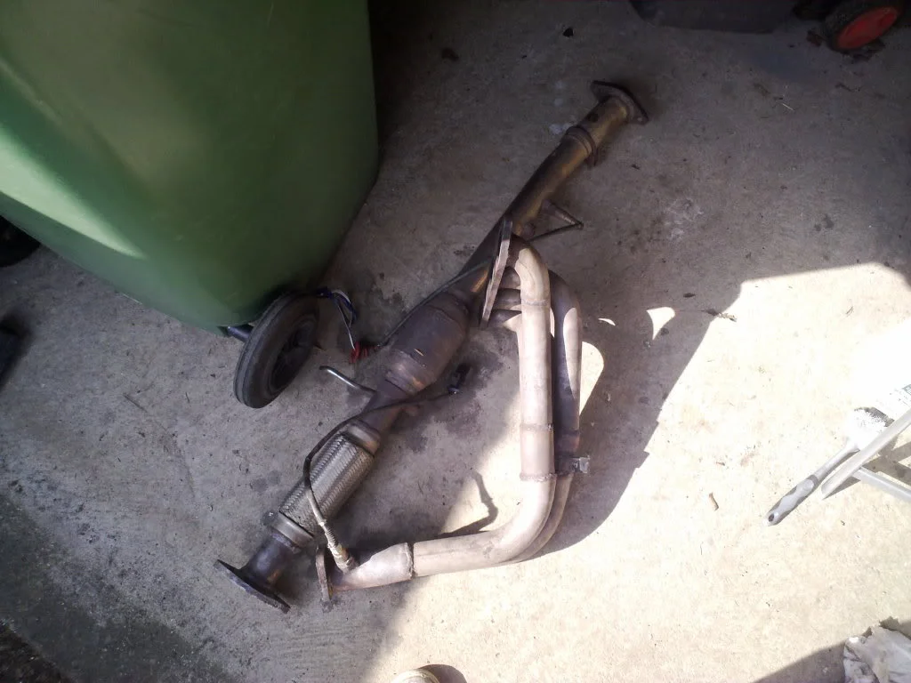

Janspeed Manifold & Sports Cat off, being swapped for standard items today. Breezed off, I thank whoever invented Nickel Anti Seize compound for that.
