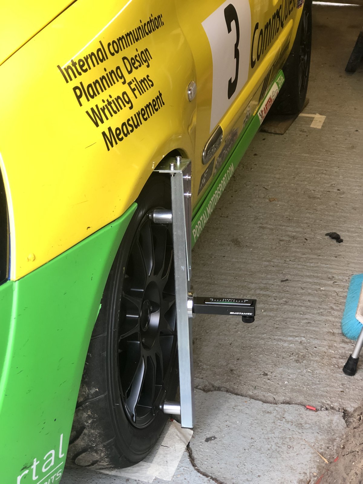

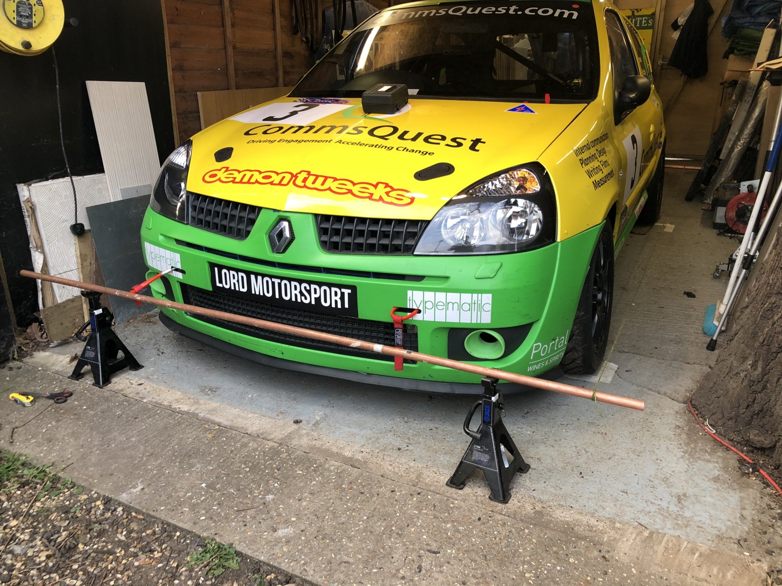

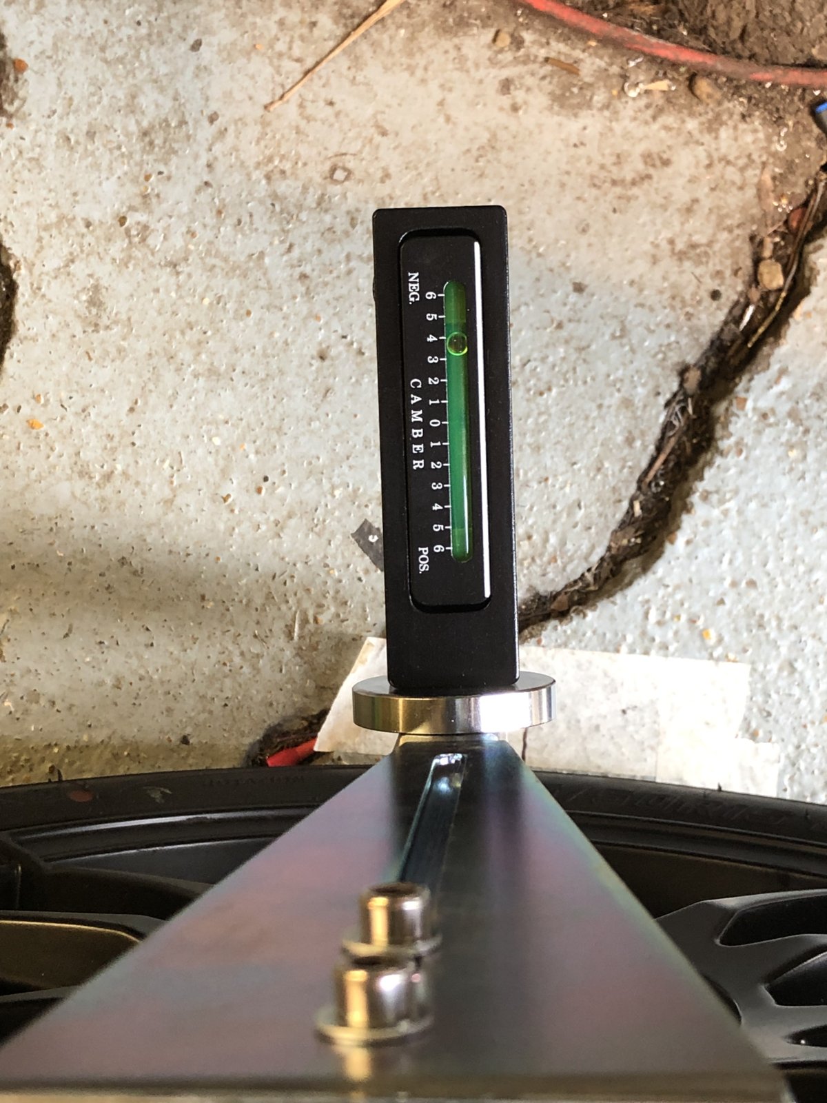

Over the weekend I made a start on checking over the suspension and tracking and thought I'd have a go at stringing the car for the first time.
Very time consuming doing it for the first time but with lots of notes taken and measurements taken hopefully it will get quicker. And the equipment needs to get a bit more accurate too! The string is not the right type and I will get some ali tube that I can notch.
All the same it was an interesting excercise that after much faffing seemed to show that the front wheels were marginally toe-ing in rather than out as they are supposed to be??
Very odd, but I've adjusted the tracking by 1 quarter turn on both sides and I'll measure it again before the car goes on the trailer on Saturday.
Camber was as it should be.
Finally, I've added one more degree of camber on the rear and firmed up the anti rollbar to try and dial out some of the over steer.
Sadly the next time I drive the car will be in qualifying as I don't have the time to test on Friday.
There are only 2 possible outcomes and what ever happens I will have time to make more adjustments before the race.

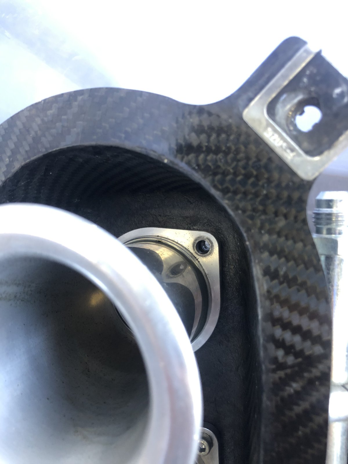

My first thought was that it sounded like a valve but after popping the end caps off and checking the timing it all seemed spot on but that was as far as we could go at Snetterton. Time to pack up.

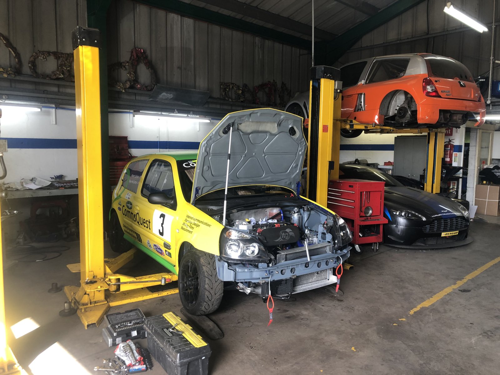

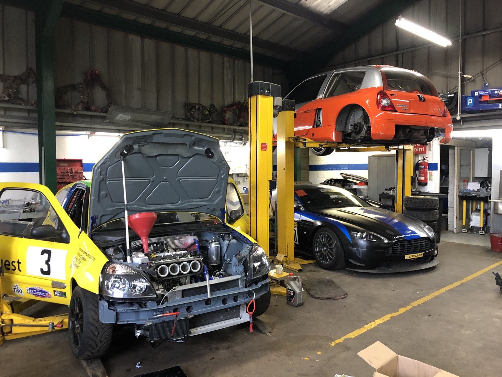

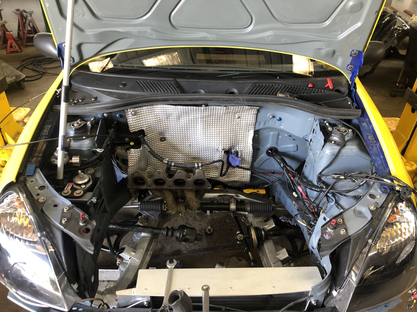

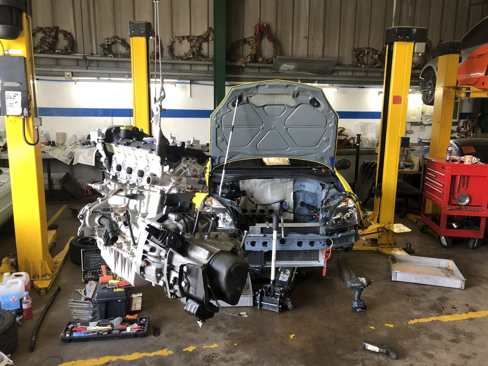

So this weekend I took the car over to Mark Fish who had agreed to let me use a ramp on Saturday with a view to him helping me put everything back together once the engine is sorted.

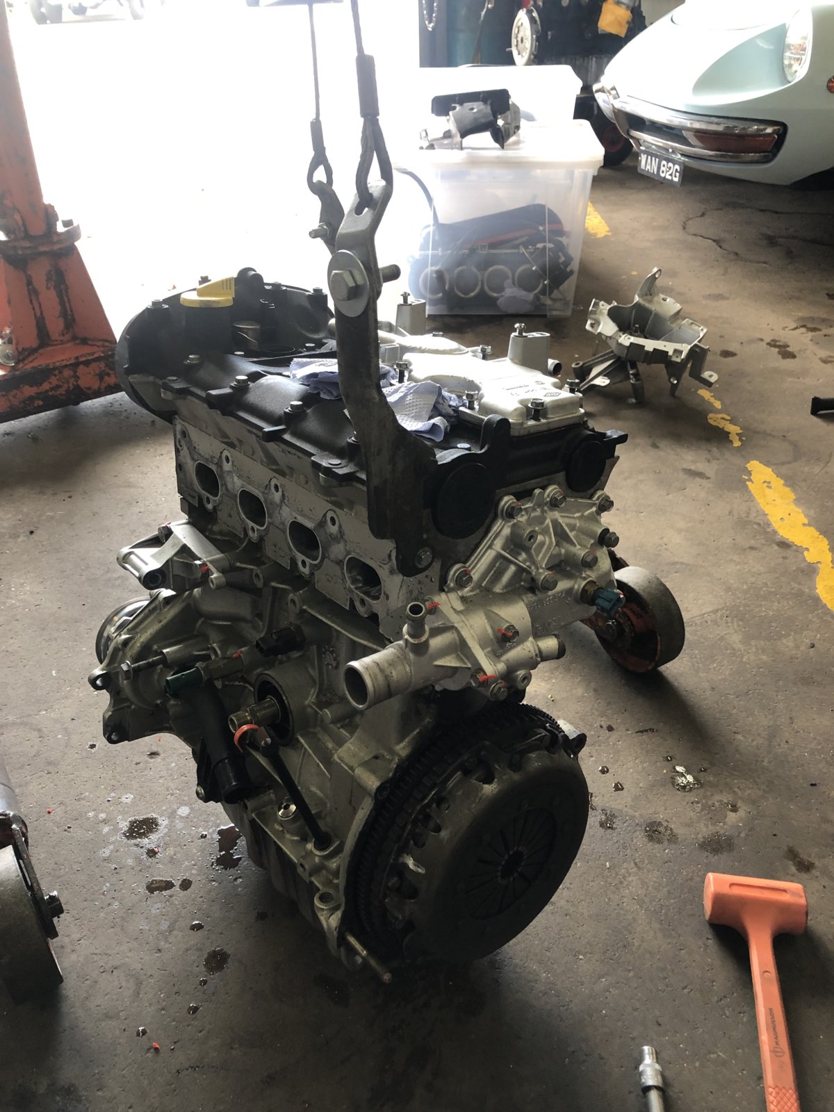

By lunchtime I was ready to pull the engine
And then strip it...

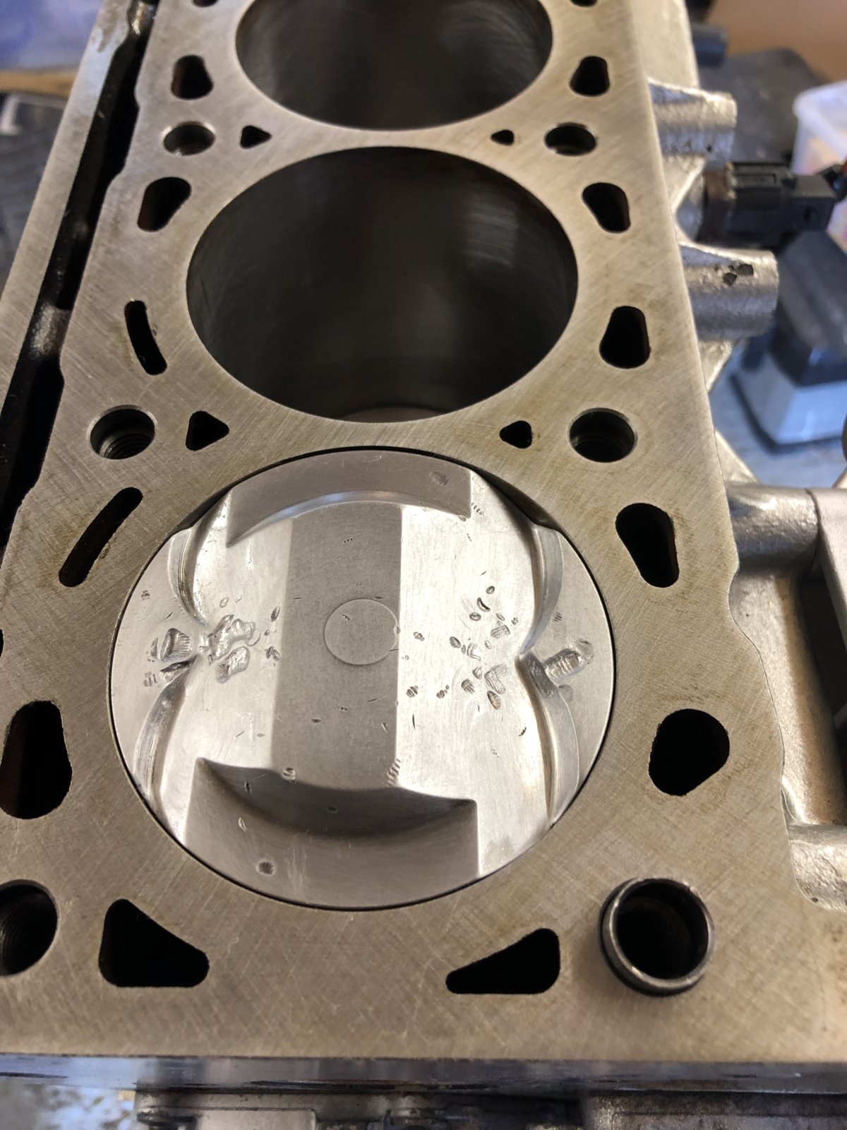

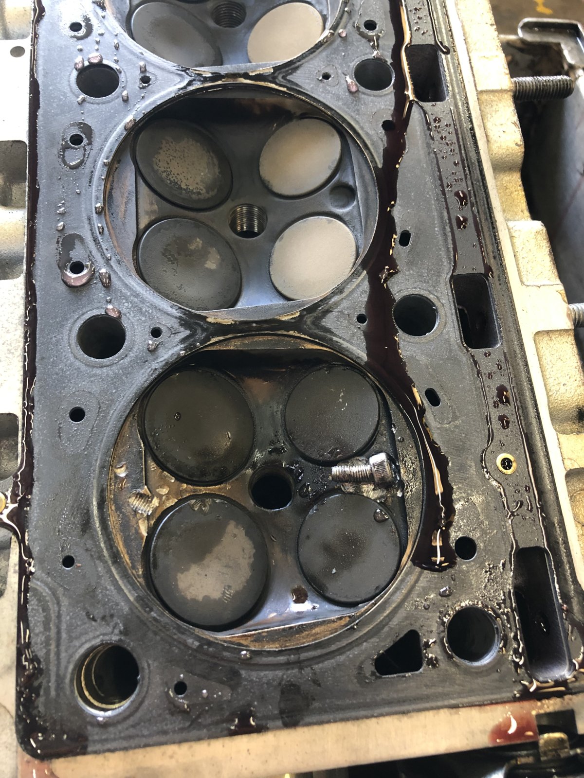

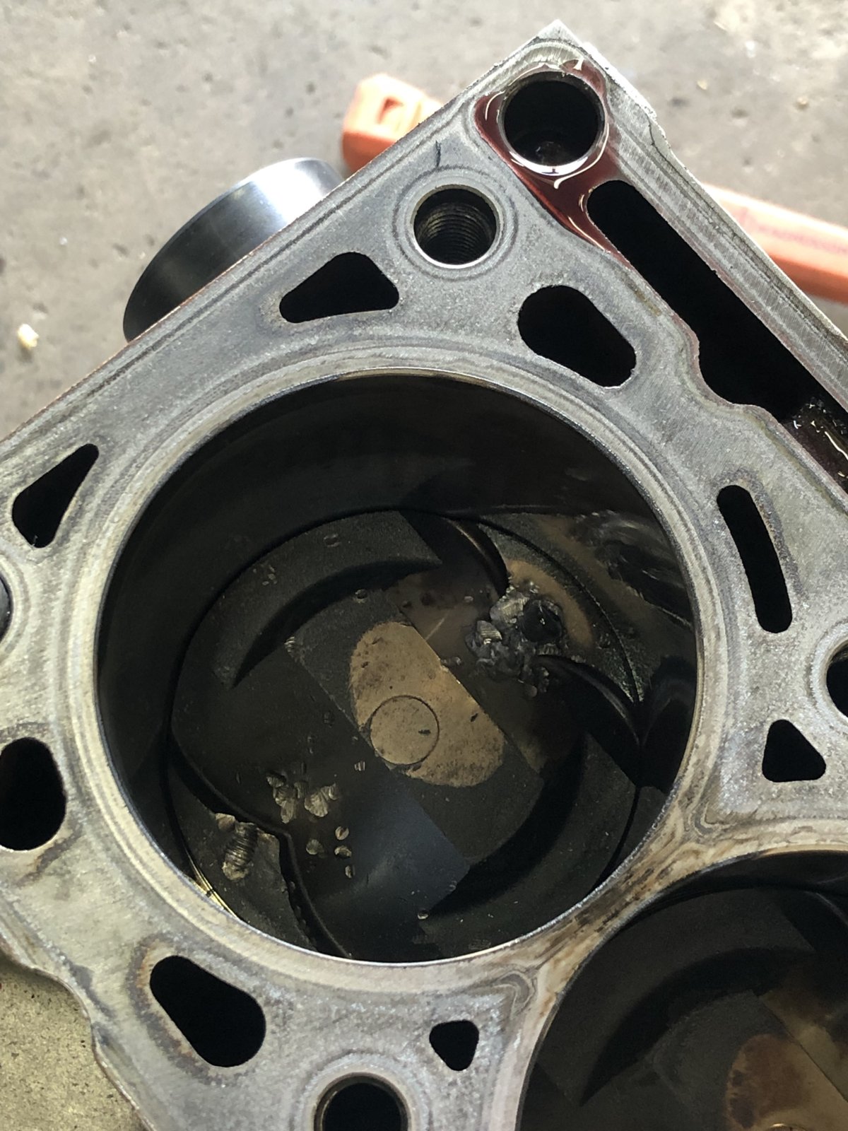

Before turning it over to remove the sump and have a proper look inside I decided to remove the head. Then everything changed!
Thank god I shut the engine off when I did though...
As soon as I saw the bolt I knew exactly where it had come from...

The engine will go to Thurston Engineering on Tuesday for them to inspect it properly. I'm hoping a new piston and 4 new valves will be all I need but there's no knowing whether a rod is bent or the glitter in the oil is from a damaged bearing from the piston hitting the bolt.
Mark and I both think the head is salvageable though, so while they sort the bottom end I'll make a start on the head.

So another call to the engine builder to ask them to have a closer look at the piston to see if there was any chance of saving it.
Then Happy Days when I got a call from them this morning to say that they think it is salvageable!
So now all I need is new rings and we decided to renew the big end bearings as a precaution.

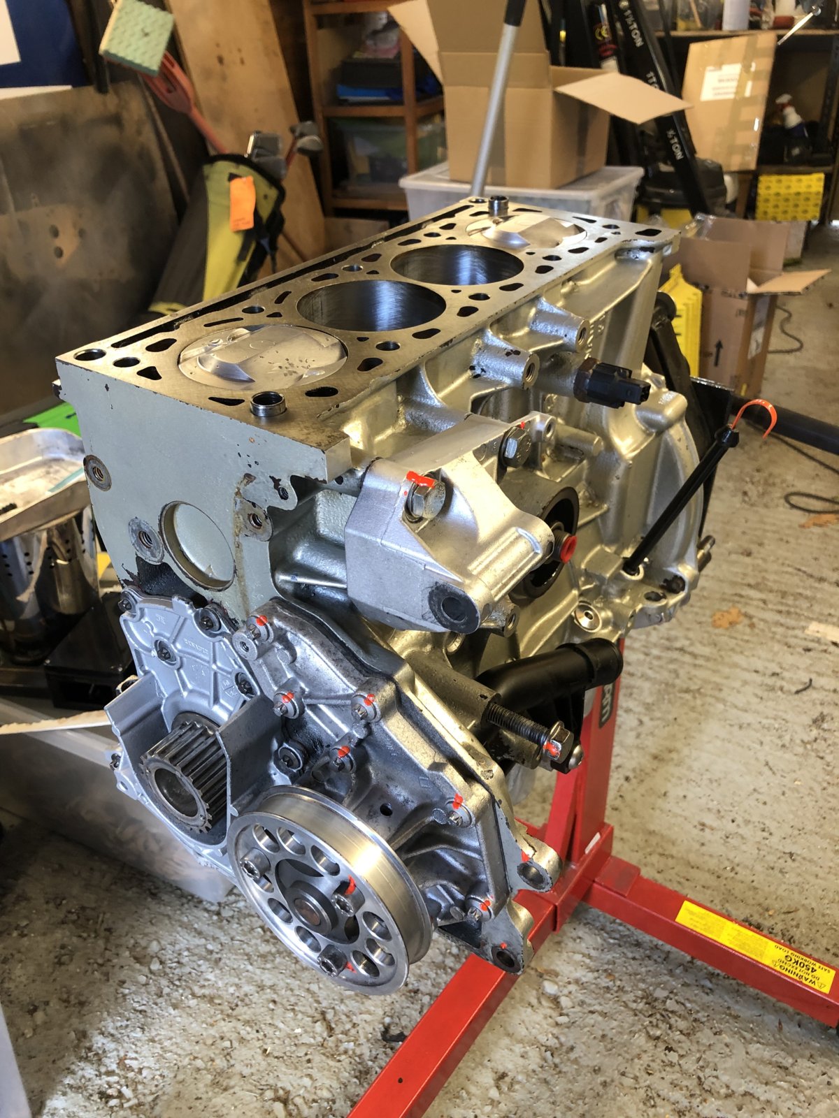

The engine parts saga concluded with Thurston deciding that the rings were also salvageable. the engine having only done about 40 hours running. They removed all the pistons, cleaned everything up including the damaged piston. Rebalanced everything and then re assembled with a new set of King Race bearings.

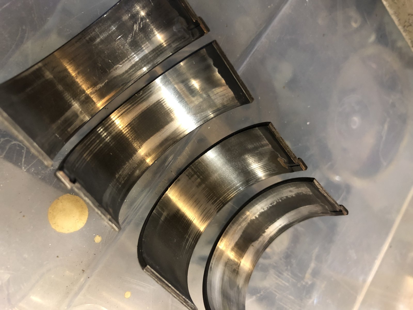

Interestingly the bearings that came out were not in very good condition with Thurston diagnosing low oil pressure the most likely candidate for the cause. Something to look at again at the end of the season. In the meantime these should see me through and we may have actually dodged a bullet changing them at this stage.
Mark Fish mentioned that when he was running a Clio Cup team back in the day they used to change big end bearings halfway through the season as a precaution. I can see why!
Back from Thurston
Very lucky that the piston wasn't worse
Badly worn bearings

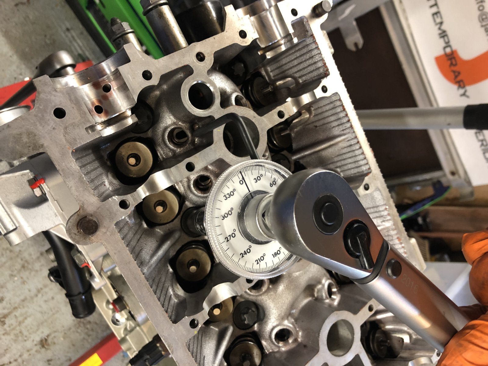

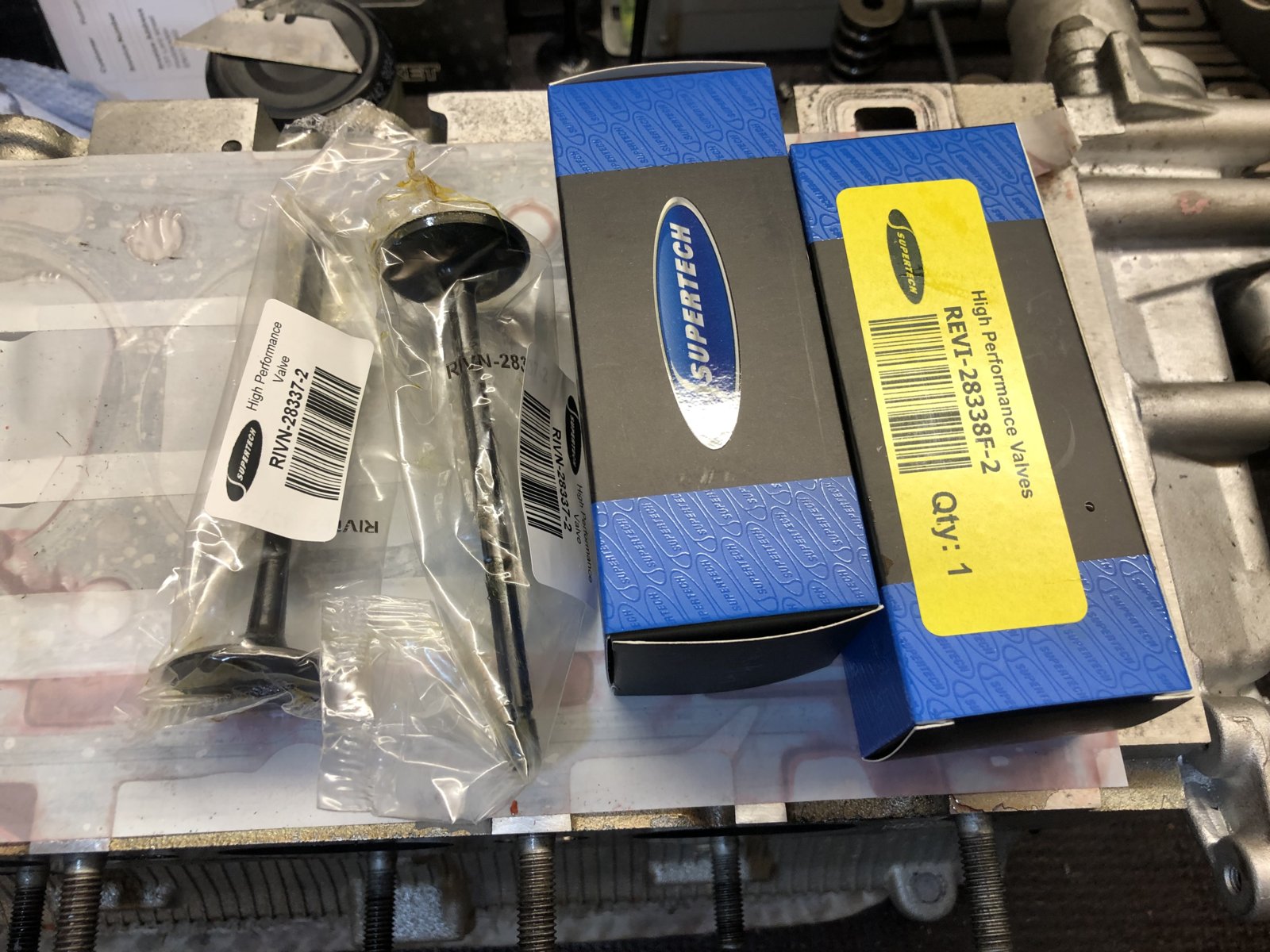

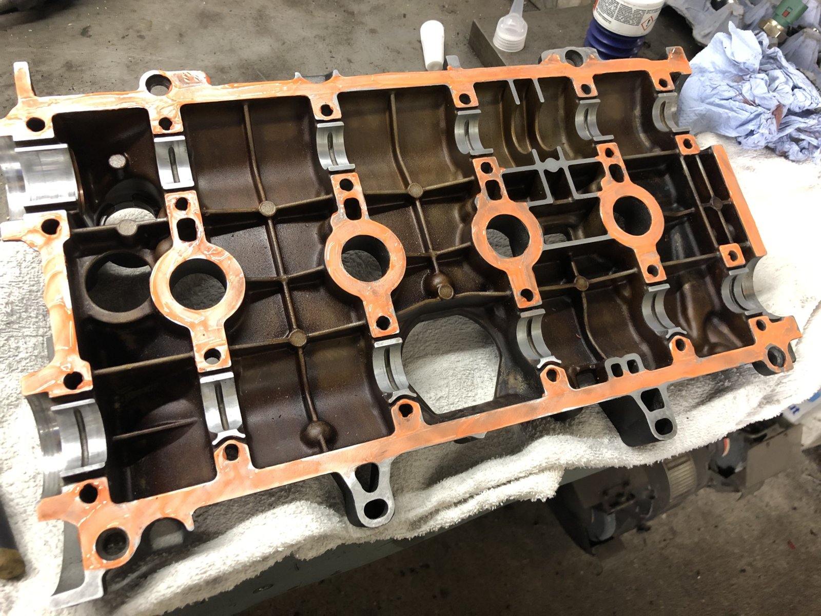

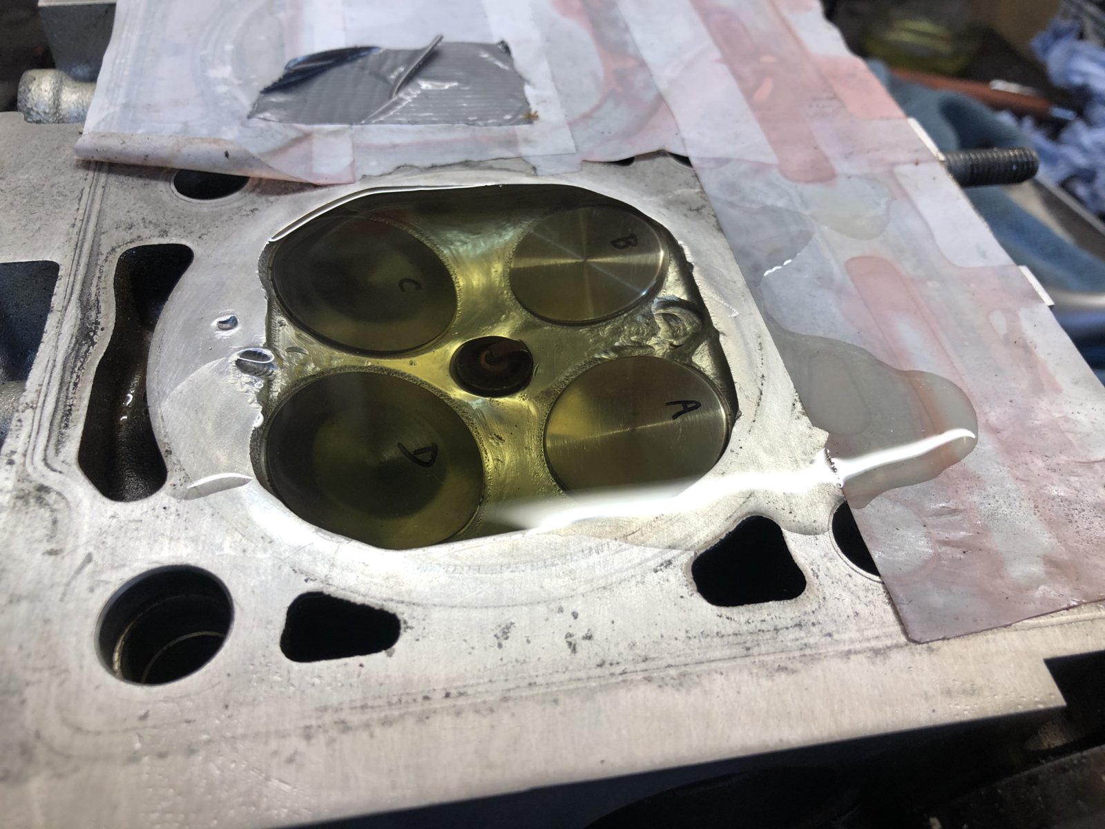

With the bottom end back and the head cleaned up, new valves lapped in and leak test carried out I bolted the 2 together with new head bolts and head gasket and then it was back to Mark Fish to try and get everything back together. This was last Saturday 21st May
New valves courtesy of Nick at PMS
No Leaks!

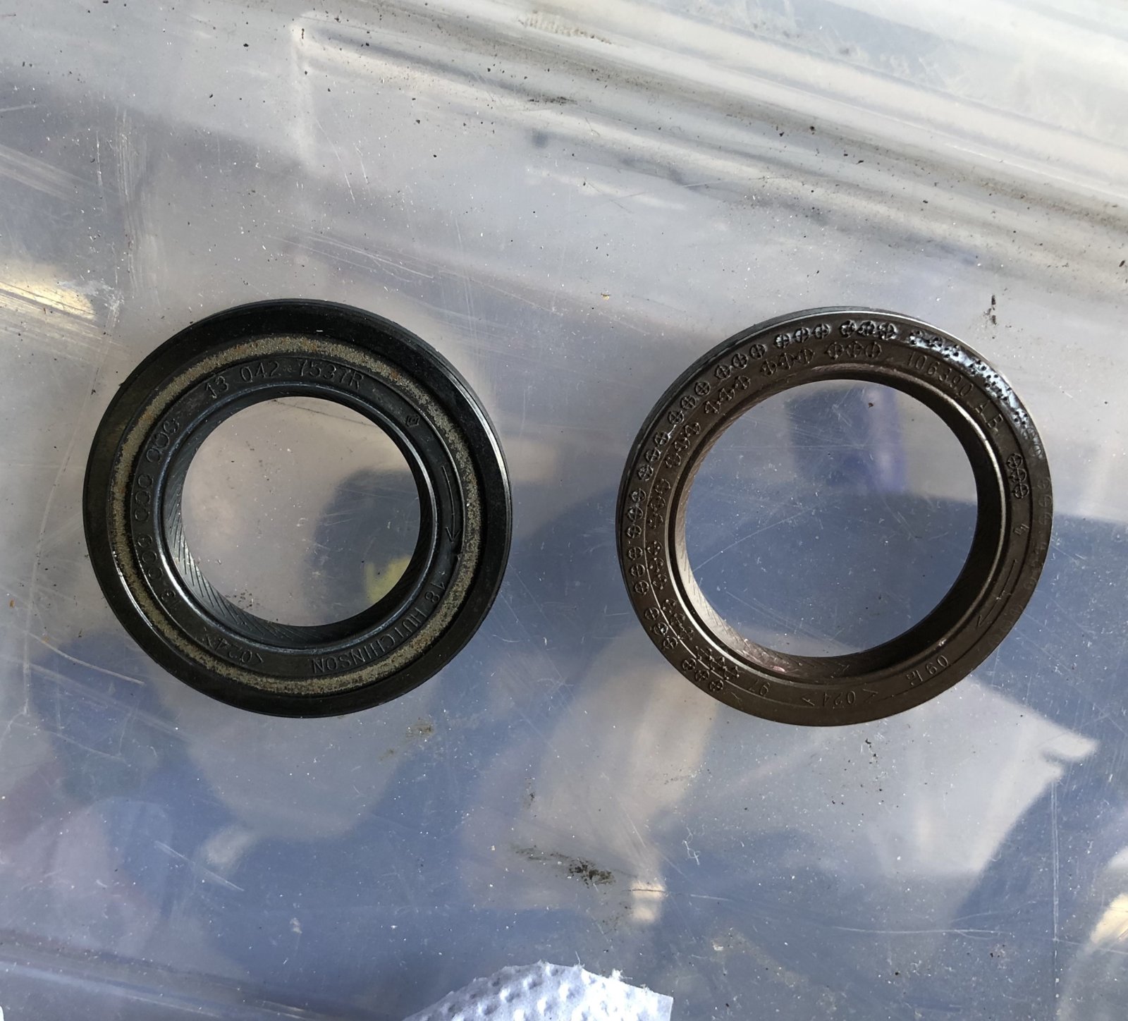

At Marks all went well until I discovered Nick had sent 2 inlet cam seals instead of 2 exhaust cam seals and as Mark has left me alone for the afternoon while he went to a party I was stuck with nothing more to do.
I left the workshop on Saturday with the Gearbox and engine all together on the hoist feeling rather deflated.
When I got back to my workshop at home however I discovered I had two brand new spare cam seals! If only I'd remembered!

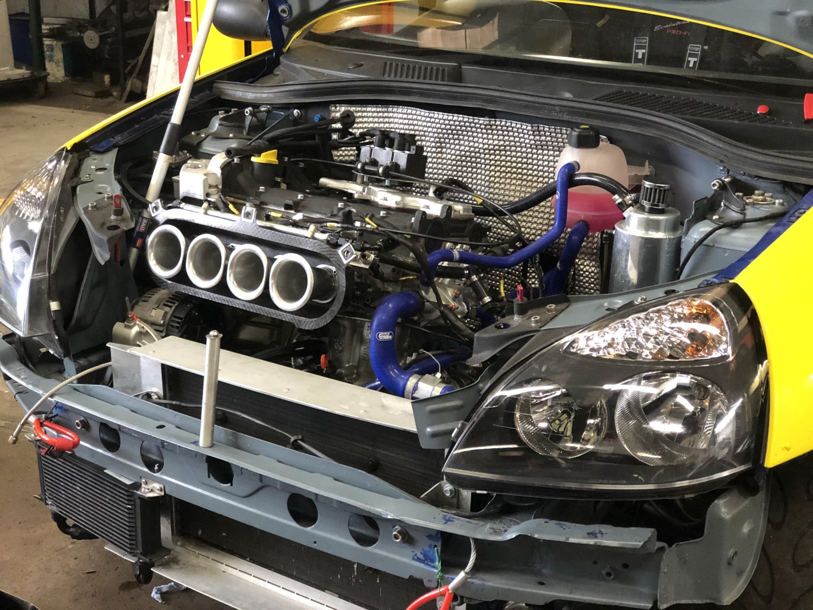

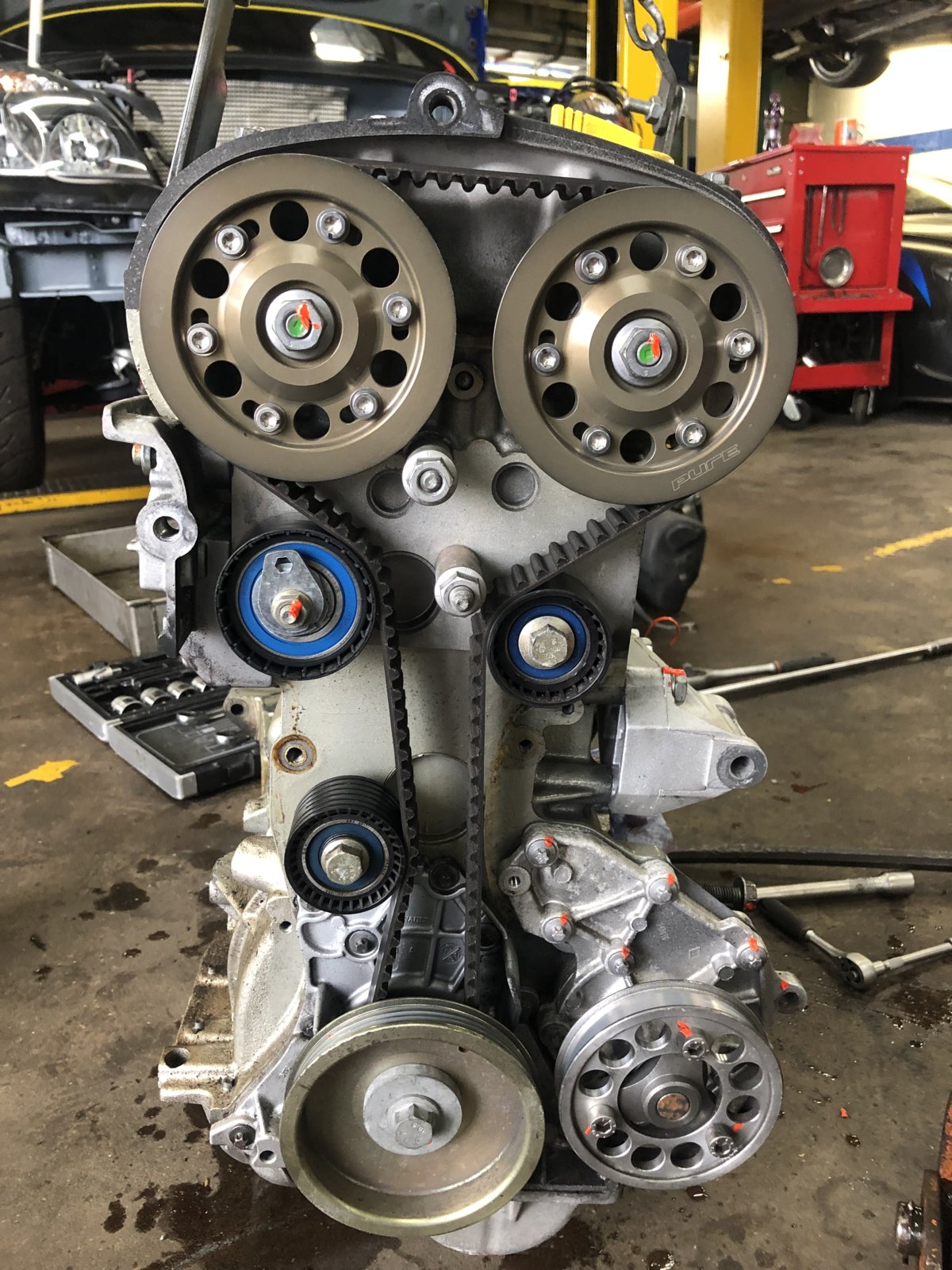

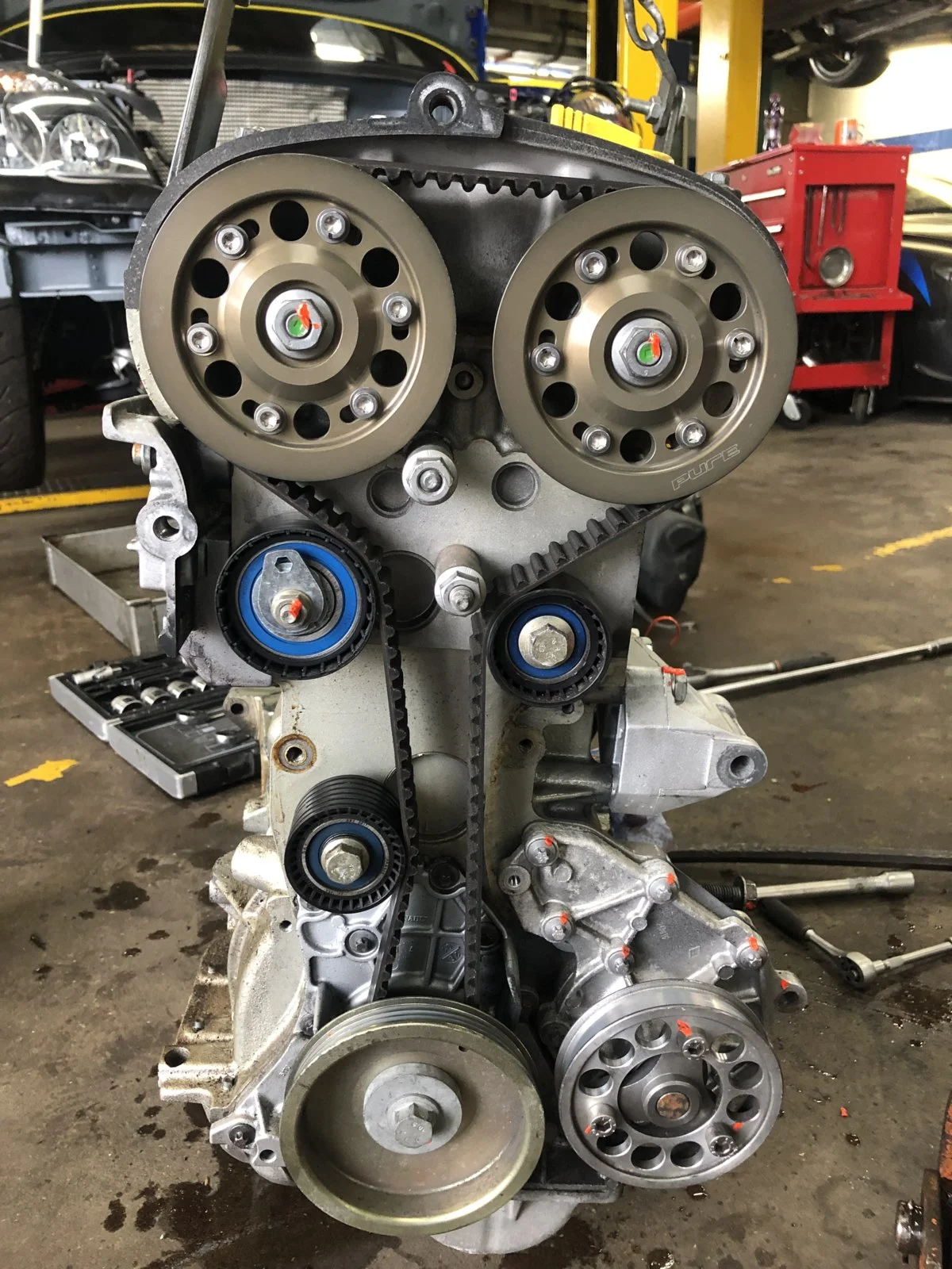

Anyway, cut to Monday afternoon. Having managed to wrap up a days worth of meetings in half a day I arrived at Mark Fish again at midday to press on with the install.
By 4pm the engine was timed up and in the car. By 6 it was full of fluids and ready to fire up. After turning the engine over without sparkplugs for a while to check for oil pressure I reinserted the plugs and prepared for the first start.
After 2 attempts it fired! Struggled for about 10 seconds and then died. It felt good but then the dreaded starting issue raised its head again!
