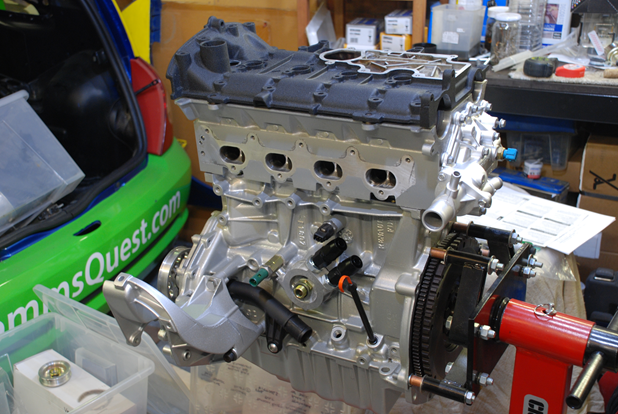

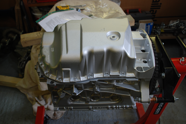

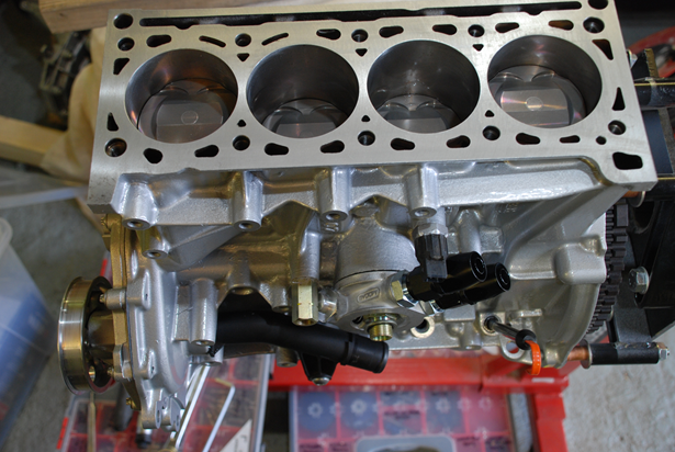

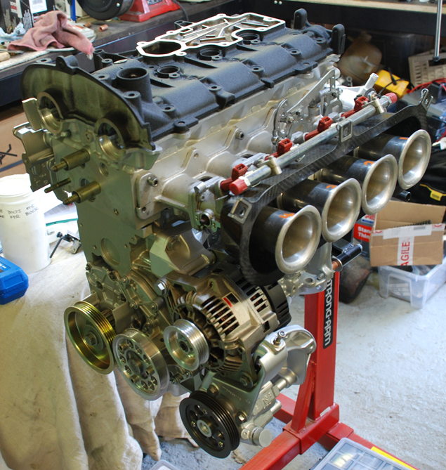

Bottom end came back this week. (finally) So have spent the weekend starting to build it back up.
It's nice to start getting some of the newly powdercoated bits out of its wrapping!

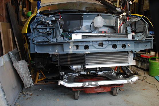

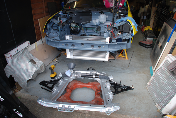

Firstly, cleared some space at the front of the car. Still a couple more jobs to do here.

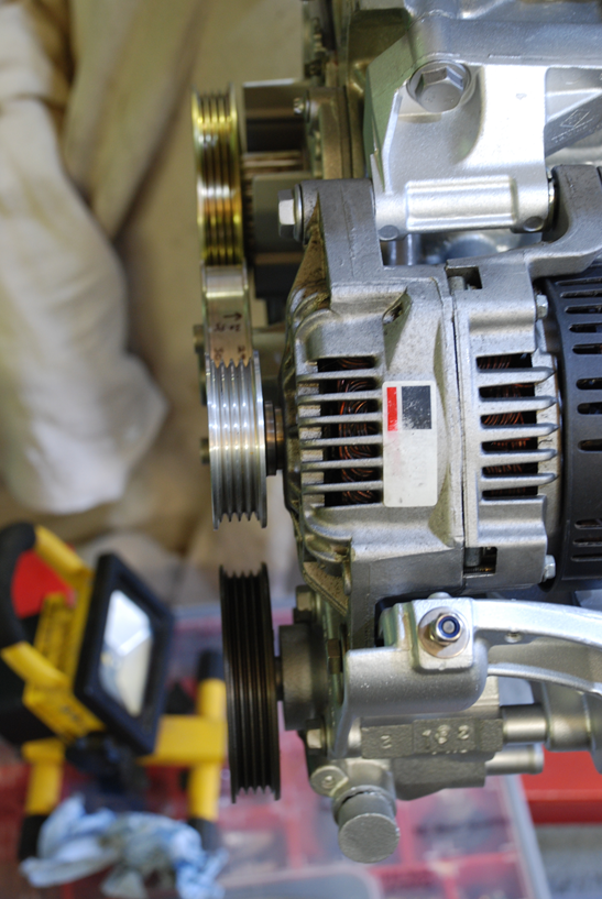

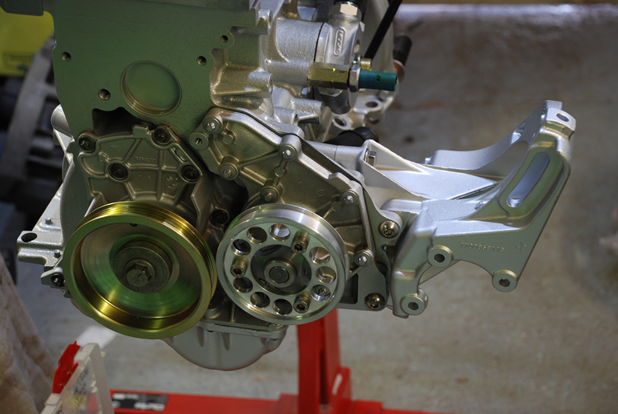

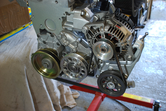

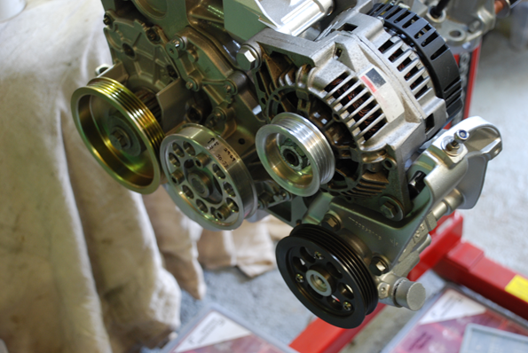

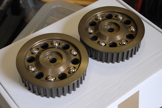

And these finally arrived from Pure Motorsport. Their newly developed vernier pulleys.
The Pure Motorsport lightweight pulleys were not designed for the "Cup" setup and Nick wasn't sure that the alternator pulley would line up. Fortunately it works perfectly. Just need to order the correct length 4pk belt.
And to finish off just had to test fit the throttle bodies!
So this coming week hopefully get the cams in and everything timed up.

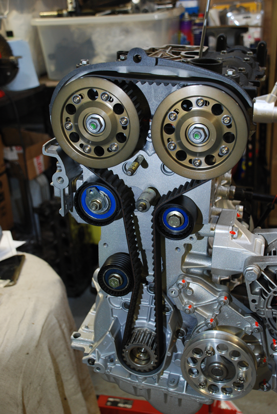

And finally got the cams in and Pure Motorsport's new vernier pulleys on. Unfortunately though, the dowel locating the pulleys on the end of the cams is in the slightly the wrong position for my engine, leaving me with either too much advance or too much r****d and not enough adjustment. Probably something to do with me running a 1mm gasket. Nick has offered to drill a second locating hole but I think I'm going to ditch the dowels and just go for a friction fit. Which is how the old Piper pulleys used to be anyway as their dowel hole never aligned with the cat cams dowel either.
So, I'll make those adjustments at the weekend and then it's ready for installation.

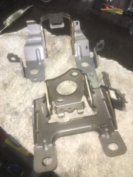

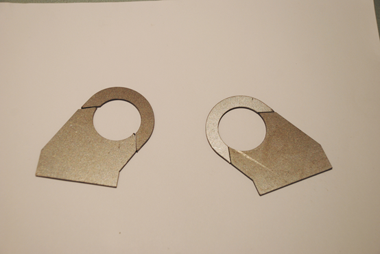

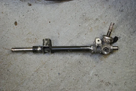

I for one will be interested in the reinforcement plates. So count me in for a set

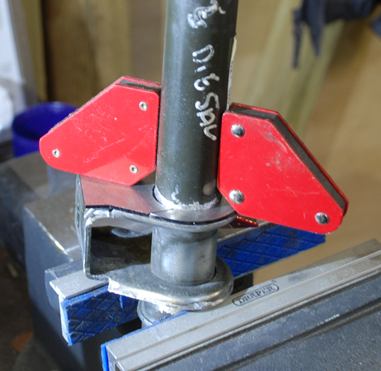

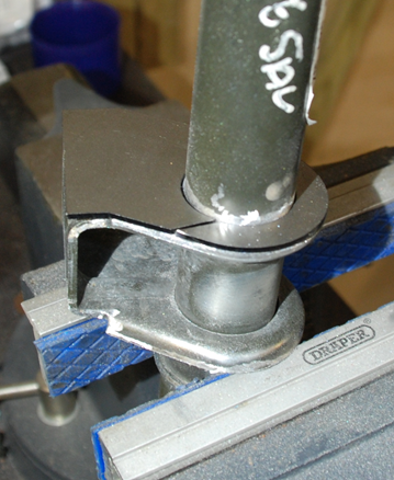

Sold one set untested. I started to fit a set before I ran out of gas but if you're interested I'll do them at £15 plus postage for now until I have had a chance to weld some up and test them properly.
Eventually I'd like to have them installed and rig up a GoPro pointing at the bracket while I'm at Brands one day to see how it looks under load.
These are cut from 2mm mild steel and are handed as the outer side of the bracket has a larger internal diameter than the inner side.

So, I decided to send the pulleys back to Pure Motorsport after all, as the dowels weren't coming out of the cams easily and I didn't want to have to strip it all down again. So new dowel holes will be drilled.

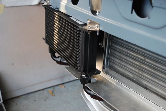

Finally finished mounting the oil cooler
Should get enough airflow through the lower grill if I open out the closed off grill section on that side.

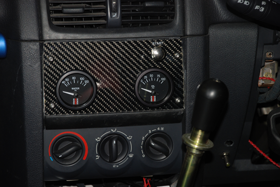

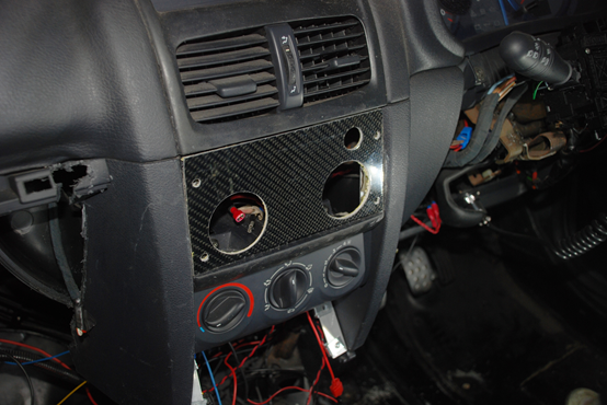

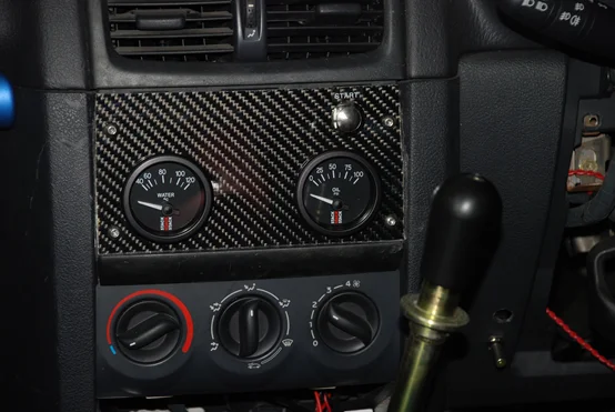

I've also finished connecting the fuel lines to the tank and started work on a modification to the dash to take the new fuel pressure guage. Again, this will all change again next year when the dash comes out completely and the loom gets sorted properly.

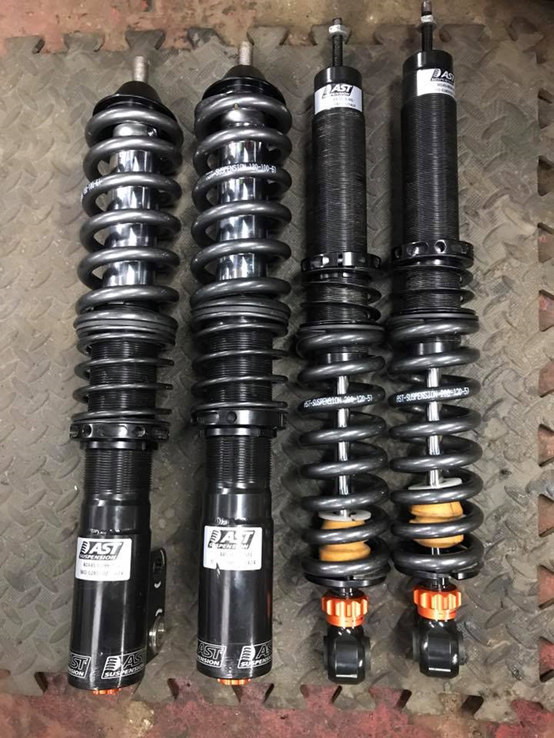

And finally, last week I purchased these...
Only one year old and done about 6 races I believe. Spring rates are already what I wanted too, so although they were on the shopping list for next year, they don't come up for sale too often second hand and in this condition.
I had them on my other clio race car so I know how good they are.

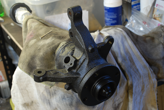

Still waiting for my vernier pulleys to come back from Nick at PM so got on with more stuff.

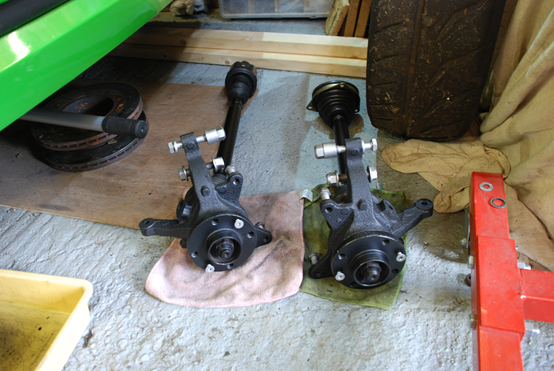

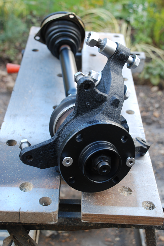

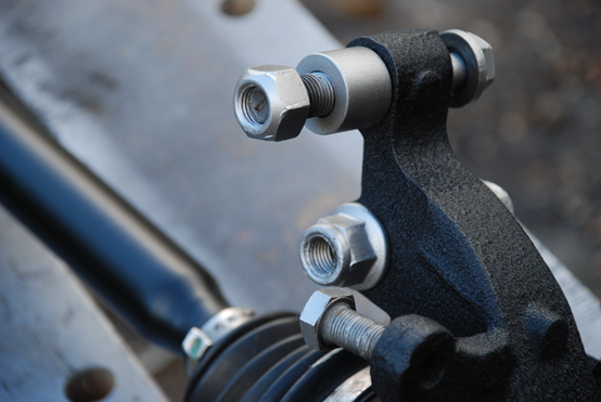

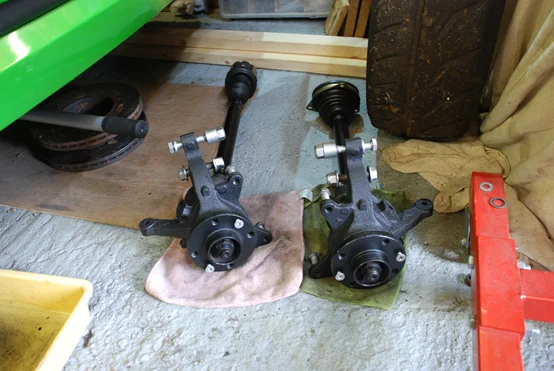

After receiving the ASTs my OCD was going to make it dificult to fit them without doing some refurbishment to the rest of the suspension and brake setup.
So off with the hubs and brakes for renovation.
Ideally the front hubs would have been stripped down with bearings removed and then sent off to be blasted and powder coated but for now I'm leaving the bearings in situ and have doone a quick refurb of the hubs and driveshafts at home.

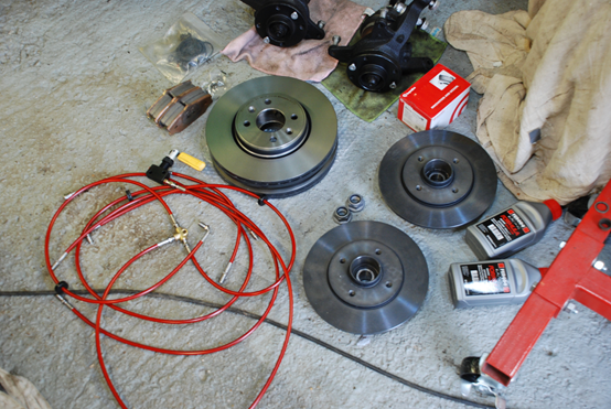

After that I ordered new discs etc from George at RTR and while I'm at it I'll also install the brake lines that Mitch at Proline has supplied.

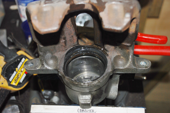

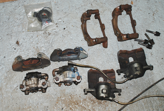

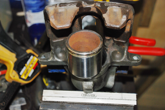

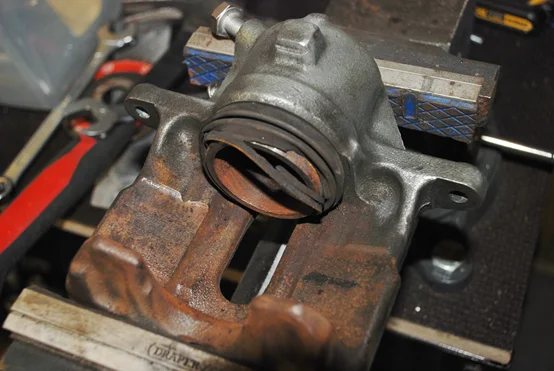

..and brakes removed ready to be stripped
seals were definitely ready for the bin.
Fortunately everything looks fine internally and the pistons are looking ok.
That's as far as I've got with these this weekend.
But during the week I finished the oil pressure guage install and also swapped my water temp guage to a Stack one to match it.

Really?? I take it you've tried these then. What was the problem?
Yeah I have them. Some lines to long, some lines way way way to short.
And it's not only me who's had issues. It's everyone that I've ever come across who's bought them.
From rear calliper to bulkhead on mine was so short. I've had to swap lines from the rear T piece to make it work.
robzracing
Thanks for the heads-up. I hadn't heard anything bad about these before I bought them and Mitch seems to do a pretty tidy job of the stuff he does. I'd better check them all out then and get on to the phone to him if it's going to be a headache.
Annoyingly I had already bought hardline for this to make up myself and only changed my mind at the last minute!
  Audi rs3/Clio 172cup
He did replace a line for me free of charge, but when I went to fit them I had more issues and needed to get them fitted. So I had to bodge it. The lines are good quality and I did see he was after a doner car on Facebook to redesign the kit. Hopefully you have the new kit that's fits.

Quick question: are you using the standard plastic timing belt tensioners/rollers or are you using the PMS steel upgrade ones?

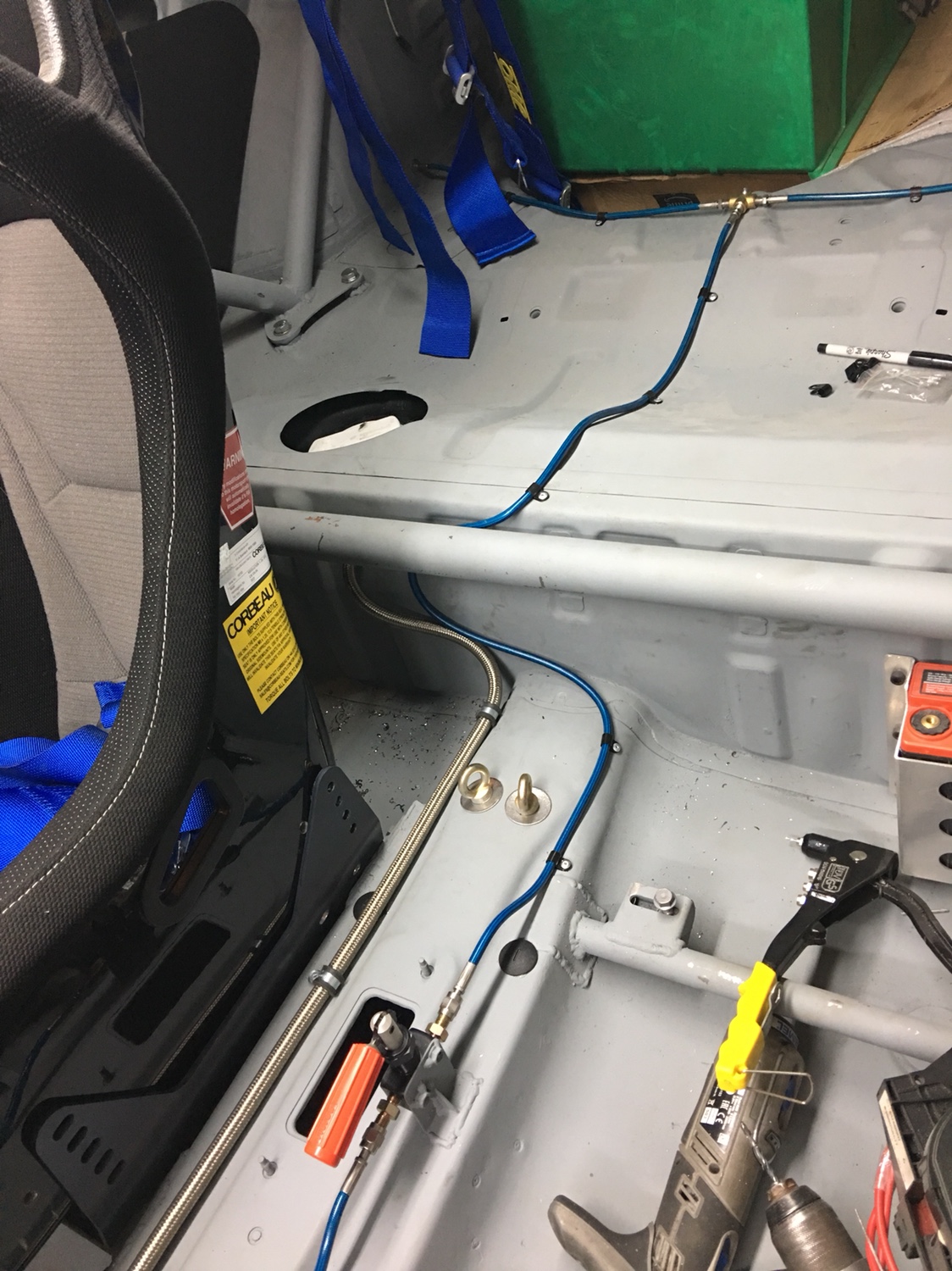

I actually had no issues fitting the kit at all. Apart from one pipe from master cylinder was m10 and I needed both M12 apparently. But Mitch sent one Free of charge next day.
The only slight niggle I have with it is one of the rear pipes a little too long so kinda had to loop it a bit. Other than that, all bitching ha ha

Using the standard tensioners. I'm not too concerned with these as I'm sure the engine will be apart again long before these get close to needing replacing and I'm not tensioning the belt any further than standard. (Although I know Nick at PM does tension his higher than standard)
These could be famous last words of course!
robzracing
The only slight niggle I have with it is one of the rear pipes a little too long so kinda had to loop it a bit. Other than that, all bitching ha ha View attachment 1344518
I was going to ask you how you found yours! That's good to know, although I don't think you've got exactly the same kit as me. I don't have a tee piece for the front brakes like yours. Mine come straight from the MC left and right, so I'm only capping one outlet not 2.
