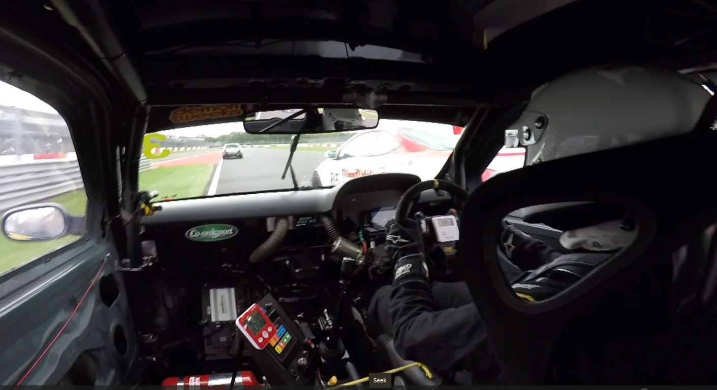

No GoPros for the Brands Hatch race. They hate the heat! So I cobbled together the VBox footage. If you can stomach the poor quality the racing gets more interesting about 15 minutes in.

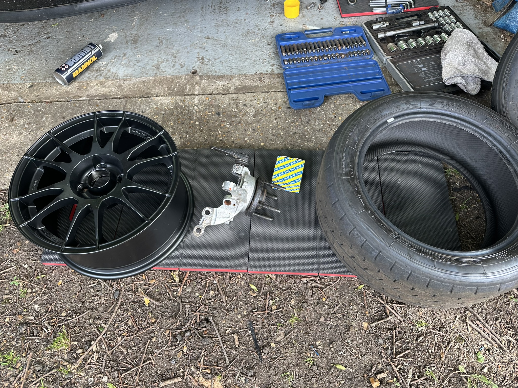

Not happy with the new wheel bearing which has a small amount of movement in it, the hub is off again to have another bearing pressed in. this time a better quality SNR one.

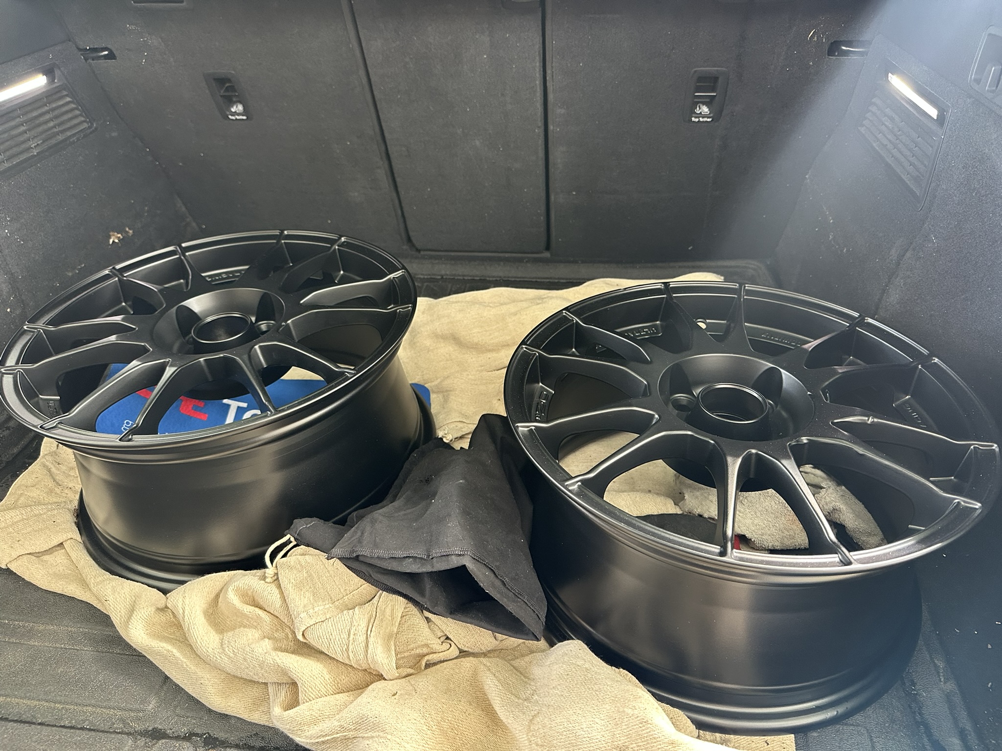

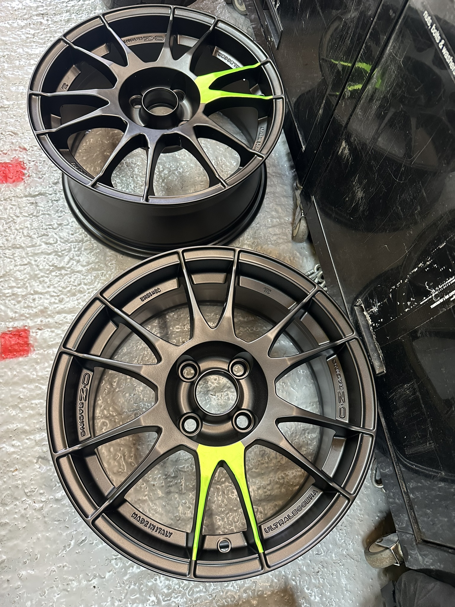

I also collected 2 wheels from the powder coaters one from the crash at the end of 2024 that will stay as a spare and the other a new one that replaced it at the end of 2024 but was only available in Bronze at the time so had had a rattle can finish until now.
Tyre will be fitted this week too.

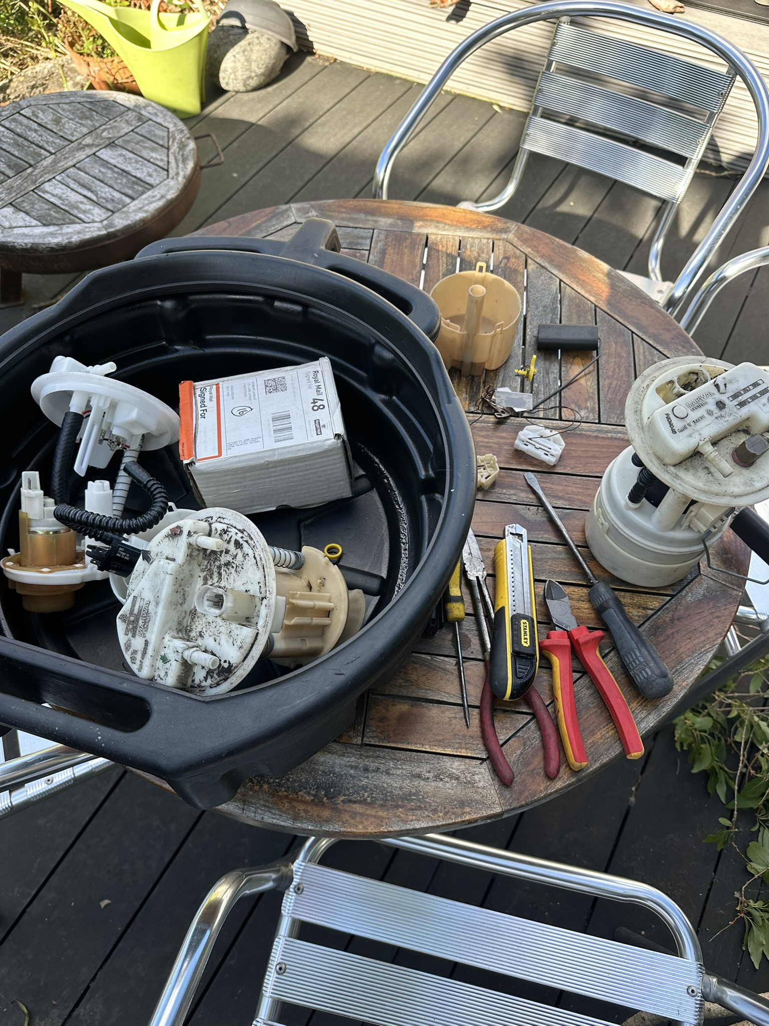

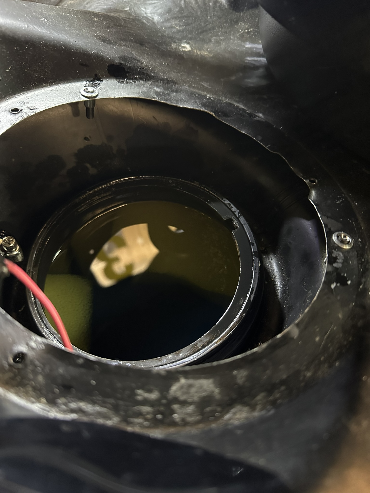

After this I turned my attention to the fuel system yet again, starting with the filter which after stripping (yet again) proved to be clean as a whistle. So then it was on to the tank.
The symptoms at the end of the Brands race was fuel starvation, so the best result here would have been a near empty tank and we could chalk it down to human error. Alas, still plenty of fuel in the tank!

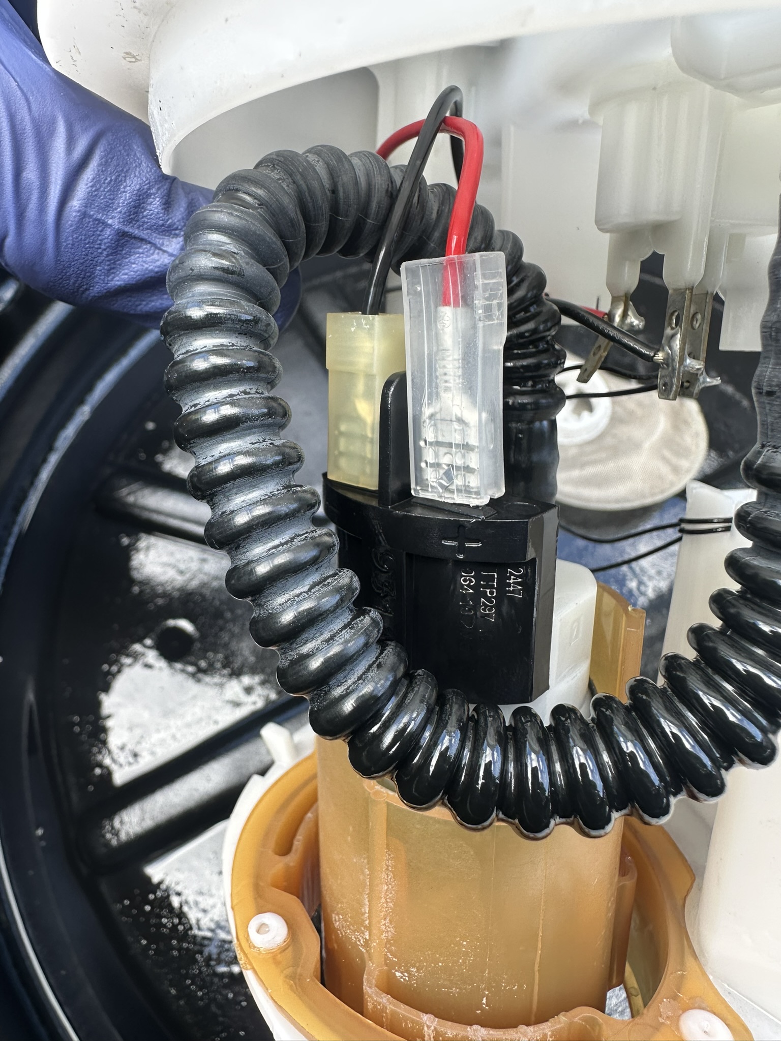

So, the lift pump came out again and that's where things started going to s**t.
All my own doing mind. I had a Walboro uprated pump sitting on the shelf so decided to swap this out with the existing one incase the pump was on its way out.
Unfortunately though it's not so easy to swap these pumps. the Walboro needs some adaption to the housing to fit and the flexi hose needs to be attached. But this did not come off the exisiting unit without a fight. In fact, it wouldn't come off at all without cutting it! And that left me wthout a hose. The Walboro comes with a small piece of rubber hose in the kit but it is no where near flexible enough. I had to can the whole idea and pulled all my spare pumps out to try and find a good one. It was getting messy.
None of the pumps are the same with one probably from a phase 1 with an integrated regulator and the other without a fuel return line but had been adapted. (this was the one in the car when i bought it back in 2013) So all I could do for now was try one of these.
After testing the pumps which seemed to work I reassembled everything and tried it. Nothing! I wanted to run the lift pump without the high pressure pump so i could empty the tank, but the one I put in didn't seem to have the strength to pump anything.

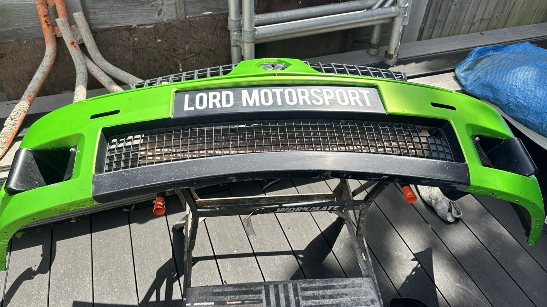

So, with that headach shelved I moved on to some cosmetics.

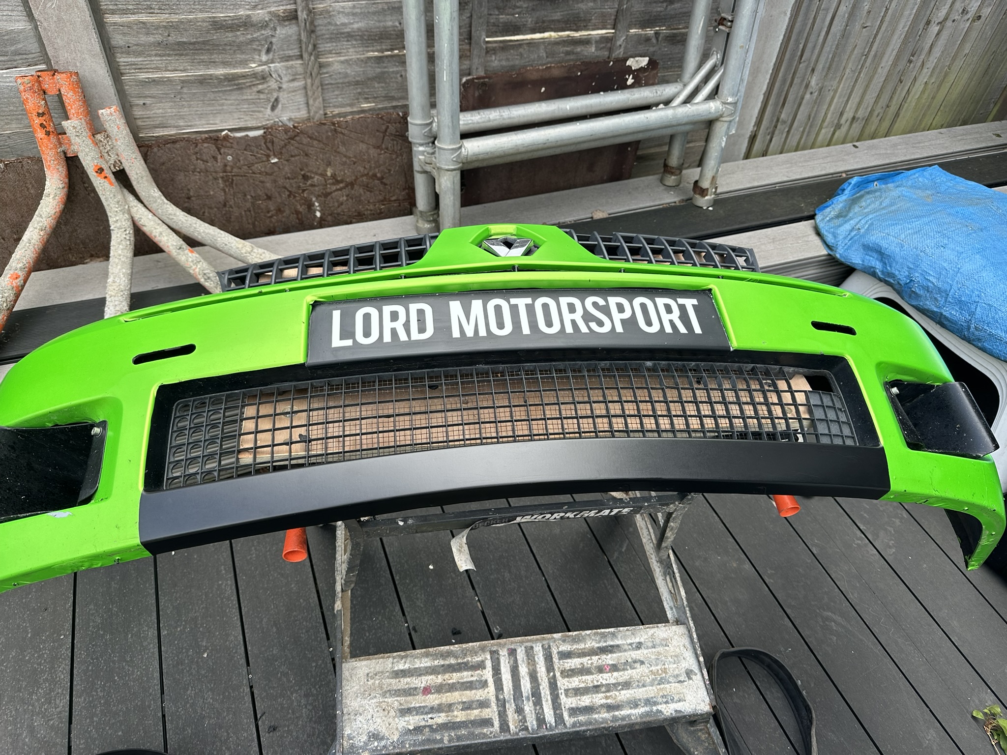

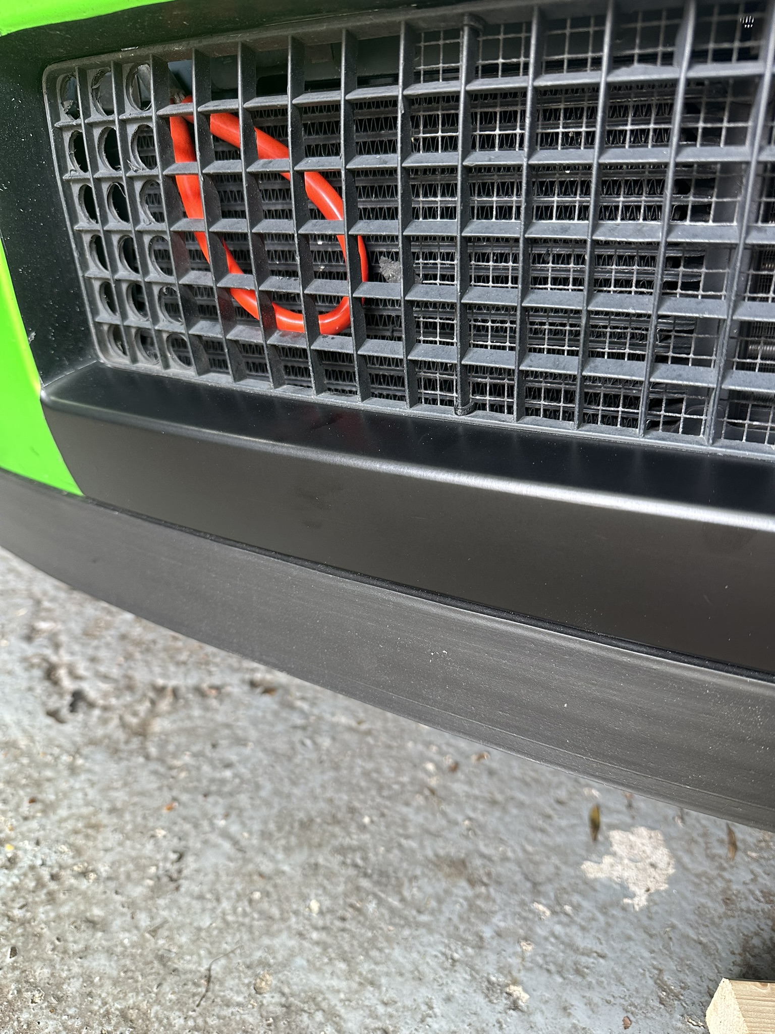

the front bumper was looking a little tired and the rubber lip has been bothering me for a while, so recently I ordered some 50mm lawn edging which I've seen used before to replace the lip and also add a little more protection to the oil cooler which sits slightly lower than the bumper.
I had to tidy the chipped black strip first by wrapping it.
We'll see how long this lasts!

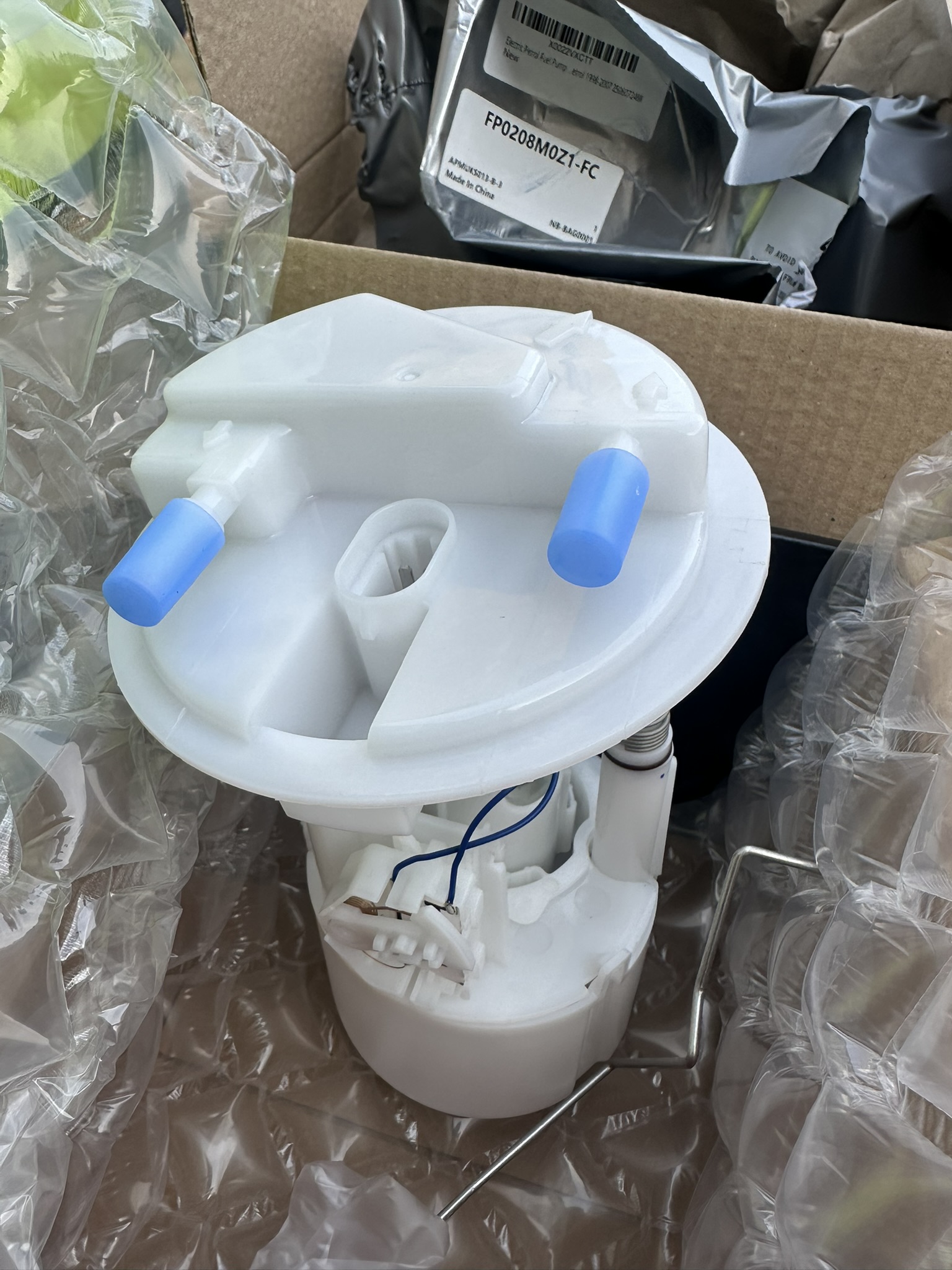

New lift pump assembly arrived in the week along with the front hub with a far better quality SNR bearing from PMS pressed into it. Feels much tighter.
Need to check the camber setting once on some level ground but much happier now.
With the new pump installed it immediately sounded much healthier and I was able to quickly pump all the fuel out of the tank. So with that companent replaced, the only remaining part not replaced is the fuel pressure regulator.
it was suggested that these can get clogged inside but as mine is at least 13 years ols and never been opened I didn't want to try it without having some new gaskets ready to go back in. no time for that this week. So instead, i ordered a replacement regulator that will come with us to Donington. If the problem returns in qualifying, this can be swapped out, along with a new set of injectors. After that I cannot think what else could be the problem. So lets hope there is no problem anyway!

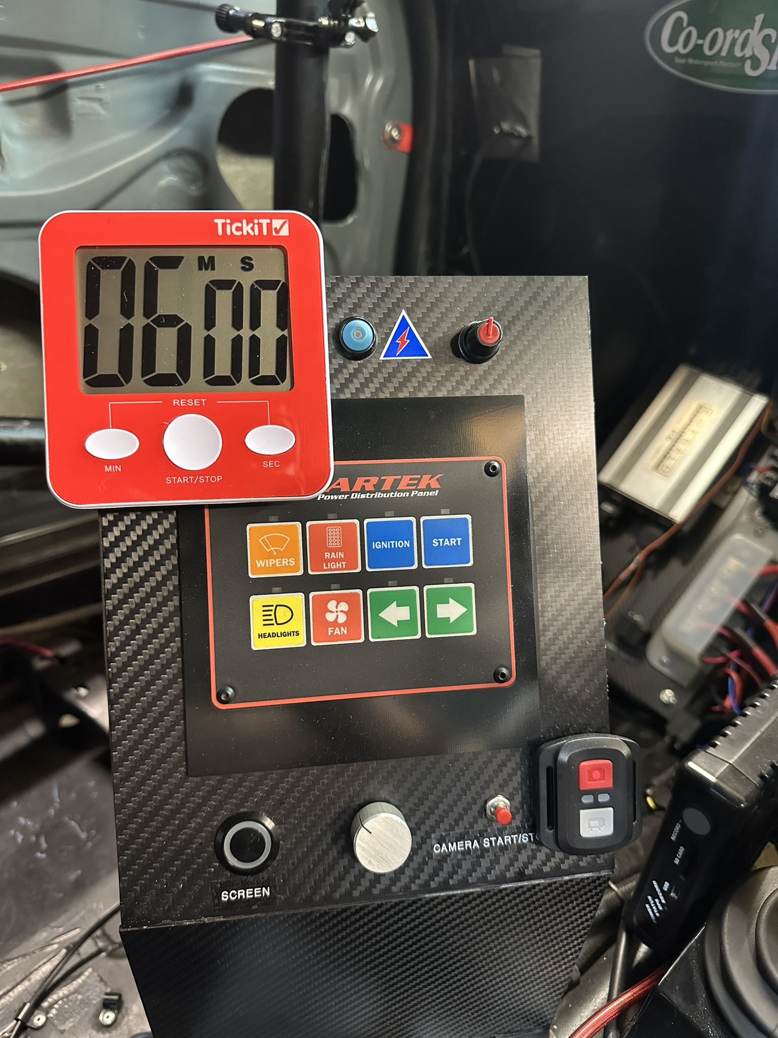

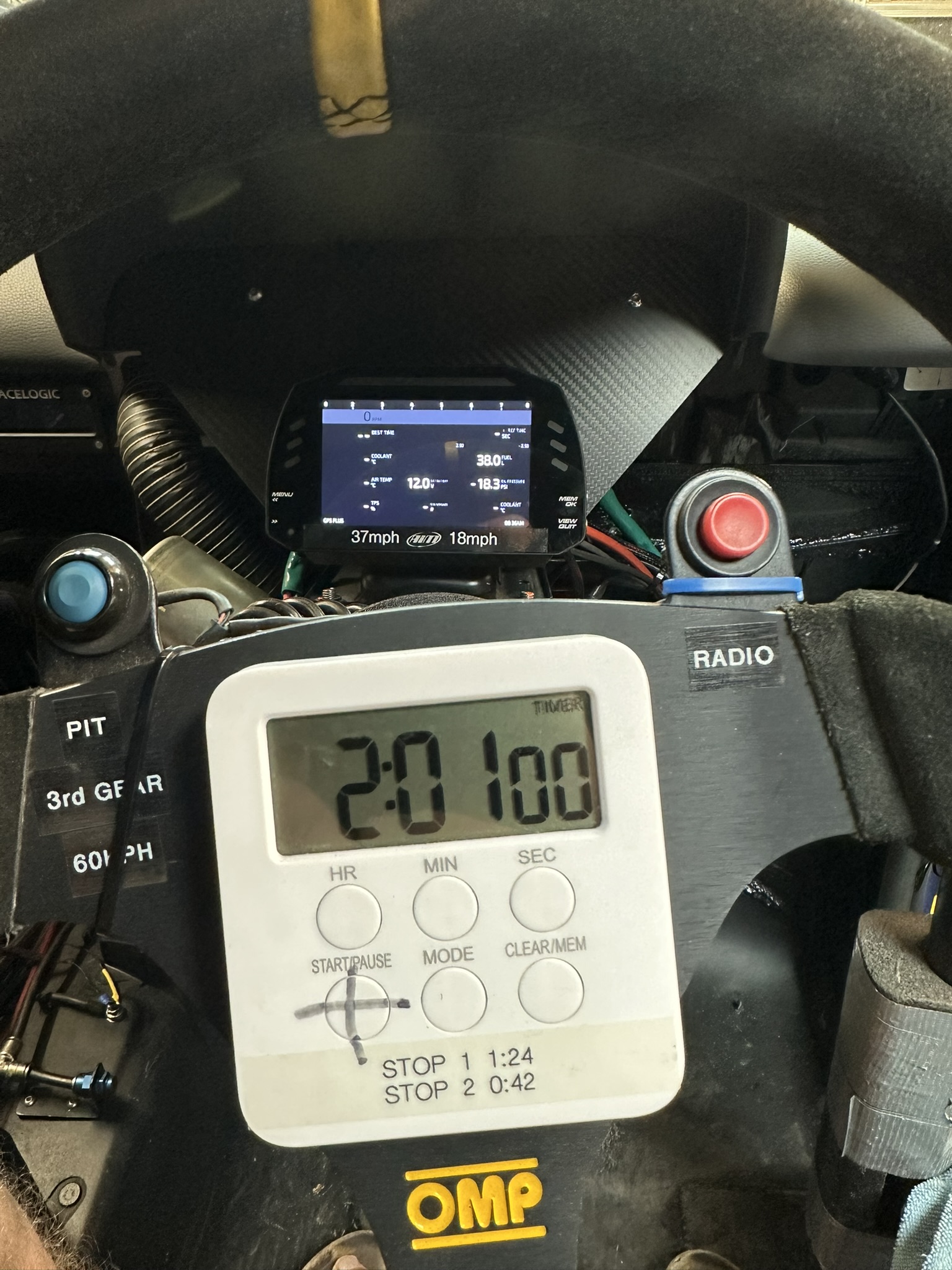

So with all this being the case, I've prepped the inside of the car with 2 timers and some key time and speed information as reminders while we're in the hot seat.
All we have to do is remember to hit the start button on the 6 minute timer as we enter the pit lane and then watch the speed.

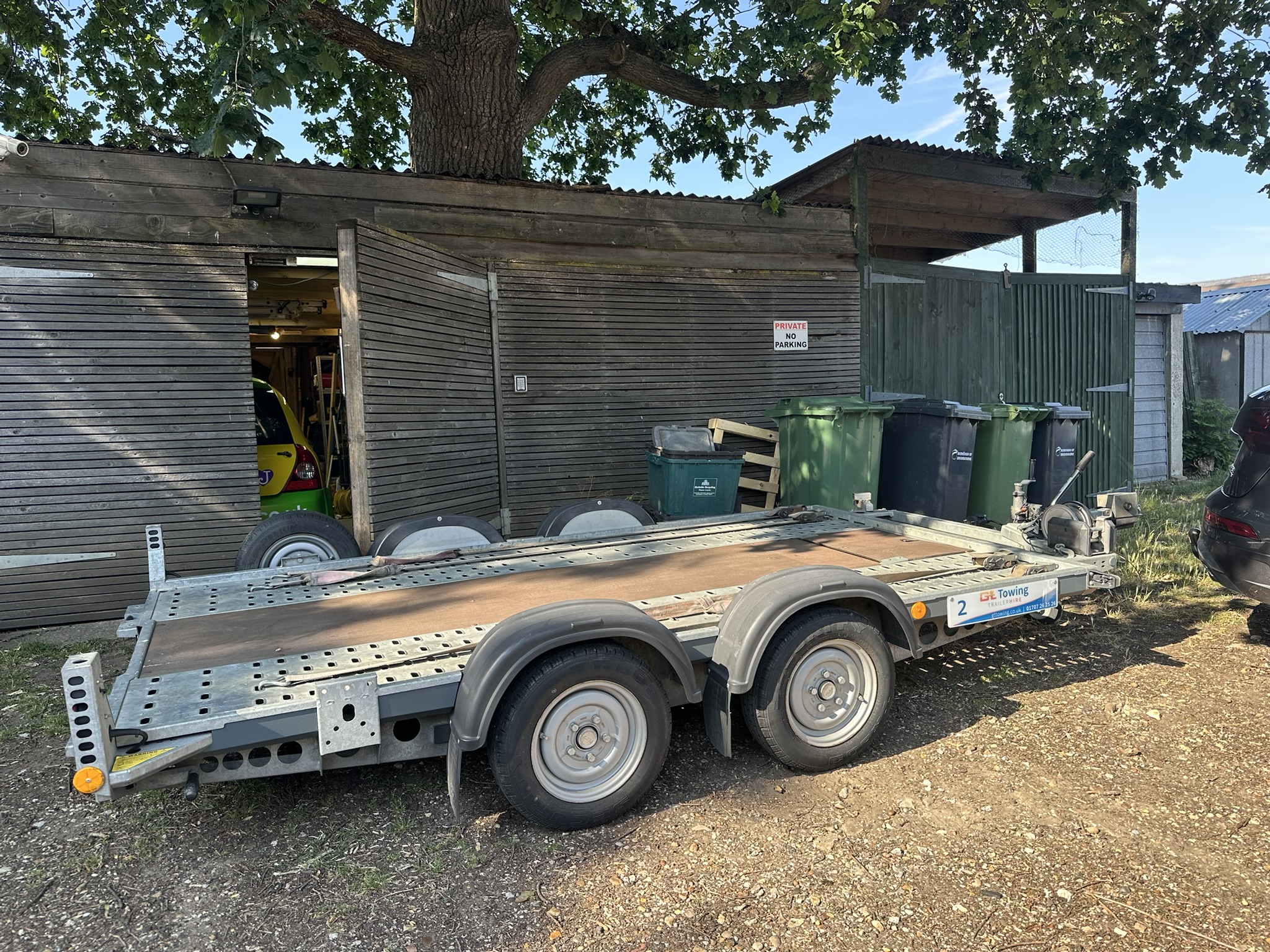

And so with everything back together, I collected the trailer this evening and tomorrow morning will be spent packing and loading ready to set off around 3pm Saturday afternoon.

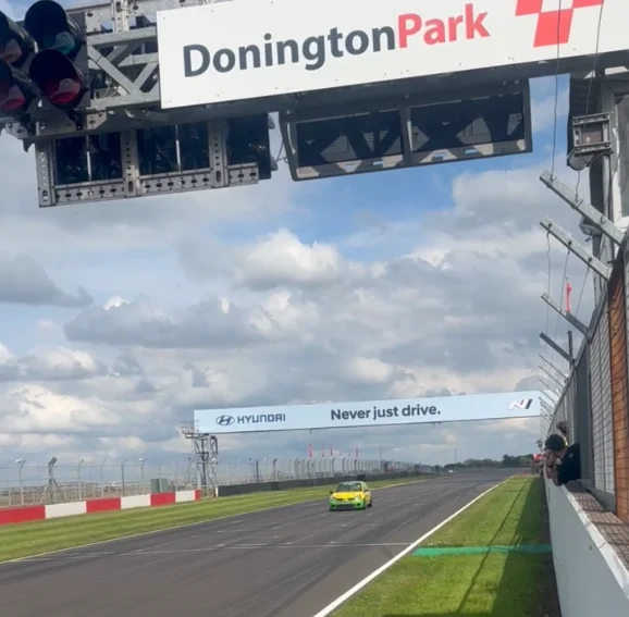

Donington 2 hour endurance 21st June
Well that was stressful!
This was the first event of its kind at Donington and the CSCC had put a fair amount of effort in to its smooth running.

As mentioned in a previous post, I had mounted an extra timer in the car set to 6 minutes which we could start as we pitted, allowing us to keep over the minimum time. In theory this was a good idea. More on that later!

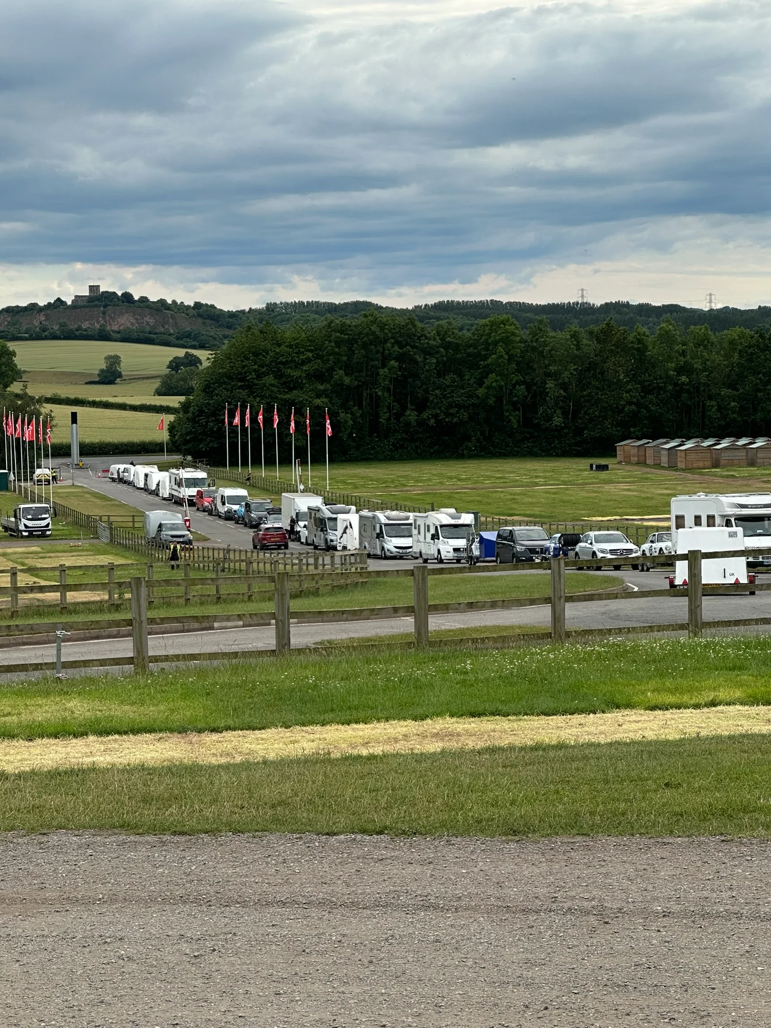

Queuing to the road
I pulled up in the public parking area.
Rob and John both arrived soon after I started setting up so within an hour or so we were ready and headed off to the hotel for some food and an early night.

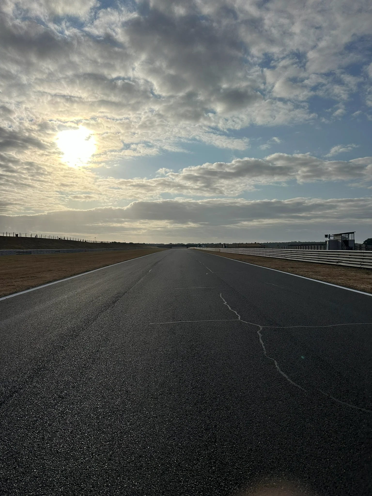

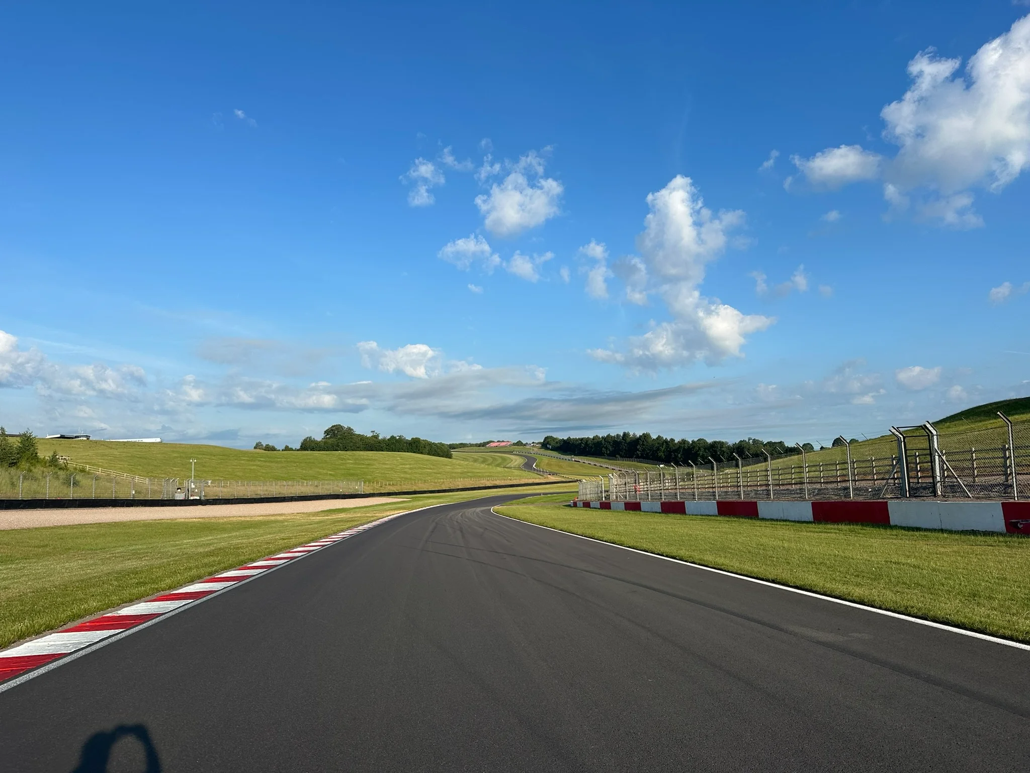

We agreed to an early start for the obligatory track walk at 6:30am and the weather was perfect.
...and joined by Shaun from Recycled Racing who we were sharing a garage with.
Once satisfied that the track still went the same way we remembered, we returned to the garage to prepare for scrutineering and quali.

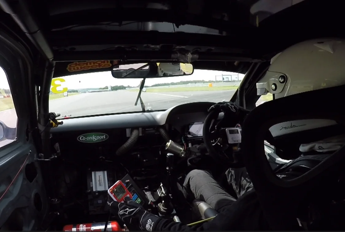

So, as I came to the Pit entry line on the Melbourne loop I was conscious of having to start the 6 minute timer. But I also had to hit the pit lane speed limiter button as I crossed the line and all of a sudden I was patting my head and rubbing my belly and somehow didn't hit the timer button hard enough!
trying and failing to hit the timer!
I only realised as I stopped the car at the garage that the timer wasn't running. So i hit it then and we began a guessing game on the timing!

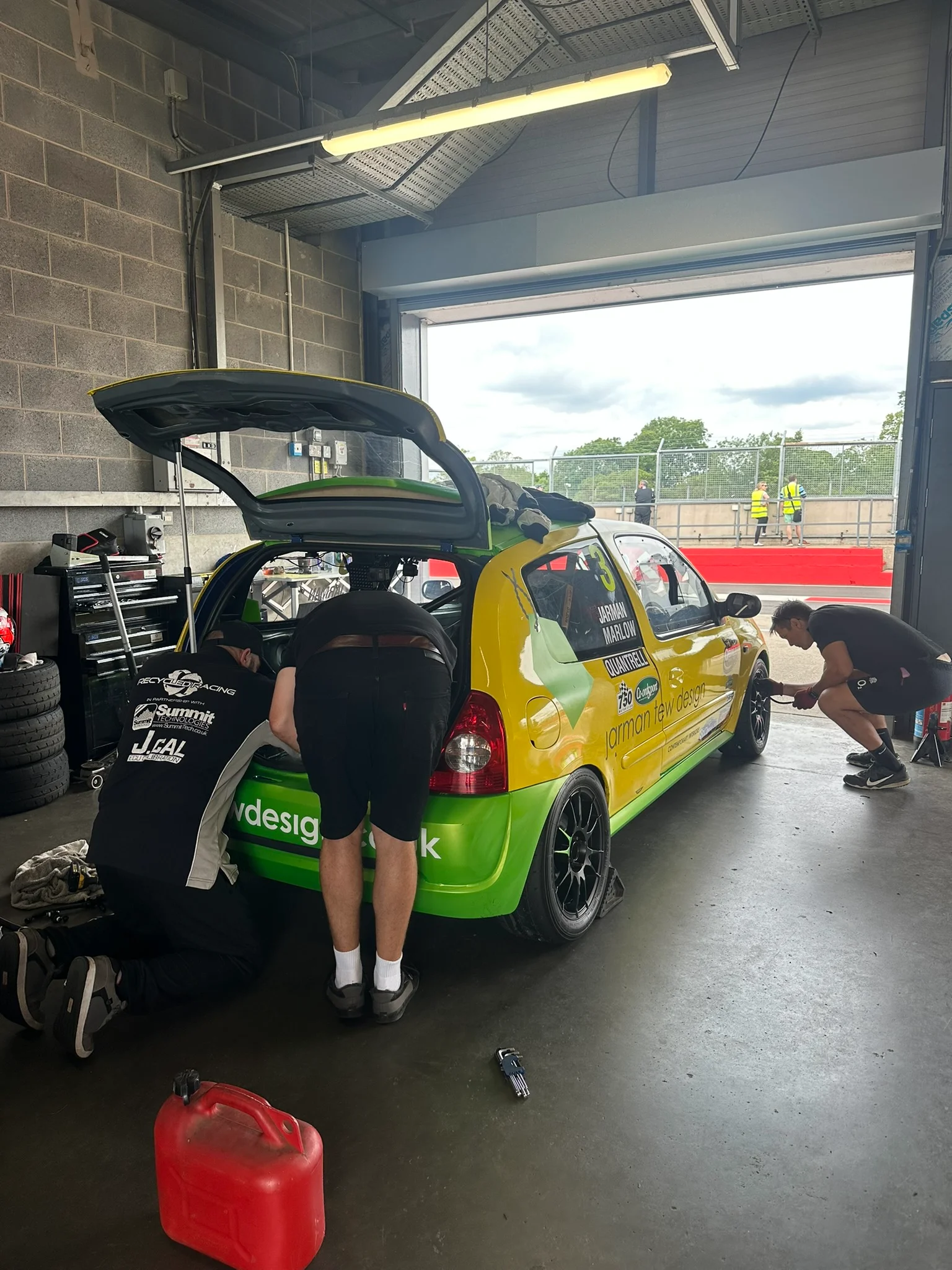

The refuel and driver change went like clockwork though and I had time to warn Rob about the failing clutch and we released him hoping and praying that we got the timing right. And looking at the timing sheets afterwards, we were certainly safe with a 6:38 stop.

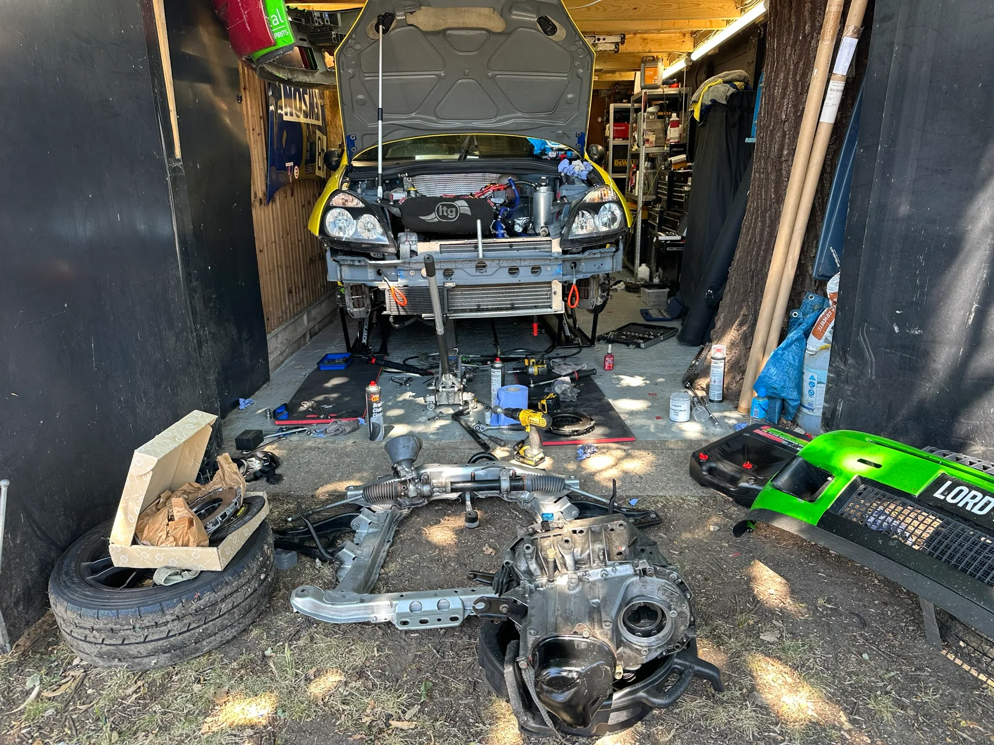

Main job was the clutch change, so yesterday morning got the car up on the quickjacks and started the strip down.
The car is still disgustingly filthy after Donington but that will come later...
Shaun, who we raced against at Donny in the Civic came over to lend a hand as he is going to have a go partnering with me next weekend. Although he's never driven the car, we've been racing against each other for about 13 years. his normal whip is a 205GTi that has been developed over the same sort of time as mine and is pretty much just as quick. In fact, he raced at Cadwell Park last weekend and had an outright win, so it will be interesting to see how he gets on in Clio.
Anyway, after a couple of hours the box was out and we could see what we were dealing with.
Interestingly, there was still plenty of material on the clutch but we could see witness marks on the flywheel bolts.
It transpired that the clutch springs had been bottoming out on the bolts, causing the slip! It would seem that the LUK clutch design is not compatible with a lightened flywheel. Comparing it against the new Valeo unit, there is considerably more clearance from the springs to the clutch face on the Valeo. (unfortuately I didn't get a photo)

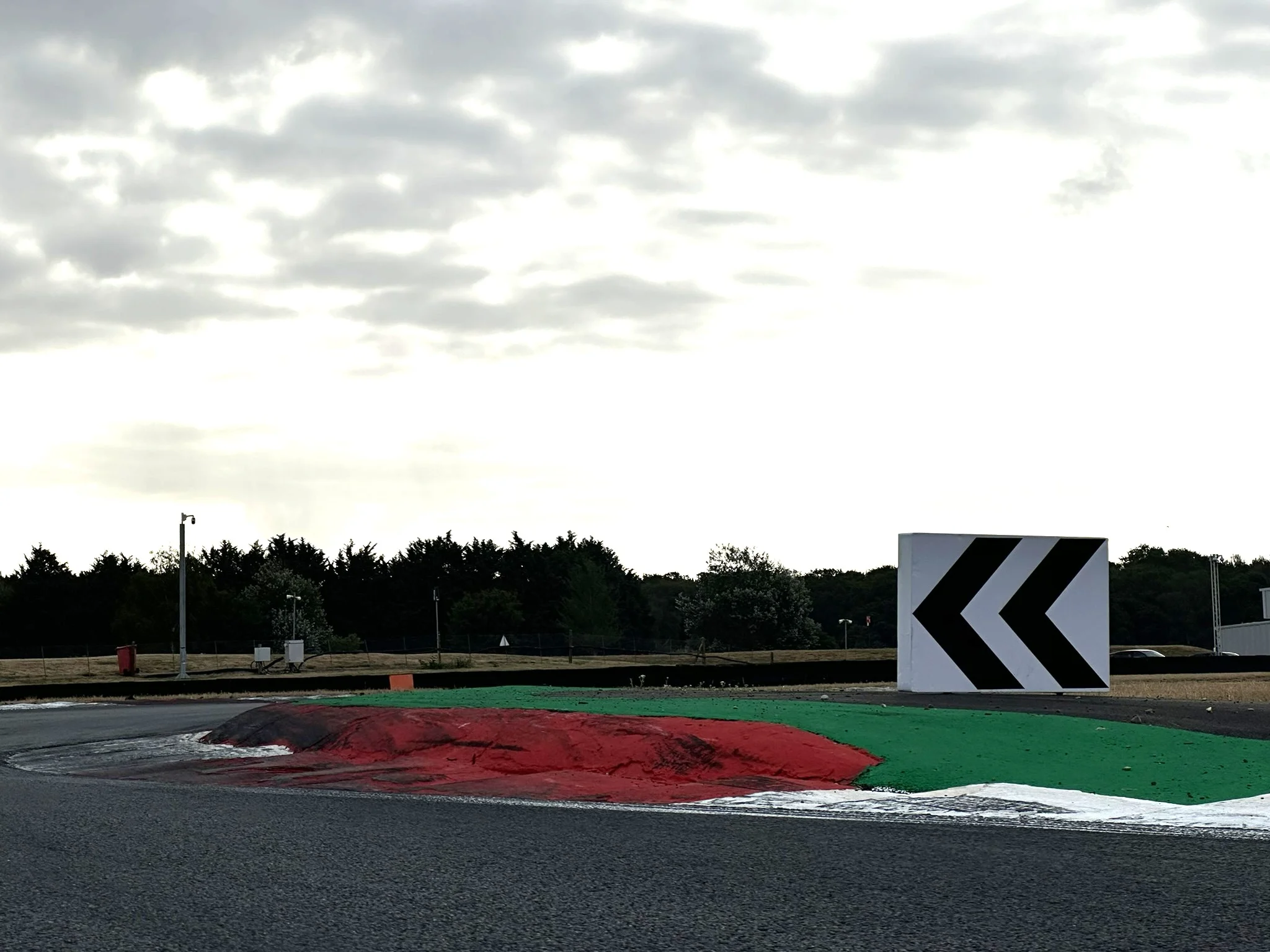

During our walk we also examined the new sausage curbs at Nelson and Murrays. The overiding message being.. Stay well clear or face drama.
Sadly, we didn't pass the message on to everyone..

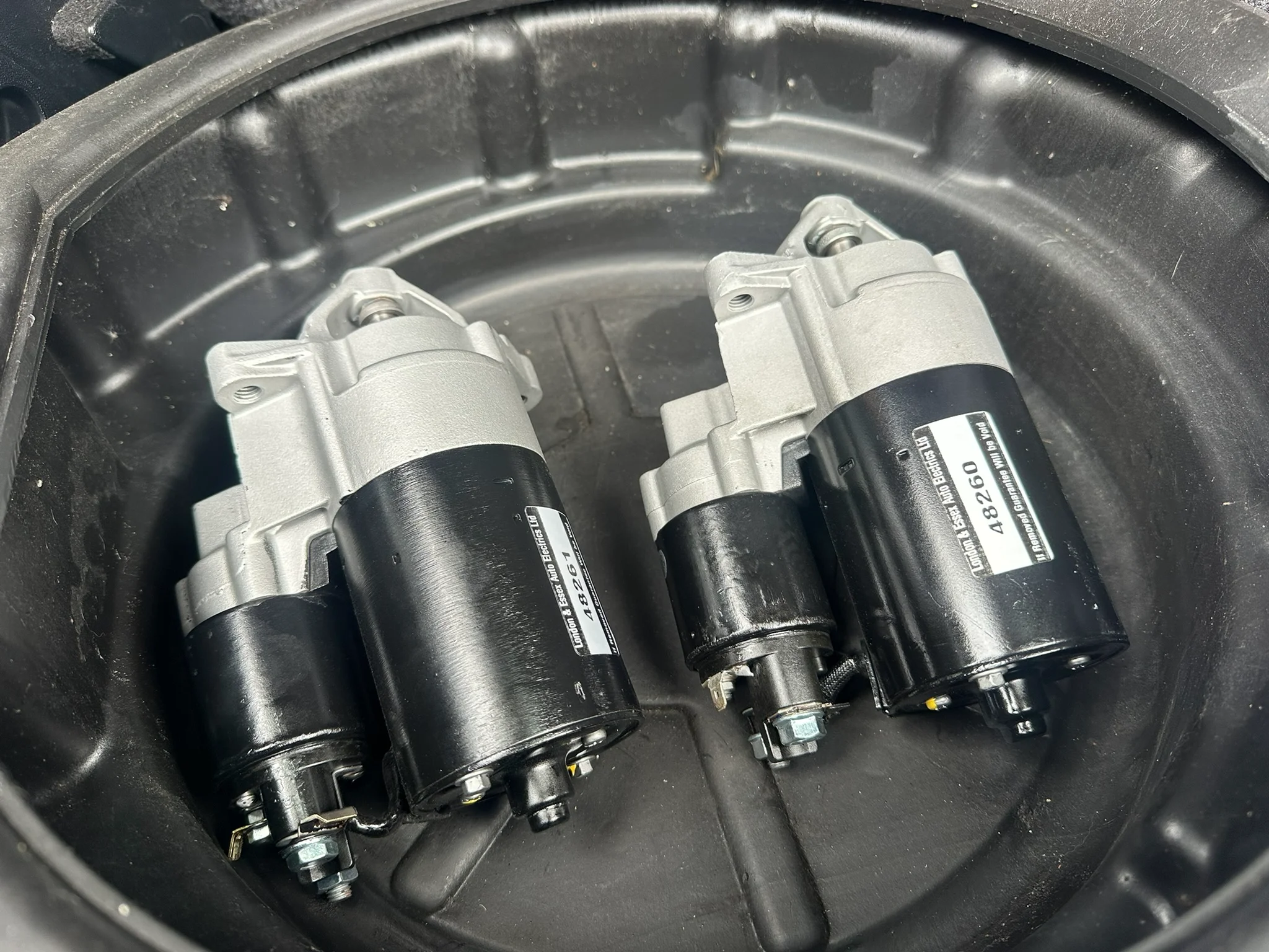

I have seen this before and suspected the starter motor.
The stud that the main lead attaches to had come loose in the body of the solenoid and the subsequent movement caused a short.
Of course, changing the starter motor on these is a bugger of a job even on a race car with far less clutter in the engine bay so you can imagine my reaction after fighting to get my spare starter on only to find it was also f***ed.
I had one more spare but decided rather than face the same thing happening (and probably torching the car as a consequence) I would take all the starter motors to be refurbished.
a day later 2 starter motors refreshed and one in the bin as it was irrepairable.
Cheaper than a new starter motor and guaranteed for 12 months too. £80+VAT each if you're interested.

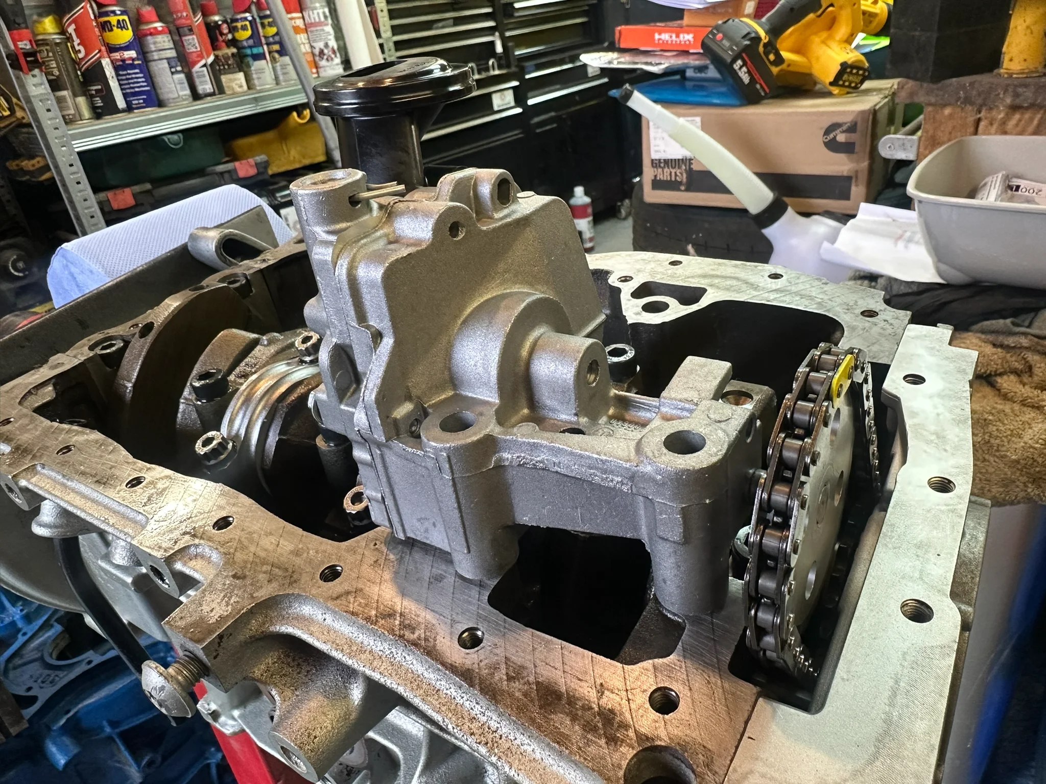

I've now turned my attention to the new engine. Starting with buttoning up the bottom end.

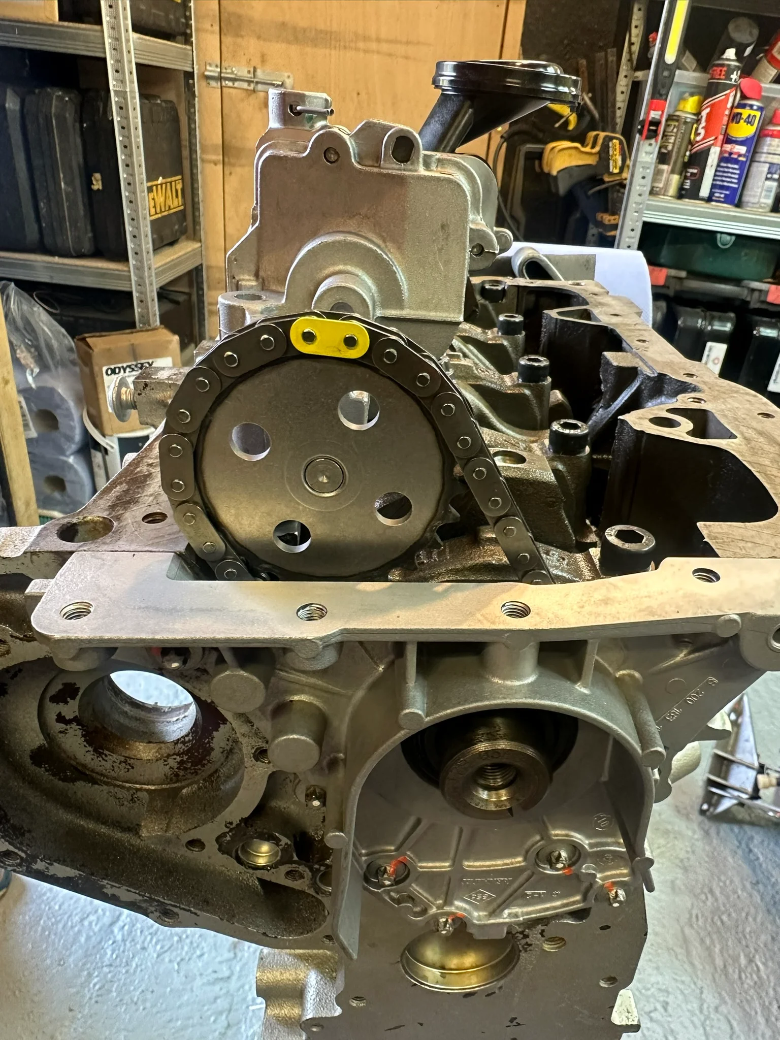

Not much to do here but I have the uprated oil pump which i installed at the weekend but this needs some fettling to the sump which is as far as i have got up to now. Hopefully tackling this tomorrow.
Should be interesting to see how this turns out.

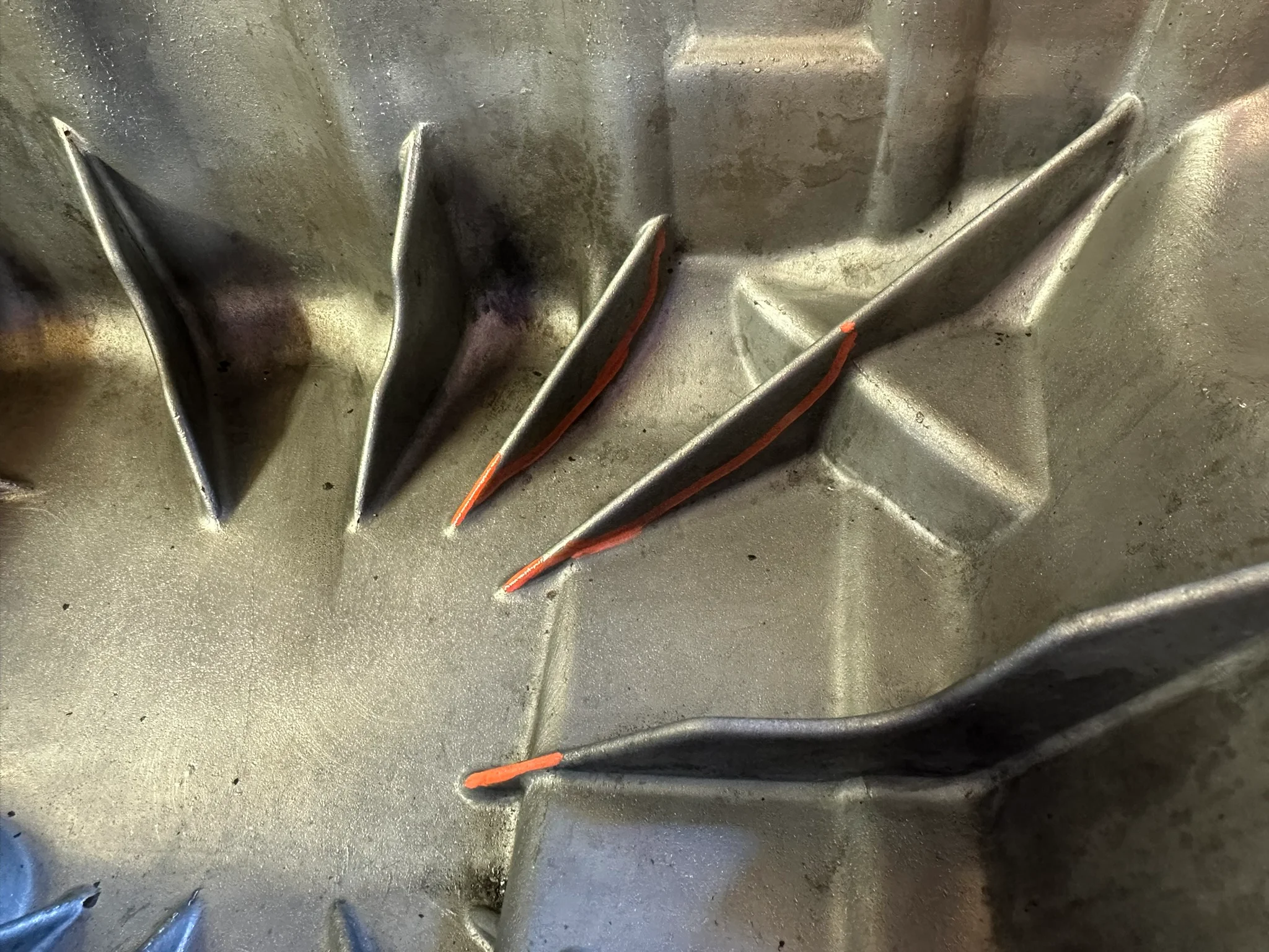

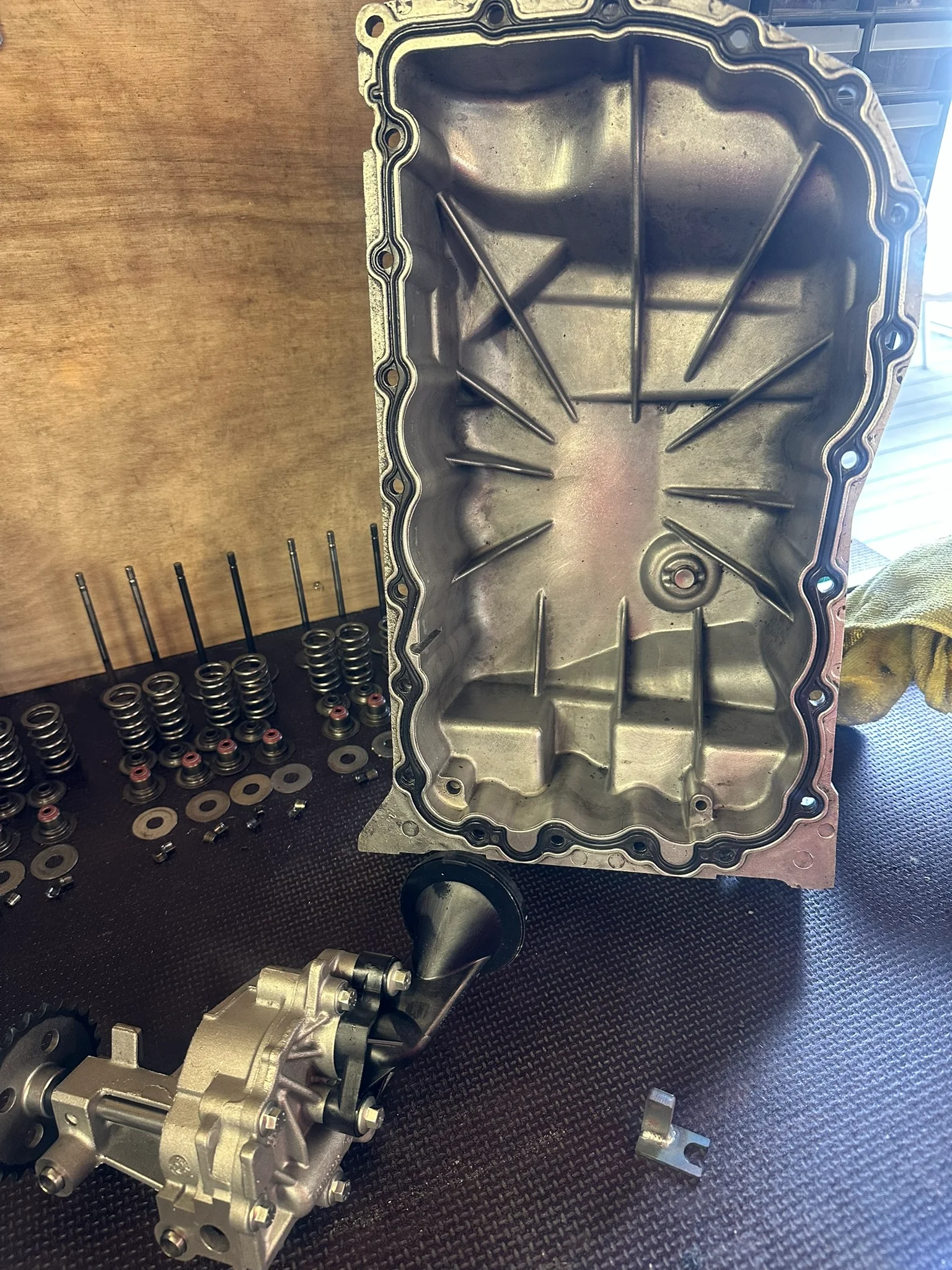

A quick update after spending the afternoon getting this oil pump installed.

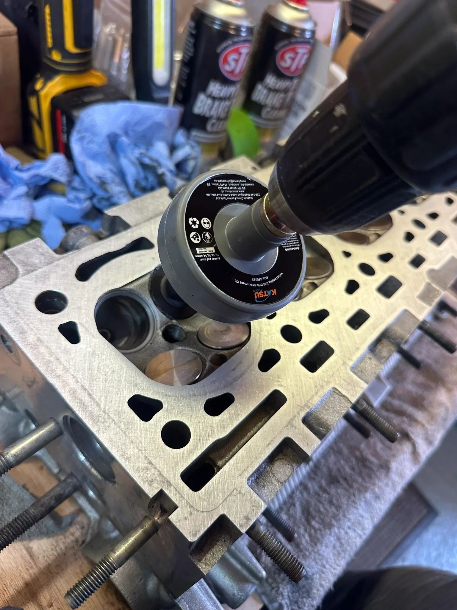

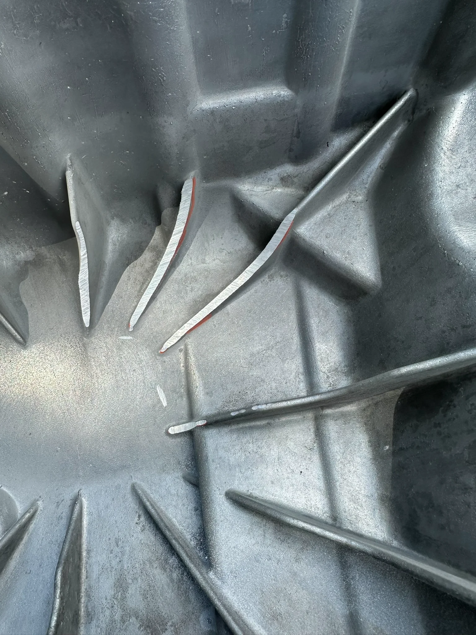

Started with drinding out the fins in the sump as per the instructions. Went better than expected and cleared the pump on the first attempt!

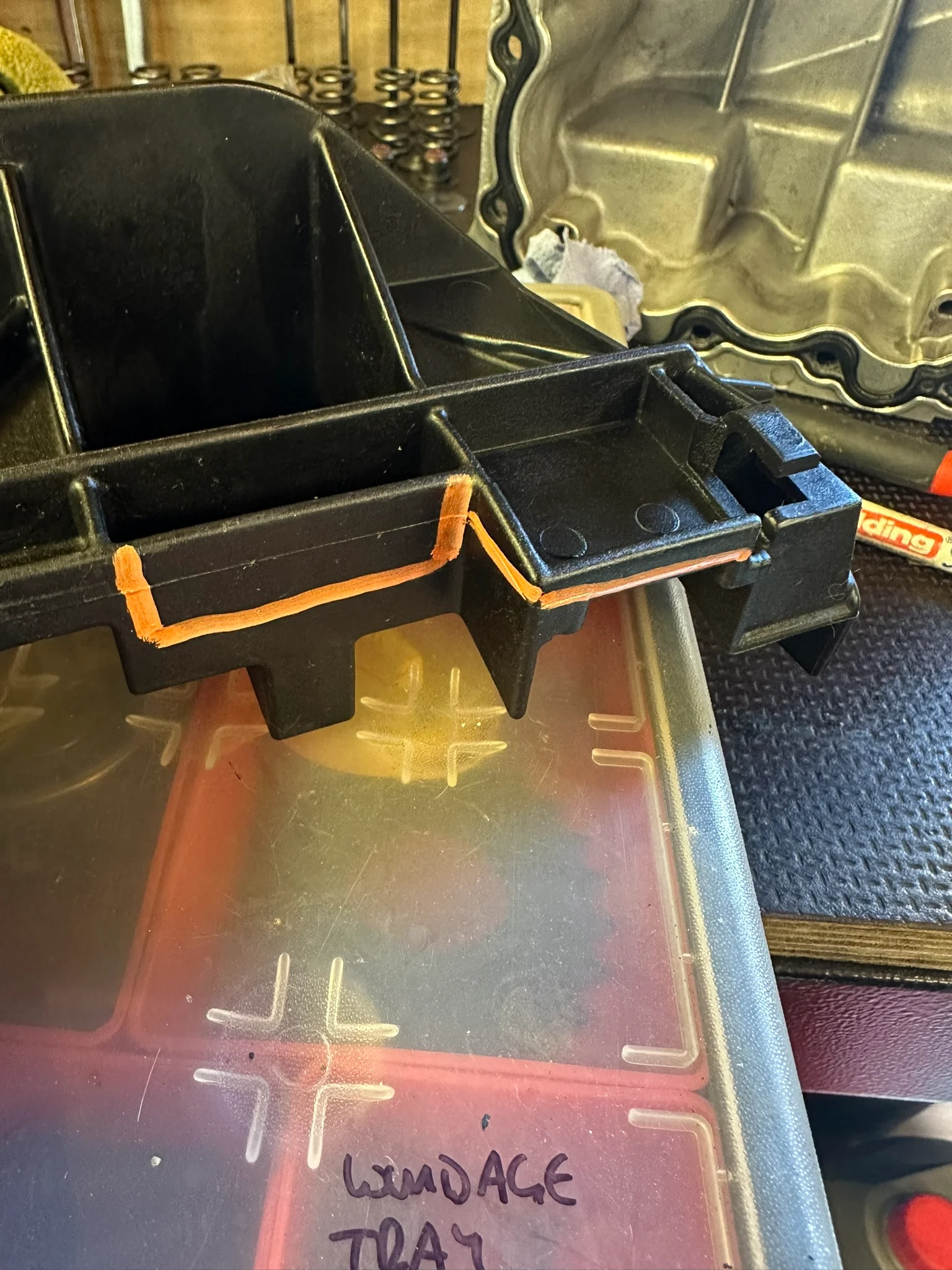

After this I turned my attention to the windage tray. I had heard previously that some versions of this do not fit without trimming although this isn't mentioned on the PMS site.
I marked the areas to trim and then filmed a short video to explain for anyone else who tackles this upgrade.
After that I just continued fitting and sump and torquing up the bolts, then fitted the plastic cooland pipe, the water pump and pulley and generally collected together everything I need to reassemble before moving onto the head.

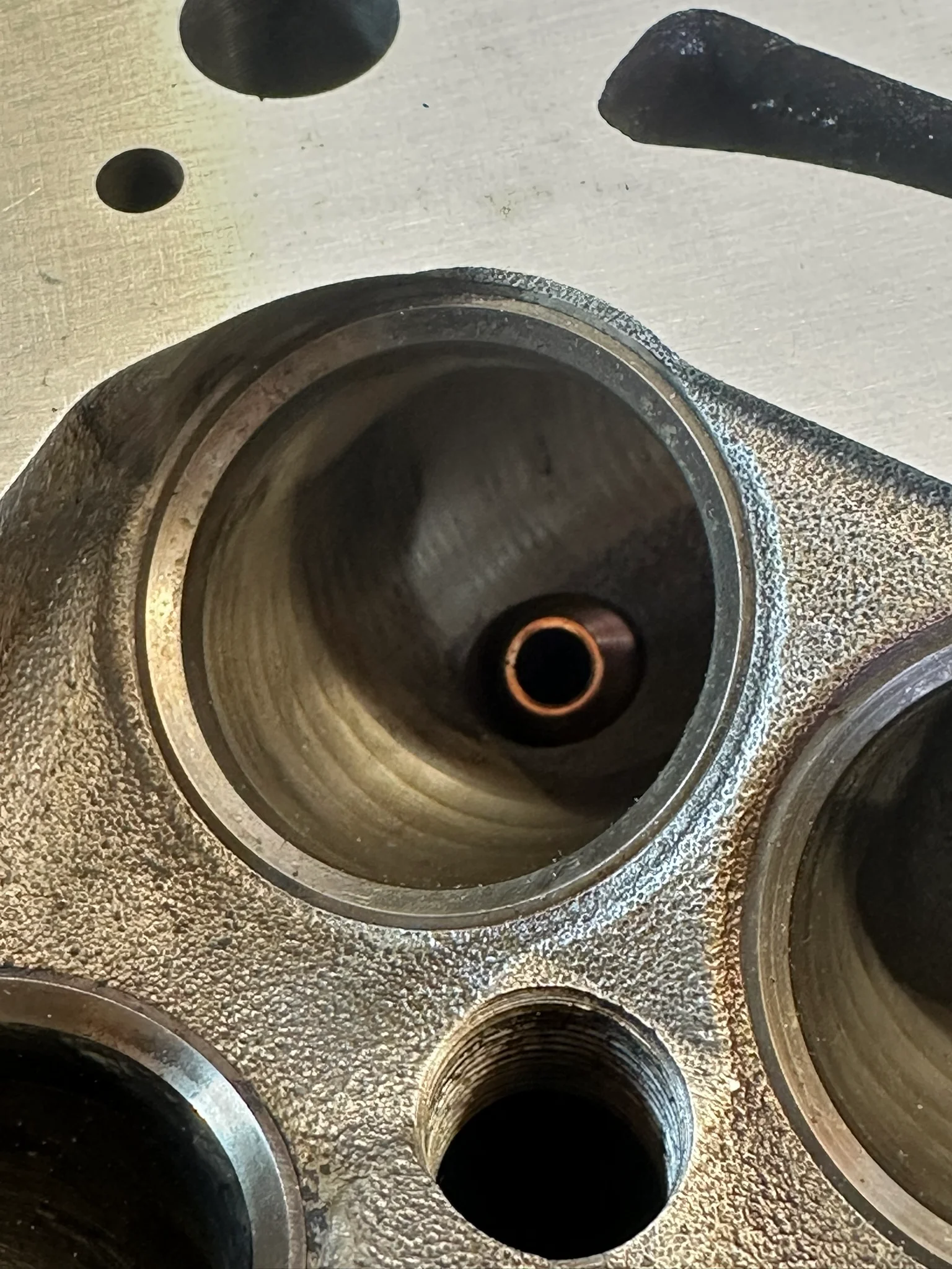

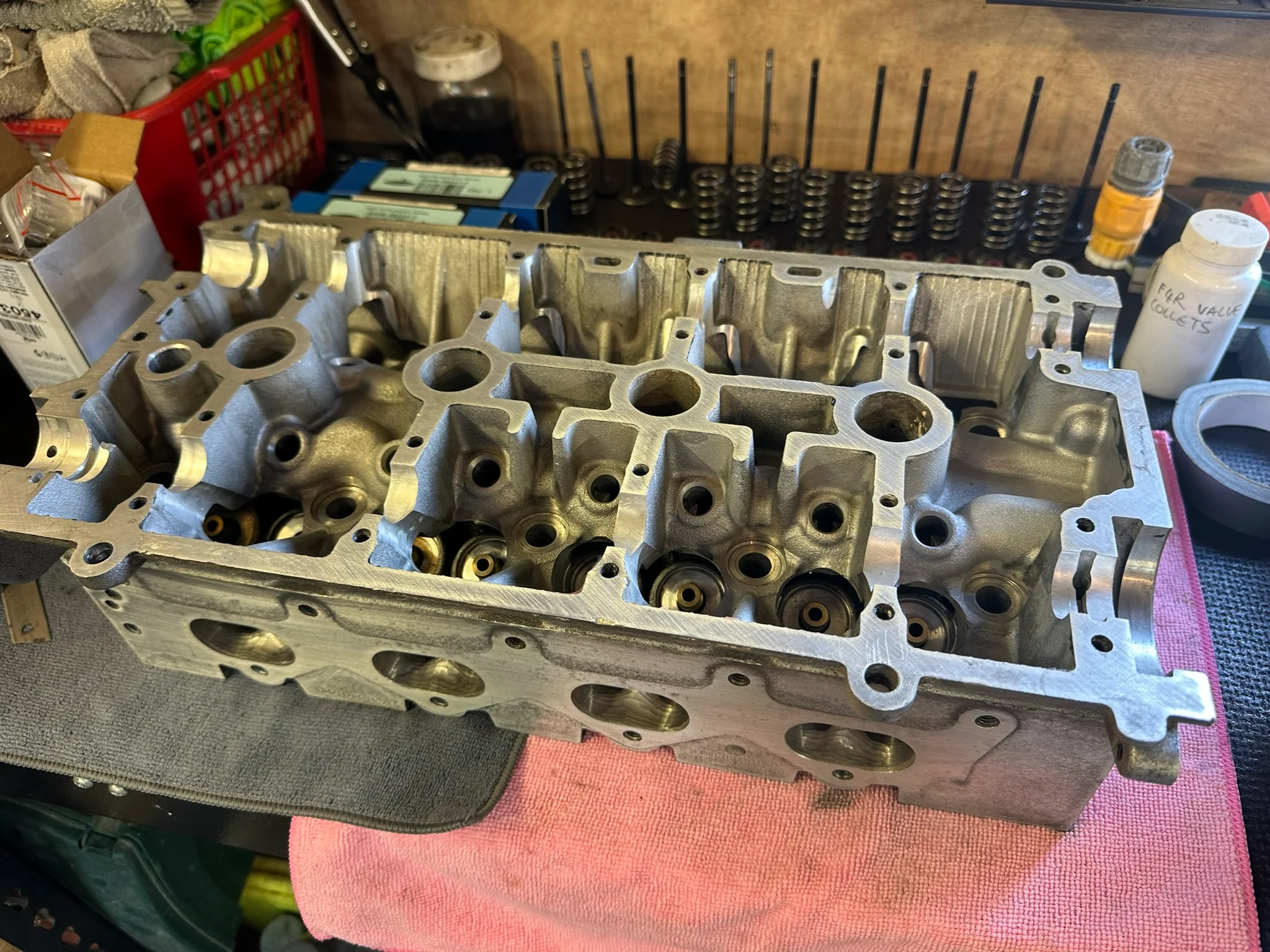

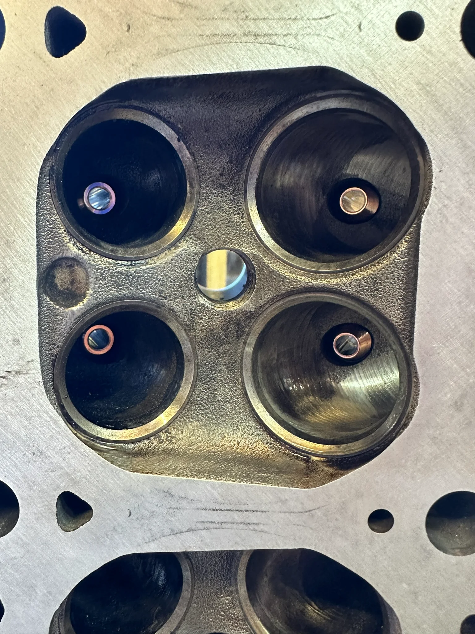

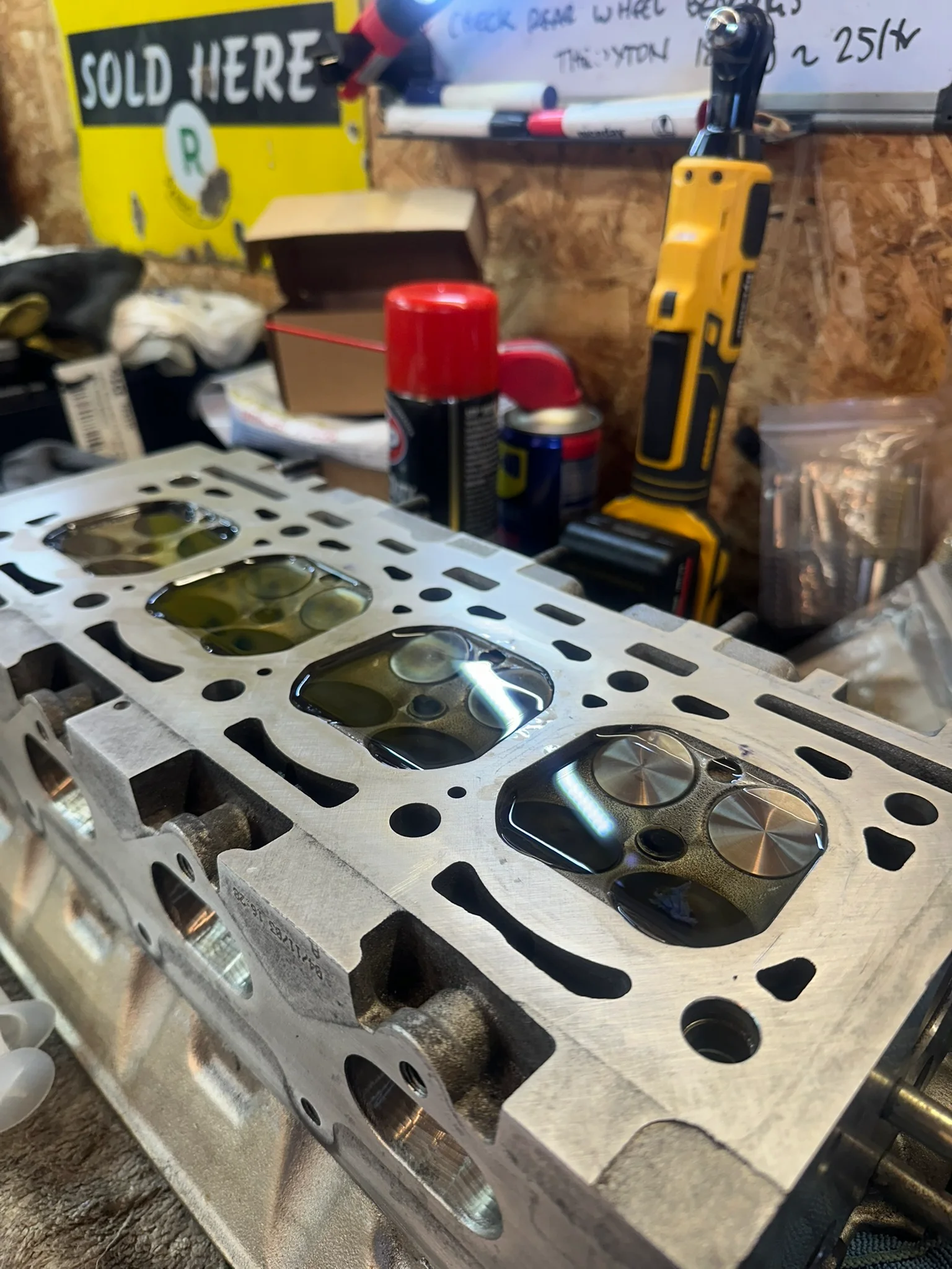

Made a start on the head these last couple of days. Stripped out the old valves and cleaned and dressed all the surfaces ready to remove the guides.
there's some minor scoring on the cam journals but after a quick call to my engine builder he assured me that there is nothing to worry about as long as there are no high spots. (I do have another head from a 182 which has better cam journals but needs a good clean so this may get prepped as a spare)

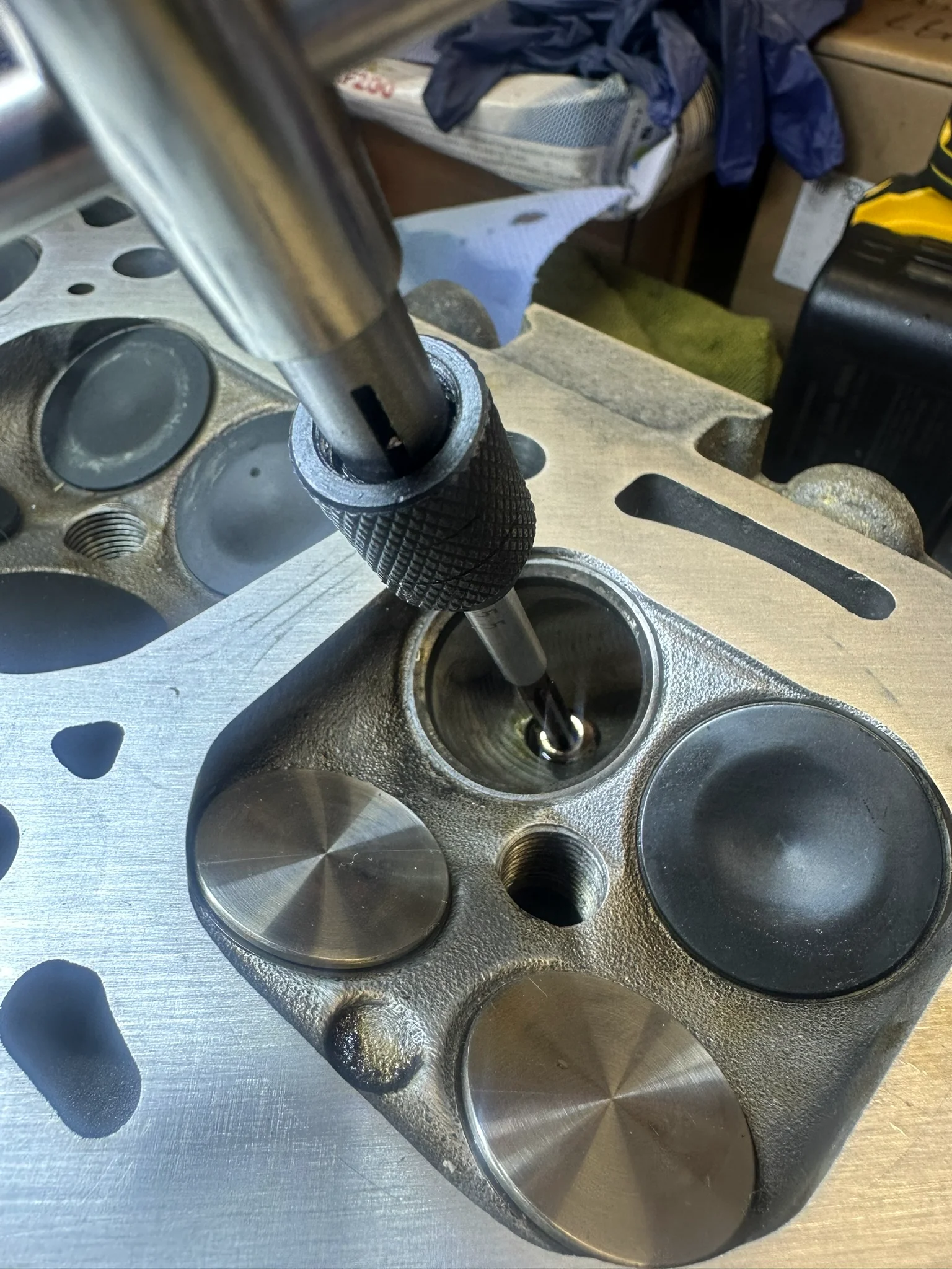

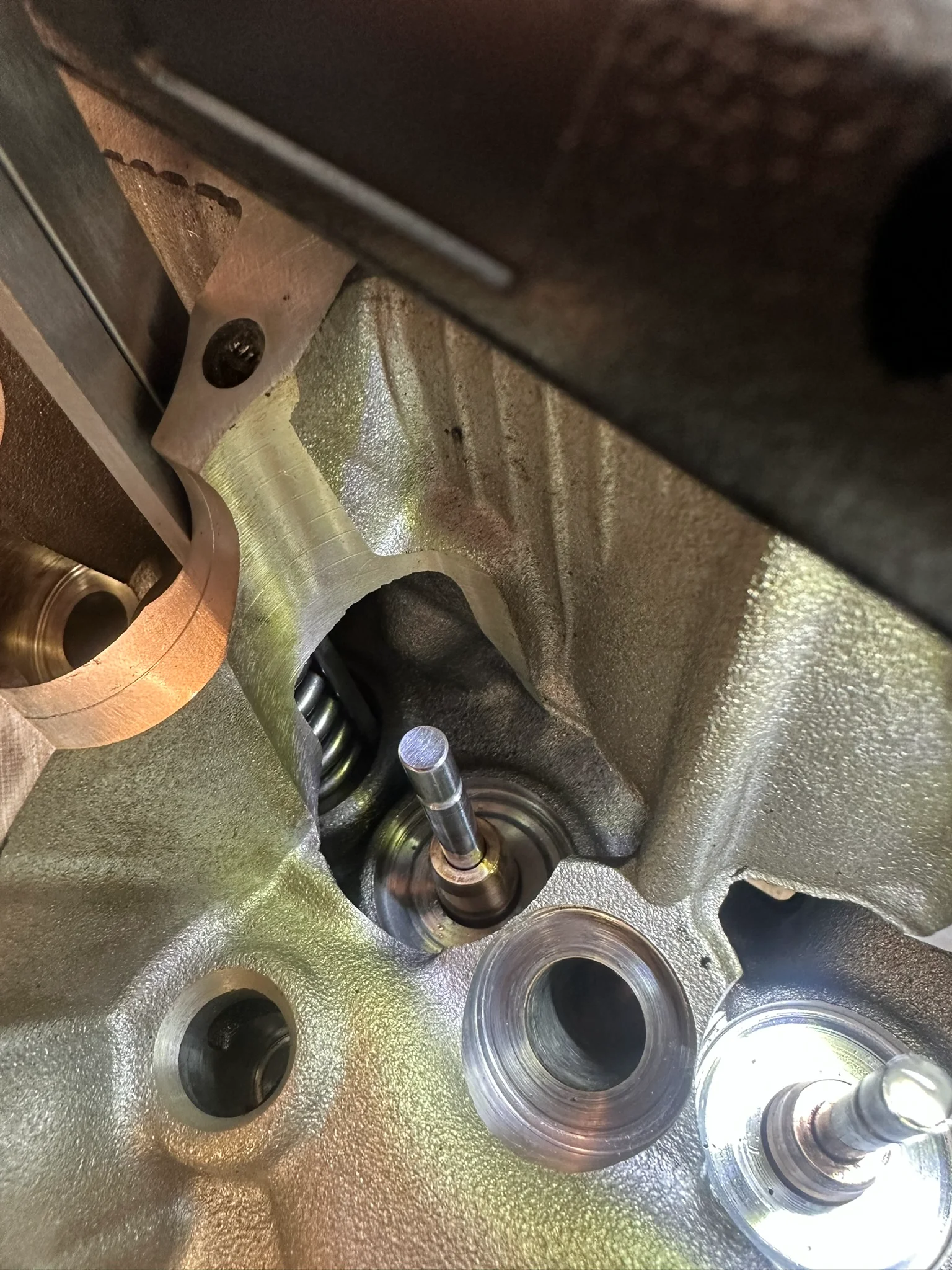

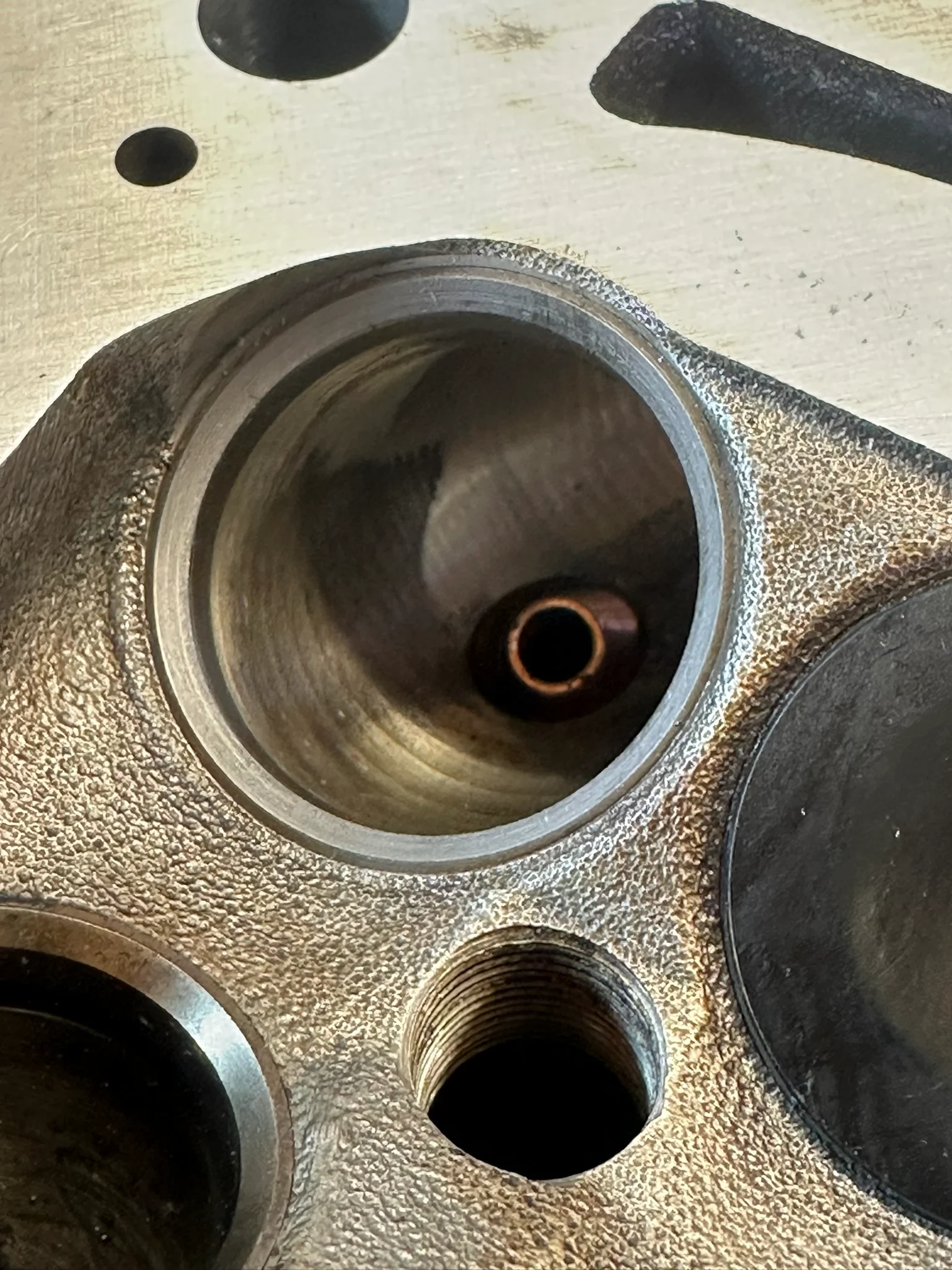

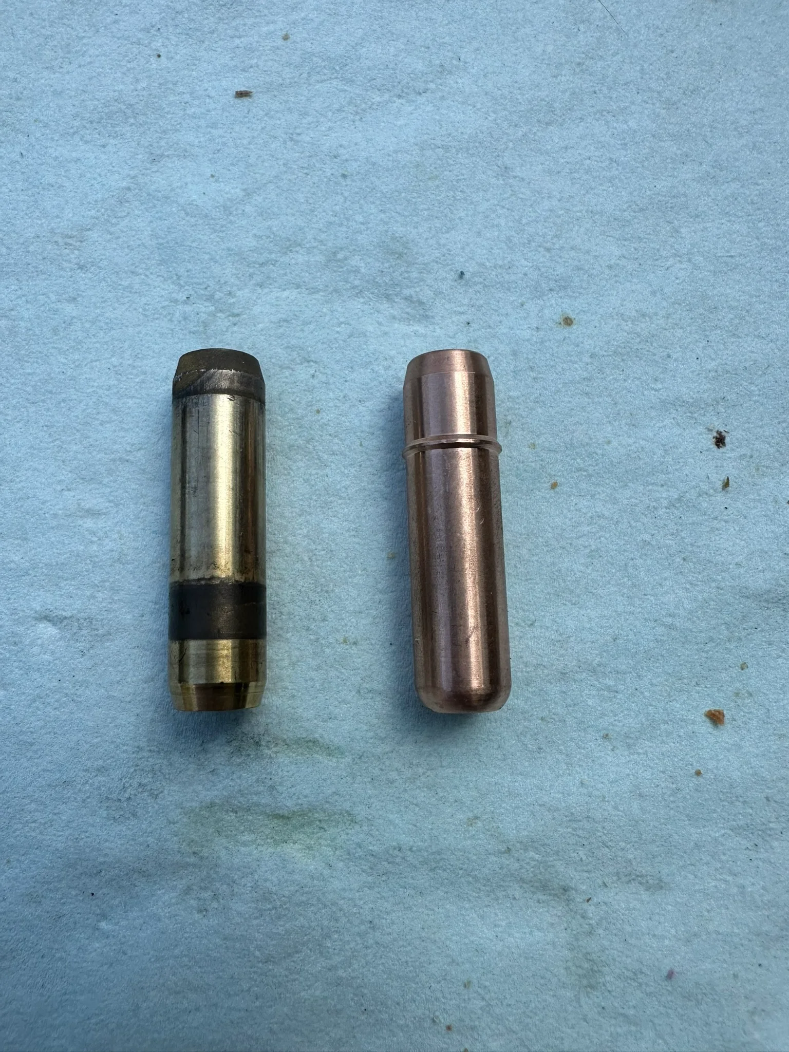

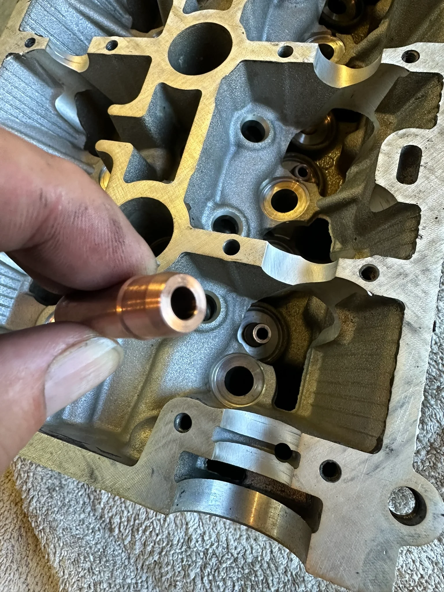

So, knocking out the guides was fun!
Ear defenders required as its a noisy job and they require a good amount of whacking to extract.
The replacements are FrogJams finest. Shaped for better flow and different profiles for the inlet and exhaust. My worry was getting them in without damaging them after how much force was required to get the old ones out.

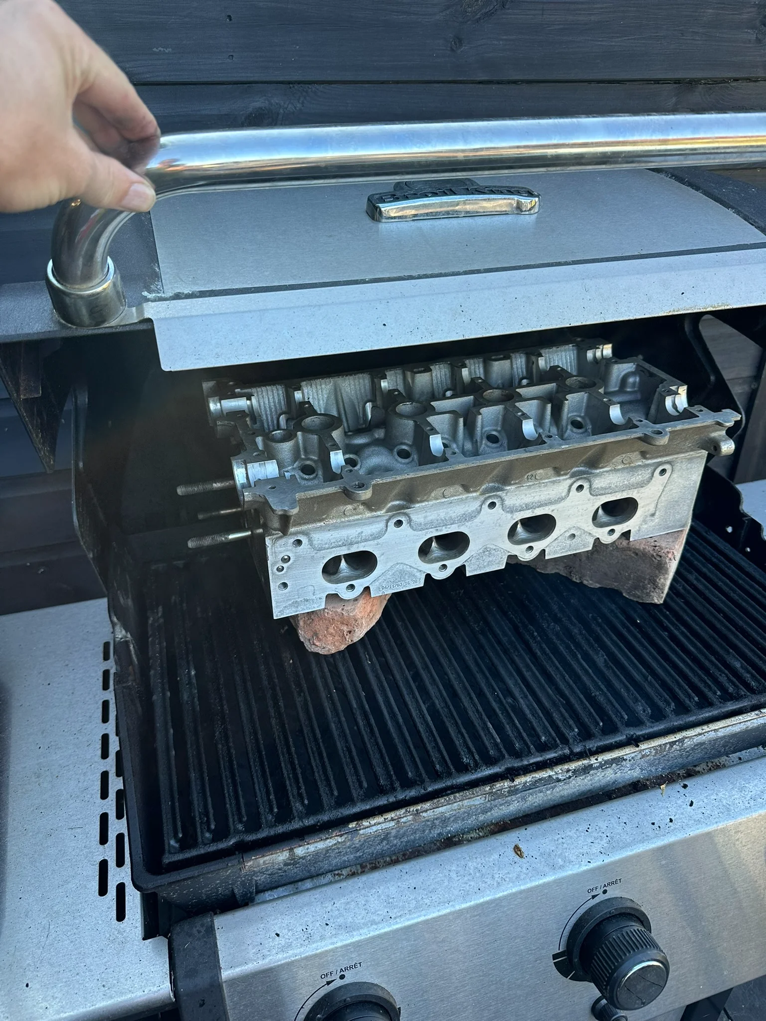

The answer promised to be baking the head at 180 degrees for about an hour!
This left it too hot to touch and still very difficult to drive the guides in. They required some light dressing with some 1000 grit wet and dry and lots of lubrication.

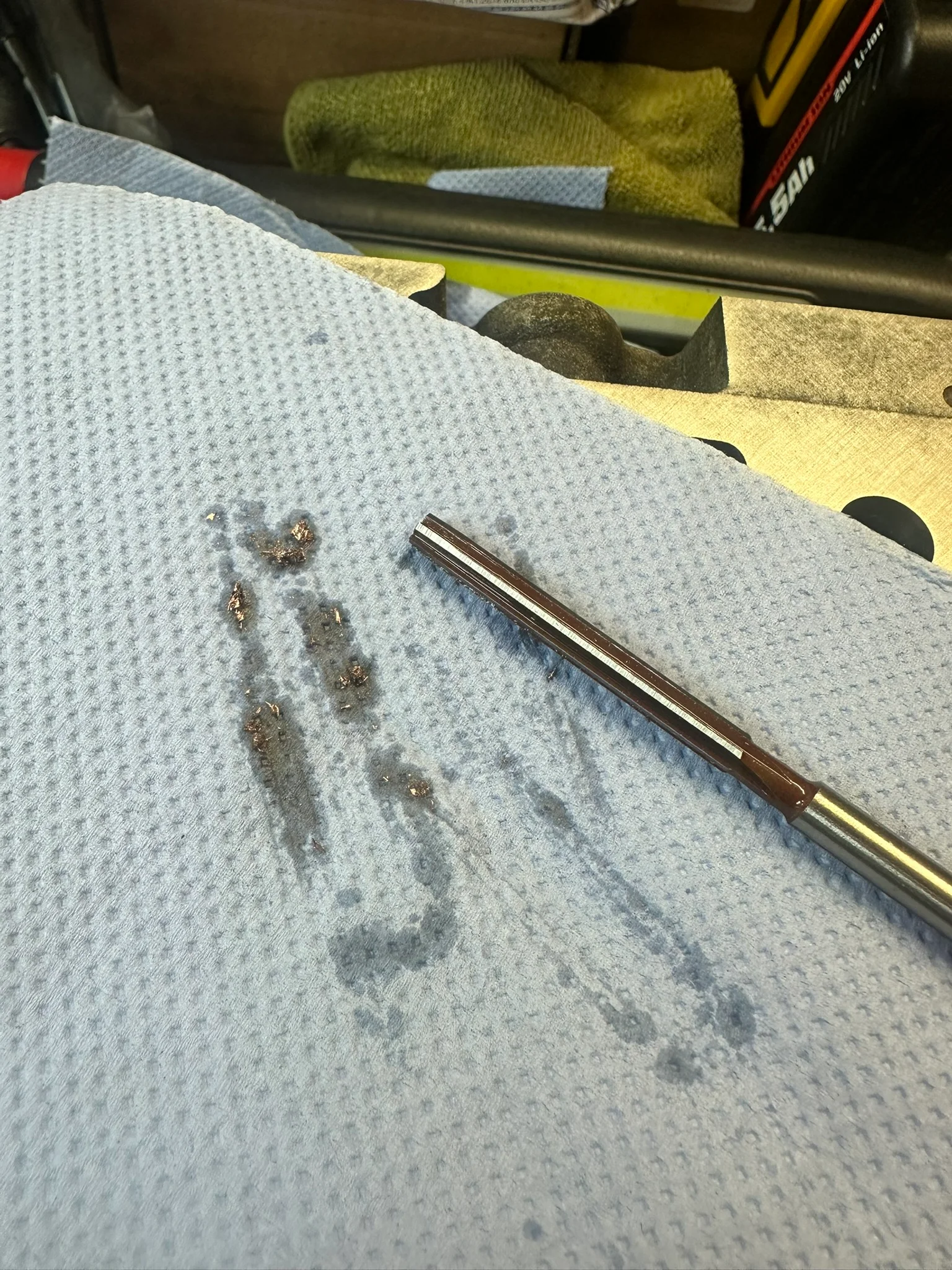

After a bit they were all in, but the bores had gone tight on a lot of them.
Most were fixed with a slight ream at the top where they had been driven in but some are going to need more work. I have a couple of 5.5mm reamers on their way to me now which should hopefully do the job.
Look at me learning new skills!

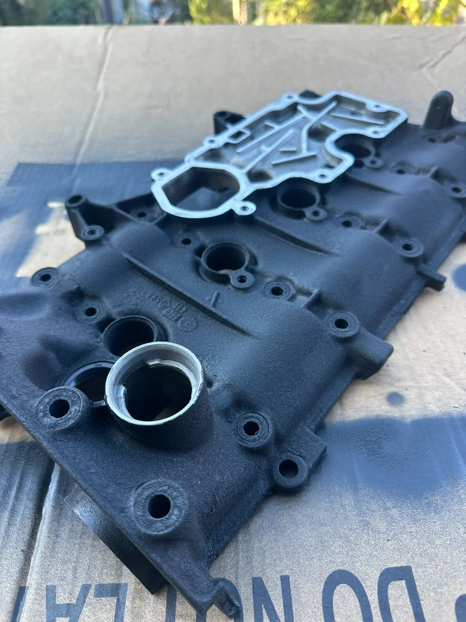

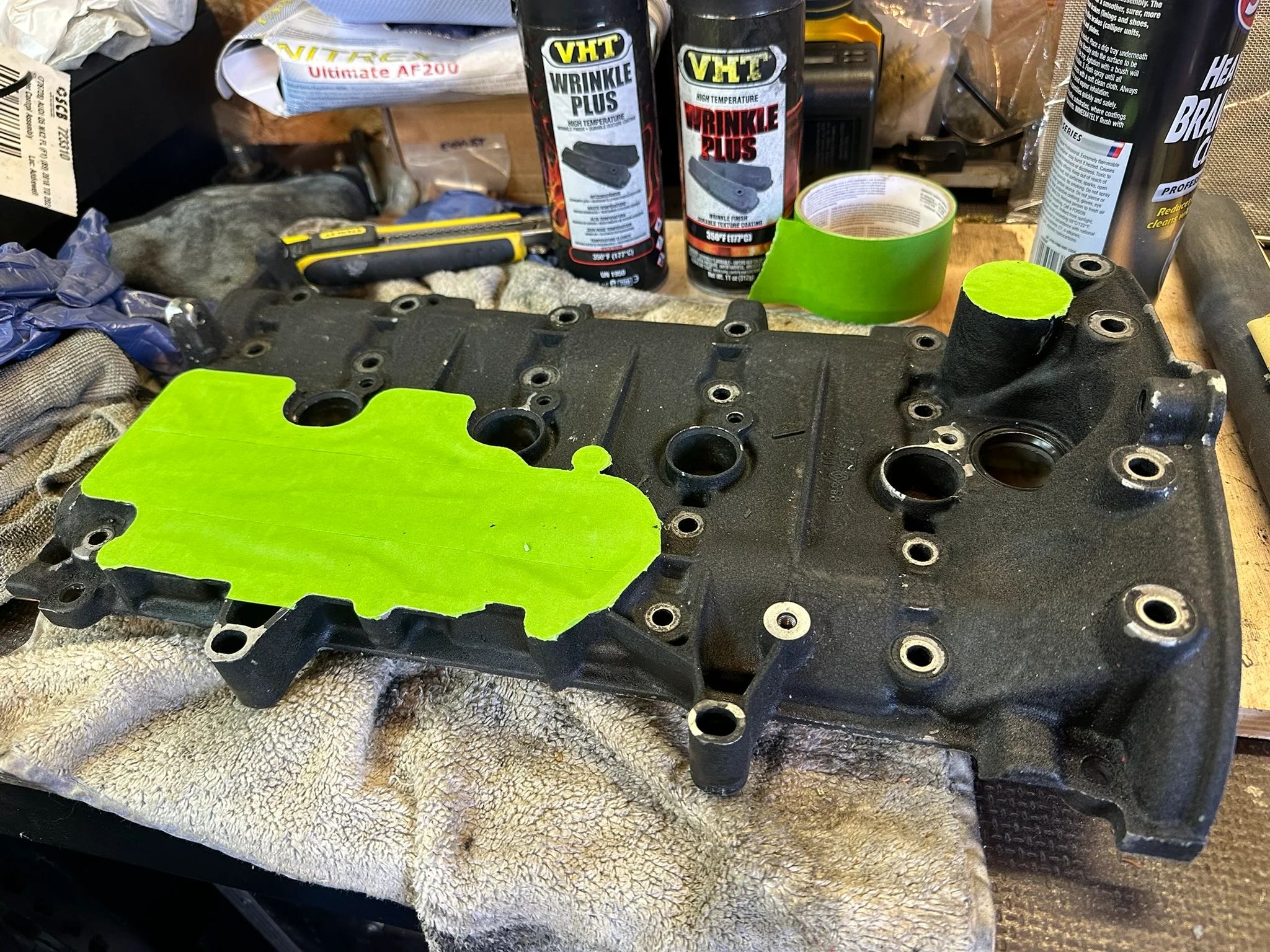

Cam cover received a fresh coat of wrinkle black too.
All being well I'll have the valves all lapped in by the end of the week.

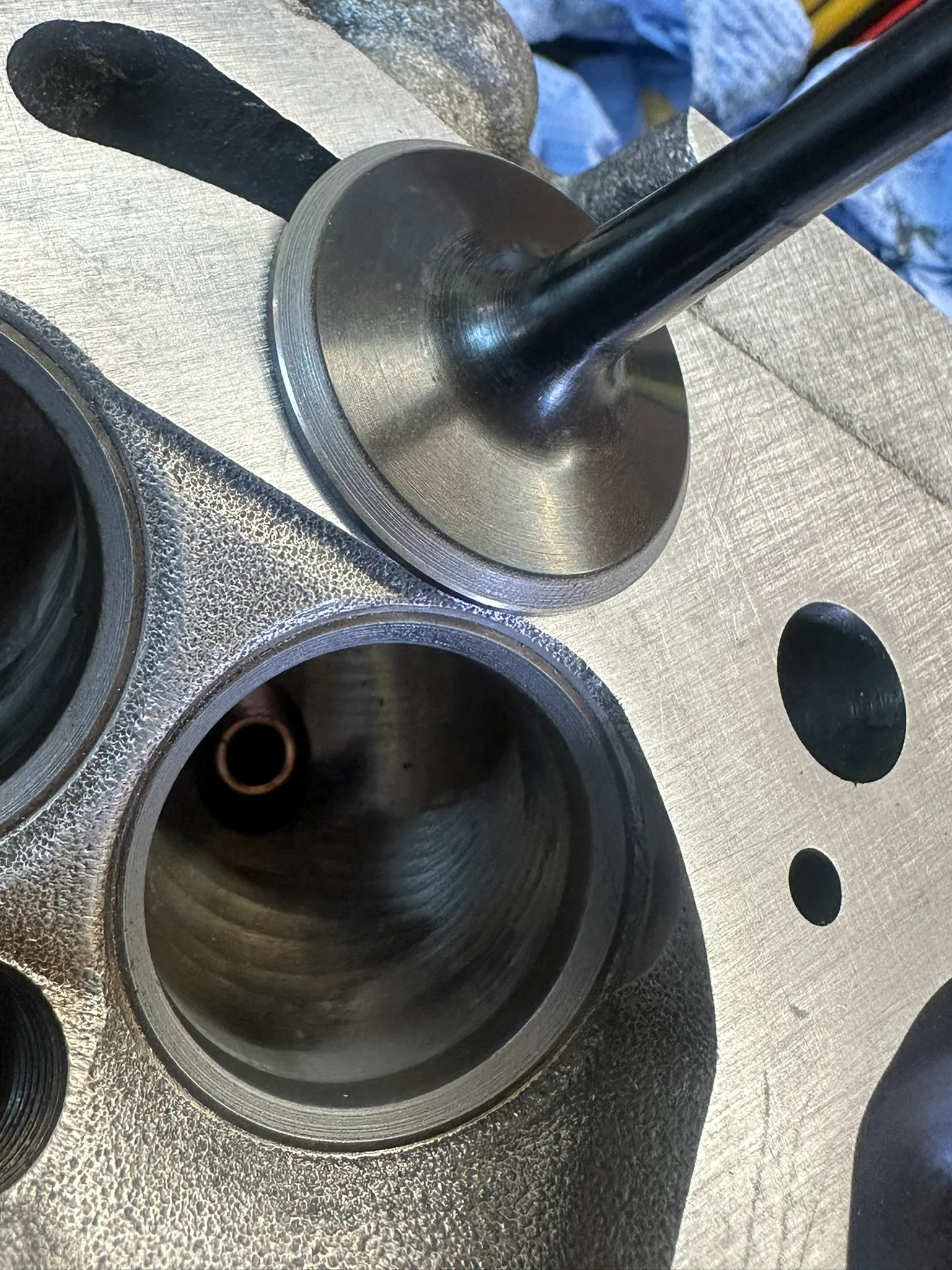

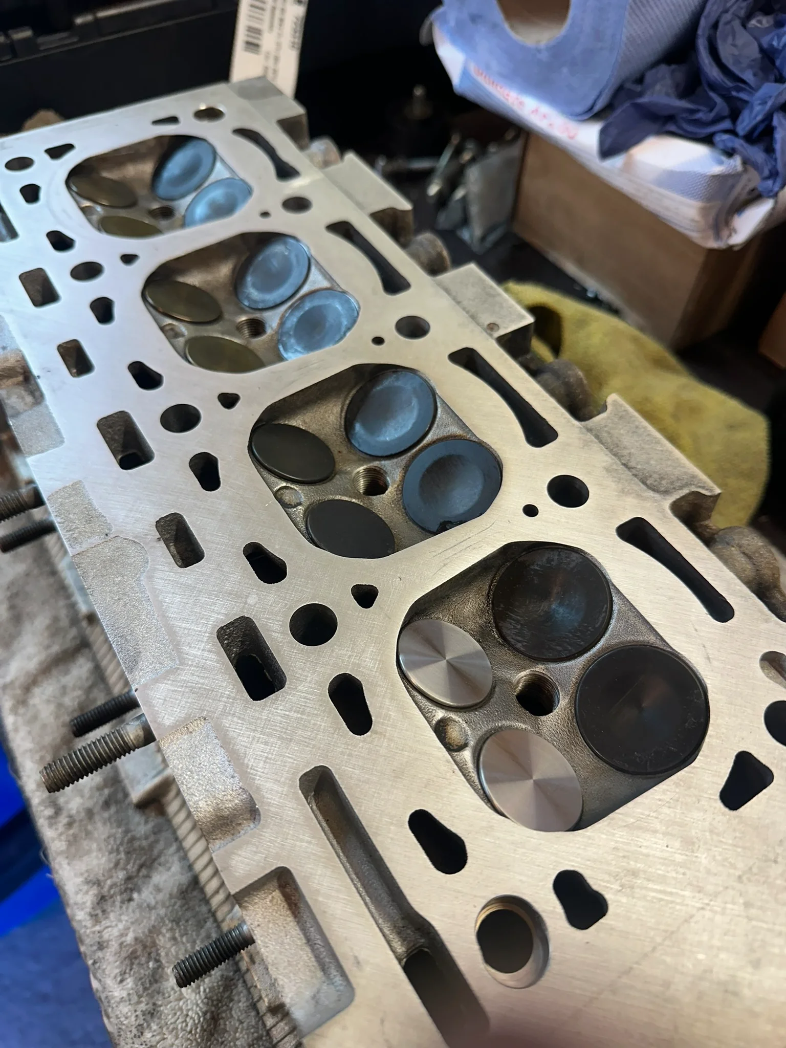

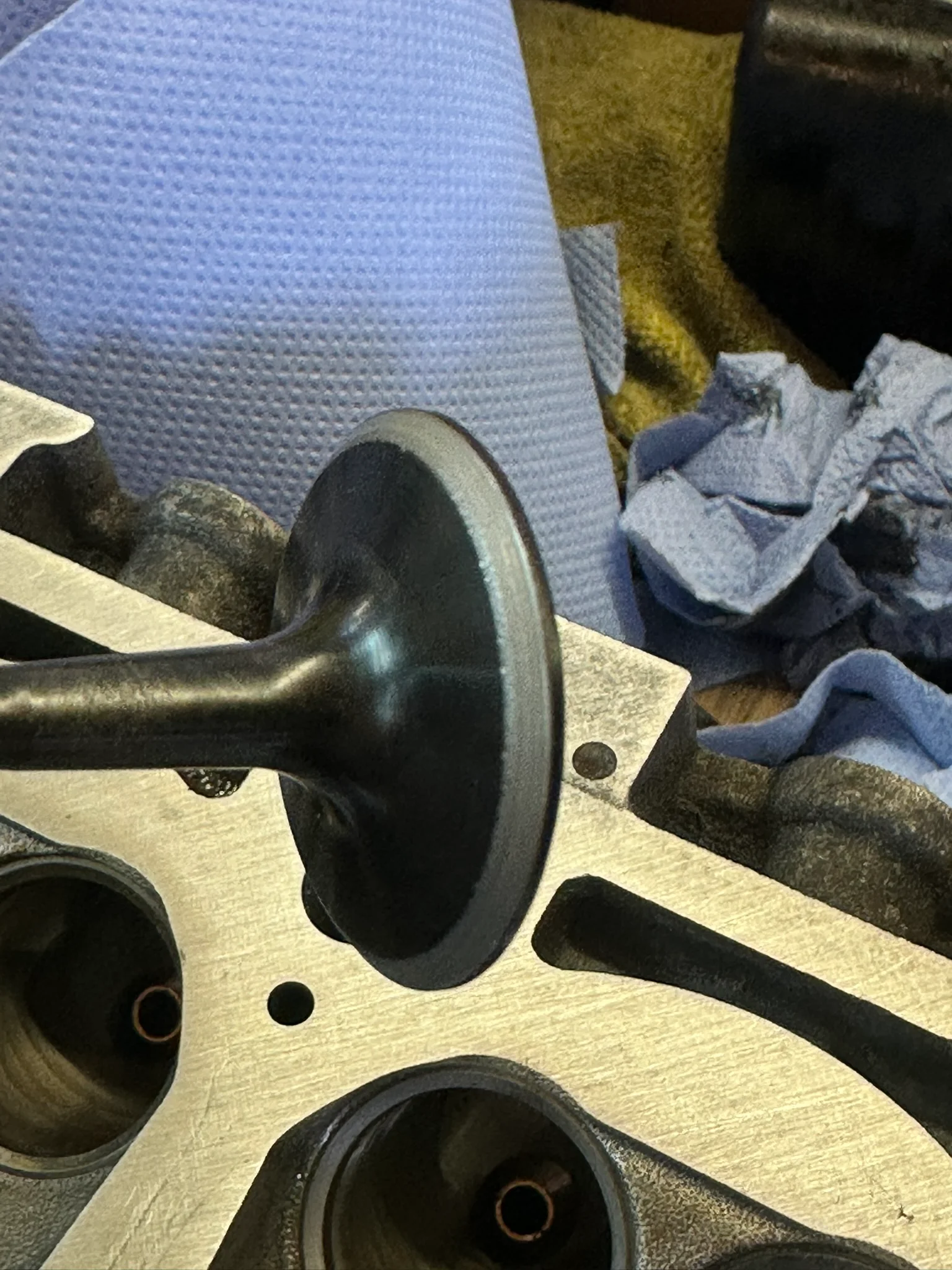

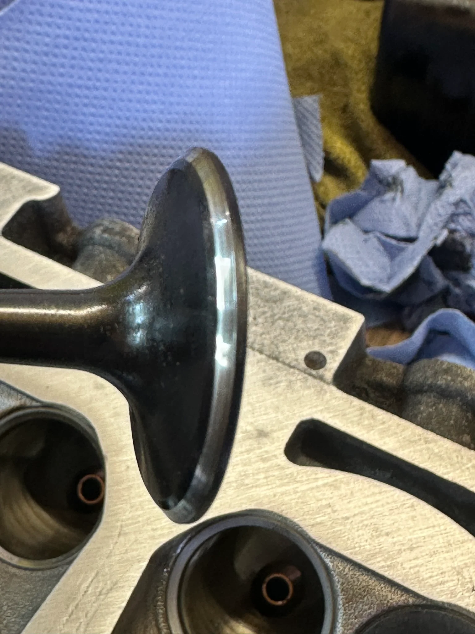

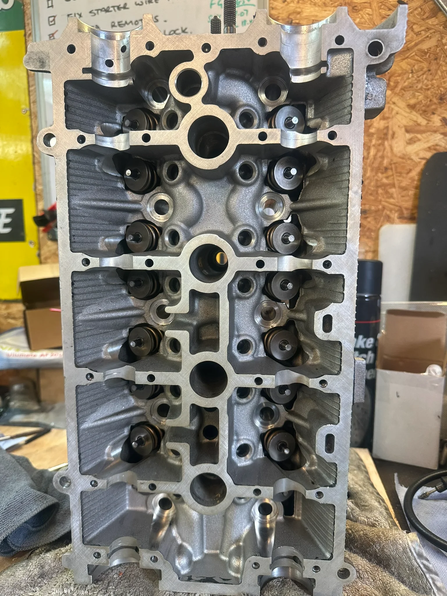

More progress over the weekend, getting all the valves lapped in....

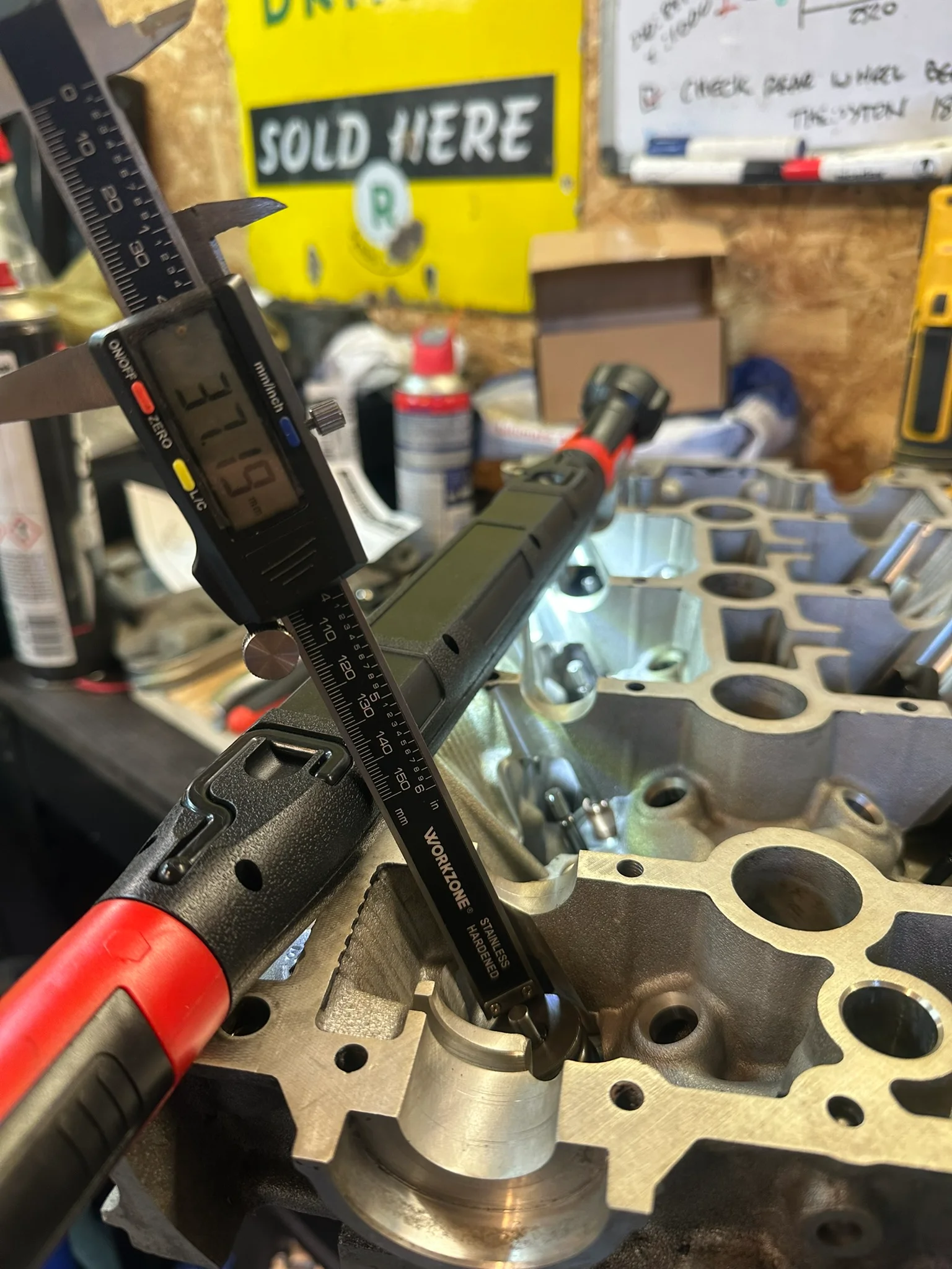

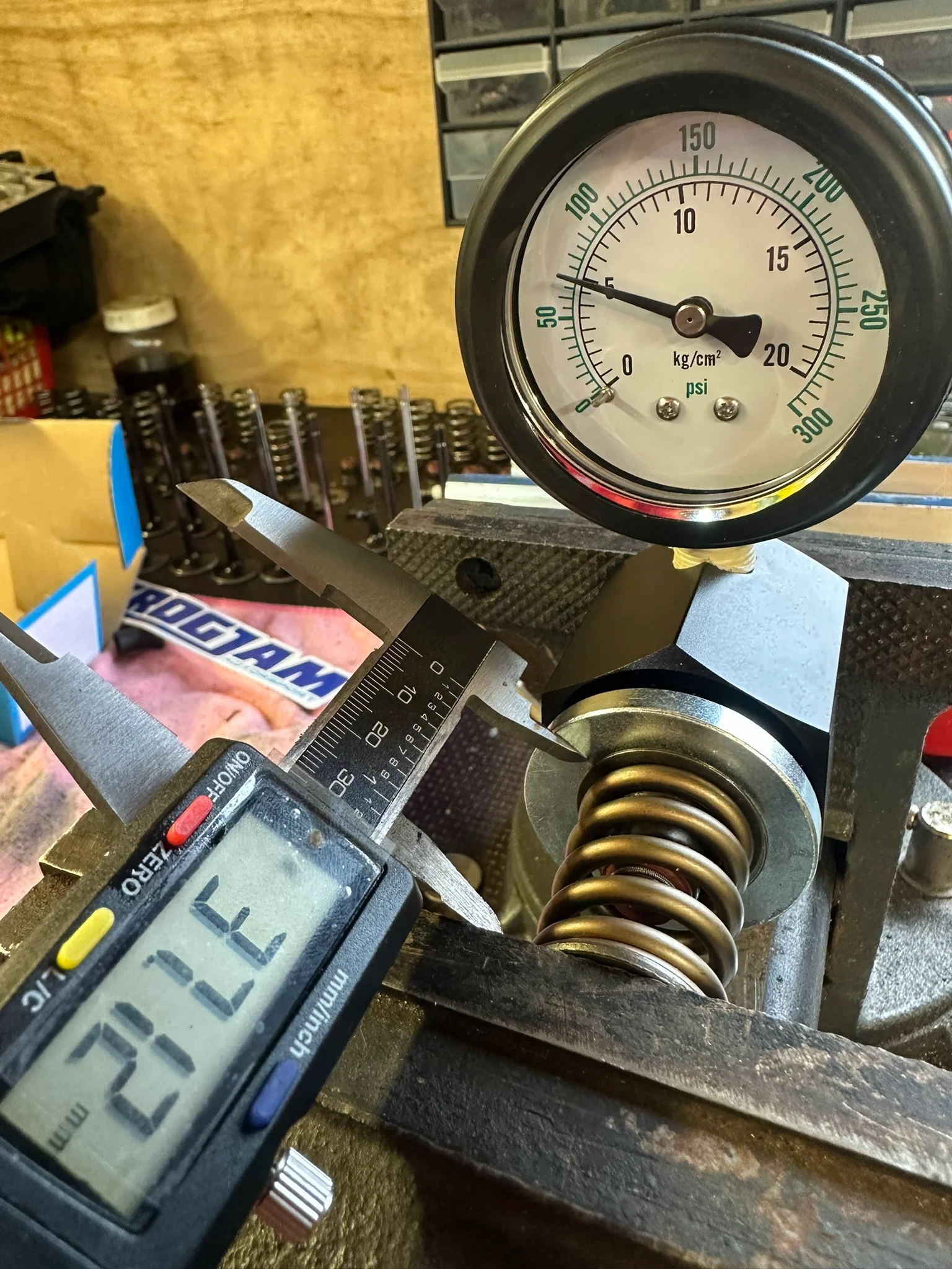

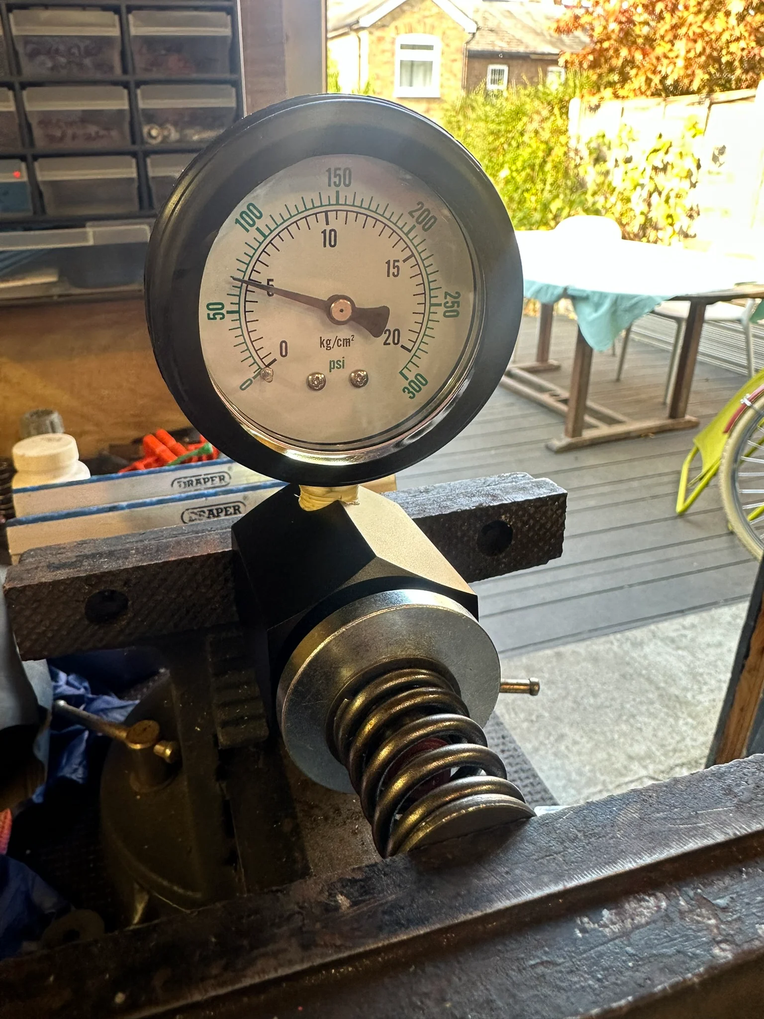

and then measuring preload of the valve springs which showed up something interesting. After measuring the installed spring height and then measuring the load at that height it appears the springs are not giving the the pressure that they should be.
I've had these Supertech valves since I built the first engine in 2017 and they don't actually make single valve springs any more but they should have been giving me a preload of approximately 30kg but it appears they are only around 25kg. So I'm guessing some fatigue has set in.
New CatCams springs ordered from Frog Jam. Will be interesting to see the difference.
Any tips/advice on measuring installed height on springs? I have a set to do soon.
I was told a while back that springs wear out pretty fast, so not shocked to see yours are under spec. I reckon a few of them on my trophy will be similar.
Totally unrelated/different use, top fuel cars check spring pressure between runs, really critical when pushing mega hp.
Easy enough as long as you have a vernier. You need to measure the complete assembly, so include the oil stem seal and the top retainer. And then check what preload the specific springs are rated for. If your reading is low you need to order the appropriate shims to increase the load. (Nick at PMS sells them)
I read about the springs on the top fuel cars too. They're preload is immense though so no surprise that they don't last long. You probably saw the same Youtube videos I was watching!

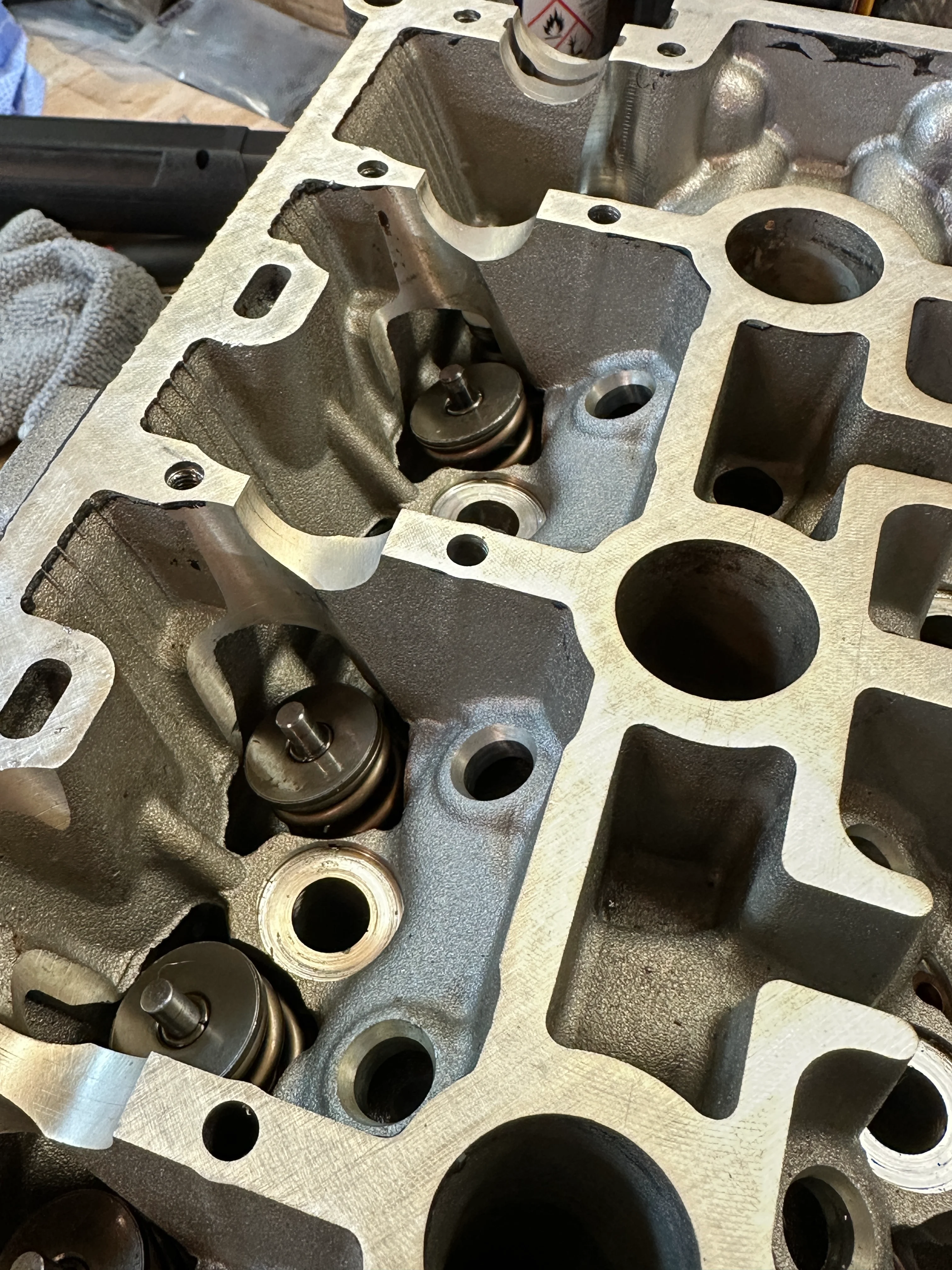

Cat Cam springs arrived over the weekend and happy to say that with a 1mm shim they're showing a 35kg preload which is what Nick at PMS tells me I should be aiming for.
Strangely though, while sorting out my shims I've discovered that 7 of them (that have always been inmy engines) are only 0.6mm? Really strange and also odd that I never noticed before. this could certainly be the cause of past failures though I guess.
So, some new shims ordered which will hopefully arrive in the next couple of days and I can button up the head and install it on the block.
Installed as many as I can with the shims I have.
Unfortunately, with everything taking longer than expected I don'y think I'm going to make Silverstone on the 6th September. So not sure what race if any will be next this year. The Birkett 6 hour in October is potentially on the cards though. We'll see.
A slightly frustrating week and weekend. The shims finally arrived Frday afternoon, over a week after I ordered them but I suspect this is due to the fact that Pure Motorsports has just been absorbed by KAM Racing, as the shims were dispatched from KAM in the end.
So I was able to get the head finished off on Saturday.
And a quick check for leaks.

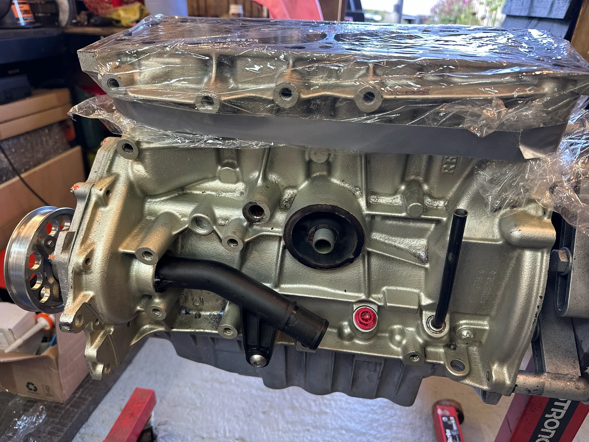

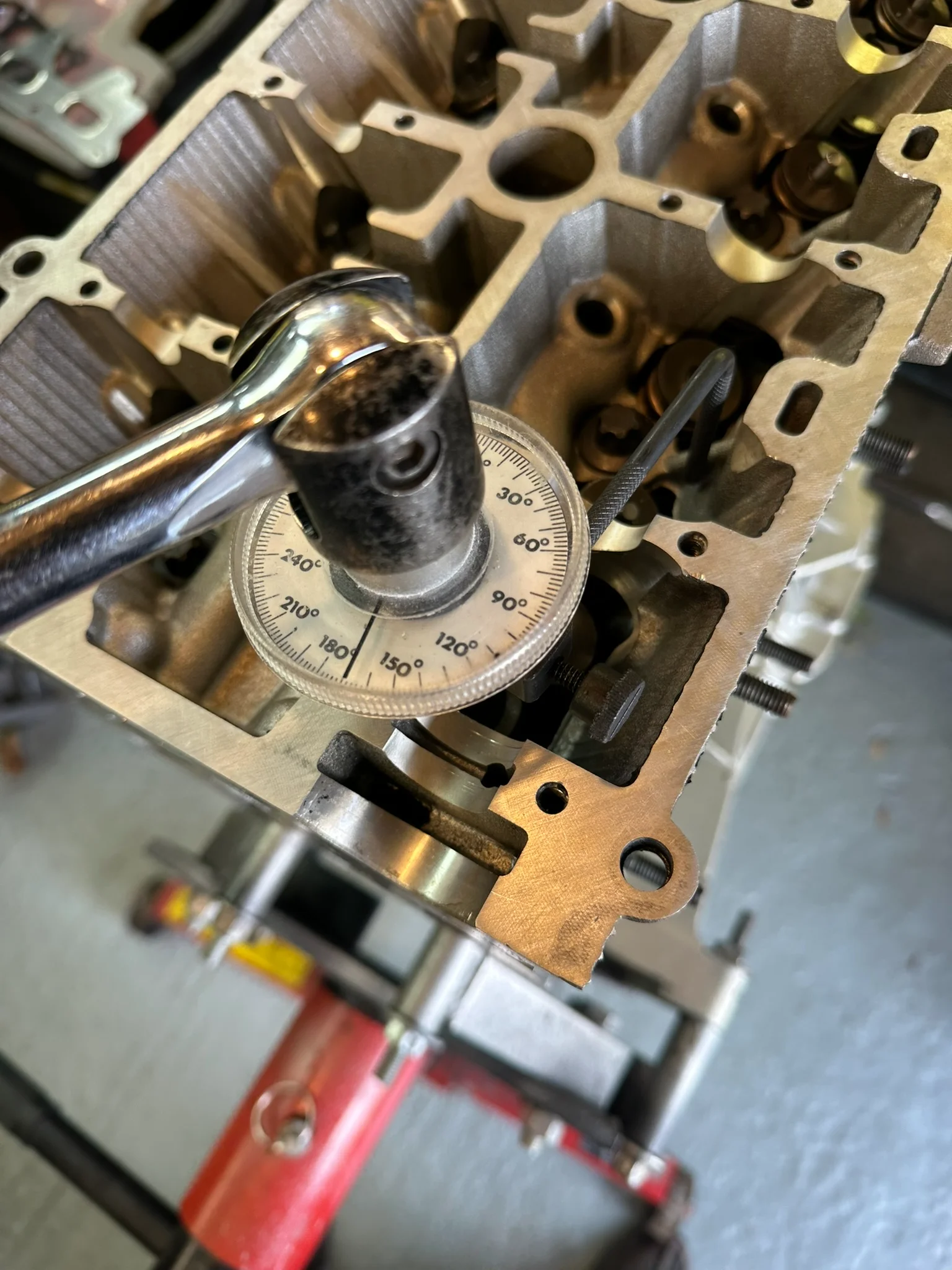

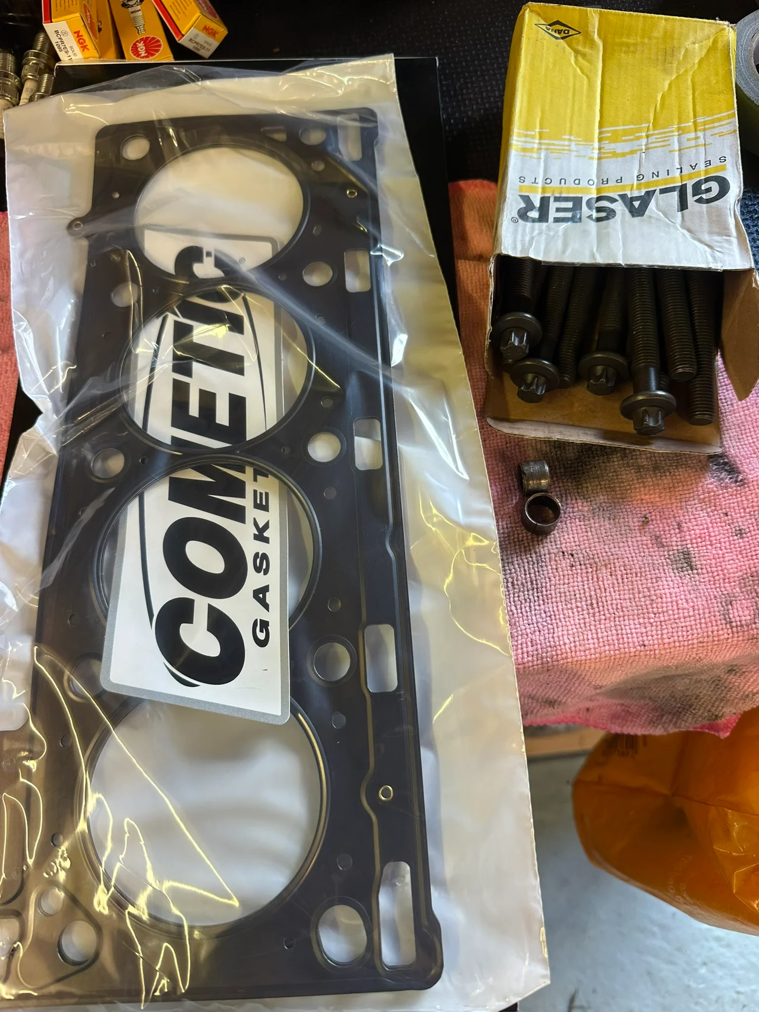

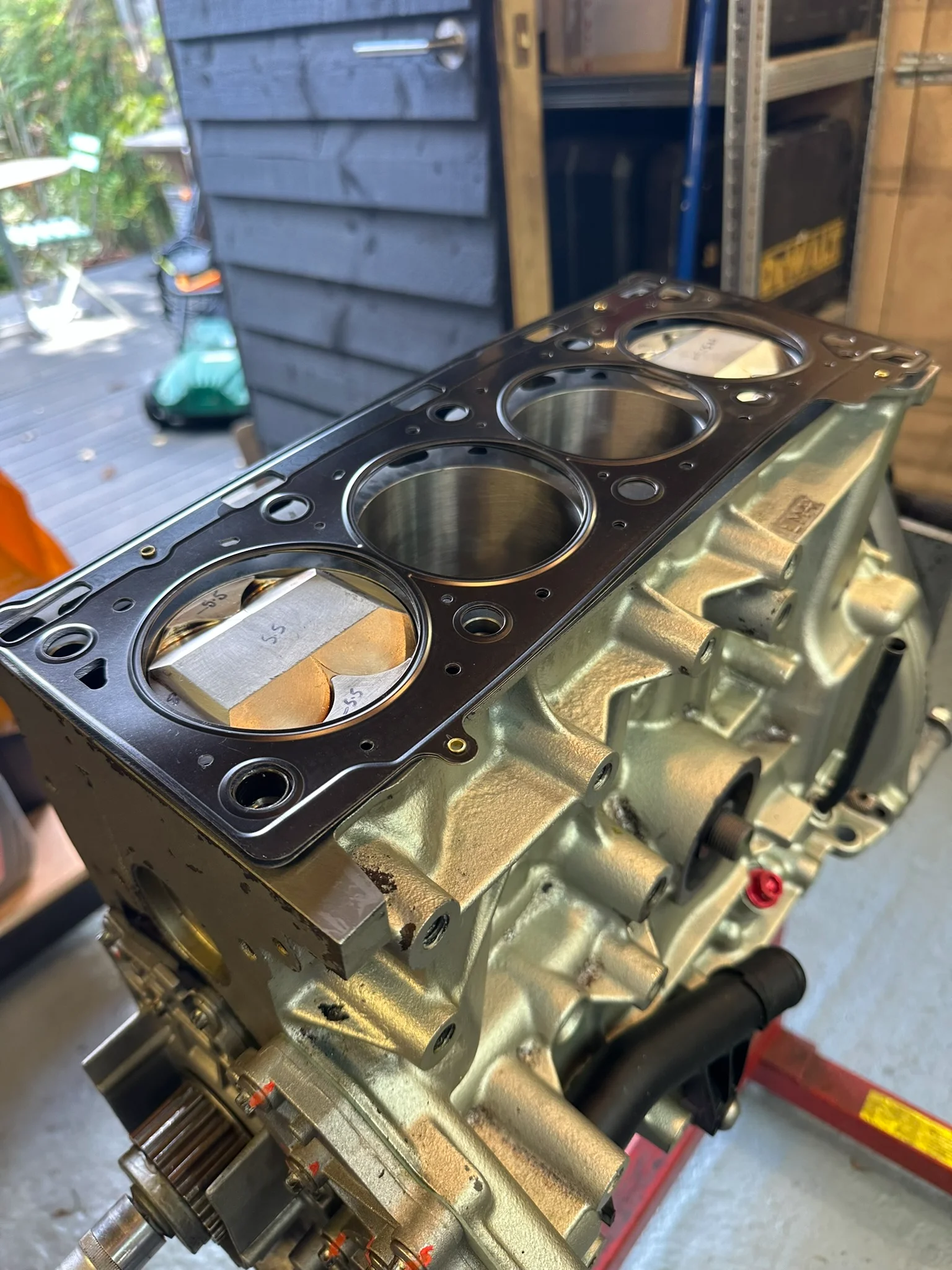

After that it was onwards to mounting up the head to the block.

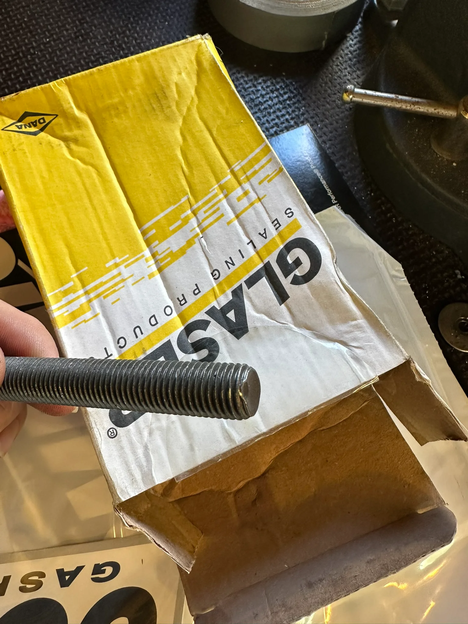

A slight annoyance that one of the head bolts was damaged slightly but easily fixed.
And then the usual tightening sequence..

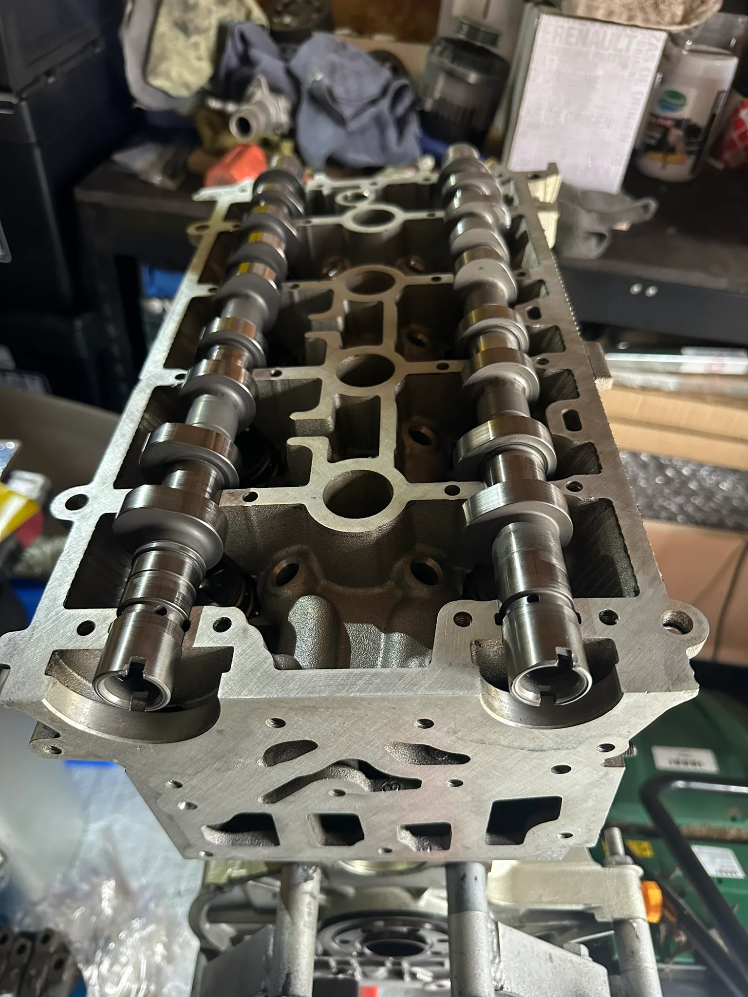

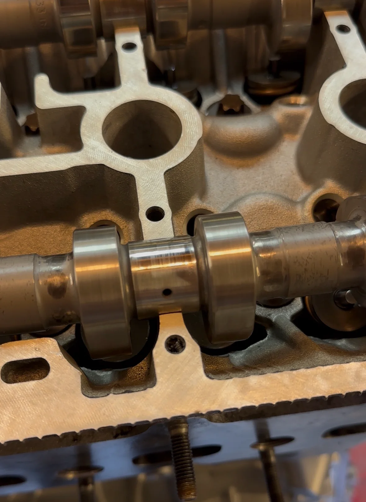

After this I hit a snag.
I laid the cam shafts in place to check things before installing all the lifters etc, only to find that the exhaust cam is not rotating freely. It appears to have a very slight bend in it. As you rotate it it binds up very slightly during rotation and then frees up again as it passes that point.
Strangely, it looks like this is not new as the bend appears to be on the cylinder where I suffered a lifter failure a few years ago. not on the usual cylinder 2 where valves normally fail.
Not sure if CatCams would sell a single camshaft (as I'd have to go through a dealer anyway) so my engine builder is going to investigate the cam and possibly straighten it. Failing that he says he could get a copy machined up from a blank if necessary.
So, another delay and hopefully I'm not looking at an £800 bill for new cams. (although that would be the quickest solution)
