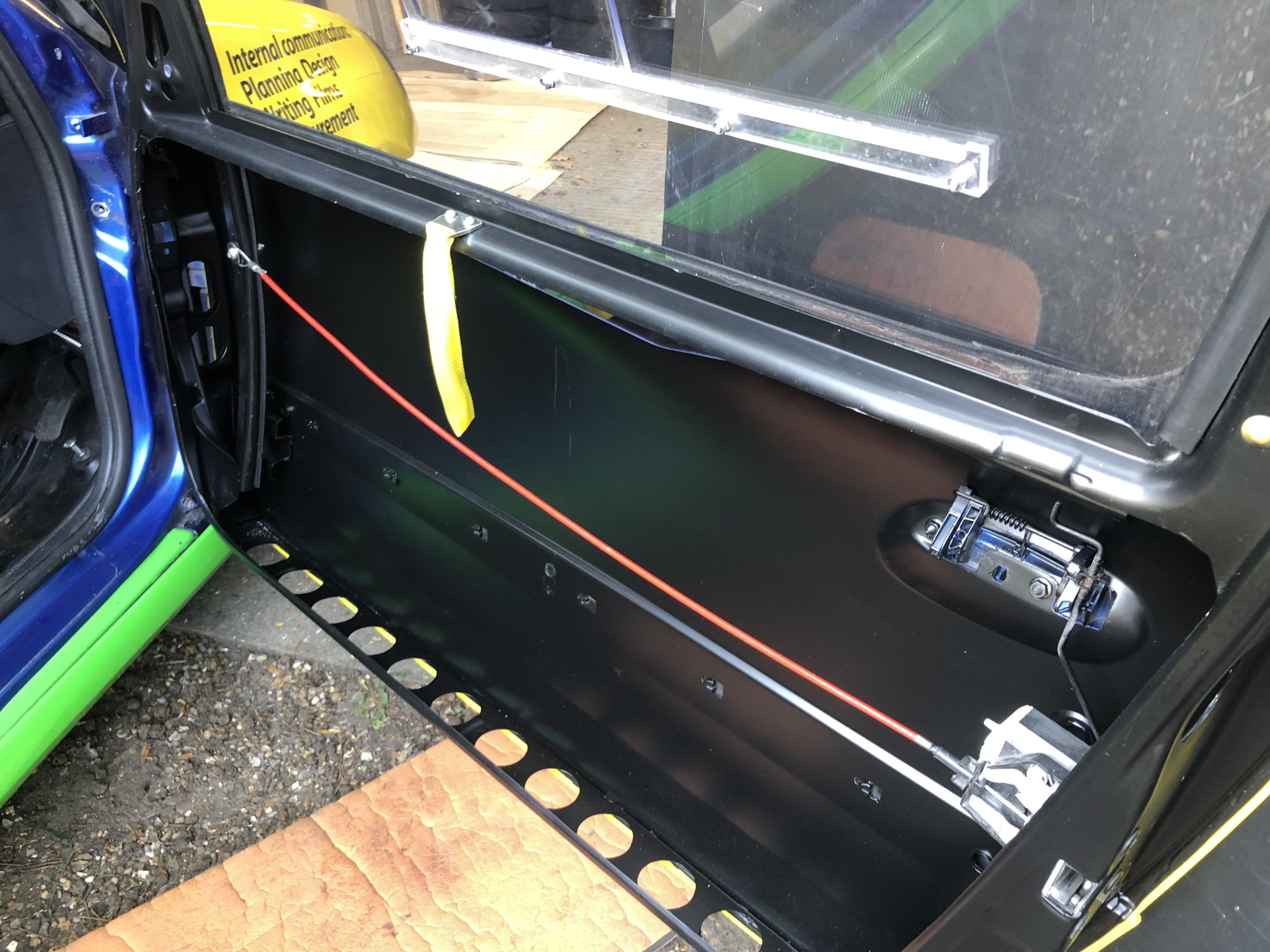

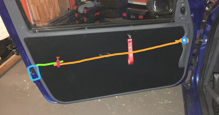

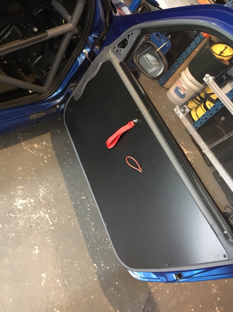

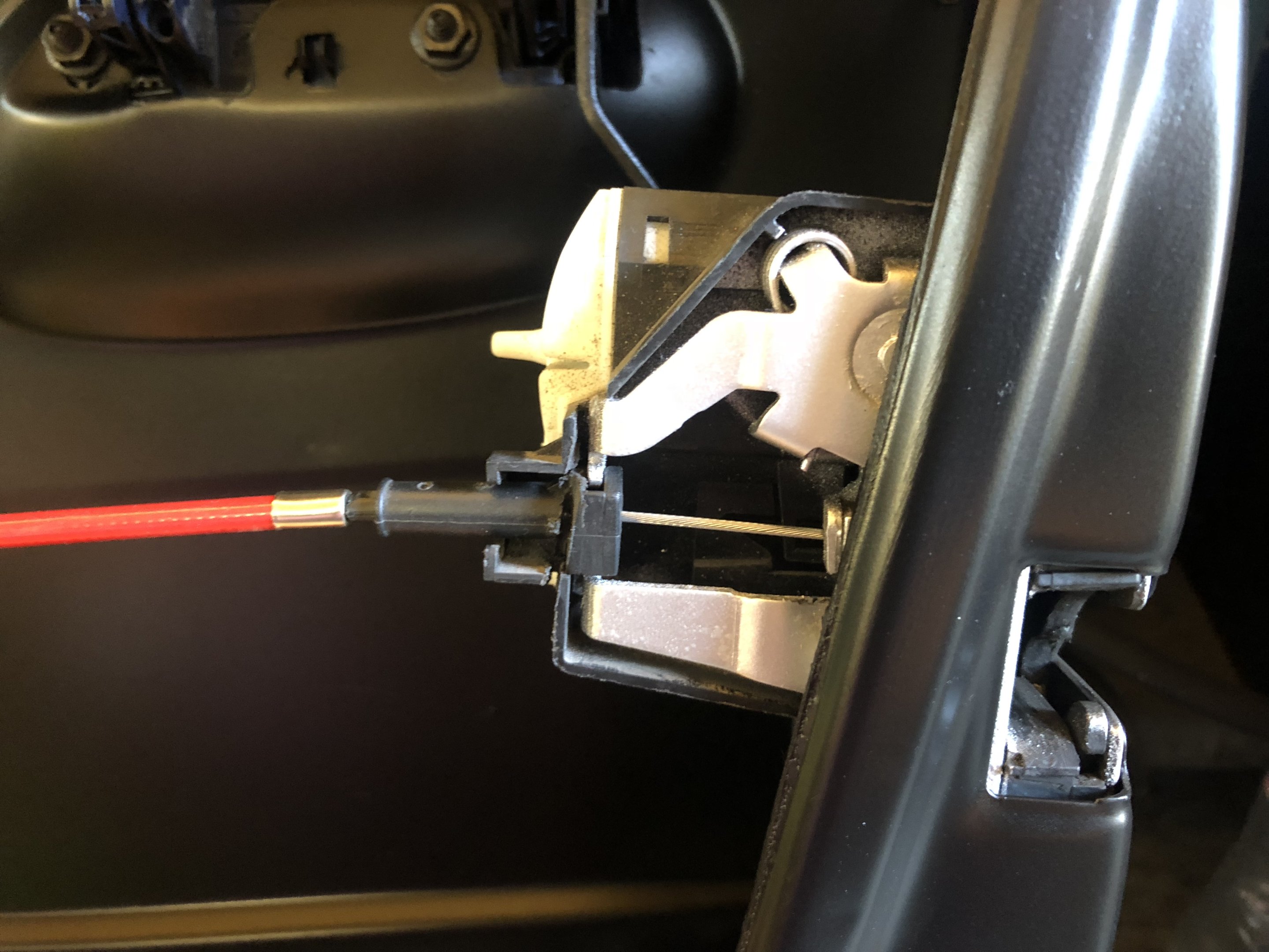

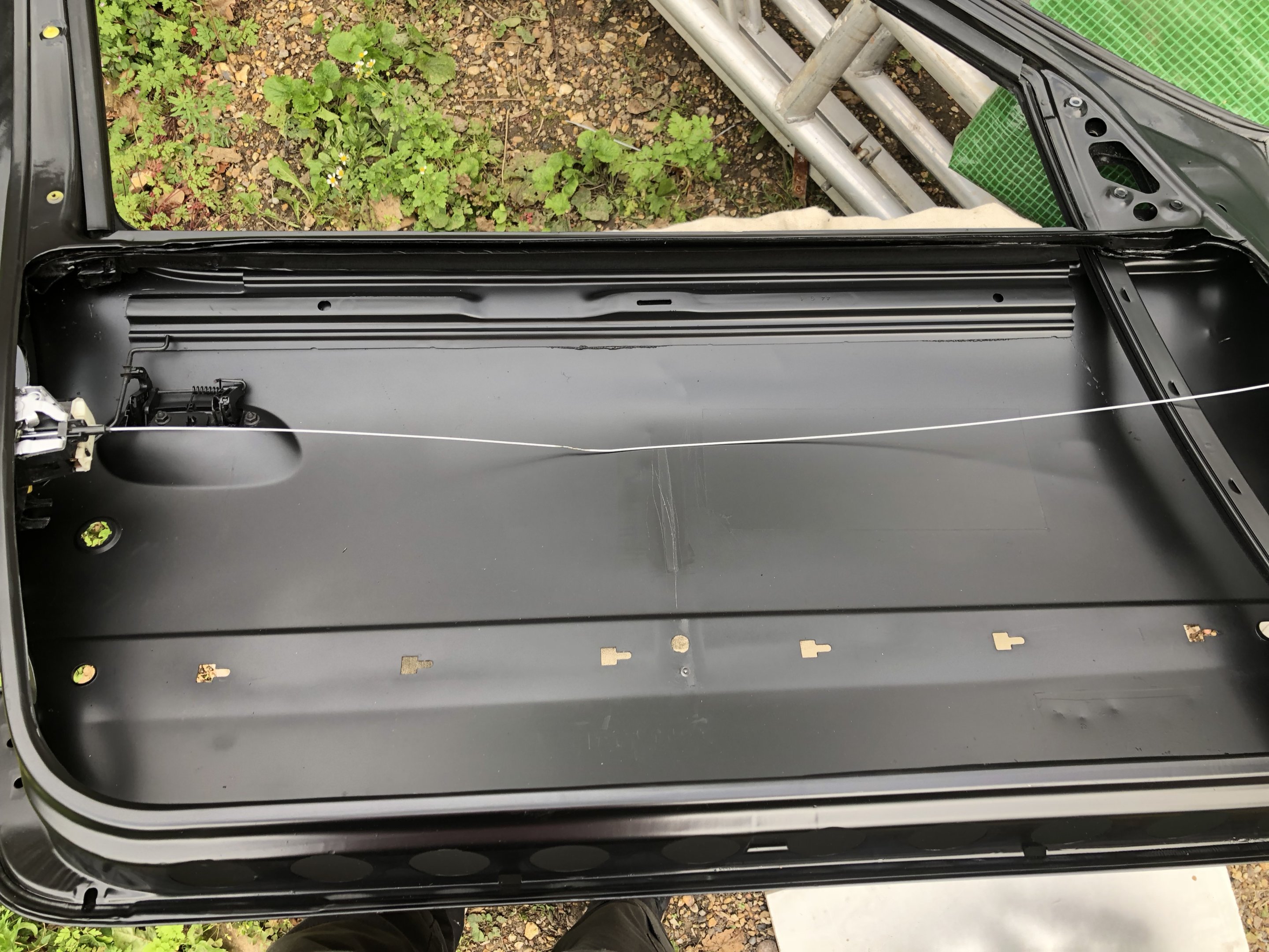

Did you manage to sort a door opener out?..

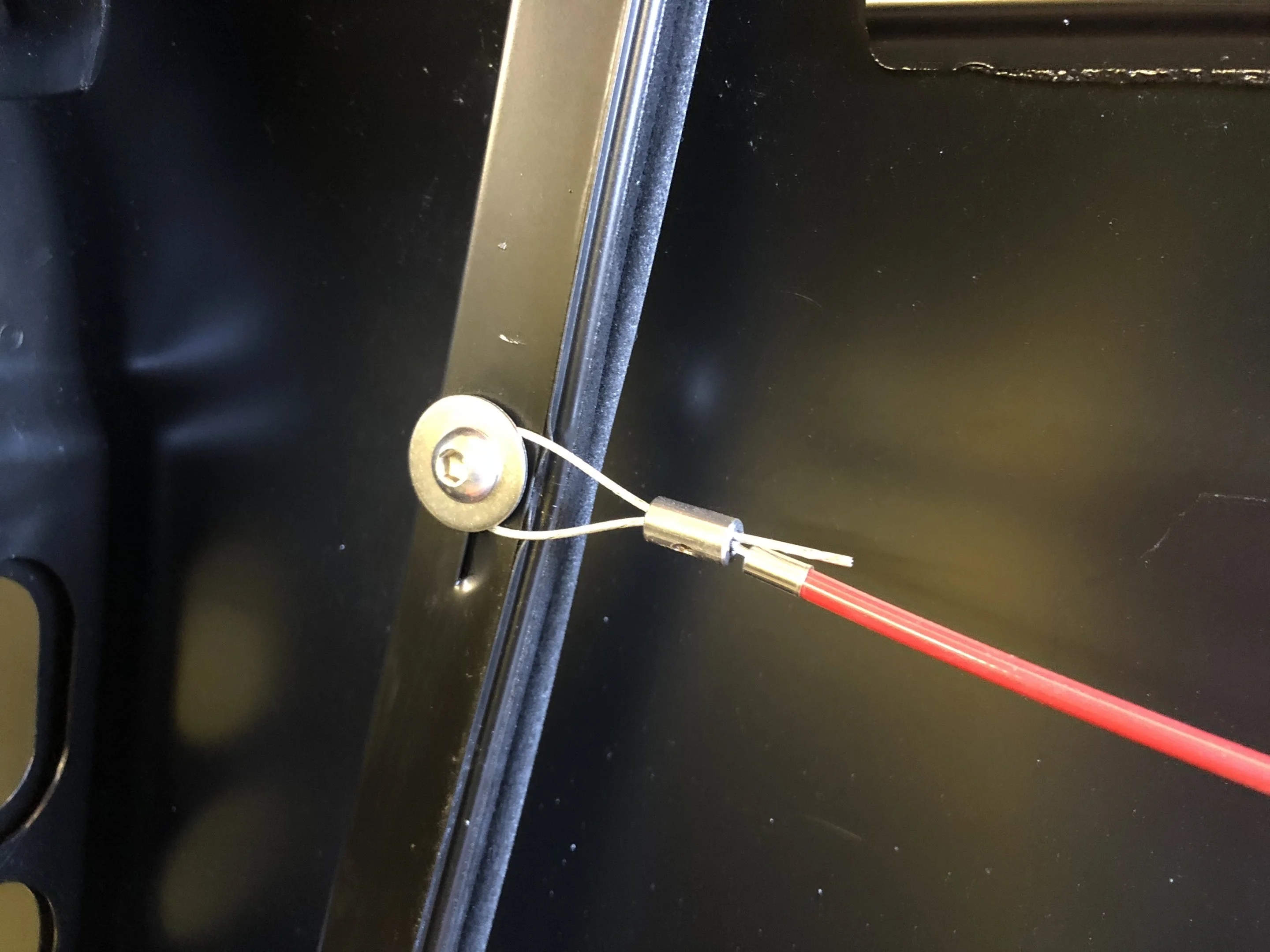

I cut the end of the cable off mine and trimmed some of the outer sleeving back. Then put some red heatshrink over it and looped the end of the cable on itself and fitted a cable lock barrel.
I cut a hole in the door card and passed the loop though.. I just then pull the loop forward (rather than towards myself) to open the door
That's a nice solution. But you need something to clamp the outer sleeve to don't you? So the inner cable can slide? My problem is I now have nothing to fix to and I'm not replacing my door cards now after discovering they weigh over 1kg each despite being carbon fibre!

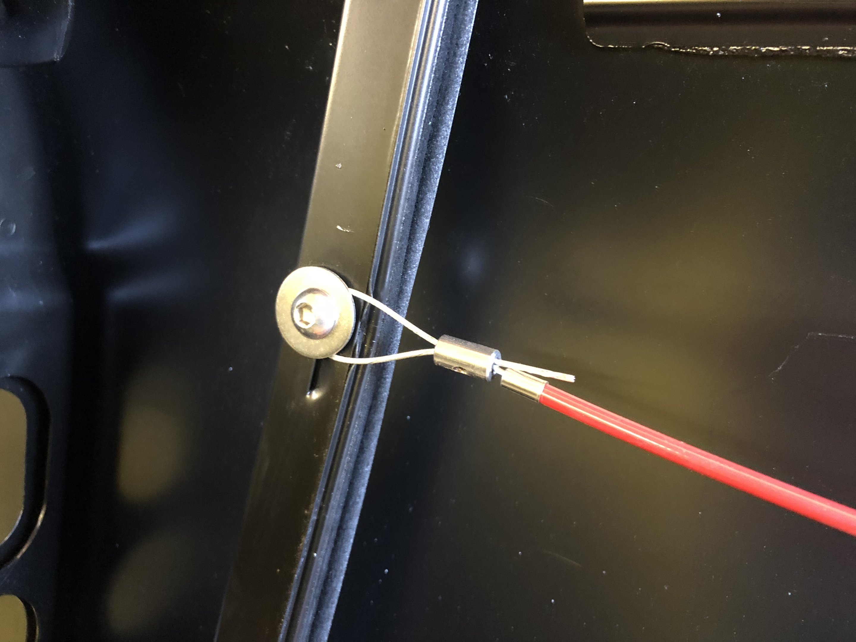

I've been trawling through the Car Builder Solutions catalogue to try and find a cable long enough that I can extend to the other end of the door, fix it and just pull it under it's own tension. I'm open to ideas of course and I may be missing something obvious!
I haven’t got anything holding the outer in the middle of the door, just the hole in the door card keeps it in position.. the outer sleeve is attached to the mechanism so doesn’t move.. tbh I could of removed the outer completely and it would have been fine
I have seen people do as you say. If your not using a door card.
You could remove the outer sleeve completely and shortened the inner, then buy a bike brake cable and just use the inner and clamp the original cable and the new one together making it long enough to reach the other side of the door, then loop the end and bolt it to the door. Then just pull on it like you said.
Yes, this is exactly what I have in mind. I'm just trying to find a cable that has the right end on it that I can use in one piece. Otherwise I will have to join 2 like you suggest. (It's just more to go wrong in the heat of a driver change!)
original cable, p clip on the upper edge of the door and fit the cable through that, nipple holds it there and all you need to do is pull on the outer.
This was the advise I was given and went Armtech. Works perfectly

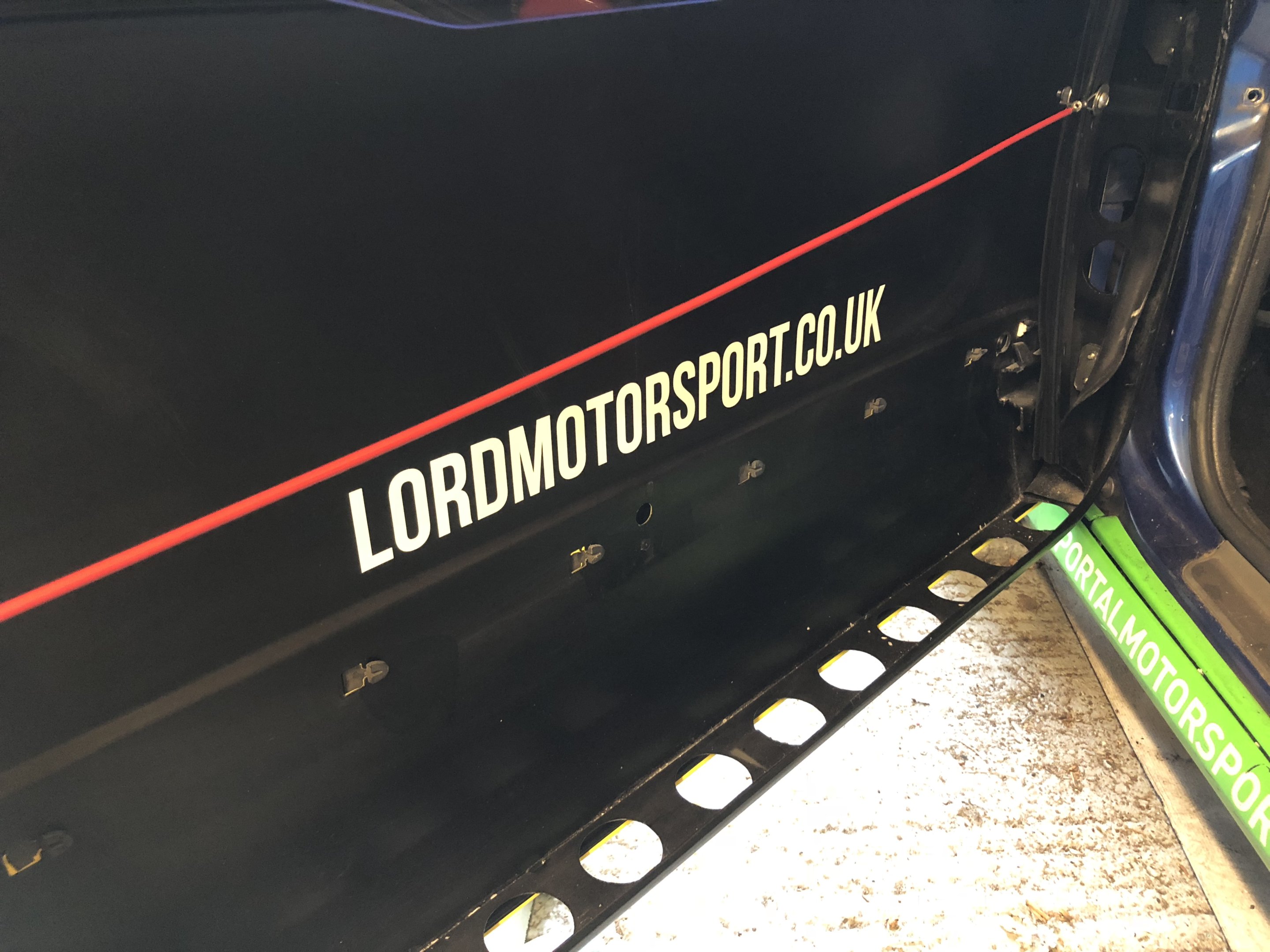

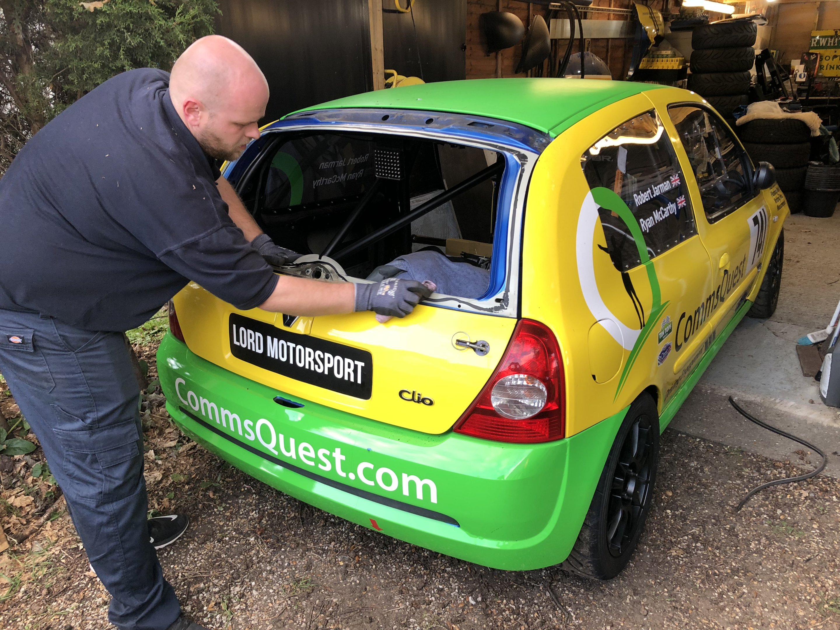

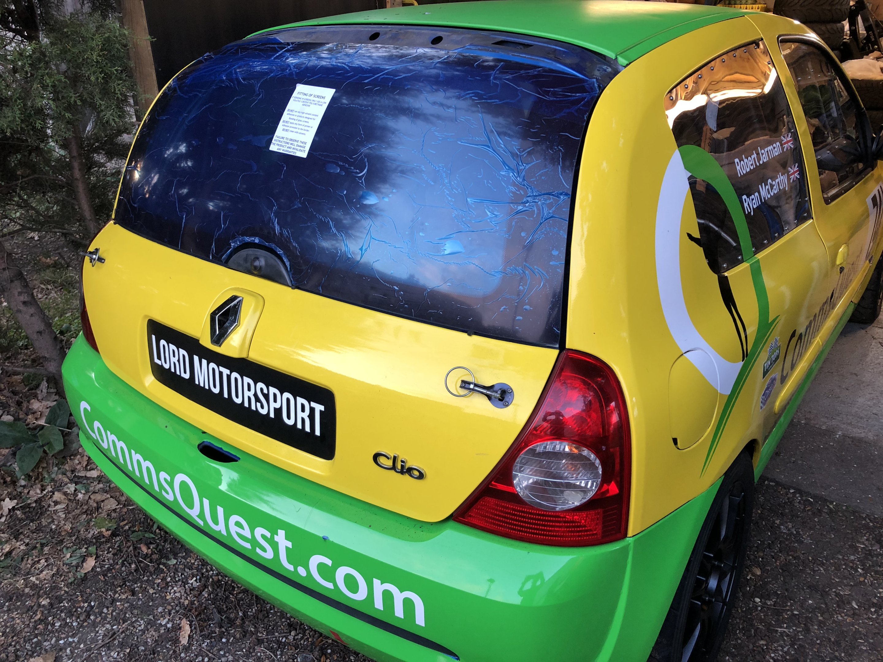

The current weight saving phase is complete with the rear Lexan screen going in this evening with the help from my friendly neighbourhood National Windscreens man!

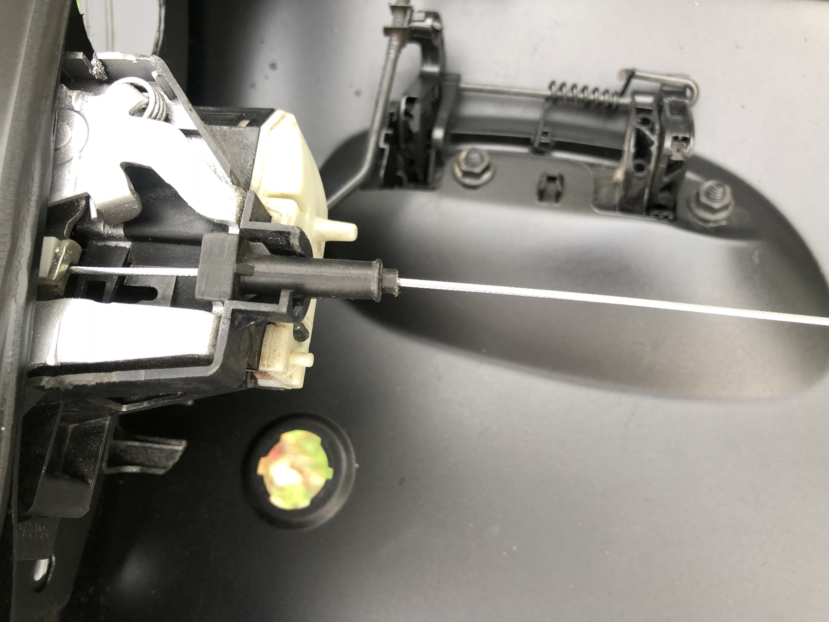

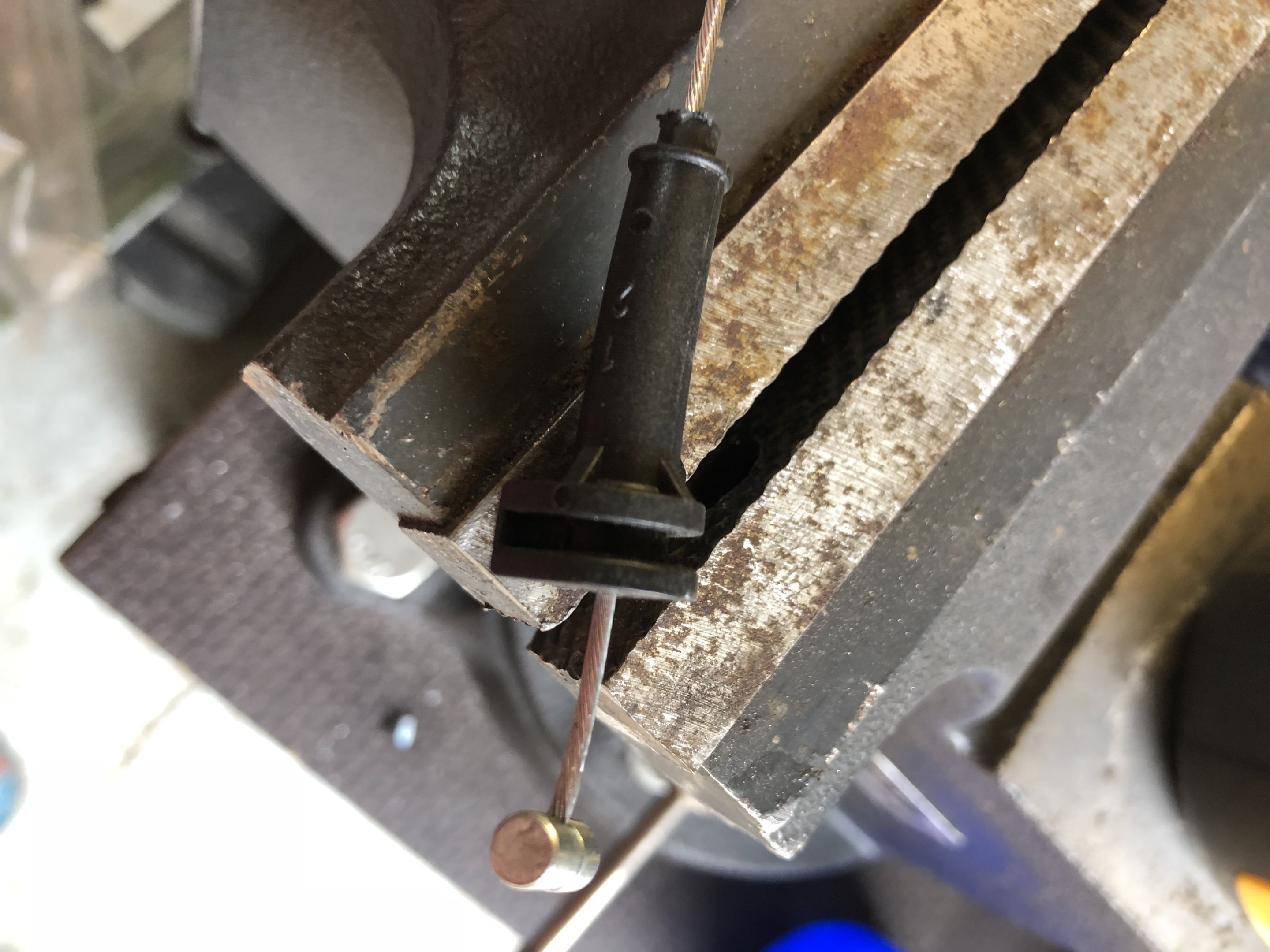

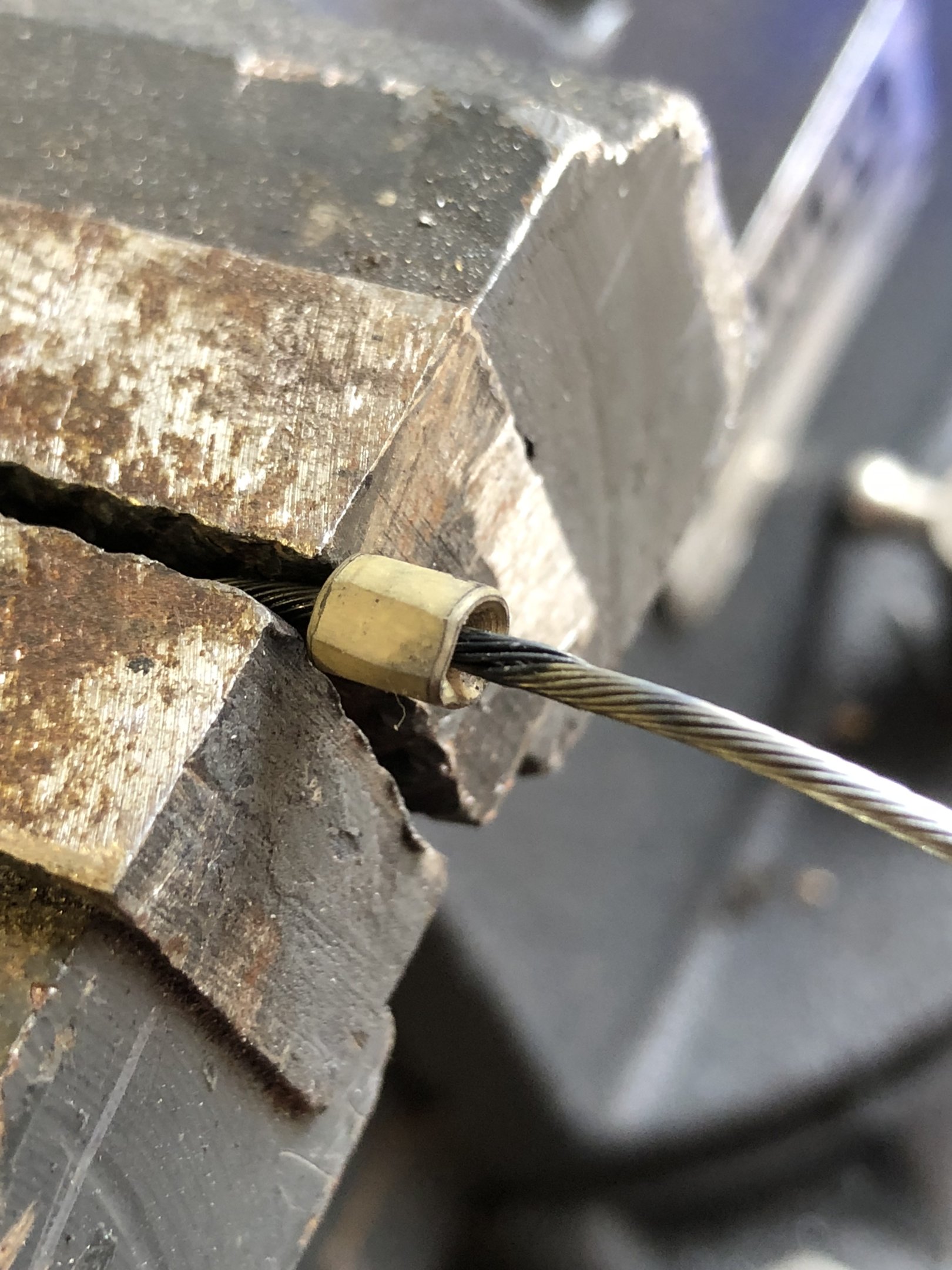

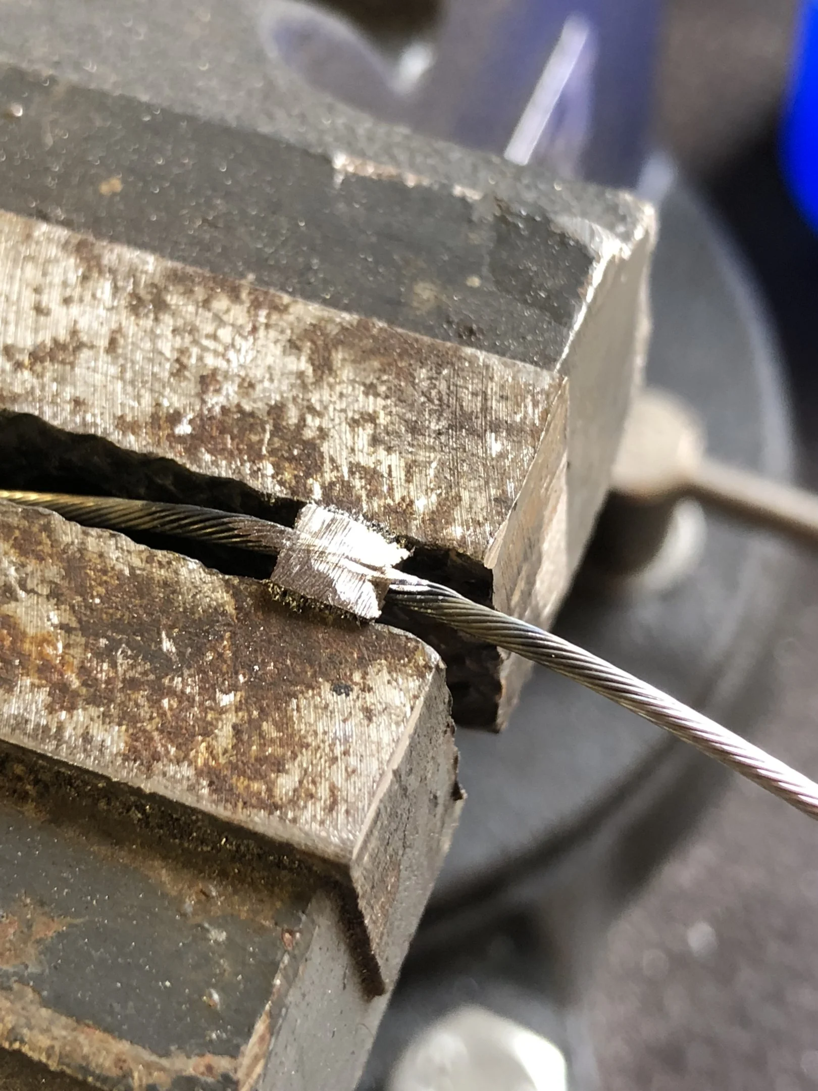

The doors are now finished with the longer release cable coming courtesy of a Fiat Doblo which happens to have the same barrell end on it. A small bit of fettling and some brake cable sleeve and 'job's a goodun'.
The Doblo cable had one of these little widgets fixed about half way along it's length, which had to go. (carefully ground off)
And finished...

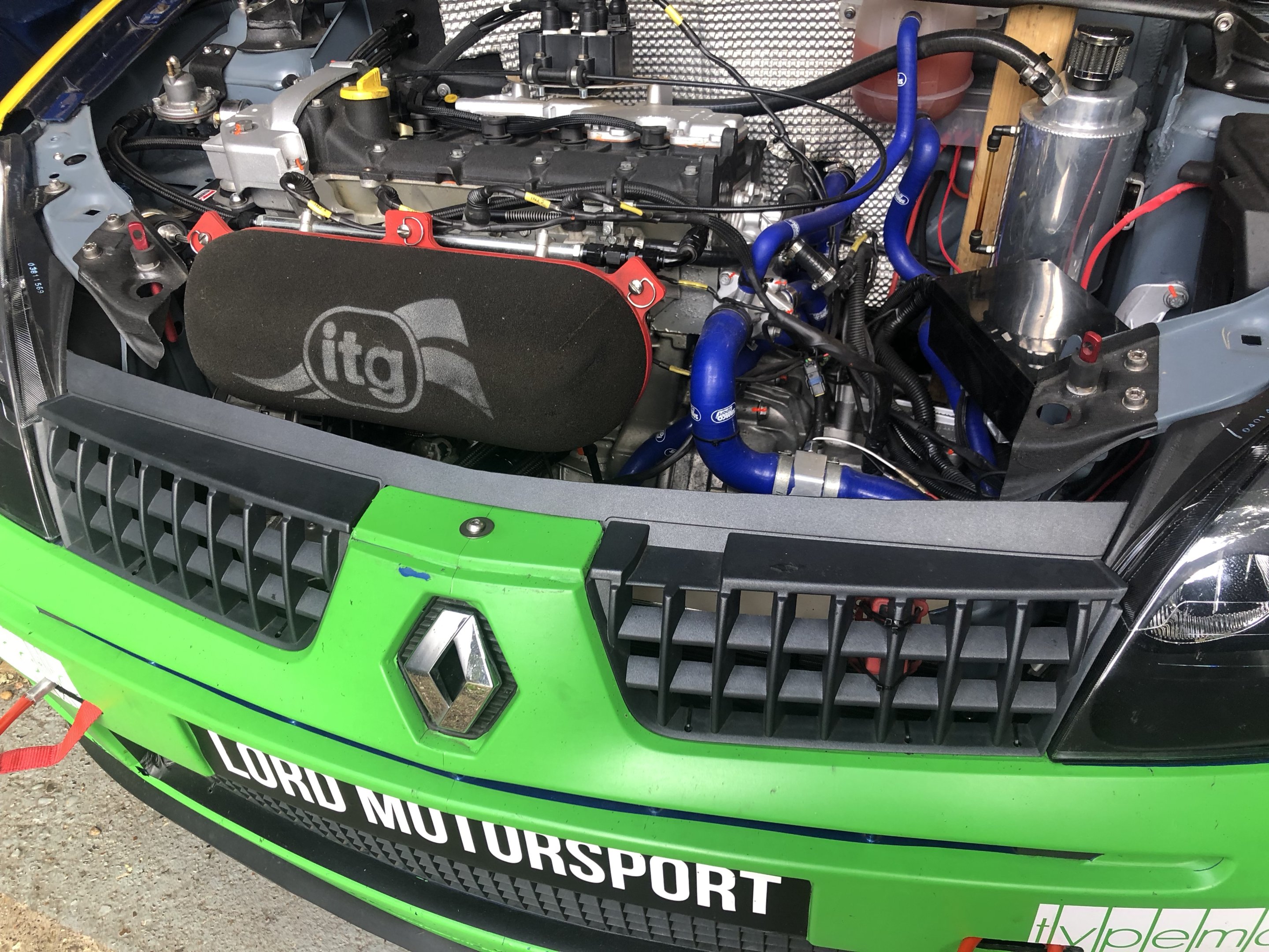

I've also modified the front bumper and grill. Mainly to give the centre of the grill more rigidity as there is no slam panel anymore and I know that fibreglass bonnets can be known to flap a bit, so if it needs tethering on the nose it's got something firm to fix to.
A fairly simple solution that should be sufficient hopefully.

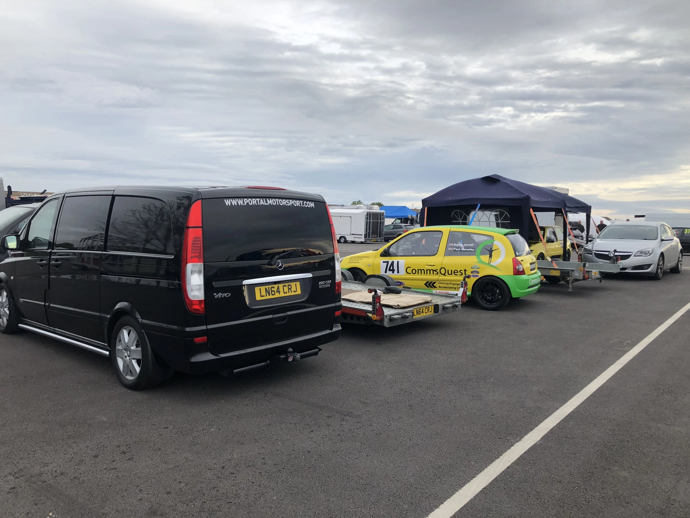

Well, what a weekend!

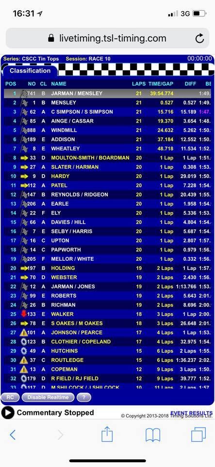

Was it a GP circuit? Just curious what was your lap times [emoji4]
Yes, GP circuit. Best was a 1.49.2.
What was your turbo monster doing?
1.48.38
Not much faster haha
But in my defence [emoji13] this was my first ever outing in this car. Defo can do better.. but considering the power I have a be it only 230bhp it’s not an impressive time... but saying that my mate in a 600bhp GTR does 1.47... and he is a good driver not just some amateur.
1.48.38
That time sounds decent to me mate. You were on slicks weren't you? They would help massively. We don't have that luxury!
