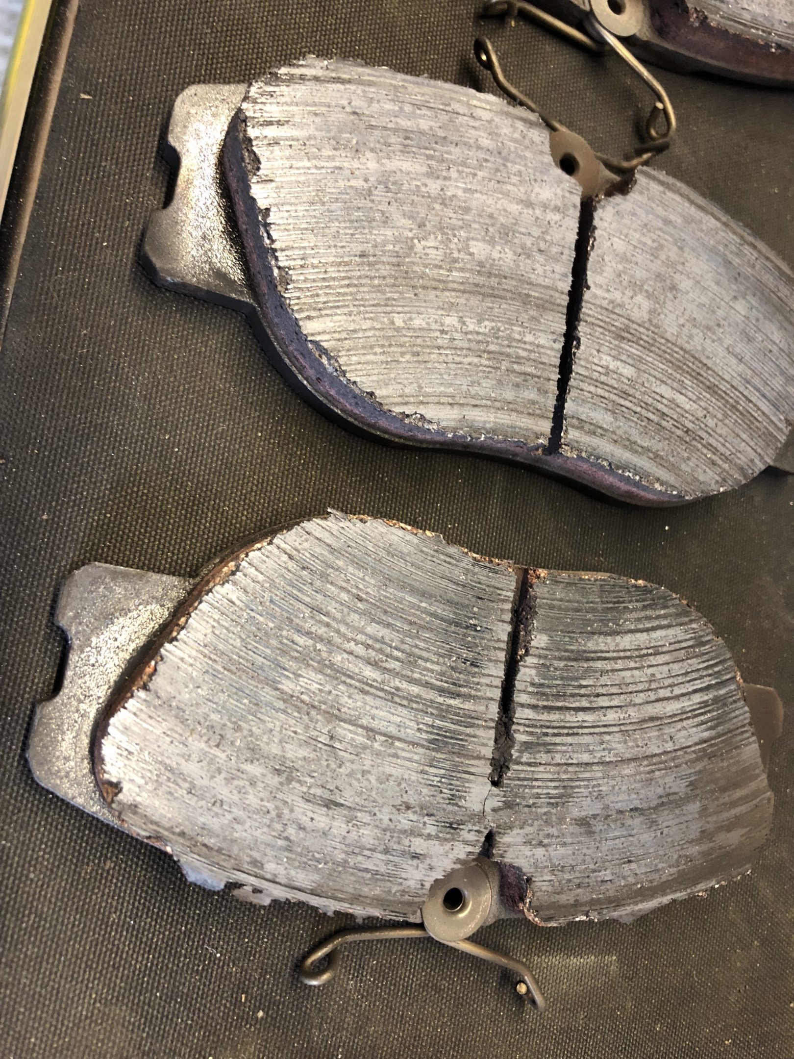

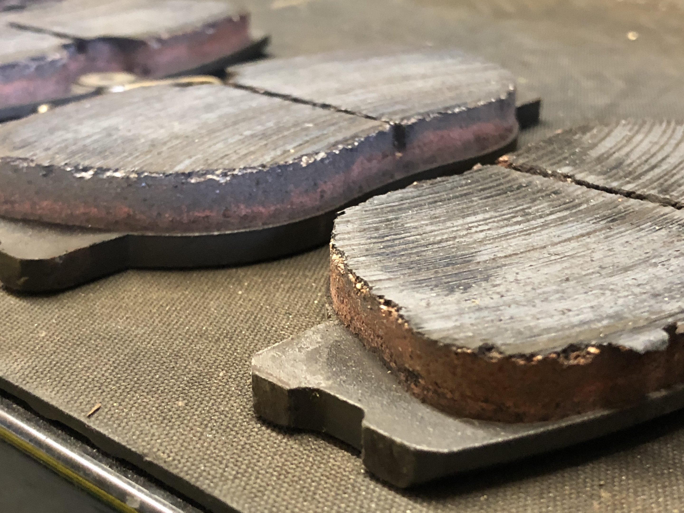

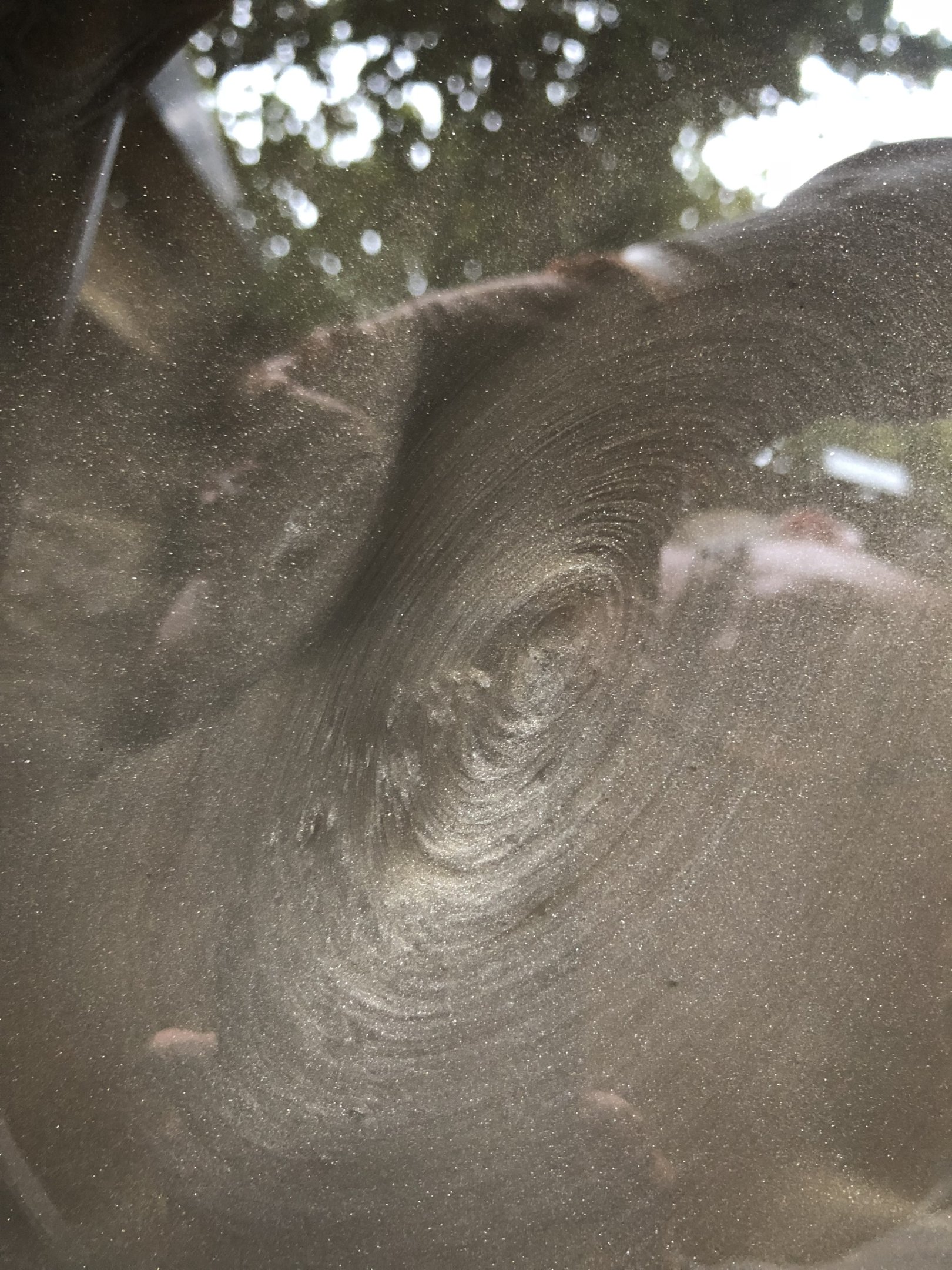

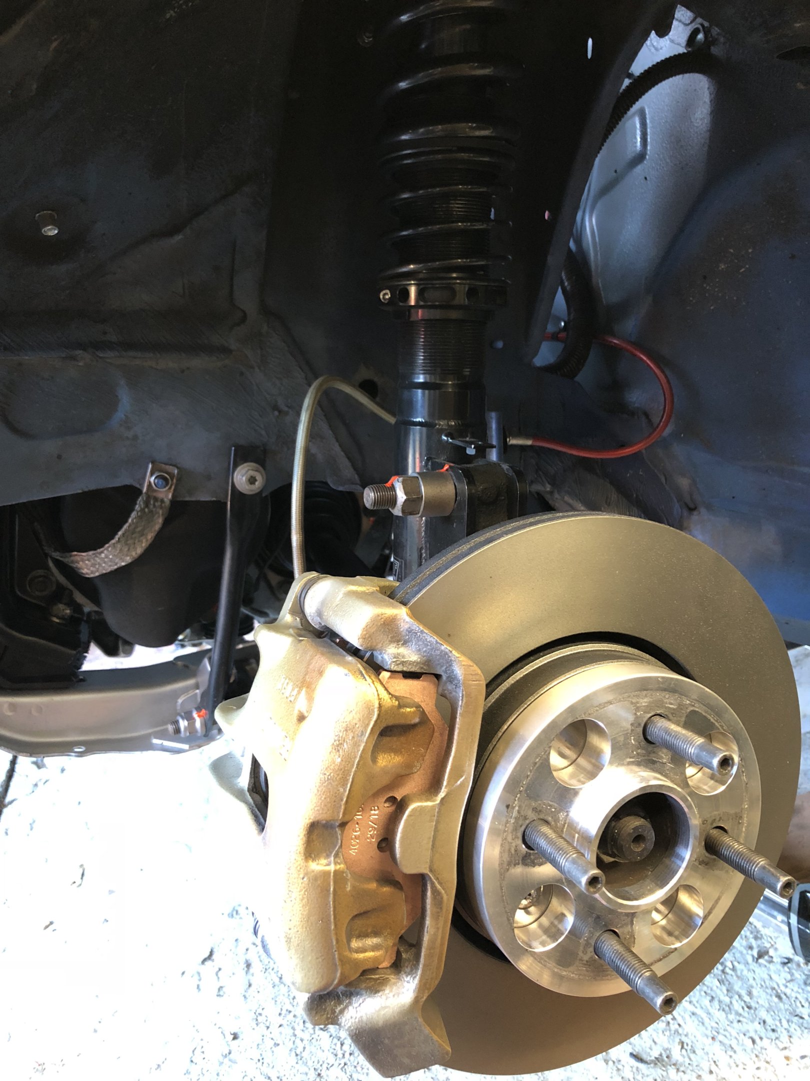

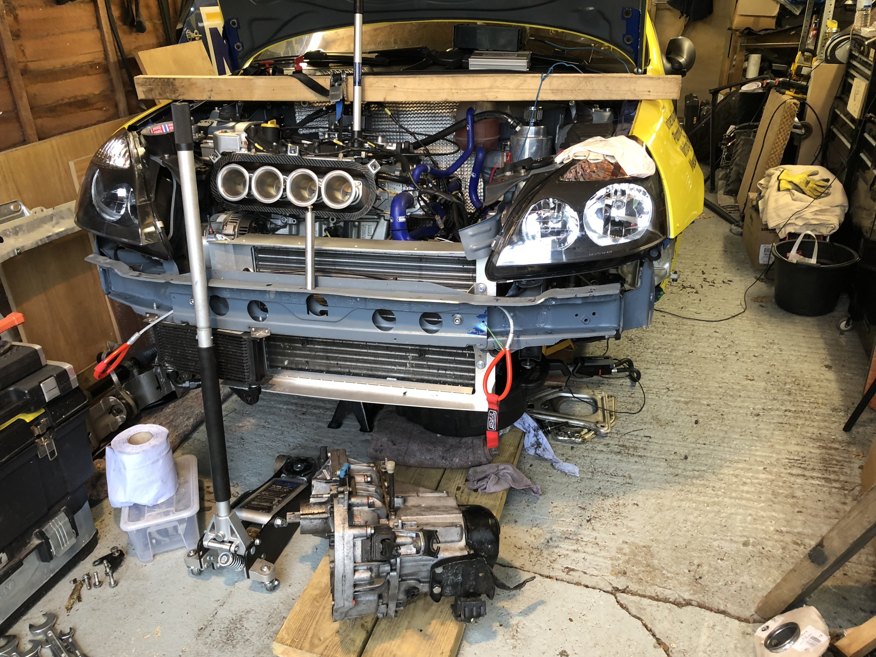

This weekend the brakes were stripped and the gearbox dropped out. Doing everything on my own, some of these jobs definitely take longer than with 2 people. But after starting about 10am on Saturday it was all out by 4pm, allowing a stop for lunch of course!

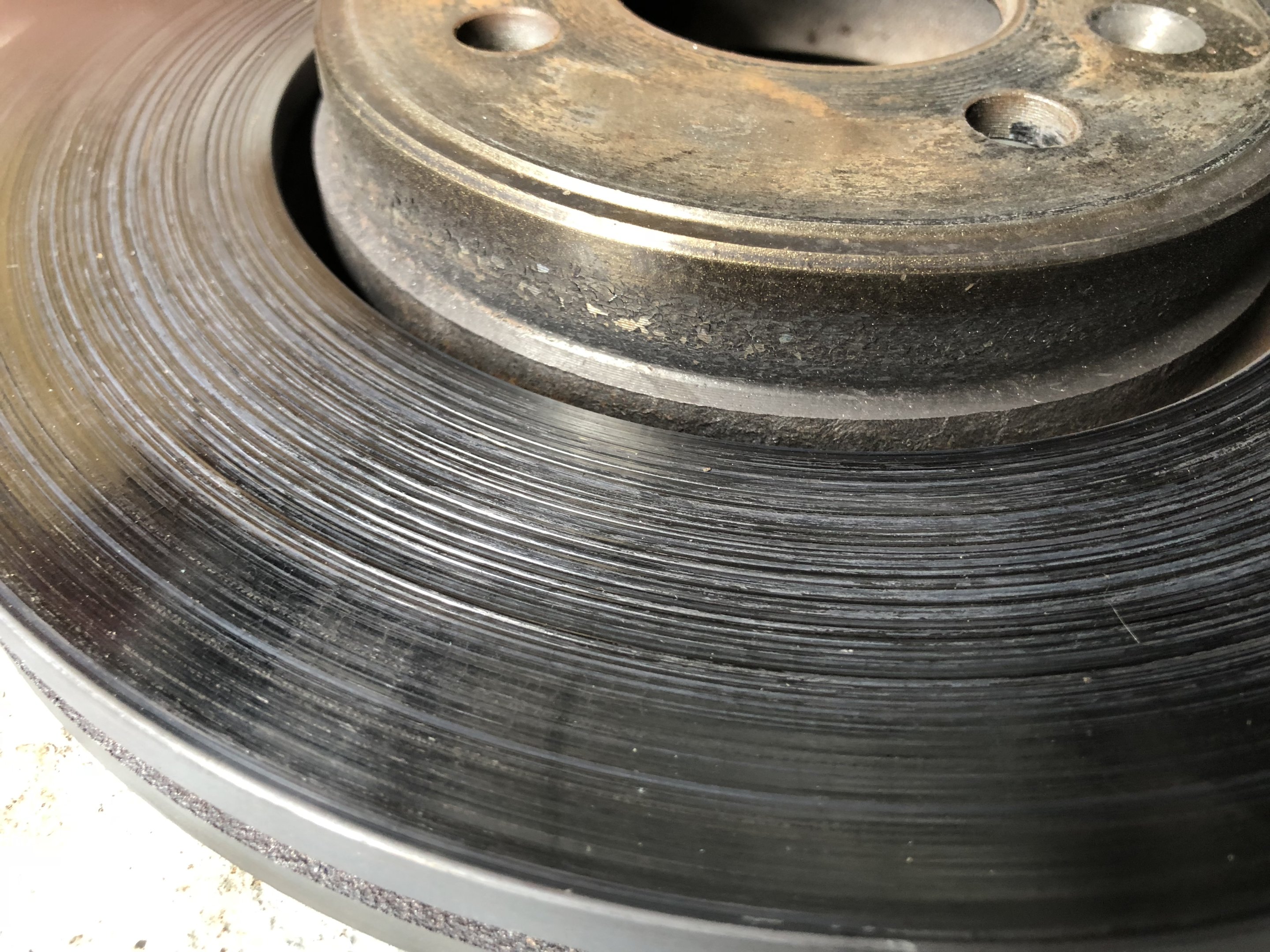

These are DS1.11 pads on Brembo HC discs. Clearly a very aggressive pad and possibly a bit too aggressive on such a small disc. I think we may go back the CL RC6s for the Birkett. A big brake upgrade is on the cards for over the winter anyway. (funds allowing)
These pads have done 2 races and 1 test day.
Ready to start

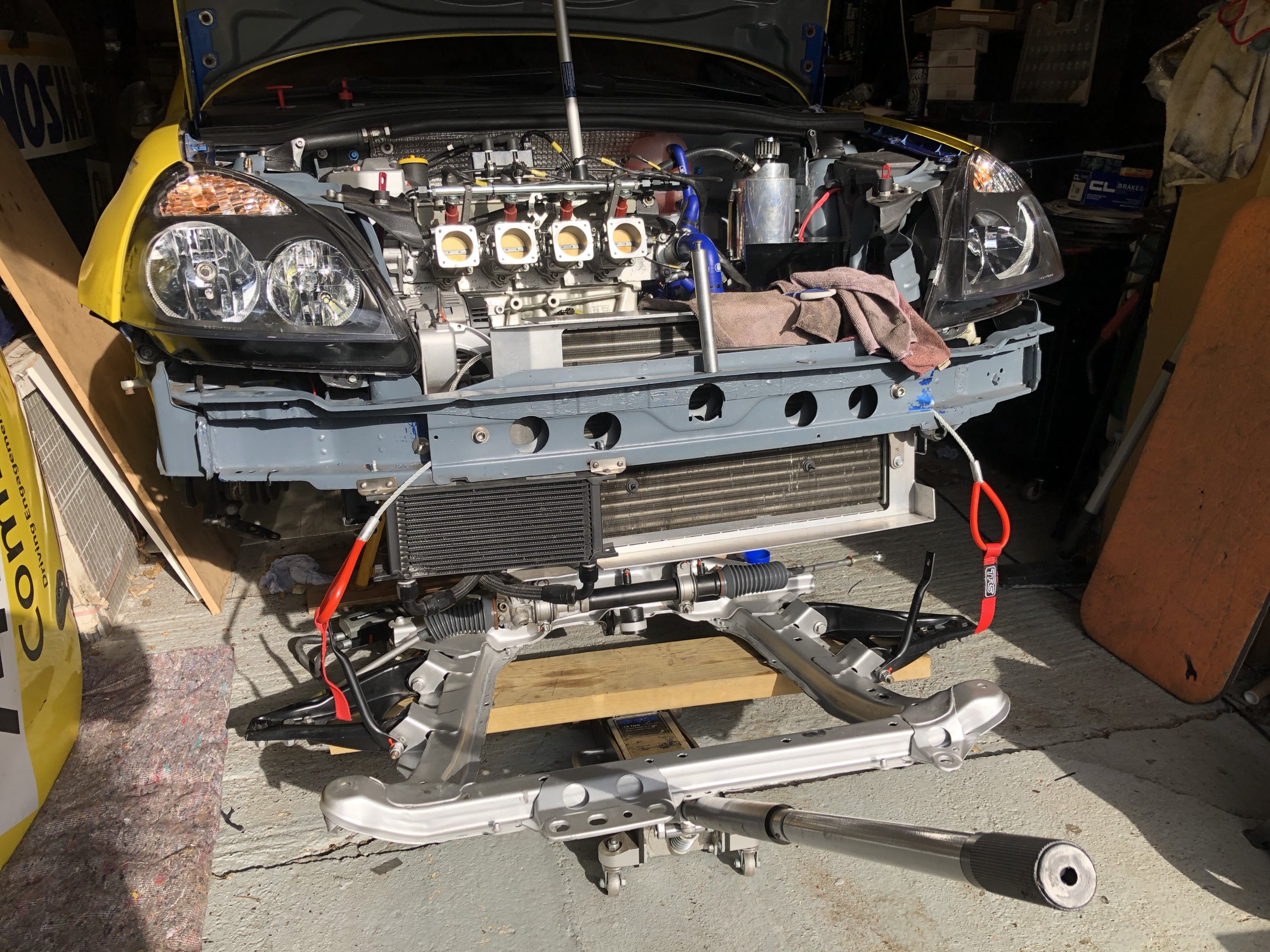

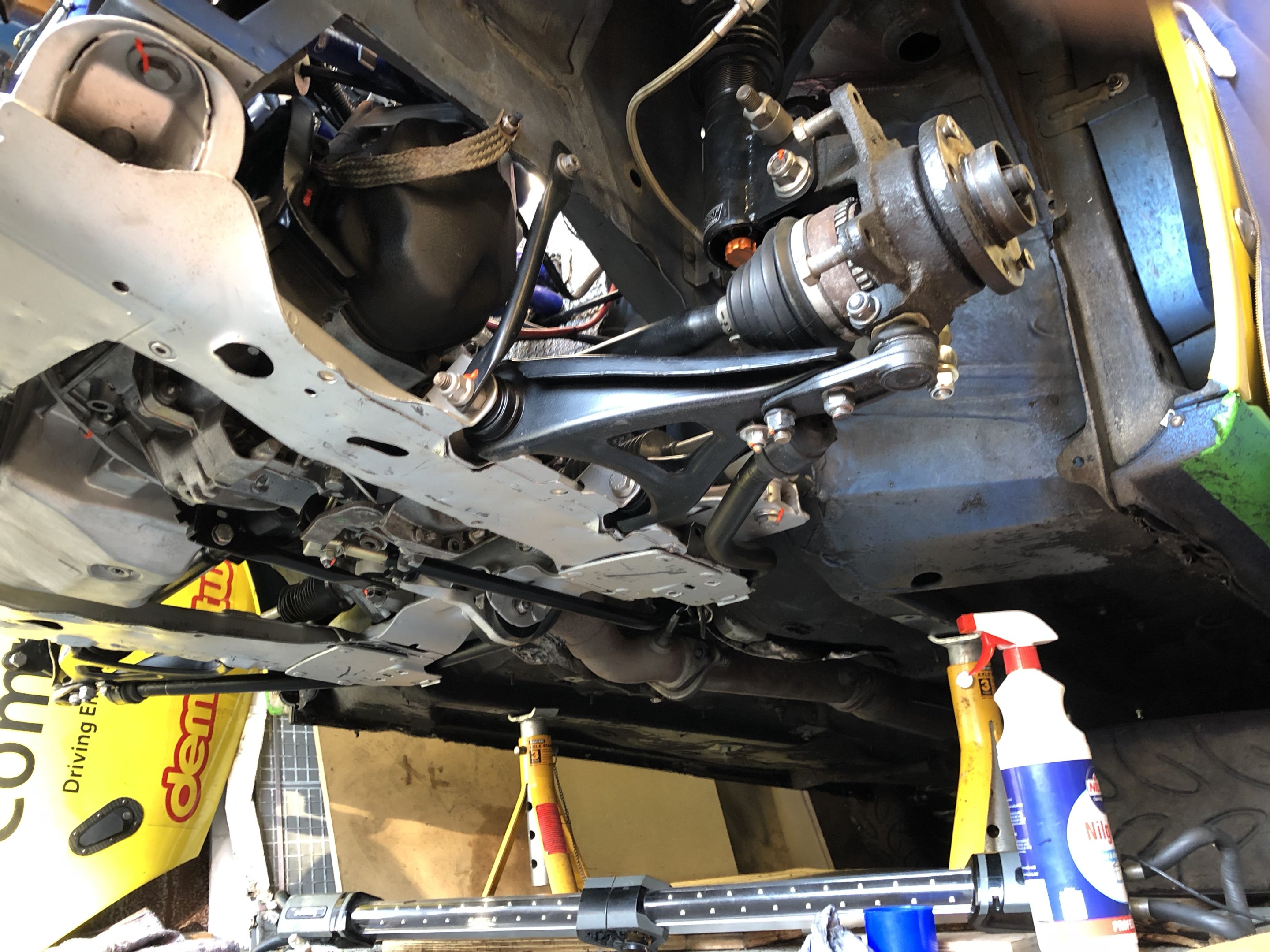

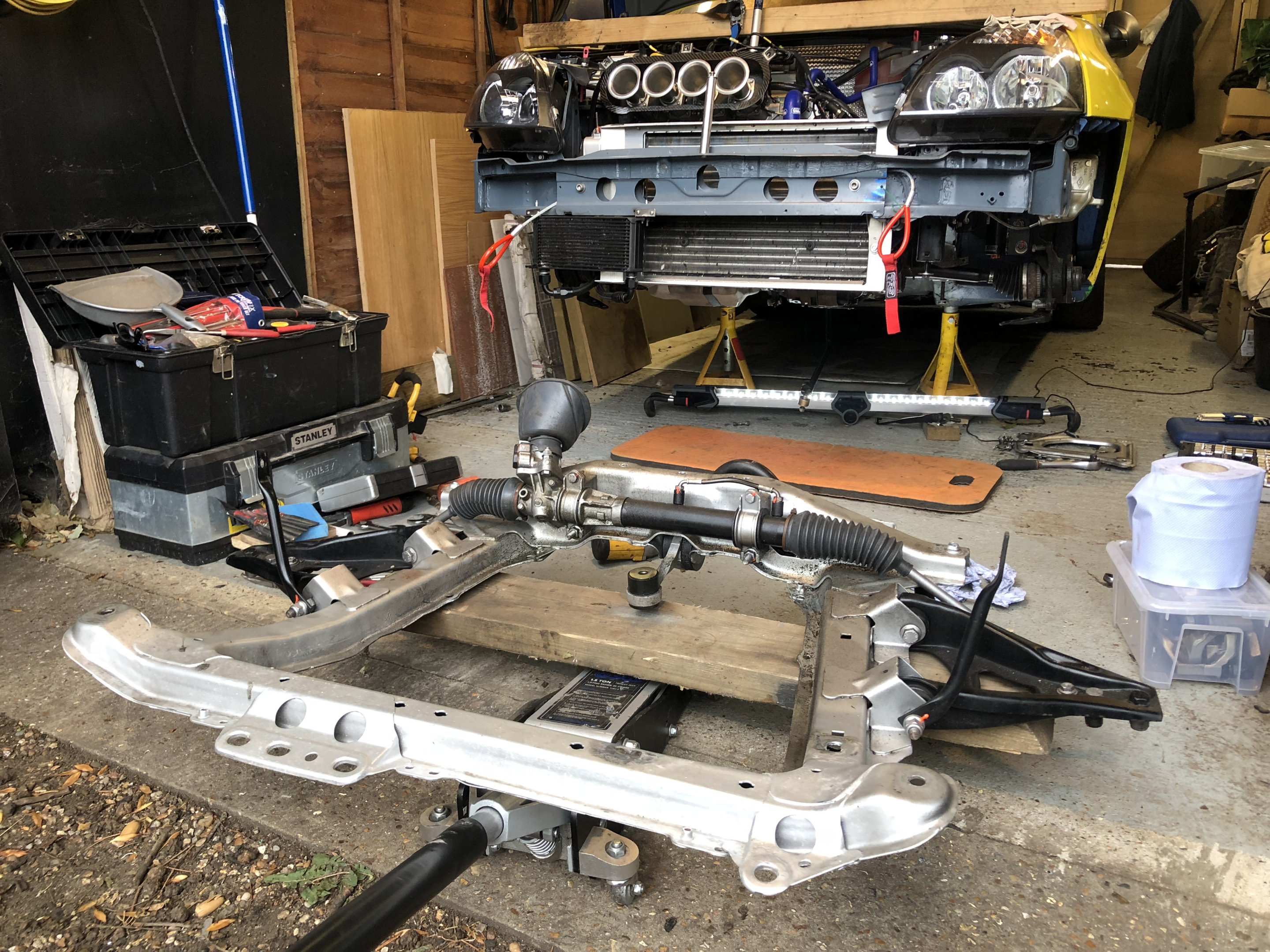

Subframe out. I wasn't going to take it all the way out but it's covered in oil from the gearbox leak so this is a good time to power wash everything.
...and finally out. Not the easiest job solo.
Glittery oil is definitely not right!

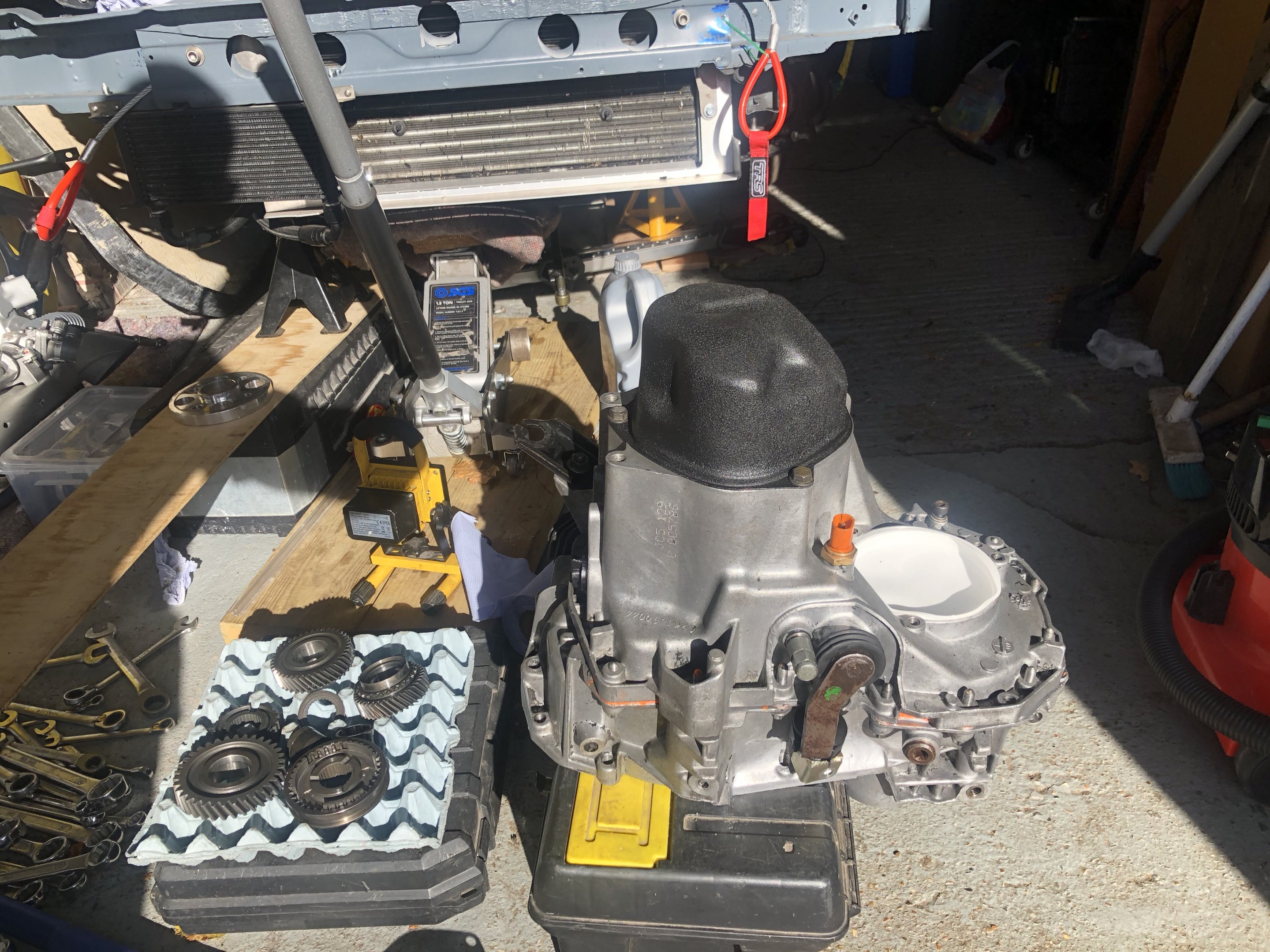

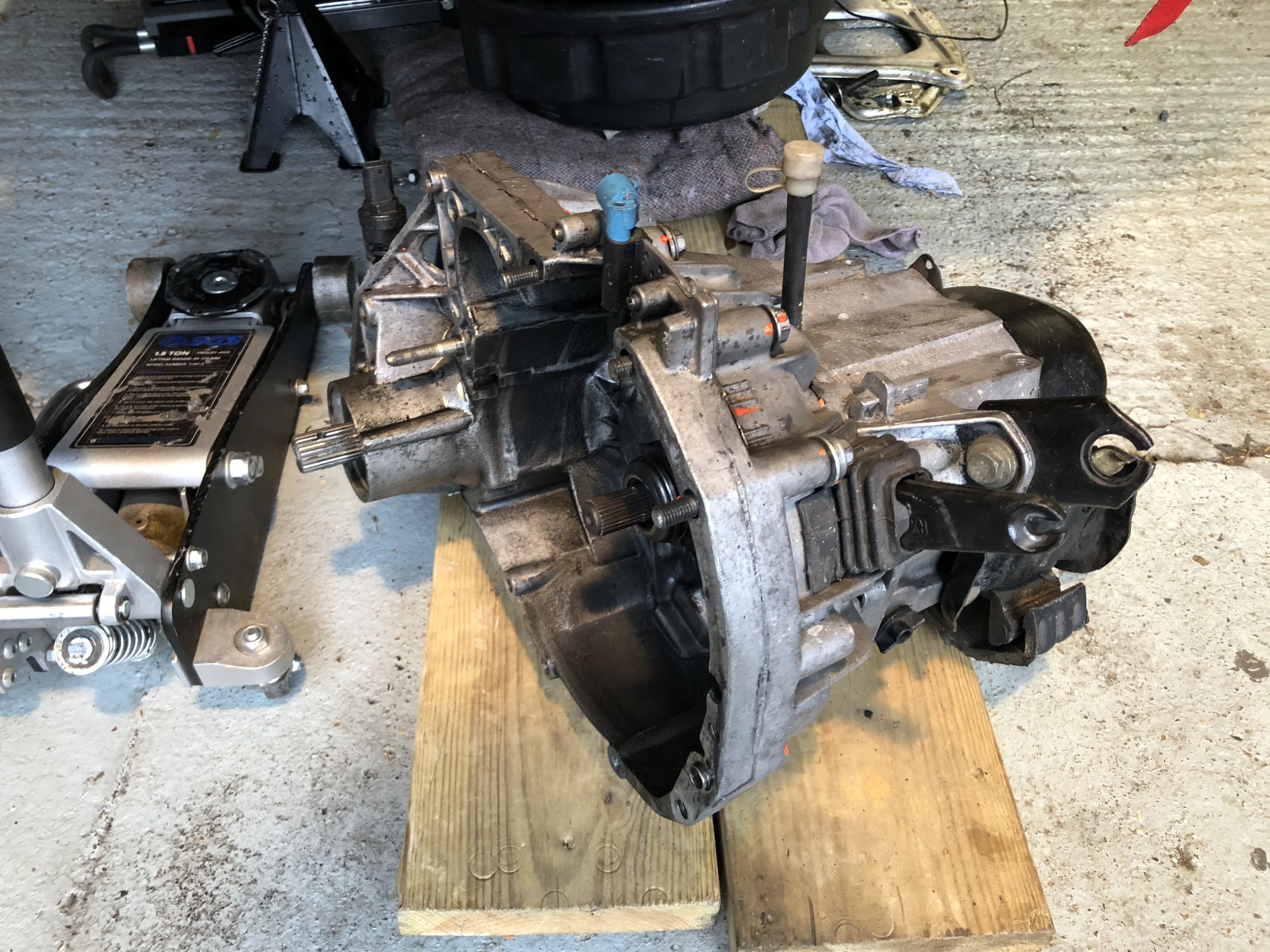

12 days to go to the Birkett, so time to get busy.

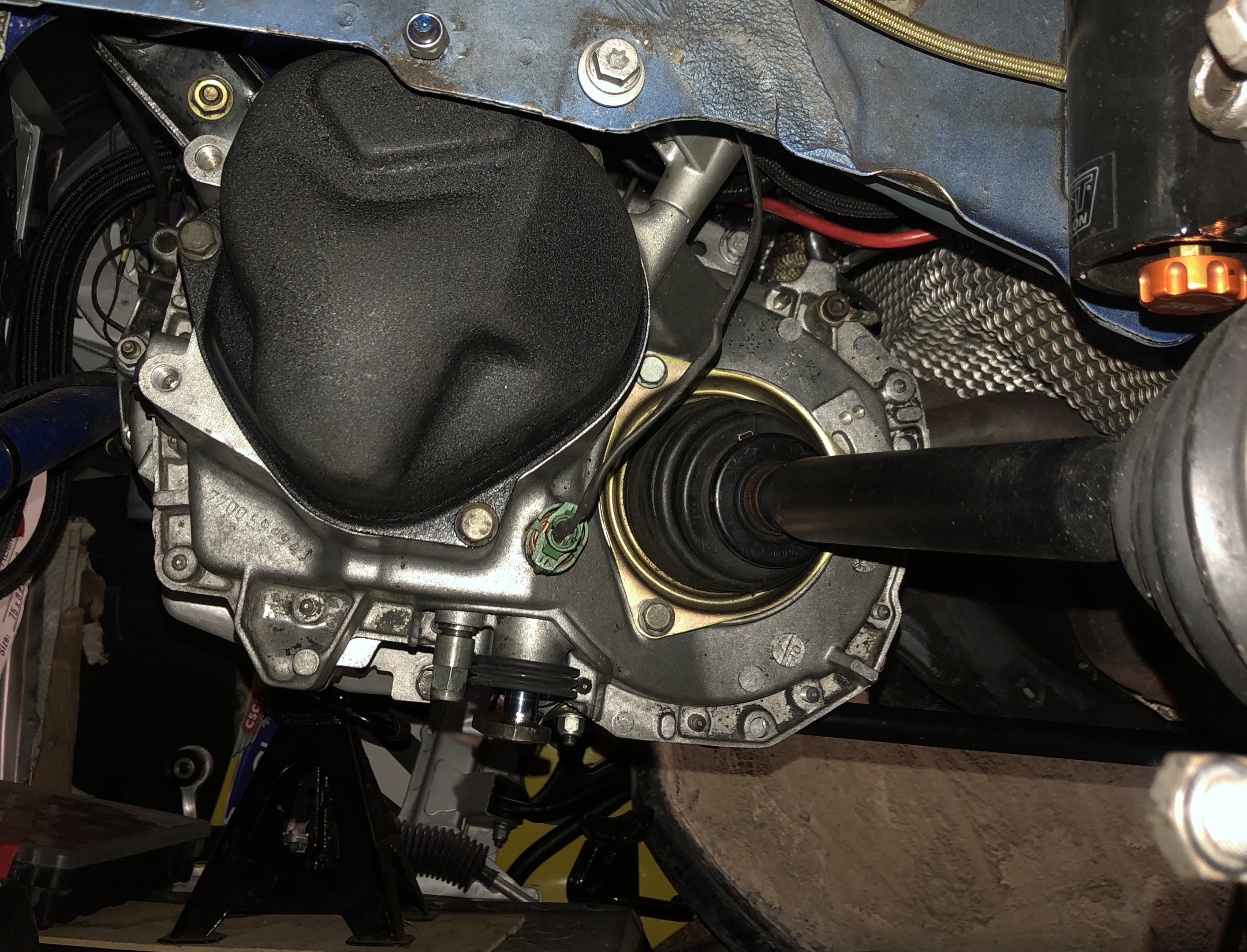

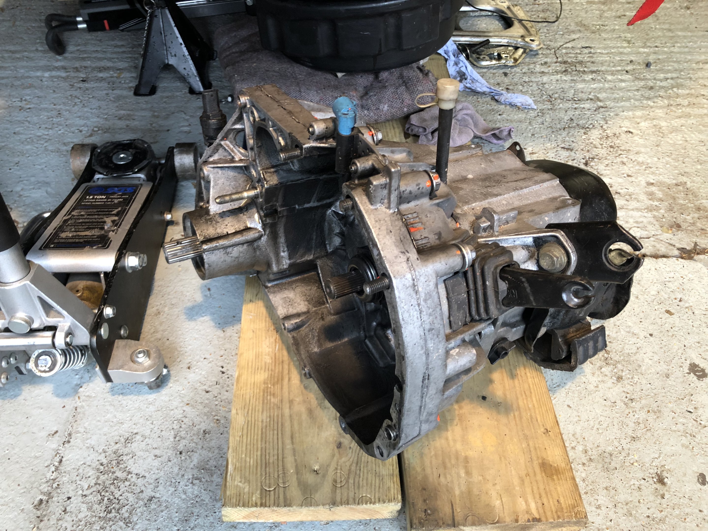

On Saturday I collected the gearbox from Mark Fish. Not a cheap rebuild with a whole new 1st and 2nd gearset, all new syncros and selector forks, plus a new shorter 5th gear added up to a parts list in excess of £700! In addition the diff went back to Gripper for a refurb and a new output shaft so now the new box should be much improved and leak free.
A couple of hours wrestling it in on my own and the bolts were all tightened.

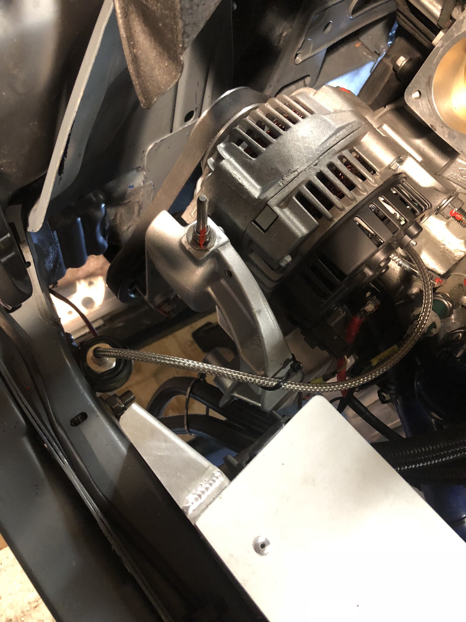

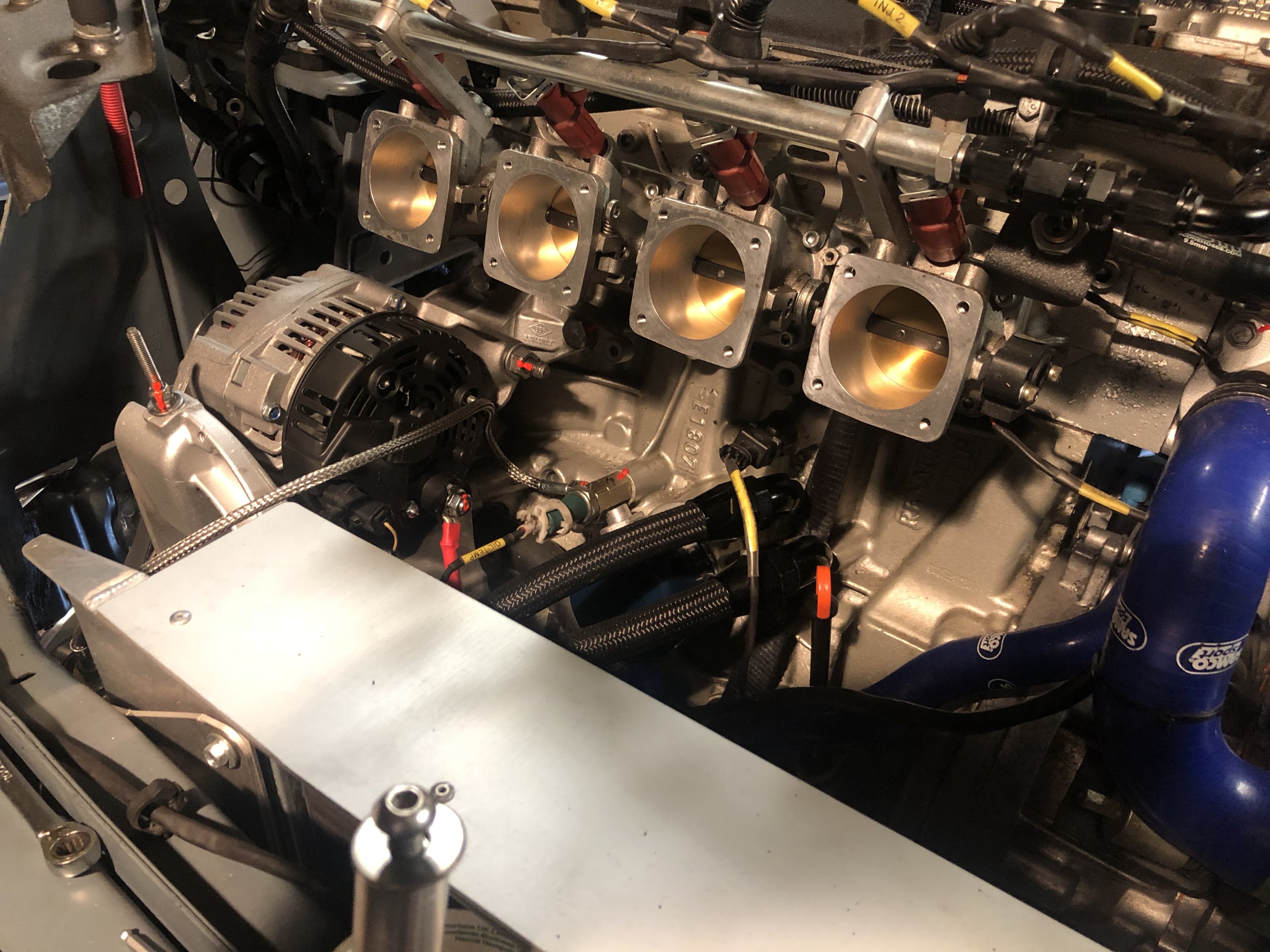

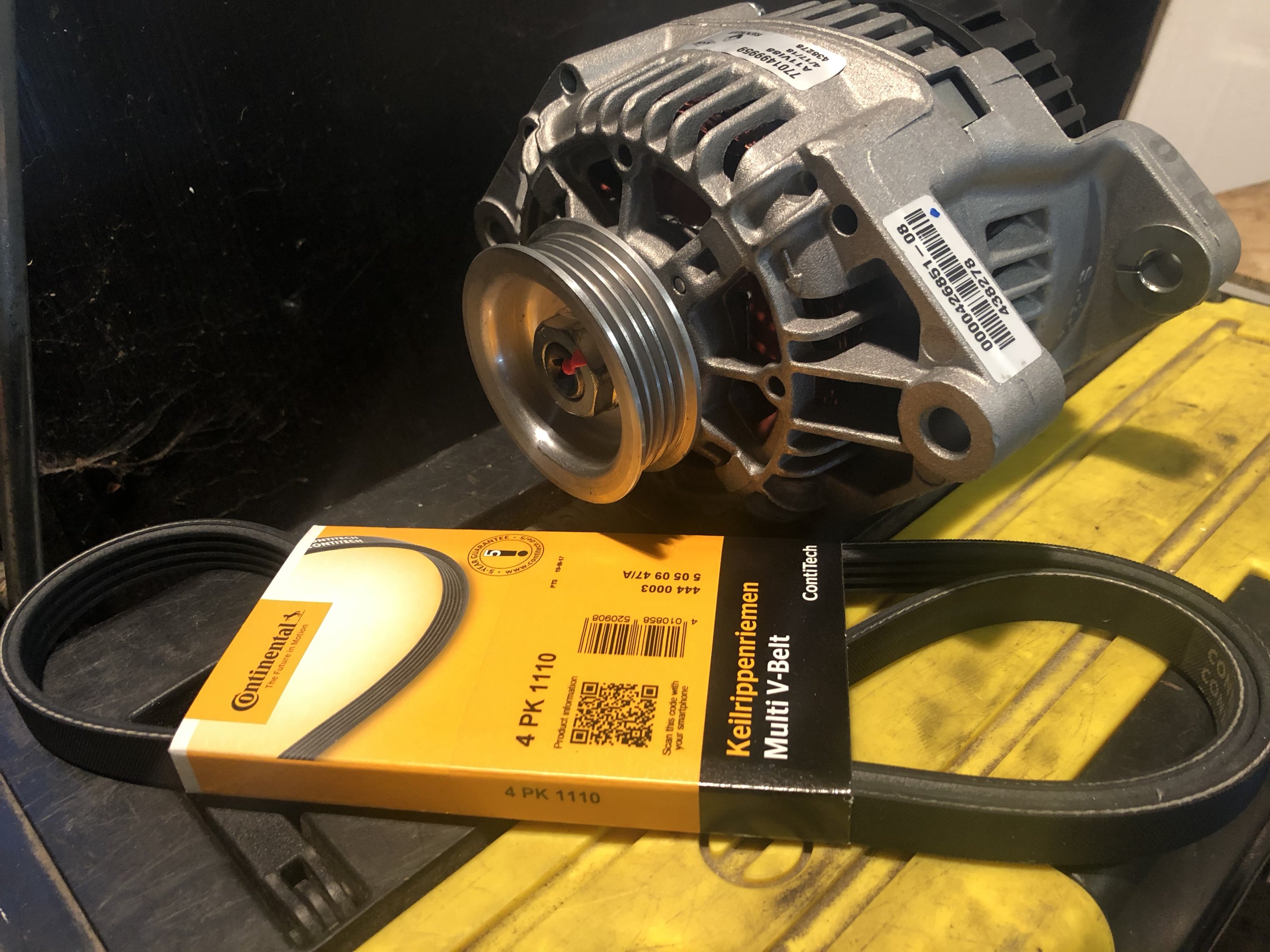

Next was a precautionary measure. I've replaced the alternator and belt. Nothing obviously wrong with the ones on it, but with the car doing 2 1 hour stints during the race it really needs to be on form.
And with the alternator off I found another loose bolt on the lower alternator bracket. Another bullet dodged maybe.
And finally this evening I've relocated the oil pressure sender. Before it was mounted up behind the headlight and I think the height of it was the cause of the low oil pressure readings the dial was giving me. Now hopefully, with it down beside the radiator we might have some meaningful figures on the gauge.

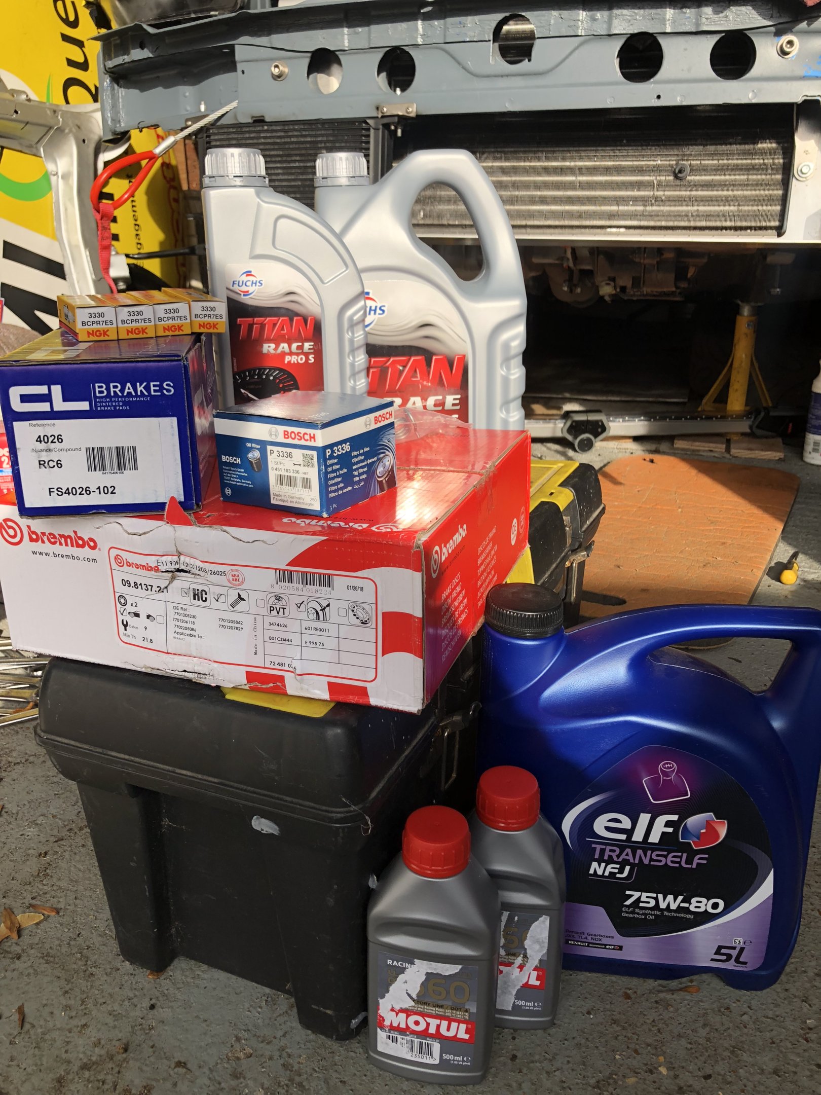

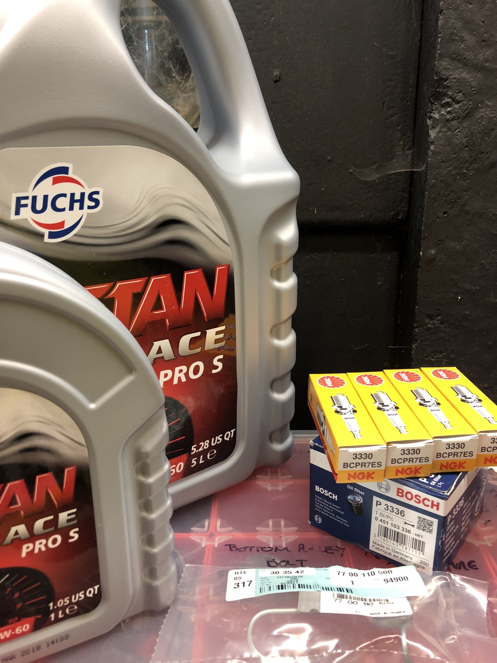

I've ordered oil and a filter for the engine, gearbox oil (obviously), new Motul RBF660 brake fluid which will hopefully handle the high temperatures better; new spark plugs and new front discs and pads. I've reverted to the CL RC6 pads for the Birkett which should be kinder on the discs and if the brake upgrade happens over the winter this is all they will be needed for anyway.

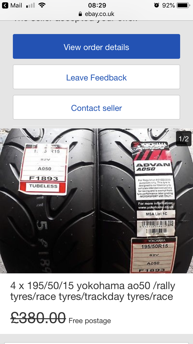

Where do you source your A050’s?

I get mine from Adams & Page in High Wycombe. They support the CSCC so I think we get a bit of a discount.
There don't seem to be many people selling them yet though. Possibly because they are not a road legal tyre.
I paid £360 delivered for my A050’s that was cheapest I could find.

That’s not bad. A&P did them to me for £380 inc fitting. But it’s a 45 minute drive to get there for me!

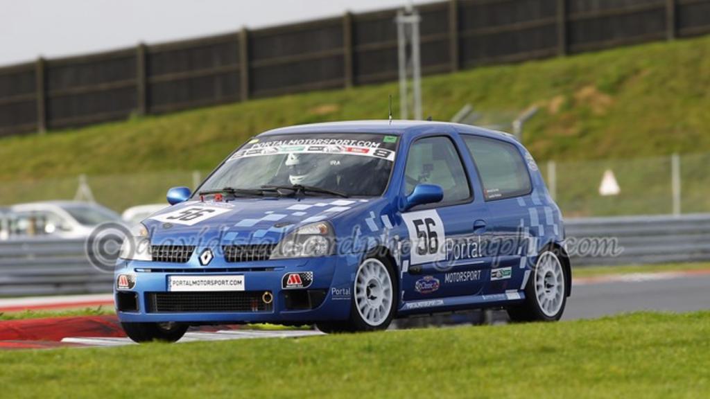

I’m not going to lie, I completely ripped off the graphics of your old blue car?! I asked for something similar and my mate literally did it spot for spot! Sorry
I think I asked you when it was up for sale where you got the graphics from via the eBay add for the car. Also I think I chatted to you when I dropped mine off at Mark Fish for it’s roll cage fitted and you were showing the potential new owner around it?
Does the blue one live on? It’s poorer yellow clone does.......
Ah yes I remember talking to you! I had 2 cars, the one I was selling then had the green check fading to blue. That car still
Lives although the new owner has had some bad luck this season blowing 3 engines and one gearbox!
The one with the white checks is the same one I have now, wrapped yellow and green.
Your car looks good with the yellow. Flattered that you copied it!

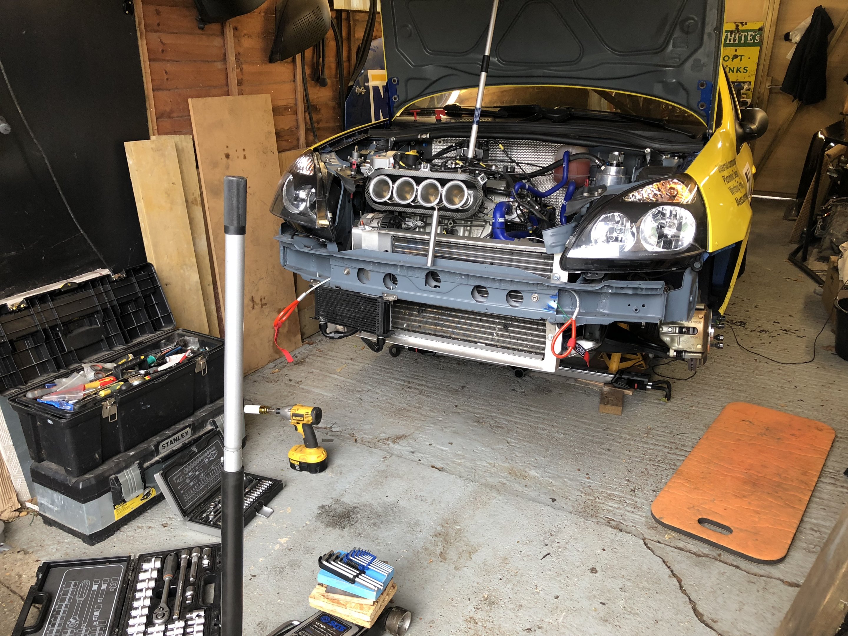

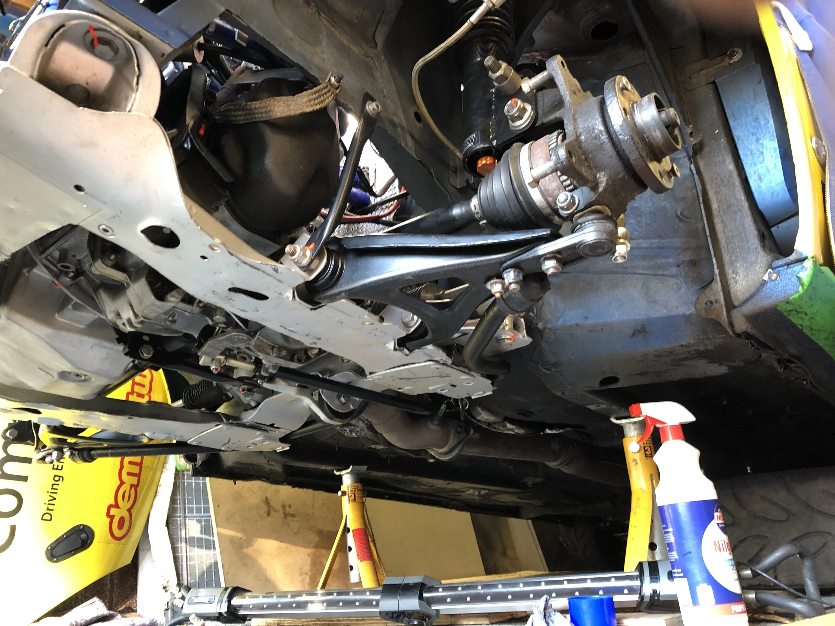

Just about ready for the Birkett now. Last weekend was just about reassembling the front end, fitting subframe back on and then installing the new discs and pads. Then just torquing everything up properly and double and triple checking every nut and bolt.
Then Monday evening it was fluids time.
The only thing I haven't done yet is change the brake fluid and as I'm out of time now. I may do it either during or after the test day on Friday at Silverstone. We'll see how they feel.
I've run the car up on the stands and all gears seem to engage and it feels miles better than it did before. Much tighter. Even reverse goes in ok with no adjustment needed to the selector linkage which saves a whole heap of pain.
And finally this evening I've reinstalled the in-car radio. This should make things much easier out on track.

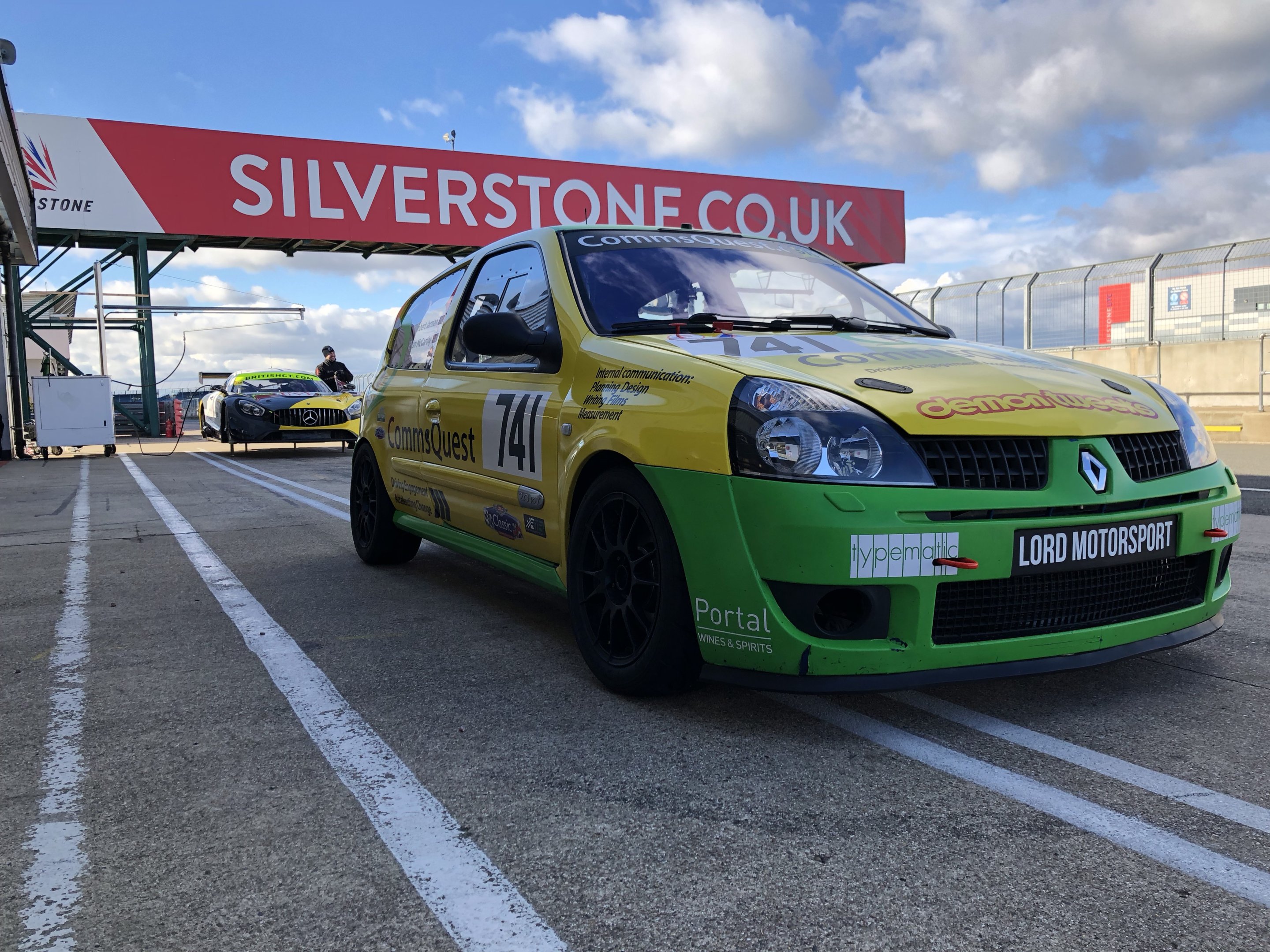

Birkett 2018 - Silverstone GP
Over a week ago now, but shortly after the race I came down with the manliest of man-flu that I've experienced! I'm still suffering now, so I've been a bit slow updating this.
Firstly, for anyone who hasn't been before or even knows what it is; the Birkett 6 hour relay race on the Silverstone GP circuit is 6 hours of absolute gruelling mayhem held at the end of every season and is open to any closed wheel race cars as a team event with a minimum of 3 cars and typically 2 drivers per car. I think the maximum number of cars is 6.
There are 2 possible results from the race. Outright winners and winners under an imposed handicap system giving (in theory) any team a chance to win, regardless of what cars you drive. As an example, 2 years ago a team of Hyundai Coupes won it!

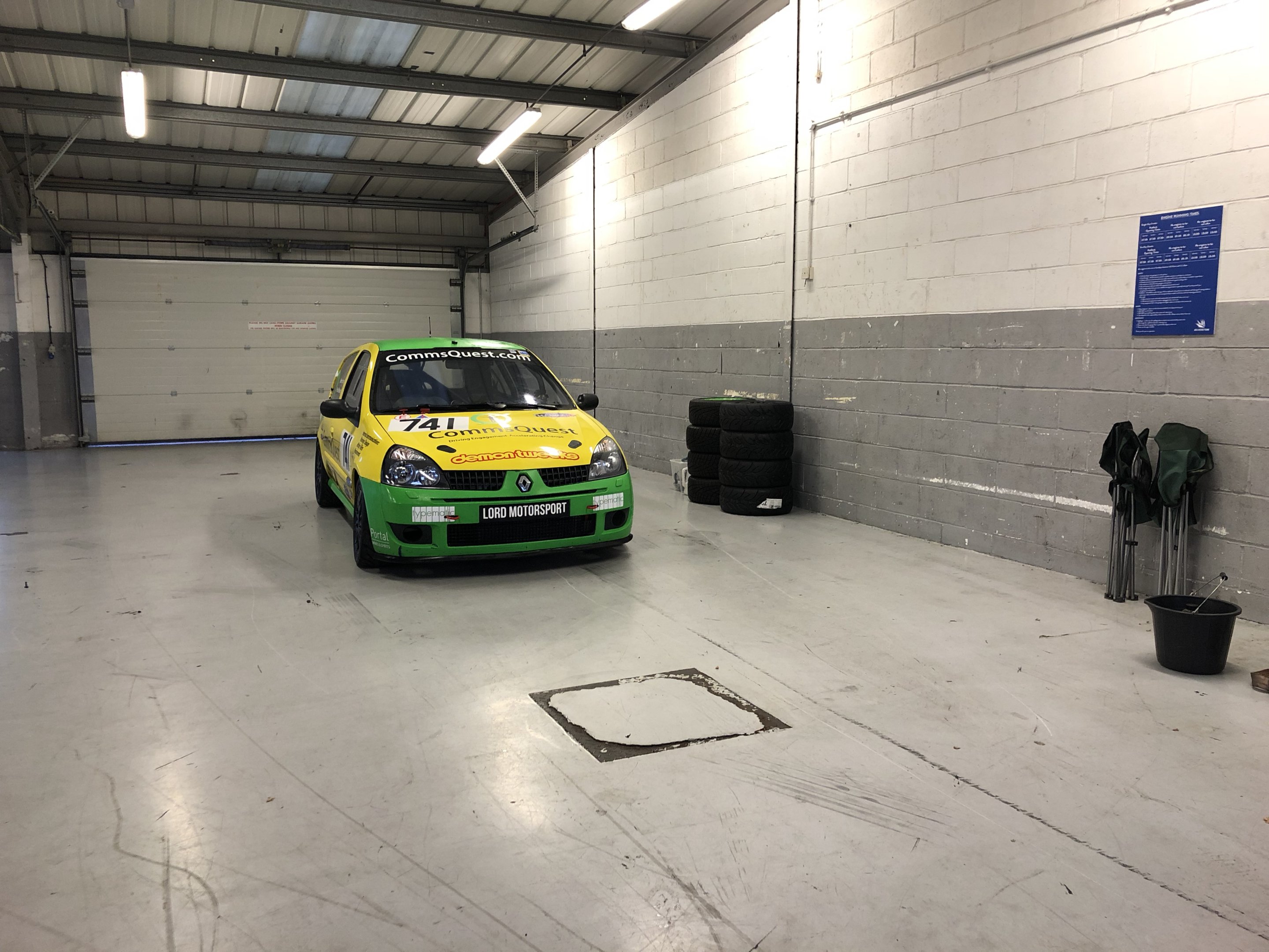

So, we arrived at a damp Silverstone early Friday morning for a day of testing which we needed, having never driven the full GP circuit before and Ryan, my co driver for the event not having driven the car since our last visit to Silverstone back in May.
The calm before the storm.

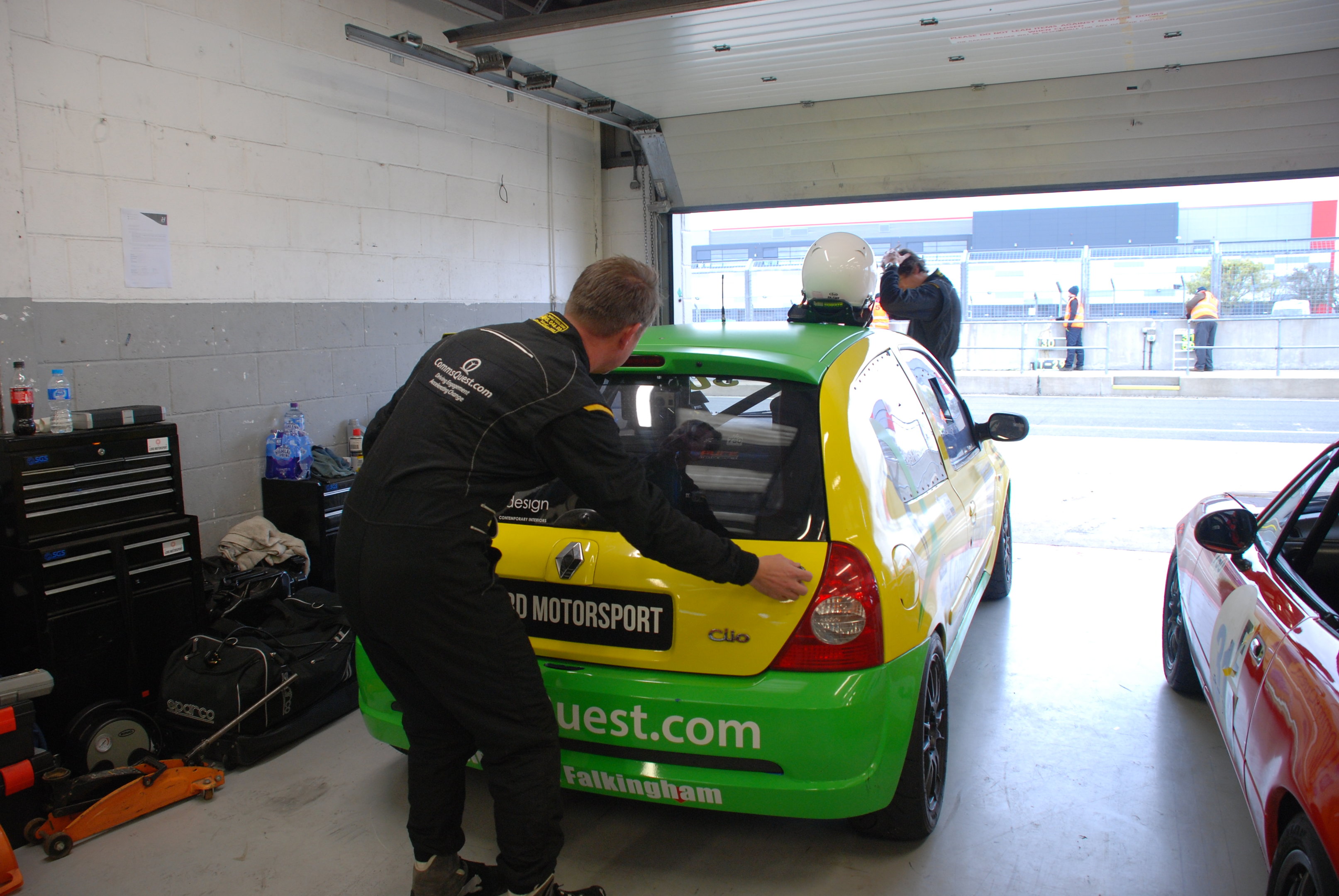

Friday evening we were able to get the cars scrutineered and then we set ourselves up properly in the garage before heading off for dinner.
Come Saturday morning and it was cold. REALLY COLD. our practice session started at 9.30 and under a glorious sunny sky we got started.

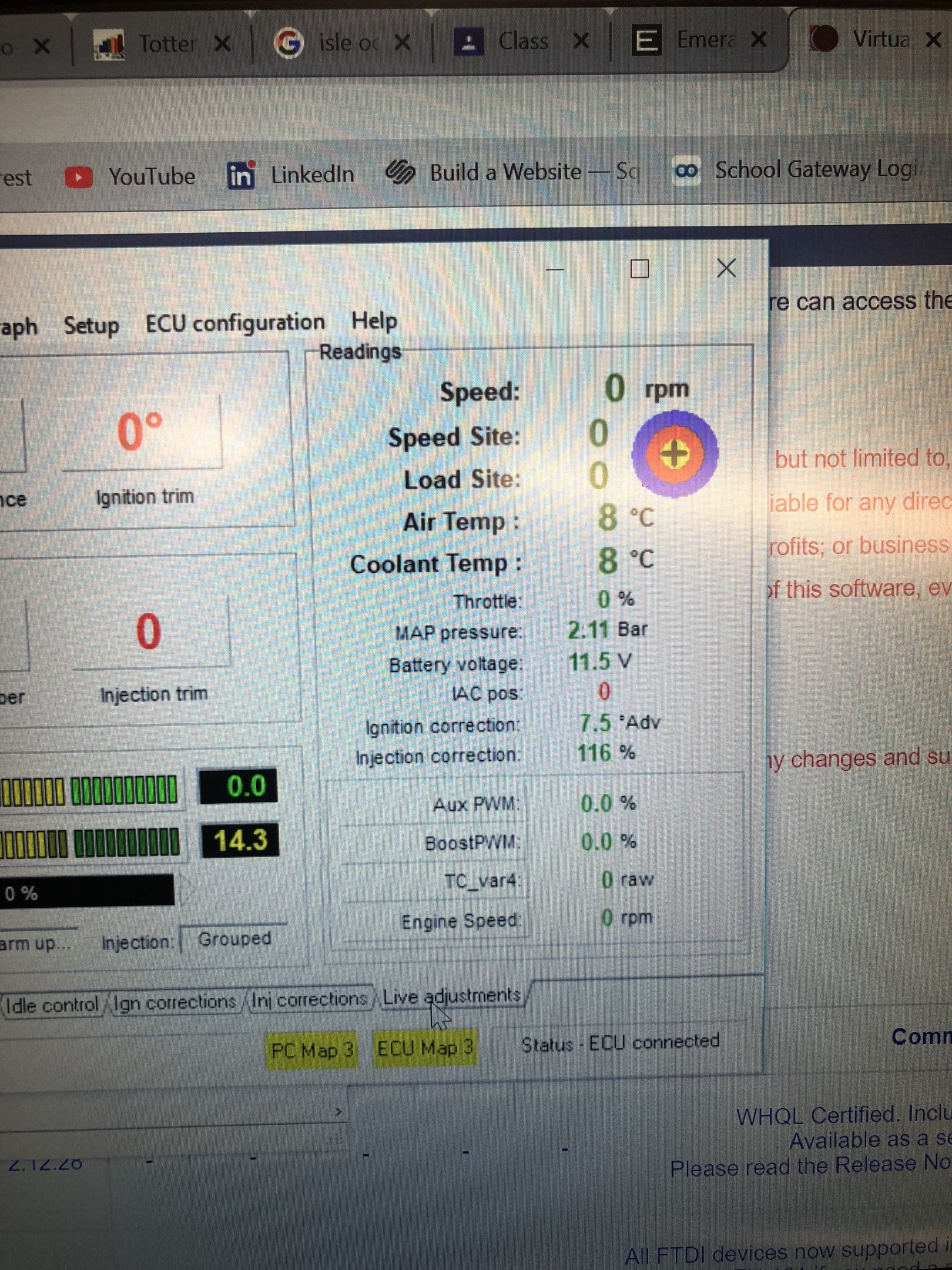

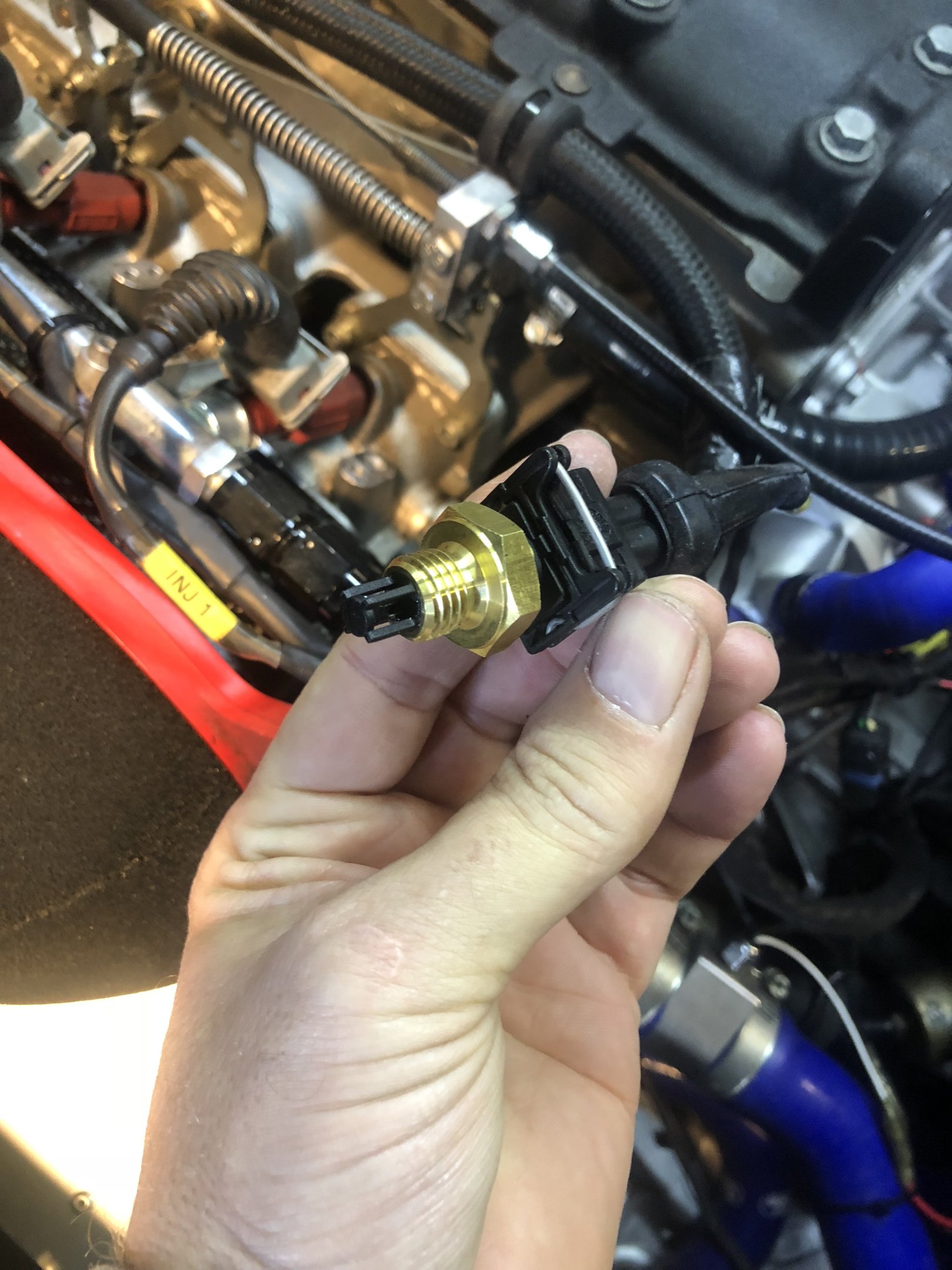

After our sessions were done the car was feeling a bit sluggish. Under the bonnet we discovered the bracket holding the air temp sensor had snapped with fatigue. No bother, we cable tied it up and went out again. Still no better and when we came in again, the sensor had completely fallen off.
We replaced the sensor and plugged the ECU in to the laptop. Air temp was reading 80 degrees and the map was retarding the ignition to compensate. Nothing we could do as the race was due to start and Ryan was out first.
We each had a 45 minute stint to do, alternating the cars with the exception of Ed in his 182 spec Clio which we agreed would do one 1 hour stint in the middle, as he had no co-driver and being down on pace this should still give us a decent chance.

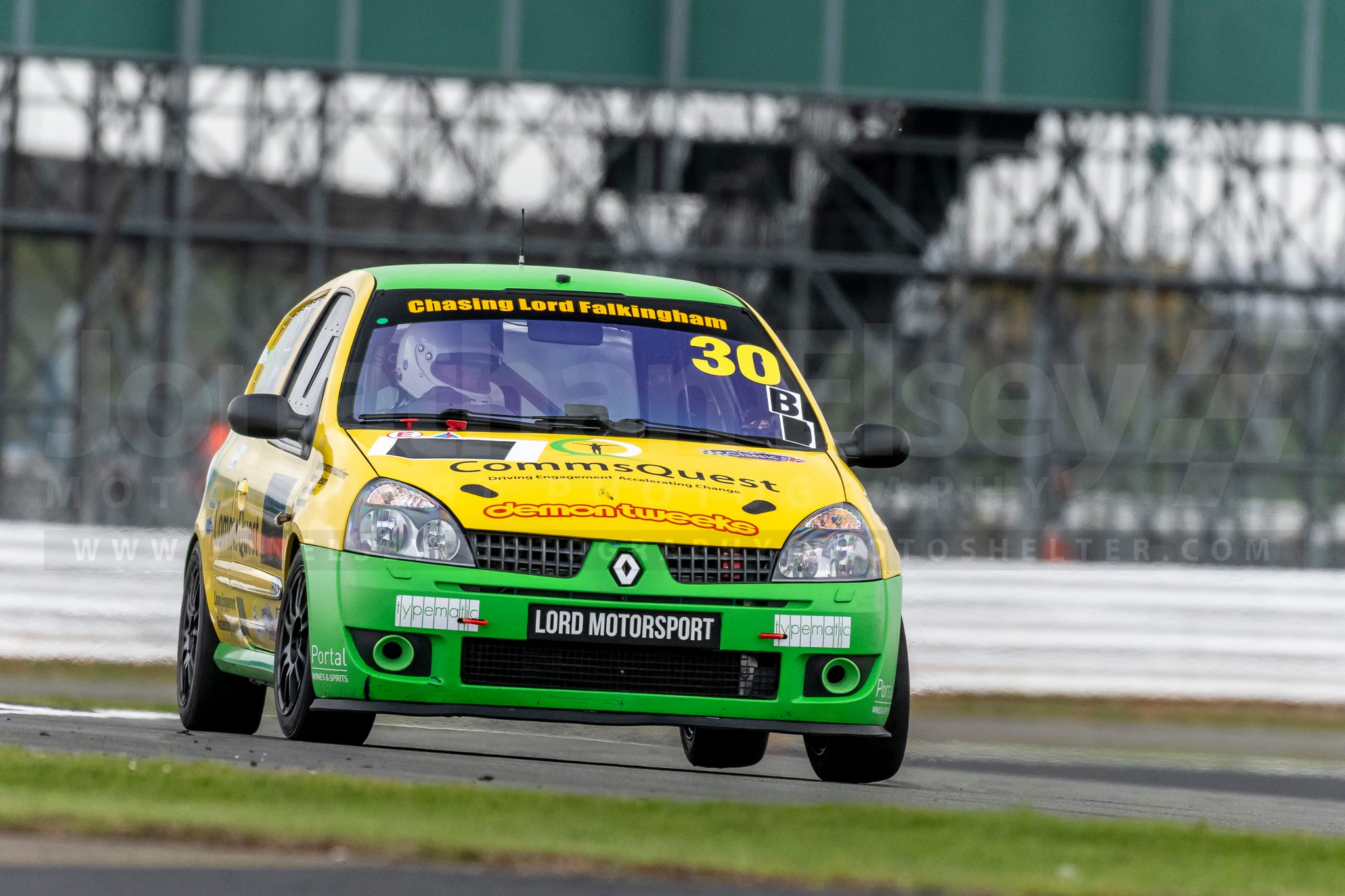

All this became academic when this happened on the 1st corner right at the start.
Ryan got bitten by the cold tyres in a fundamentally rookie mistake which subsequently put us right to the back of the pack. Recovering from this proved to be an insurmountable task.
The cars ran well for the full 6 hours, but this spin and then one of the other Clios having an off in to the gravel later meant our finishing position was 45th at the chequered flag.
And did I mentioned 4 hours of the race were in torrential rain. Another challenge for us as we had absolutely no wet running in the car. We put the R1Rs on and guessed at the pressures; disconnected the rear ARB and kept everything crossed. With the cold temperatures as well it wasn't easy but both Ryan and I managed to keep the car on the track and off the grass and gravel. Many other competitors were not so fortunate and there was rarely a lap where we didn't see someone spinning off either in front of us or in our mirrors.
So, quite an experience and lots learnt. The cars starting problems continue to hinder us and by the end of the day it wouldn't start at all despite having a charger on the battery.

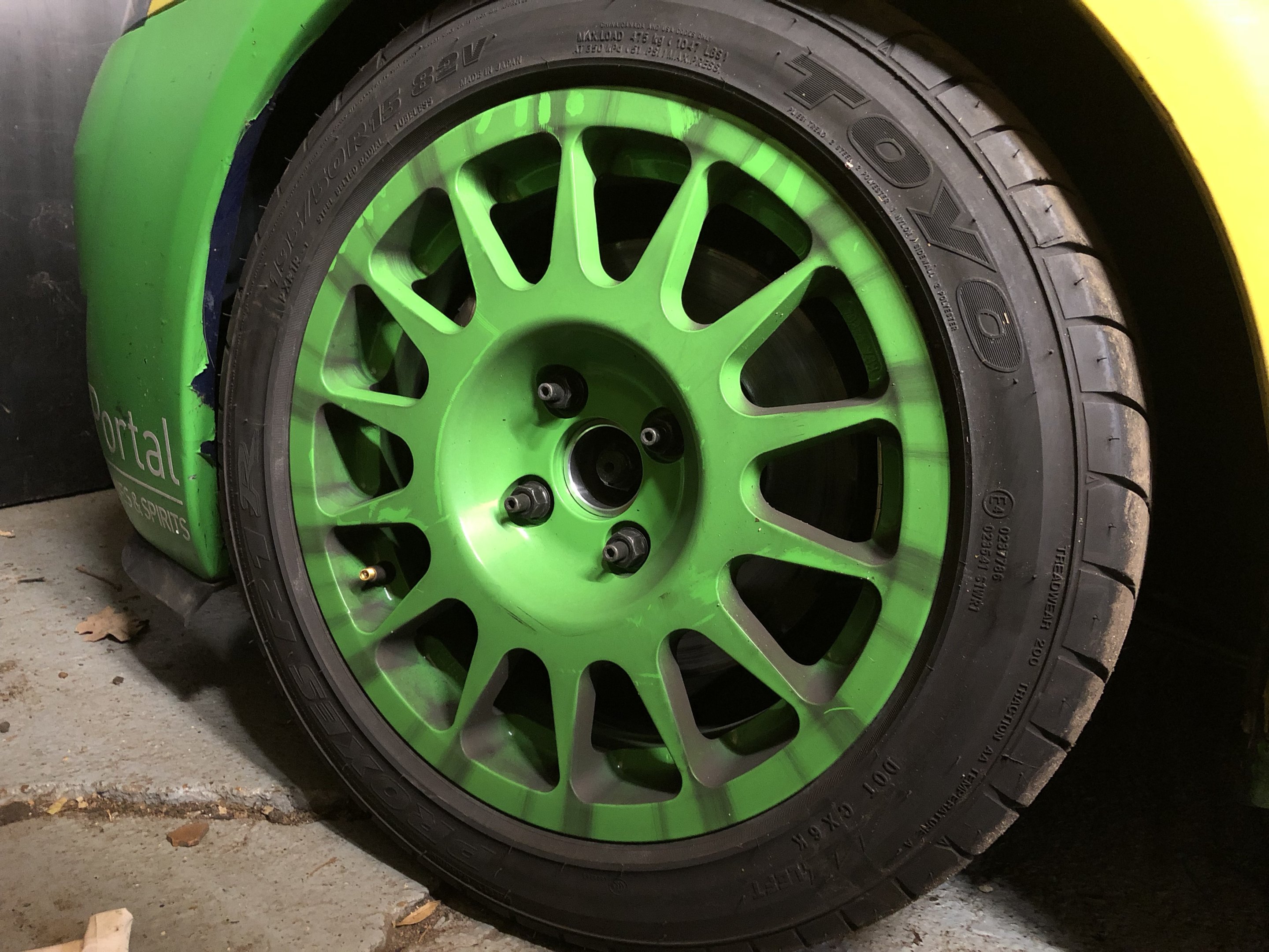

Back in the workshop, these wheels will need some attention.

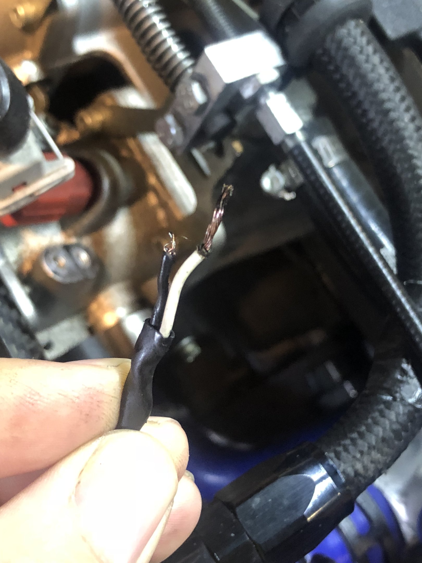

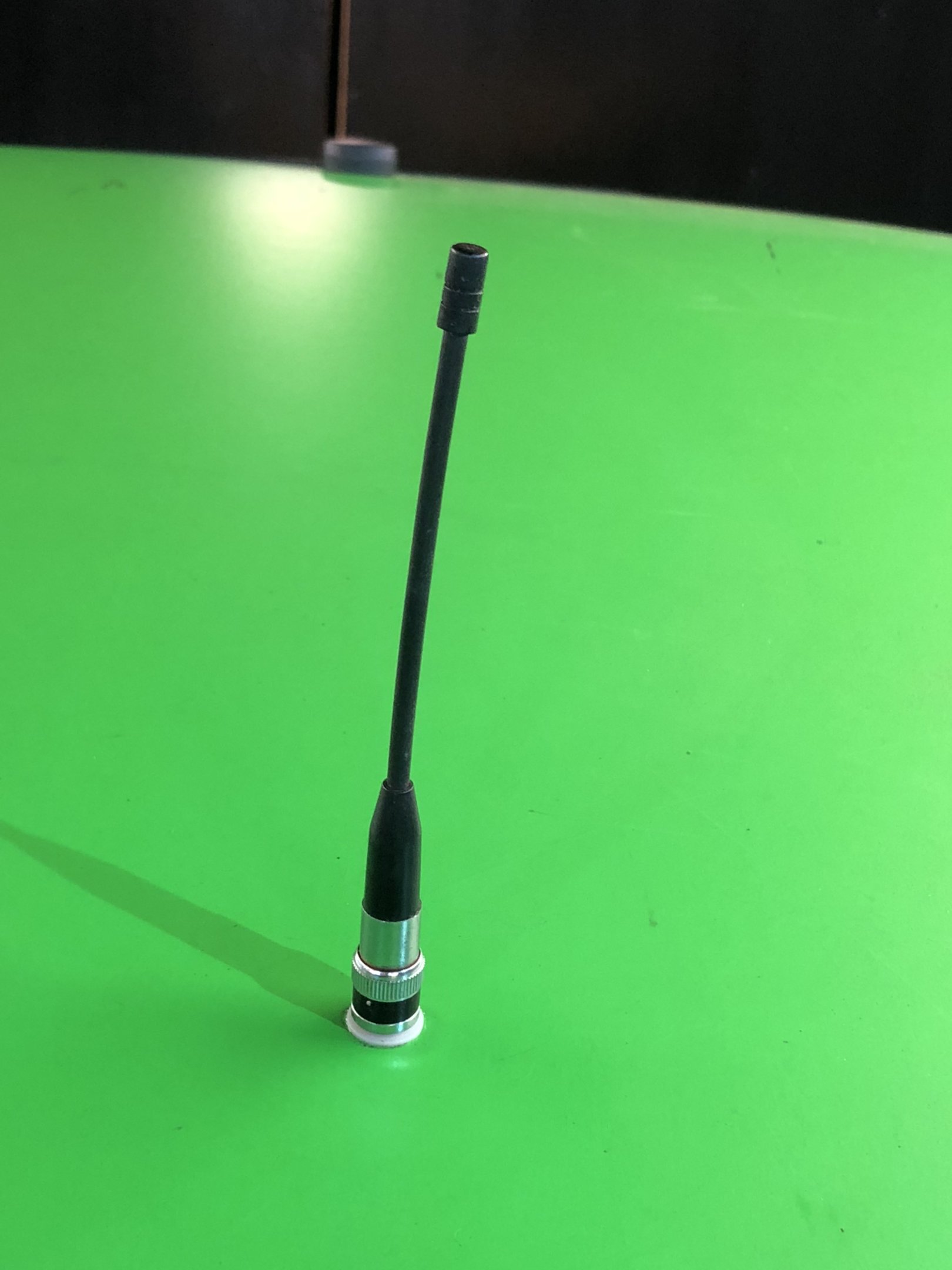

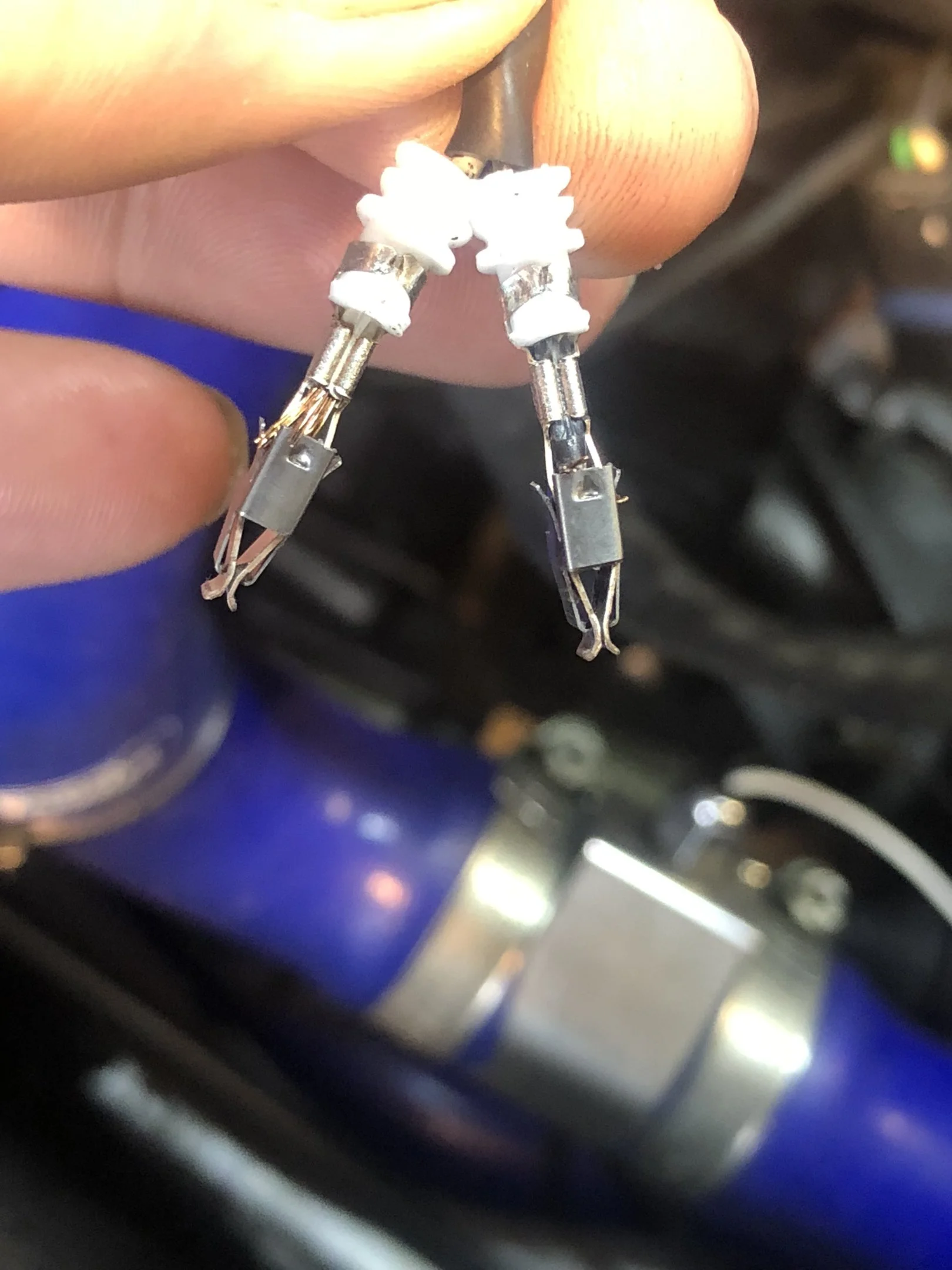

With the persistent man-flu I've had little chance to get back on the car but it was a simple enough task to diagnose the Ait Temp sensor issue.

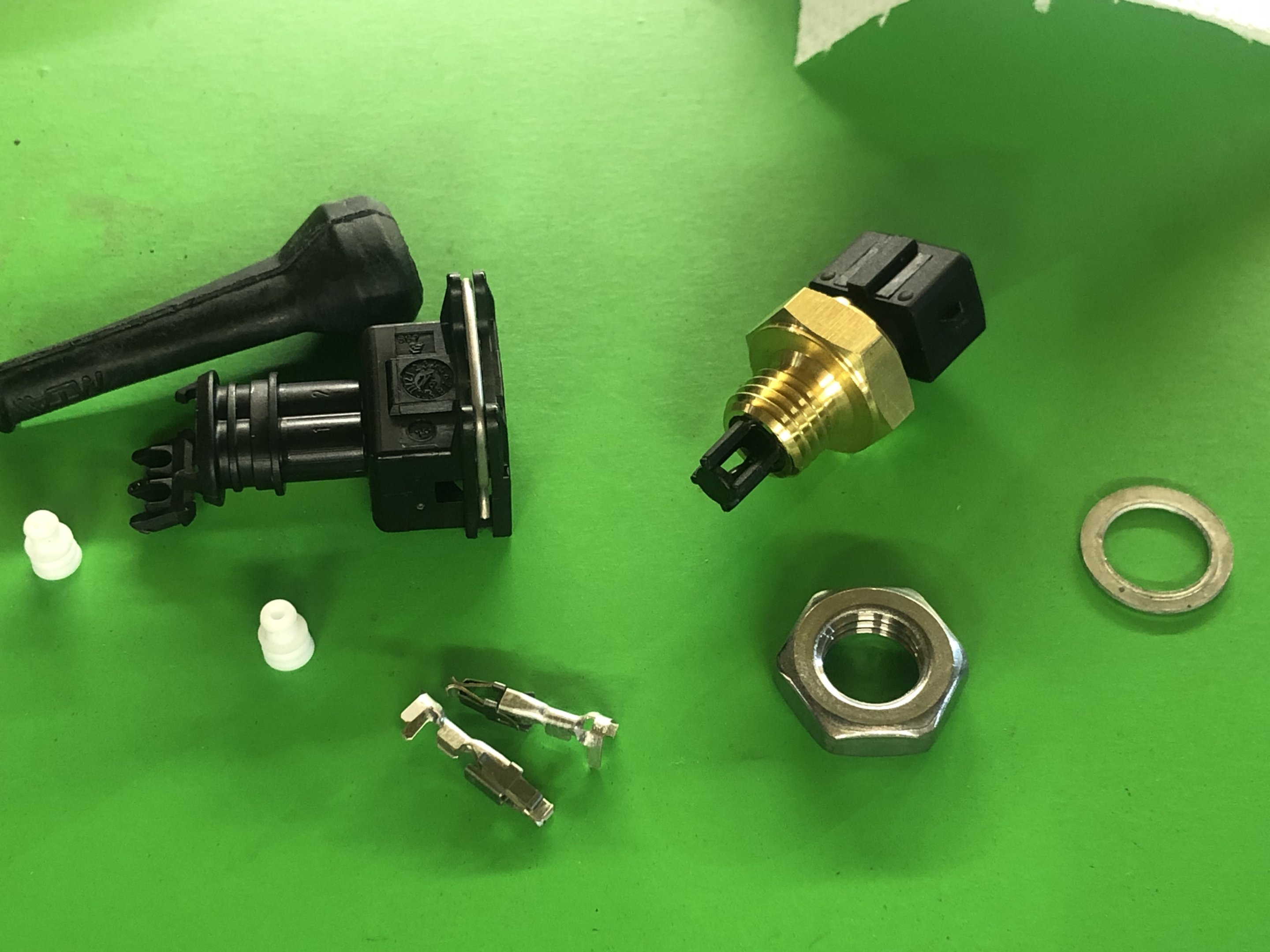

Within 30 seconds I had found the problem
Both wires detatched from the plug, so new pins ordered along with a new sensor from Emerald.
And connected
Just need to make up a new bracket now but at least air temps are looking more realistic now.

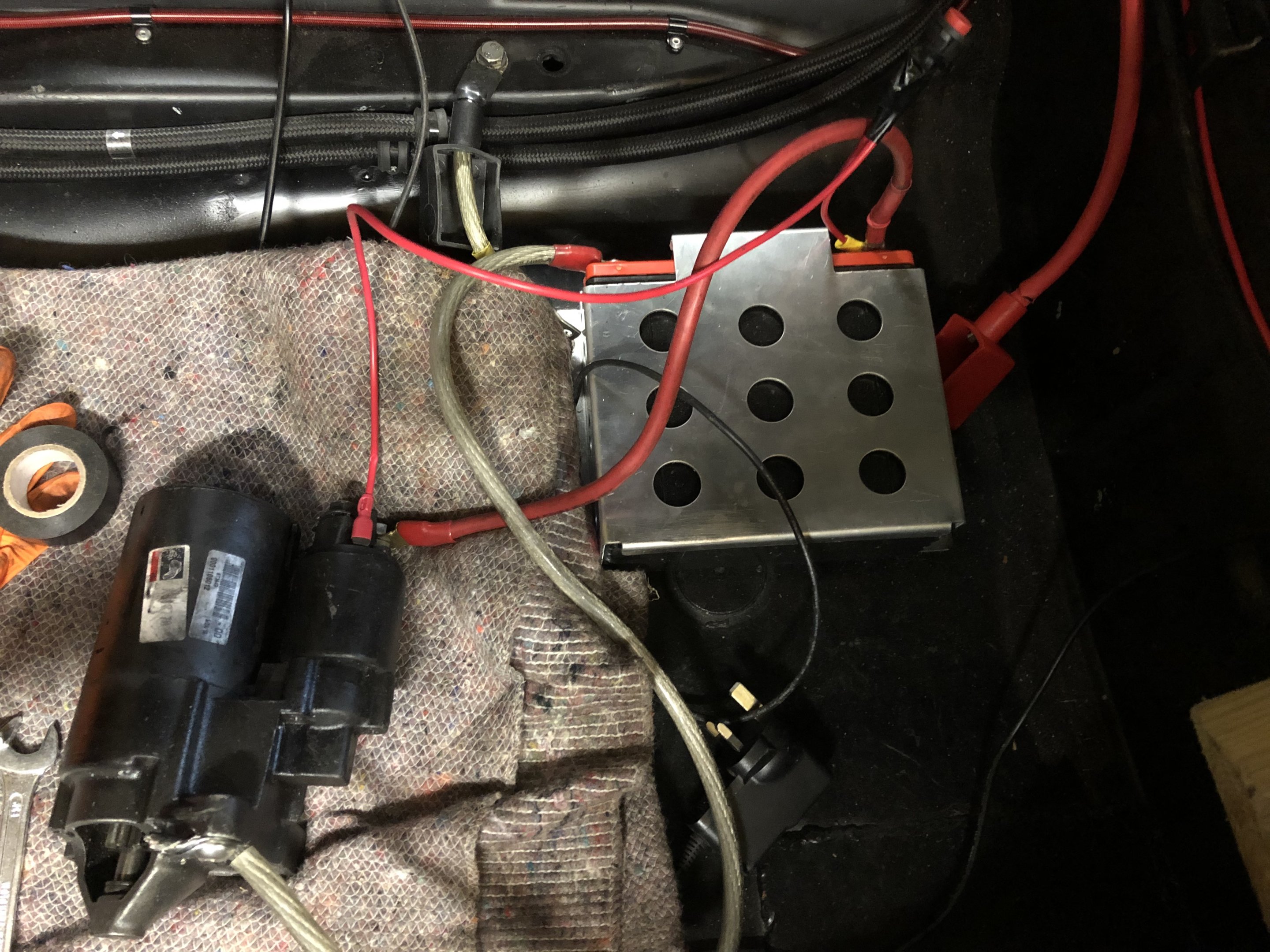

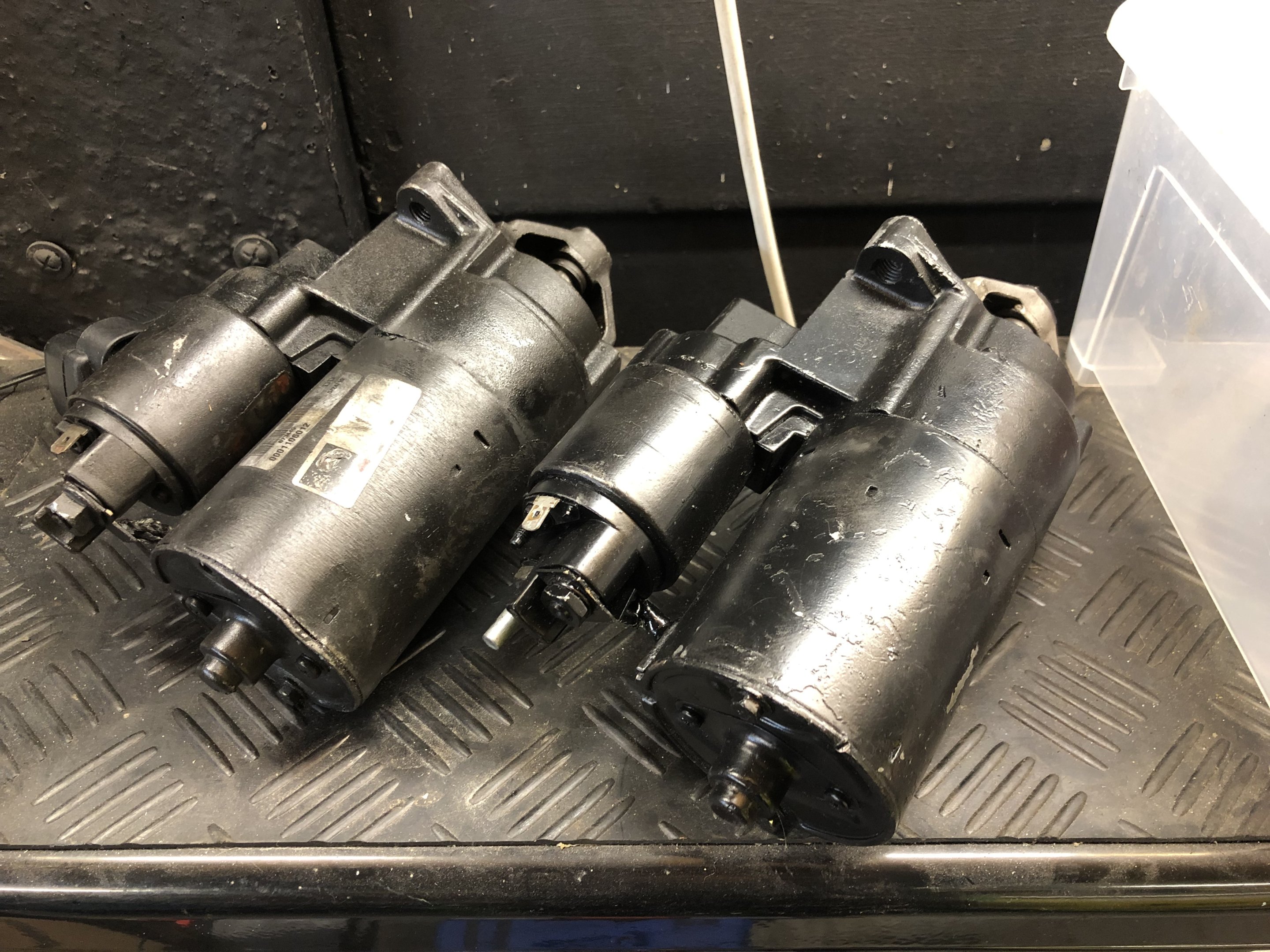

My first thought was battery. It's an Odyssey 680 which I've always thought was probably at the limit of it's capability starting this car, especially since the higher compression engine went in. But after a trickle charge over Christmas the battery seems to be holding about 12.5 volts which is within spec.
Someone else had mentioned the starter button could be the problem. An inspection of the button doesn't show up much but to be on the safe side I've ordered a new 50 Amp button.
So finally, a bit of research revealed that a failing solenoid can also present the hot start symptoms and as I had a spare starter motor this is what I began with.
I rigged up a set of test cables, connected to the battery and one with a starter button attached so I could remove the starter and test it out of the car against my spare.
No visible difference of course although the one removed from the car (left hand side) has a bolt missing from the body holding the armature.
The test showed the old starter coughing a spluttering into life followed by swirling whisps of smoke seeping out of every orifice. Compared to the spare which zinged into life on the button!
So, I really hope that I've located our problem. Once the motor is back in the car I'll be able to give it a definitive test and all being well I can then crack on with dash removal.
