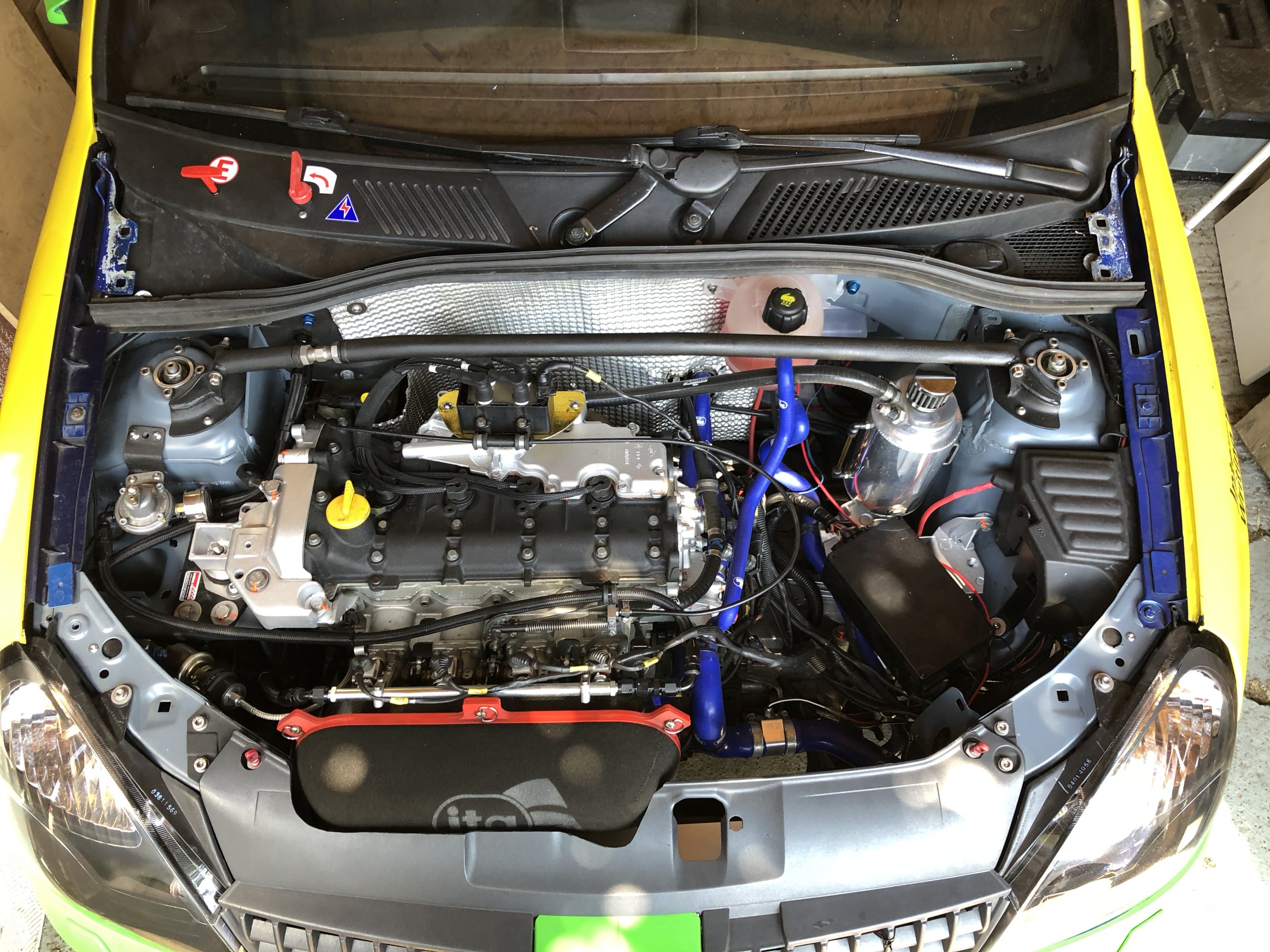

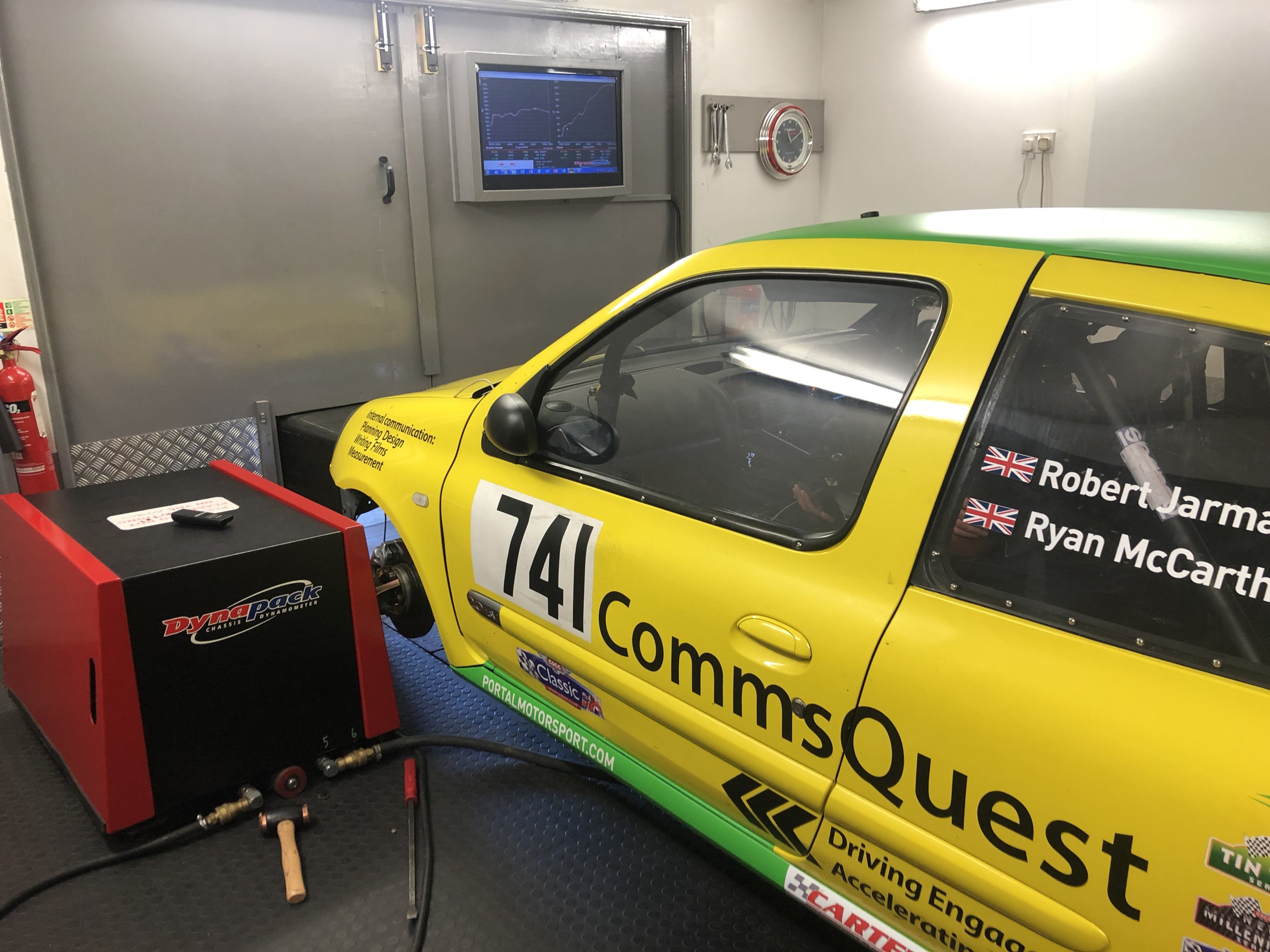

Up at Silverstone Dan at AME was suitably impressed with the engine after it's first run on the dyno and after a bit of fettling in the map managed to gain another 5bhp. It all helps!
After lunch we worked solely on the geometry, removing my toe out shims at the rear and dialling in 10' of toe out at the front. Camber remained the same and with the newly sprung and valved dampers we set everything to a mid point; disconnected the ARBs and corner weighted it.
Once done I headed home to get ready for Brands Hatch the following day.
Wednesday was to be the first time Dan had driven the car although he is an accomplished racer it was going to be interesting to get yet another point of view on the car's driving characteristics.
And I'm glad to say he loved it! The comments were that it was the nicest, most well balanced car he had ever driven around Brands. Whether he was just being flattering I don't know, but I do know that the car certainly did feel the best it has ever felt around Brands and by far the most stable since the rebuild.
With new wheels and tyres as well the car now feels noticeably more lively.

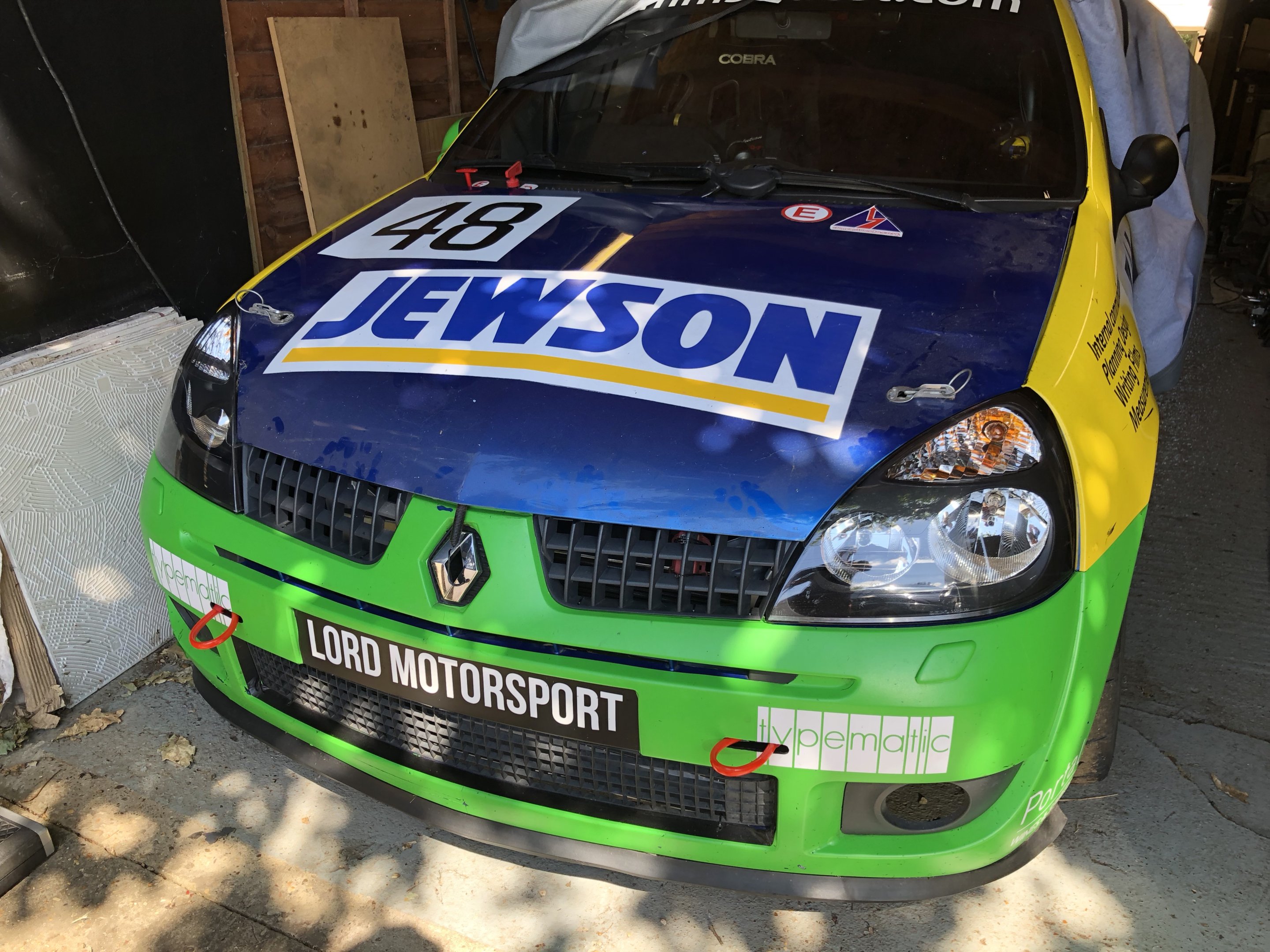

So Sunday was an early start but by 8am I was all set up in the paddock and ready for scrutineering.
Once signed on and scrutineered without incident we went in to Qualifying at midday feeling hopeful.

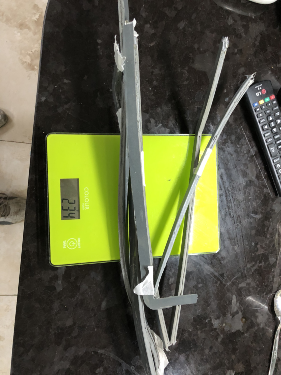

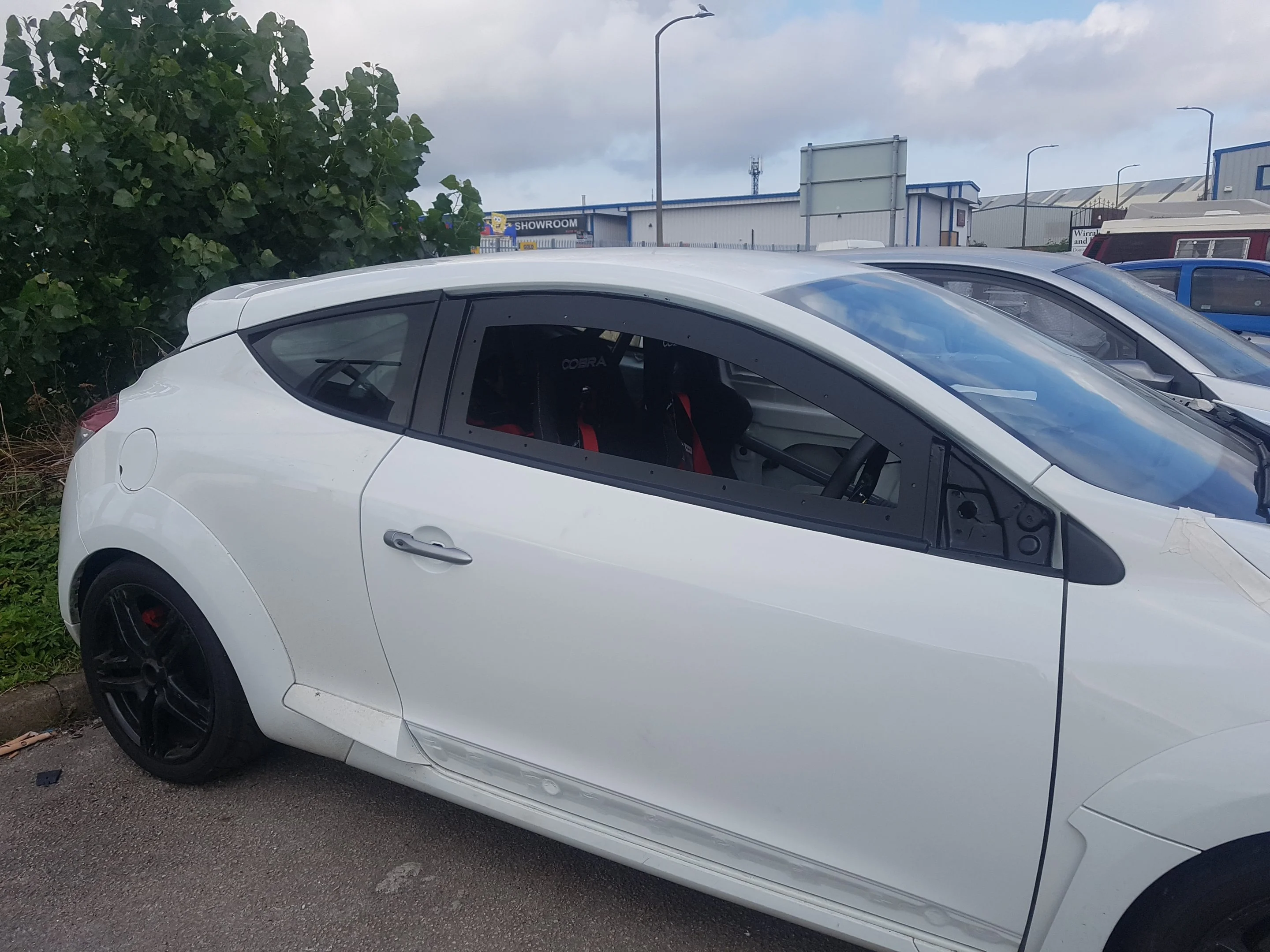

I've begun weightsaving phase 2. starting with ordering a plastic rear screen (not due until mid September!) and also some new Starrett hole saws to tackle the doors and lose a bit more weight out of them. Interestingly the doors currently have carbon fibre door cards fitted, but despite the material they are 1.1 kg each, which is weight that is easily lost.
There's quite a bit more metal I can lose out of the doors, so in the absence of anyone making a decent fibreglass door at the moment I'll go as far as I can with these.
I've also binned the existing wingmirrors which were originally motorised and ordered a pair of manual mirrors from a 1.2 Clio. They haven't arrived yet so I don't know what weight saving will be made but I expect it will be a bit as these mirrors feel very heavy.

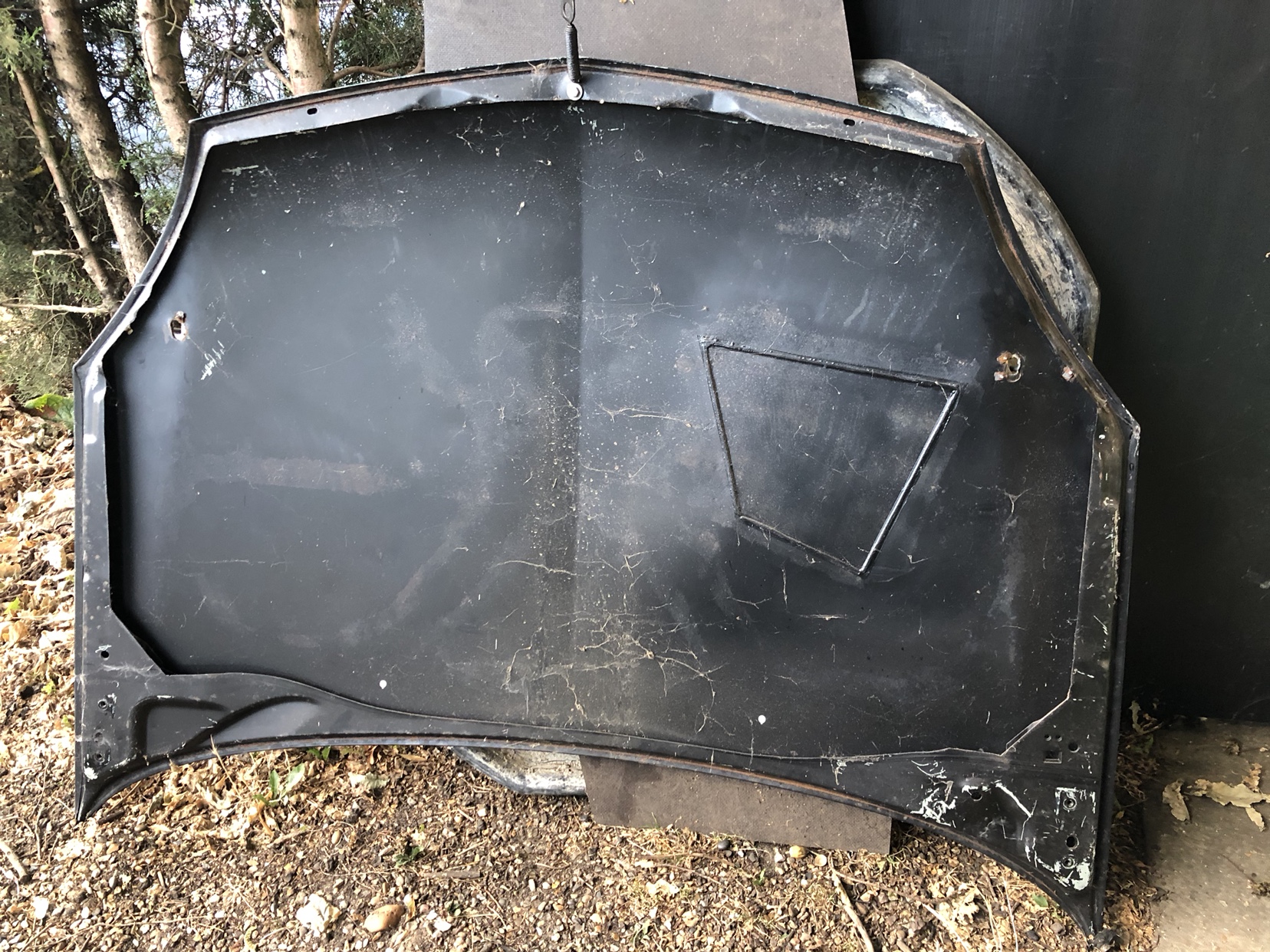

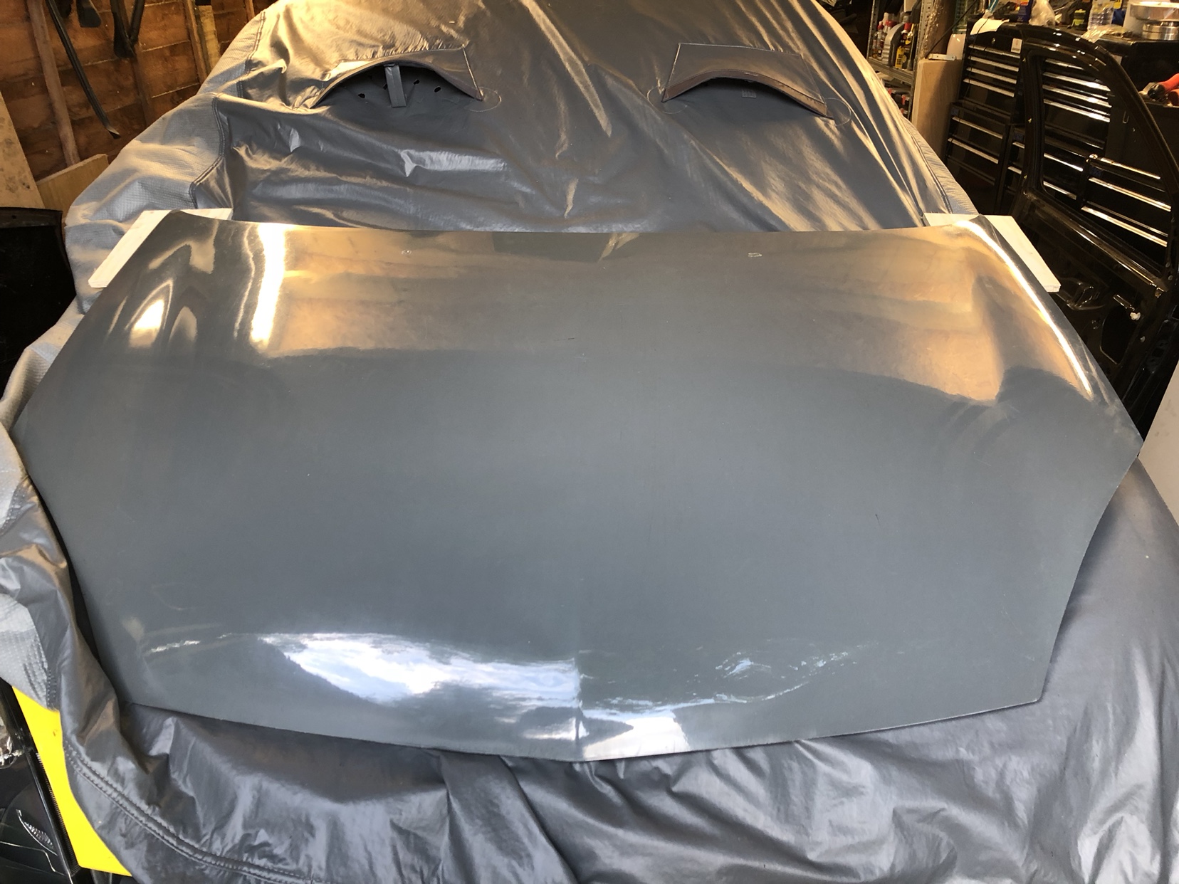

And finally, the bonnet.
I've had another bonnet sitting in the workshop for a couple of years that has already had the inner skin cut out. It was a bit tatty and the bonnet pin holes were in the wrong place for this car so I had never used it.
My existing bonnet weighs 11.3kg. My de-skinned bonnet weighs 8.3kg. However, as this bonnet isn't perfect I decided to order a fibreglass one which is 5kg apparently. It arrived today, so that's first on the list once I'm back from holiday.
de-skinned bonnet offered up.

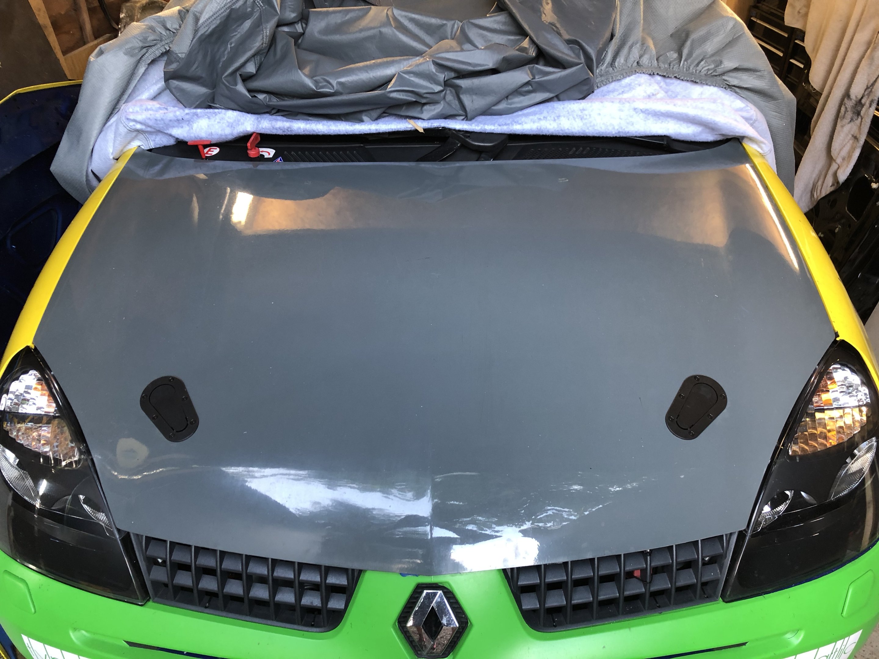

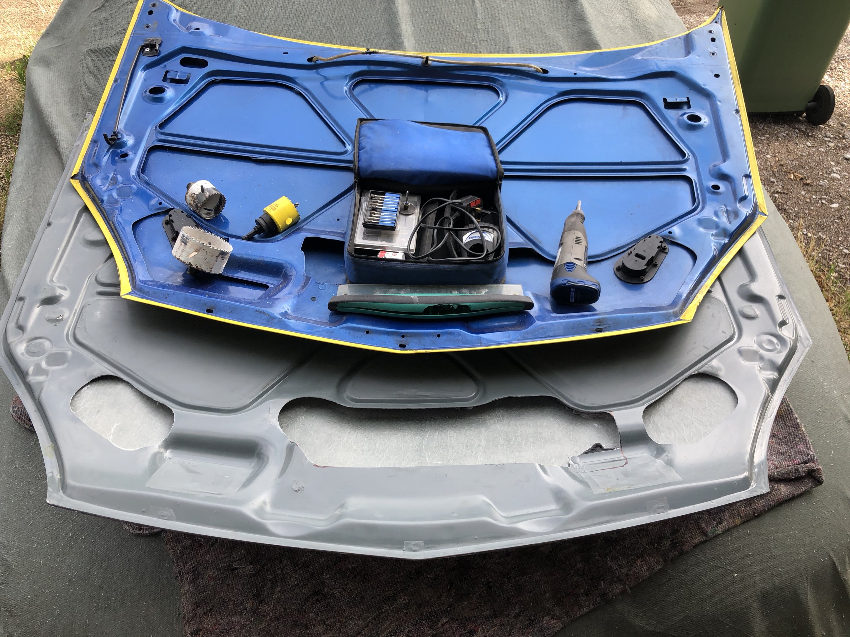

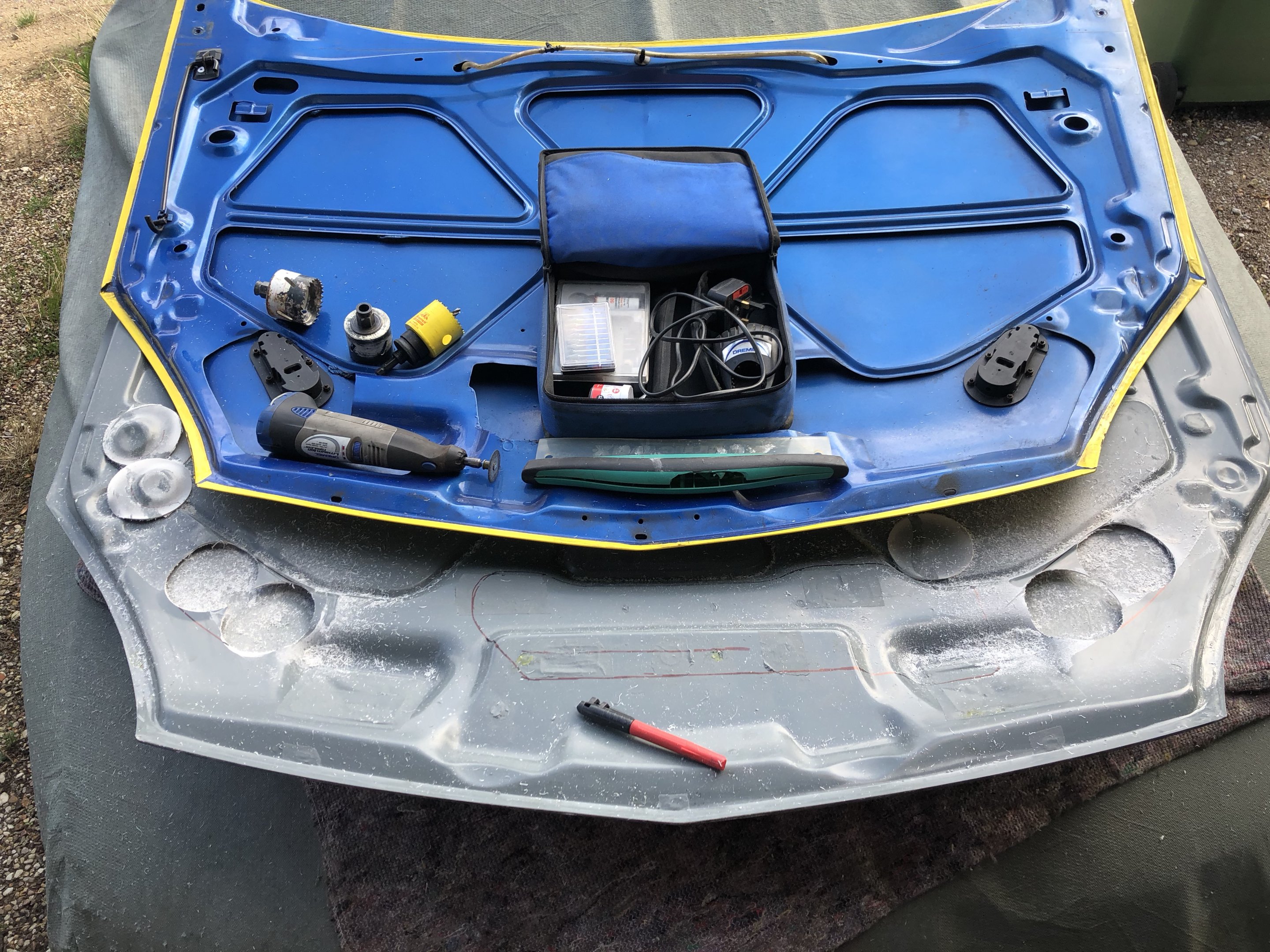

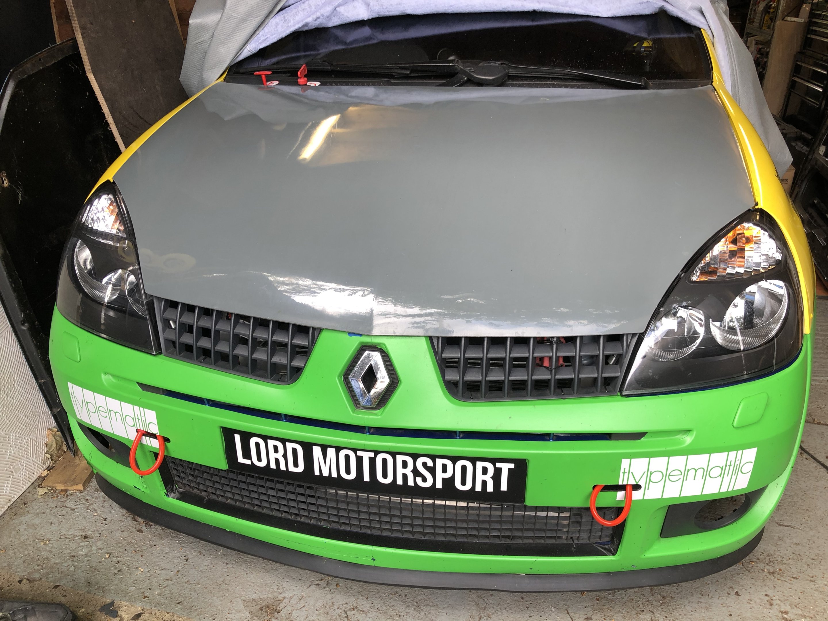

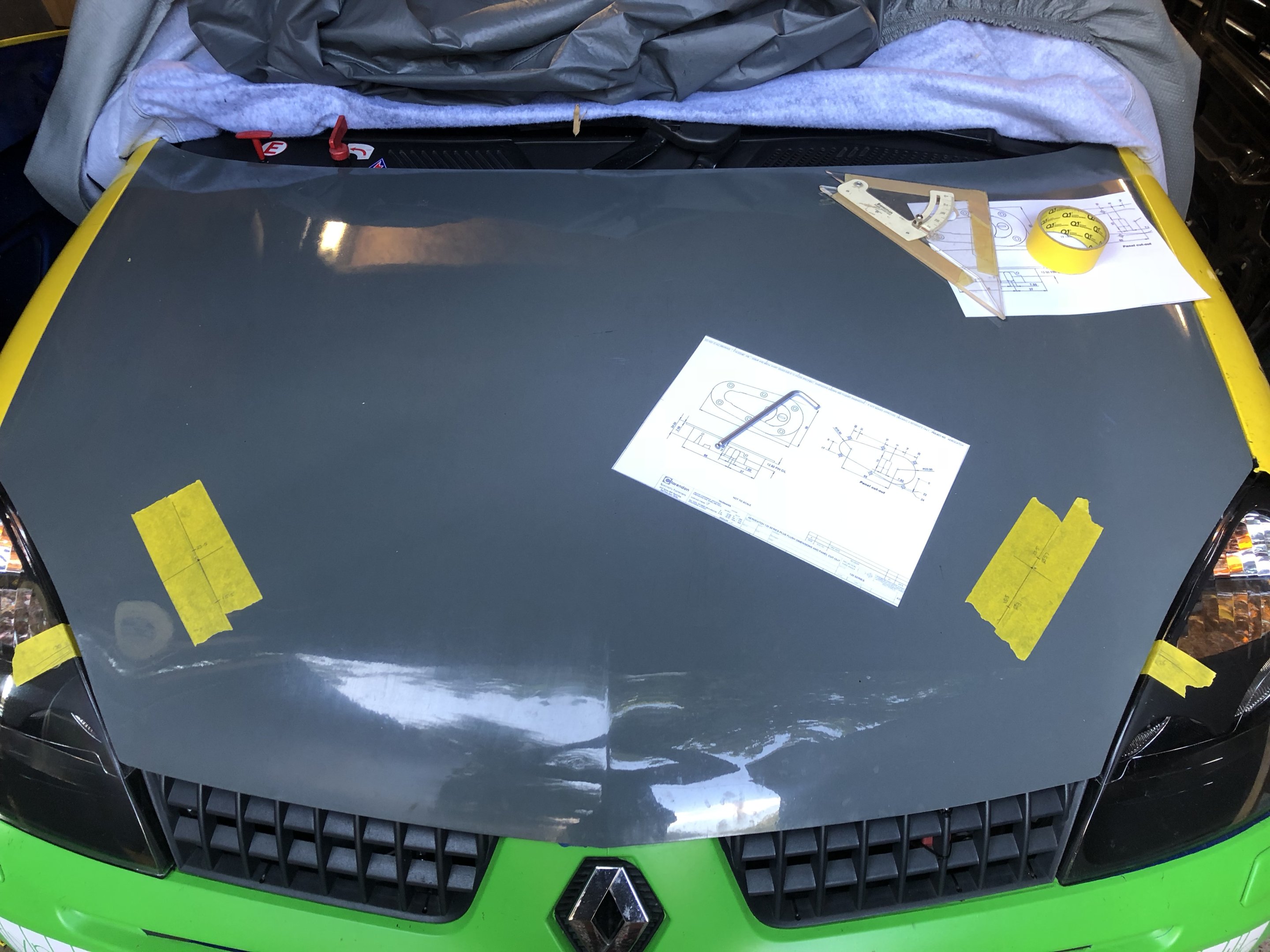

Just a quick update tonight. back from holiday on Friday so cracked on with fitting the fibreglass bonnet.
The fit is good and the finish is certainly good enough for a race car although would need some work for it to be perfect for a road car and especially if it was going in a dark colour. For me it's perfect and a lot better than the bent one I'm replacing!
First job was to lay over the old bonnet and cut out the inner skin where required to clear the airfilter and expose the outer skin for the bonnet catches.
With the right tools, a very simple job!
and a bit of adjustment at the hinges was all that was required. I can improve it a bit more by edjusting the front wings which will come later.

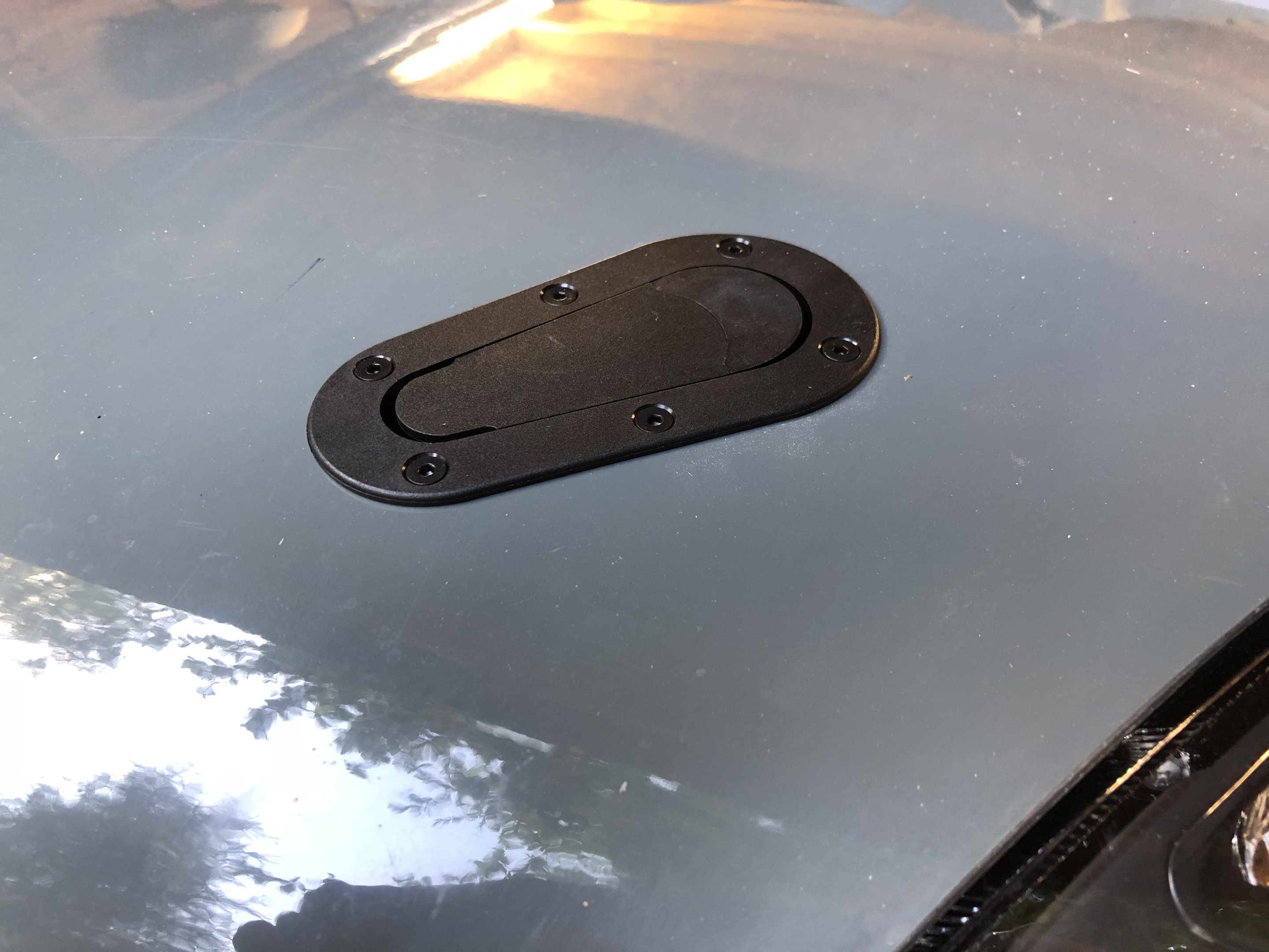

And then on to marking up the catches.
Again, a pretty easy job although the drawings weren't 100% accurate and I could have drilled a smaller opening for them and they still would have fitted.

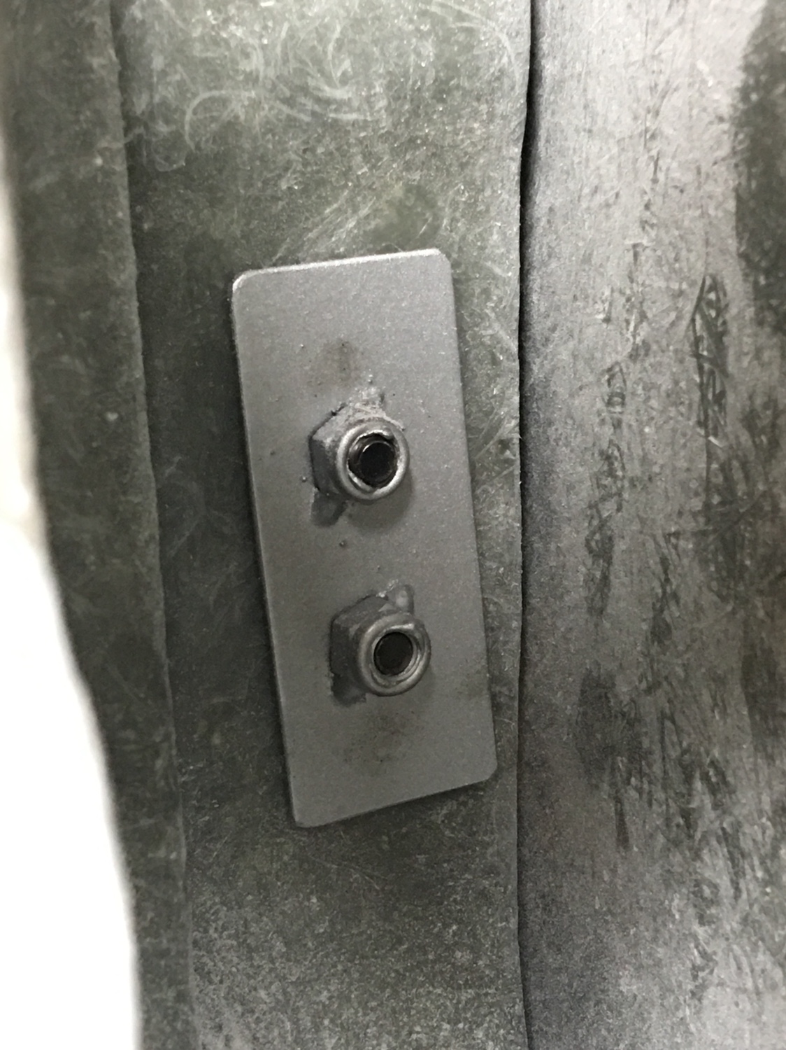

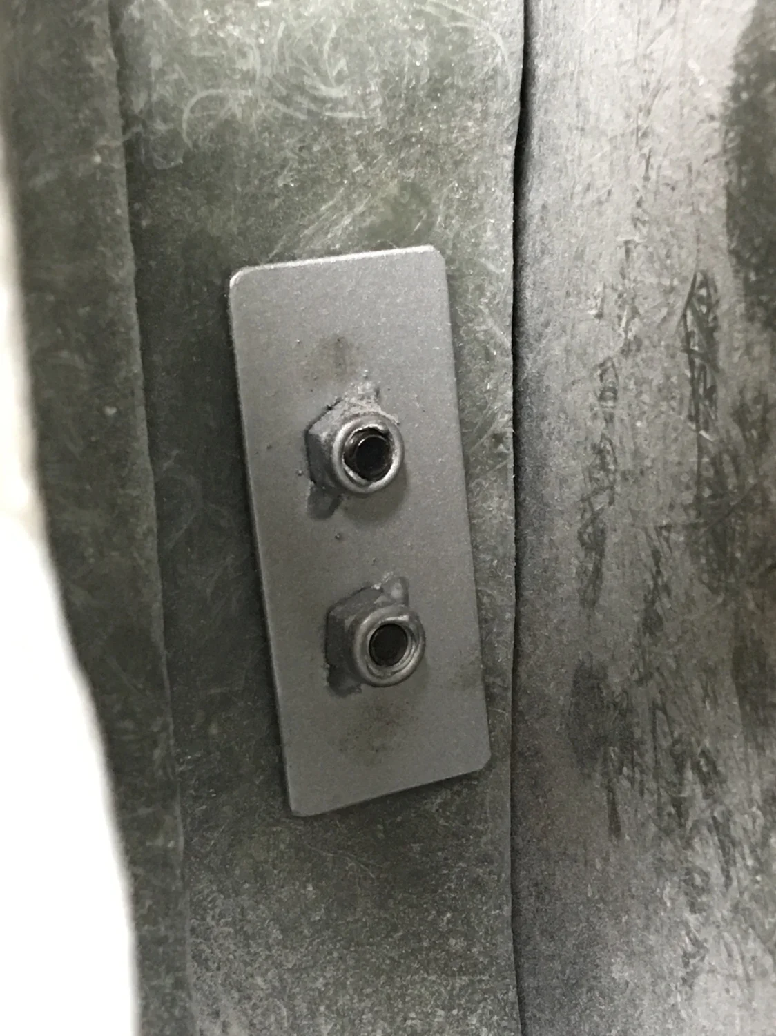

There are 2 ways (maybe 3) you can go about it. Buy new hinges from Renault for about £120ish
Cut from your old doors
Or a third way is if you find some dented old doors somewhere to cut from them and sell yours. Doors even in good condition don’t go for much this days, certainly not more than £120. So unless you find some junk doors to butcher, I would use your old ones, keep all parts that are salvageable and scrap the rest.
I made little plates to go on the inside with captive nuts to reinforce.
robzracing
I made little plates to go on the inside with captive nuts to reinforce. View attachment 1382565
That looks straight forward enough. I have a few spare hinges and a couple of extra doors so maybe I'll concede over the winter and get it done.
In the meantime I'm going to cut as much metal as I can out of the existing doors and along with the lexan rear screen due in a couple of weeks that will have to do for the rest of the season.

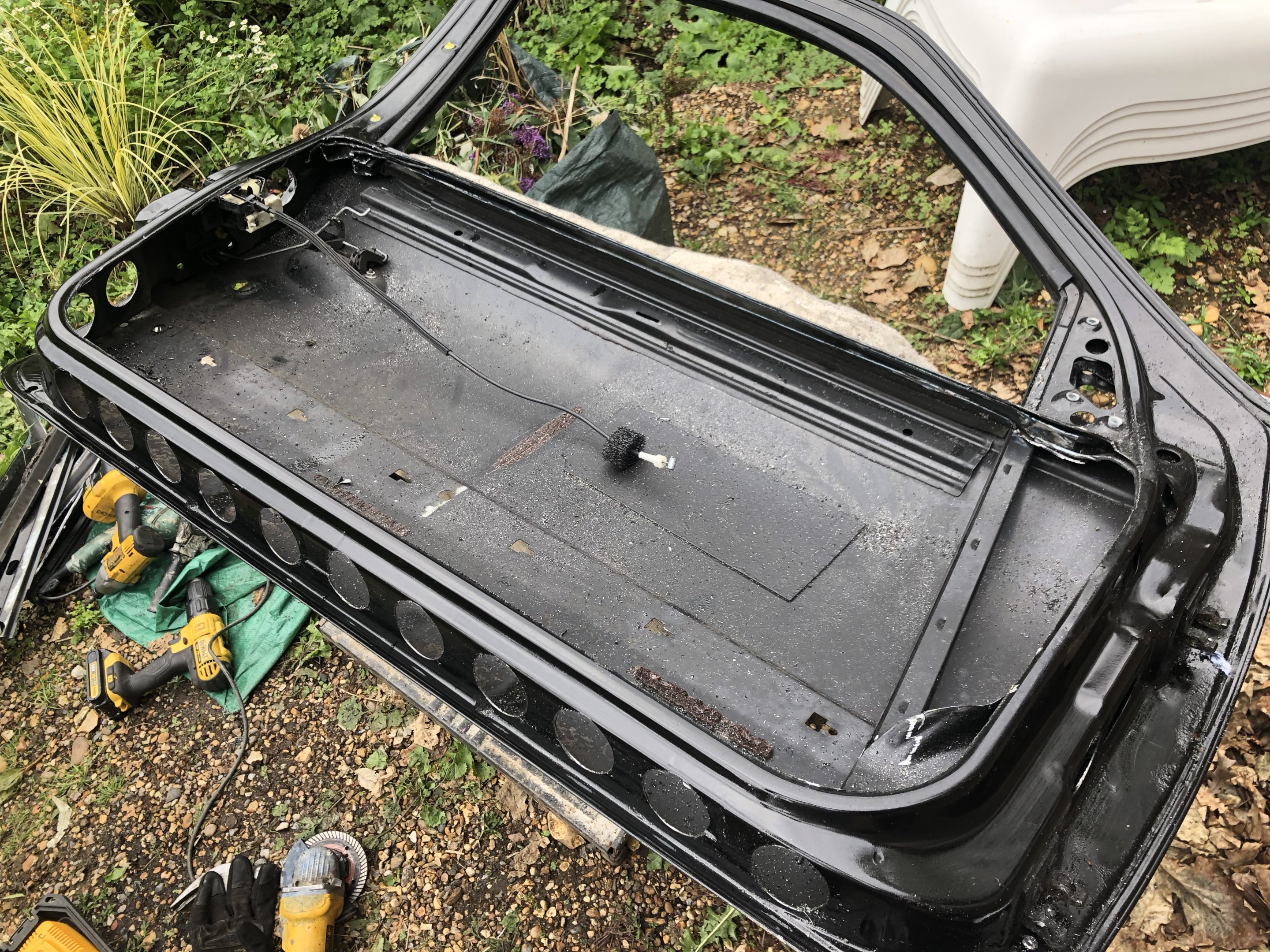

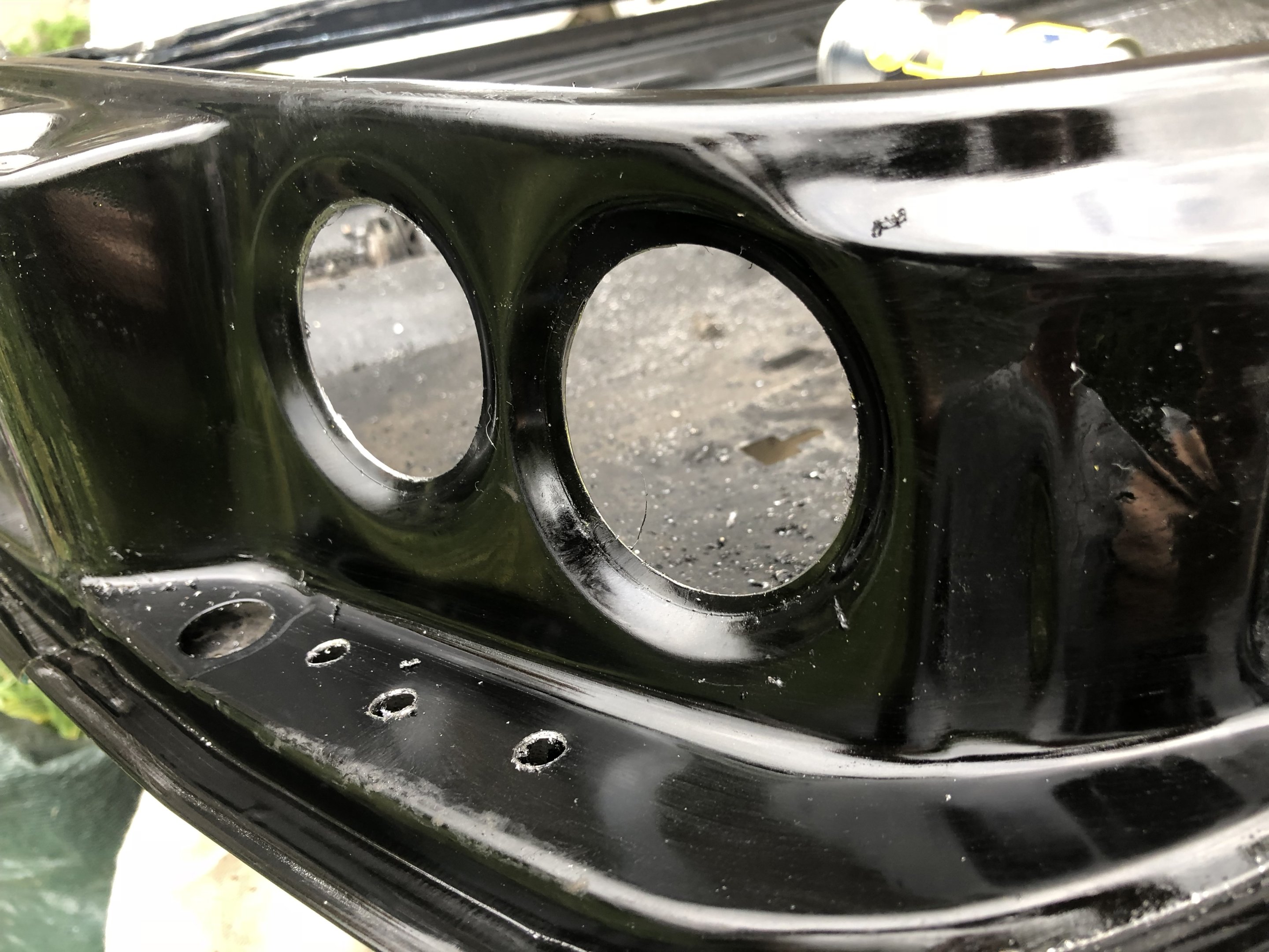

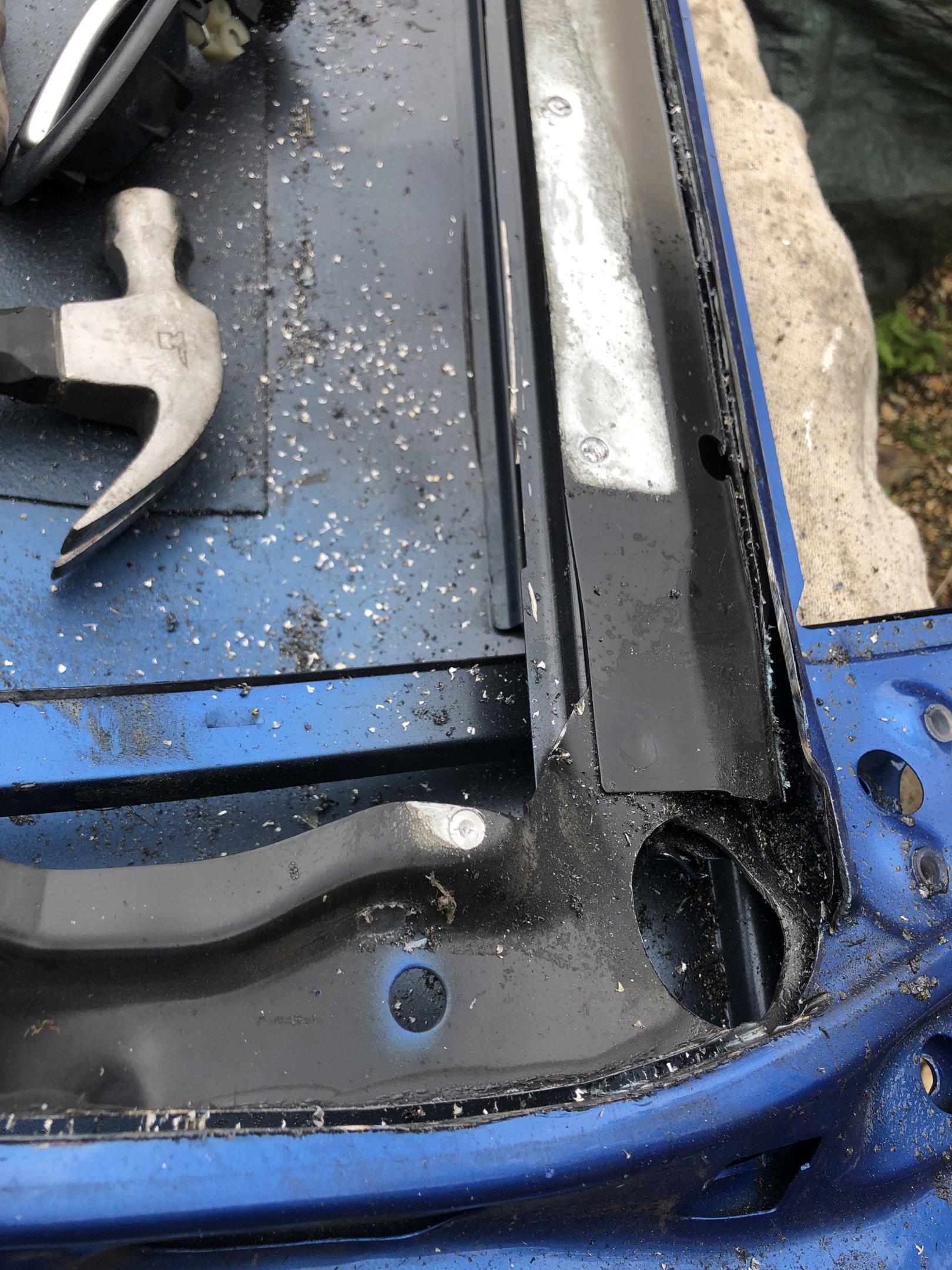

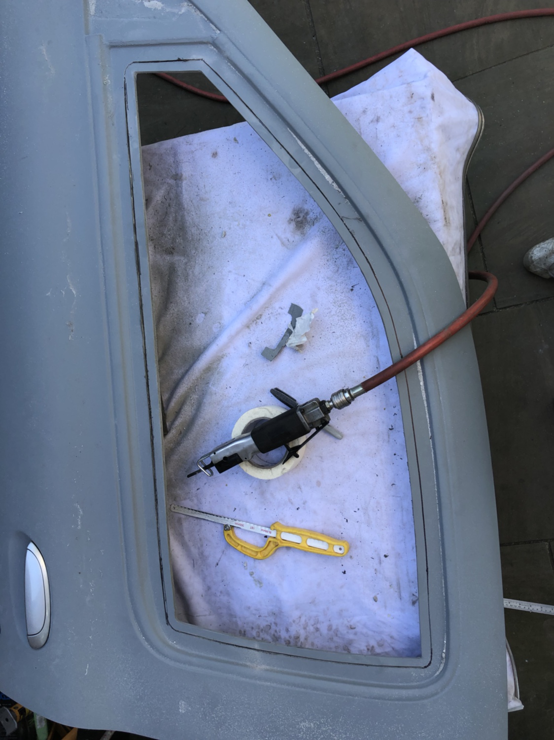

Made some progress with the doors today.
A couple of years ago I had cut a fair bit of metal out of the doors but decided to see how far I could go to get them as light as possible without losing too much rigidity.
The standard doors with glass and trims removed weigh 19.8kg. I had already got mine down to 18.3kg.
Today I managed to get them down to 14.48kg which will do for now. There probably is more I could do but along with the new bonnet, manual mirrors and a few other bits I have so far taken another 17.1kg out of the car. Once the lexan rear window arrives the car should be a good bit lighter for Donington.
Seeing how far I could go with the old door
And getting silly with the hole saws.
Dimple Die only worked on the side holes unfortunately.
Still lots of tidying to do and need to make a door release pull somehow too.

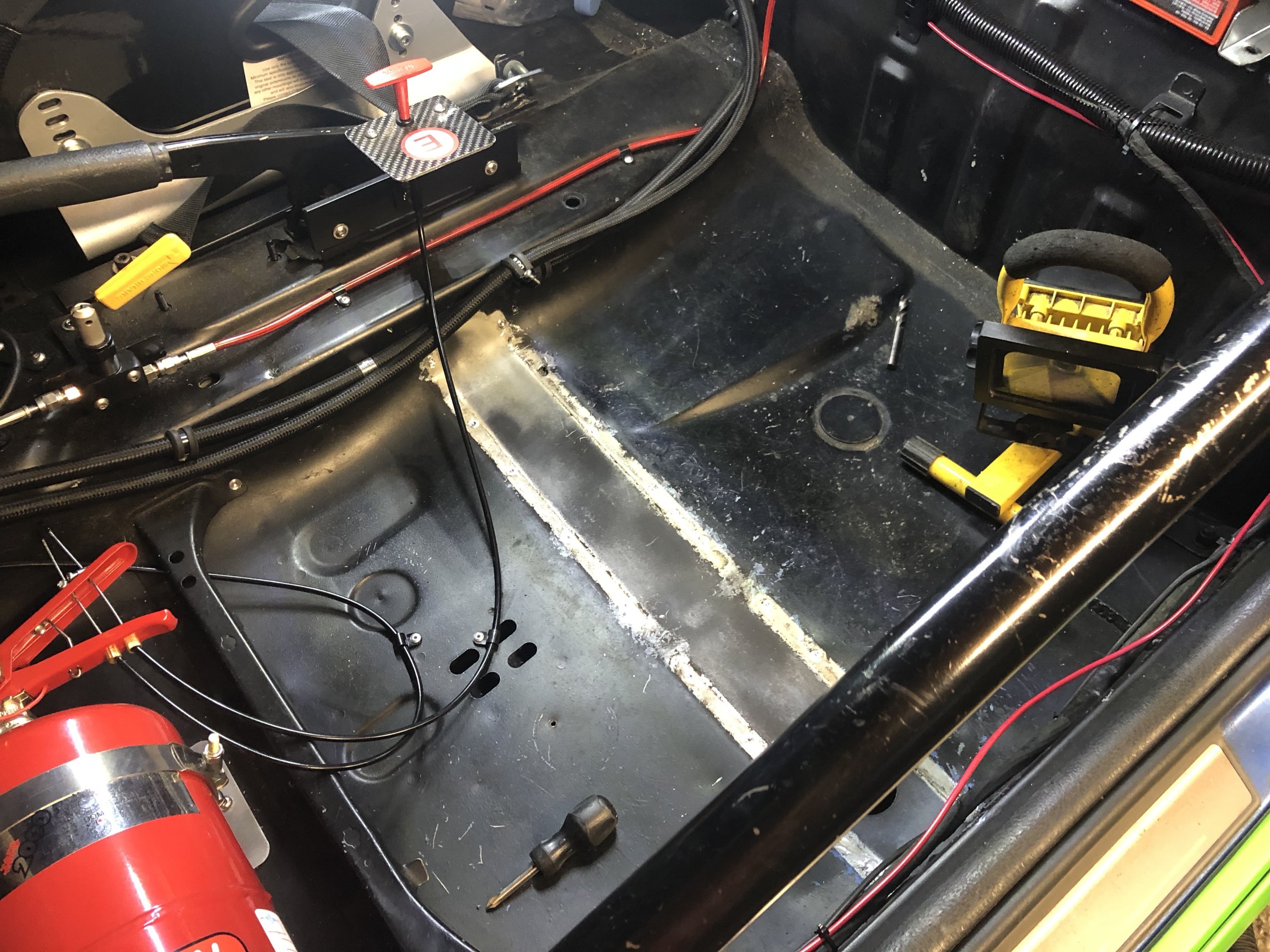

And finally, started to make some space to relocate the battery. Not exactly where I'd like it but I think this will do. It will at least be lower in the car and most importantly, have a shorter cable run.
