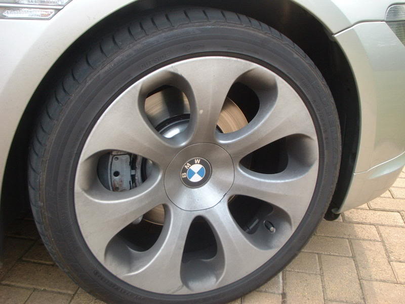

The test car was my very own BMW which had racked up a few miles over the last few weeks.The wheels had not been treated to anything other than a wash several weeks ago for the purpose of this guide
The first step is to ensure the wheels are cool to the touch as this will make the process a lot easier and the products will work better as well.

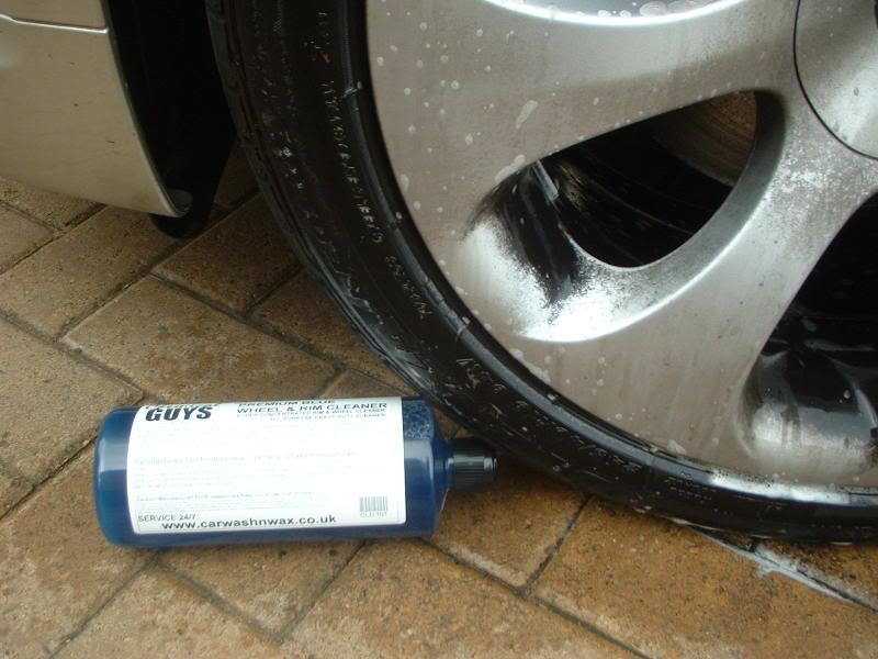

The first product to be used was BLUE RIM AND WHEEL CLEANER,which was diluted 4:1 into a 1 litre plastic bottle and was sprayed via a chemical resisitant sprayer,and left to dwell for 5 minutes.
After 5 minutes the cleaner was sprayed off via pressure washer and then the back of the wheels were brused using a meguiars wheel brush.

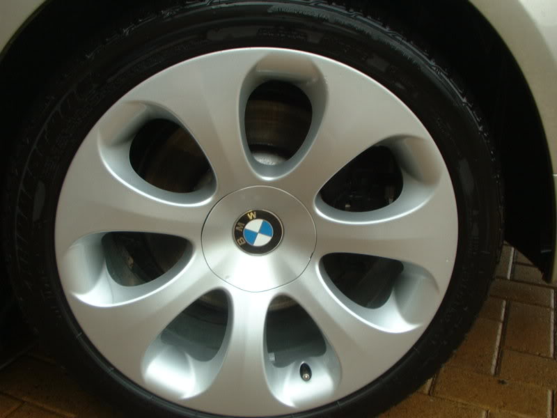

This was the finished article

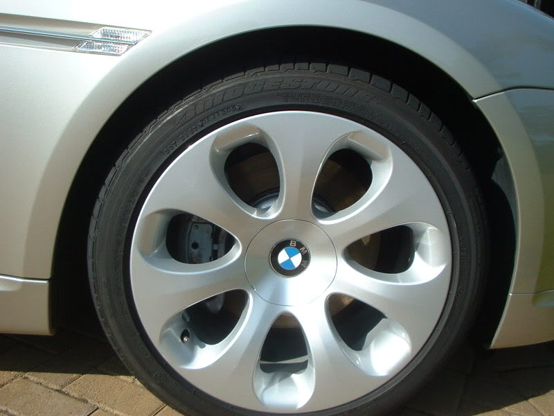

The next step was to wax the wheel with our RIM WAX and this was left on the wheel for 1 hour .The RIM WAX will remove light surface scratches and will help protect your wheels against brake dust and make future cleaning a lot easier.RIM WAX has been made to withstand the heat that is generated from your wheels thus creating a better barrier against brake dust ,normal waxes and sealants are not made to withstand the same temperatures as the RIM WAX.

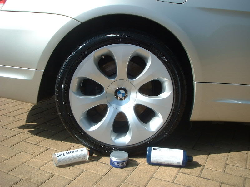

The final piece is now to dress the tires and the tires for this purpose have been dressed with TRIM GEL via aTIRE DRESSING APPLICATOR,and left to dry for 30 minutes to minimise any sling

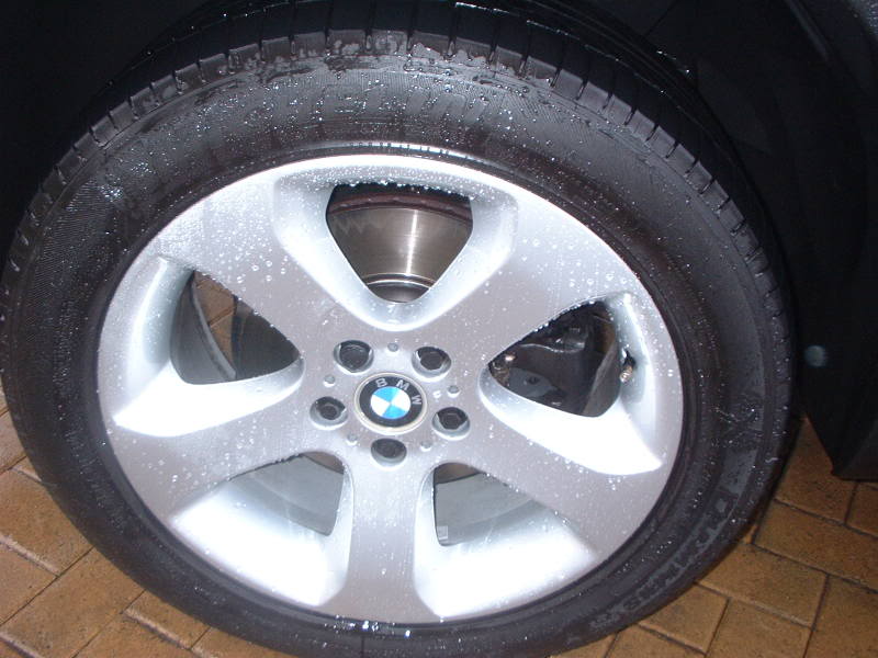

Yes mate ,have alook at these pictures of my wifes car,just after a clean with the Blue Rim and Wheel cleaner.The Rim wax was applied 2 weeks prior to this shot ,and you can see the water is still beading
  106 GTi
Sounds intresting a cleaner than only strips the grime not protection would be a real bonus.
Beading in itself is not a sign there is any protection left. Brand new paint beads water.
These wheels are 2 years old.A simple application of the Rim Wax left on the wheel for 30 mins and then buffed off to reveal a great shine.2 weeks later and the beading effect is still there.I normally reapply once a month
