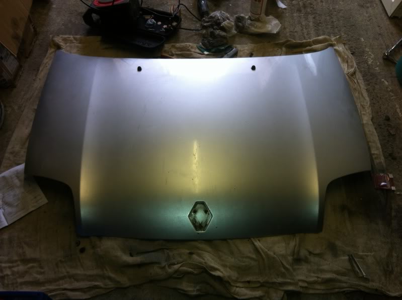

Spent a few hours on my alloy bonnet today getting it prepped up for paint.
Before:

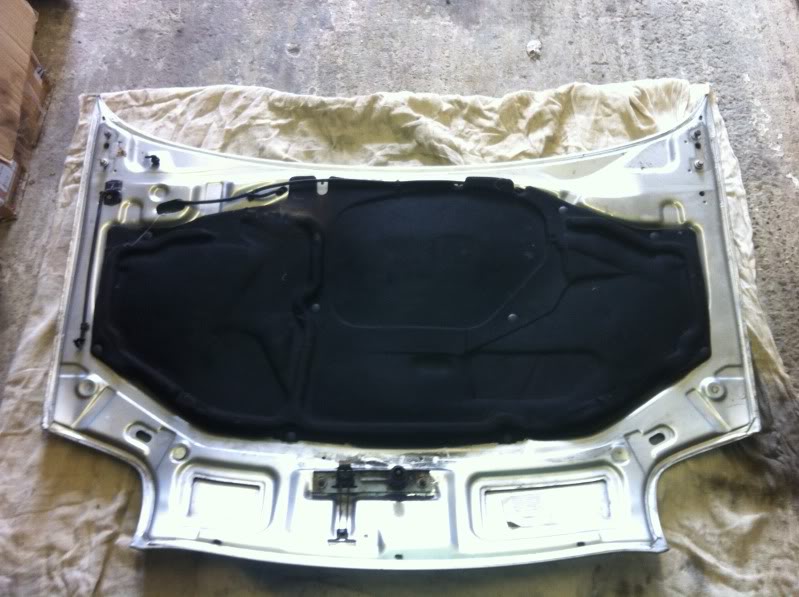

Then removed sound dedening:

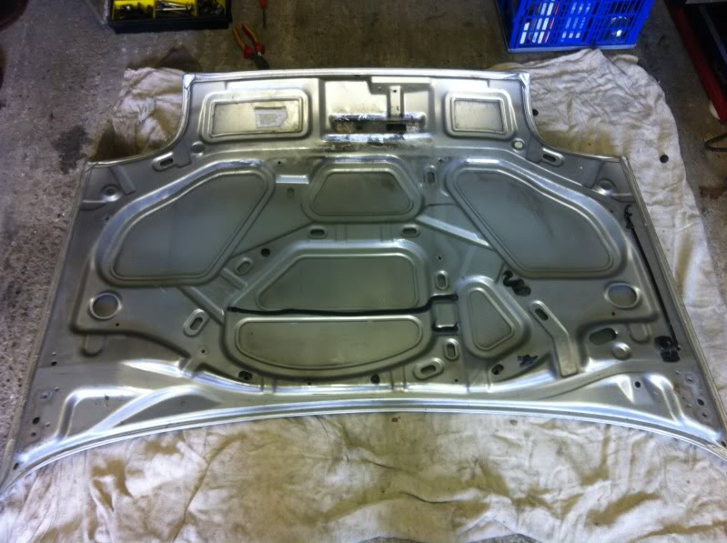

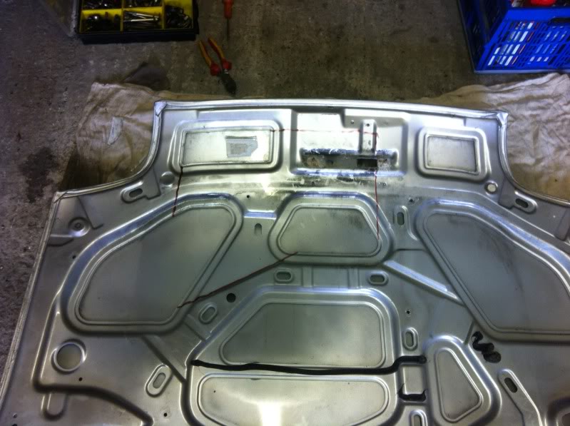

Marked up for the cut out for my air filter, tried to make it as neat as possible:

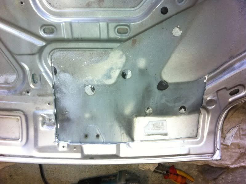

Cut out:
I did then sand down and clean all under the bonnet, but the picture didn't save :/

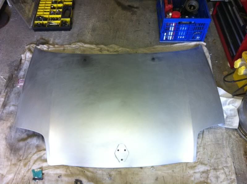

Then onto the top, the before:
and after lots of sanding down:
Next weekend i will trial fit it and cut out the Aerocatch's, but that's enough for this weekend, wasn't even meant to be working on the car lol :)
