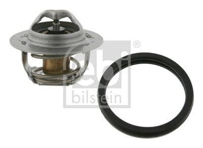

@RustyMojo I bought this one, Febi so cant be too bad and looked near identical to the perished old one.
Cheers Dom, looks like they have sold out now.
