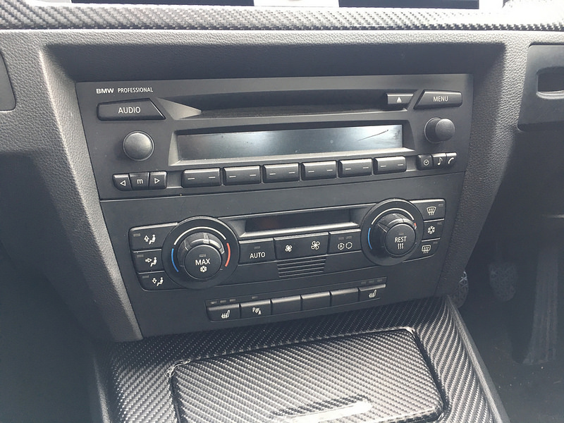

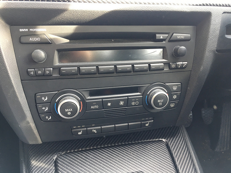

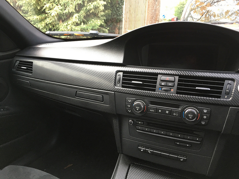

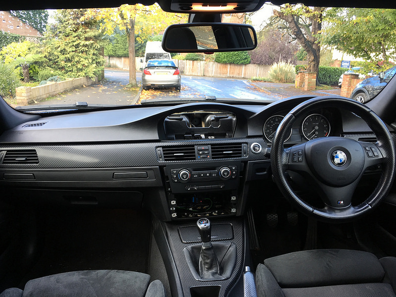

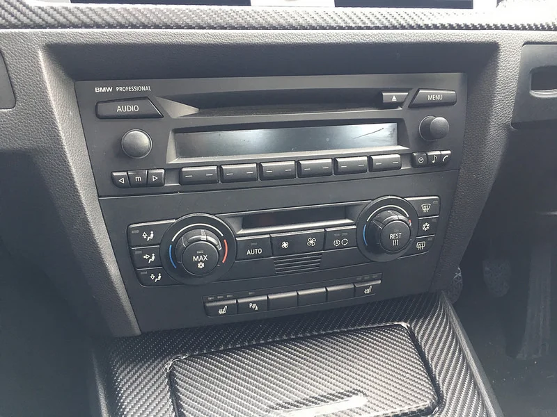

Never one to stop buying things that i dont really need ... facelift climate control panel with the chrome knobs instead of black plastic ...
Untitled
by Sir_Dave, on Flickr
Untitled
Minor change, but i think it ties in better with the rest of the dash, especially if my next addition (as below) goes to plan.

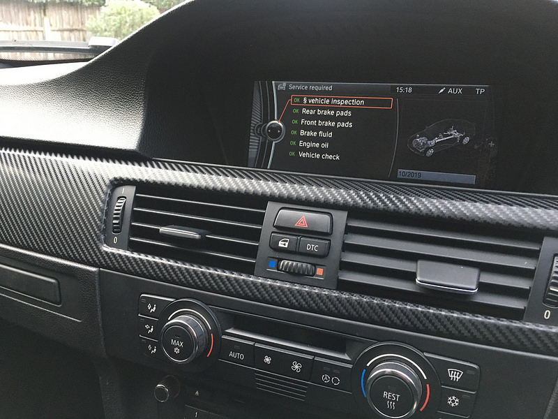

In effect, whilst my little Bluetooh dongle is ok for music streaming, its not so brilliant for actual talking (you have to switch the headunit to "AUX" to hear anyone for starters), which is a tad unhelpful being that im trying to setup a business, so out & about quite a bit at the moment!! On that basis, im currently pondering either the LCI headunit with Bluetooth/USB/DAB that @GrahamS has fitted to his 135i, or just going all out & doing CIC/Combox ... the latter does look infinitely cooler, especially if i can get Waze/Carplay integration somehow (also dont actually think i've seen Pro Media with Alcantara interior before!), but the difference is circa £1k ?

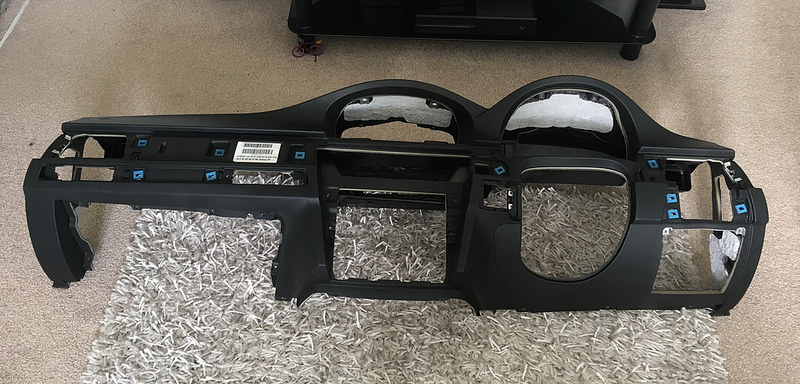

Which brings me onto my next update; DHL just delivered what looks like a body ...

Oh herro.

That's quite the task. I used to consider dash removal a right of passage to calling a car your own. I did Mk1 > Mk2.5 upgrade on my old MX5, the Ph1>Ph2 upgrade on my 172...
Not sure I'd brave a BMW dash tbh!
I also quite like the clean look of an E90 without iDrive. But then I'm probably in the minority who would actively look for a non-nav car with a manual box.
It doesnt actually look that hard (famous last words!), 5 bolts holding it in, but lots of ancillaries that need to come off. 3 hours work apparently ... ?
Errrrrr, what did I miss? Why are you changing the dash?
I want to fit OEM bluetooth, so considered just getting the unit that GrahamS has, but realistically speaking (unlike @Jeff simply), i hate the look of the non-idrive dash, so thought id put in either OEM CIC/Combox retrofit (the usual nav/bluetooth/BMW apps etc) or perhaps an iPad Mini in the upper display area ( for Waze/Music/other stuff). No idea how the latter would work, although i think AvinUSA do a screen that allows Carplay/iPhone mirroring etc when linked to the CIC.
All in all, i just wanted something to tinker with.

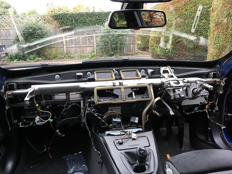

So this happened.
Untitled

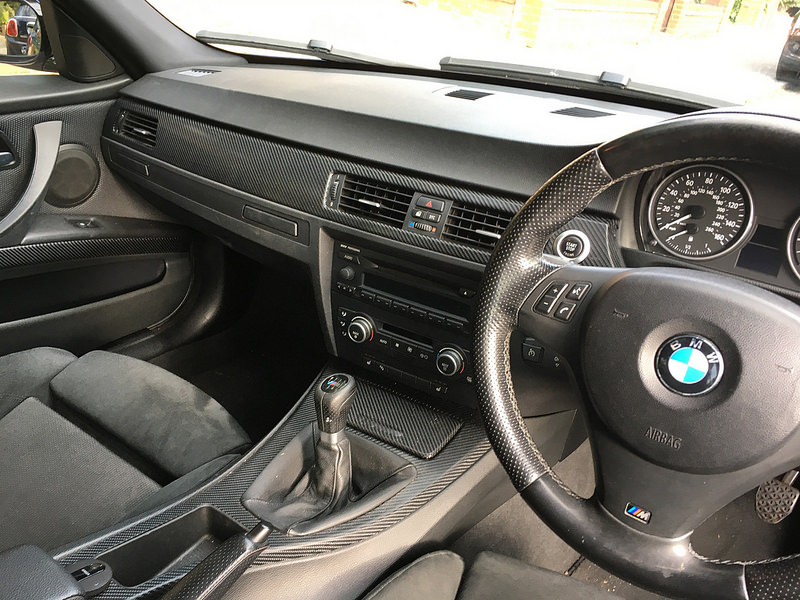

Back in 2008, a chap called "Booster4075" created a mammoth thread on how to retrofit CCC.
He then created a nice little PDF which i followed for the dash removal etc: https://www.pdf-archive.com/2017/04/01/e90-idrive-retrofit/e90-idrive-retrofit.pdf
Took about 3 hours all in, less rattles now than previously, which is always nice ?
Looked like this at the end of the day, few more bits of trim required ... but the bulk of the work is done:
Untitled

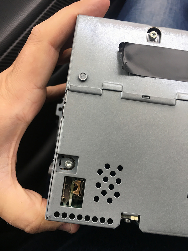

My CIC unit then arrived. Naturally being a breakers yard, they had just cut the cables, so when i pulled out the Fakra antenna:
Untitled
FFS. They wont refund me, so i'm (when i say me, i mean Sarah's dad, whose a retired electronics engineer!) going to have to re-solder on a new Fakra to the CIC at some point. Still it came with the latest C1A firmware so its not the end of the world.

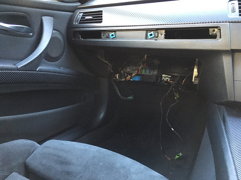

At this point, it was time to tackle the wiring, so i used another guide, this time by "mr_vys": https://www.e90post.com/forums/showthread.php?t=1336444
Untitled
Unfortunately, i found that PIN 37 at the JBE already had something in it, so whilst the Screens Can +/- and ground went in there, i spliced into a retrofit Quadlock harness for power. For the controller i simply spliced all cables into the Quadlock. No OEM wires have been cut, so i can go back to standard if needs be.
By this point, i had something that resembled a dashboard again:
Untitled

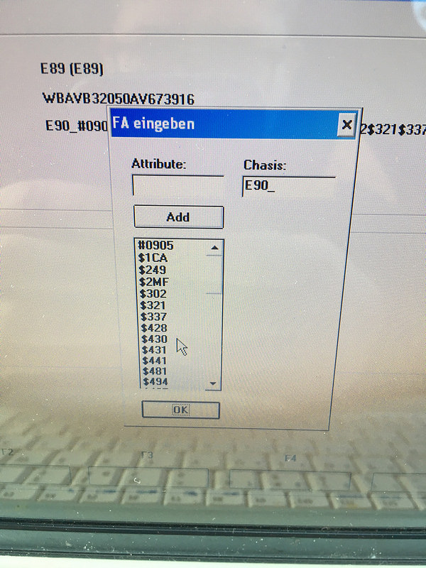

So after a little coding (changing the VO) with NCS as per this video:

Everything works bar the Nav, this can be activated with software/code these days, but my god it looks complicated, so ill probably just buy an emulator for £45. In all honesty, i only ever use Waze, i dont like having the option greyed out in the menus, i also tend to leave the map in the smaller screen because, well i just think it looks nice lol.

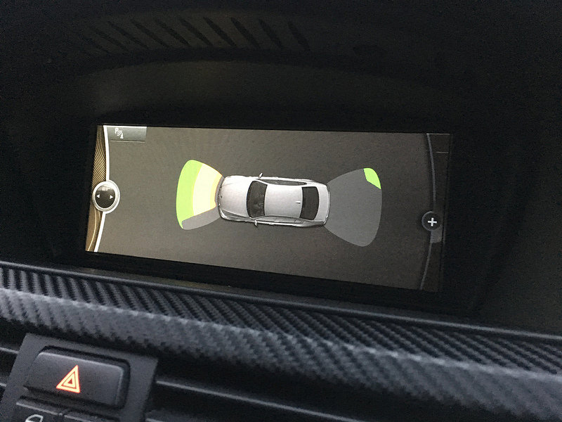

Also coded front PDC so it appears on the screen, with all the latest bongs & other noises. Parking sensors come through in stereo now as well, which is useful.
