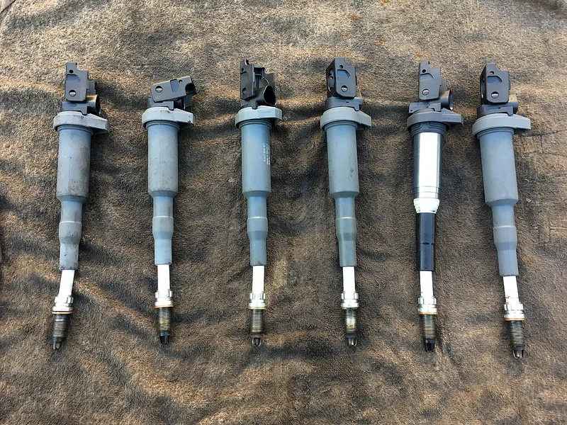

Initial fault finding so far has resulted in:
Cyl 1: Unknown brand coil pack, NGK spark plug – smells of fuel.
Cyl 2: Delphi coil pack, NGK spark plug – smells of, & appears damp with fuel.
Cyl 3: Unknown brand coil pack, NGK spark plug – no fuel smell.
Cyl 4: Bosch coil pack, NGK spark plug – no fuel smell.
Cyl 5: Unknown brand coil pack, NGK spark plug – no fuel smell.
Cyl 6: Unknown brand coil pack, NGK spark plug – smell of fuel, very wet tip.

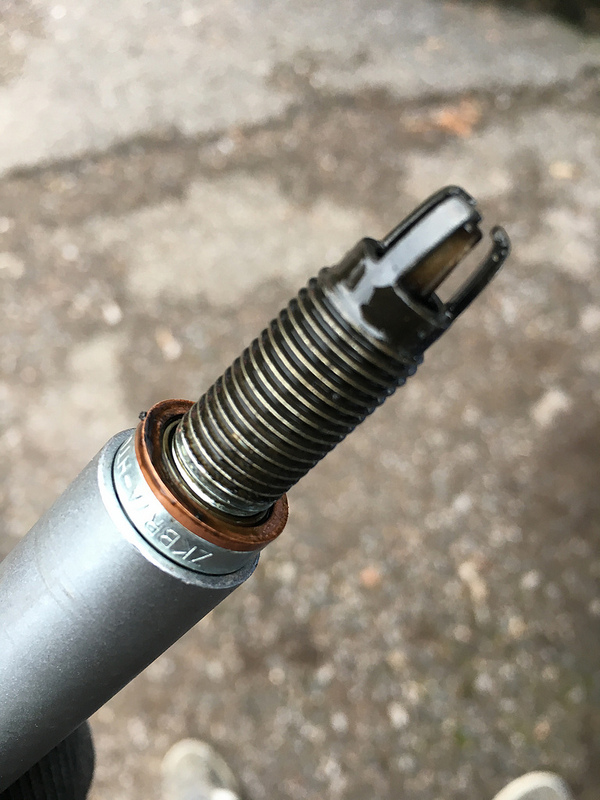

I cleaned all the plugs, re-inserted, then restarted the car, Cyl6 was instantly wet with fuel, all others were fine.
Then swopped the coil packs around, misfire stayed with Cyl5/6. Did the same with the spark plugs, misfire stayed on 5/6.
If I pull the oil cap, the idle stays the same, i.e. doesn’t get any/even worse, suggesting the CCV is fine.
As an aside, people who dont swop all coil packs/spark plugs at the same time are pikeys, they arent exactly expensive FFS.

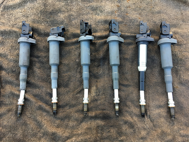

Cylinders 6,5,4,3,2,1:
Untitled
by Sir_Dave, on Flickr

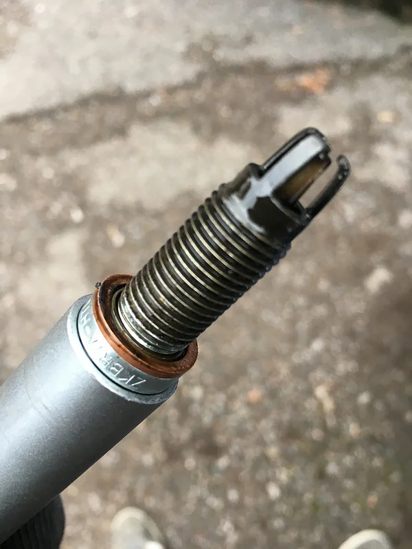

Cyl6 Spark Plug:
Untitled
After buying a new 12mm adaptor, I then did a compression test (tested cold, all other plugs left in):
Cyl 1: Compression at 120
Cyl 2: Compression at 130.
Cyl 3: Compression at 130.
Cyl 4: Compression at 130.
Cyl 5: Compression at 110.
Cyl 6: Compression at 0.
At this point, after swearing a little, having read that a completely failed DI injection can occasionally cause compression pressure to bleed away giving a false reading, I bought a new Index 11 injector & de-coupler. Having removed the old one, I was faced this this, appears covered in white gunk?

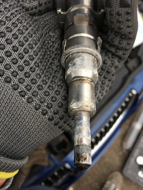

Cyl6 Injector:
Untitled by Sir_Dave, on Flickr
New injector fitted and coded with INPA, re-started it, misfire still there. FFS.

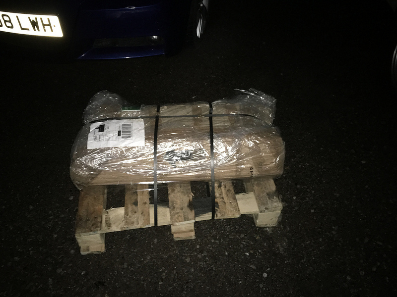

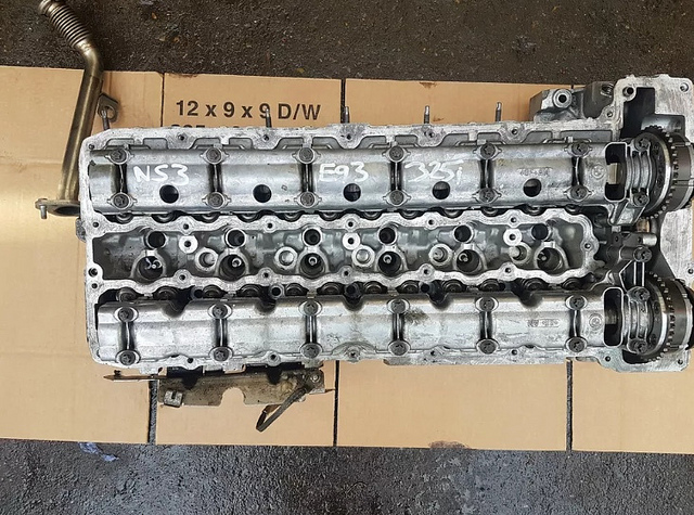

Parts for the engine rebuild have now started to arrive, needless to say, moving a cylinder head on a pallet isnt easy by yourself ?

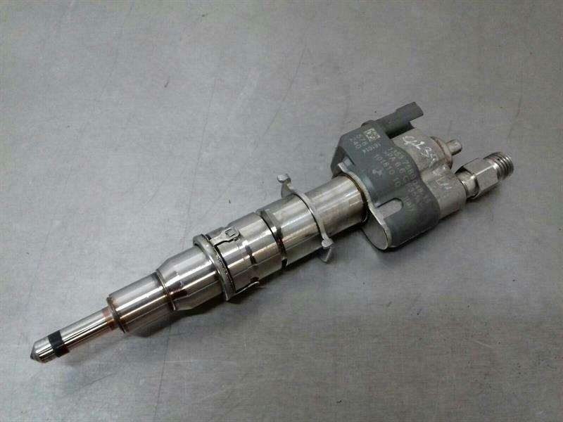

Also managed to find a couple of Index 11 injectors on ebay for £75 each. They'll need new Teflon seals/de-couplers for fitting, but so would the existing ones when they are swopped into the new head - I'll then have a full set of Index 11 on Bank 2, with non-leaking Index 9's on Bank 1.

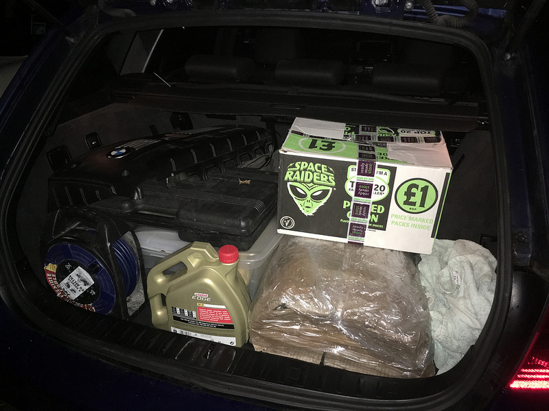

Naturally, the car swallows everything with ease.
