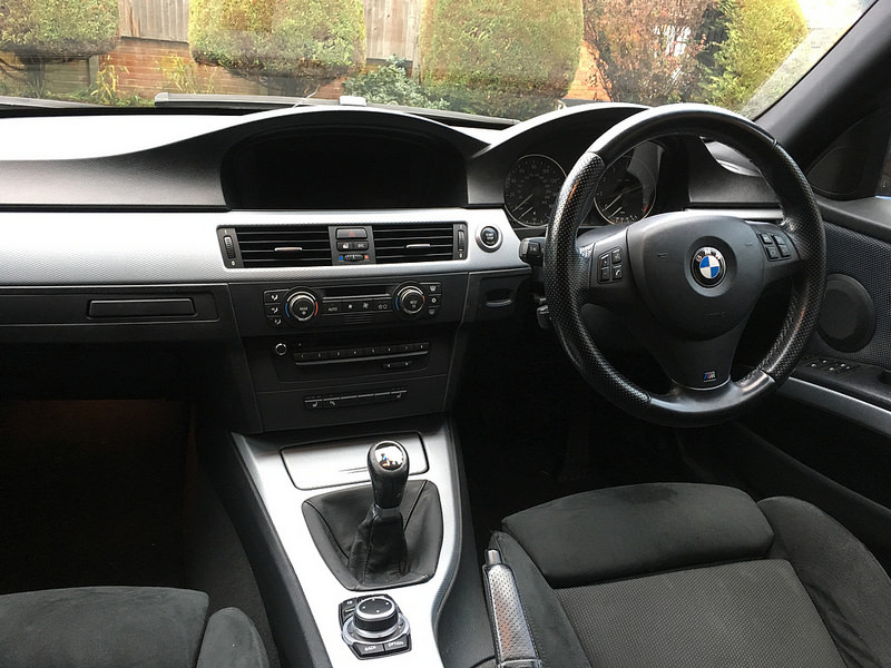

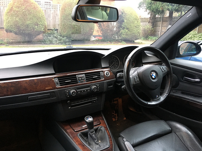

Cheers to all! Has been a decent amount of work, but the final piece of the jigsaw came today ...

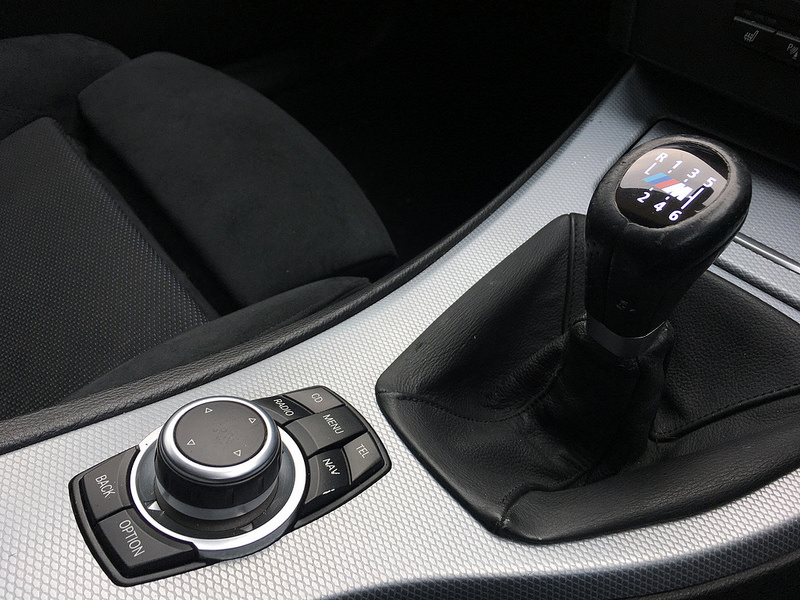

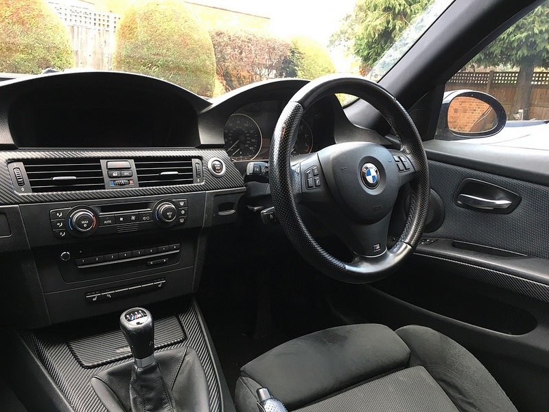

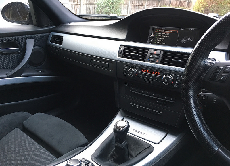

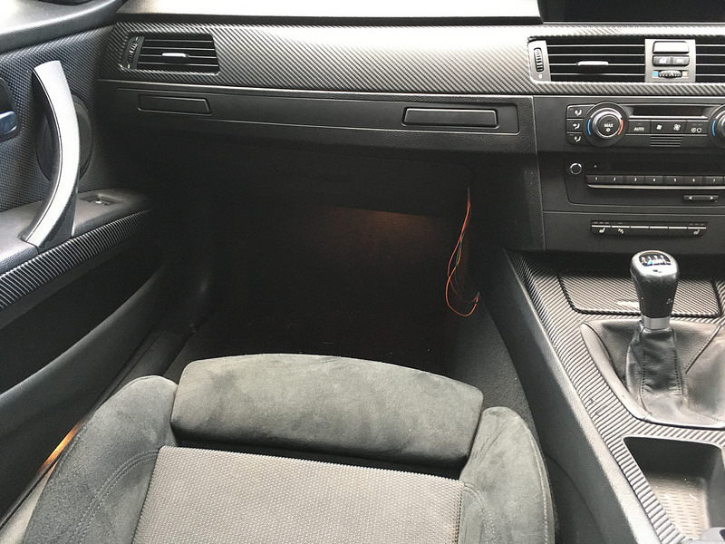

Some before & afters:
Untitled
by Sir_Dave, on Flickr
Untitled
Untitled
Untitled

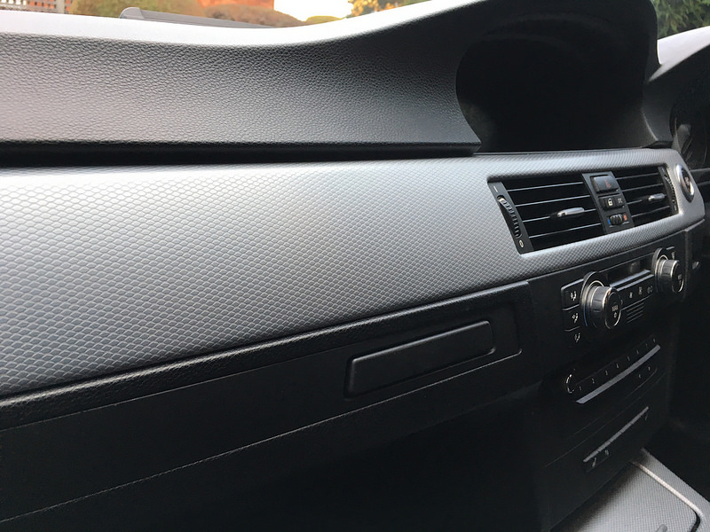

Completed look.
Untitled
Its quite difficult to pick up the pattern on the trim, but its the stuff that came in the 320si ?
Untitled
Untitled
Also finally got rid of the last piece of Birmingham from the car, that ruddy awful "carbon" wrapped trim!!

Am really pleased with the changes though, as @Christopher says, the iDrive etc really makes the interior feel more modern!
Yup, it looks much nicer now. If you serviced it at BMW it'd probably confuse the techs no end now, although I guess it's a common retrofit.
The car looks SO much better now than when you bought it.

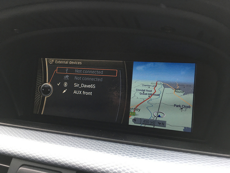

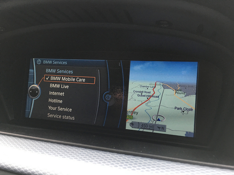

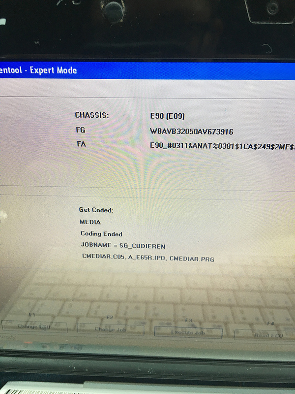

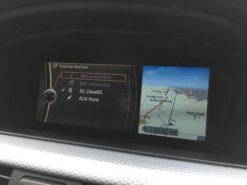

Some tinkering later & we have it mostly working, just need to mess about with a VIN change (or similar) for BMW LIve.
Untitled
Connection Options - Aux currently not working as i need to do some further wiring, but as Bluetooth music /USB Audio works, not sure i can be bothered.
Untitled

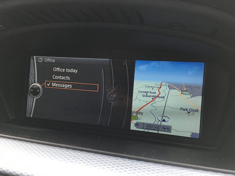

Text Messages pull through to CIC, plus can be read out by the car:

More coding required for these to work - Nav is now running (using Emulator) with latest 2018 maps. Still sh1t mind.

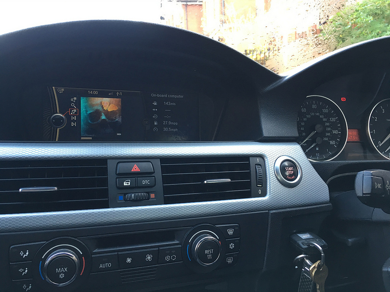

Music:
Untitled

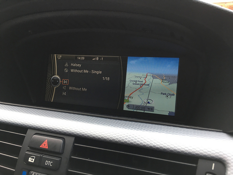

Then with Album Art pulled through from phone:
Untitled

Shame my laptops battery died so i cant finish off the rest of the coding ... will have to rig up an extension lead out to the carpark somehow ?

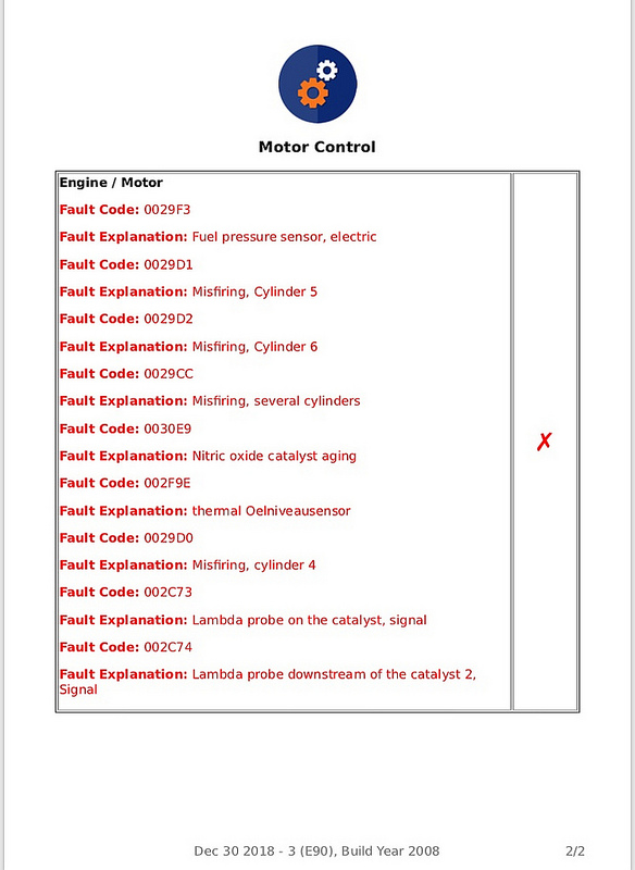

So between Christmas & New Year i bought a manual e91 N53 325i off ebay, with a misfire, whilst a bit drunk.
I'll post about it in here, just because hopefully it'll be an easy fix and i can get back to messing about with the 330i.

And a sh1t load of errors.

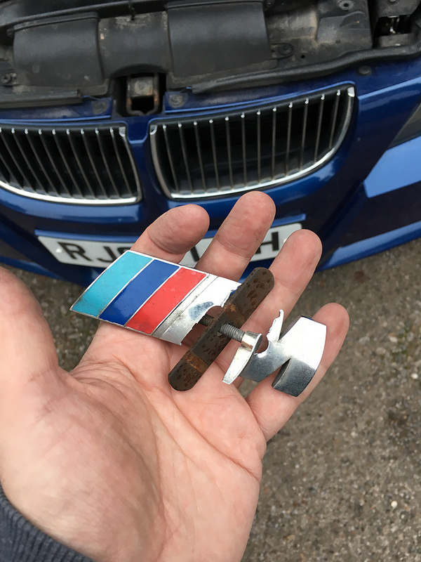

I havent yet done any diagnosis, but i have removed this f*cking thing off the bonnet.
Untitled

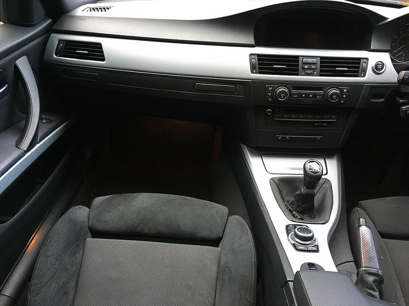

Spec is very good and mostly why i bought it, so adaptive xenons, highbeam assist, pro nav, usb input, bluetooth, Logic 7 DSP speakers, retractable armrest, black leather electric seats with memory & lumbar. No front parking (easy to retrofit) or heated seats (utter pain to retrofit, but possible). Currently im unsure why ive bought it, or what im going to do with it, but i'll update the thread as & when ?
