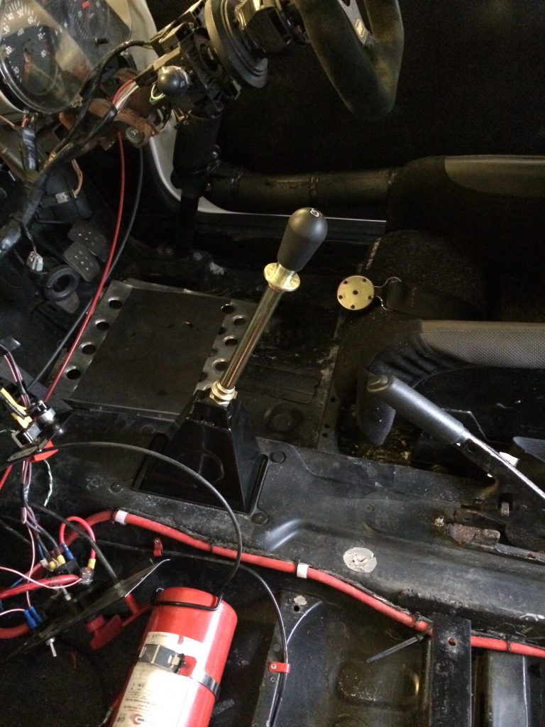

On to the PMS close gear stick. Nice bit of kit, although difficult to fit. Took about 2 hours to get it spot on!

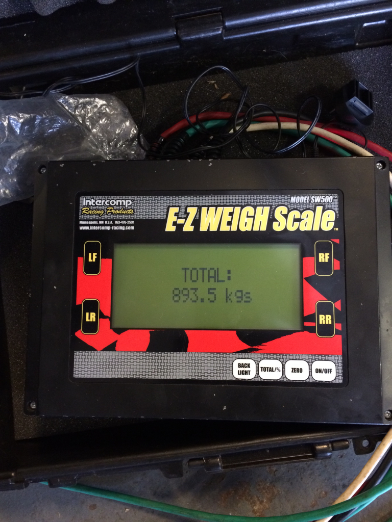

We got the car on the scales, and it looks like it's been off the pies! Weighing in at 893kg!
Amazing the difference in weight! Someone posted on here already, how to work out the power difference the 222kg loss will make to the power, I'd be very grateful.
I'd also be interested in opinions on the corner weights. We changed a pit around, but only shuttle tweets. It was always going to weigh more on the drivers corner, due to the extra kit on that side, but we didn't think the difference really made any difference. The car handles very well already!
Forgot to take pics of the corner numbers, but without me in, the back was exact, but the front corners had 26kg difference.

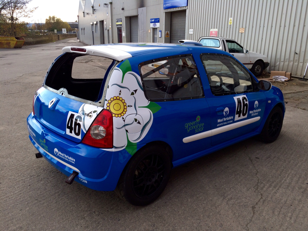

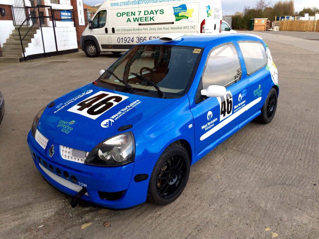

Anyway, a couple of shots of what it looks like now!
The front door still need a bit of alignment.
I'm well chuffed!

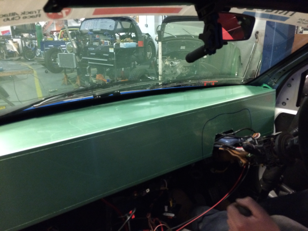

Finally for today, as we were shattered, we started on the dash. From the pictures, we still obviously have the green protective take, but we are making it out of Ali. The wires will all took up nicely behind, the original clock will be getting fitted to the left of the wheel. Fuse box and diagnostic will also fitted to the front, for easy access.
All the rest of the switches and panels, will be fitted down a centre console, still to make. The dash will also have a selection of other dials, but not until we are in to the winter projects. There's a gear changing light panel to fit directly behind the wheel, as that's the main thing I struggle with, changing at the right time!

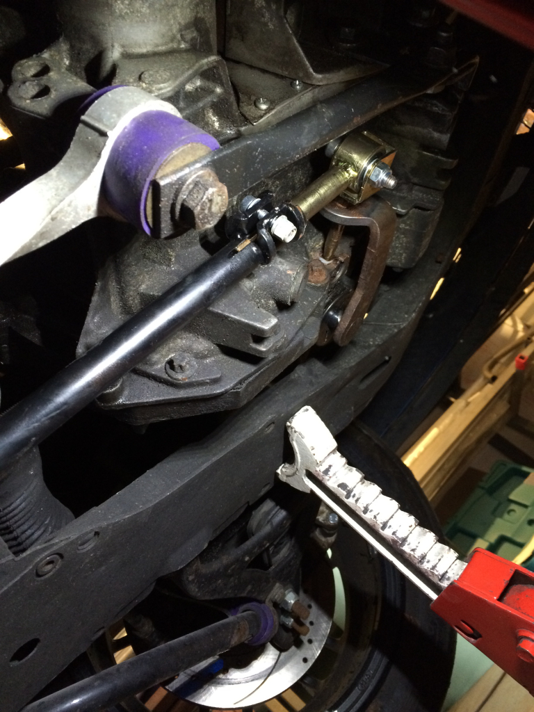

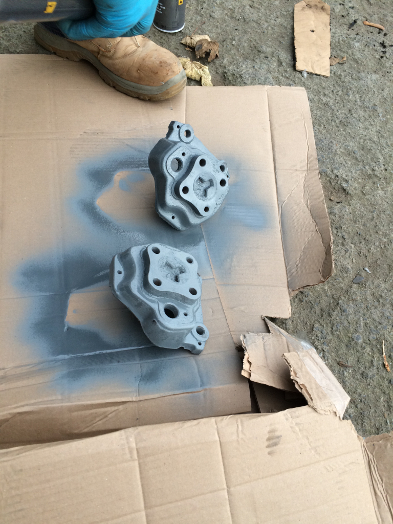

Whilst stripping it all down, primed and painted these bits. No idea what you call them!

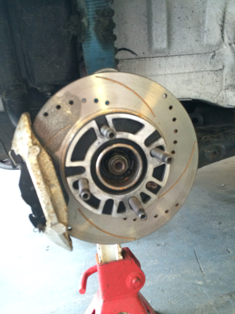

I've also fitted some Brembo vented disks around

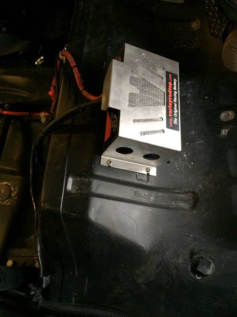

Car is looking awesome Andrew :) Just a few bits I would say and I’m only saying them as dont want you to have issues further down the line. Sorry if you’ve already thought of them.
In the top picture I’ve quoted you haven’t accidentally caught the fuel tank under where you’ve drilled have you? Its pretty close under there.

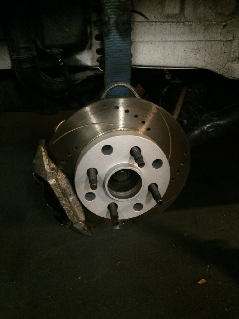

2nd picture I can’t see if you’ve masked it but its best not to paint the surfaces that mate upto each other as when you are running the paint can compress which then loosens the bolts holding everything together. Its especially common with the back of powder coated wheels

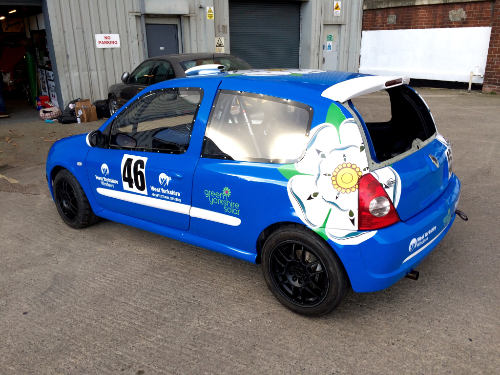

3rd picture Do the wheels still locate on the centre bore or are the spacers too thick if so in future you might want to pop them onto Hubcentric spacers :)

Pic One, We didn't self tap it, so I'm pretty sure it's okay. I didn't actually do it myself though, so will make sure.
Pic 2, No, we didn't mask it, but did clean the wet paint off that part before it dried. We also put some copper grease on both sides of the shim before we put it all back together, to ensure it didn't rust.
Pic 3. I'm not sure. I'm pretty sure they just locate off the studs? I've never heard of Hubcentric spacers.

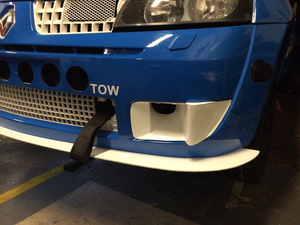

Also got this little beauty fitted to the front bumper, thanks to Chris at CM Composites.
After we fit it, we trimmed it down a bit at the sides, purely for aesthetics.

Basically if you drew a horizontal line down from the most forward part of your bumper the splitter must not protrude further than 10cm
Same with the side,
Quote from the book below
5.2.7.
Aerodynamic devices may only be fitted to
Racing and Sports Racing Cars (unless prohibited by
an Approved Formula), or where specifically permitted,
where FIA homologated, or where complying with
National type approval. Such devices must not extend
beyond the maximum width of the vehicle, above the
maximum height of any roof, or for an open car the
maximum height of the ROPS, or extend longitudinally
from the body work by more than 100mm
Dont want you to have any scrutineering issue mate

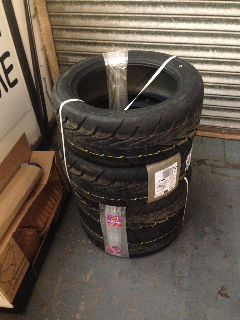

Started with a new set of tyres from Demon Tweeks for the weekend racing. Probably had enough tread for the racing, but booked in for testing too, so better safe than sorry!

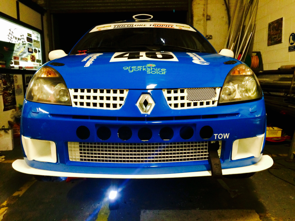

I think the front end looks awesome now! A mean looking front!
