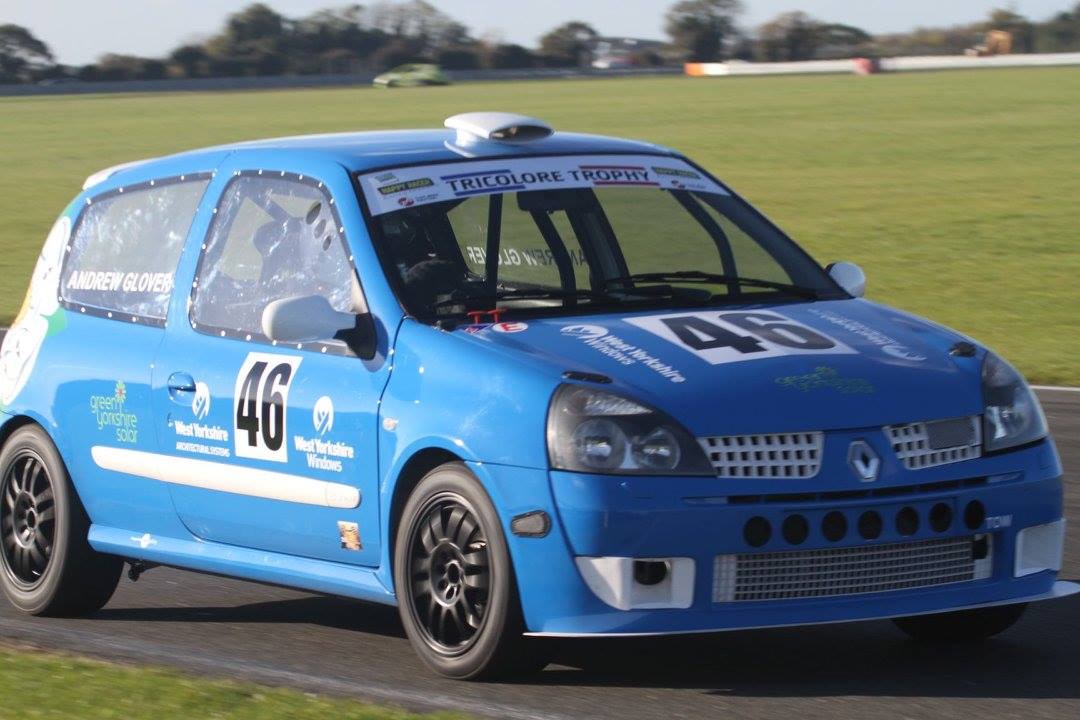

Baptism of fire today! Handled like a bag of knackers first session, then rear break pad fell out in second!!
So, took ARB off and sorted suspension out. Handled lovely for the second session.
Then, flying down the back straight at about 120mph, breaks went! Turns out we had fitted a clip the wrong way! Won't do that again!

Snetterton report!
Qualified in 21st out of 40, which I was quite pleased with, as I was still getting used to the feel of the car, and it was slippy as hell!
Got a few battle scars in the first race, as I got rear ended by a Maxda! Once I got out of the mess of all the MR2's and other Japs, I got going and started to improve. Finished in 13th after the first race, with a best lap of about 2.27 from memory.
Second race started in 13th. Dreadful start, and lost about 4 places! Found it very difficult doing a race start on a hill! Anyway, got going and pulled it back to end in 10th. Dave's Clio (not sure if he is one the forum?) in front of me, but I couldn't keep up! A faster car and better driver!!
Race 3, started in tenth. I started with intentions of keeping my place, as I had no idea how I'd keep up with those in front, as they were all a lot quicker! I did gain one place though, which I was chuffed with, so ended up 9th overall. I think I was second in class, but I may be wrong. Lost track a bit, with all the excitement. Best lap was 2.24. 3 seconds off the guy in front of me!
