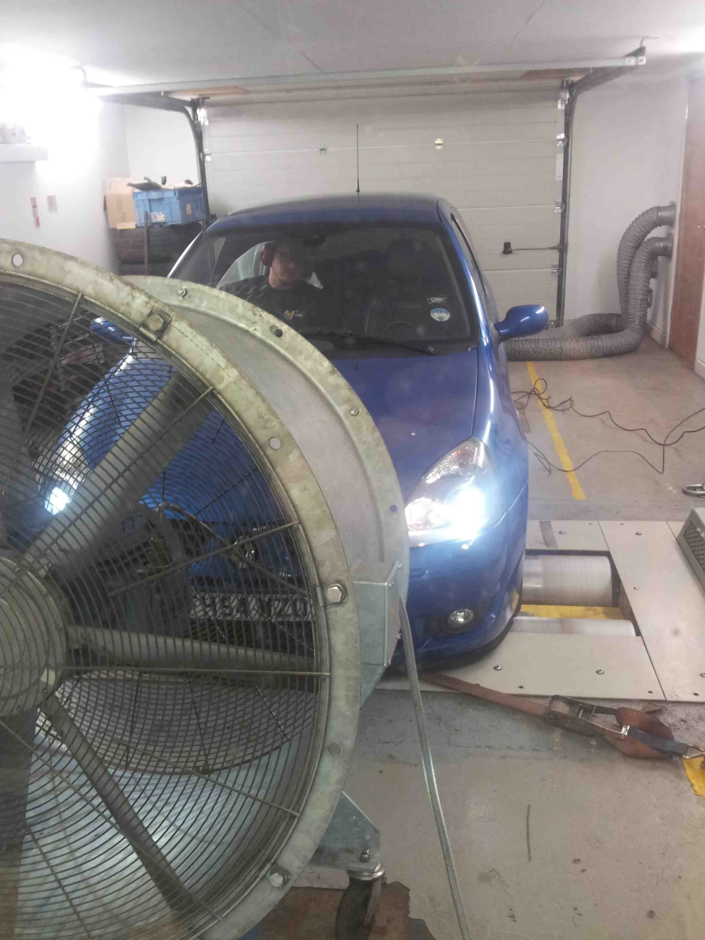

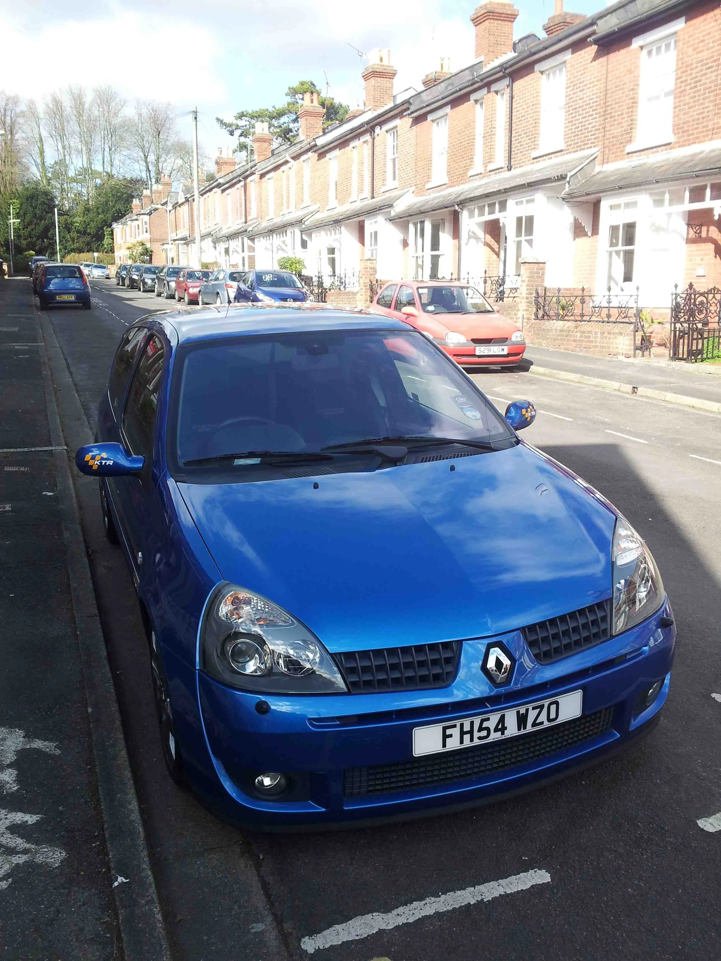

thought you might like to see my 182 after a visit to ktec on Friday!!
Car  182FF

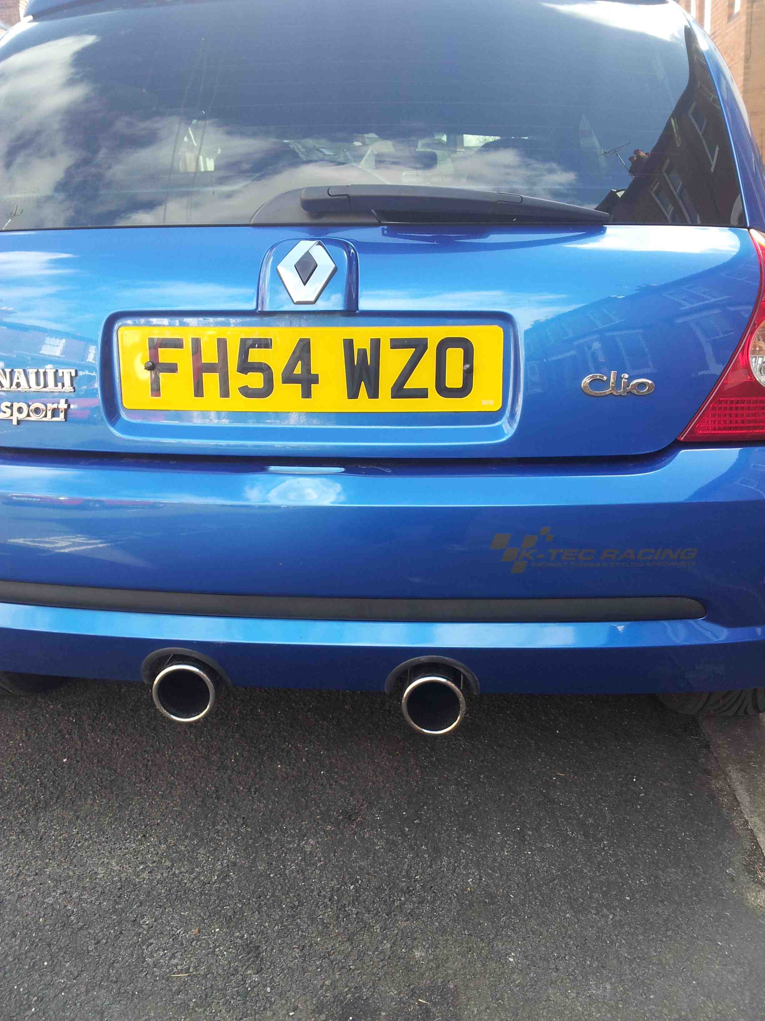

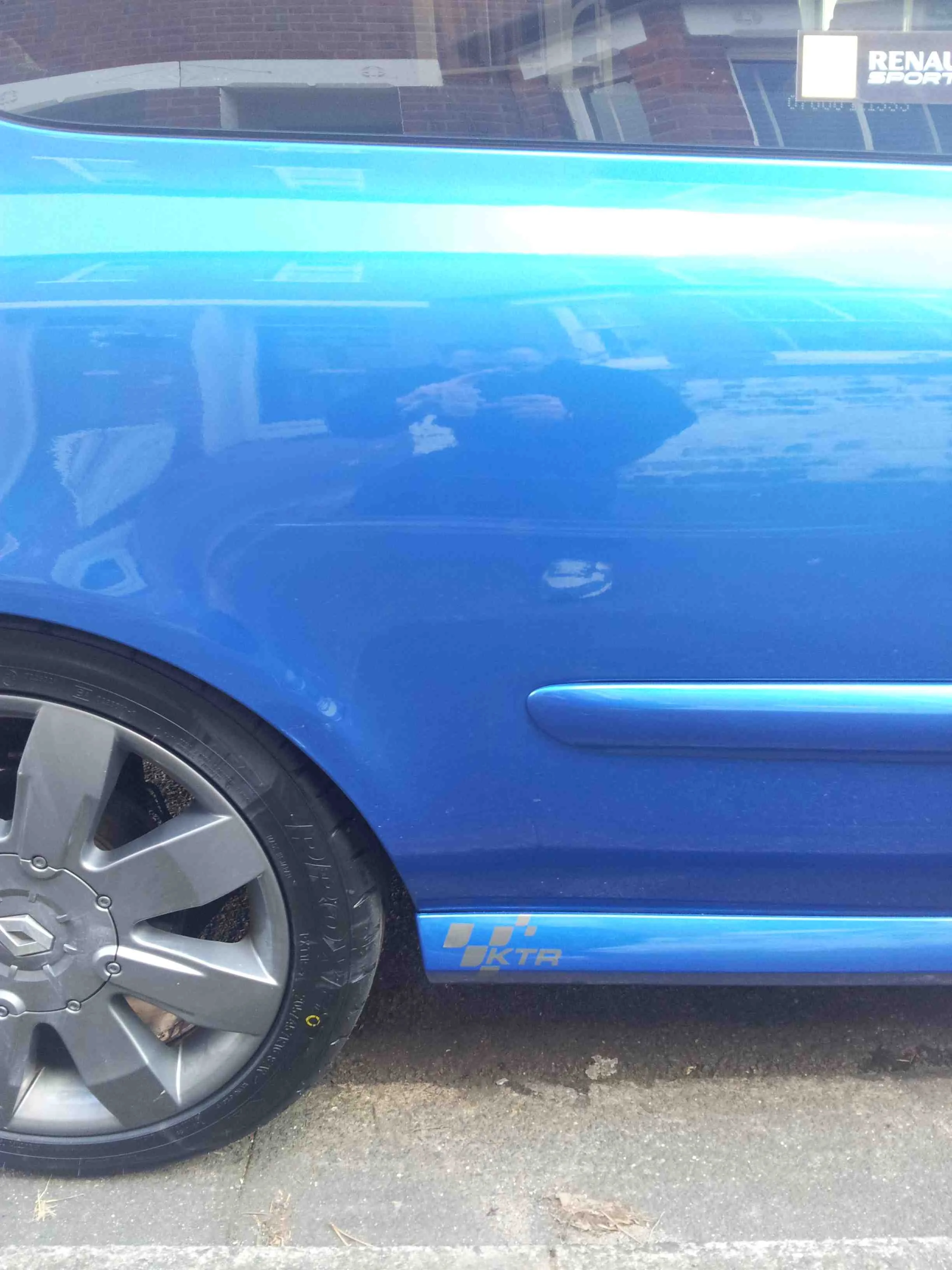

hello all, here is some new pics of my 182 after a stage1/ 30mm lower/ and ultra exhaust
we tried a prototype air induction which i have a vid of!!!.... good gains from it too!!
lovin the new exhaust!!!
the guys at Ktec were really nice too !!! !:D
enjoy.

Correct me if im wrong, but if this is their own exhaust, & they fitted it themselves, you would have thought they'd fit it on straight ... Looks like the right tailpipe is lower than the left?
Nice system though, had one on the old Trophy, before i upgraded to the BTB ;)

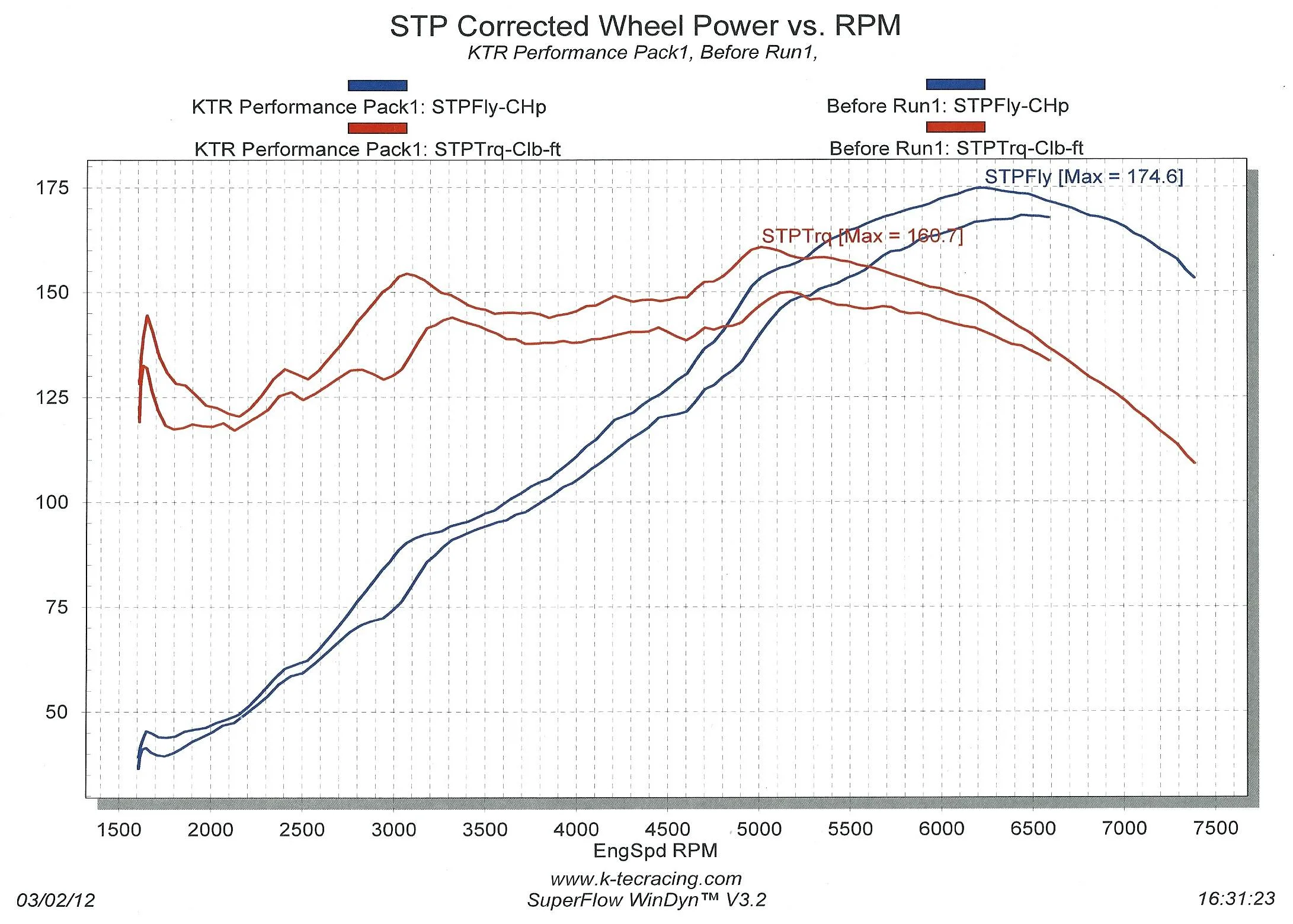

so here it is !!!! sorry for the delay
this does not show the prototype air induction...but i saw gains of about 8bhp with it
i will be fitting it when it is ready approx £130.00??!!
so this is before and after remap!!
yes i will be removing some stickers as it looks rubbish, prob leave the back and sides, the ears are gone!!! LOL

what have you done to get 197bhp?

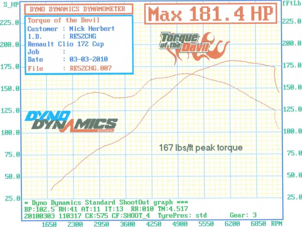

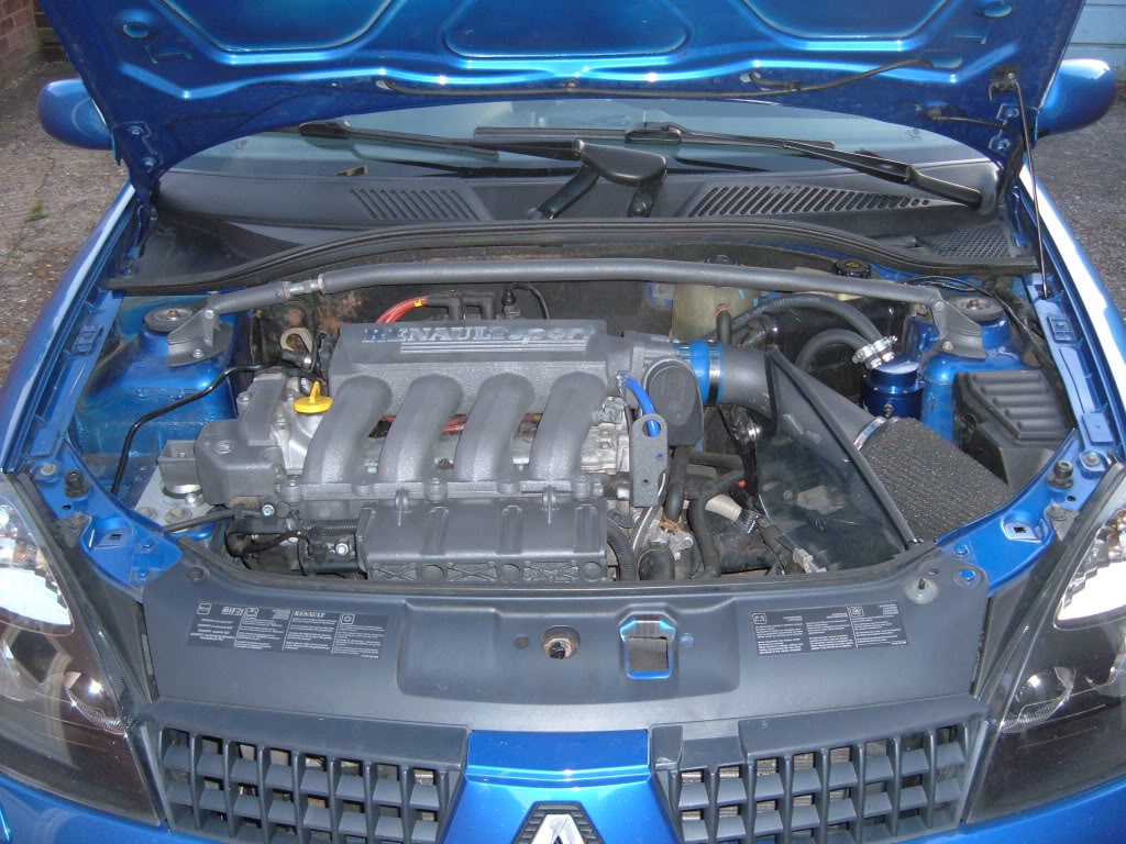

Lol at this super spaffy induction kit, i'm sure its been done before or something very similar.
Maybe something like this?
That was my best setup for a standard inlet manifold. 181bhp/167lb/ft of torque from just matched inlets/RSTuner remap/decat-back exhaust and that setup.
Looking back on it now i'd go with a similar setup that the Honda civics B16/18's use like this...
http://www.ek9.org/forum/sale/4714-js-racing-carbon-induction-kit.html
Nick
