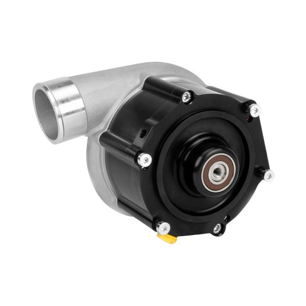

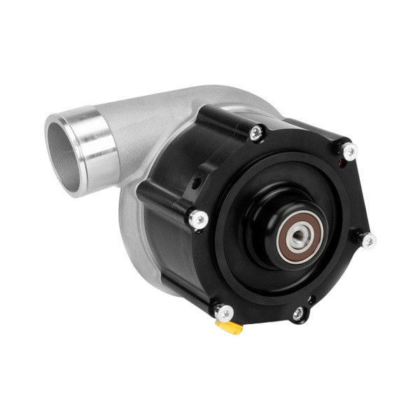

I do have a Rotrex C30-94, would need a different pulley to run on the clio but the non replaceable parts do worry me sometimes that I would have to fork out for another charger if it was ever to go wrong :expressionless:
Internals can be repaired. Saw it on a different website where someone listed bearing part numbers and info on the main shaft
