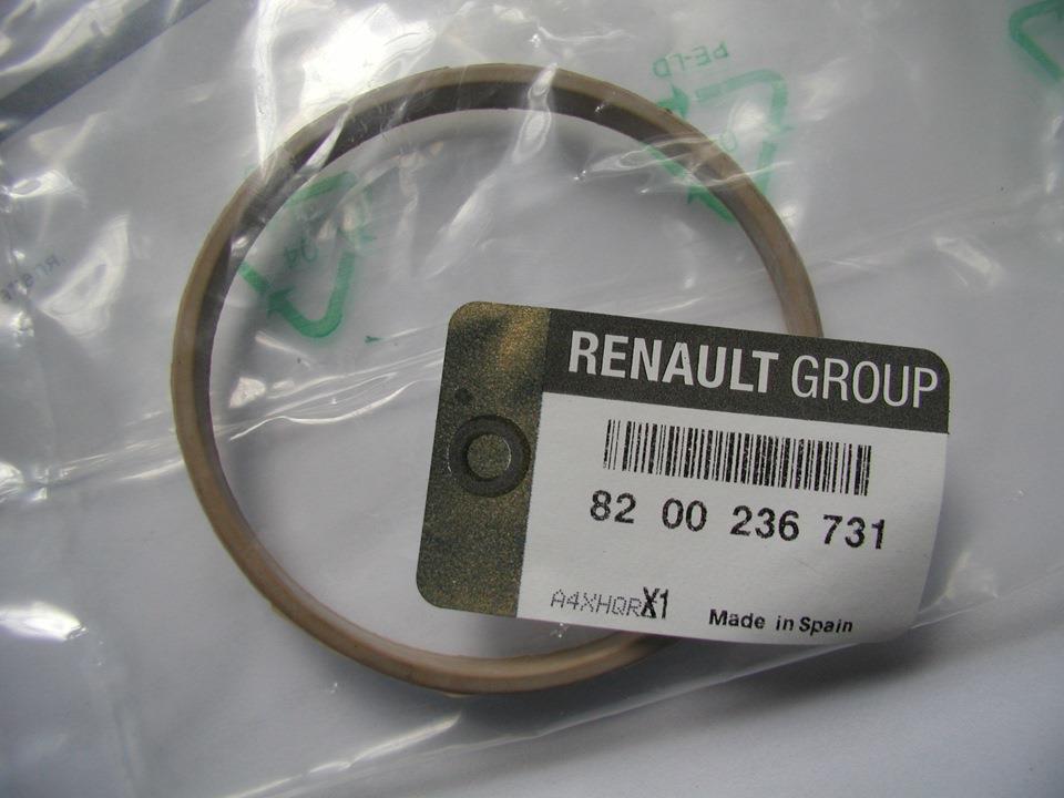

Really struggling to track down the part number for the seal that sits in the deep groove on the throttle body to inlet mounting face. Partsouq doesn't seem to be throwing up any results.
Will be re-fitting the throttle body and matched inlets soon, so hoping to get a fresh seal in there.
Can anyone help?

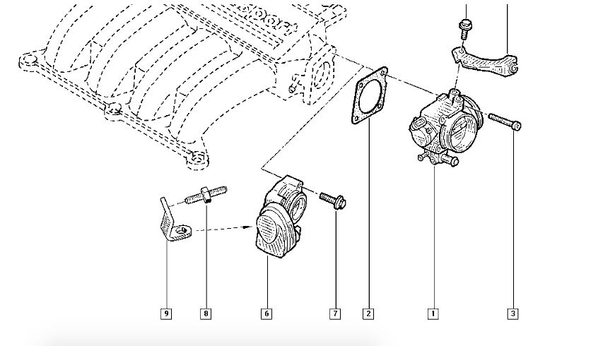

The seal comes part of the Throttle body and not on its own.
Item Number 6

That "seal" shown on there is available... But its not a seal its a gasket and way to small. I ordered one and when realised it was wrong was told by rpd that the oring isnt listed
Think the gasket maybe for a ph1

As far as I can remember, there is no gasket, just a shaped O ring.
