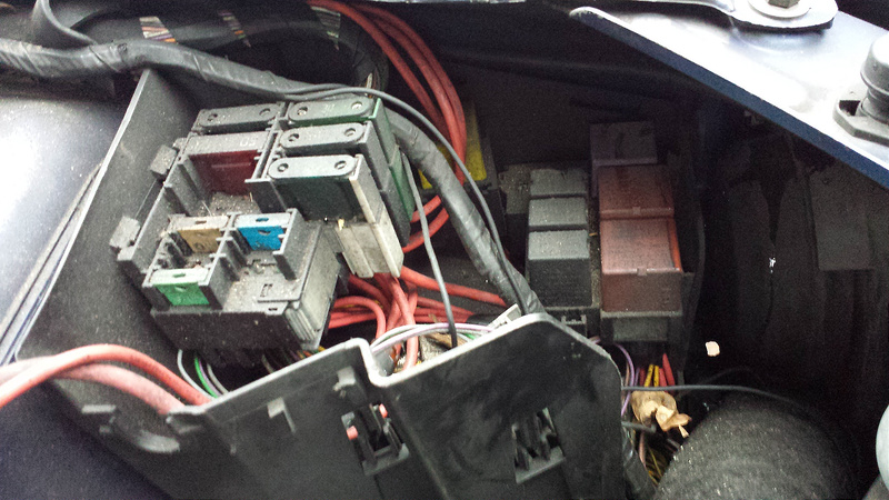

Ahh ok cheers, car doesnt seem to have a fuse box cover so i dont think that is helping in keeping the elements out. Will have a look in the morning for it. Managed to get a video of the noise the TB is making, dont know how to upload it onto here tho.
Went out this morning, where abouts am i looking? dont want to sound like im ignoring your advice but TB sounds more like a nasty scratching than a buzzing, normal? Pedal didnt make a difference.
20150116_085205 by felixta22, on Flickr
TBO,I spent hours cleaning this and checking that.I would have been better off doing a bit of overtime.In the end I took it to Mick at Diamond Motors,who sorted it while I went for something to eat.
I would give Mike at Rentech in Portsmouth a ring,023 9266 5848.He has no doubt seen a few of these.
