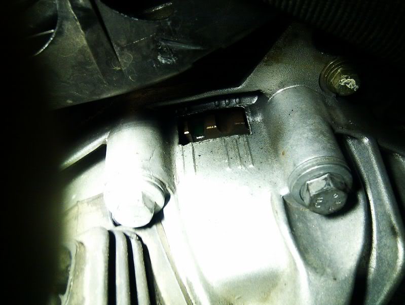

Pretty easy to read off error in degrees from the angle markings on the gearbox though

that picture i put up shows the flywheel lined up with the 0 degree's line, ie it's at top dead center, your man is saying the crank/fly was approx 6 degrees out from this alignment. The close together lines in the picture are 1 degree apart ;)
