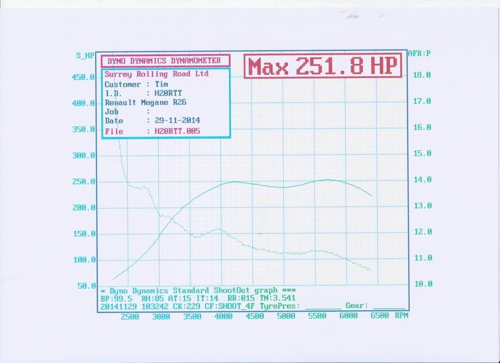

I headed to Surrey Rolling Road at the end of November to see what it was making.
Slightly better than the 237bhp at RS Tuning but still not good. Emailed the graphs to Paul and he responded saying something still doesn't look right 😧

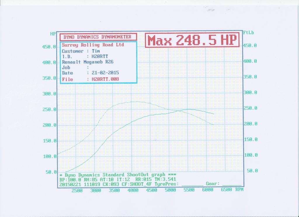

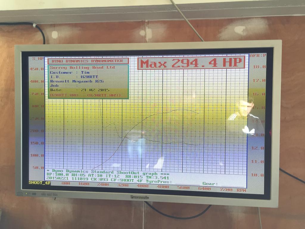

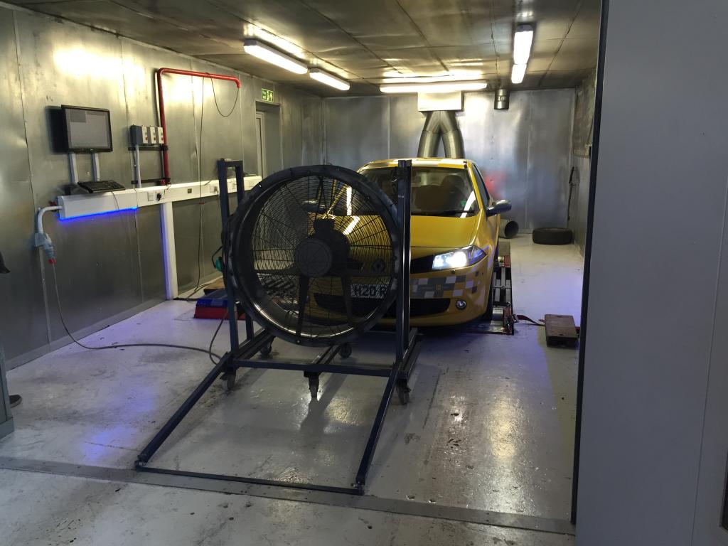

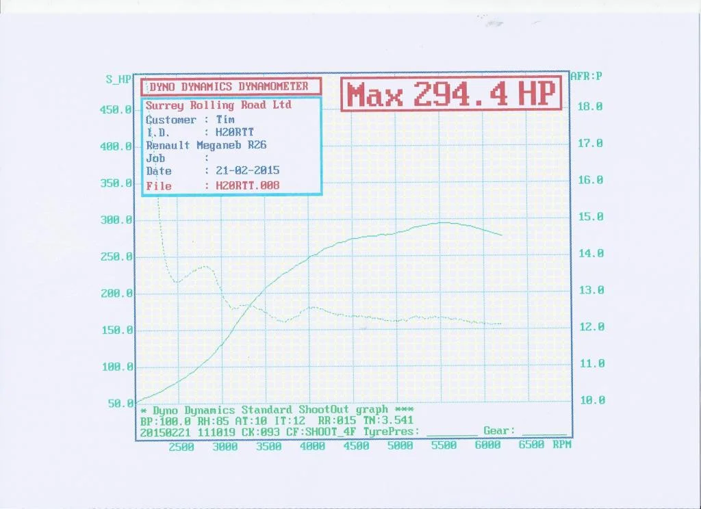

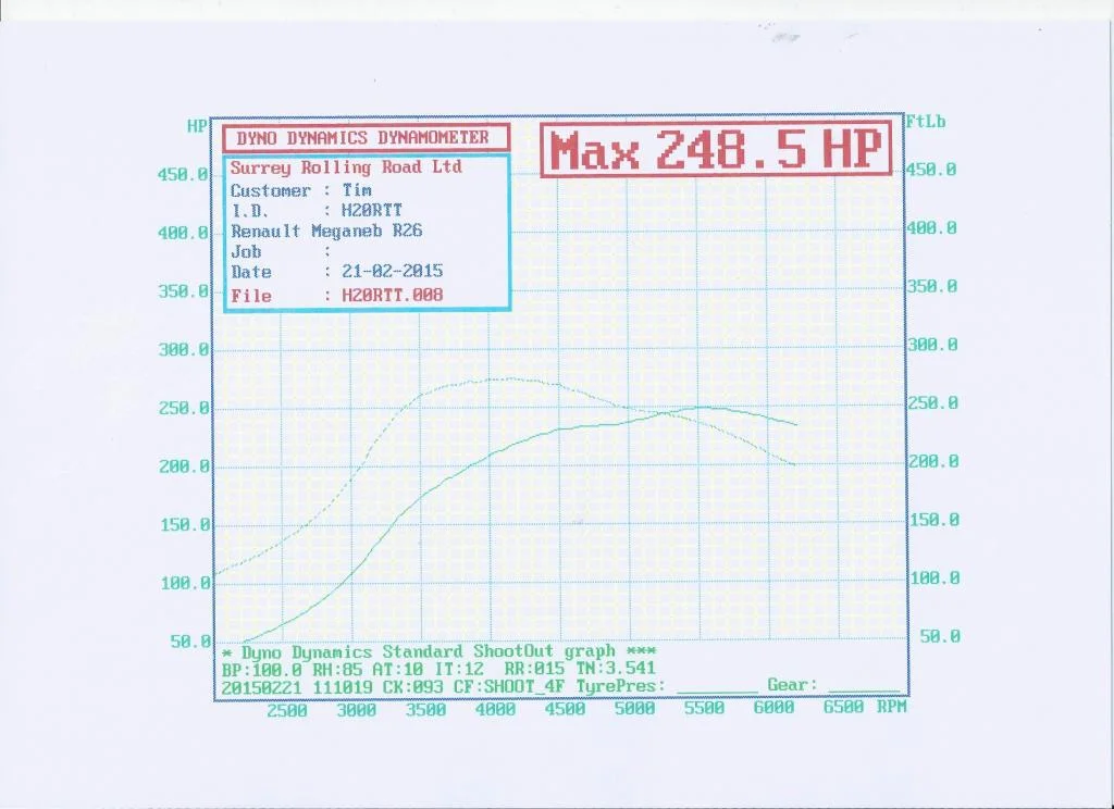

This morning I went to Surrey Rolling Road to see if the Rentech correcting the timing had actually made any difference.
Nice to see it bang in a 294 first run :tonguewink:

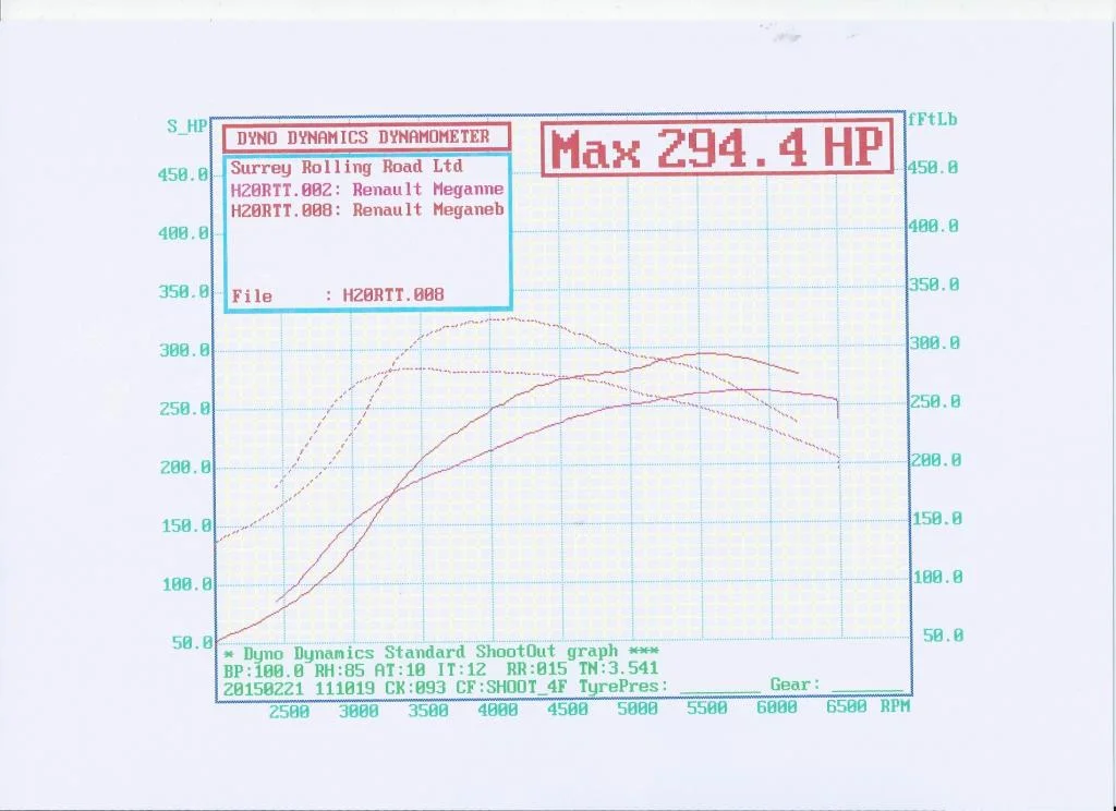

Here are the graphs:
294bhp and 325lbft at the flywheel
AFR's not too bad considering it's running a forged engine and hybrid turbo on just a 630cc injector base map
245bhp at the wheels so almost as much as the flywheel figure when the timing was out.
Comparison to the old engine and replacement turbo on the 630cc base map.

Nice result on that 294hp
Knew it would be better

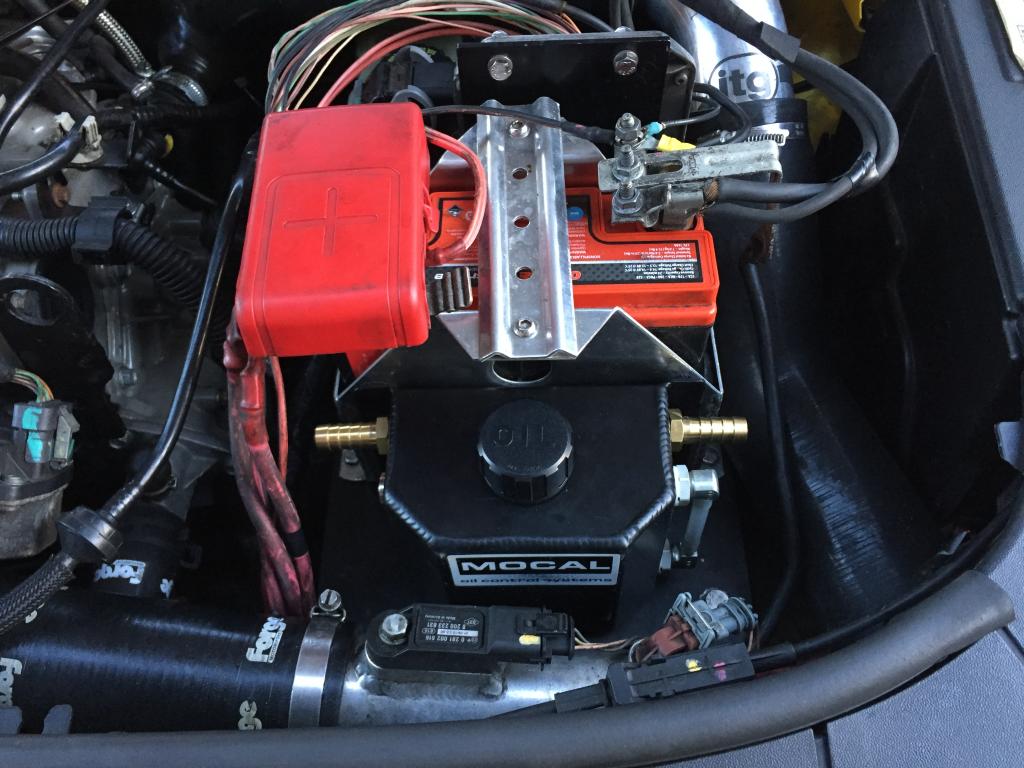

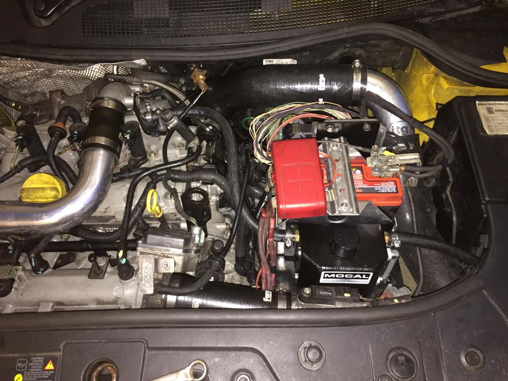

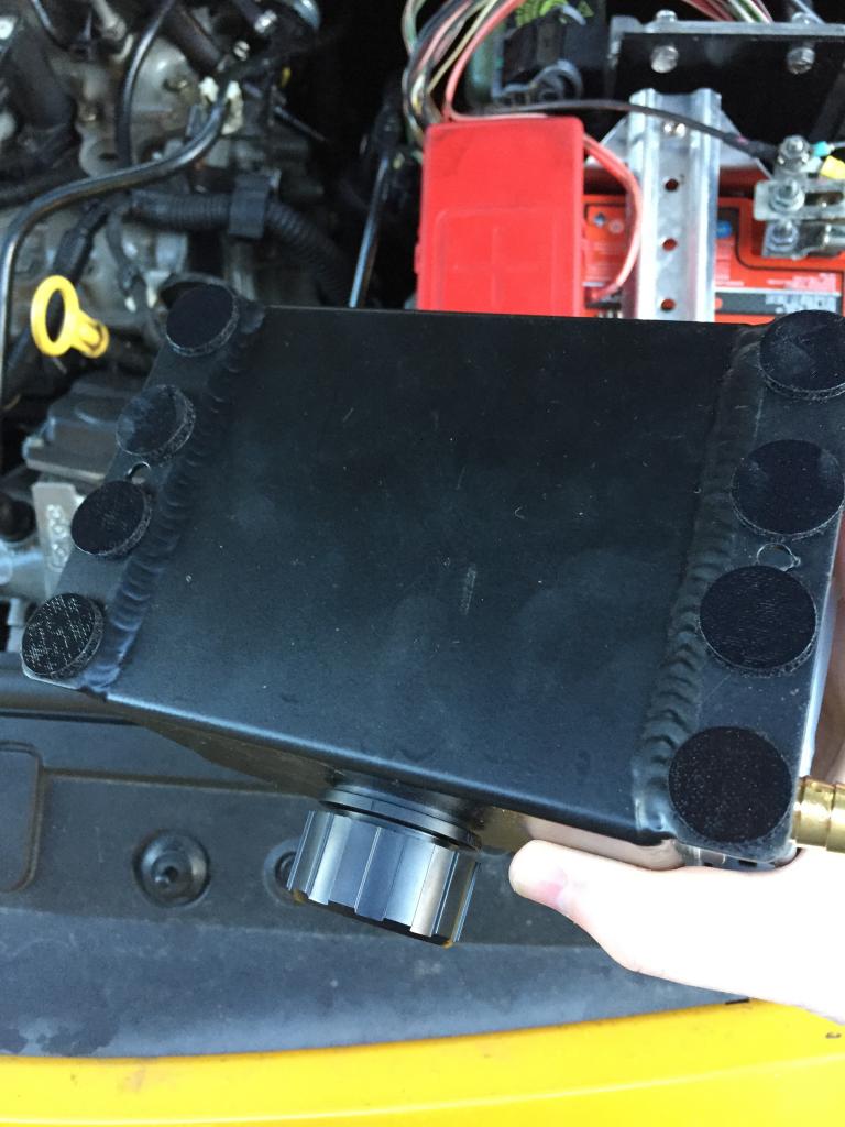

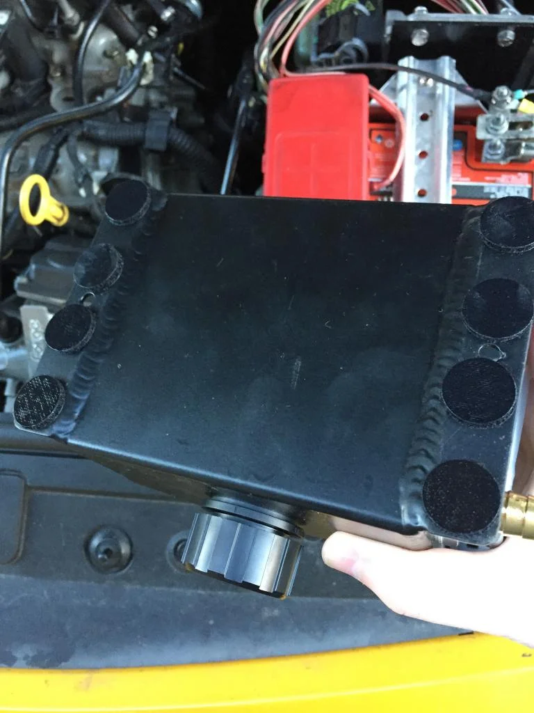

Plan was to fit my Mocal catch tank yesterday but the rain stopped me.
I got home from early today and the weather was ok so I decided to attempting fitting it.
Decided to use velcro coins to mount it on the battery tray. Figure they hold my number plates on at 160 so should be up to the job :tonguewink:
Catch tank in position

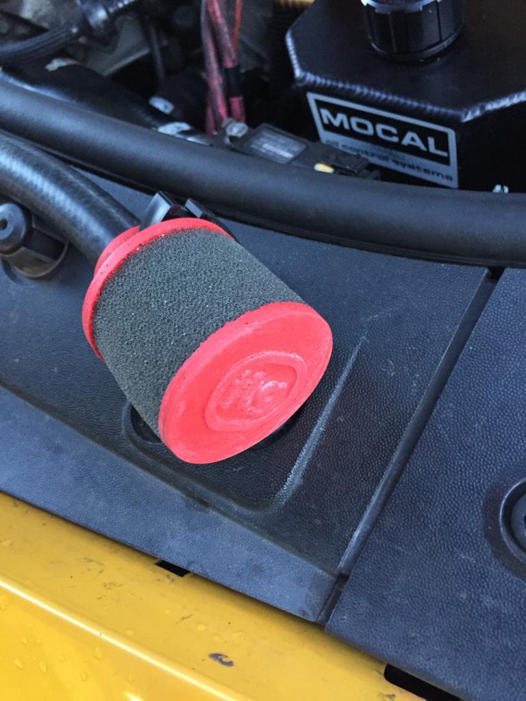

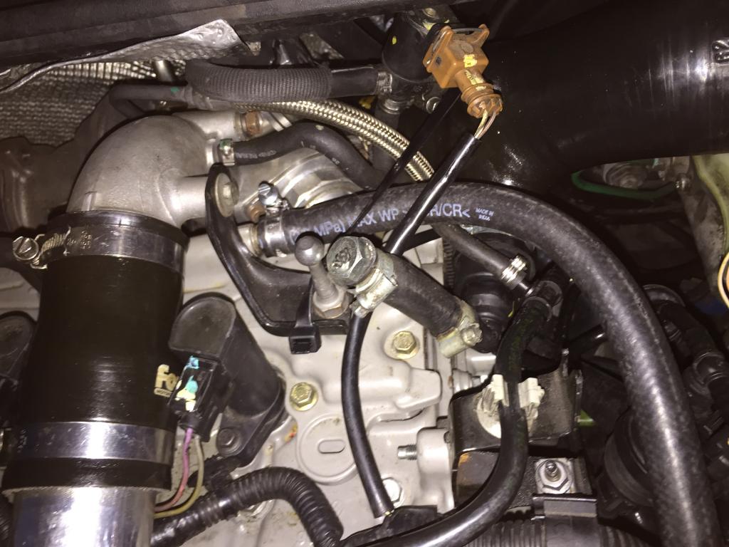

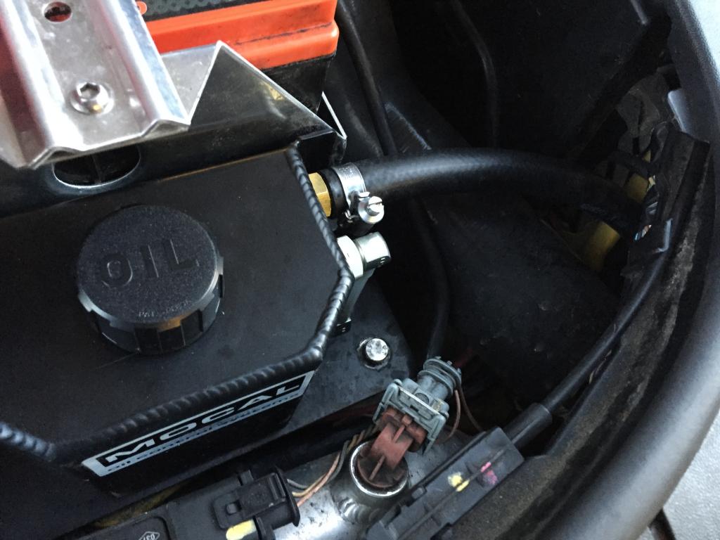

ITG breather filter
ITG breather running down behind the headlight next to the ITG air filter

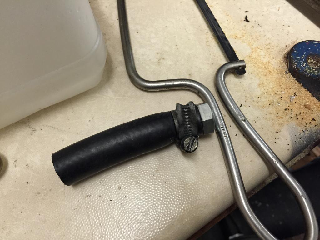

New piece of hose blocked by a bolt and jubilee clip
In position blocking off feed to the intake hose
Mocal catch tank and new rubber hoses secured in place
