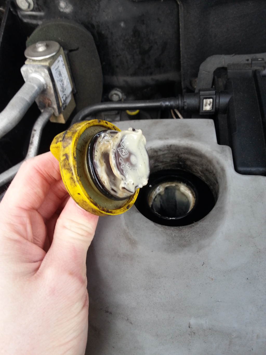

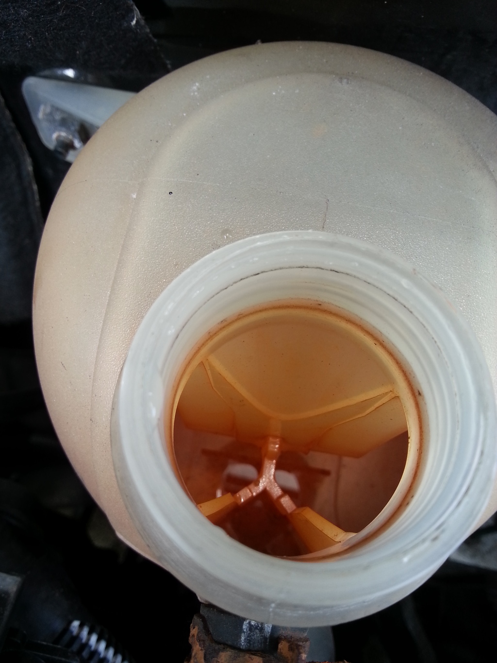

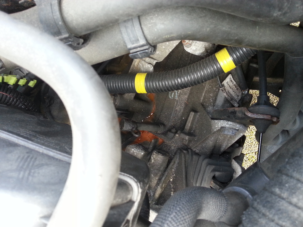

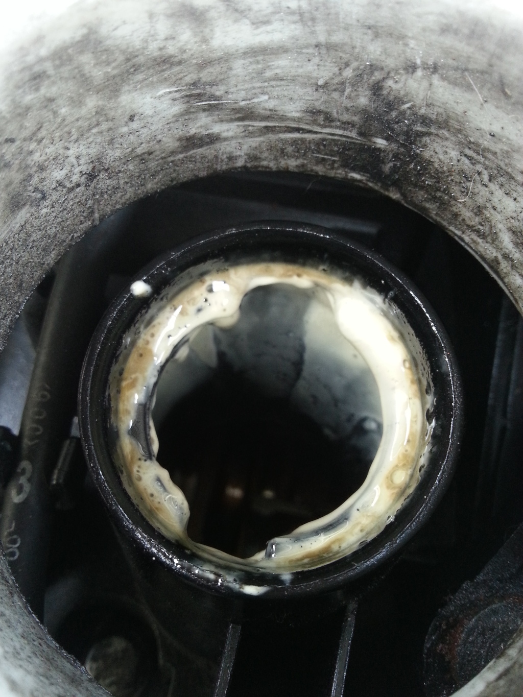

I did find this under my oil cap though, but am i right in thinking its down to me making only small journeys in the clio and nothing else major? I've not lost any coolant or oil. I did notice this down the side of my engine though, so maybe a small drip of coolant from somewhere? Hoses do have rusty clamps on, worth doing a coolant change?
Anyway, let me know!
White foamy stuff is nothing to worry about, I get it too. Its by not letting the engine get to temperature and too short journeys. Try to take the car on a good blast once a week.
Not sure on engine noise though tbh mate, as I have a different engine to you!
Well i've not gone above 40 in it in the past 200 ish miles. So that's probably why too... Lot of stop start in huddersfield! Hopefully someone else is able to help. Thanks though mate you've helped a fair bit already!

Also it looks like your thermostat maybe leaking
I'll get under it tomorrow and have a look. Would the thermostat leaking just be small then? Hence no loss in coolant? It gets upto temp okay usually.
You can have a look from under the bonnet at the flexi, look over the back of the engine between the coolant bottle and engine and you'll spot it, just have a feel round there see if you can feel it blowing, watch your hand as itll be hot lol
It may not be the thermostat, but my car had a small amount of coolant puddling on top of the gearbox and it lost a small amount over a week, and it turned out the thermostat housing was cracked, cheap part and relatively easy to change so i wouldnt worry
Gave it a run back to york today and im happy to say that the build up of "cream" under the oil cap has gone! Must've been all those short journeys... Got 38.7 mpg now which is better than the 23 I was getting. Had a look today and think it is the flexi which is blowing. How much of a job is this to replace and how much would it set me back? Is not getting it done going to negatively affect the car at all? I also have an MOT in a month.
Ahh good, i used to get concerned at mayo in the cap, but i do 350 mile a week in mine on a run so havent seen it in a while

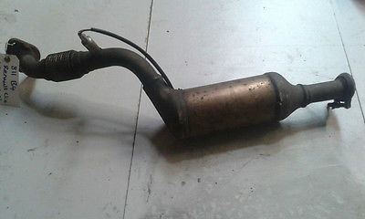

The flexi is part of the cat (borrowed the pic below off google)
Its one olive joint clamp which will no doubt be rusted beyond use, so its best to relace, and two nuts to bolt it to the manifold flange,
Shouldnt take long at all, just will be fighting with rusty bolts and it'll prob be hard work to remove the lambda sensor
Either a second hand one, or they're around £70-80 for a new pattern part

A second hand one can be had for sub £50 maybe cheaper in a scrappys or by keeping an eye out,
no major adverse effects really, itll just sound a little blowy, and maybe have a slight impact on mpg.
