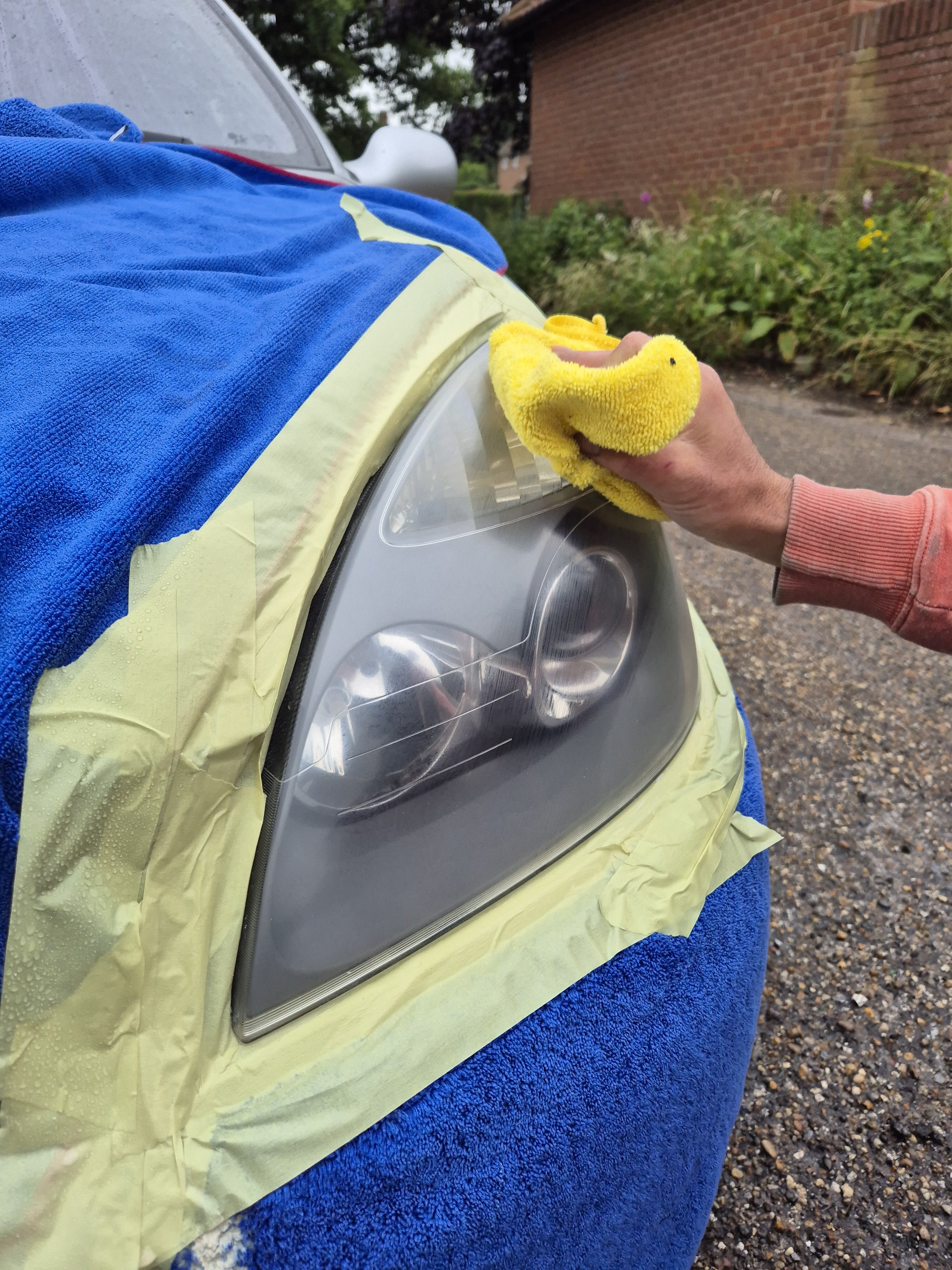

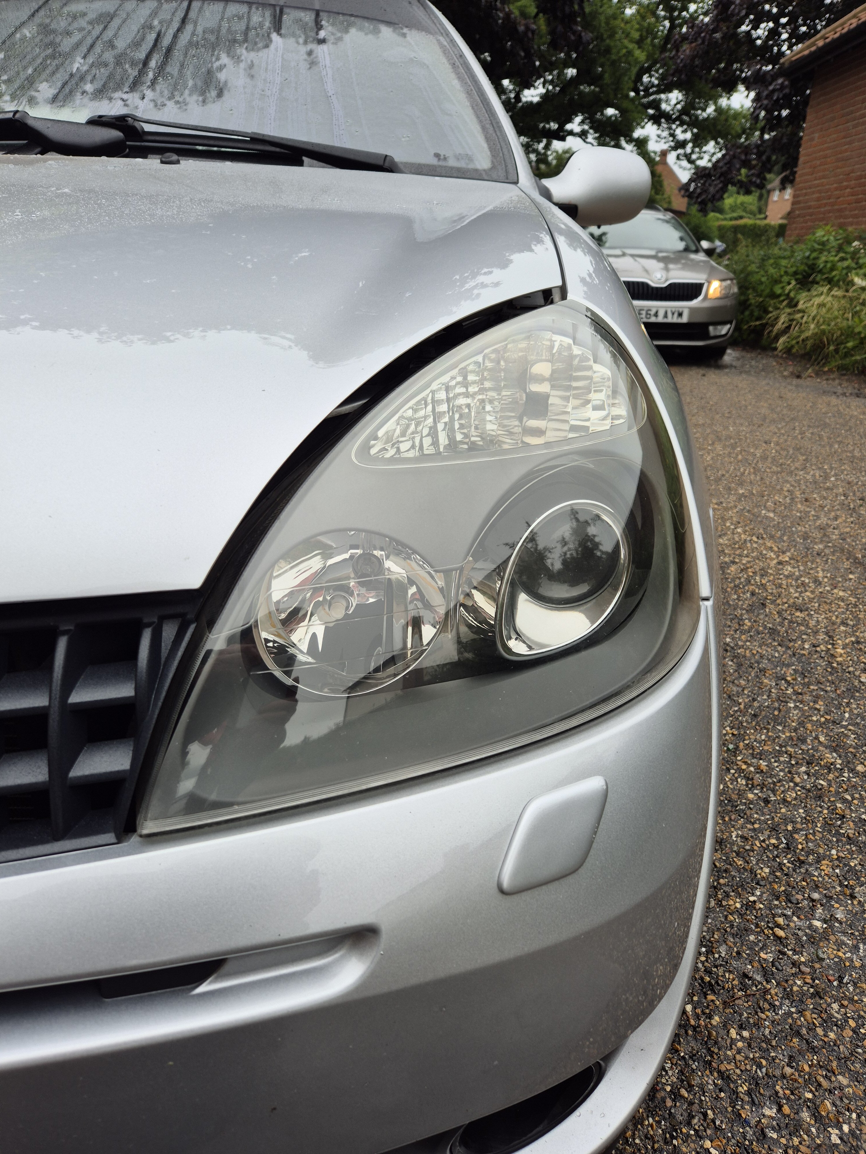

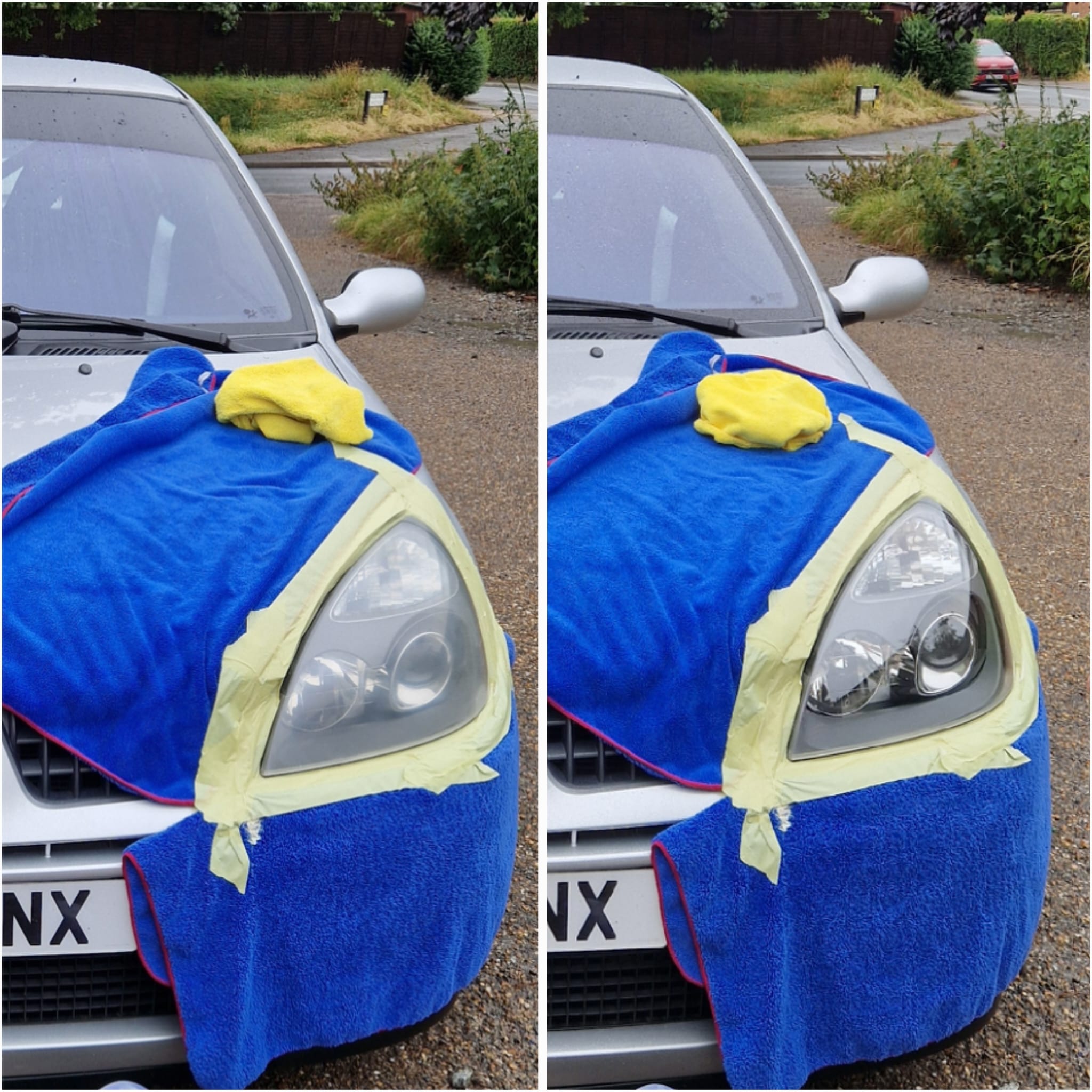

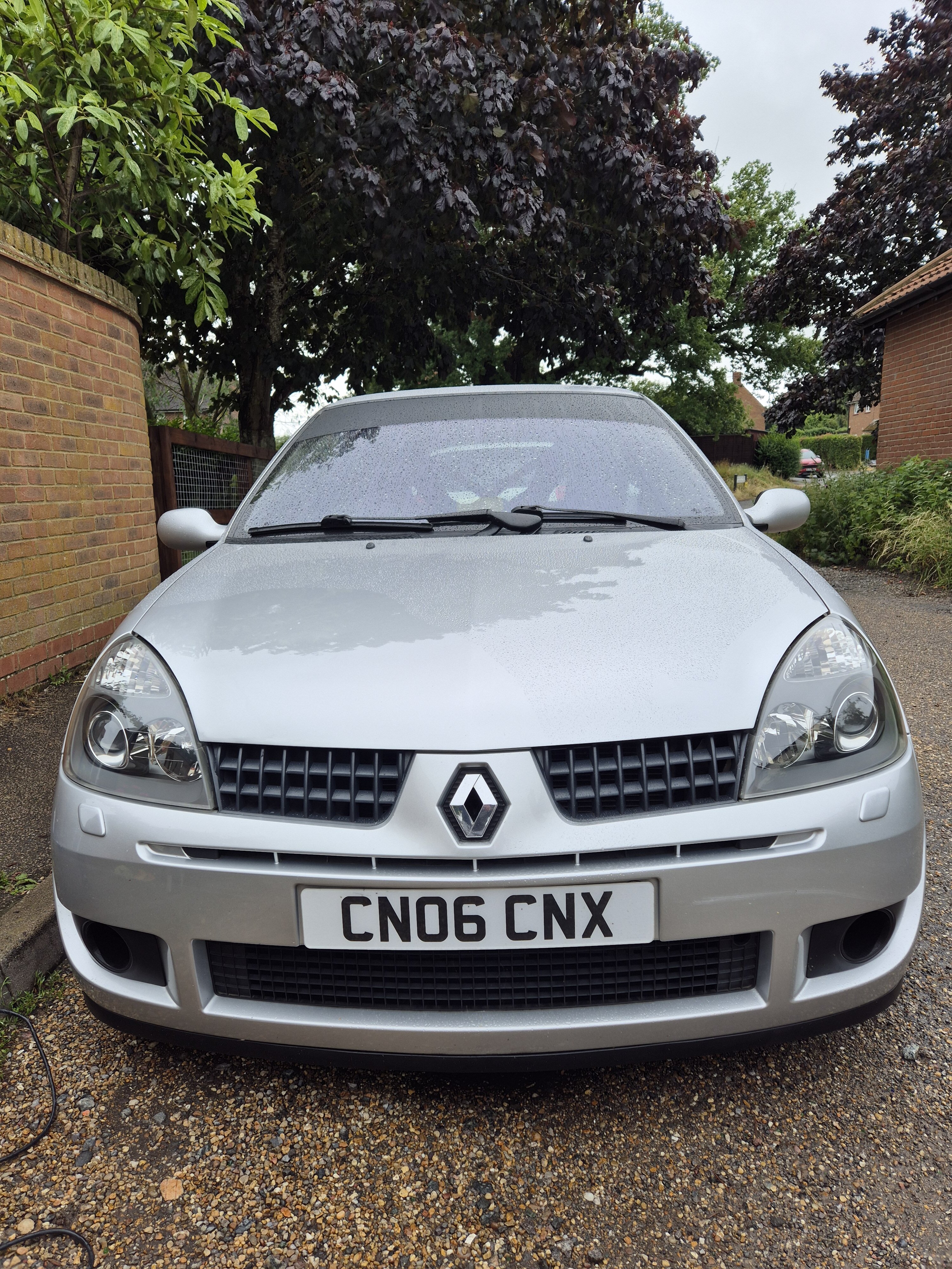

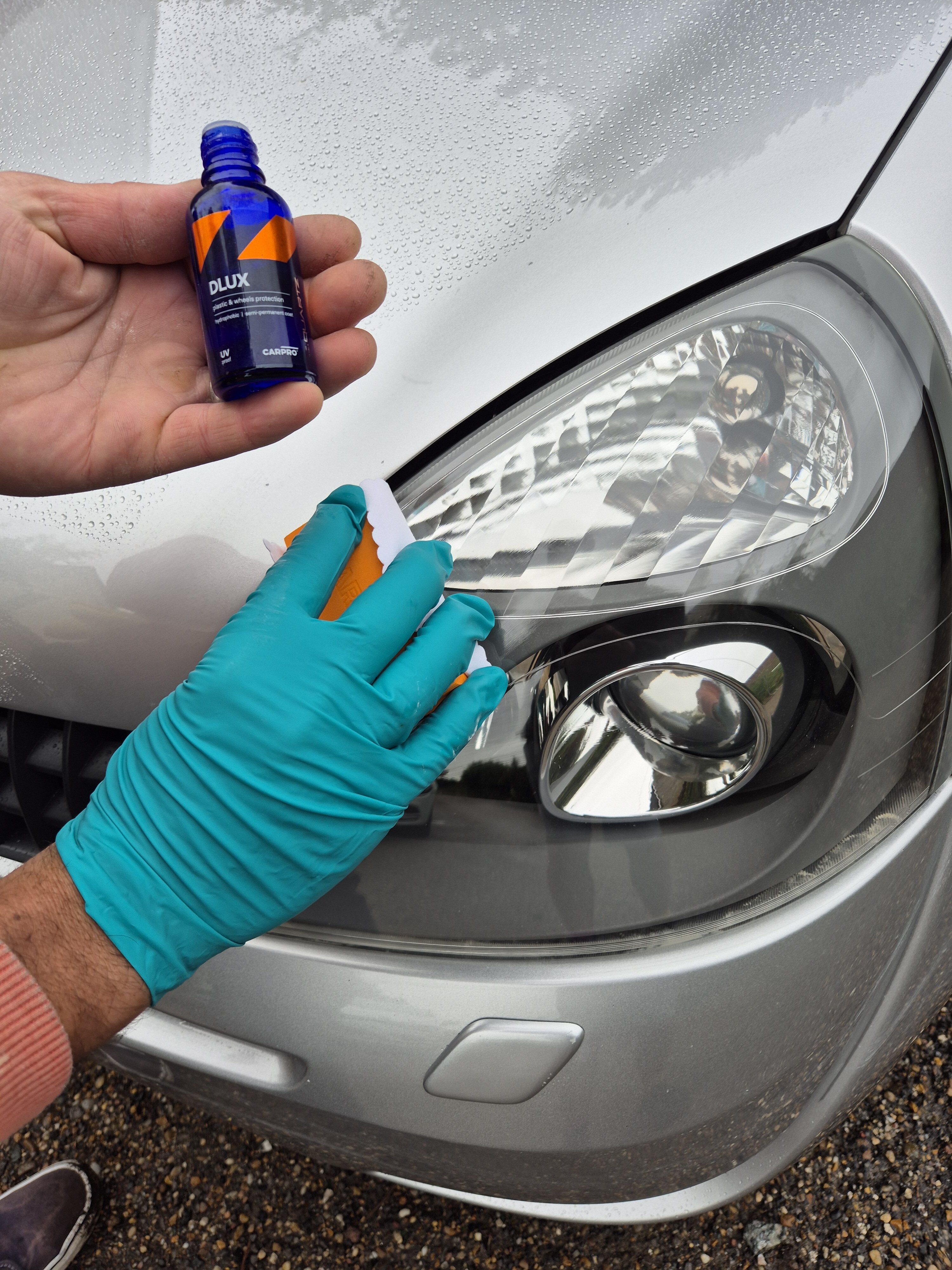

My headlights started to show signs of going a little bit yellow.So asked Mark @Jekyll if wouldnt mind restoring them again.There were in good condition considering last done 3 years ago to this month.As always Mark done a great job and protected again with a ceramic coating.
If you live about an hour away from Harlow and would like yours also done,drop Mark a message.

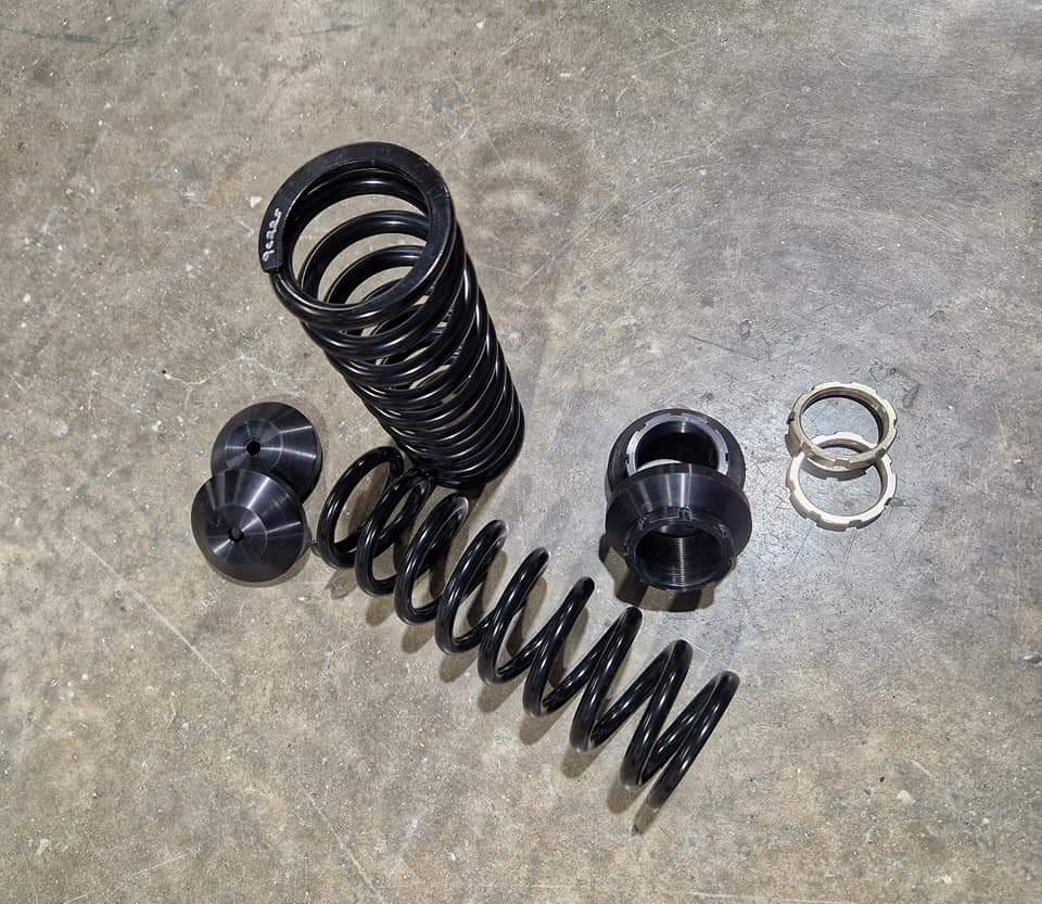

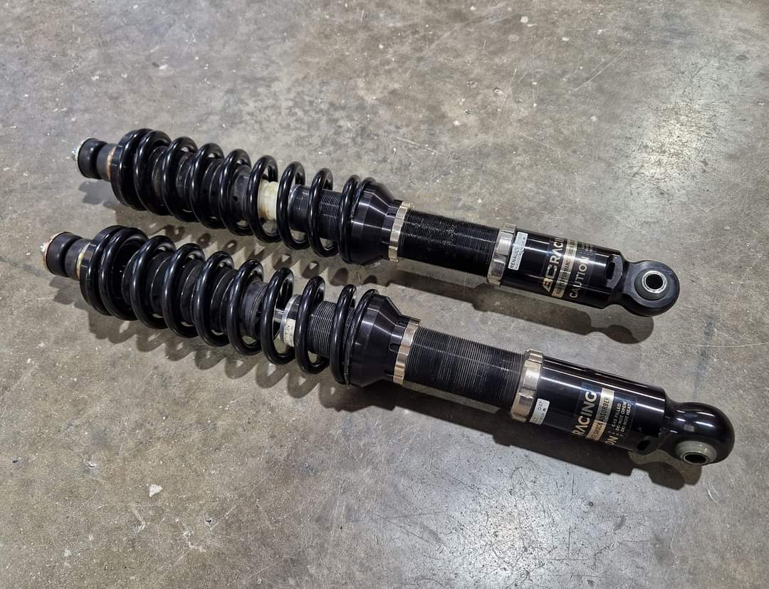

So bit of an update and change of things.Met up with @frayz during the week to catch up on things.Frayz kindly let me take out his well set up 182,it drivrs so well,funny thing is both of our cars are pretty identical with mods.Apart from his superb asts,which then got me thinking thats what im missing on my 182,also being my B14s are over 10 years old now.
After a lot of research and chatting to few other members,i spoke to BC which they recommended me what series and spring rate to go for.
So i orderded the BR series with 4.5kg Front and 6kg rears,which should work well just for fast road use.
I still have a PMS rarb in the shed to fit,but questioning if i actually need it along with the front pms strut brace and top mounts,as i just want it best suited to our B Roads in the uk.

I have been recommened to use 170lb springs with this conversion
170lbs is roughly 3 kg/mm so that’s half of what BC Racing recommended?
More compliant/comfortable for sure, but a bit more prone to understeer if you’re pushing on during cornering.
MrBlonde
More compliant/comfortable for sure, but a bit more prone to understeer if you’re pushing on.
Yeah it is,but the fella doing the conversion said about the rate.Because of the "That's where it gets complicated as there's a lever ratio to factor in on the rear axle"
Im not set on that rate yet,so would be good to see what others think.I know when mark got his,he put on 225lbs.But his bc's originaly came with 8kg rear springs.
I have the size i need to get,just need to work out the rate
Mr Underhill
Motion Ratio - Rob Boston was trying to explain this to me when he was setting mine up. Something about 182s having a lower than ‘1’ ratio due to the design of the axle. I confess i didn’t fully understand it, but nodded my head in agreement. 😂
