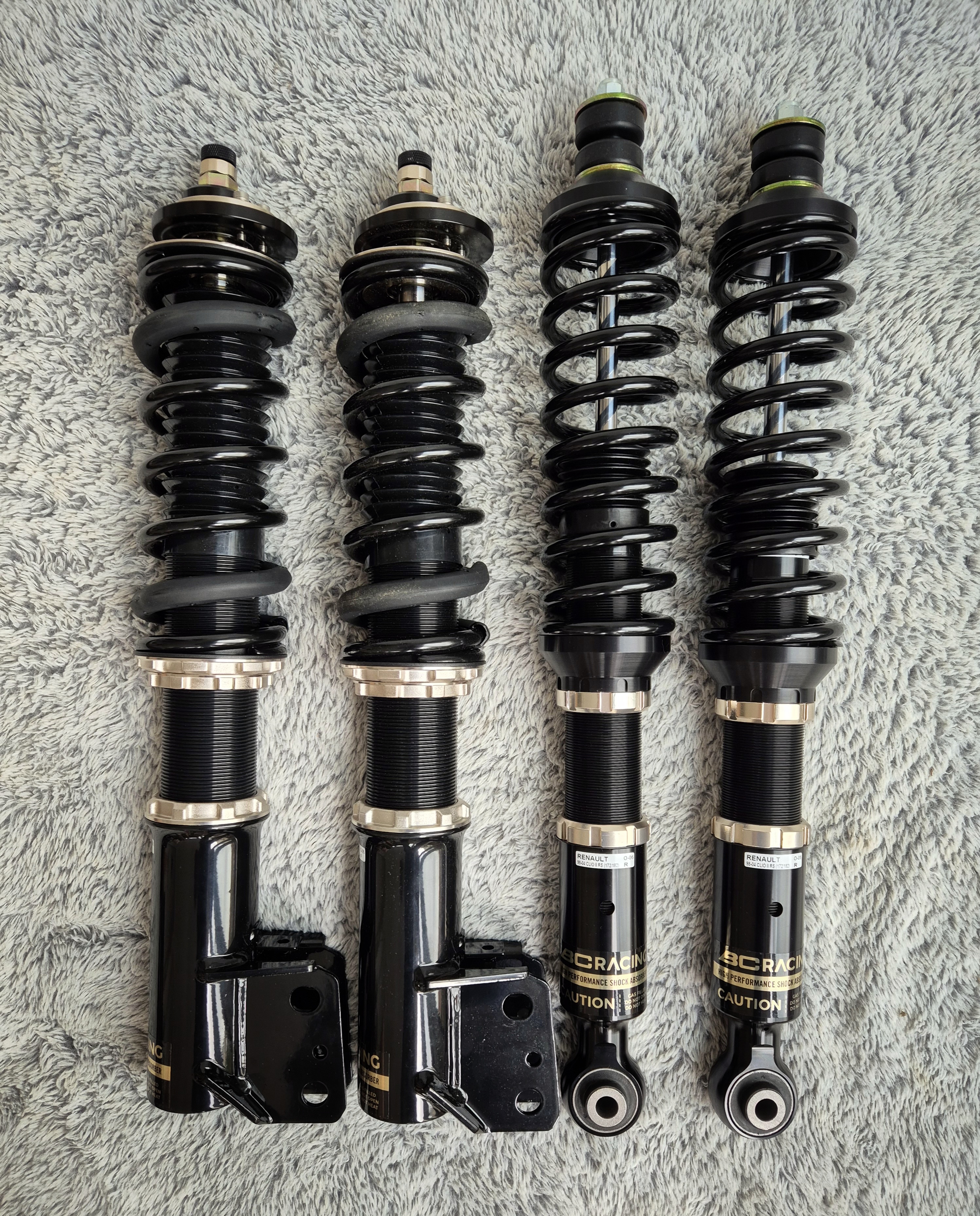

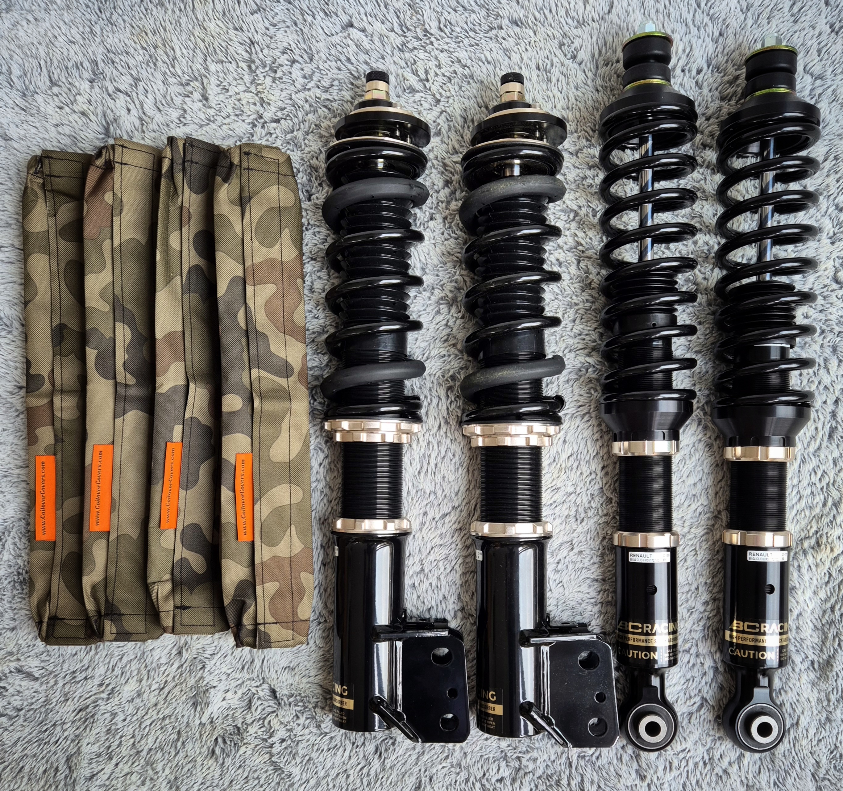

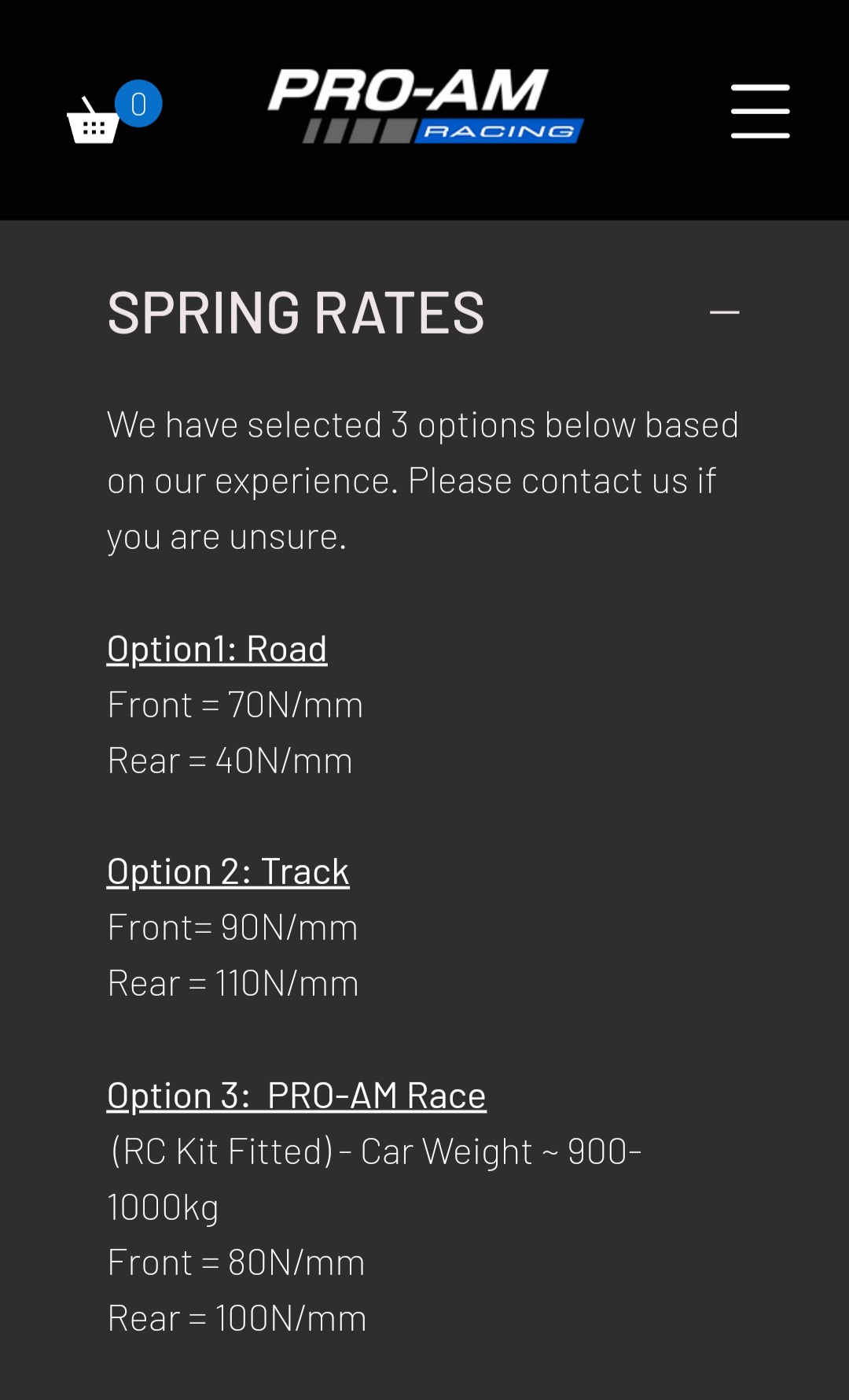

Sounds about right, I believe the ast road set is 70/40 nm or 4kg at the back.
AST told me they’d run equal or higher spring rates at the back on the 5100 series. That was for a fast road set up with occasional track use. I went for 70/70 nm (7kg/7kg) but found them a bit too hard for daily use. Now they’re purely used for track, I’m on 9kg F and 100 kg rear. It’s superb.
Ah not sure then, they probably do different kits. I've got 70/40 ( I believe 😂), the same as the kit Pro Am are selling and think @frayz runs the same on his.
Works well enough either way and didn't feel any softer than the grams springs I had before.
Pro-am run 70 F 90 R. They used to run 90 F 110 R.
This kit is 70/40 as well, or are we talking about different kits?

Yep the fronts should be set from factory.But as ive done a full conversion on the rear,just something i questioned to myself.But i think they dont need to be,just in place so there just tight with no play.
Nice. 3D printed or did you buy the base caps off the shelf? Genuine Evo Corse caps aren't cheap and aren't particularly attractive imo, so looking for other options that fit the X3MA.
So the Bc's have been on a couple of weeks now with no problems,i just need to dial in the damper settings.But not to worried at the moment as it will need alignment and will get Alex to corner weight it also at the same time.

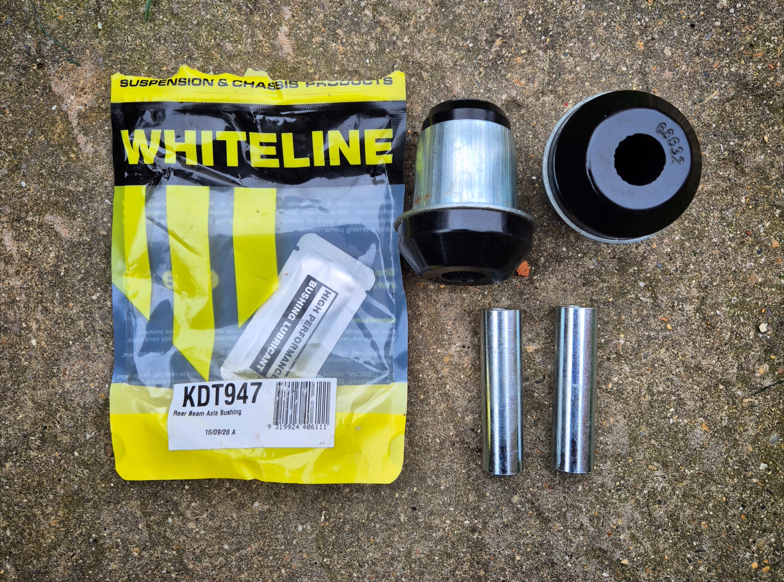

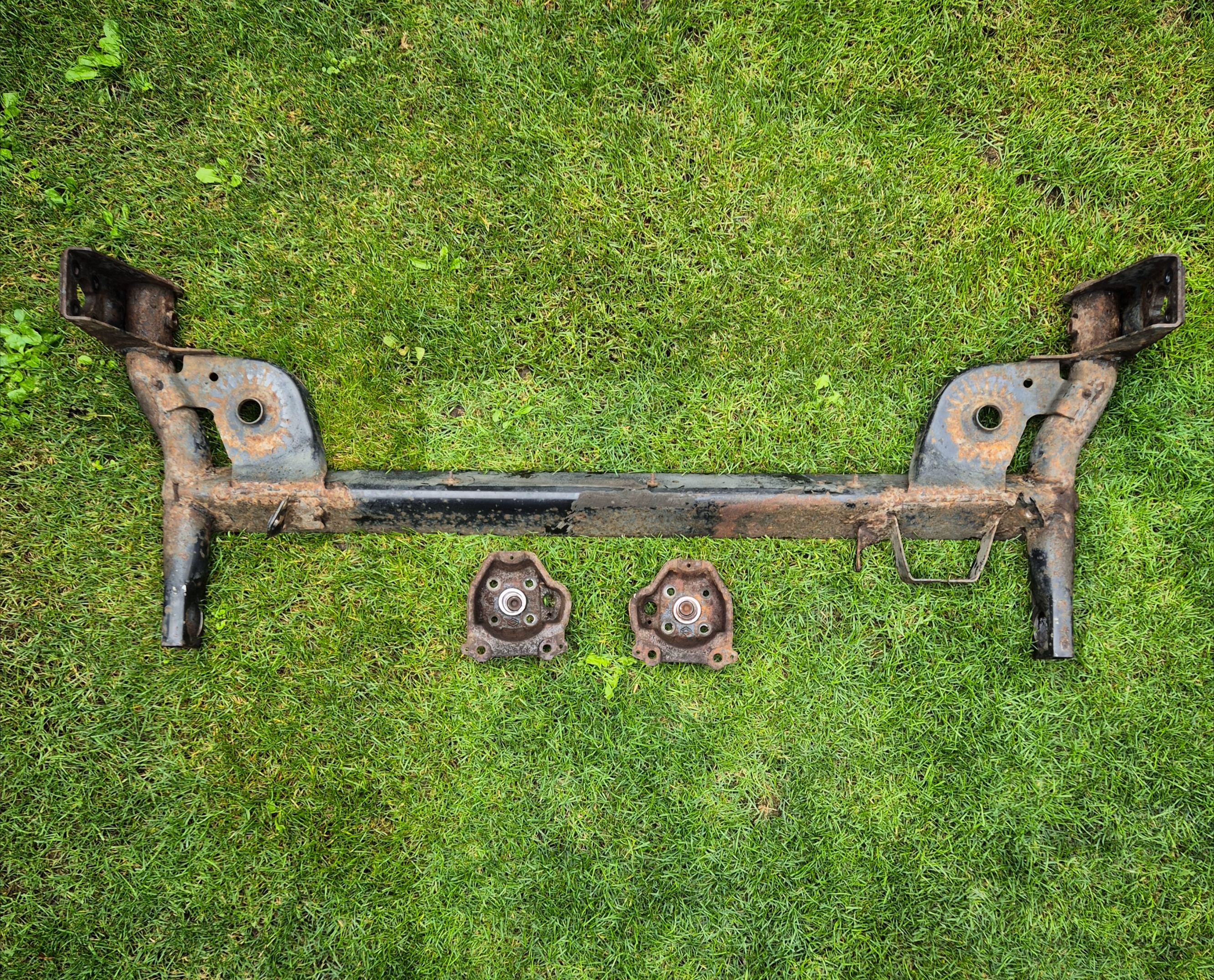

I Have also started on the refurb of the spare rear beam i have.I have split it down ready to be blasted then powder coated.Also bought whiteline bushes.
While the old beam is off,i will tackle to tidy up the underneath with treating/sanding/grinding back any rust etc and a decent clean then treat with bilt hamber products along with stoneguard.
Any advice tips on the removing/fitting the rear beam?.
Also with treating the underneath?.

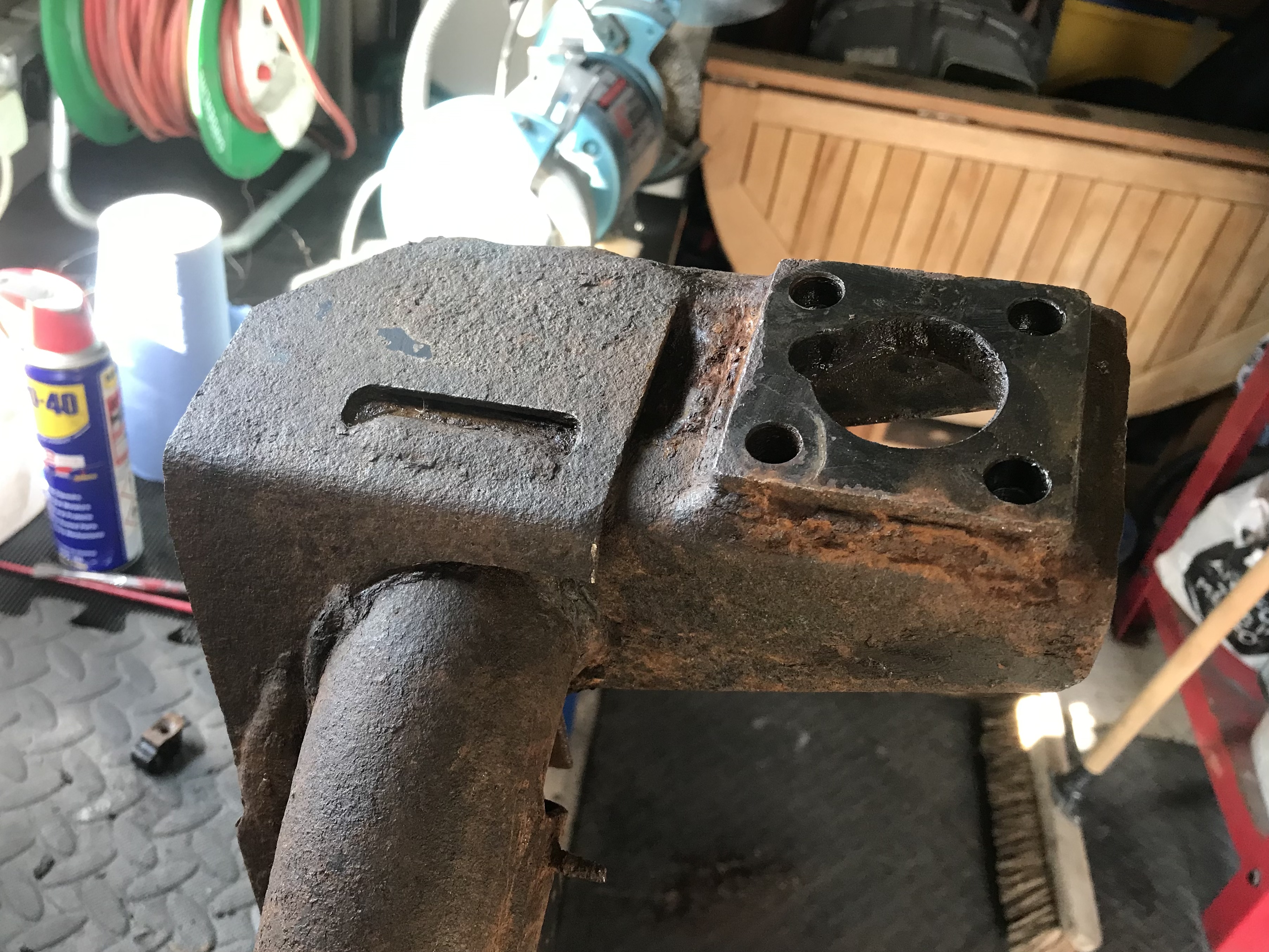

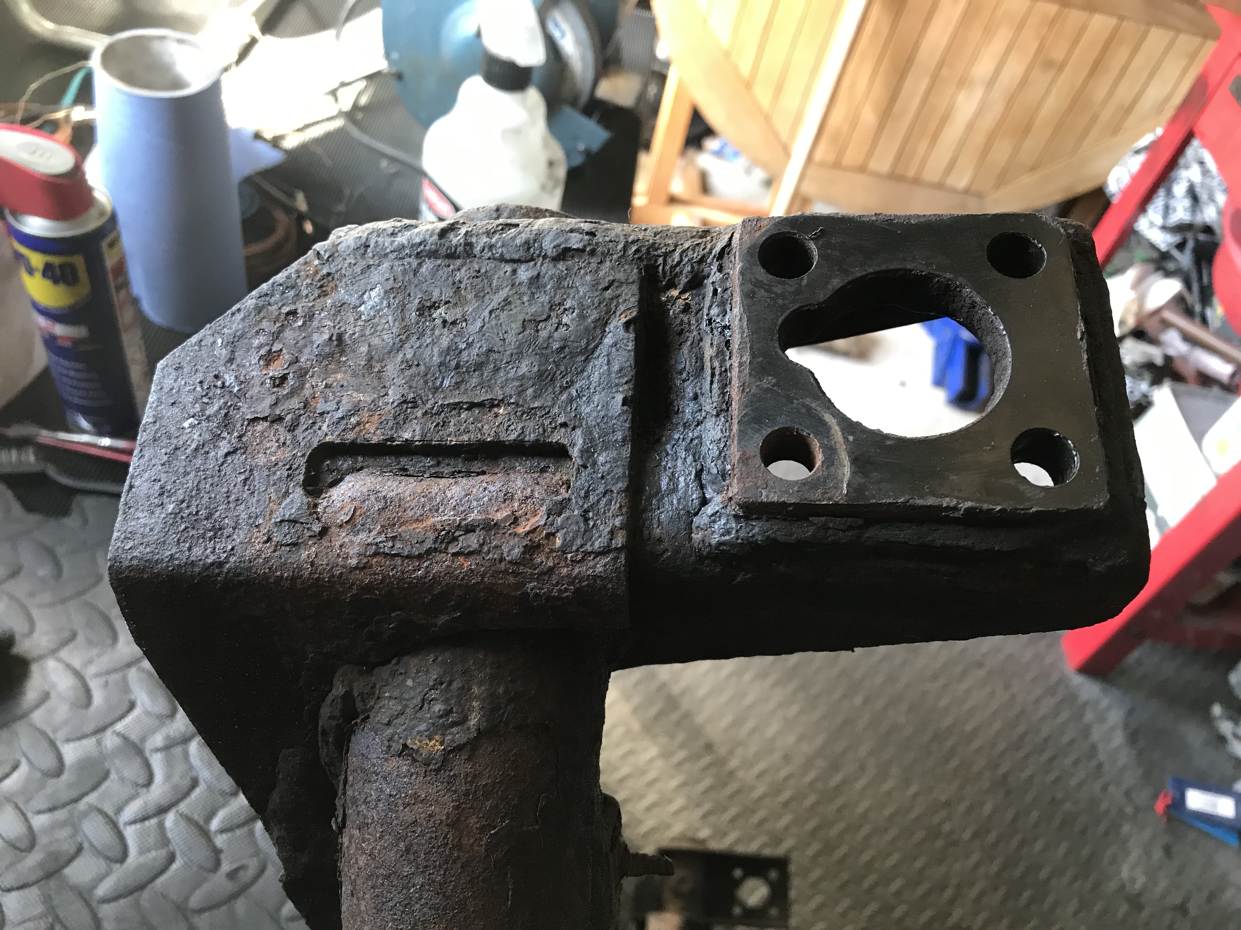

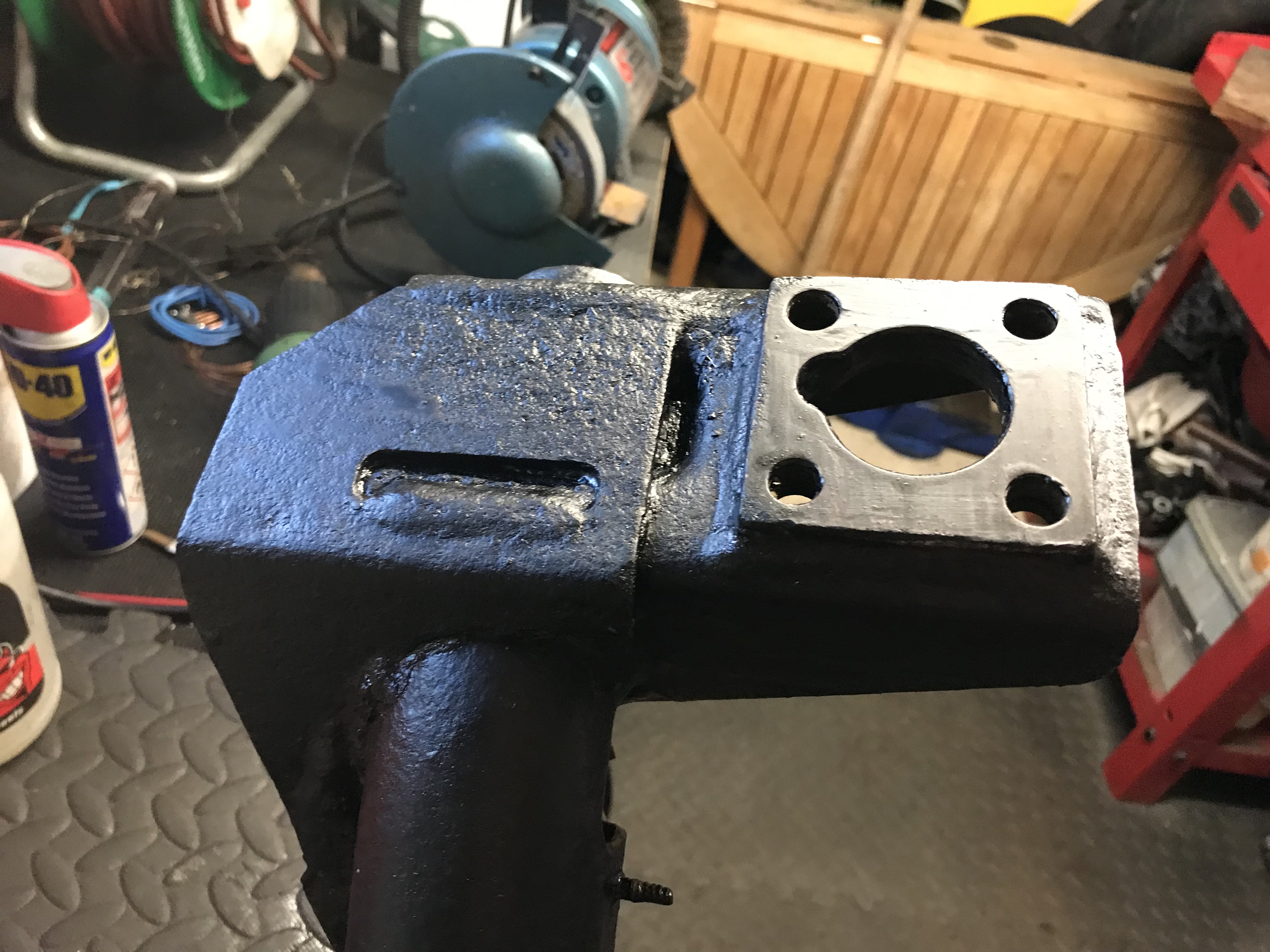

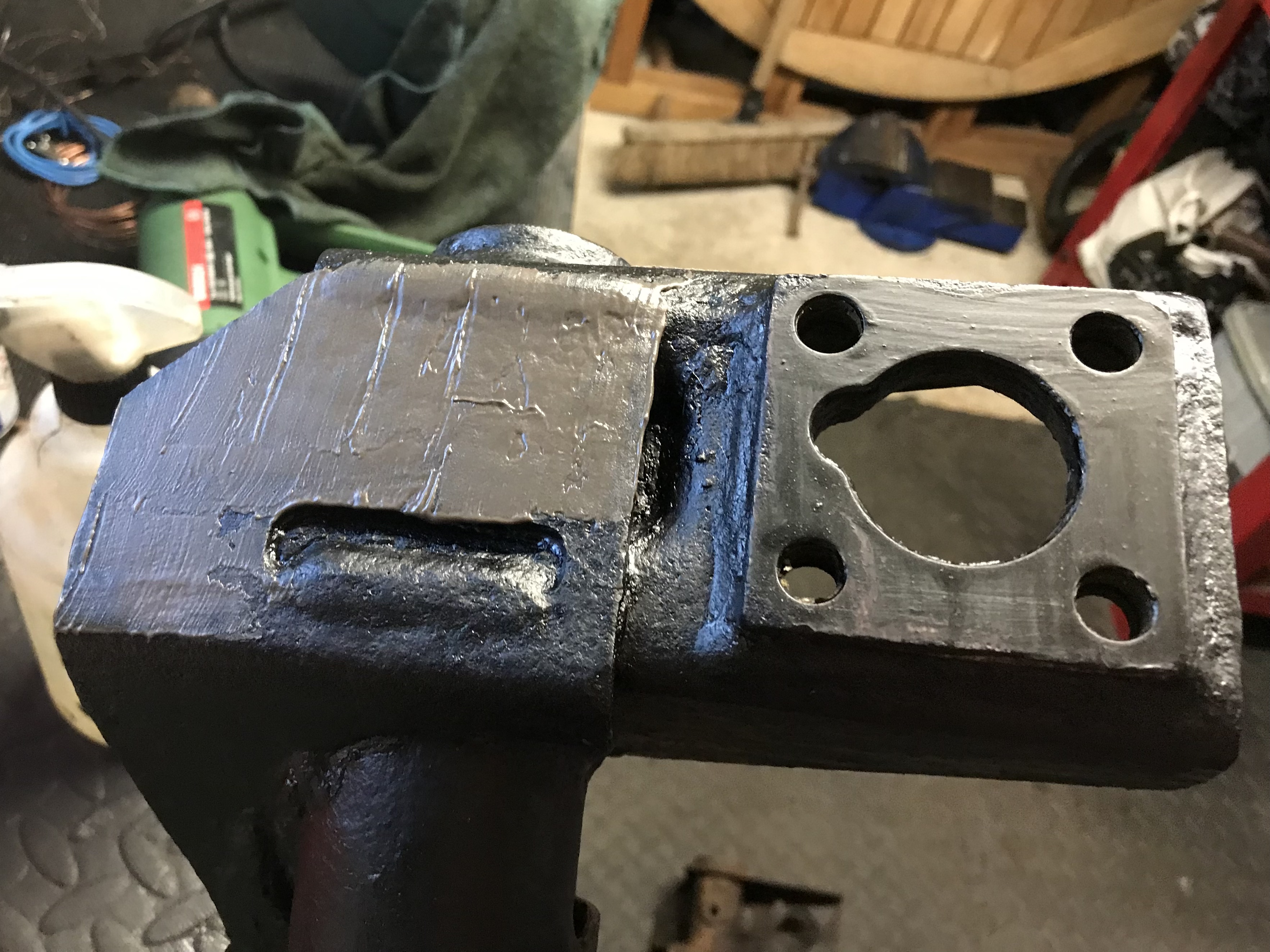

Back on the rear beam testing an area before plunging into the full restoration.
The beam’s pretty crusty so I removed all the crud with my small hammer, then gave it a wirebrush.

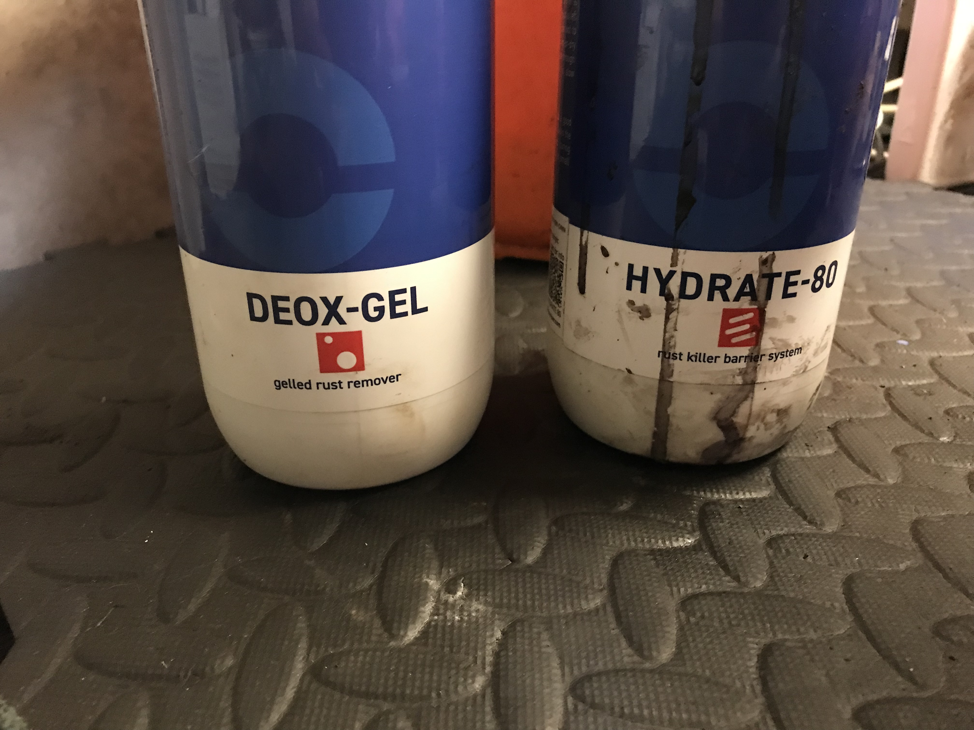

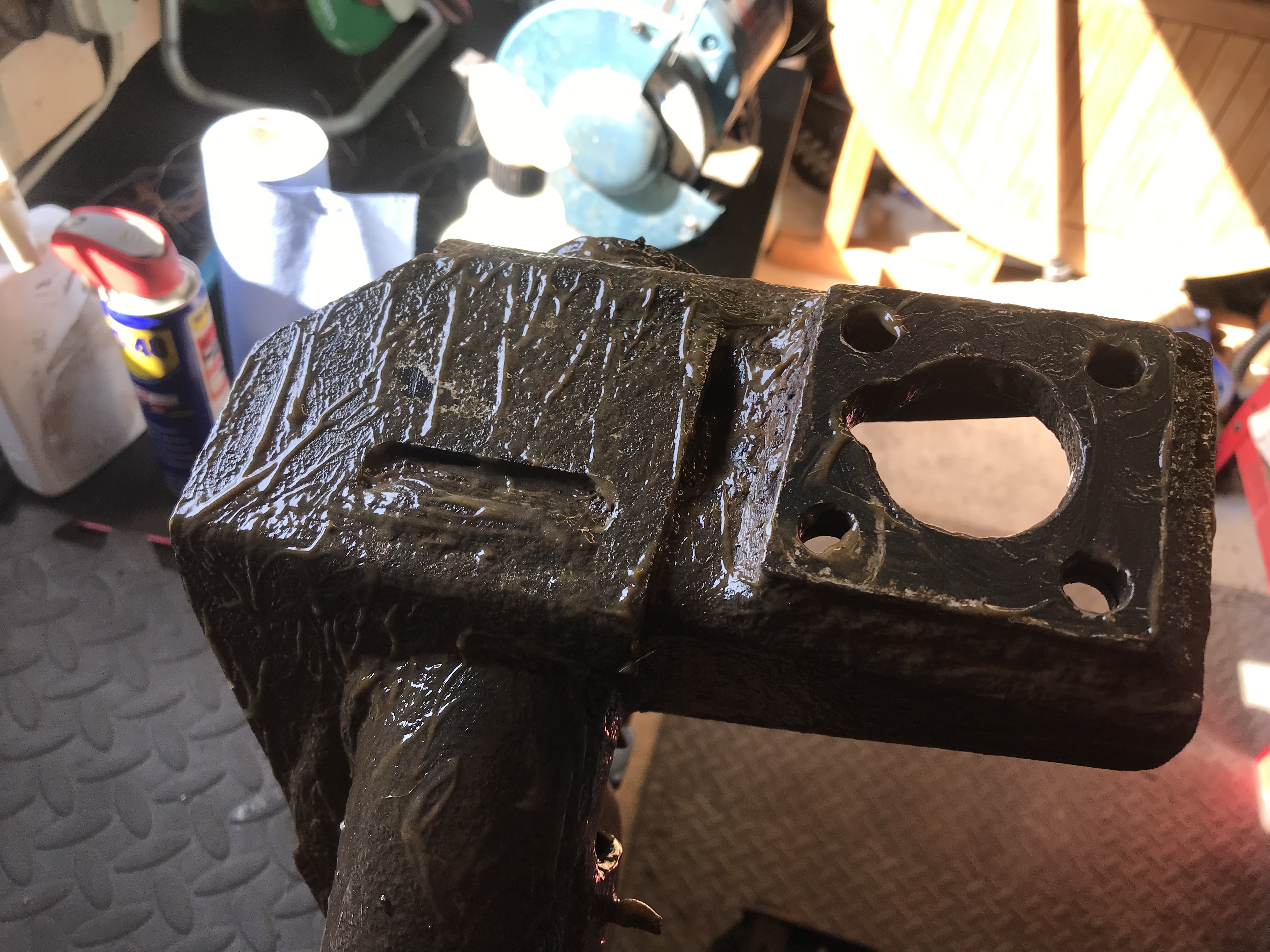

Degreased the area with Bilt Hamber’s excellent Surfex-HD, then washed any residue with warm water.

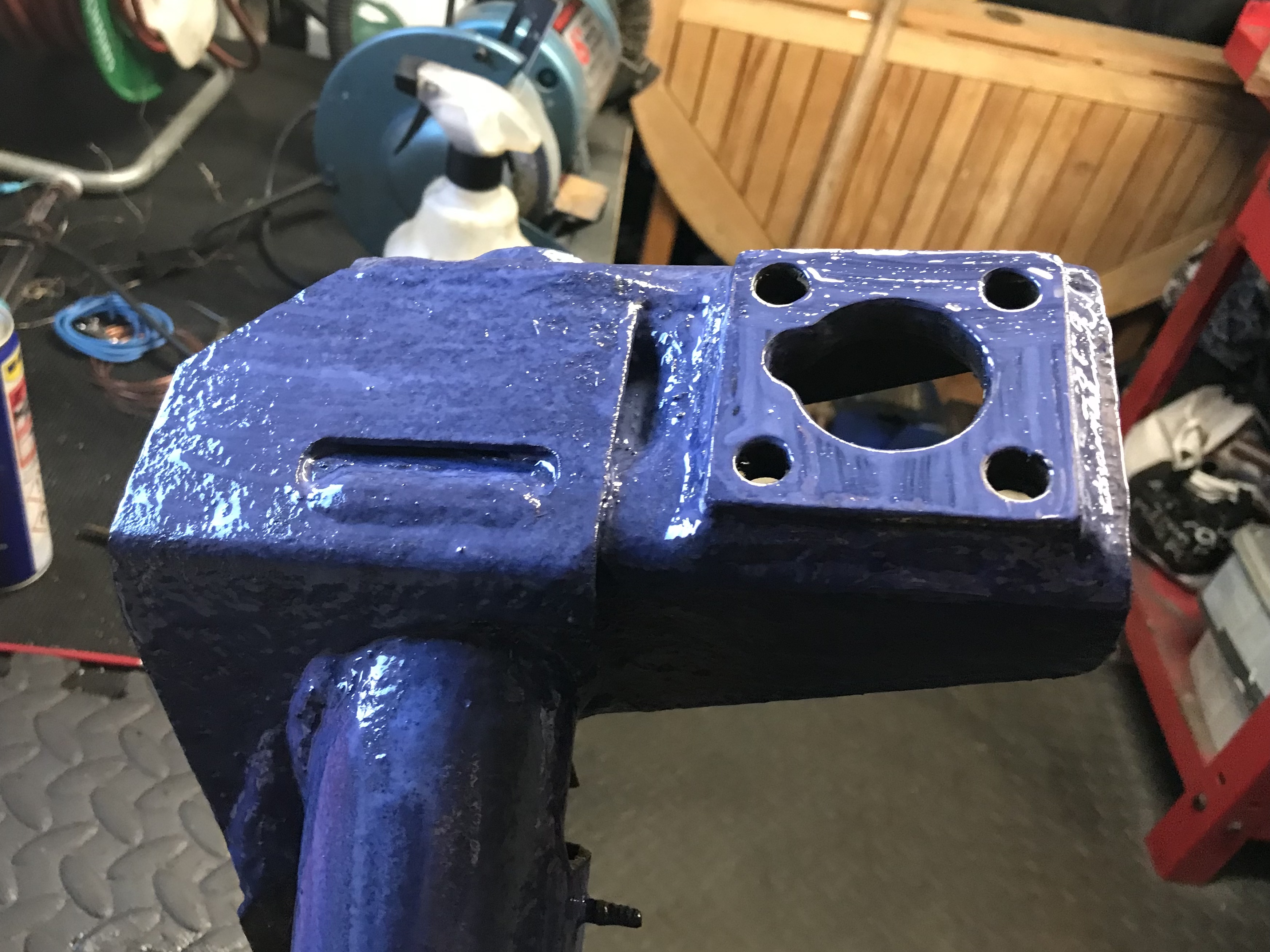

Applied a coating of Bilt Hamber’s DEOX-GEL with a brush then agitated this into the steel with a small wirebrush to keep the coating even.

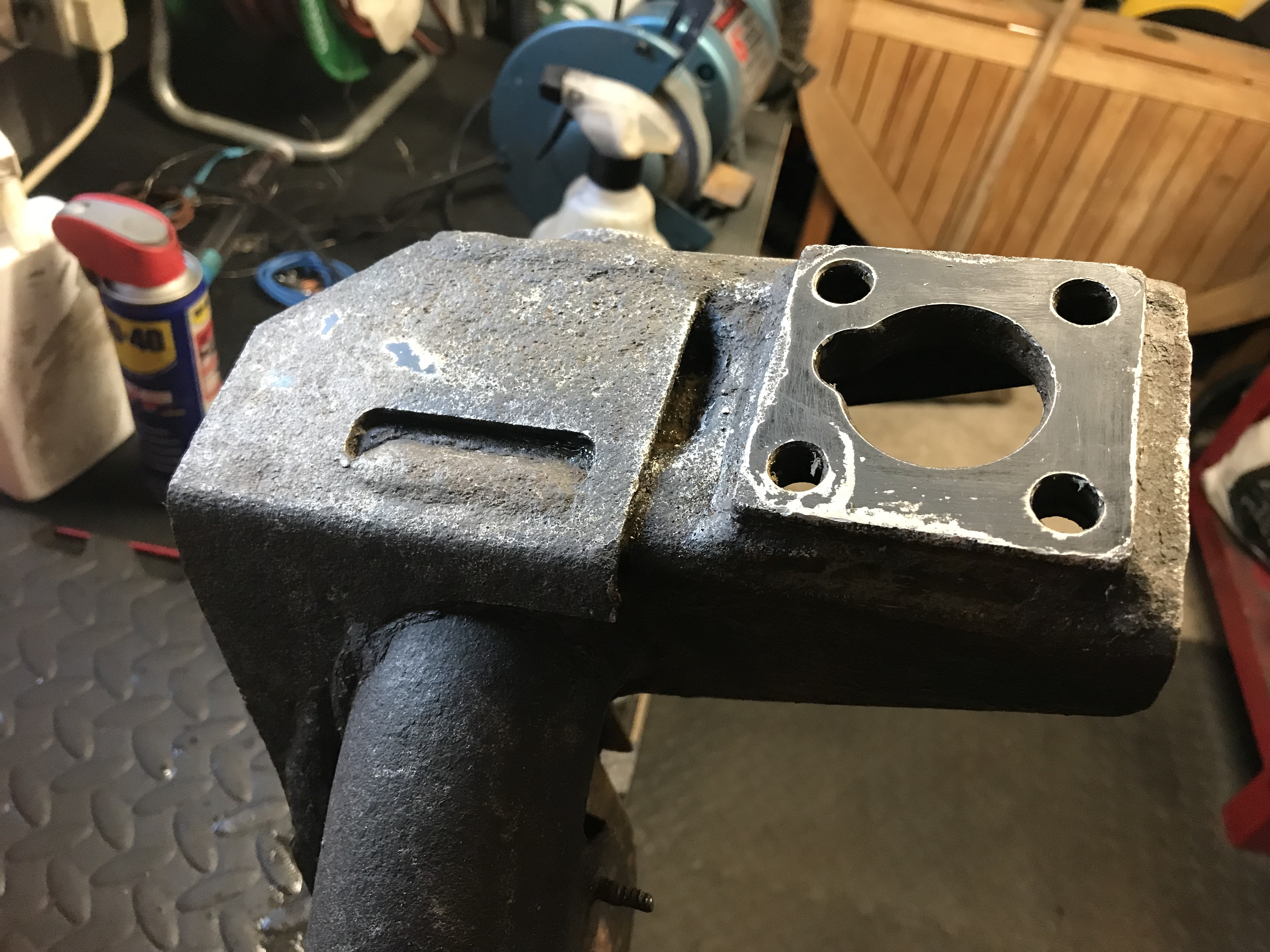

A few hours later the rust had pretty much gone although pitting is pretty heavy in places.
View attachment 1555074View attachment 1555075

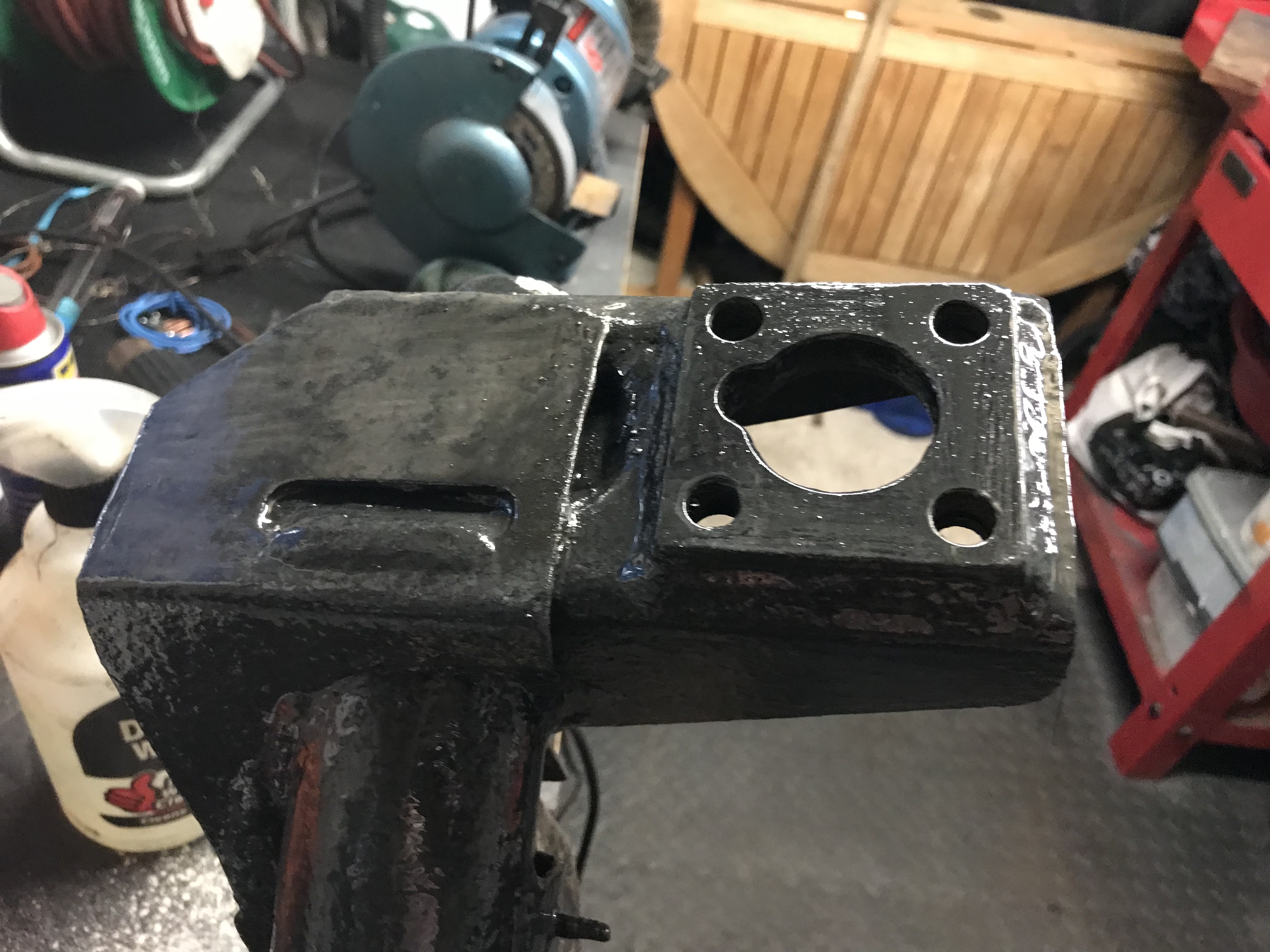

Next up is a good coating of Bilt Hamber’s Hydrate-80 which will convert the rust and leave a nice coating over the steel. Starts out Blue and ends up a nice rich Black.
View attachment 1555076View attachment 1555077

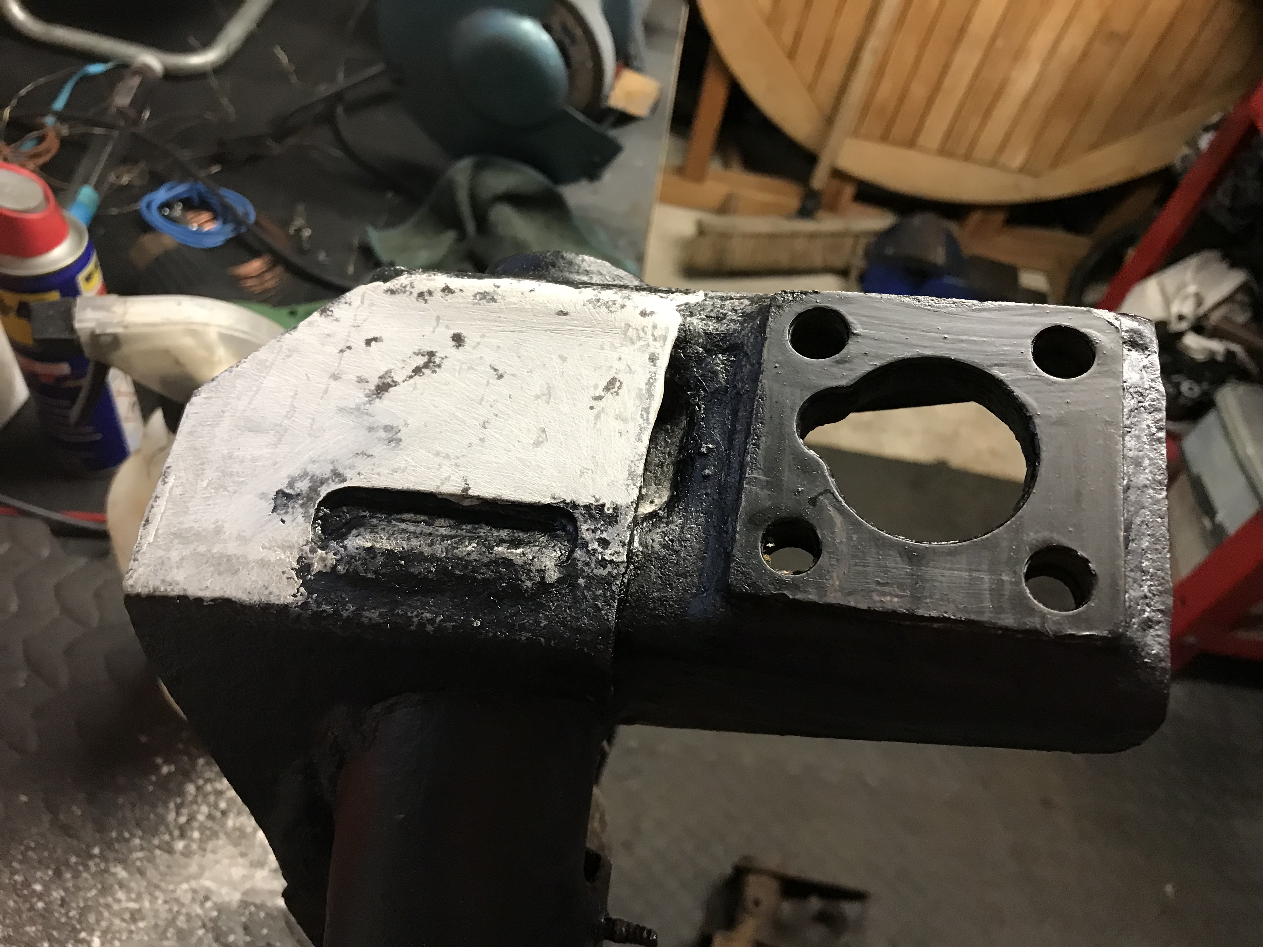

Any heavy pitting is treated to a touch of plastic filler, then rubbed down and then coated with Bilt Hamber’s Electrox zinc primer.
View attachment 1555078View attachment 1555079
Once dry I’ll go over the beam with a few coats of primer and final top coat.
I know people will be thinking, just take it to get powder coated, but in my experience it never lasts that long and rust starts coming through.
I think part of the reason is there’s a time delay between sandblasting and getting the steel into powder coating. So effectively they’re powder coating over steel that’s already started corroding. And it’s probably not commercially viable unless you’re in the restoration business.
Something I'll need to do at some point as well. Need to sort a spare rear beam first though! Where did you get yours?
I would just use this as a step by step guide with pictures 👌
I bought it ages ago from someone on facebook i think if i can remember.Luckly i can shot blast it and powder coat it at work.Job to do over autumn

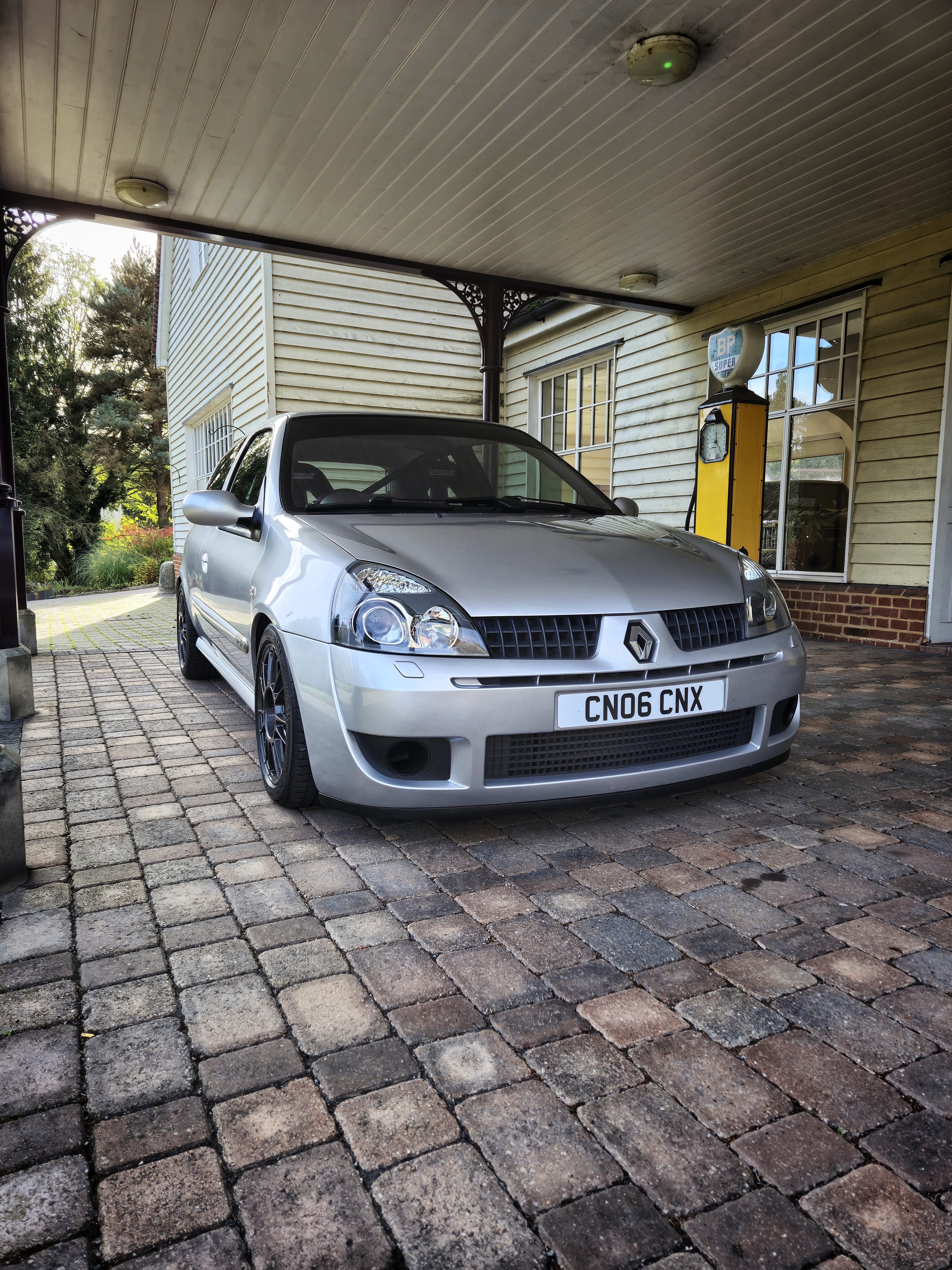

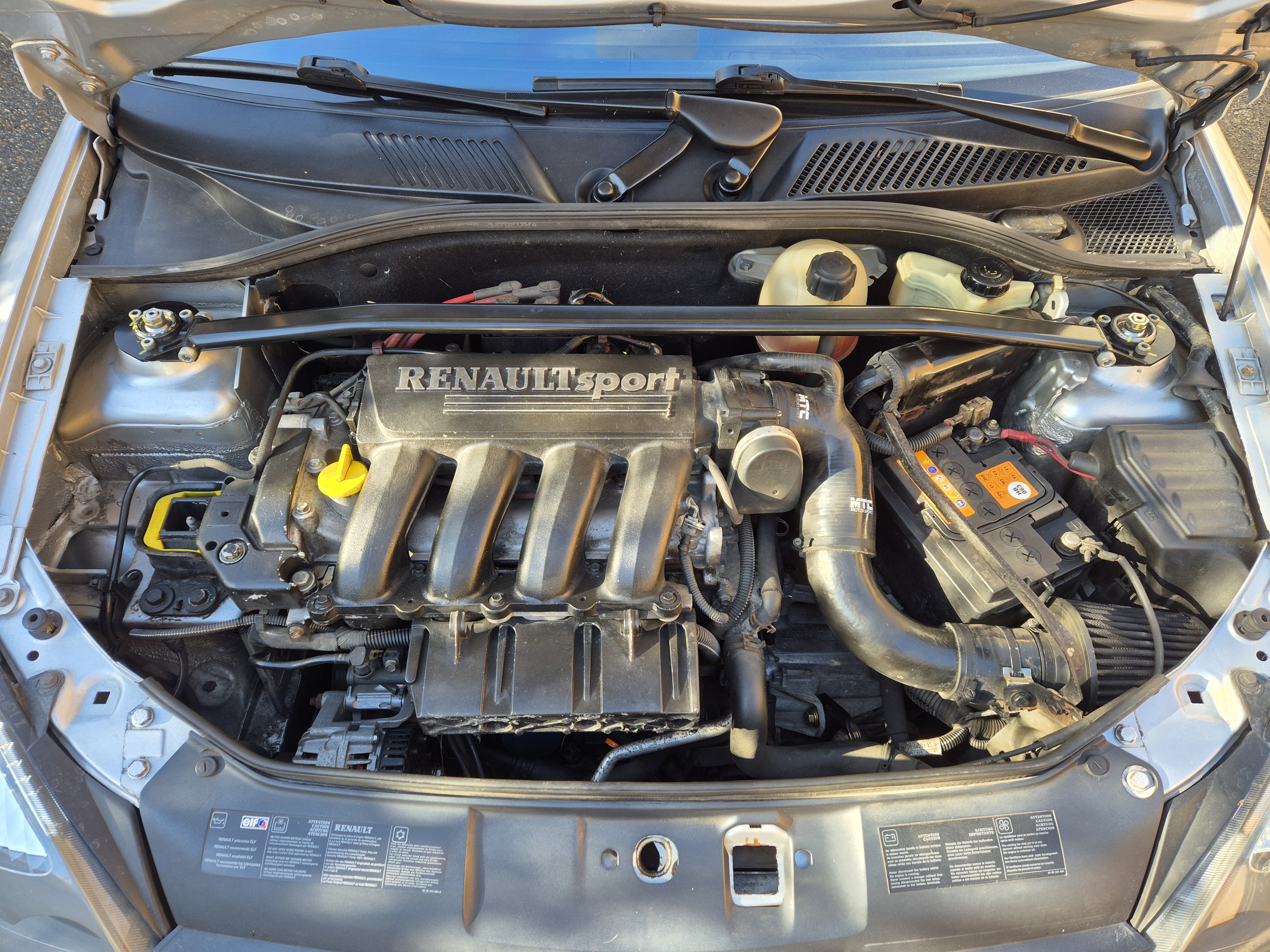

Went out for a little drive today being a nice sunny day.First time ive taken the clio out since having all that work done and drives great!.

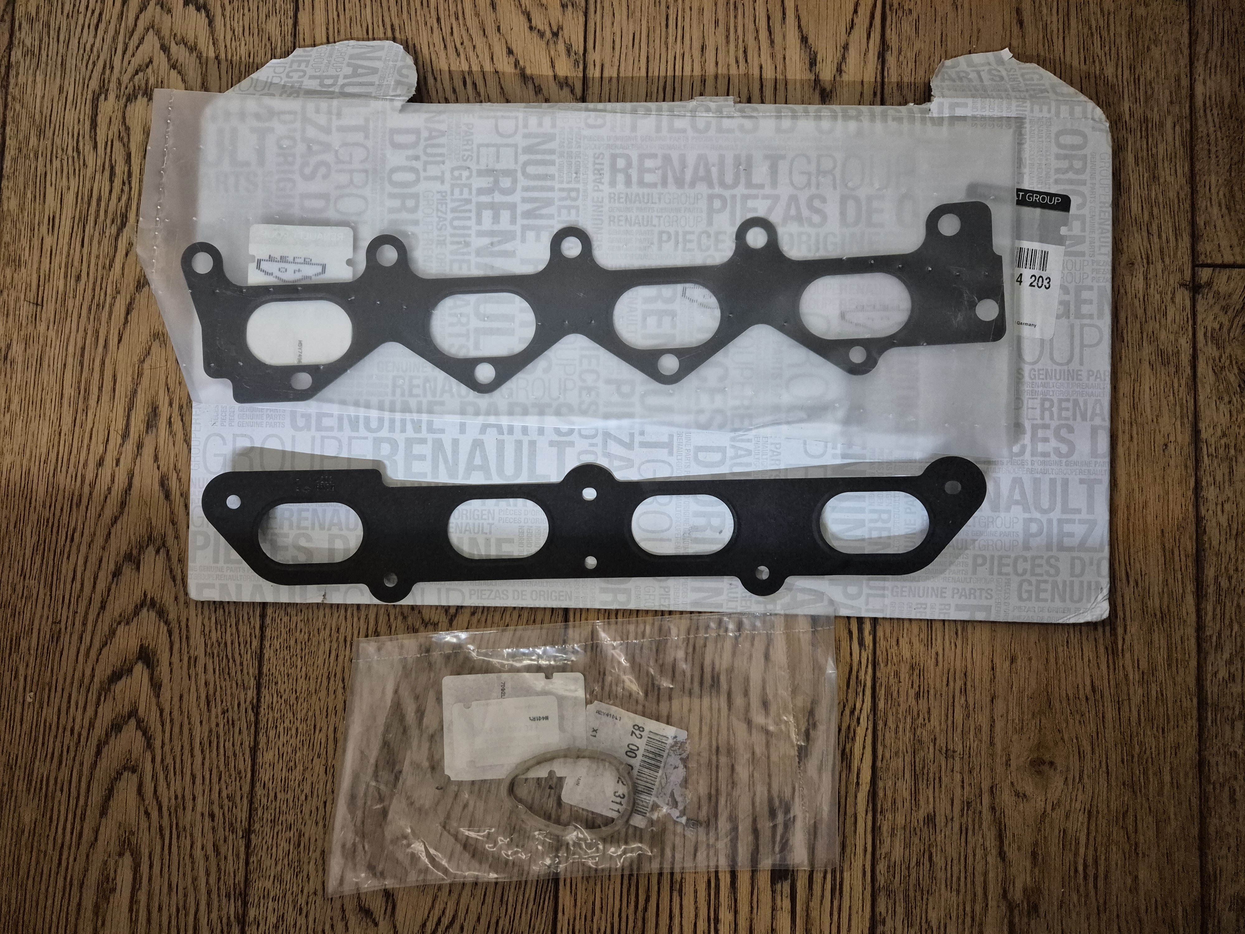

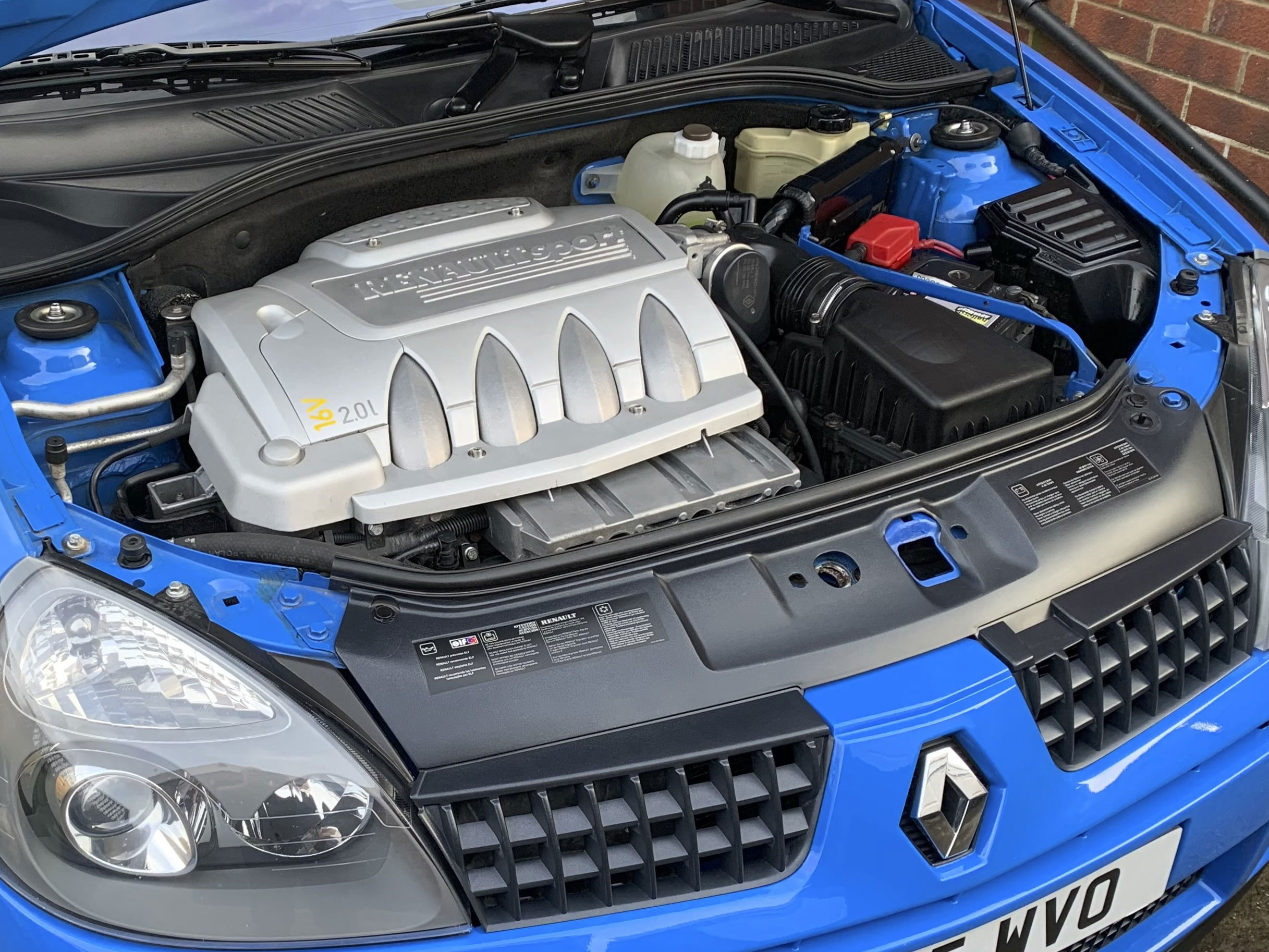

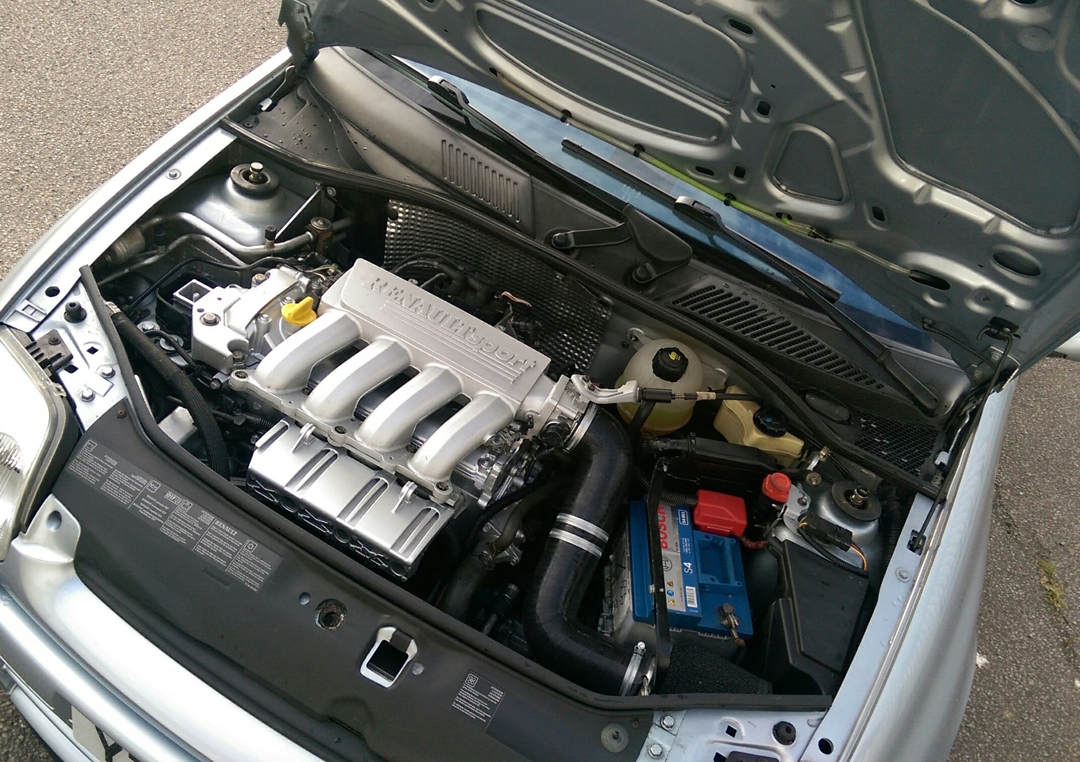

Along with doing the rear beam and underside i will be giving the engine bay a freshen up.
•Nimbus along the bulkhead and brake res
•New HT leads
•New spark plugs
•New inlet gaskets
I will paint both inlets,crash bar that covers injectors,engine mount cam cover area and ecu cover

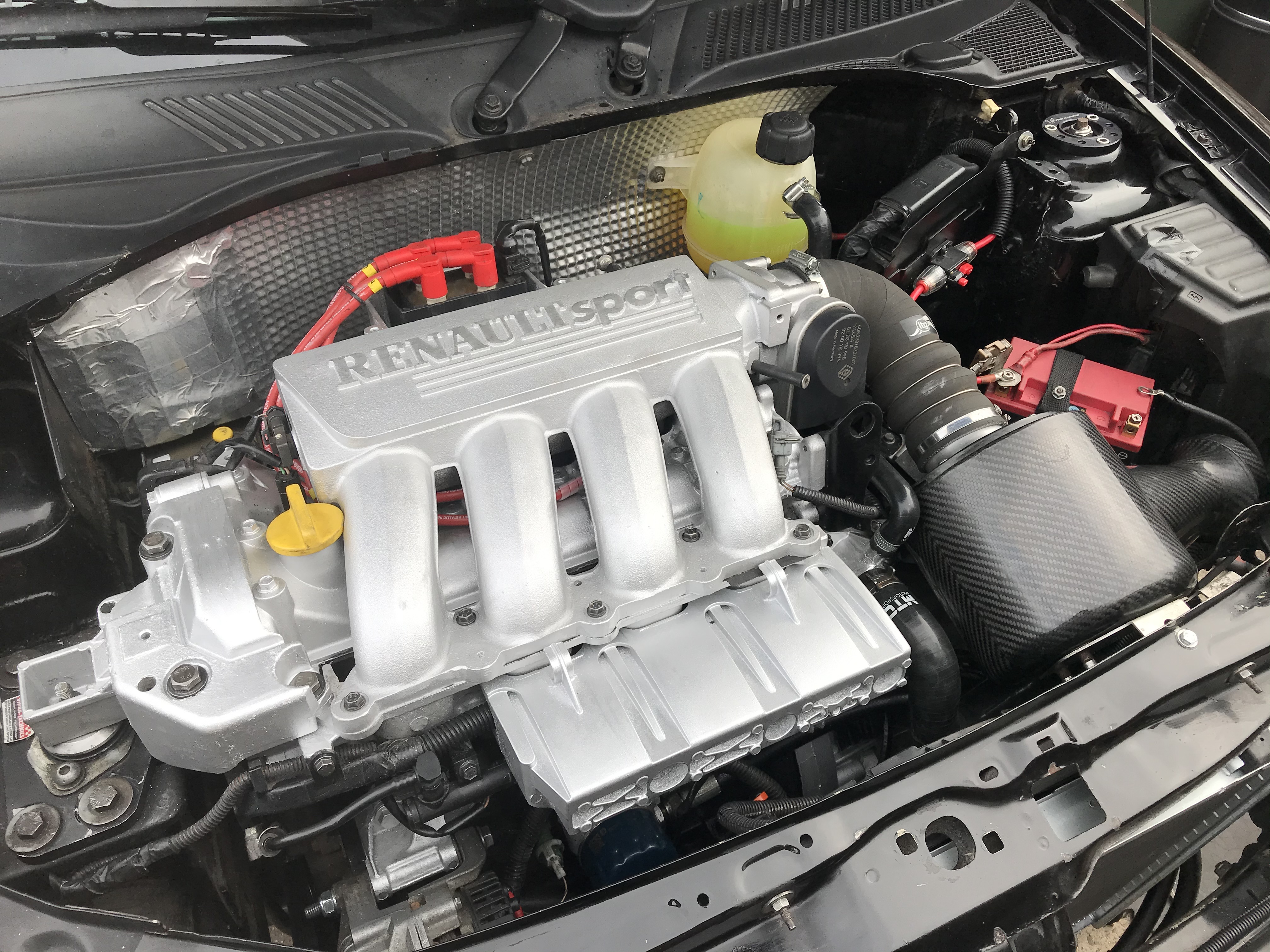

Engine is now leak free after seals,sump gasket done.Its just tried looking and bit dusty etc.
Thinking to do all parts silver or in satin black or even an anthracite.
Photos of others engine bays would be great to see what others have done with colours,nimbus etc

Started on rebuilding the spare rear beam and once done i was planning on fitting the PMS rear arb i have along with the whiteline poly bushes.
My question is,is it worth fitting the rear arb when im going to have the clio corner weighed just for road use?.as i know the whiteline rarb is an easy fit and to take off,where the pms is not if i decided i dont want it on after fitting.
Personally I much preferred the design and location of the PMS bar. The Whiteline always looks like a cheap afterthought IMO.
Just my thoughts, entirely your choice mate.
The WL is certainly much easier to remove at a later date.
Maybe ask yourself what you want from the car and if you feel you need it anyway?
If you’re rebuilding a rear beam, why not get the PMS strengthening plates welded in first and it’s likely that will stiffen the beam enough to negate the need for either ARB.
Yep the pms is much better kit but,more agg to remove if i dont want it on anymore.But the plates have crossed my mind,so may look into that and just sell the pms arb.
Or once corner weighed that maybe good enough for me for on the road and not have a rear arb at all.
