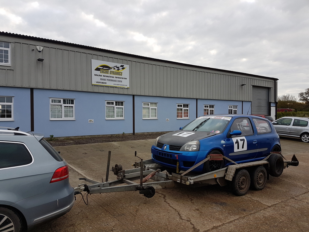

Just had to write a "I'm sorry" email to Andy at Engine Dynamics as he has had a look at the map on #17 and as I read his email to me could imagine the "like what the actual xxx" when he was looking at the map put on by the original engine builder #1.
He is fitting me in as I said it needs re mapping after an re build, turns out the map is so bad it needs re doing from scratch. Not Ideal for a busy business.
Wasn't until I wrote my reply that I noticed that the only part re used in this recent refresh is the head, just lol'ing all over now.
Even the pistons, which engine builder #2 said were fine and for which I sourced £280 new rings for, engine builder #3(Beaniesport) said that the pistons where complete garbage.

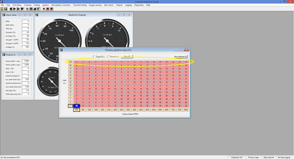

Still undecided whether to post Andy's and my emails or not. I'll post the map pic for now see who can see what's 1 of the issues with it.
If it's what I'm thinking it is, then f**king lol!! That's not even a bad map, that's a f**king disgrace.
@NorthloopCup something along the lines of;
"appears the static timing has not been set correctly as looking at the Ignition table the advance is extremely low (see pic), actually less than you would see in a turbo setup! We should be seeing numbers in the early to late twenty’s as rough indication at 100% throttle. Simply this means we are not getting the numbers input into the table as TDC is actually x amount of degrees out. This also affects the injection timing."

Yeah it is what I thought I was looking at then unfortunately Pete.
Give ED a chance to map the engine and see what it makes mate I say. Ultimately, a mapped f4r making good power is worth more like that, than one in kit form. Just thinking that at least you can still break it if you get it back and have no love for it.
It almost looks as though someone's just installed a map to get the engine running.
So it's purely map related?
No, Found out from engine builder #1 that he put on 3-4 degrees advance timing on the inlet cam - which explains the poor running to a certain extent as now the timing has been set to std.
ED are going to check the compression, timing and go from there - glad I really didn't just book a mapping session now.

#17; Never easy is it.....Andy, from Engine Dynamics had, had enough, problem after problem so picked up on the 5th June and took back to Beaniesports (230 mile ferry trip for me) for final resolution. I had another hefty bill from ED (which was expected after the emails received for work being completed fixing etc) and #17 got no where near to be mapped, things just didn't go right from the off. Fair play to Andy as I think the bill could've been a lot more had he put all the time spent on it. Chris from Beaniesport has said the next call I'll receive #17 will be mapped and ready for the track - all bar a spanner check etc.

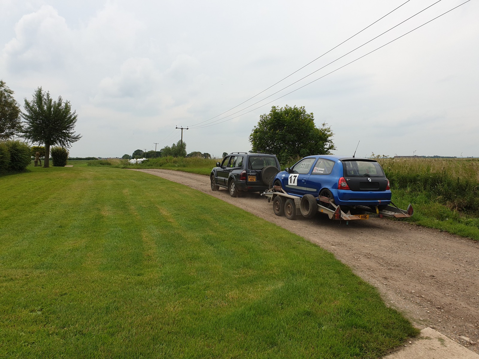

I'm taking the picture and it say's it all, literally deflated by the whole situation brought on by false hope and promises that lead to one disappointment after another. A can do attitude just doesn't cut it - it you can't deliver whether that be on a time scale or ability then say no, don't take the job on.
Andy from Engine Dynamics was and has been the only engine builder\specialist to ever set realistic times scales and was totally honest if he could do the work or not or if in fact he even wanted to take any part in the work. I wish I went to him 4 years ago when we decided to start chasing power.
Decided to call a halt to and put my efforts into a different car - looking at a Megane (seen a r26 on here) or S2000 and just track for fun.
Sold all as a job lot car, trailer, wheels, spare engine, all of it, gone.
Sad that it all ended up this way.

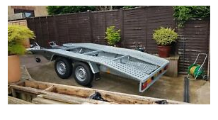

Trailer is this one
1425154
came with an electric winch, which I have sold for £110 so lowered the price of the trailer too - it's not a low profile one like my old Benderup or a Brian James one - but I'm never going to pick up a 6mth old trailer for this money any where,. I sold the winch as the trailer came with the original one and I would'v had to keep a 120amp hr battery in the boot to use for the odd occasion that I need to use a winch. Will have to watch the weights though as it a bit heavier than my last so a 1400kg car will put me over my car's braked towing weight.
