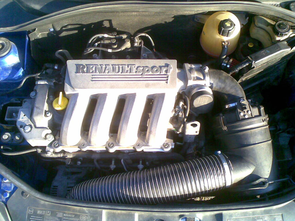

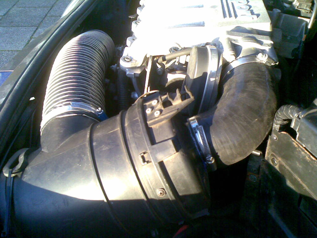

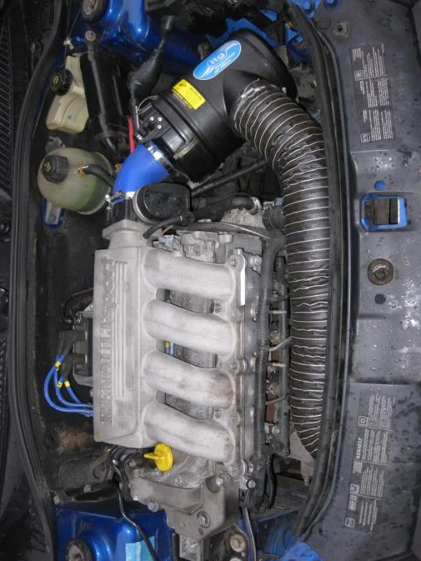

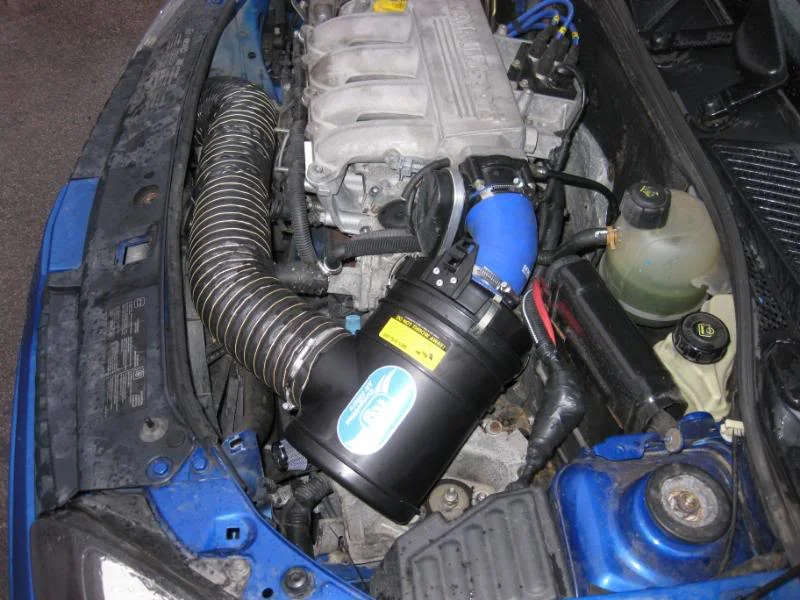

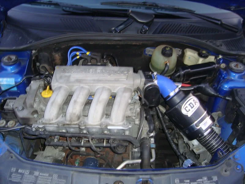

Decided to remove my bmc cda today, and replaced it with a espace V6 airbox, ITG filter and 105mm cold air feed. Already have my battery relocated to the boot courtesy of mr burp!;) The car was just not liking the bmc compared to my old ph1 setup.
Looks very similar to markcups setup but with a 45 degree elbow. Hope u like.
BEFORE:
AFTER:
Would personally use a straight piece of silicon hose & sit the air feed off towards the nearside lamp you aint gunna pressurise anything so its best to have the shortest straightest inlet tract you can.

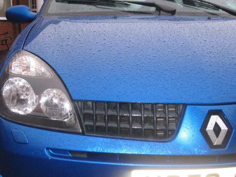

All you need to do is remove the front grill if you can. The plastic panel behind it will unclip. You only need to remove some of the right hand side of this panel to place the caf. As you've only cut this part you still have the protection for the aternator.
To run the caf down to the grill you need to remove the fuel guard rail. The cold air feed once placed seems to fit snugly between the grill and the fuel rail. Had no problems so far!;)

How the hell do you remove the grill !? Is the grill only the left black piece (vent holes , what's in your picture above) or are we talking about a whole upper-bumperpiece ?
