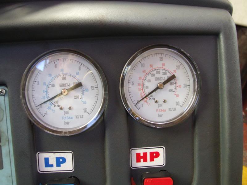

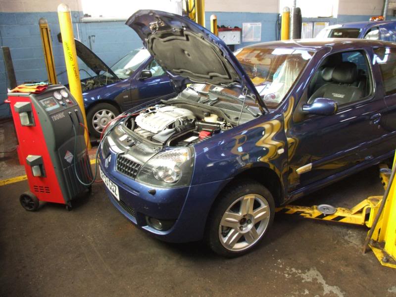

anyway aircon wasnt working so hooked up our machine
mmm no gas what so ever
did a leak check and found a massive holes in the condenser so have ordered a new one and well as a filter dryer as that will be well saturated by now, should be here tomorrow

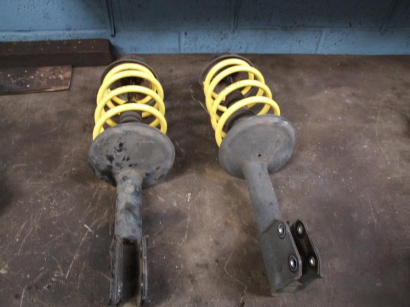

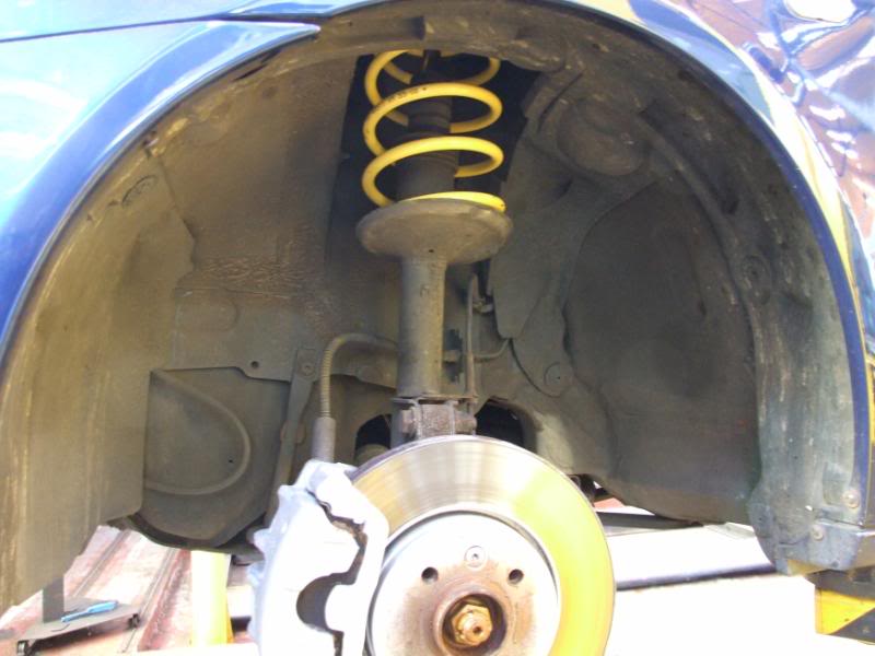

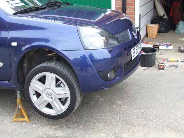

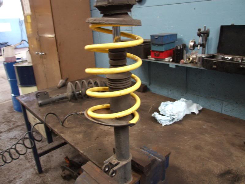

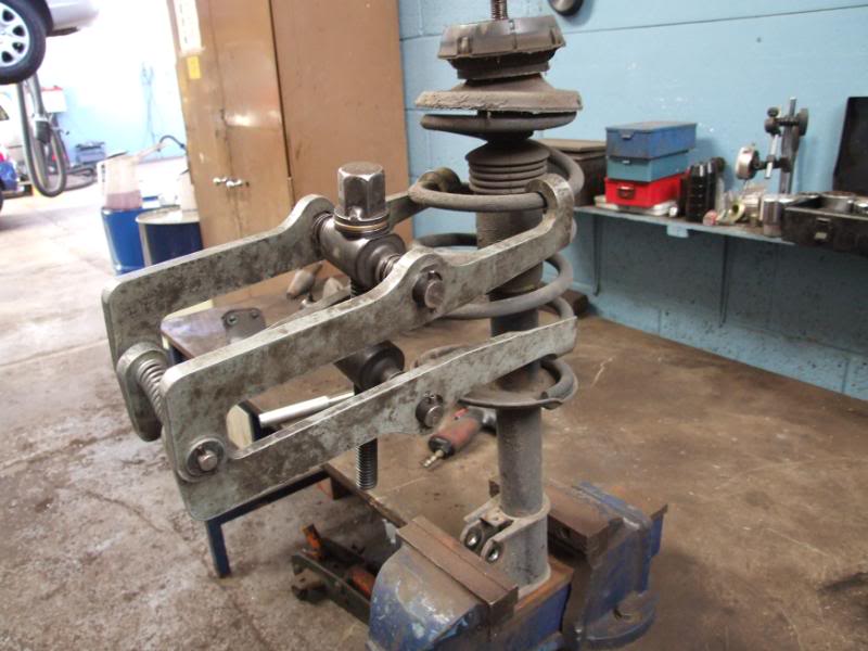

well ordered some springs and they came today so got the car back on the ramps and took the front struts off
removed old springs
fitted the new ones
then refitted the front struts, wooo easy

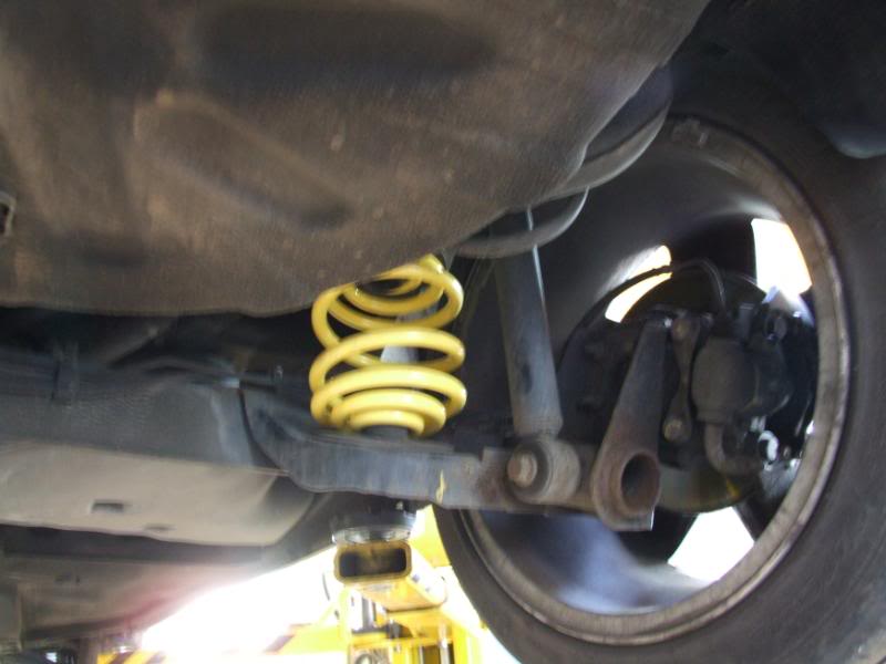

rears took all of 2 bolts to drop the axle down the slip out the out springs and in with the new
after that i checked and adjusted the tracking and all was dandy

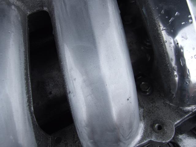

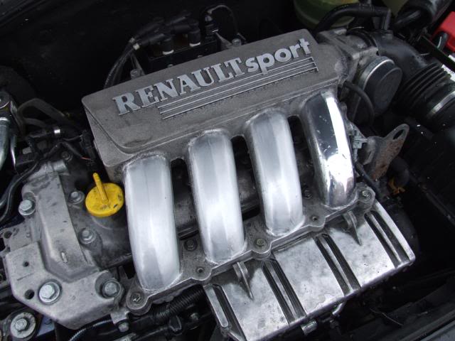

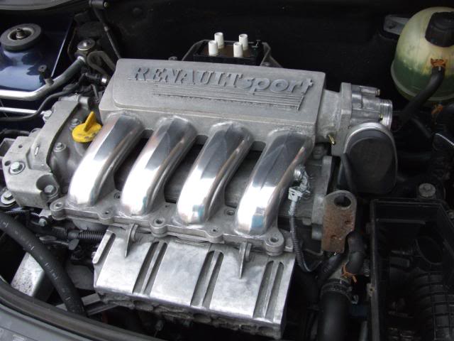

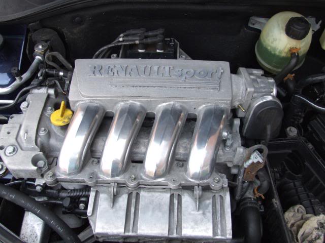

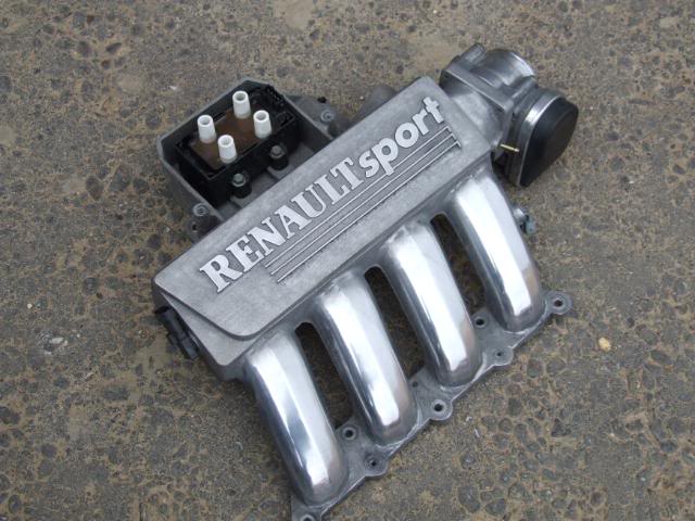

decide to polish up the inlet runners, took the car to work and roughly smoothed them off with the air grinder then spend a few hours with some wet and dry to get them smooth enough for polishing
then a buff up with some autosol and the electric polisher

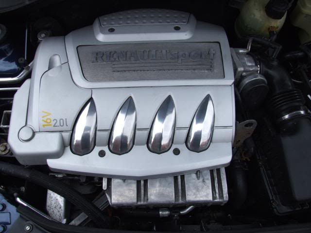

have started to polish up the fuel rail cover but i got bored and sore hands lol
will be taking the inlets off soon get then matched up and and quick internal polish. looking for a 182 exhaust manifold at the min too

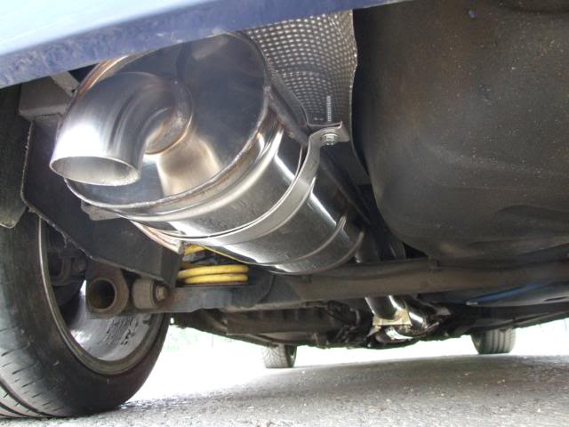

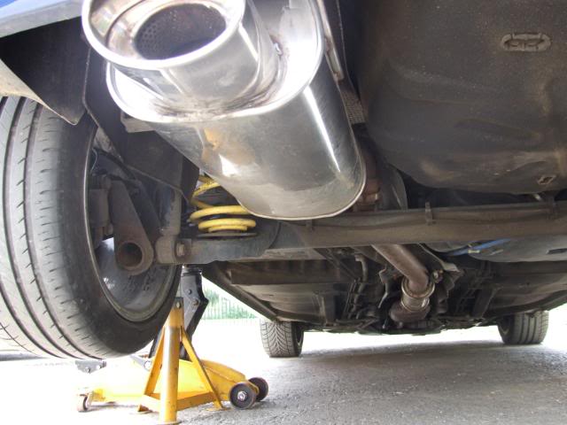

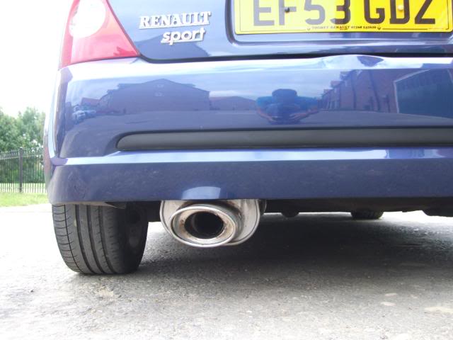

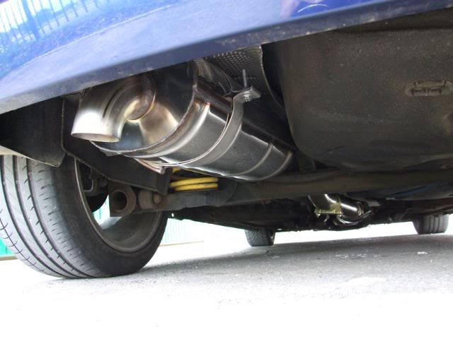

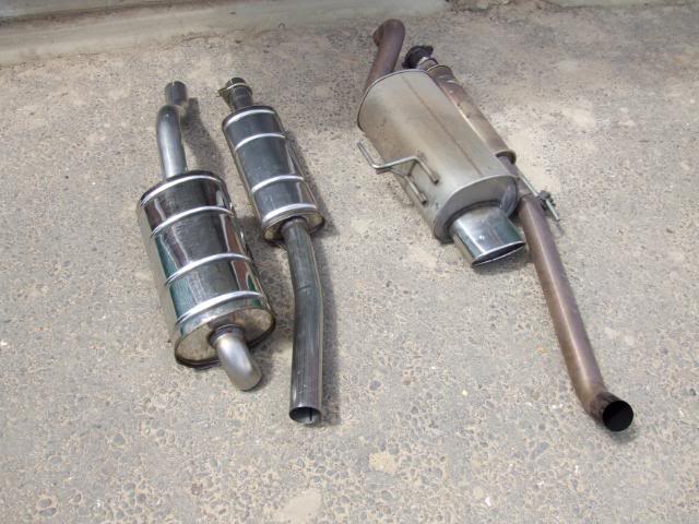

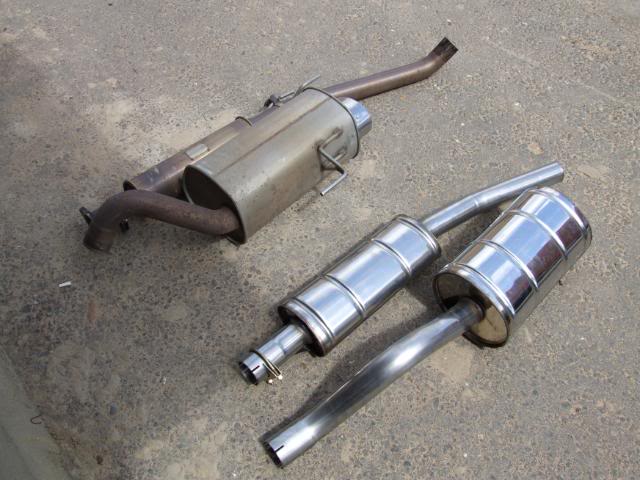

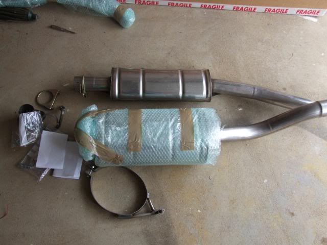

ordered a k-tec stealth exhaust and a carbon firbre splitter on fri and they came today so im very pleased with them
got the whole week off so went to work but they didnt have a ramp free so not matter ill just do it on the floor
well heres the old crappy magnex that was on, looks horried but sounded ok
jacked the car up and put it on axle stands then got to work taking it off
whooo new bits, its like chirstmas again
all fitted, was very easy to fit no problems at all would deff recommend it
struck it up and went for a drive, wasnt as loud as i thought i was gunna be after all the posts ive been reading found it quite quiet really

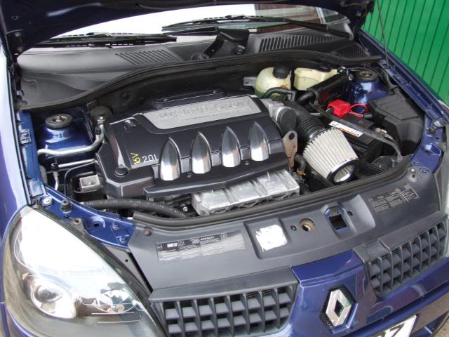

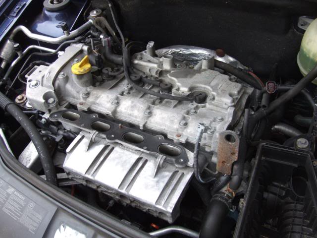

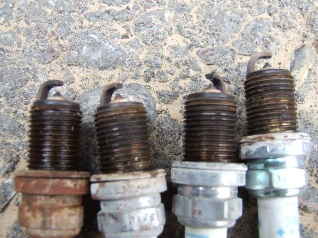

got back and decided to fit some new spark plugs while i had the tools out, and seeing how its just clock 70k.

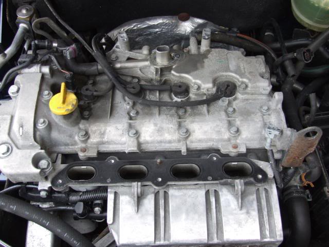

few bits off
upper inlet off, eeasy work
old plugs out, didnt look too bad
new plugs whoooo
all fitted and inlet put back on

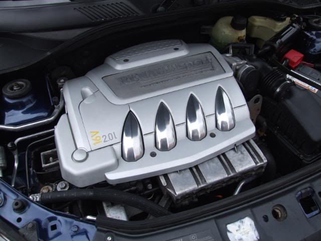

covers were put back on and gave the engine bay a bit of a clean

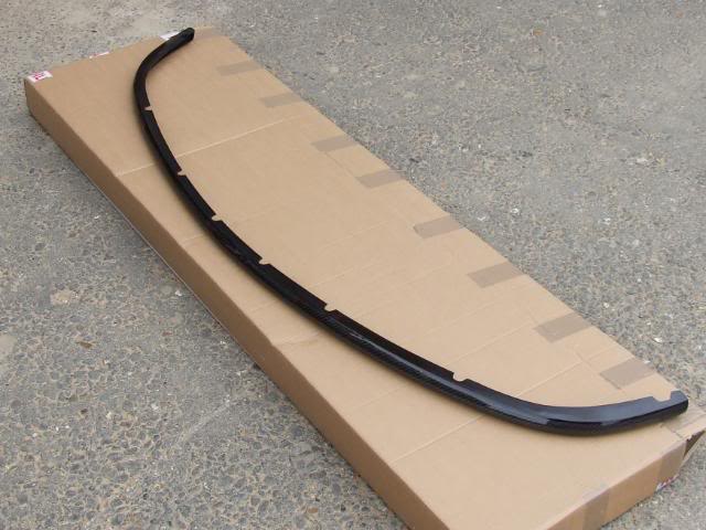

after that jacked it back up again to fit the splitter
was well easy to fit just line it up molegrip it in place drill a few holes and screw it on job done lol.

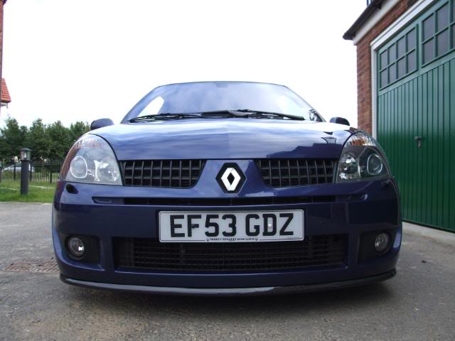

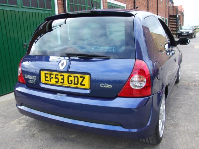

overall im very happy with the parts and fitment. just gotta get my wheels and may be coilovers and im sorted.
will be taking a few more proper pics once i find a decent location

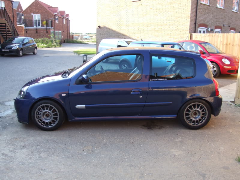

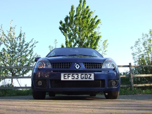

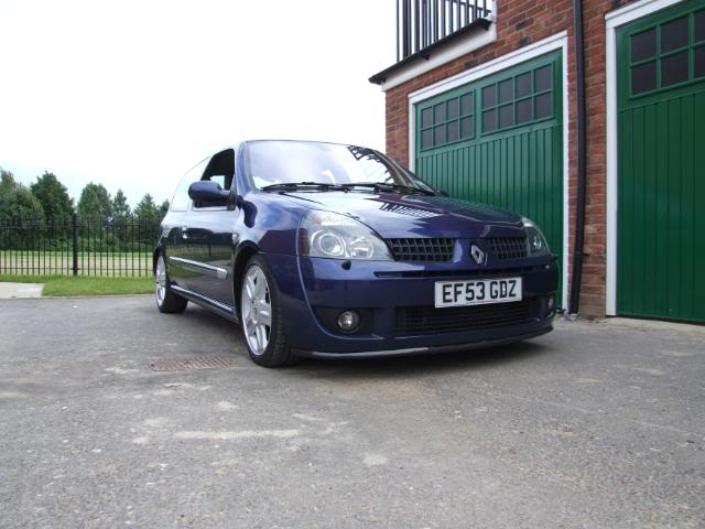

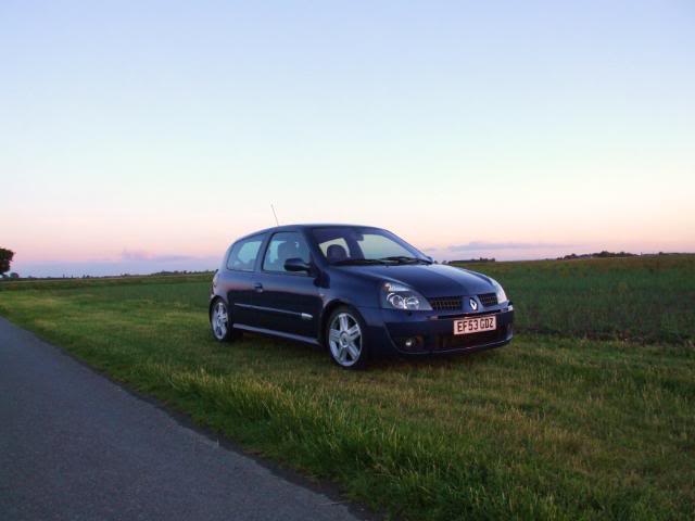

any chance of a pic from the side of your car mate, jus to get a good view of how low your car is sitting.
cheers fella
awesome, thanks bud. any major problem with speed bumps? is it nose diving abit or is it level all round?
speed bumps are fine havent even touched the splitter yet even with the 15's on lol. on level ground it is level think the photo makes it look like it is lower at the front
niice mate. thanks for that. im jus deciding how much to lower mine by at the minute, but didnt want to hav the wee beastie nose diving lol
