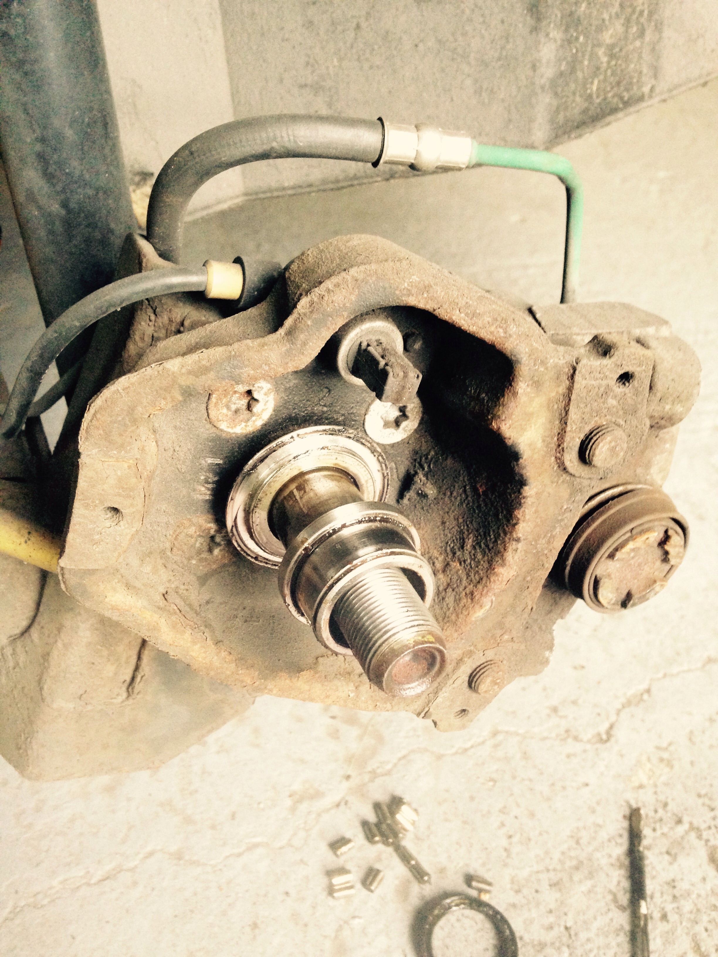

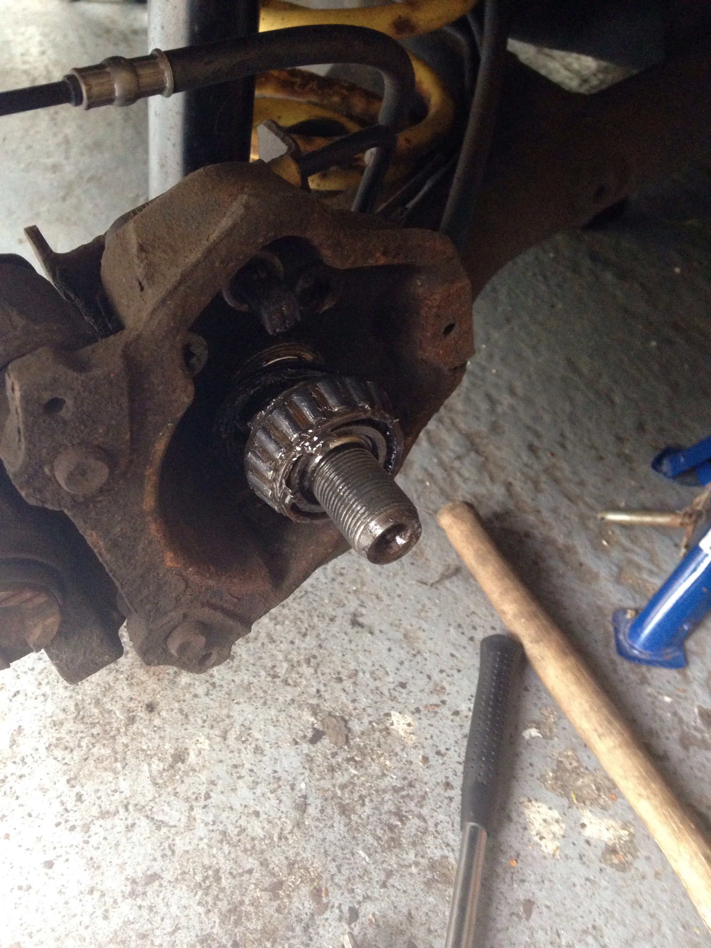

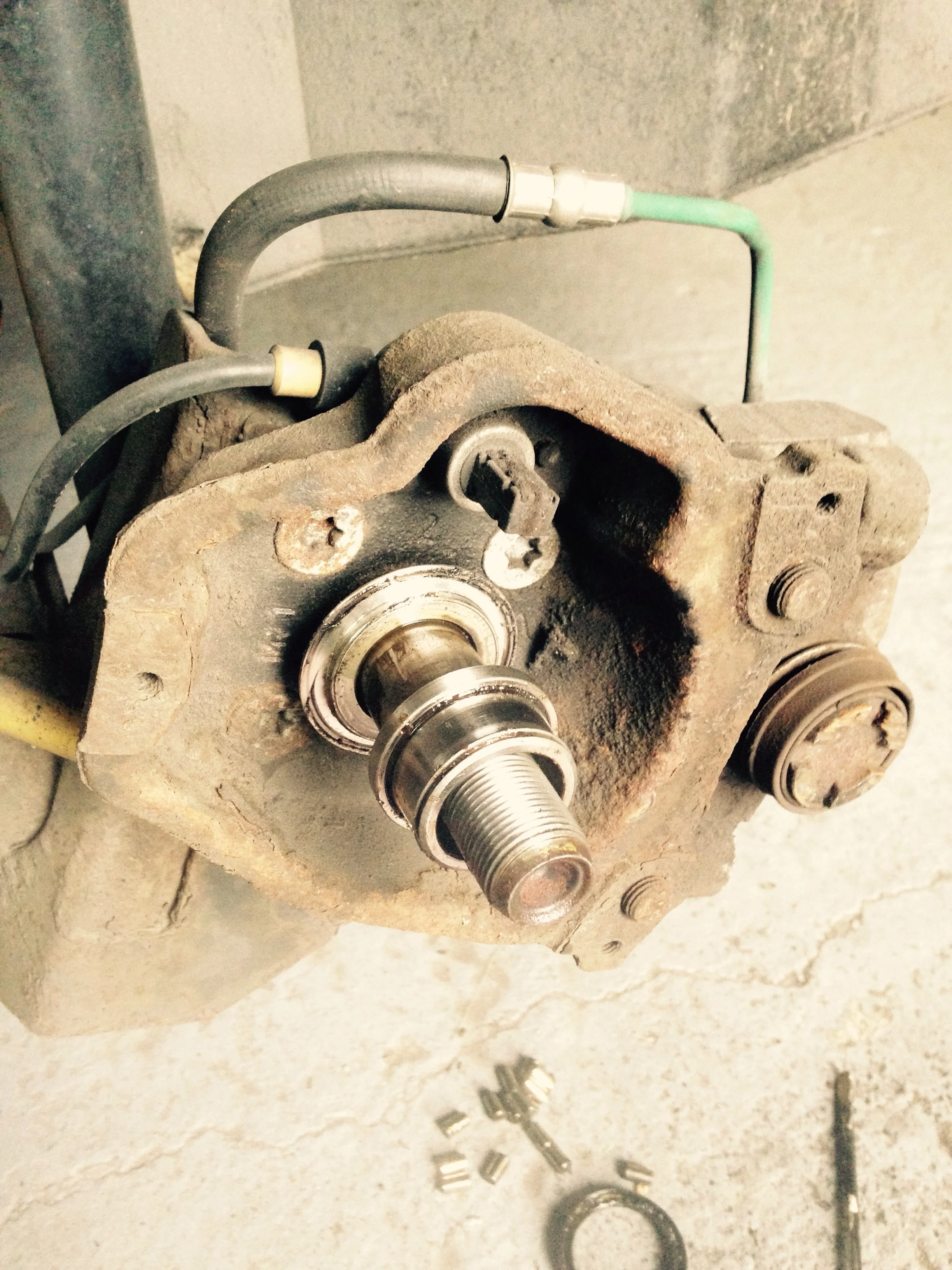

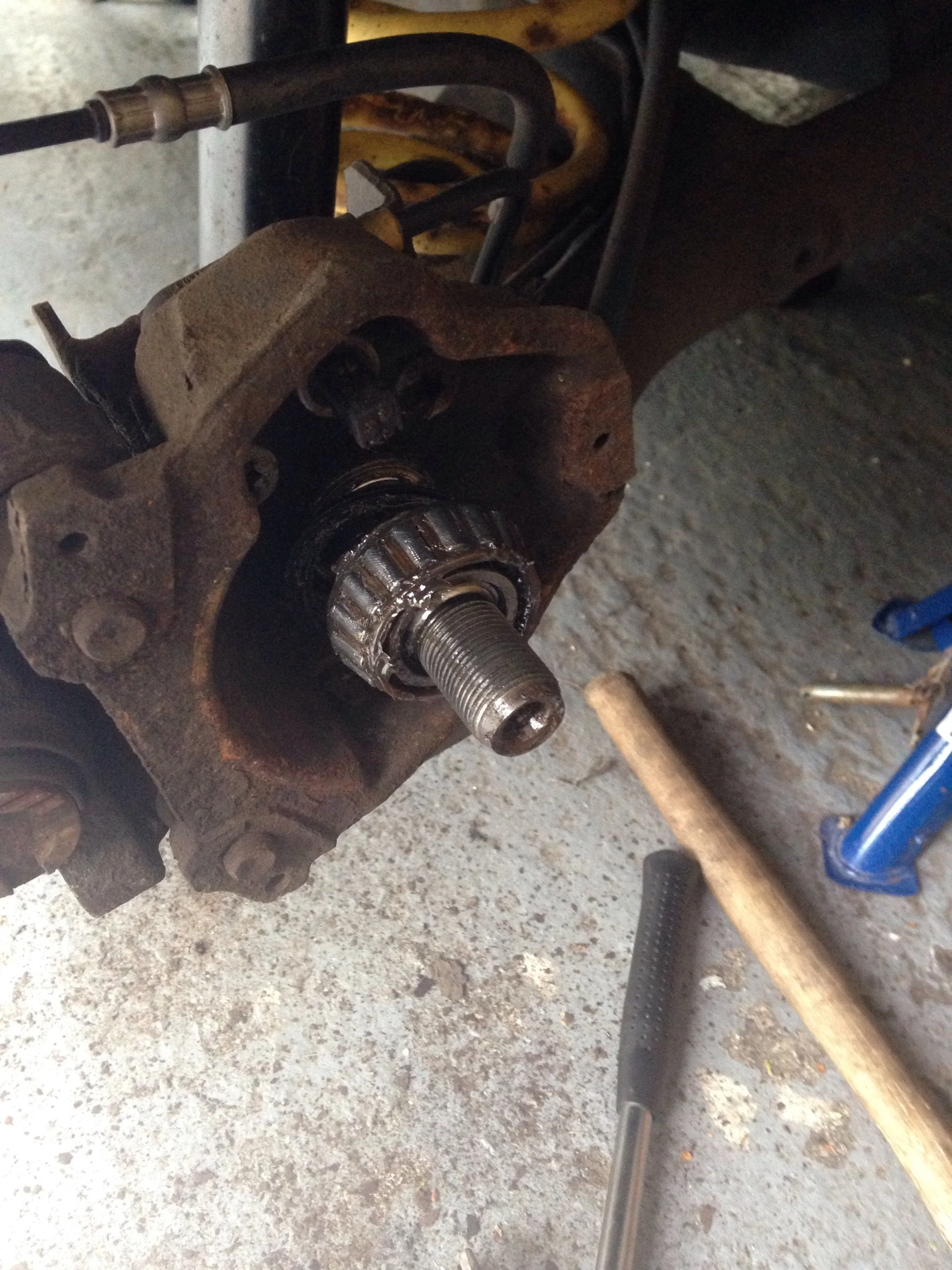

Passenger side disc just slid straight off but the bearing holder is stuck on...?
How do I get it off.
Also the drives disc just won't budge

Either need a puller, or use a lever bar against the hub to pop it off.
Shouldn't be that tight tbh. Just make sure you don't score/damage the stub axle
Ok got it off.... On both sides

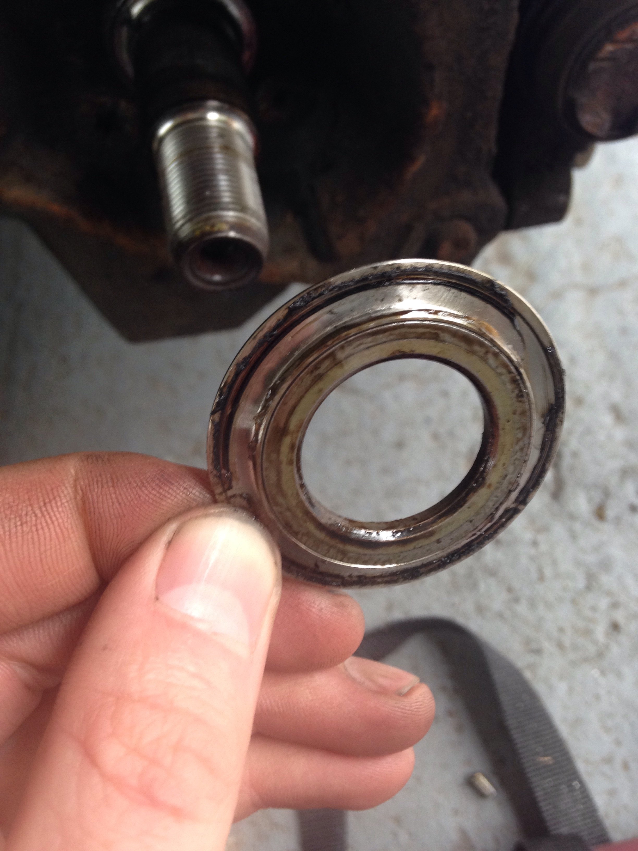

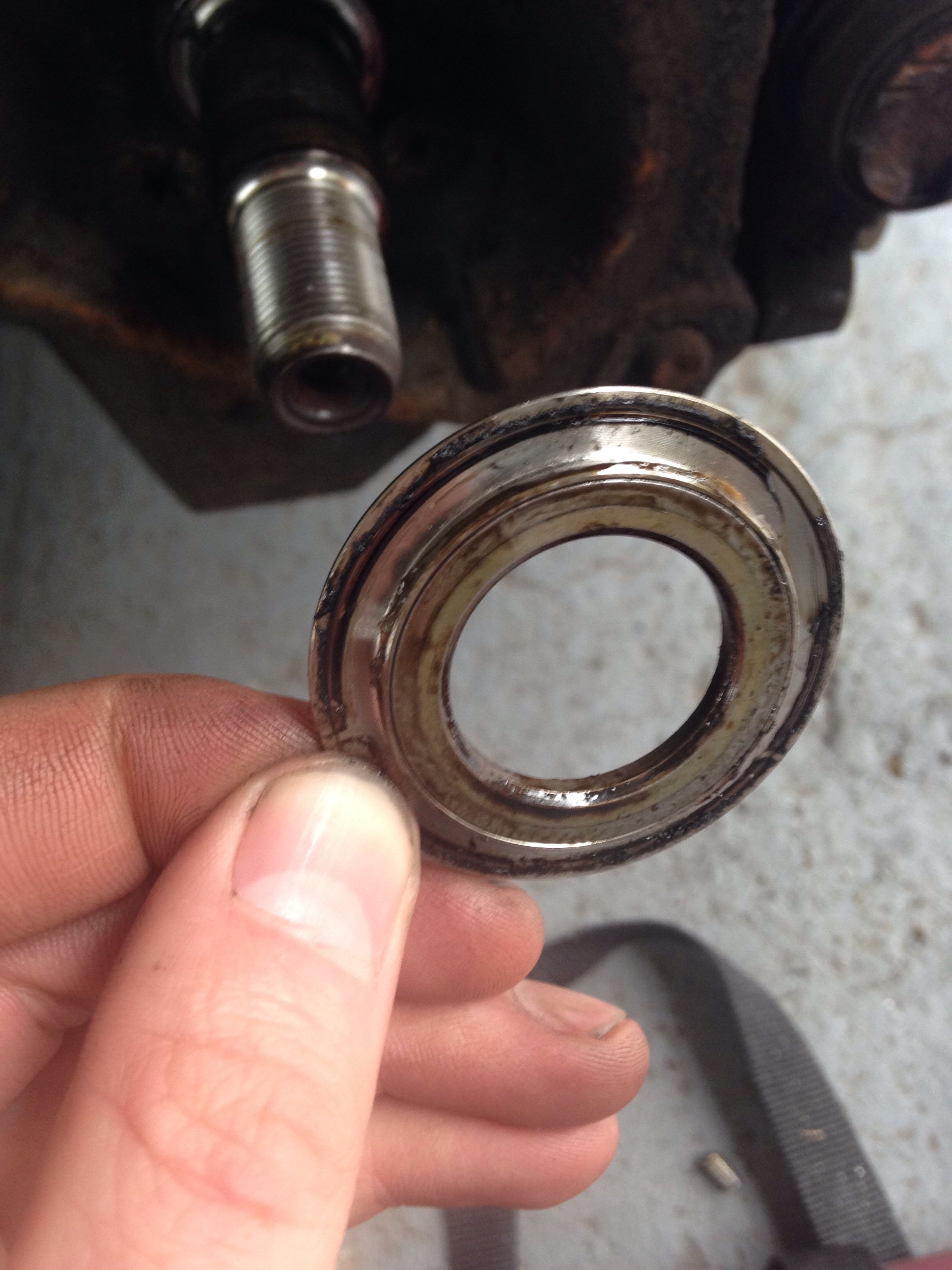

I presume this is the washer to be left on?... ( that most people throw away )

It's probably stuck to the back of the old disc. Which is how most throw it away.
If you genuinely haven't got one, start phoning renault dealers and get your push bike out. No point in refitting the rear brakes without it.
Oh god yeah I know it needs one. This is probably what started the knocking in the first place!
This is the correct washer you mean.. Sorry total newb.
Put it on the right way as well, it'll break into about 635 bits if you don't. I also know that Renault don't stock these and they come from France.
Oh brill....
So do I have to go to Renault and order one in? Or is there any other options
