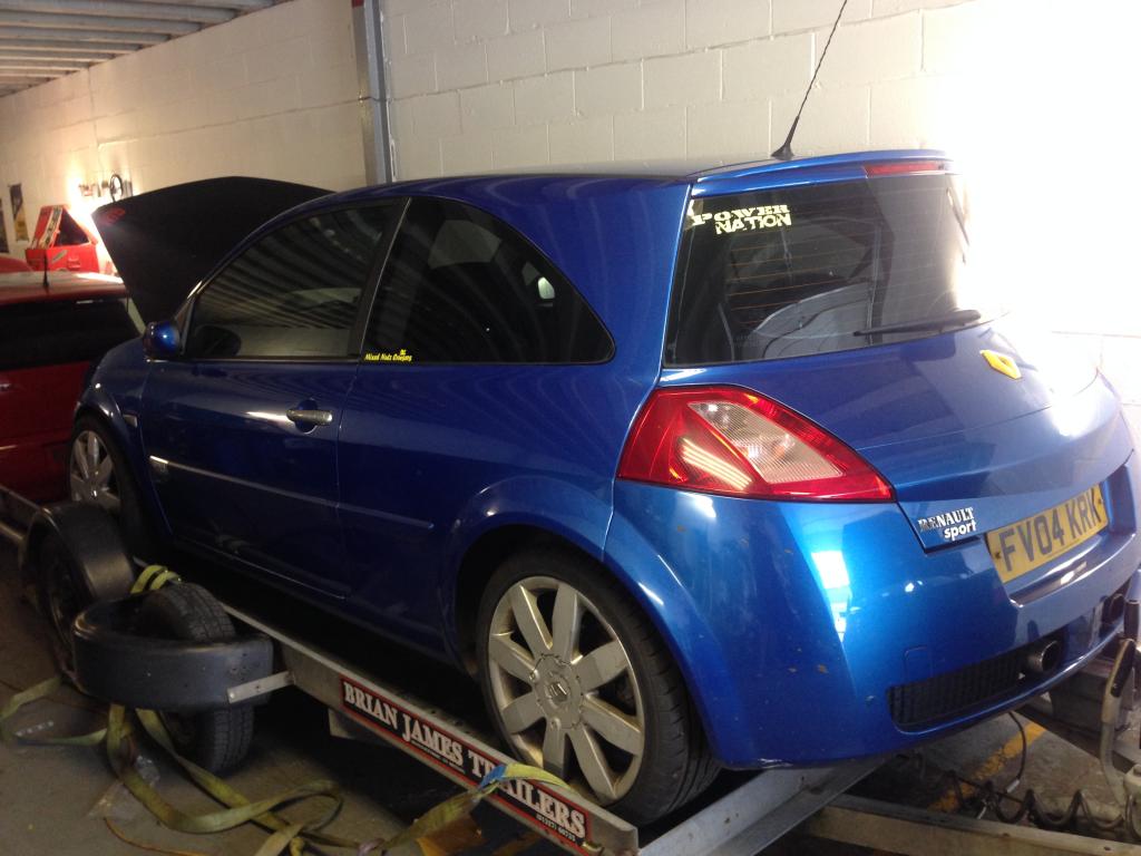

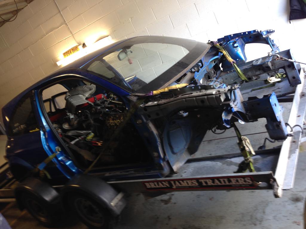

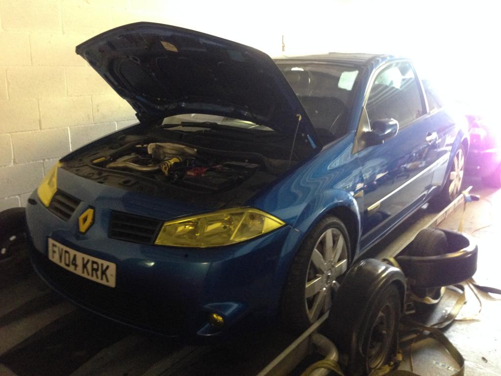

well a total change of plans occurred after spotting a cheap megane 225 on the salvage auction I bought it and am going to fit the full running gear (yes 6 speed box as well) into the Clio!
I have done the belts on the megane and plan to fit it as is from there including running it on the megane 225 ECU/Loom

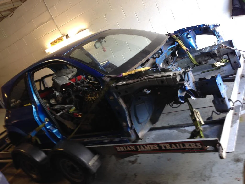

here is the car in question bought with a little suspension damage and no keys for the car, luckily I tracked the previous owner down who had a spare key! car fired up first go...
we then gutted the full car and loaded up all the crap from the unit and went to scrap the lot

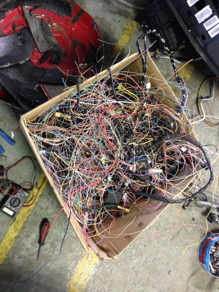

next up was to chop the loom up and remove anything not needed! the box is all the loom I've chopped out

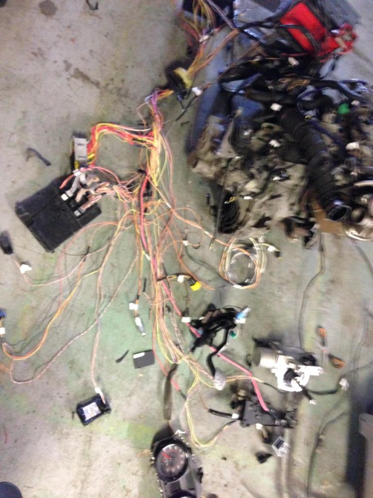

then the chopped down loom before tidying it up

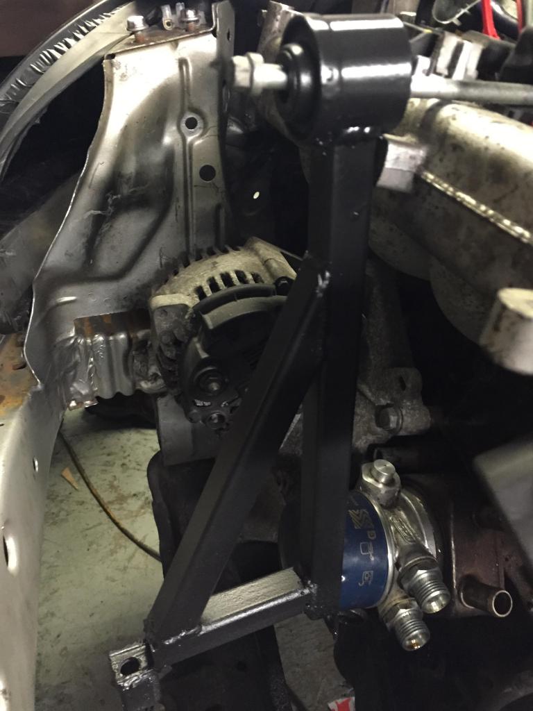

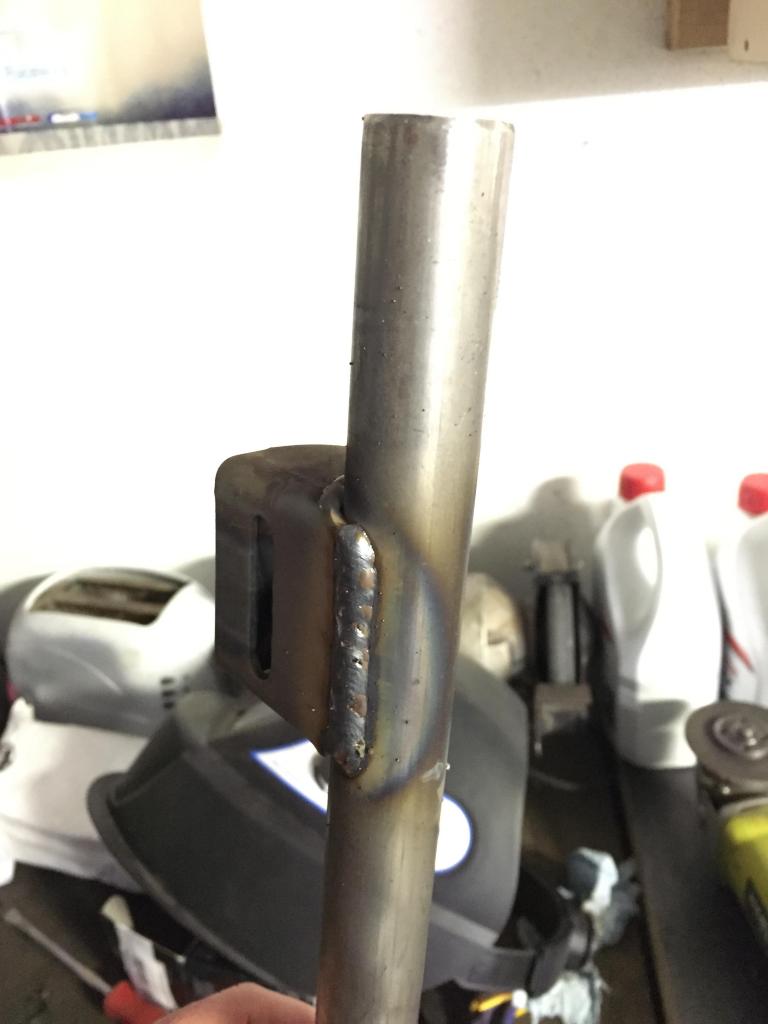

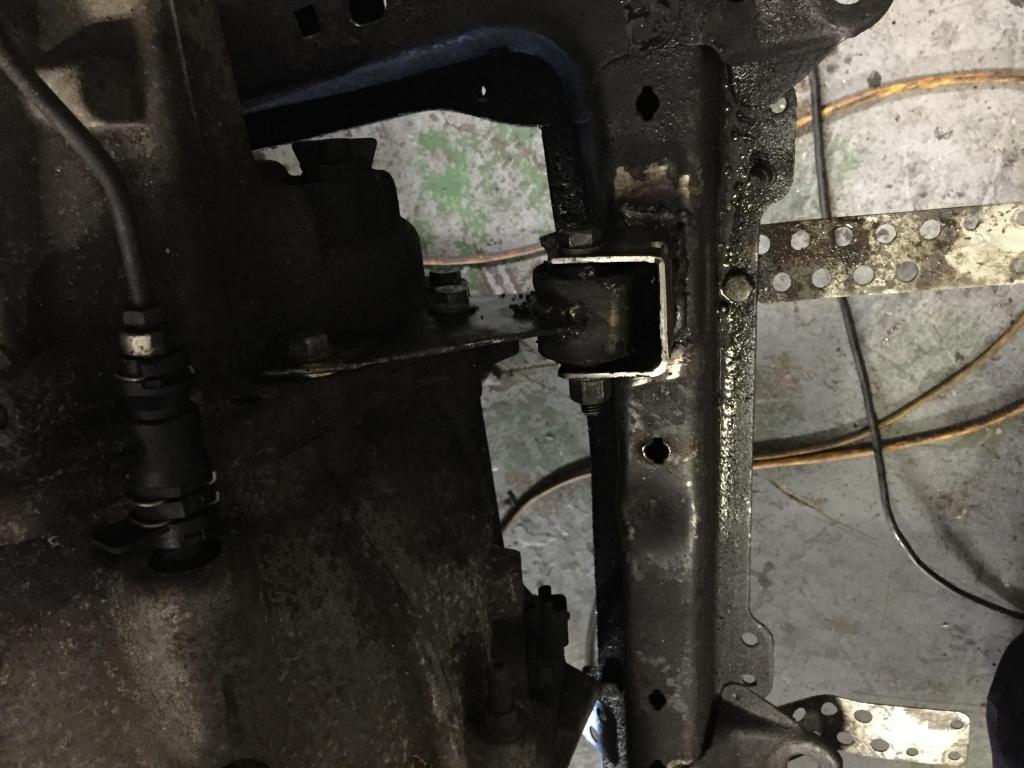

Mr horrocks a new clio sport owner and forum member I believe whipped up some engine mounts for it last night so currently have all 4 now so physical engine is mounted!
front mount
Rear Mount

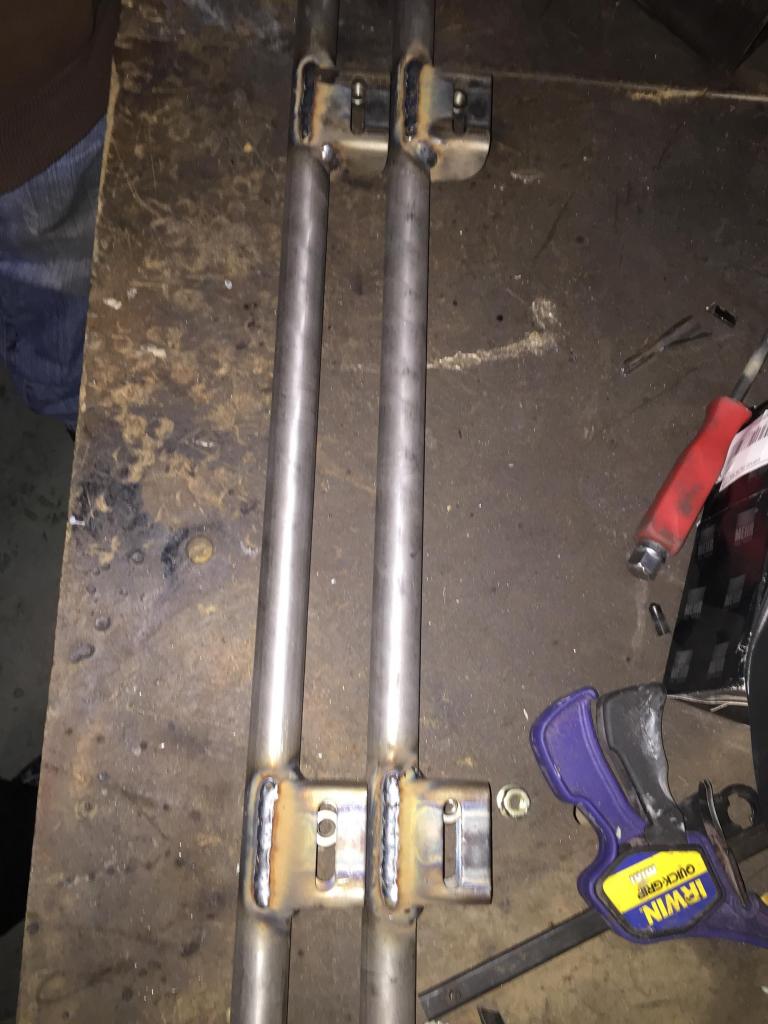

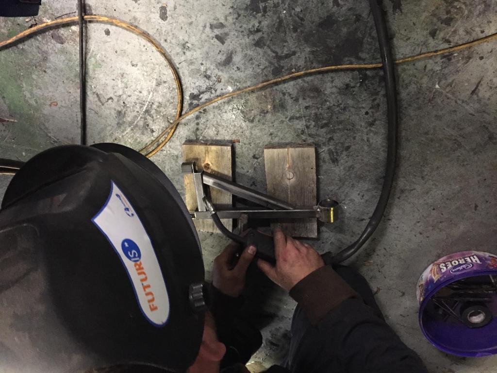

back from cuba Tuesday morning, back working on the car Tuesday night. We have fabbed both pedels and test fitted them to see if the clear the column, think it will work but need to fit the rack properly and seat as wanting to lower the steering wheel. No pics as yet. Next job is cut old seat rails out an weld in new ones

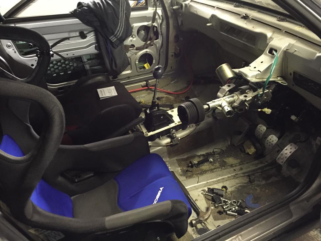

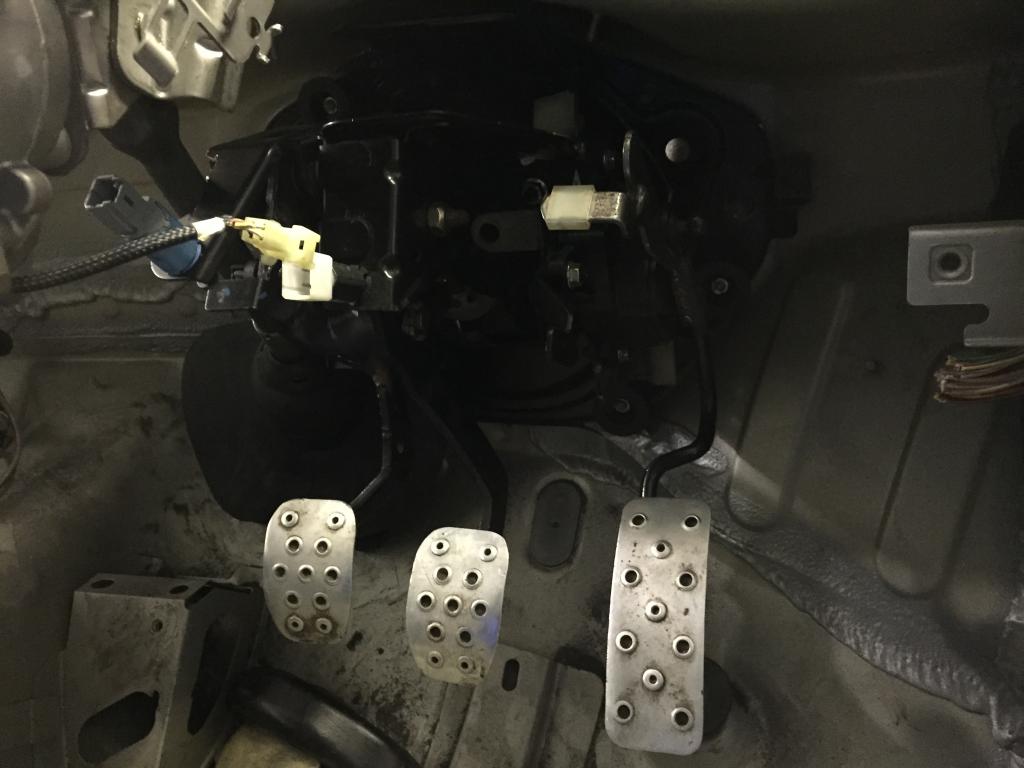

bit of an update, had to modify the pedals a touch as the steering column fouled.

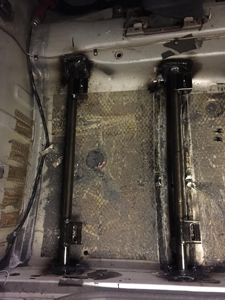

welded up the seat rails, welded them to the car and fitted the seat to where I think feels right with the pedals.

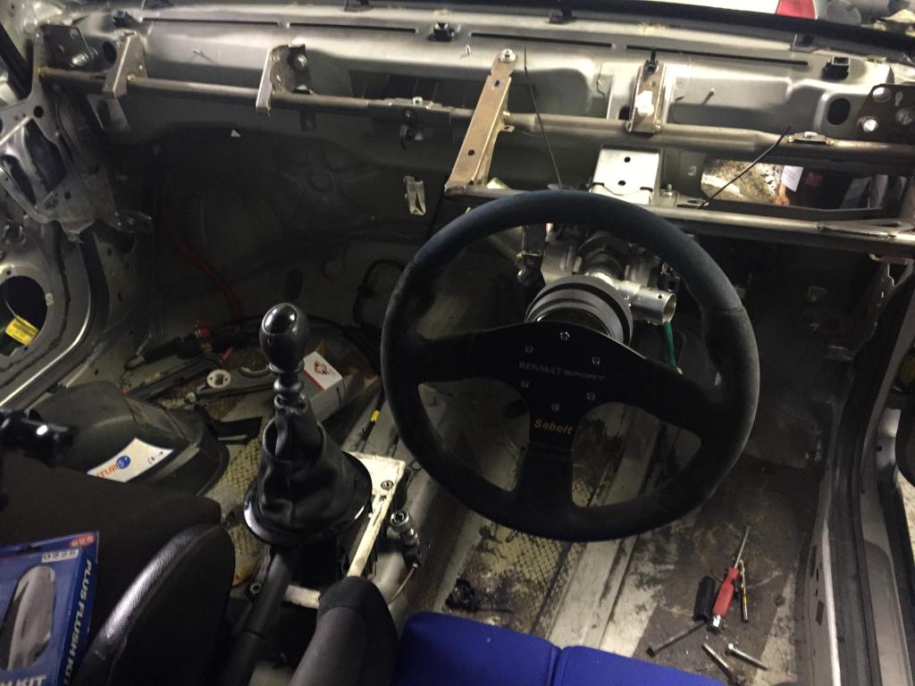

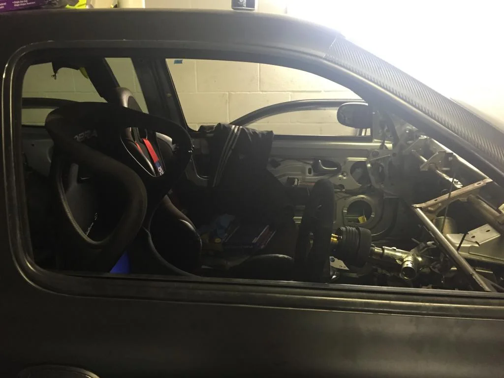

Steering wheel with then be spaced a touch and dropped down. you can see the Megane gear stick in the pic going to be fitted somewhere around that location endsup next to the steering wheel then

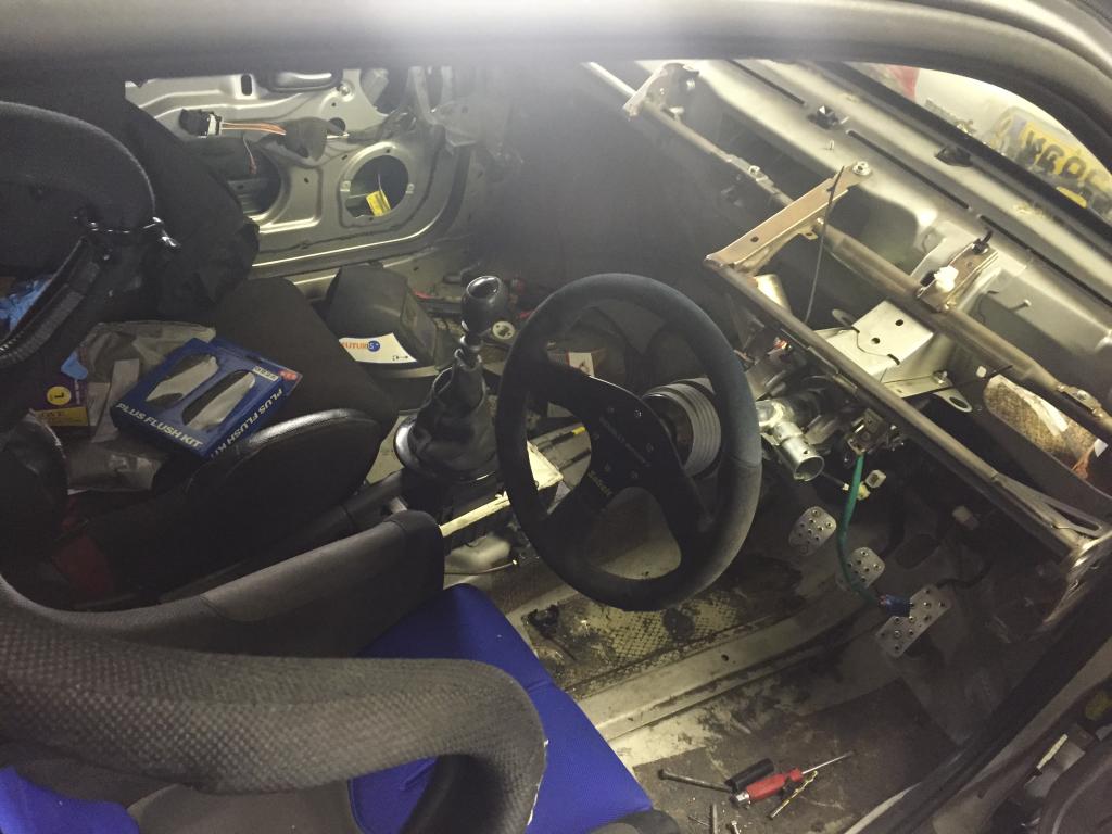

trial fitted the top dash today all that looks to work so going to send that off for flocking.

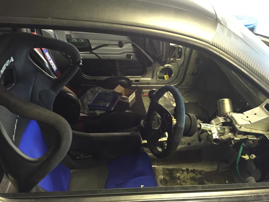

Bought quick release boss which also spaces out 50mm so steering wheel is right where I want it now. Megane shifter is also temp bolted in to test fitment. Need to weld some holes up in the floor next.
