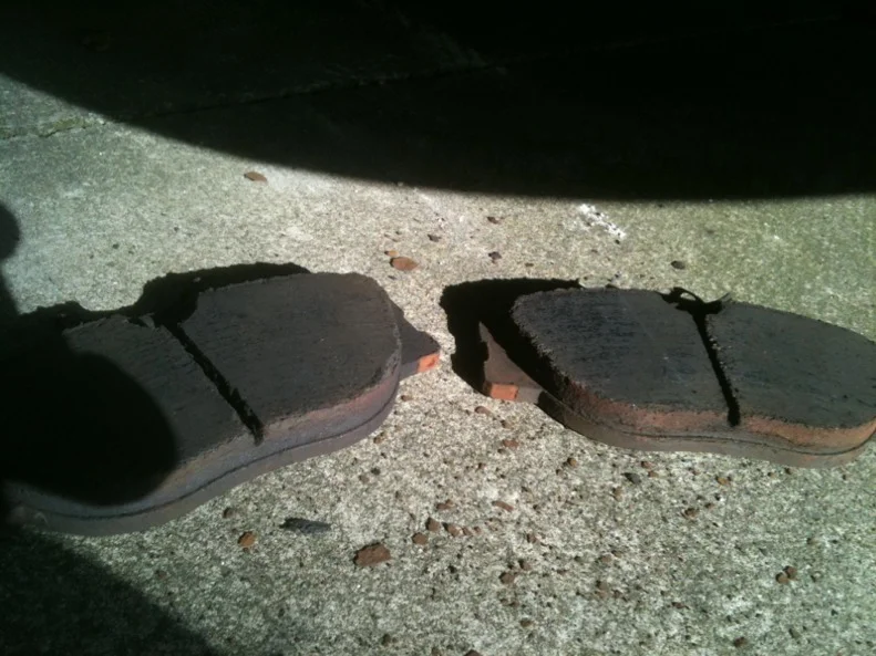

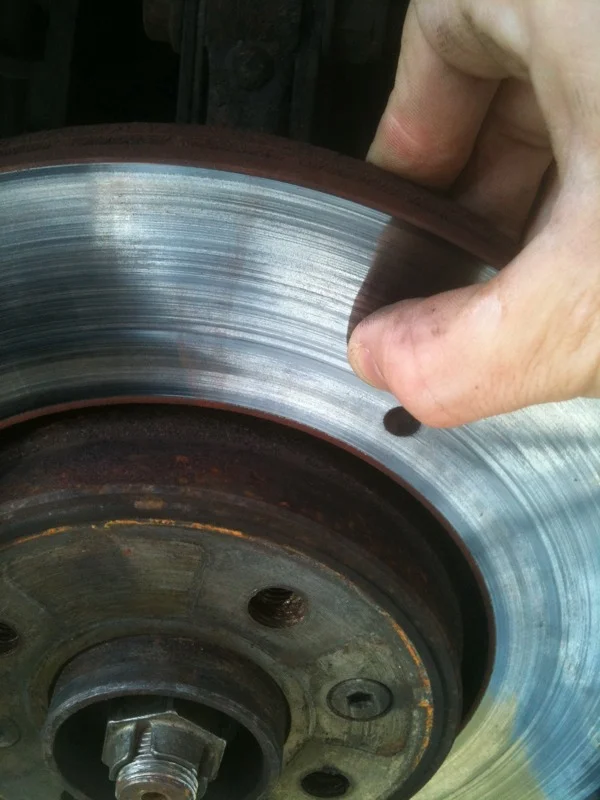

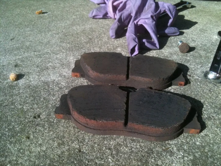

I'm going to strip them down tomorrow as I fear that could be the issue. Outer pads look ok, but I'm getting bad vibration, noise on the road :S I'll report my findings
It's a but wierd the inside pads wearing at the same rate isn't it? Discs feel slightly curved as you run your finger from outside to hub. As if they have worn less at the middle. Ideas? Pads look ok don't they?

It's from just before the wear marks to the centre. Feels like wear is uneven

Clean the caliper where the pads sit so they have a few mm of vertical travel, fit some new disks and take if from there. Thats what I would do.
Pads move in the carriers sam, but I'll clean them anyway. Could there be a piston issue if the pads aren't pushing flush?or am I over tightening the carrier pin bolts? Torque setting?
Make sure the carrier sliders are free. Seen loads seized.
Reface the pads (rub them on a sheet of emery paper) before refitting
