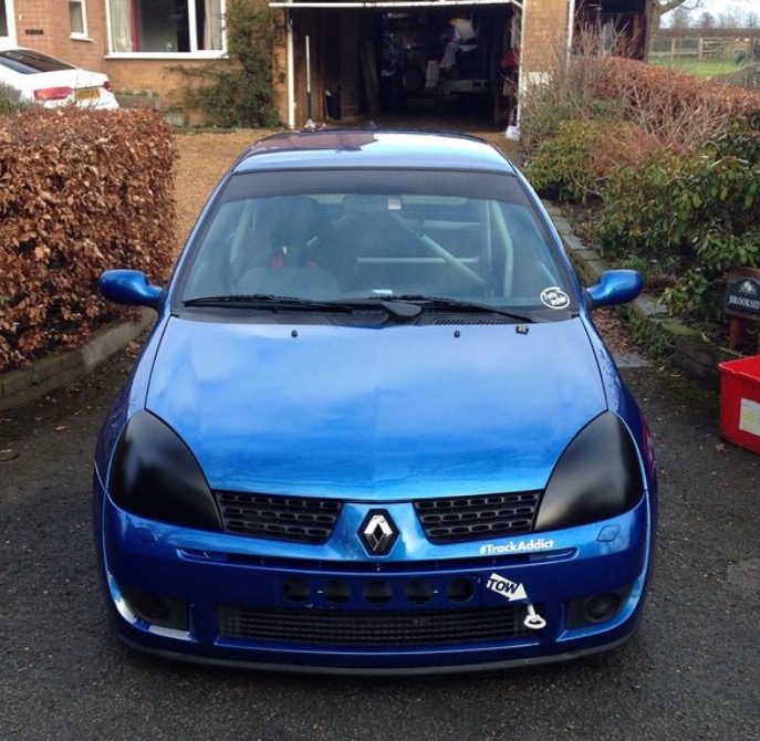

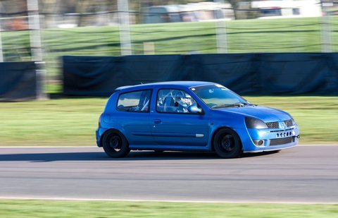

A few picture of how it stands

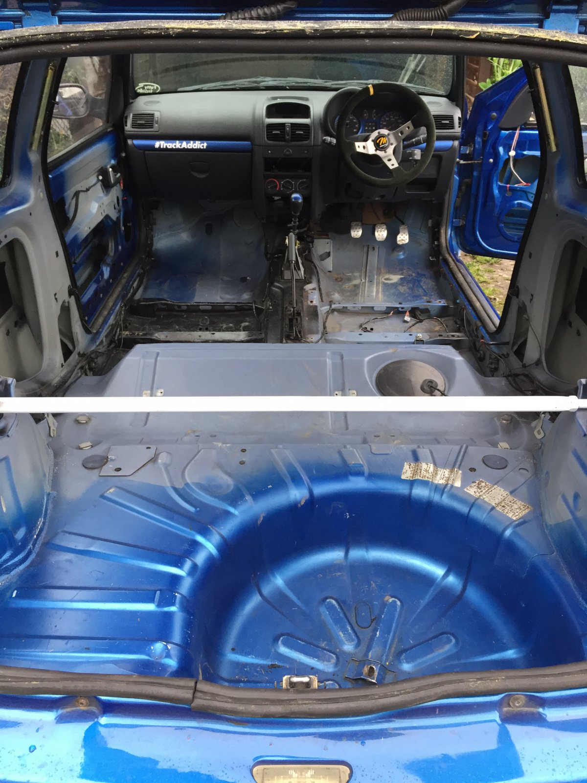

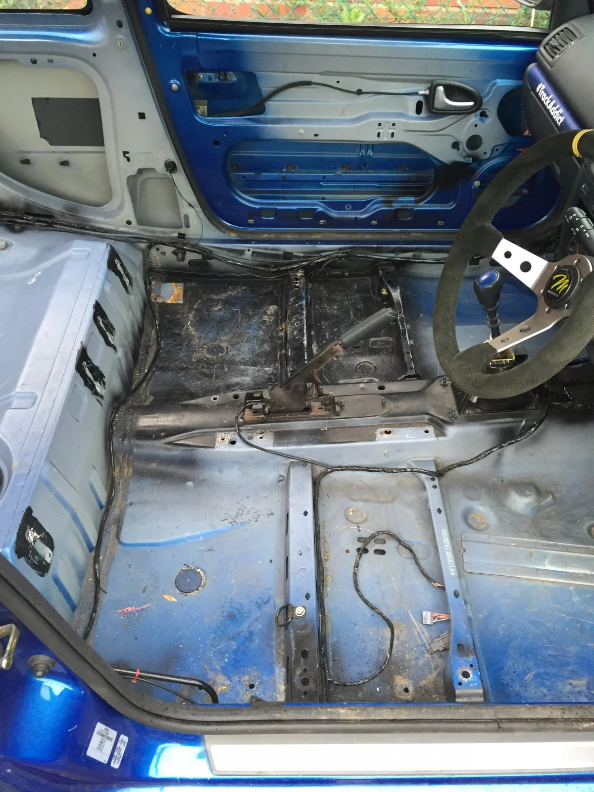

Update 13/6

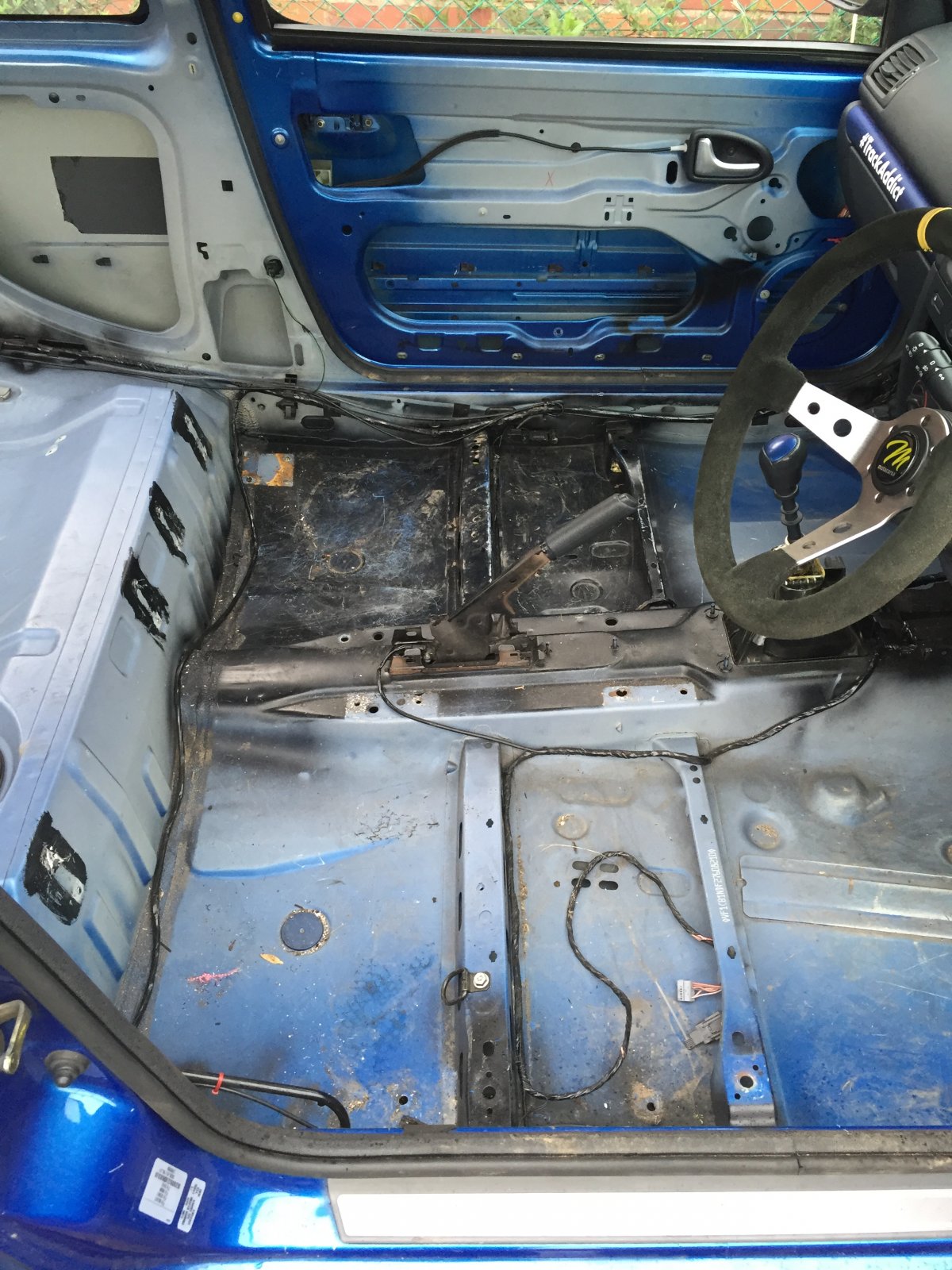

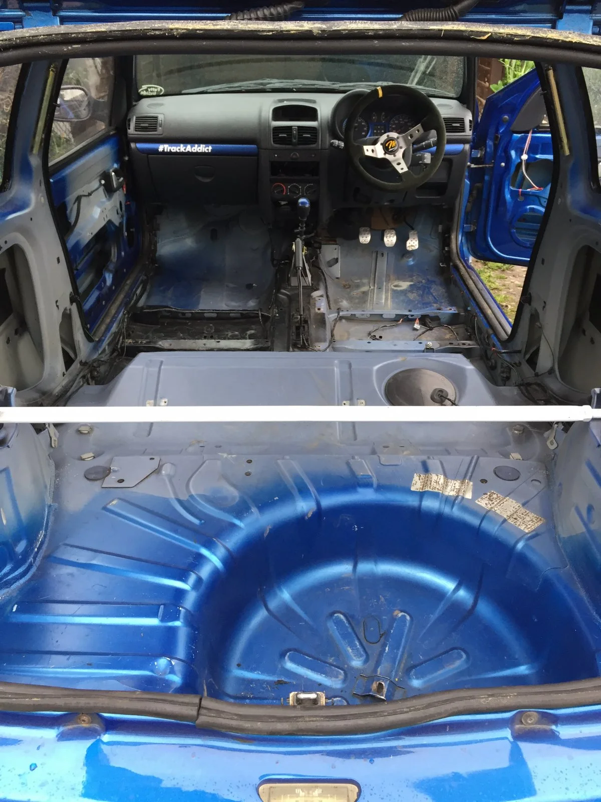

So tonight I set about removing my old eBay cage and bucket seat from the car, this was a laugh as I forgot how awkward they are to handle inside a Clio! I will save he clean up until tomorrow night and then probably going to use some hammerite paint to do the inside nothing fancy.

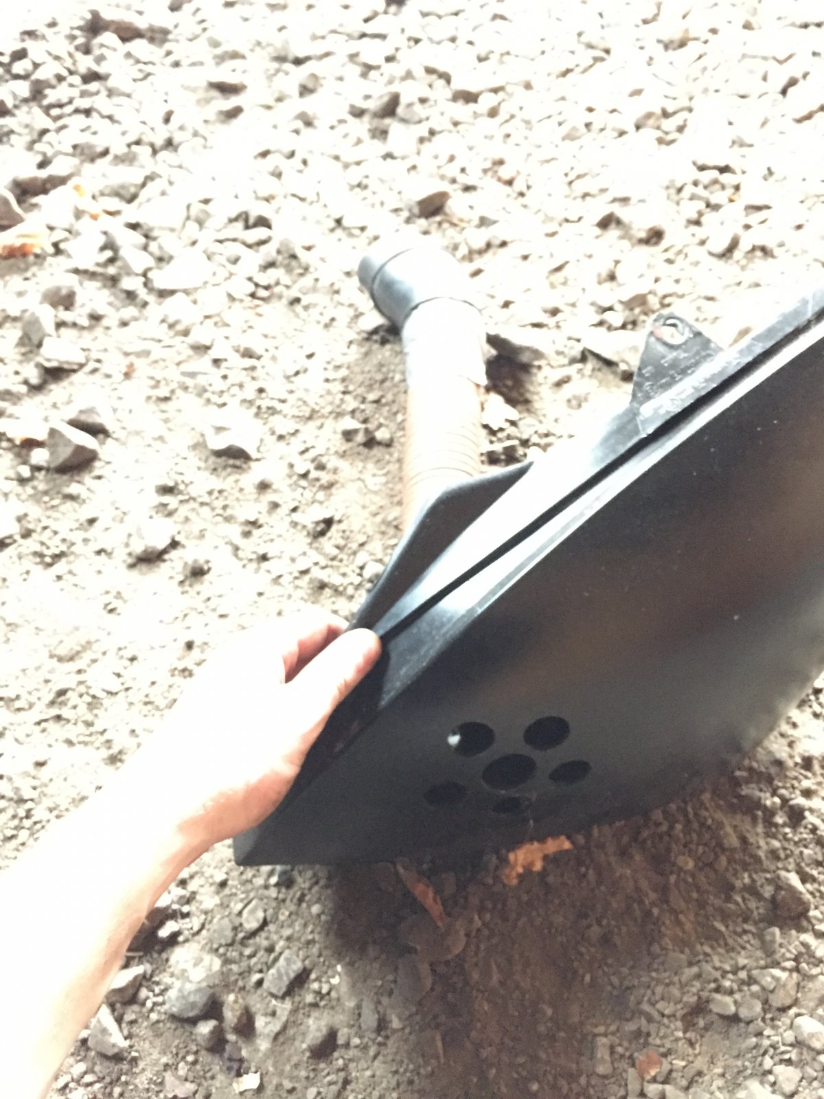

I'm going to be running standard engine with a V6 Airbox and hopefully a map to run just under 200bhp per tonne...(this is the aim anyway)
If anyone has any pictures of how they have mounted their v6 Airbox that would be good as it does look very tight even with battery relocated (not yet done). I have mocked up my headlight black into a cold air feed when I was running standard air box I will probably adapt this to suit the new box.

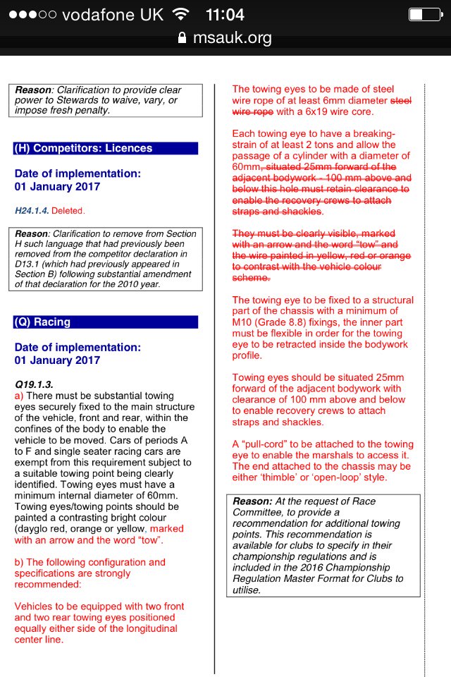

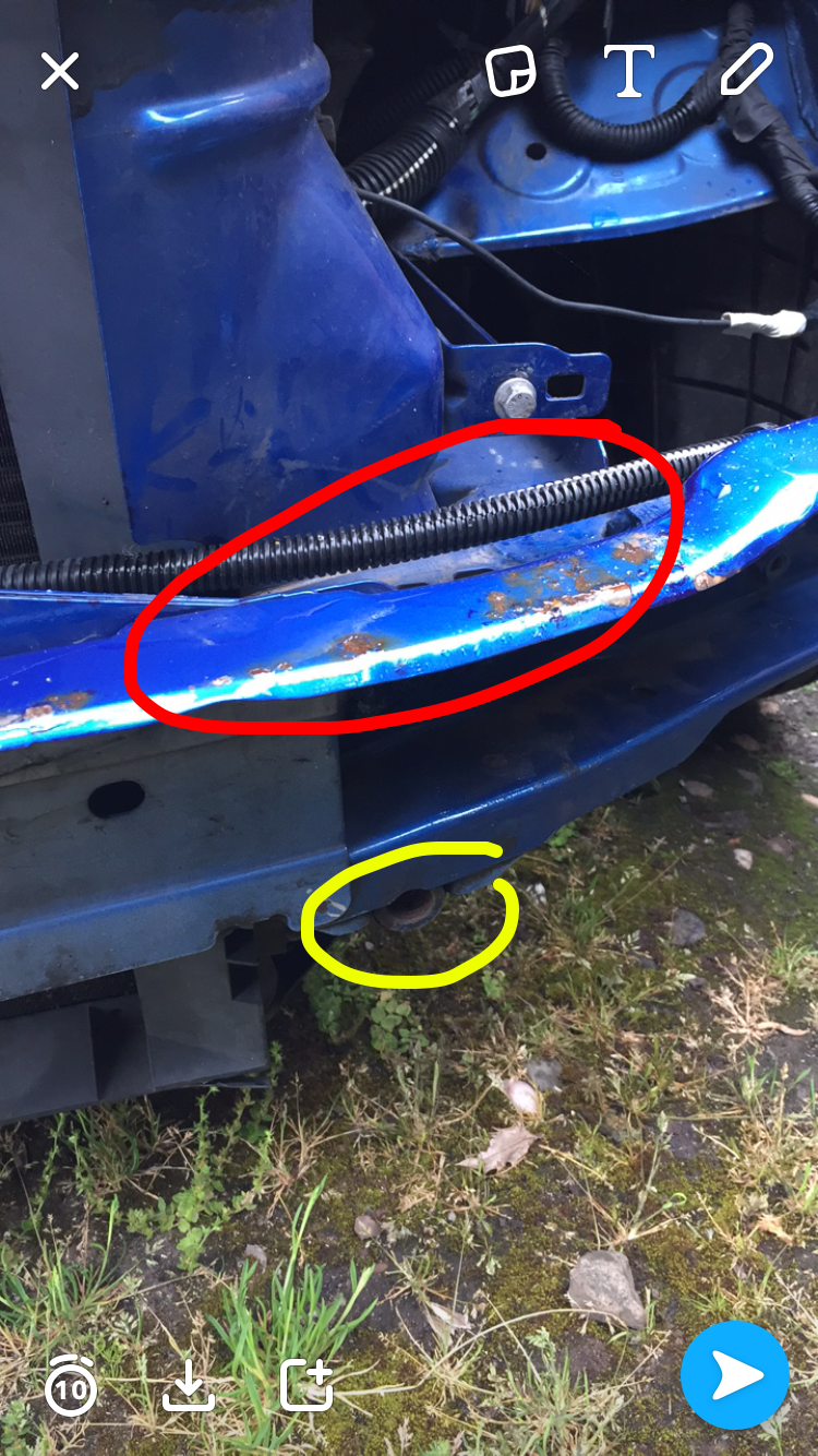

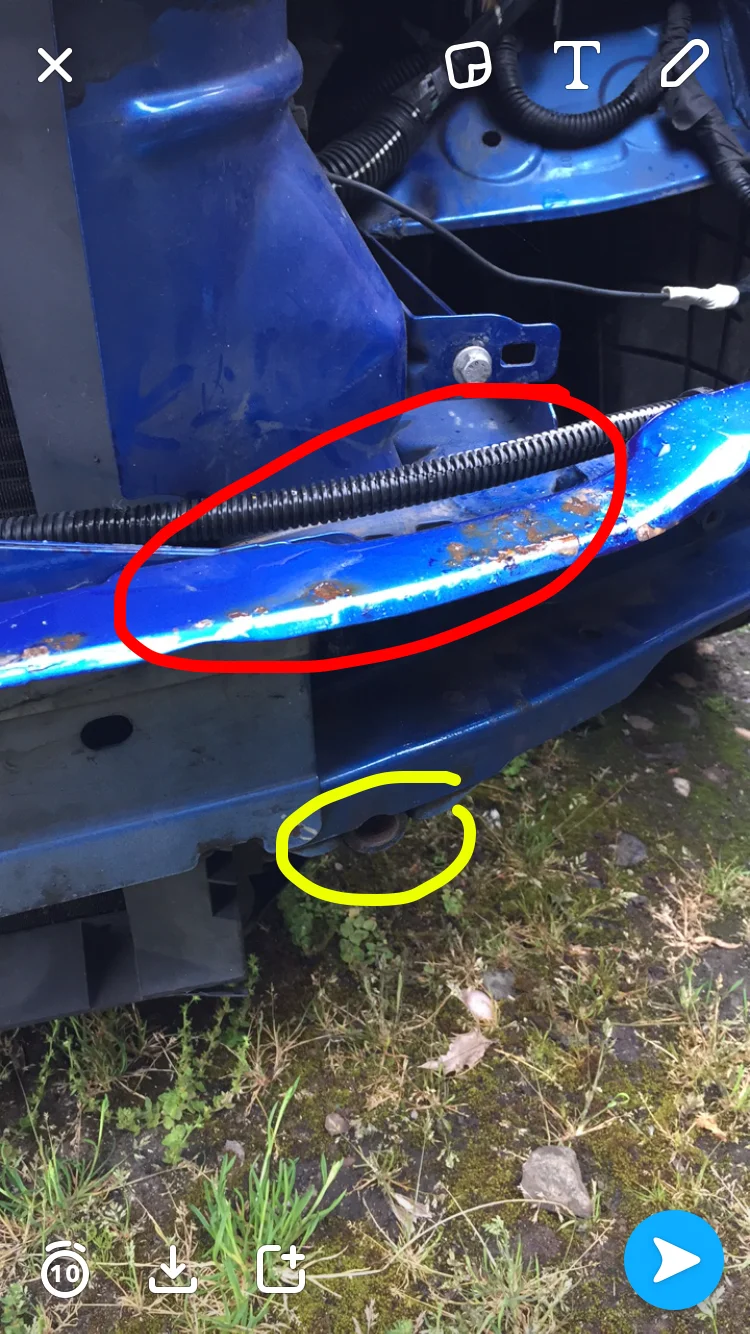

Does anyone racing run the new BTCC metal towing straps? If so have you mounted them on the panel above where the old towing eye fits? Again any pictures would help.
I have provided a picture which may help and circled in red.
Thanks

Run the v6 airbox directly off your throttle body with the inlet facing forwards. Cut the skin out from your bonnet and you'll have a direct air feed as the air can flow under the bonnet. That's how mine used to be when I was running the 172 engine. :up:
Guessing you skinned the bonnet with a grinder? I can only see that ended one way and it's not good for the bonnet!

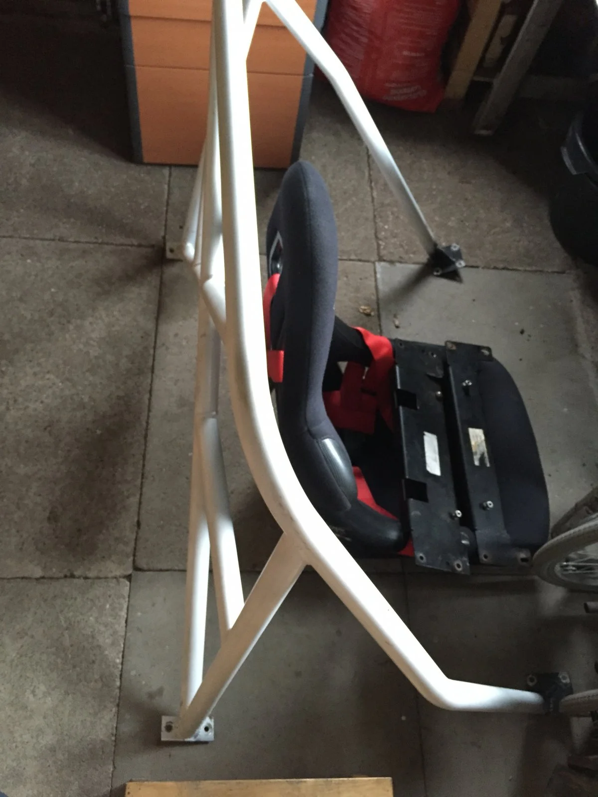

Ordered the Custom Cage today should be here within 3 weeks! So hopefully if all goes well could be ready for racing in August.
May need to call of a few peoples expertise with fitting cages as it does go behind the dash!
I run a FIA tow eye bolted through the original screw hole that has a back plate and nut to stop it pulling through.
New MSA rules for 2017 will require wire toe hooks to be fitted x2 on front x2 on rear (if I had read the draft correctly) So, as long as the part is strong enough, maybe bolt aback plate (50mm sq plate) to the back then I cant see why that wont suffice
Yeah when ordering them from JJC I have got 2 for now to meet 2016 regs but rightly so 4 are required for 2017, and the guy suggested bolt through the plate that I have circuled with a back plate. The wire toe hooks have come and they are a nice piece of kit!

Just want to update this incase anyone gets the wrong idea, the wire tow ruling as above is only "strongly recommended" so wont be in force for 2017, however watch this space for the near future.

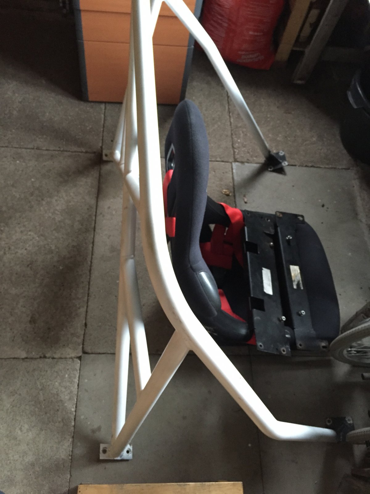

No update on this just yet as I am on holiday! However few things have been arriving at home....full cage from customer cages, my new seat.
Hopefully all ready to go in be car 1st July!
