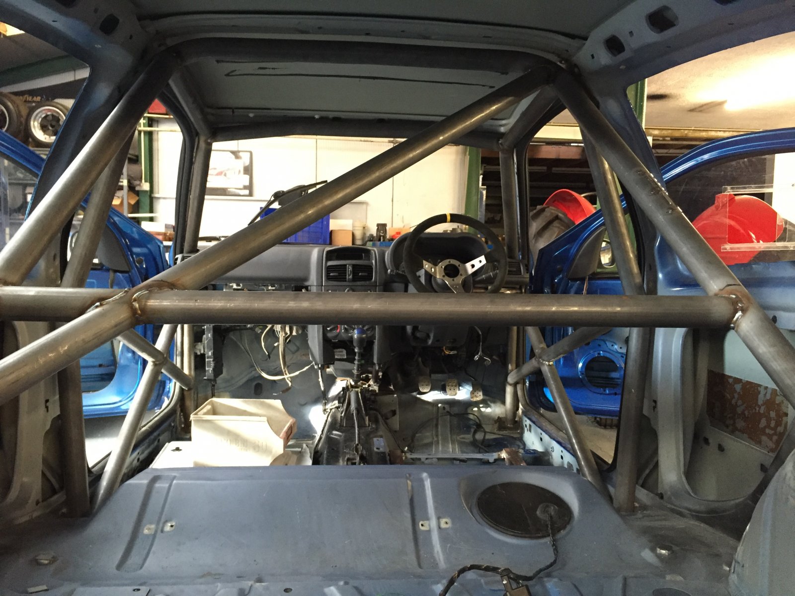

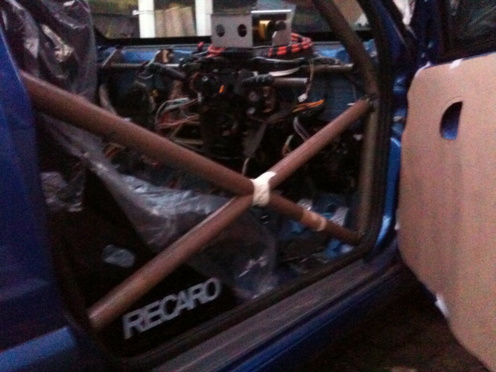

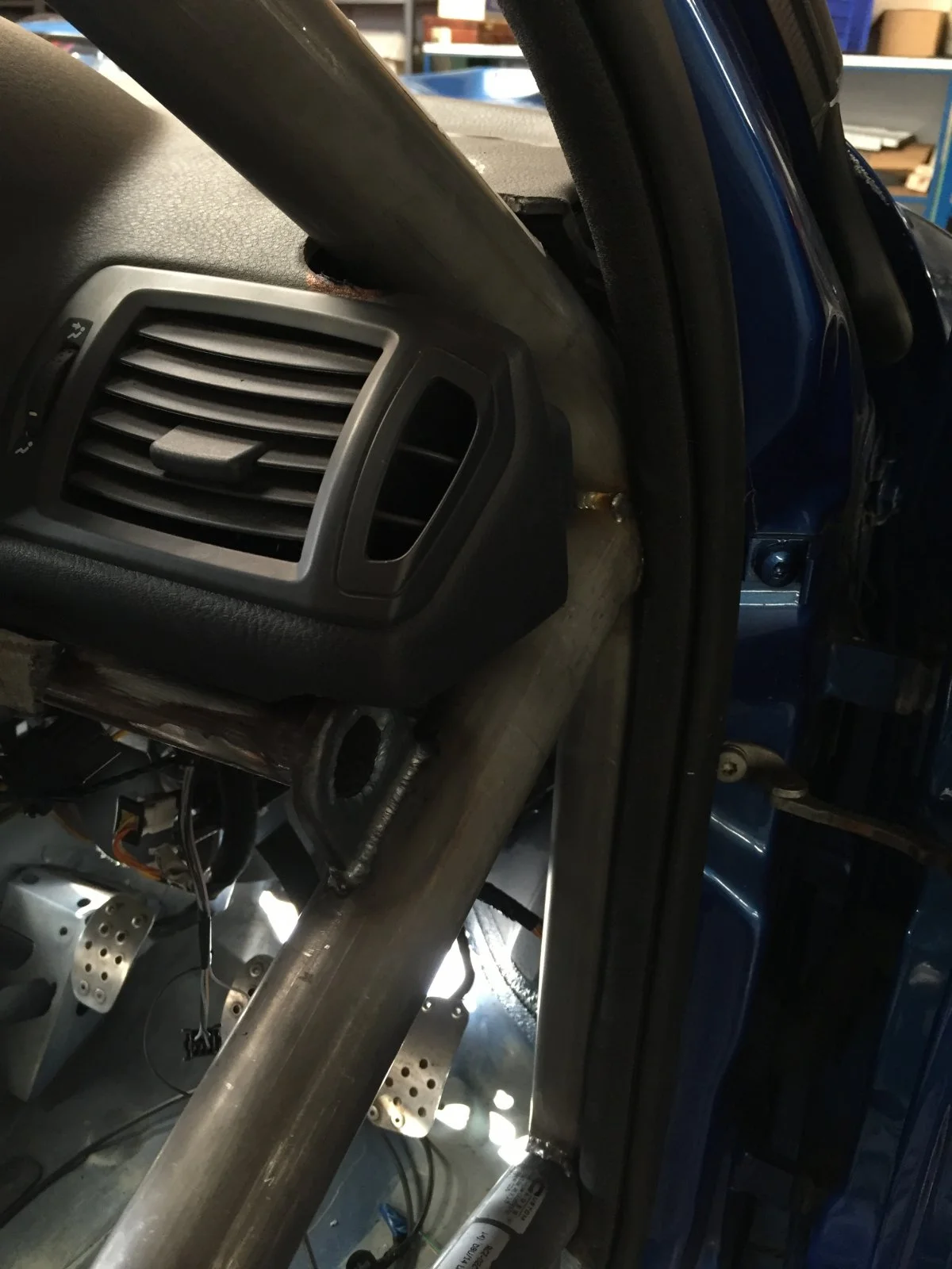

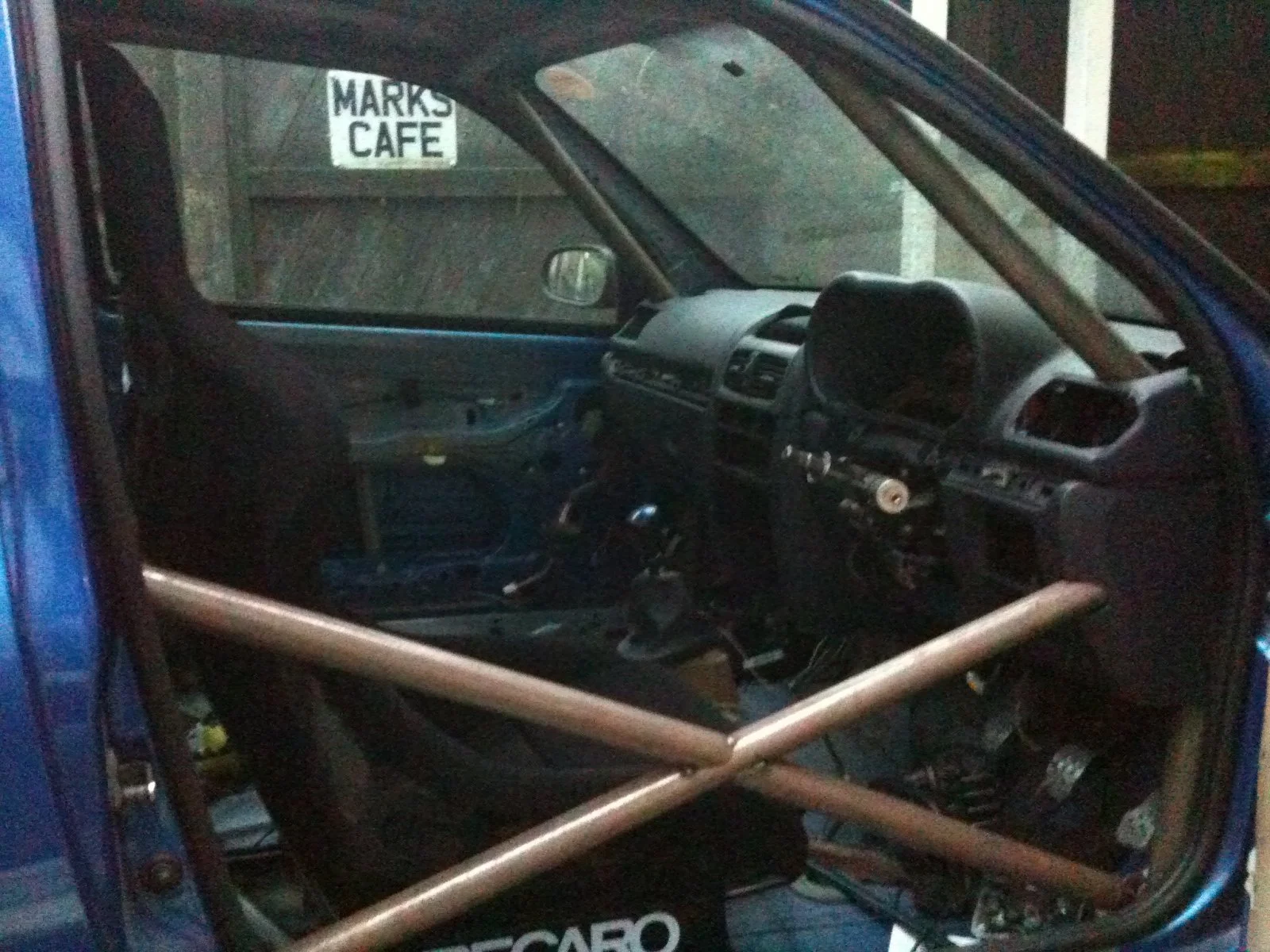

This is about as good as it gets mate, as I don't have that many pics of it in that stage.
You'll have to cut the ends off the end of the dash support mate to get the tubes in.

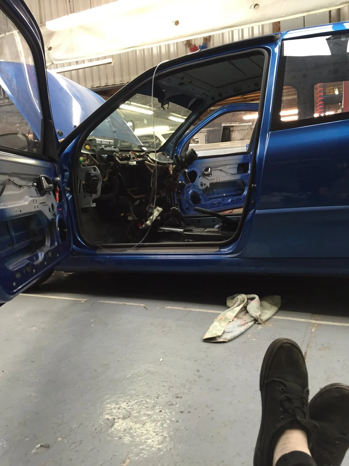

Car went into the garage today to start fitting bits and bobs!
Received the cage and it looks.....confusing!! Has some good advice from people who have this cage so will attempt to get some pictures along the way.

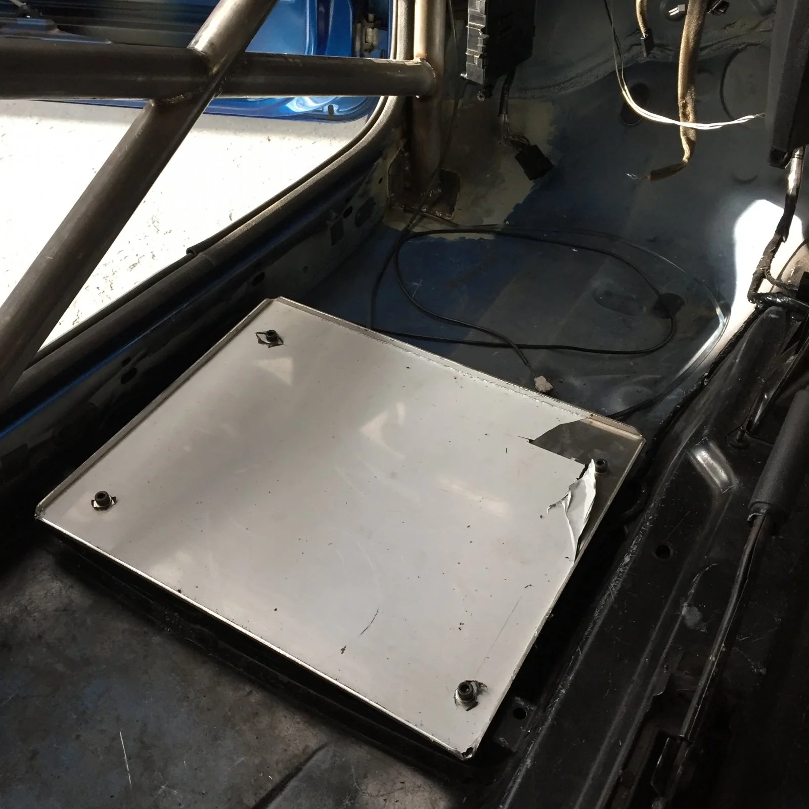

Update

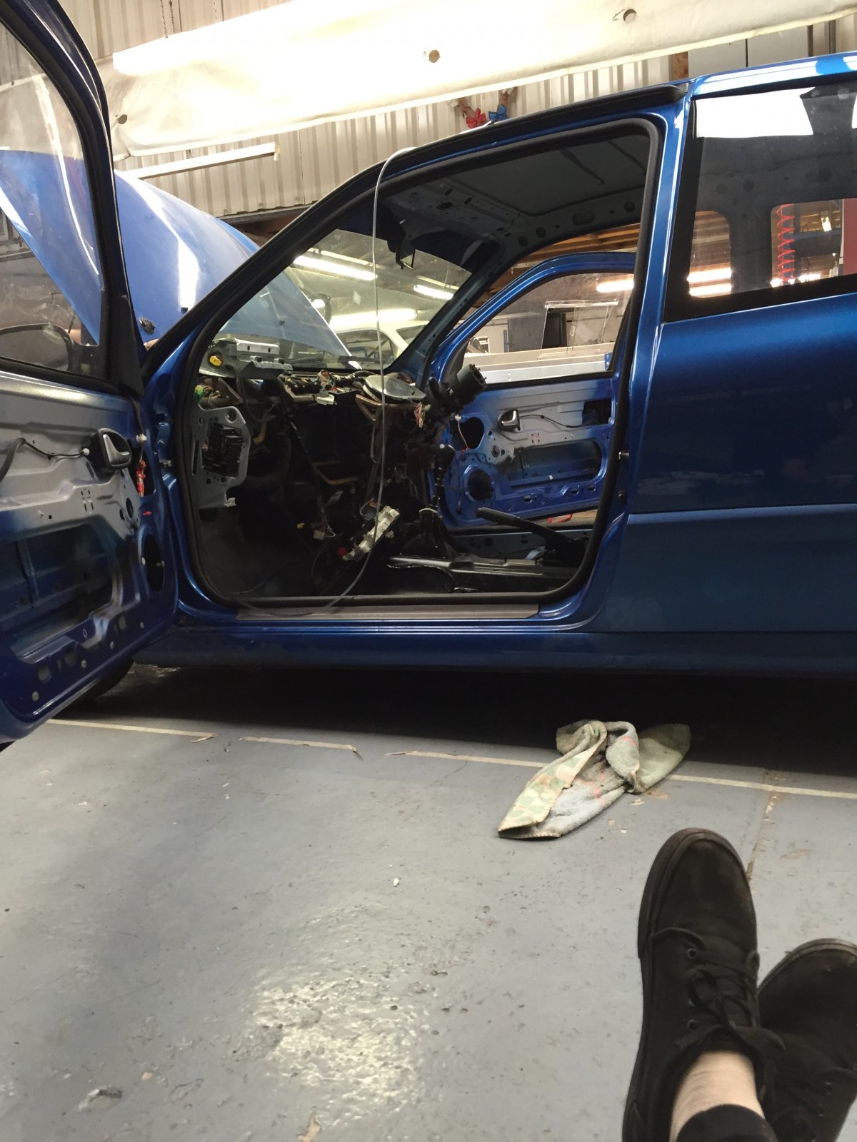

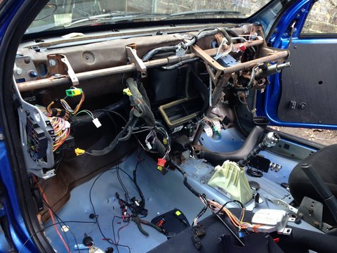

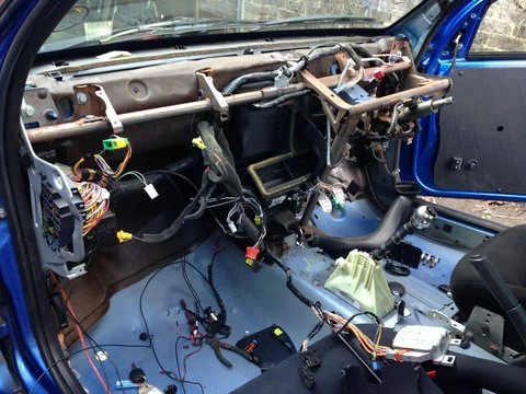

Went to the car today to clear the dash out and take the boot off to make it easier for welding.
I never want to remove the dash again never mind fit it back in It's a pin to remove.

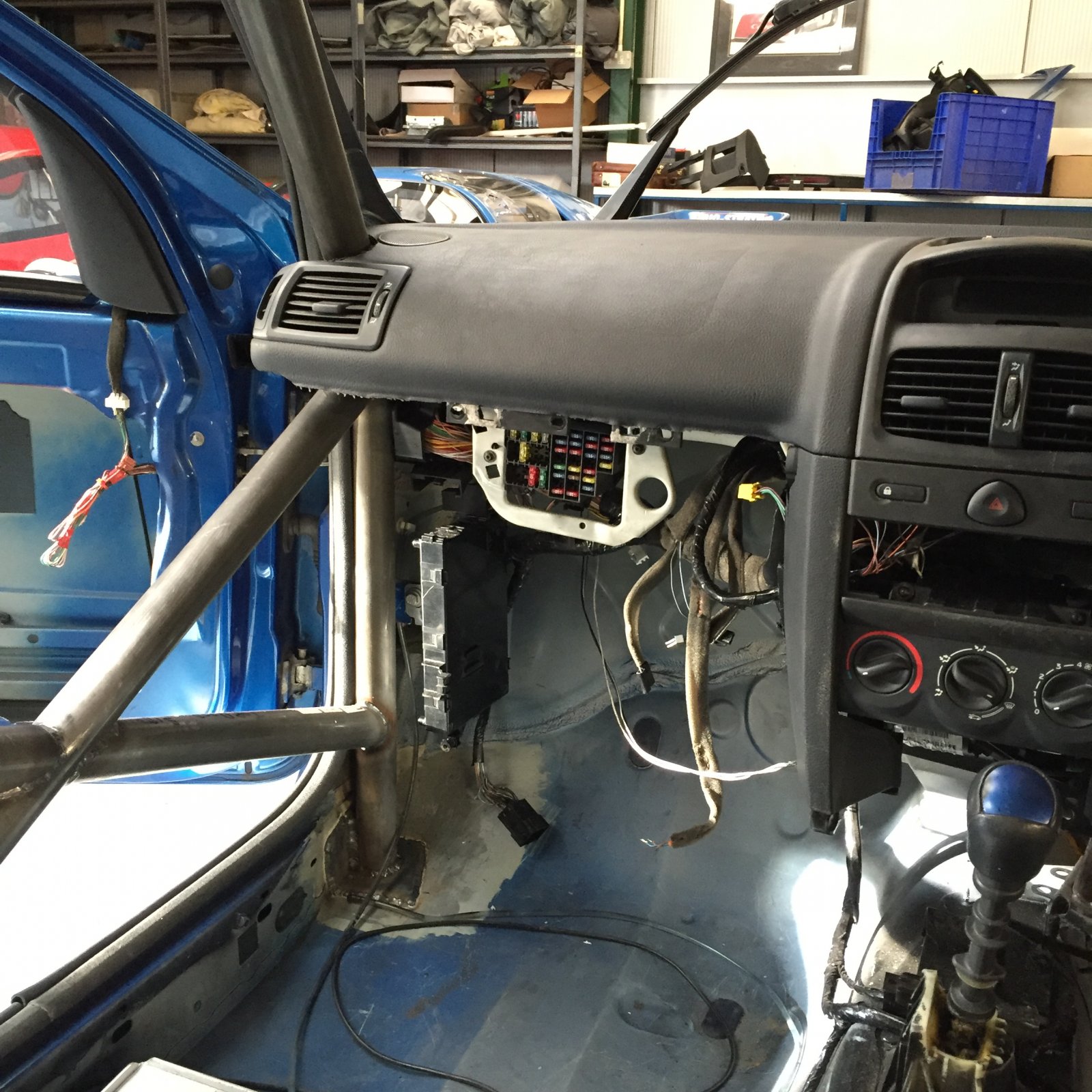

If you have removed your dash can you send me pictures of what they look like now so I can get an idea of what to put back and what I can get rid off.
Few pictures....

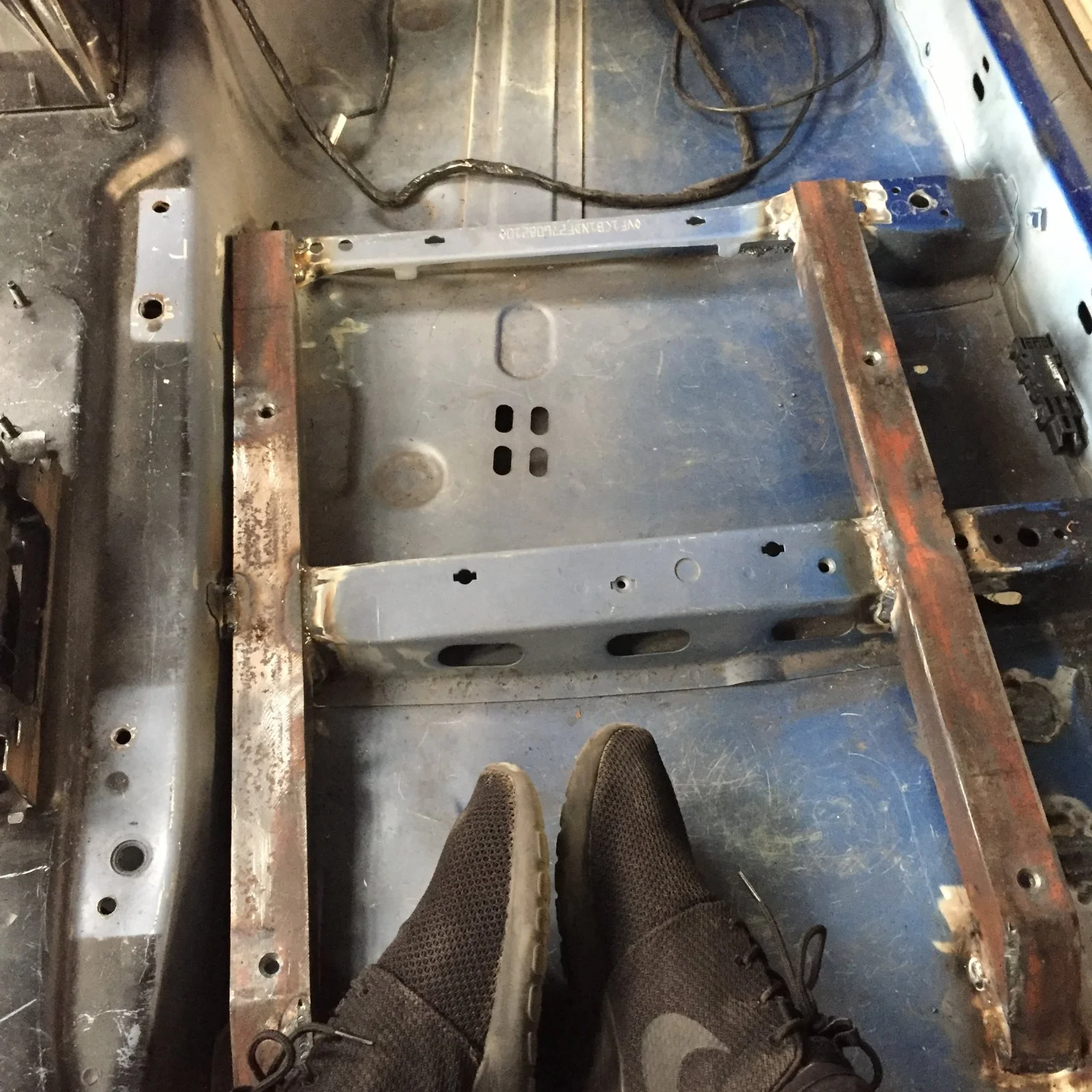

Update 2/8

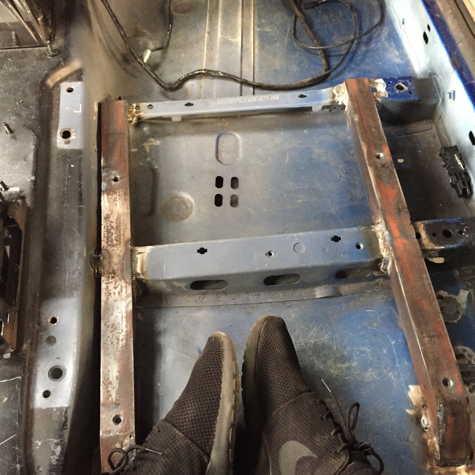

Been up to the Clio tonight, huge amount of progress which is good news! Cage is all fitted now apart from the harness bar so I lined up my seating position so the brackets can be made and fitted tomorrow along with the harness bar.
All messy bits like dash and wiring are being sorted at the weekend so hopefully in the next 2 weeks I can get a run out somewhere to make sure it is all okay and get it all set up nicely.

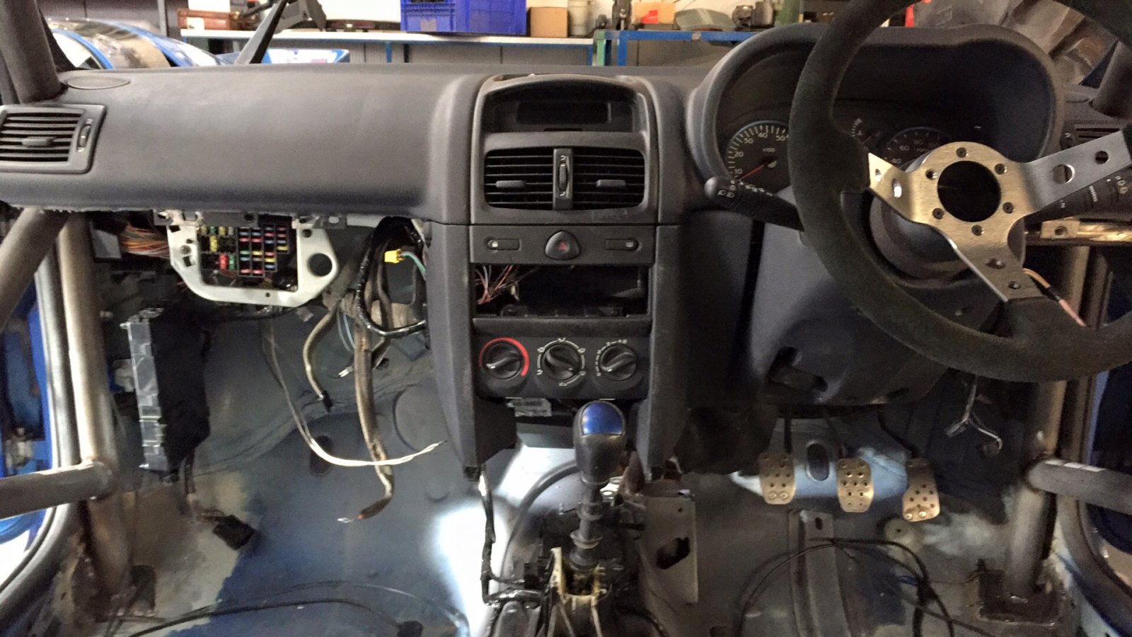

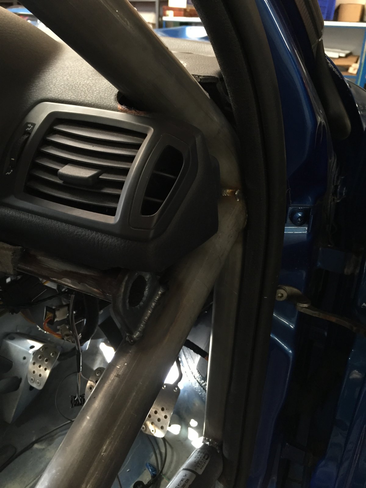

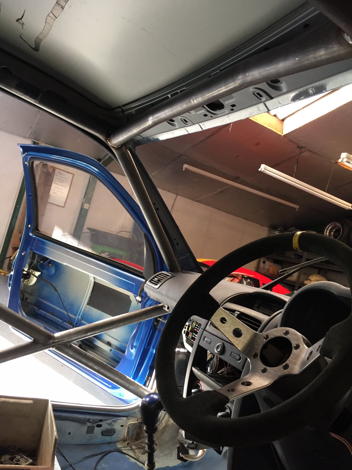

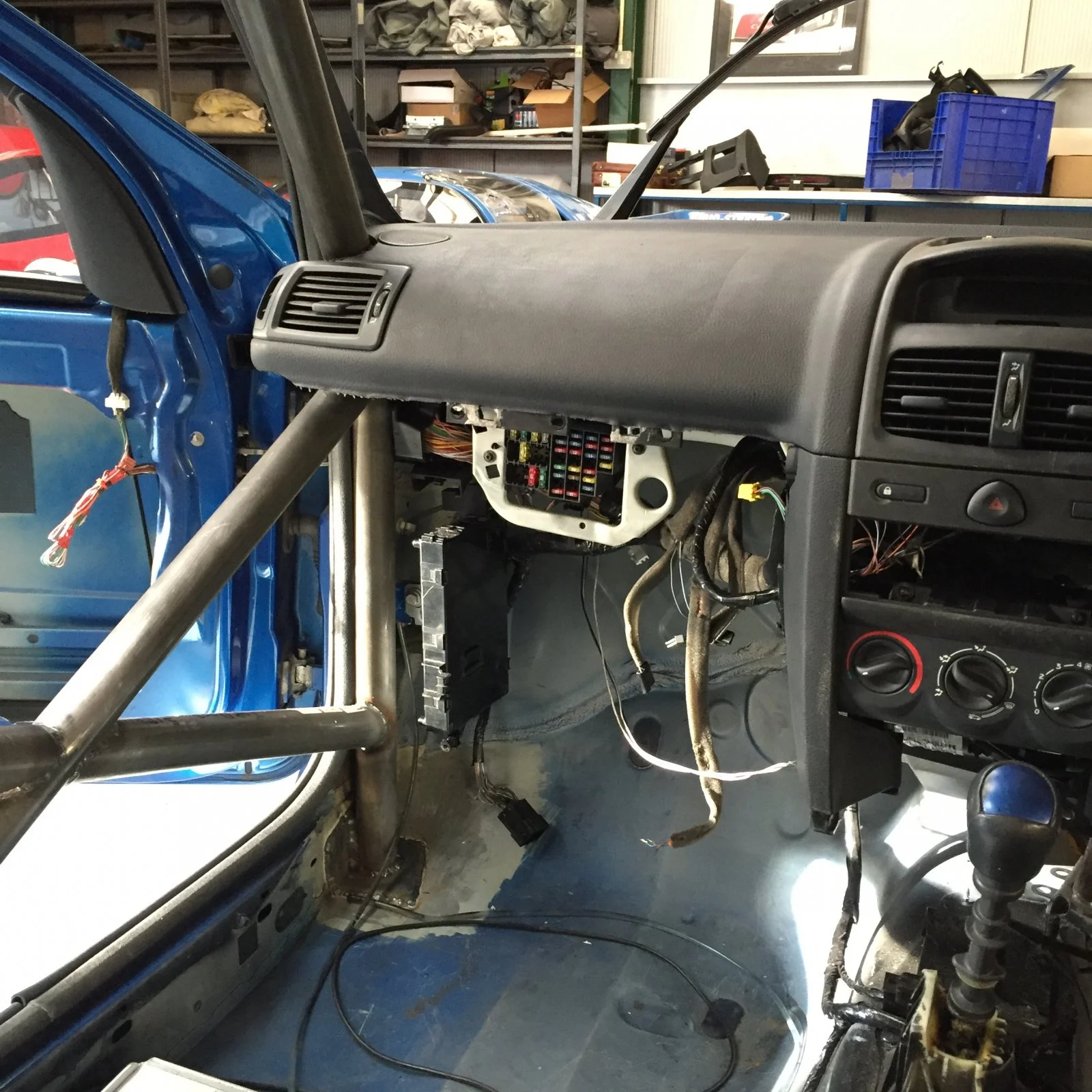

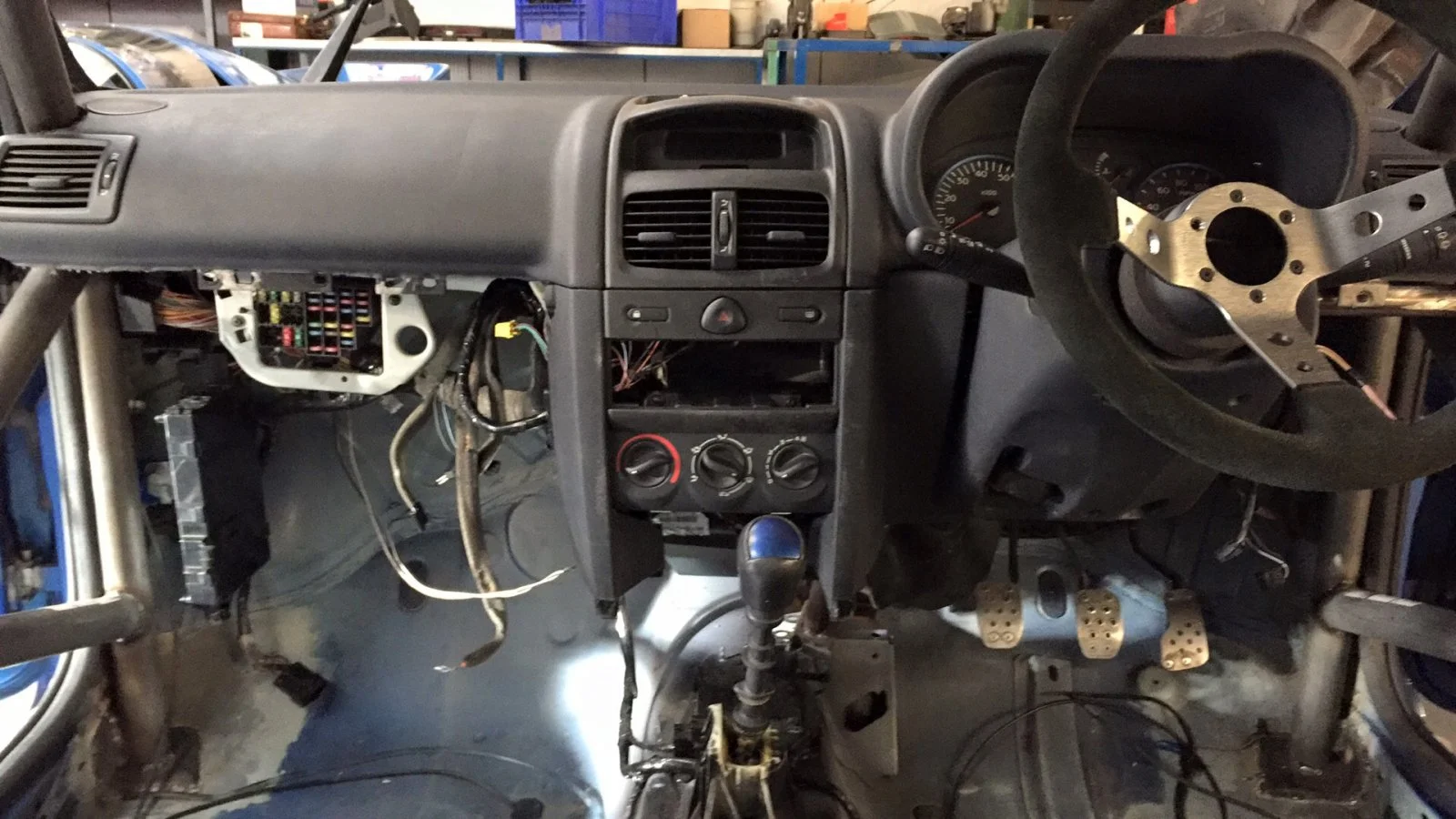

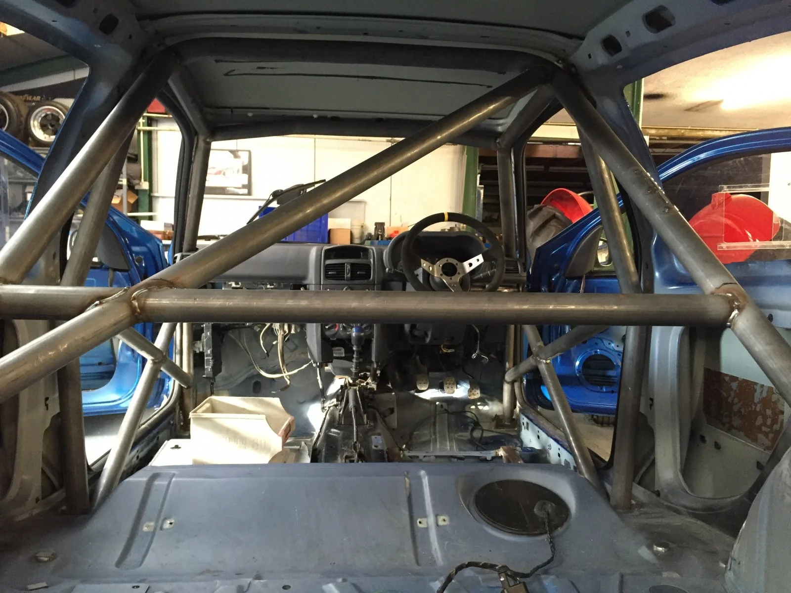

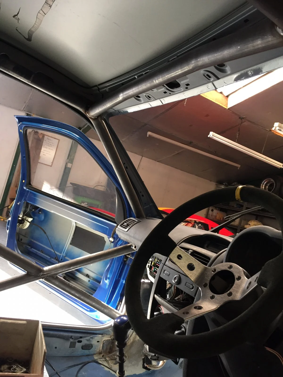

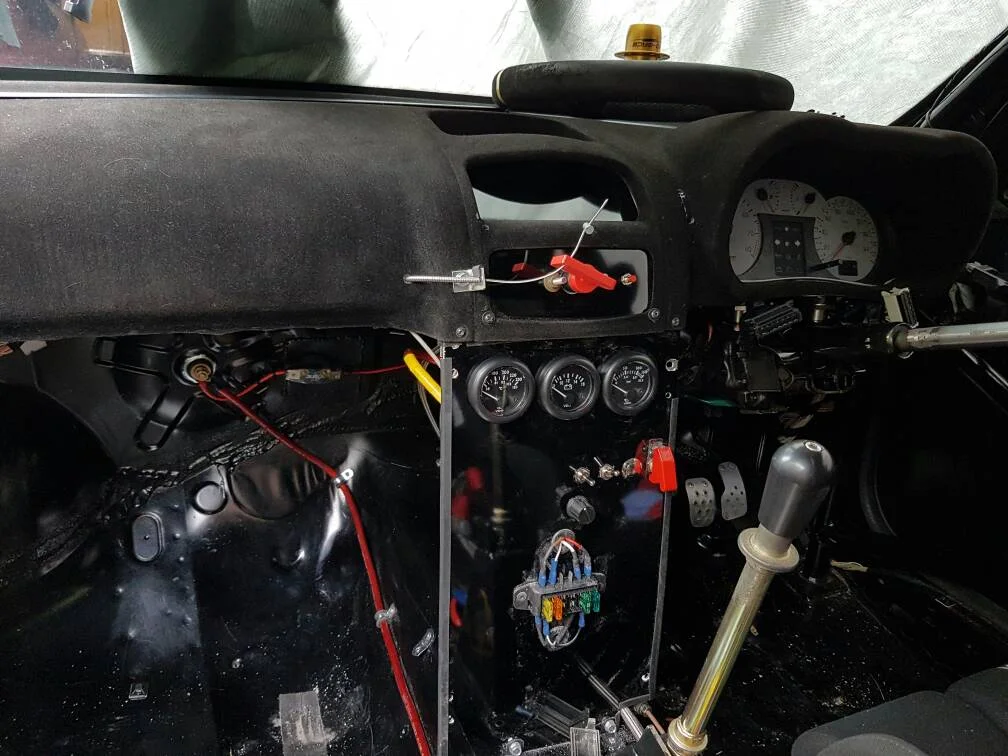

Few pictures of the Clio tonight now I have been down!
Got the top dash fitted in and trimmed the bottom dash down to the middle piece only as I am still running the heater.
I need to send my seat back as it is twisted would you believe! I will speak to JJC tomorrow and see what they say.
Needs a nice tidy up but progress is progress.

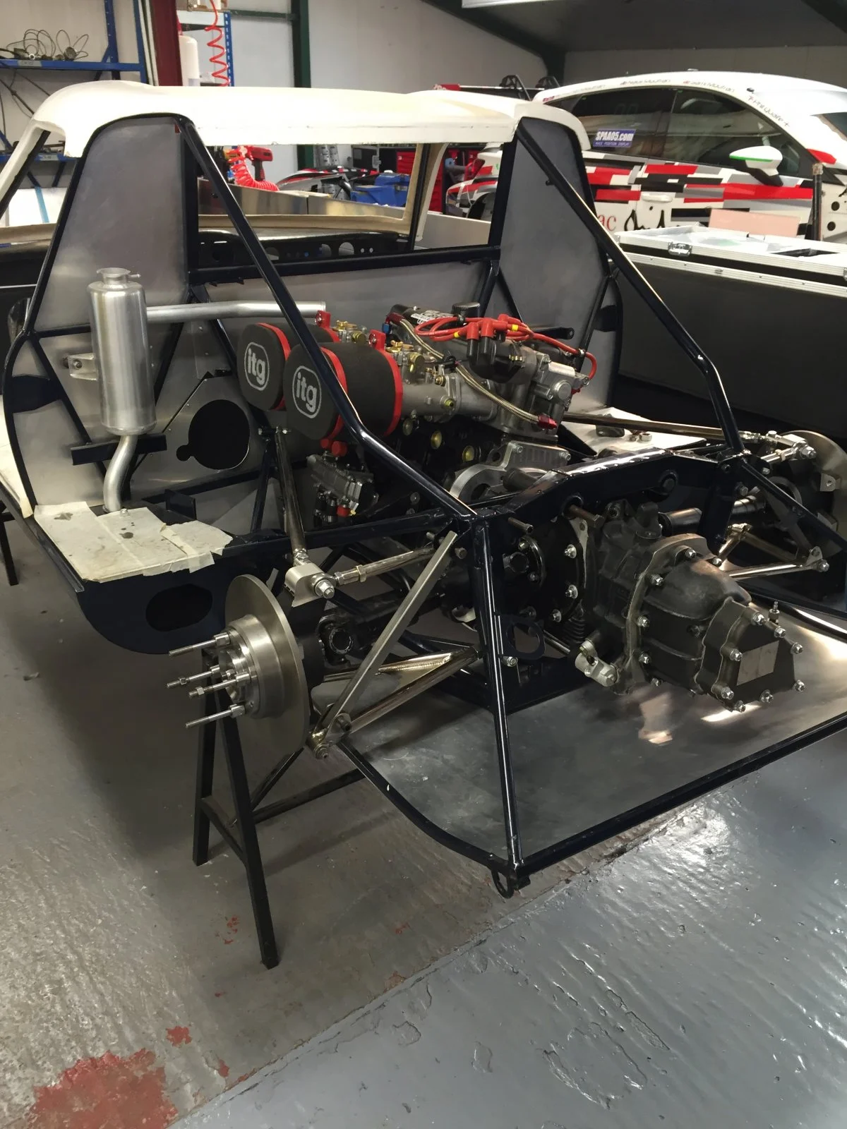

However not as nice as some of the other cars in the garage....
